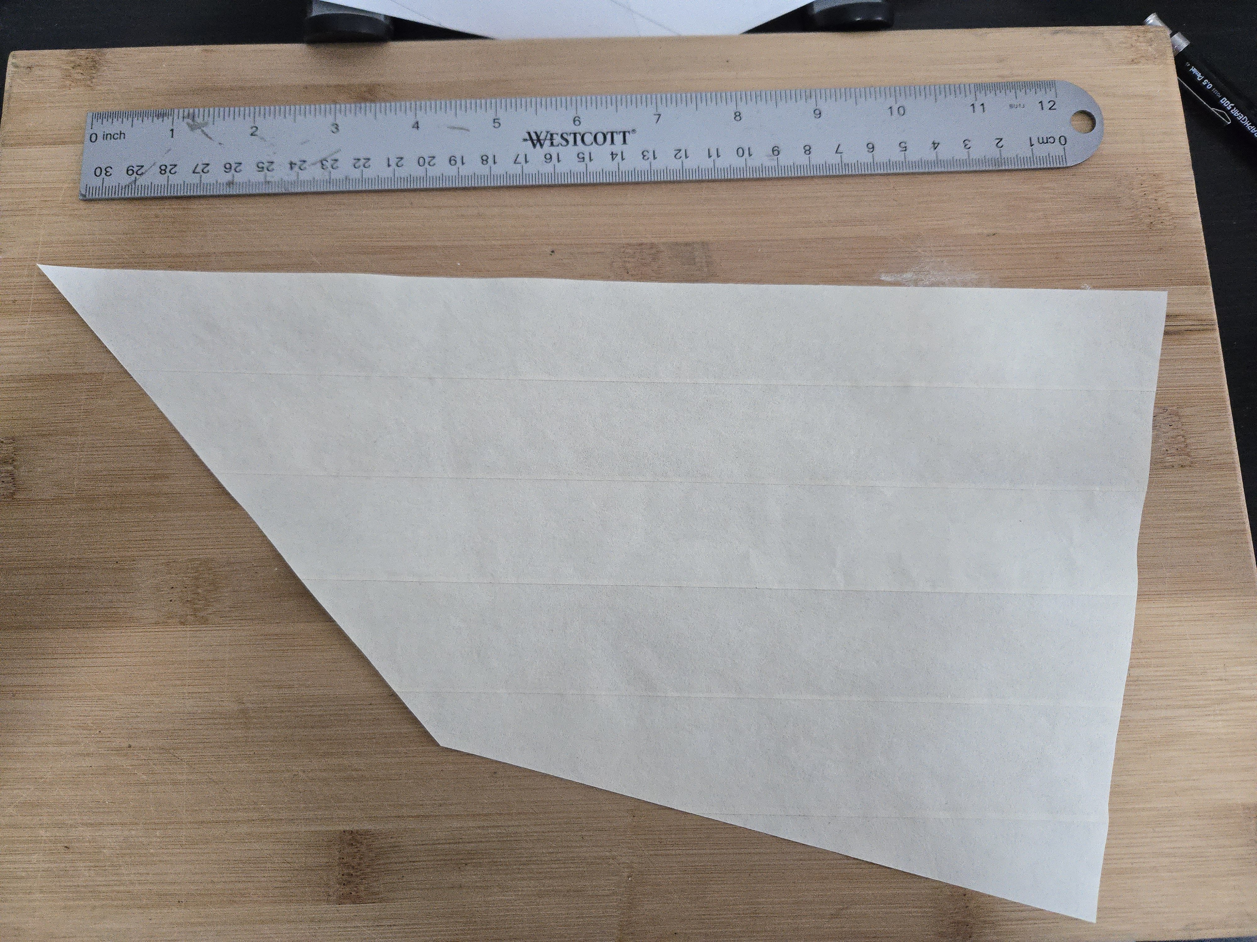

I'm working on making paper sails for my Lancha Chilota build, and was wondering if anyone had any advice on how to iron them. The sails are made of coffee filter paper, colored and stiffened with a watered-down mix of acrylic paint and white glue, and the panels are glued on with Aleene's Fabric Fusion glue. While it isn't horribly wrinkled, it would be nice to get it a little flatter, but I'm not sure what the best way to iron it would be--low or high heat? Underneath a cloth to avoid direct contact with the iron? Damp or dry? If anyone has any experience with ironing paper sails, I'd love to hear it. Thanks in advance!

In any case, don't iron sails already treated with acrylic paint. The paint is not heat resistant.
Otherwise, I ironed silk-paper slightly humid with a wool seeting or so between two thin cotton towels. Keep the iron moving, it is easy to 'brown' the paper ...
Thanks, all! Based on your suggestions, I experimented a bit.
