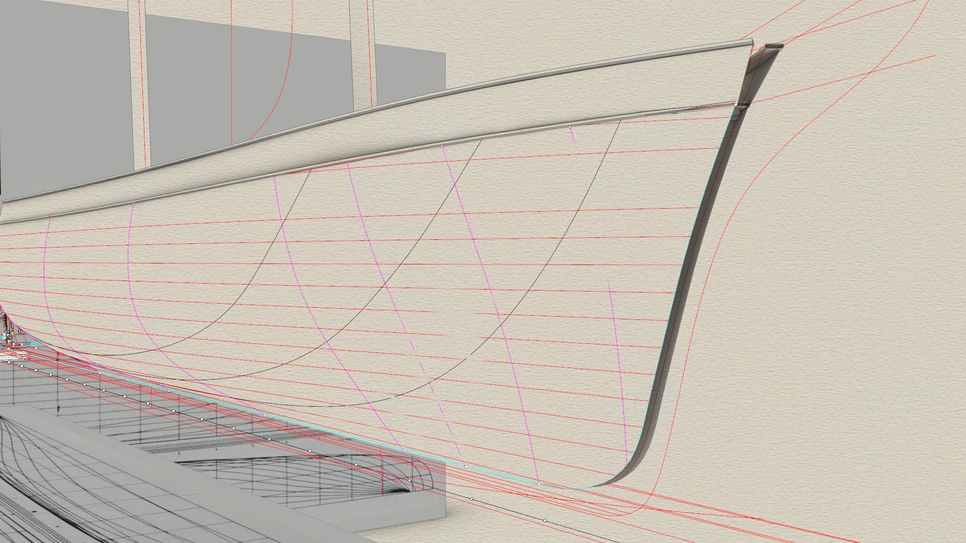

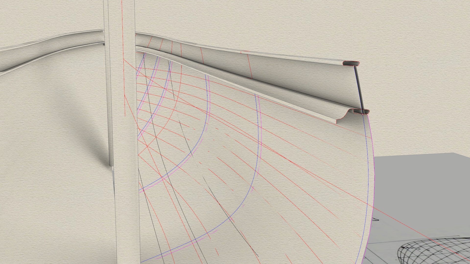

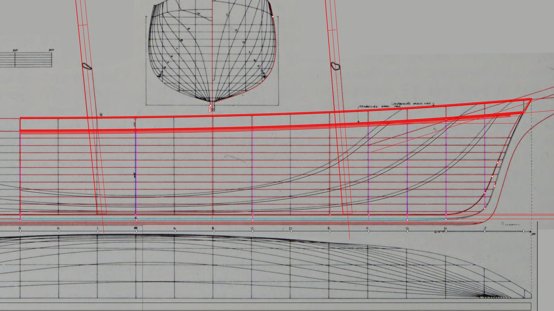

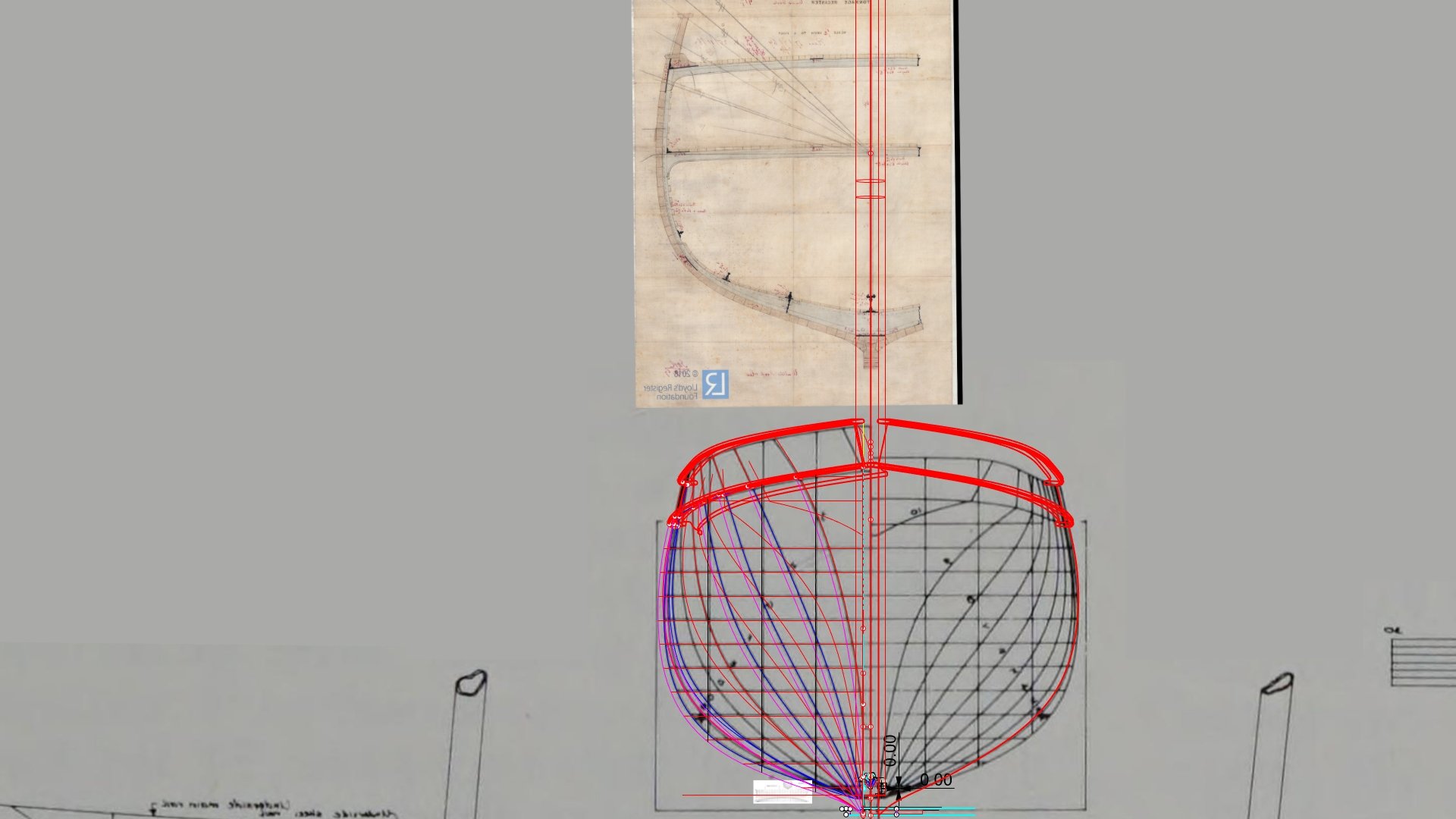

I have been able to source the original Walter Hood Offsets from a private collection and reconstruct the lines moulded. this of course, means inside planking so the tapered planking needs to be factored in, but I am excited to be able to produce this set of drawings finally.
Edited by Richard Dunn
Forward Lines recreated from offsets.
They are very different to Cutty Sark
The blue sections are the moulded offsets
The buttocks here are on the planking , but the plan is moulded so they don't line up in this view, and of course because Thermopylae had 6 inch planking over the middle 3/5ths of her girth tapering to 4.5 inch at sheer it throws out the lines a bit.
