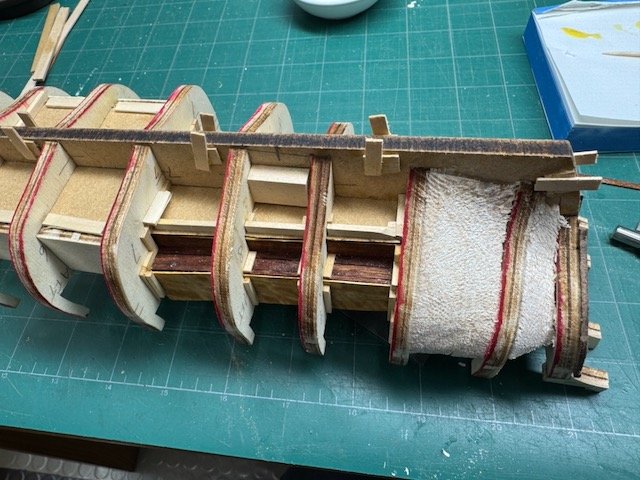

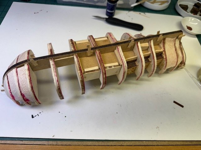

I'm hopping around on the model right now; there are a number of isolated tasks whose order doesn't depend on each other.   This post is only about the start of fairing the hull, i.e. the bow and forward four bulkheads.   I found the instructions and the various web logs ambiguous on exactly how the area right at the bow ought to be prepared,  yet it's absolutely critical to the planking that one gets this right.   Or so I believe right now.   The instructions discuss fairing and planking later than I am in the work, but I decided to start early to minimize the possibility of banging something else up with all the rough handling that the hull is sure to get.
Instructions call for balsa filler only right at the bow, forward of bulkhead #1.   But, after studying other logs, I decided to put in balsa starting at bulkhead #3.   I also put in some aft, between frames #10 and #11, but that's probably not necessary - what I really meant to do (and have now done) is to add balsa aft of #11, between it and the not-yet-installed transom #12.
I also decided  to add temporary stiffeners on the bulwark ears of bulkheads #1, 2, 3 and 11.   It will be easy to remove them later, and those ears get their share of stresses during the fairing.
All of the fairing work I've done so far involves only the area between the bow and bulkhead #4.  The stern can't be done until bulkhead #12 is installed.  And the midships in between ought to be simple and straightforward.
One caveat which I hope is obvious:   it's not a given that the way I'm going about this is the "right" way.  Time will tell.  The next several photos are pretty repetitive, but I want to give future builders of this kit clear visual information about how I'm going about it.  My plan is to leave space for a ~1.6mm rabbet (i.e. the plank thickness).   On top of the 6.5mm false keel in the pictures will be attached an 8.3 mm walnut keel.   I am undecided as to whether the keel ought to be attached before I start planking, or not.    The instructions don't do so,  but at least one build log (a good one) does.    Nobody talks specifically about the rabbet, and the discussions usually go no farther than to make general statements about the shape being tough to plank.
Here are my photos showing how I've done the fairing.
IMG_9311.jpeg.0556d4ead8d889a84ab5ef22b0cbb623.jpegIMG_9312.jpeg.ce8b078cc1e86df41b345e5dc08c6efc.jpegIMG_9314.jpeg.3c44cbb0bb97a7489492f50e02ae9f23.jpegIMG_9315.jpeg.79d5bc4a392743ce79b2d5e4f6317299.jpegIMG_9318.jpeg.aa504435541e6d3a5c9190aa1a13a668.jpegIMG_9319.jpeg.aa02289d8410b2ef0b92e1bf871bc67b.jpegIMG_9321.jpeg.b326606626cb5f1e89c7392ef93c6e49.jpegIMG_9322.jpeg.5f3b59a9659faeedd6c79d50be579414.jpeg
In this last photo I'm holding a plank to show how it sits against the false keel.
My tools for the fairing shown, incidentally, are all rasps.  The red lines on the bulkheads are to make it clear when I'm sawing away where the margins are.

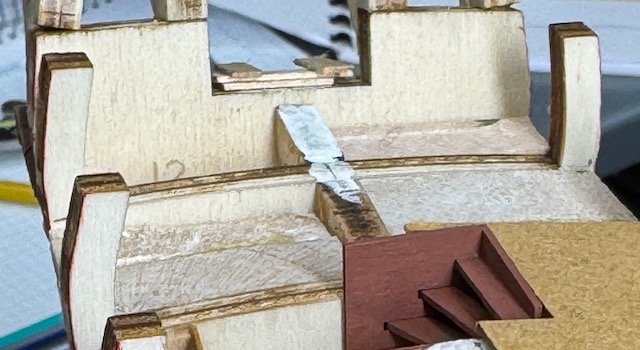

After installing the staircase I made the sequencing mistakes warned against at the start of this post.  What I did was the following: veneered the after bulkhead; realized that the extra part 10 existed, and installed it on top of frame 10; realized that part 10 was supposed to sit on top of subdeck D and its planking; so I then added a 2mm top to my part 10 so that top deck, when laid, will have the proper sheer.  I also had to scrape off the now too-short veneer I'd applied to the after bulhead of the interior cabin.  I redid that veneer before gluing down subdeck E.
IMG_9526.jpeg.104201ce03a3f36a45b133ccf0165f44.jpegIMG_9529.jpeg.54832c09e088975bfeff81029b7face2.jpeg
I hope there will not be further repercussions from that misstep.

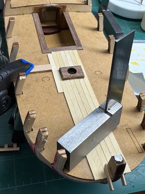

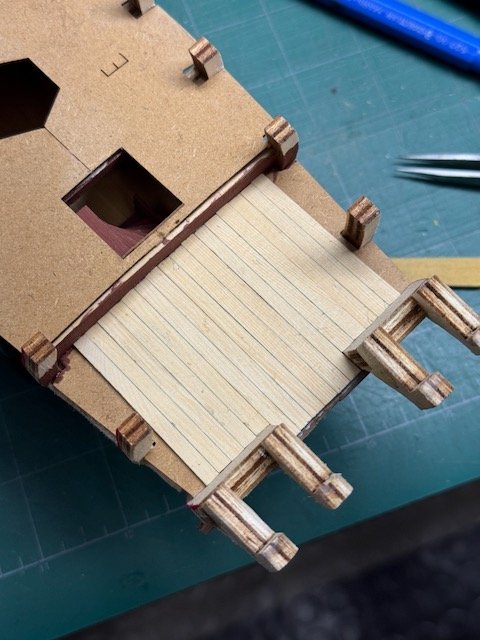

To start off, I've started planking the decks.  I'm using Alaska yellow cedar for most of the deck.  The kit supplied basswood is fine - all of the supplied wood looks great - but I think AYC will look a little better, and to be honest I wanted to mill this myself (from stock I had on hand) just for the exercise.
A question I'm working out as I go along is is how much of the deck trim details, e.g. combings, borders around the deck houses, etc. I'll highlight with walnut.  On a typical model I wouldn't do this, but it seems appropriate for a showboat kind of vessel.
I started on the aft most deck (which will be almost totally obscured when the big after deckhouse gets added).   First I levelled the area where the tiller enters, and then planked out to the stanchions.   On all of these decks, the outer part obstructed by the stanchions will remain unplanked for now.
IMG_9631.jpeg.81e30712fa8a1849ed77cdf04dc2c8d8.jpegIMG_9632.jpeg.51443230b2f9c6af070f433c275e2533.jpeg

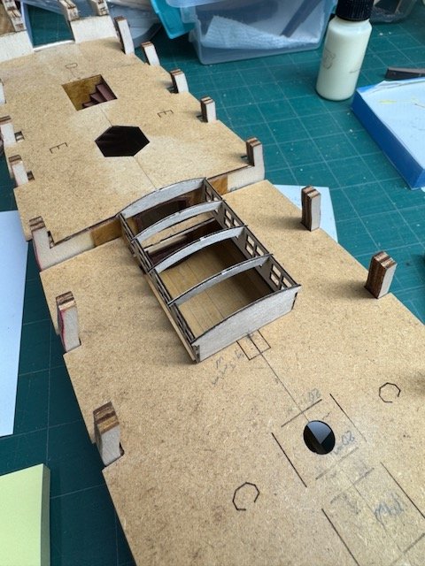

Back to deck planking.  I constructed the frame of the midships deckhouse earlier than called for so I could see exactly how it was going to fit on deck.  As the instructions note, the subdeck opening down into the midships cabin is a tad wider than the cabin structure, so some support has to be provided for it.  Also, the deckhouse top piece will be removable, so I've made a supporting surface (of walnut) that will eventually have a rabbet to register the deckhouse's position to prevent it from sliding around in heavy seas.  Visually, it will look like a baseboard around the cabin.
IMG_9580.jpeg.4cceb9cb85431a24e96b81399645c525.jpegIMG_9582.jpeg.ce2268221215df7d1b5825ddbb1c78ce.jpegIMG_9599.jpeg.346afb2c94298d4641b77bd149d2d5fb.jpegIMG_9646.jpeg.242db7763e881ecdc8446ab6e9e82bf6.jpeg

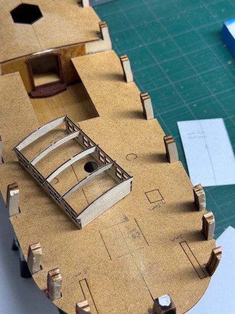

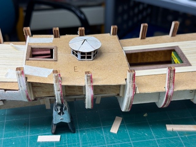

I've also assembled the little hexagonal cupola that looks down into the after lower deck cabin.  Assembling that piece would have been pretty easy had I only followed the guidance in the instructions. They say to assemble the rafters first, and then attach the windows. Which makes great sense.  What I did was to first arrange the windows in a hexagon, fit the rafters on to them, then glue it all up.  My way did work, but it required a lot more cuss words than would have been needed doing it the right way.

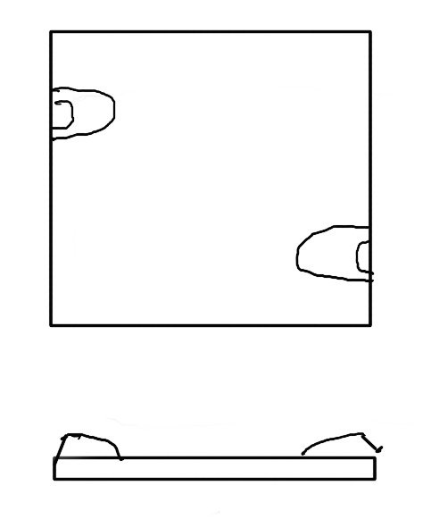

I sometimes wander down rabbit holes trying to decide about small details, and in that vein I've been looking at the two small hatches that are forward of the deckhouse.  The kit photos show the forward hatch cover as having what look like a couple of straps for lifting, and the after (slightly larger) one has hinges and a ringbolt.  Both of those hatches sit over their coamings, rather than sitting in a rabbet in the coaming.  In trying to decide the details of exactly what they ought to look like on my model, I studied drawings from Hoving & Emke's "17th Century Dutch Merchant Ships Plans Set for modelers".  That publication has drawings for numerous vessels of widely varying size from the statenjacht's period.  And, most of them smaller than a pinas have hatches similar to those on this kit.
Thanks to those detailed drawings I can see, indeed, that it was common for hatches on smaller vessels to enclose the coamings.  Those hatch covers didn't rise very far above the deck - looks like no more than 2-3" (I haven't tried to measure it yet). None of the Hoving/Emke drawings showed hinges, though maybe they were sometimes present in real life.  But several of those hatches had a pair of cone-like features, and I wondered what they were.  After much digging through my references, I found the explanation by Ab Hoving in "Dutch 17th Century Ship Models in Paper".  On p. 43 there is a photo whose caption describes it as "Hatch for the cable tier".  In accompanying text on that same page, he says,"The hatch for the cable tier has covers on both sides over the holes where the anchor cable passes". And then "The small hatches entering the spaces below decks can simply be cut from 1mm card.  If you like, you can glue coamings around them, But on board this simple ship most hatches fit over the coamings, which means that they are not visible, unless you want to show the hatch in open condition."  I intend to follow Hoving's guidance on how to do my hatches.  Mine won't open - there's nothing to see below decks there.
This is a poor sketch of what I'm talking about...

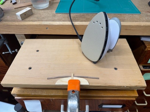

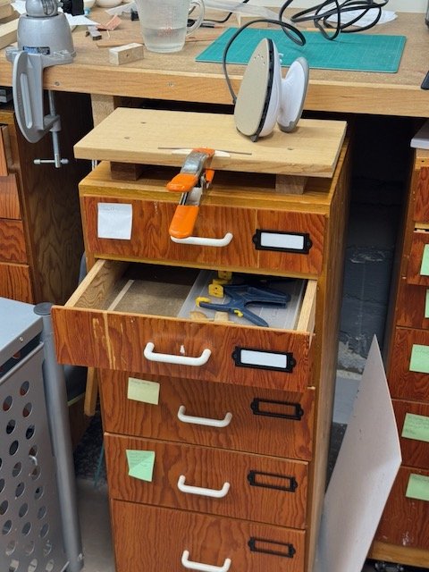

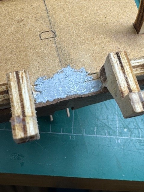

I always have trouble finding bench space when I need to start bending planks, so I built a little platform for the purpose on one of my roll-around tool cabinets.  With this setup, plank bending is ready to go anytime, but won't be in the way when not needed.
IMG_9578.jpeg.16a3aaf168080b7728df7cc3820d50ba.jpegIMG_9577.jpeg.93102038ddf5d93da51d69f64412a960.jpeg
The stem, sternpost and keel are all very nice laser-cut walnut pieces which I will probably attach before starting to plank.  In preparation for gluing them on, I've put temporary tabs on the false keel to make it easy to keep those pieces centered.
IMG_9521.jpeg.e28de5657af1fb81b995c80464c7007c.jpegIMG_9532.jpeg.ba5249b4b3edf00601e9168424ee2bdc.jpeg
I used this same system when attaching the transom, so I could ensure that the sternpost position on it was properly aligned with the false keel.  I don't have any pictures of fitting the transom, unfortunately.  But in the photo below you can see where I had the temporary alignment tabs.
Before installing the transom, I fitted the sternpost because fitting's a finicky process and easier to work flat on the bench. But I didn't glue it on.  Then, when installing the transom, the sternpost had to be temporarily involved again in making sure the transom position was correct.  The tabs helped make that a relatively easy process.
The deck stanchions at the tops of bulkheads will eventually be cut away, after the outer hull is planked.  So I sawed all of them 1/3-1/2 way through on the outboard side, while it's very easy to do.  I hope I left enough meat so they don't break during the planking process.

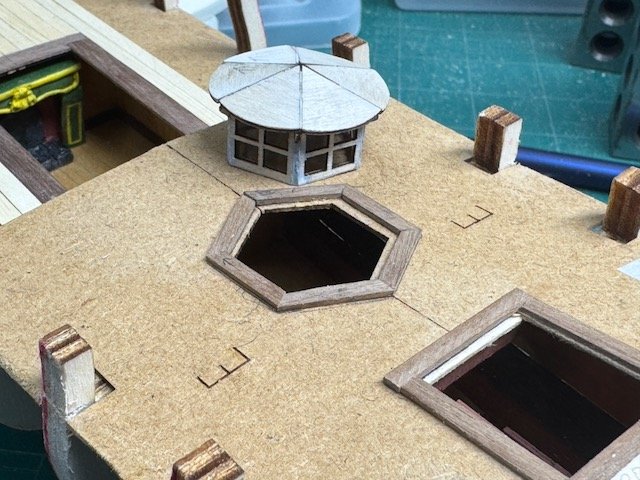

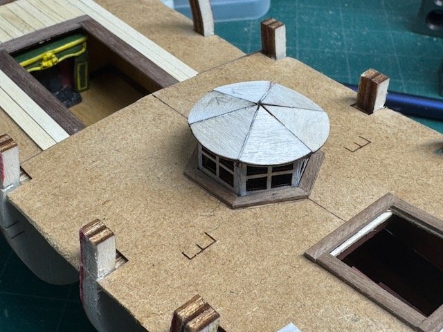

Here's a short update on my progress.    First is where I am on the little hexagonal cupola.   I've added the walnut skirt around its base.   The way I've handled the base is not exactly as it is in the instructions,  but the ideas are the same, I think.   Besides having the structure look good, I want to make sure that its removability is discreet, i.e. that the viewer can't tell that it lifts off.  (Because it might not - I'm still undecided as to whether I'll glue it down or not.)
 IMG_9696.jpeg.ef41458aea1e7810f2dceb549940d623.jpegIMG_9701.jpeg.b2d2ebb1b13383fda8b152653ca86941.jpeg
After getting the base all set,  what I'm working on now is the walnut roof.   The kit-provided subroof is very helpful in getting a good finish layer installed.   As you can see,  the leaves of the subroof are rounded, which visually makes a somewhat saggy-looking circle when its all installed.   Some of the build logs keep the rounded edges,   but the photos in the instructions square them off, so that the top's hexagonal like the rest of the structure.   I like that look better, so it's what I am doing.   You can see in the next photo how that's looking now, with the walnut topping incomplete.

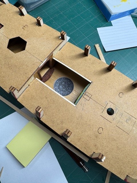

The last couple of photos show the expensive Turkish carpets I've gotten for the lower cabins.  Eventually the furniture will be painted and permanently installed,  but I'm putting that off until after the planking.
IMG_9706.jpeg.eee1edd9804cad42f2613d83f71eaea0.jpegIMG_9708.jpeg.9490f06ceb7ef822b9dc82a026218127.jpeg
