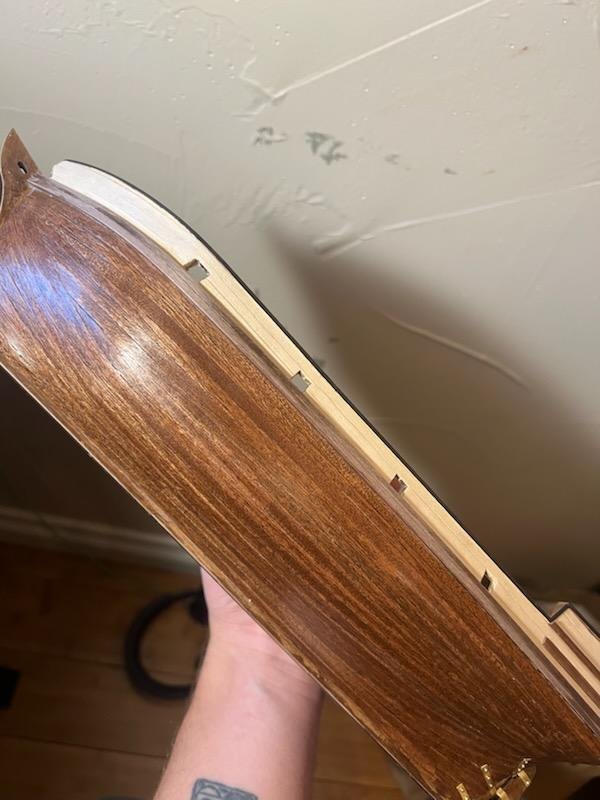

I made a rookie mistake on my Albatros hull. Because I am a rookie. I am wondering how bad this will be. I read here that I could use a clear satin, oil based polyurethane for my hull.
PXL_20251025_204531155.thumb.jpg.97085ab7a9aa018fe7d9c6e861a7e262.jpgI also read "wipe on" as a verb and not an adjective, I didn't realize dilution was a crucial step in the process. I applied full strength poly on the hull last night using a foam brush, and I fear I may have put too much on. 12 hours later it is still tacky and shiny.
Is this something I can sand down and recoat with an appropriately diluted mixture? Or should I stick with full strength and be more conservative with it's application. Thank you in advanced for advice, maybe I'm overthinking it.
 I had  to use a fan in front of a portable heater for 3 days to dry up a plastic model that I made. Air movement is the key, but like the above statement  , wait a few days if you try anything while it is sticky , you'll make more of a mess.
 Rember that two thin coats are better than one thick one.
 James, I'm unfamiliar with Varathane Polyurethane, I have only ever used Minwax Polyurethane. Once upon a time I did the same thing as yourself and tried wiping down with paint thinner and made a dog's lunch of the whole thing, In the end I still had to wait till the poly dried where I could then sand down and start over.
 Lesson learned......set it aside and wait till it dries. Find something to work on while you twiddle your fingers. :)

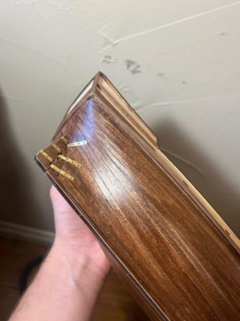

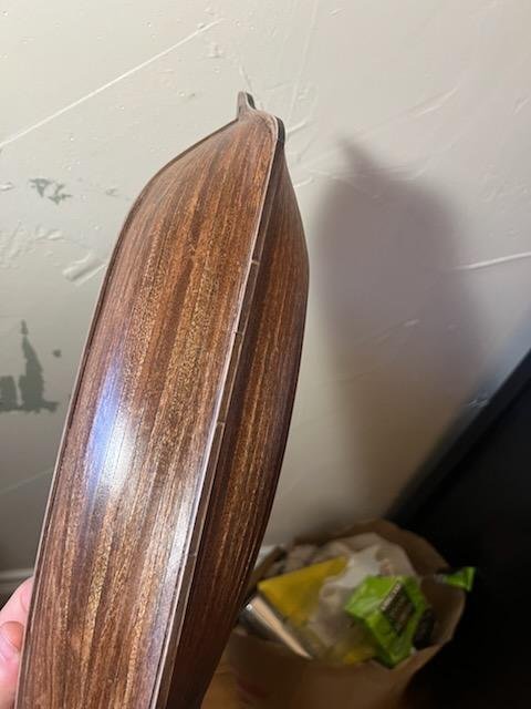

I wanted to come back here to report that patience, sanding, the right polyurethane, and also patience payed off! Here's pictures after the first coat of wipe-on. IMG_20251028_152730.jpg.af03c7cbdcf2143d760213d55c43e909.jpgIMG_20251028_152719.jpg.3749add863bca871c241ed2e2b60d67f.jpgIMG_20251028_152723.jpg.c66fc4c3068ee1ed234cb29d4f819768.jpg
Almost glad I messed up, now I get to be even more satisfied by the wipe-on experience. Thanks for the advice.
