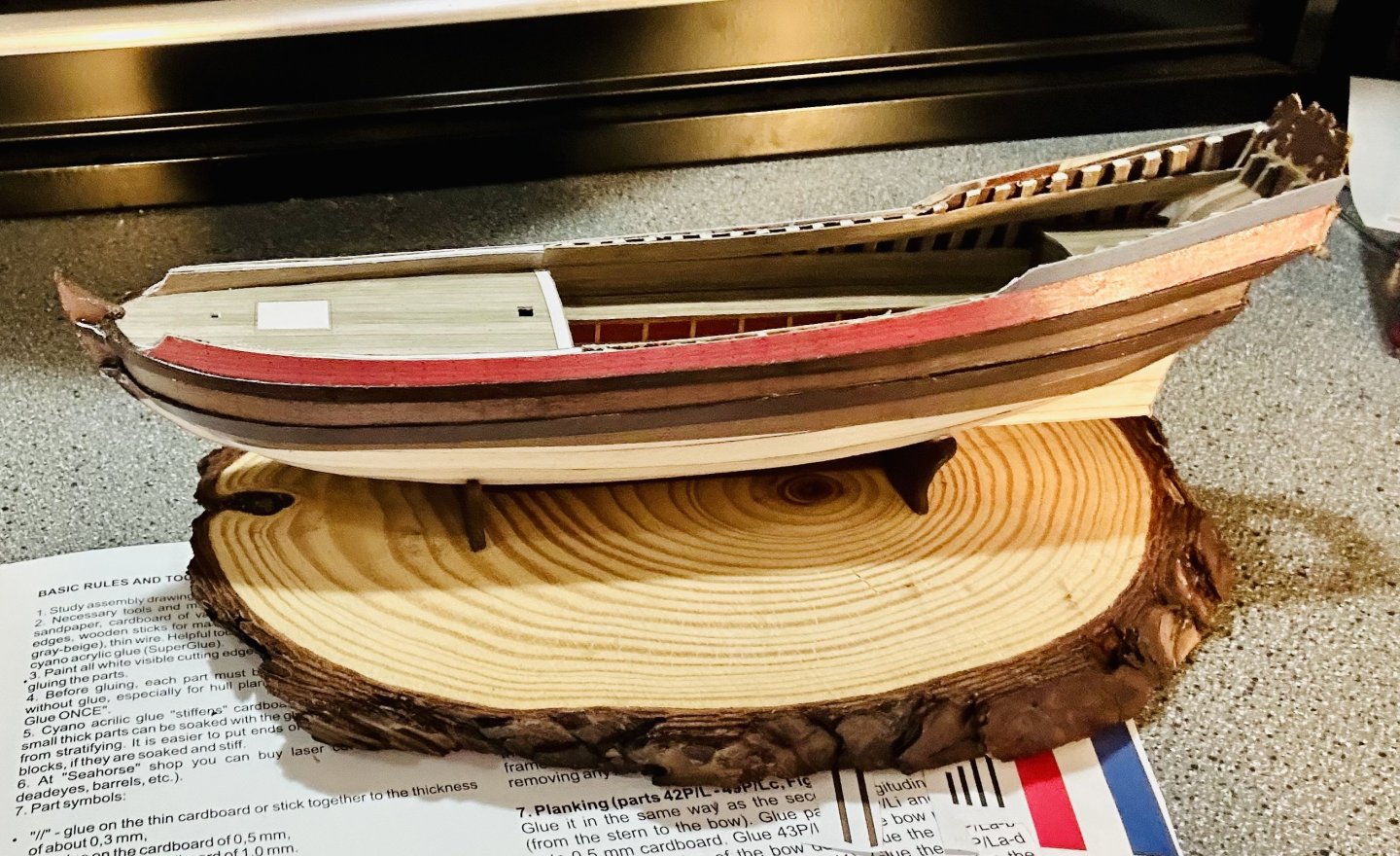

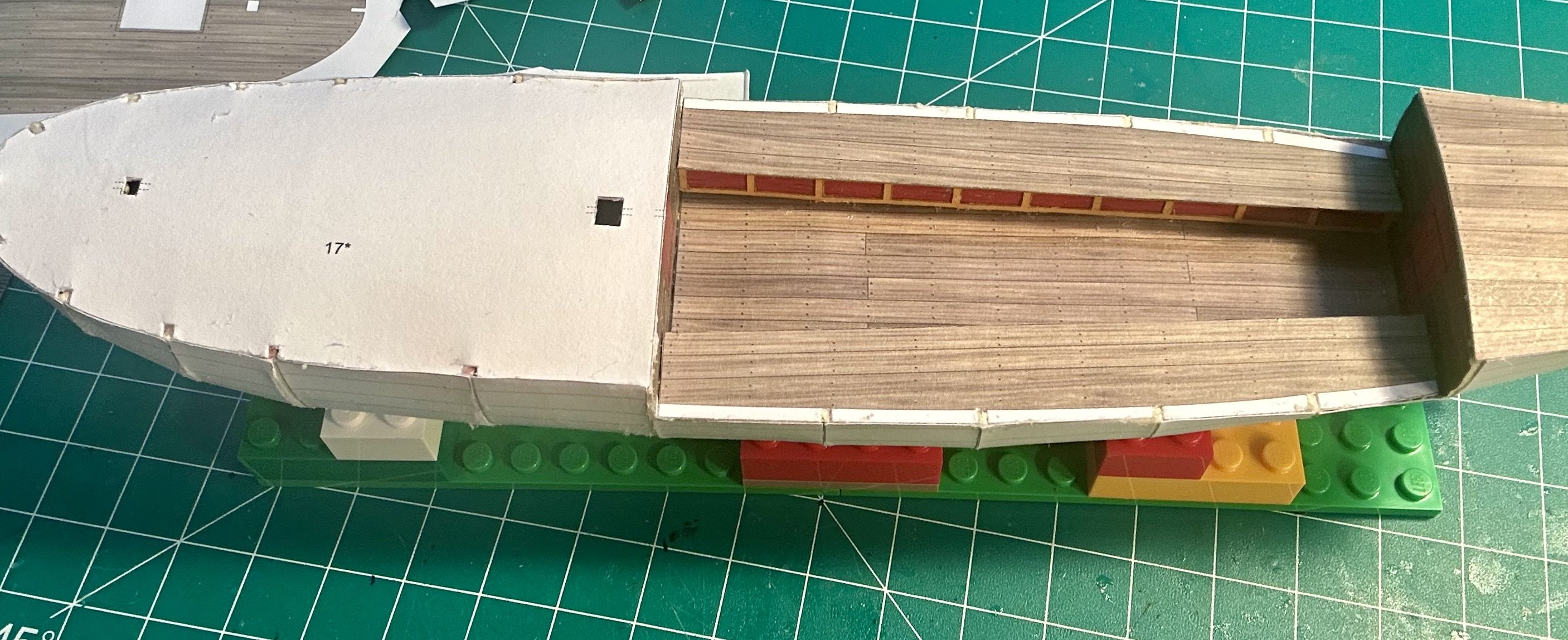

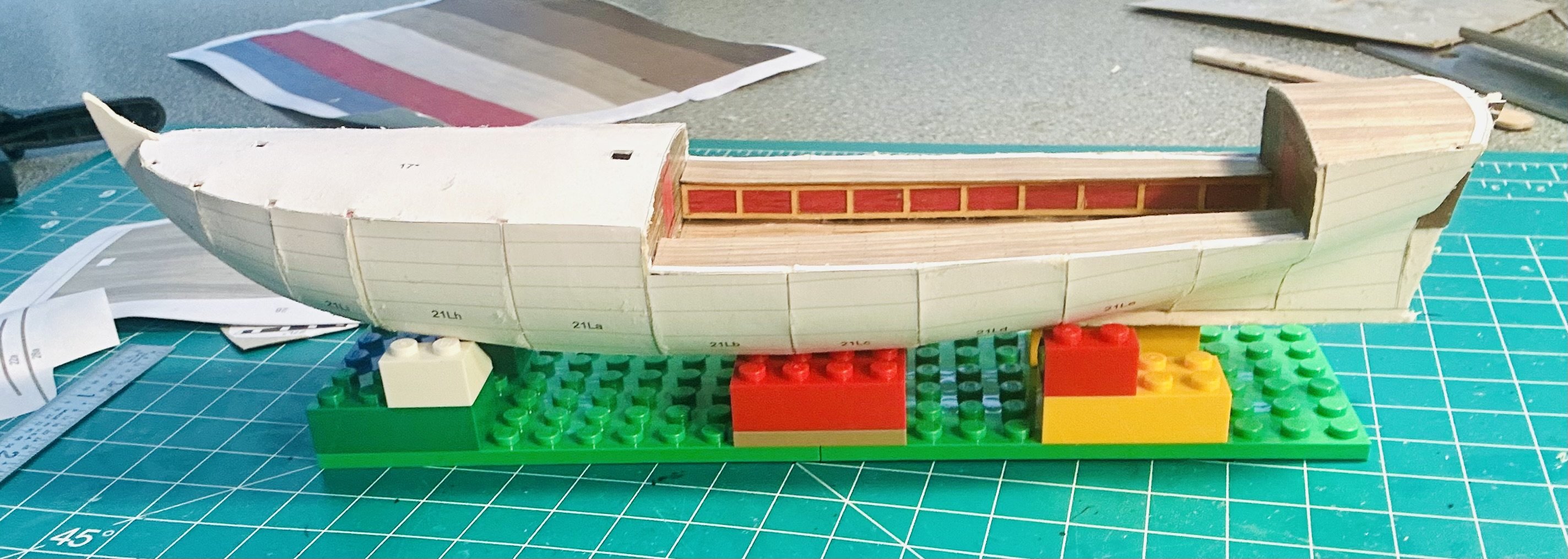

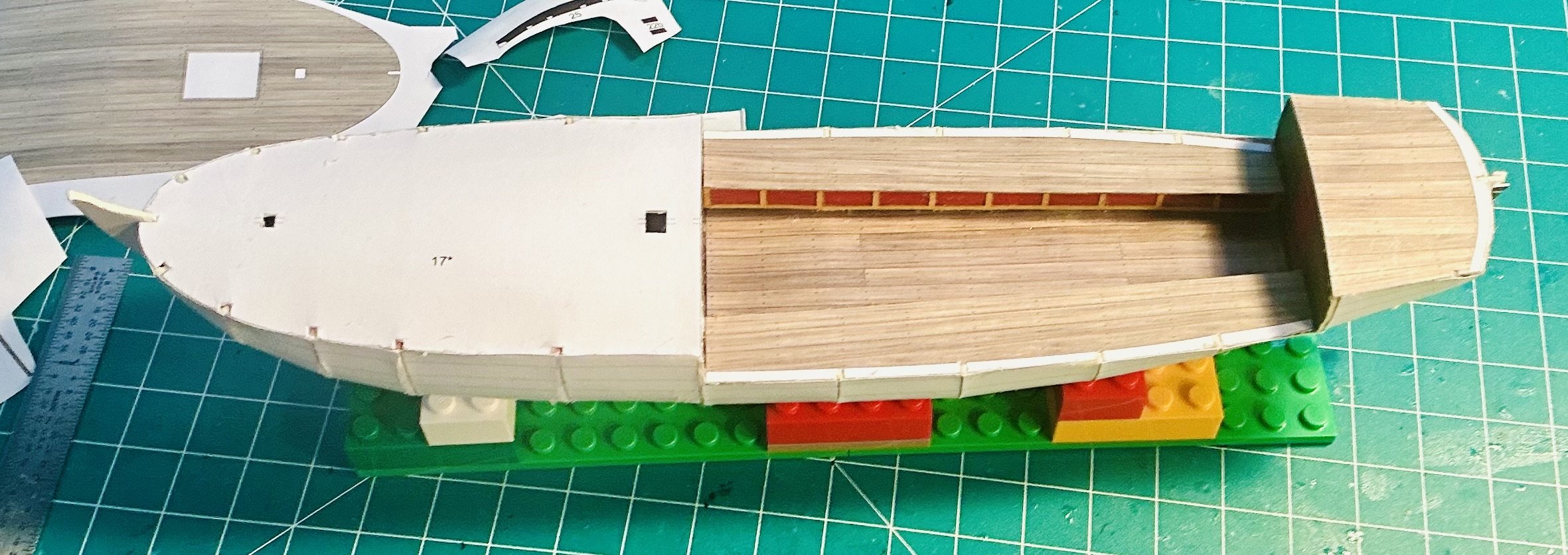

Making good progress on my speeljacht!  It is now covered and I made a Lego temporary cradle:

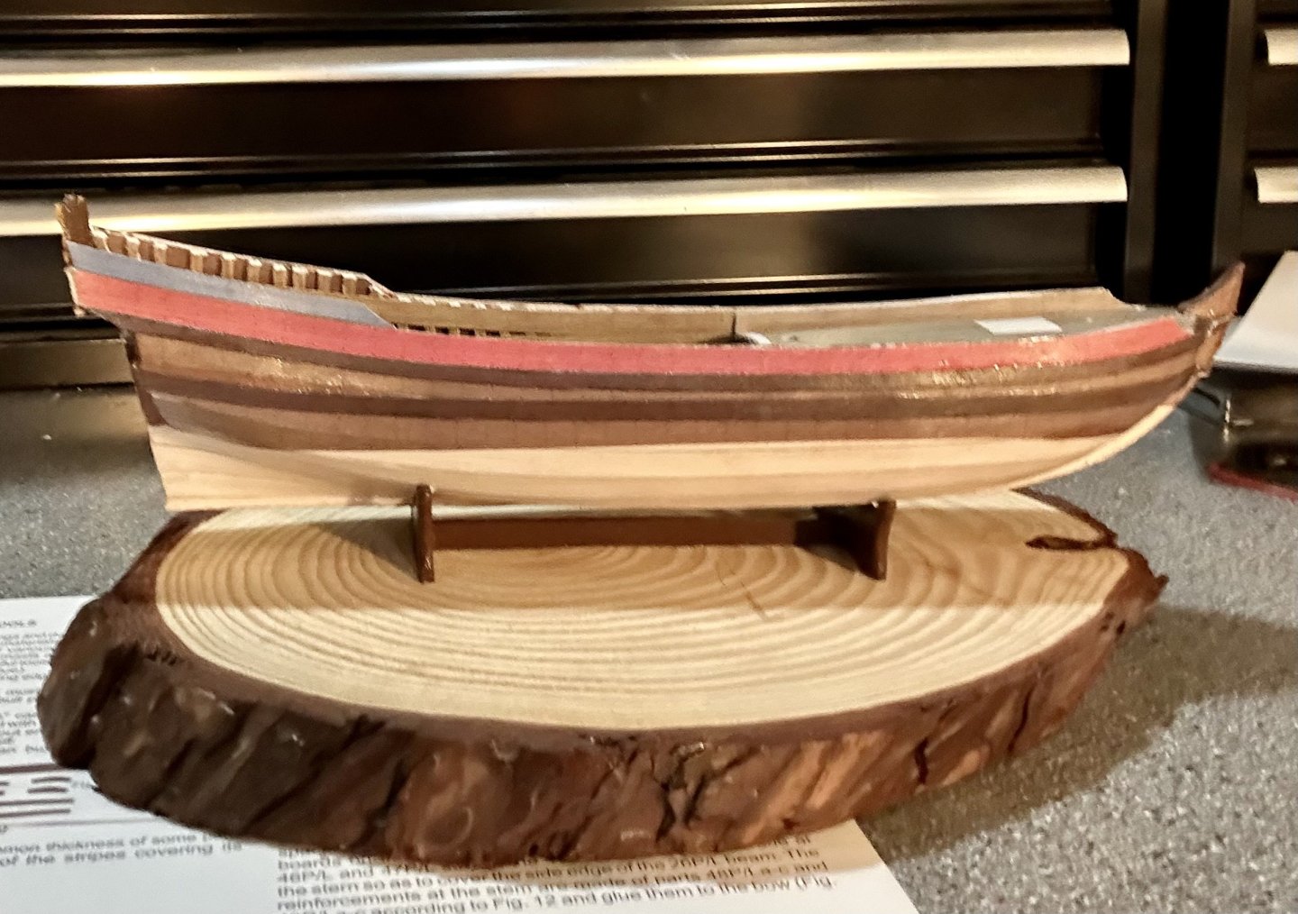

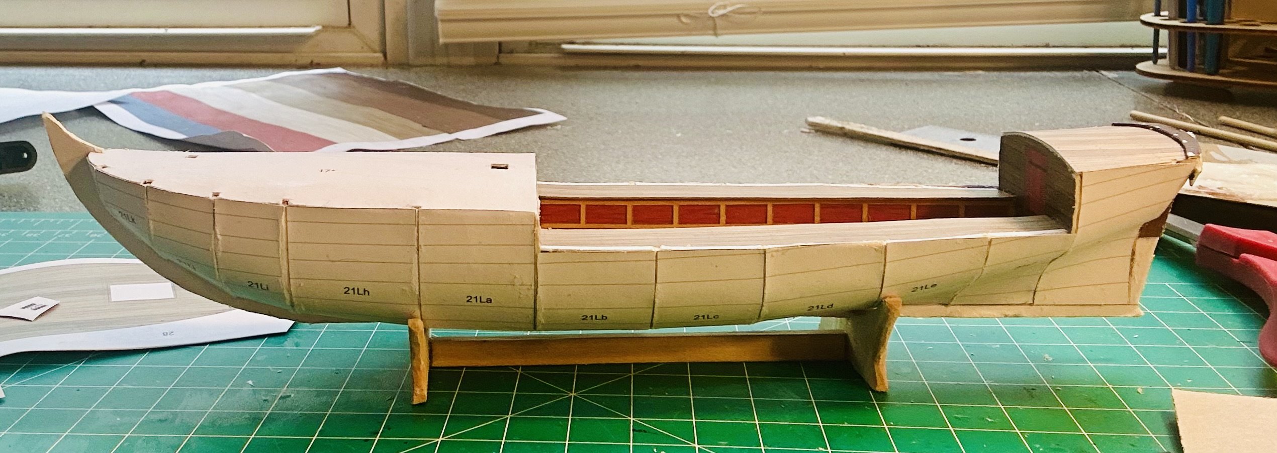

Then I figured that I should just make a permanent cradle, so I did:IMG_2478.thumb.jpeg.7ba2c839f7a55a39efa0fd36d09e9c24.jpeg
It is still a little rough, but it works.
I will paint it later after I get the outer hull made so I can match the color of the ship better.
I am thinking flat black or tan for the cradle.
The base will be one of those live edge rounds from a craft store.
I ended up with a whole bunch of them a couple of years ago from a liquidation pallet.  Needless to say all of them ended up in my stash.
This is my first time building a Seahorse kit.
I am enjoying it so far.
I own most of them and am starting to work my way through the smaller work boats and yachts between larger projects.
Card models are like the old potato chip ad, you can’t have just one.

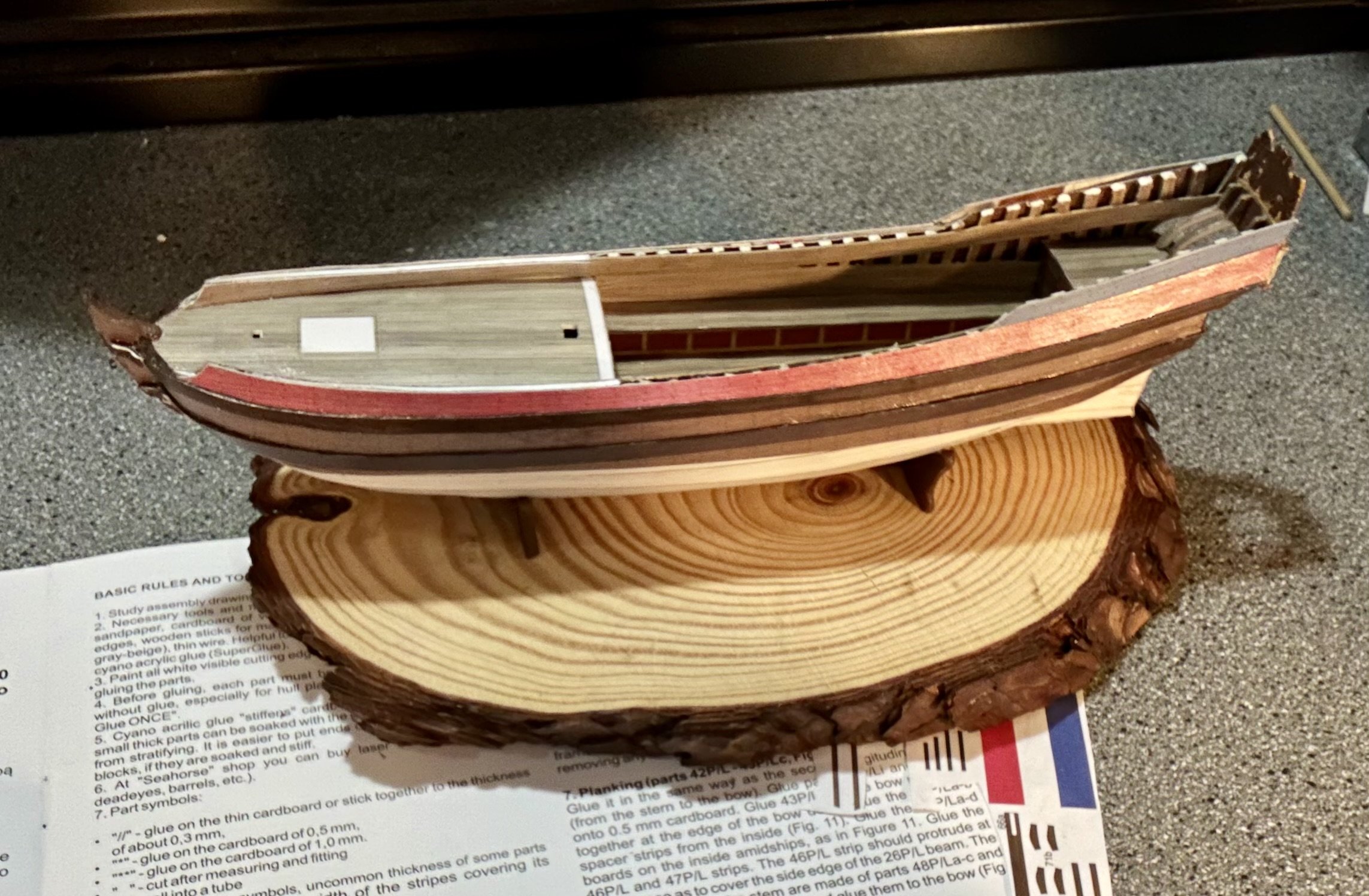

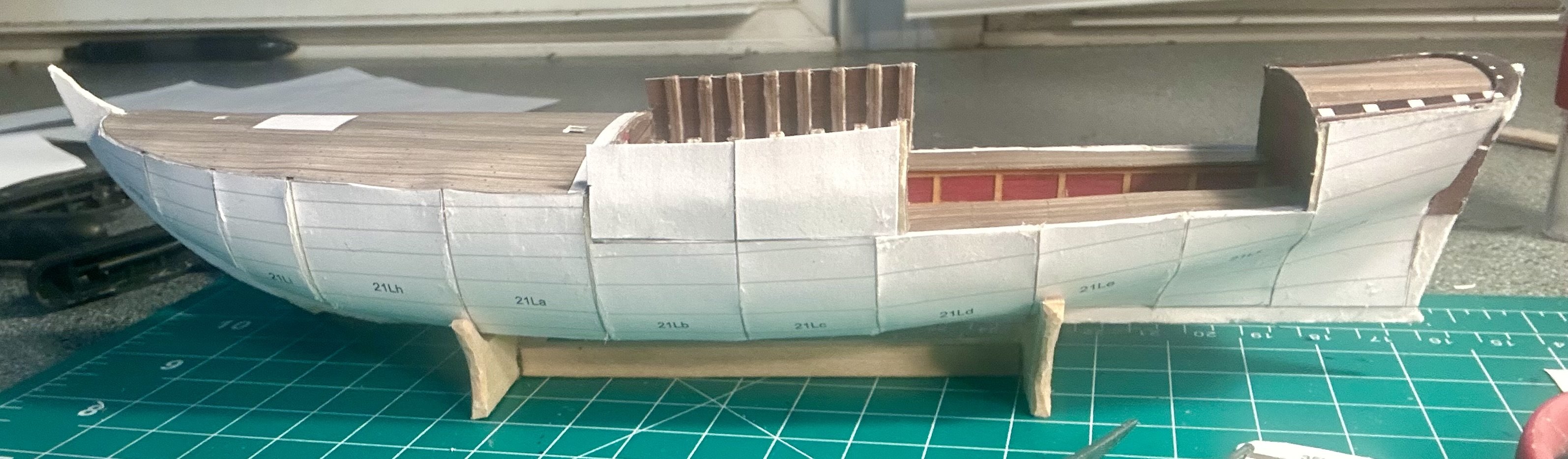

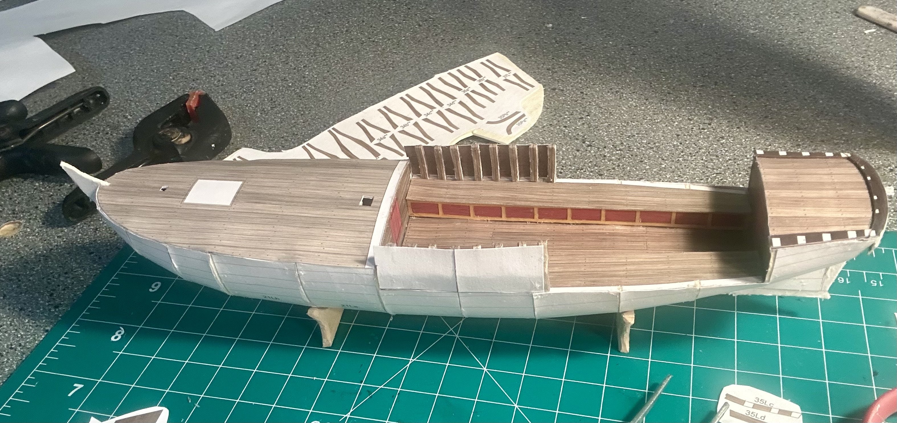

I finished all the bulwarks:
Then I got the transom bulwarks installed:
Then I added the middle layer of planking:
It isn’t perfect, but it is good enough.
I have very little starving cow (ribs showing through the skin of the hull).  There should be none after I put the outer layer of planking on tomorrow.
I am going to remember this method and utilize it for my next card scratch build.
Three layers of planking/hull covering is more work than two layers, but the effect is totally worth it.
Edited by GrandpaPhil

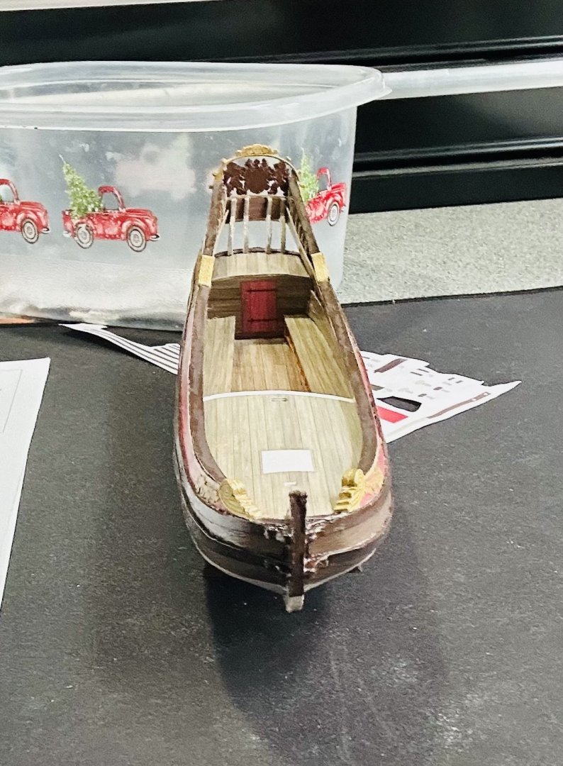

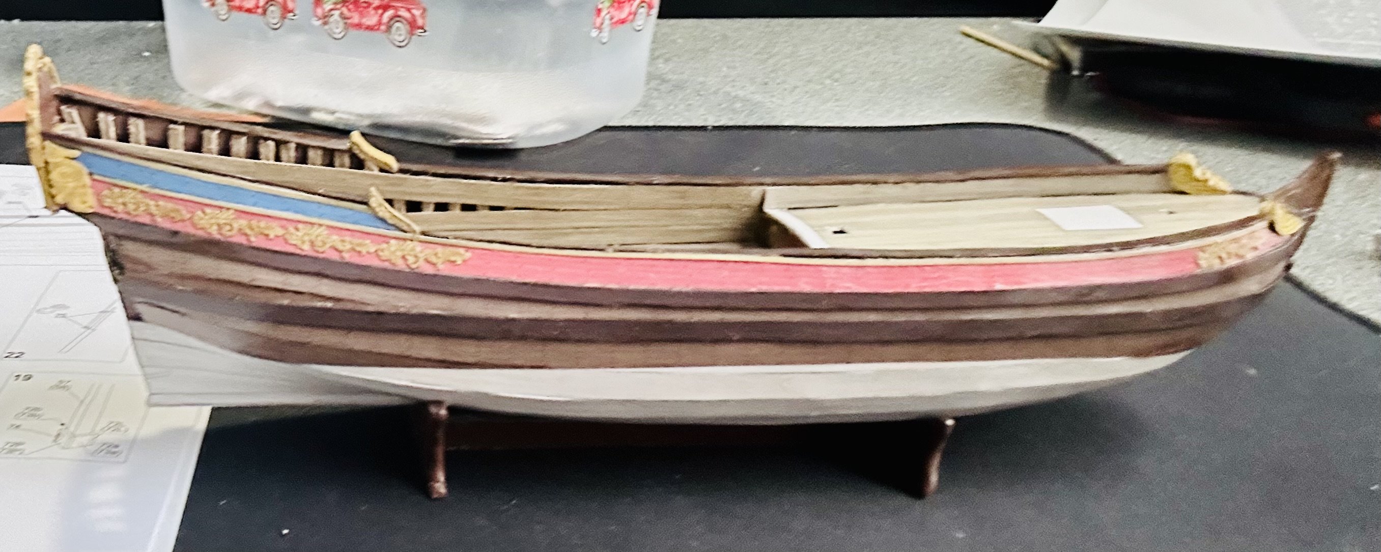

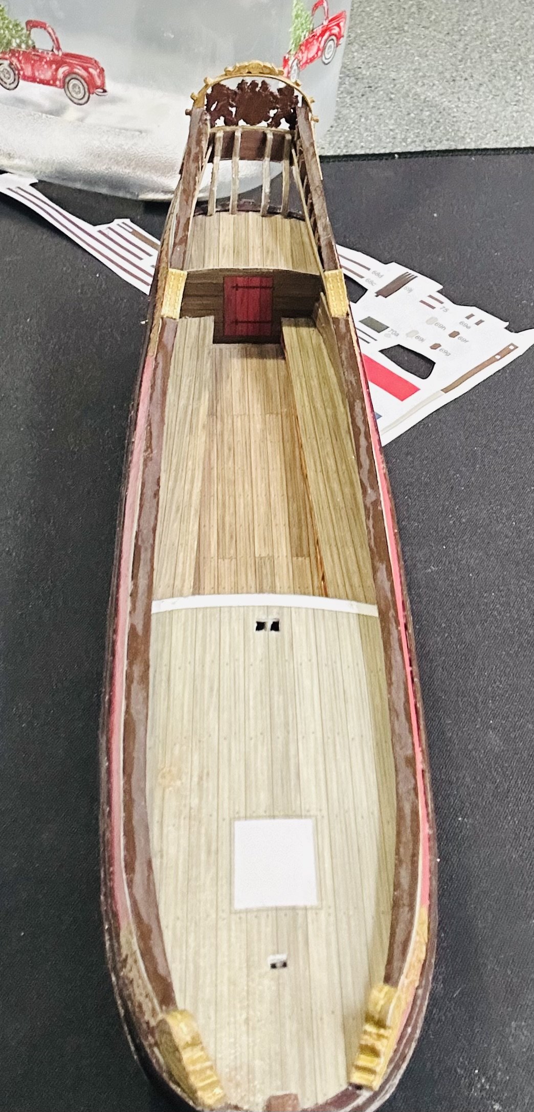

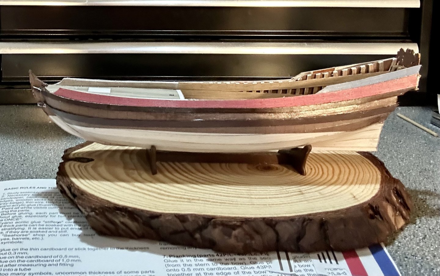

Most of the outer hull covering and inner bulwarks are installed:
I’m still short a wale and the model needs a BUNCH of trimming and touch ups, but at this point, I have a hull to work with that I’m happy with.
Next time I’ll finish up the wales and start adding all of the hull decorations.
I was going to carve my own stuff, but those decorations are way too fine to carve from basswood (similar to lime wood) and I don’t have any more cedar, so I’m going to try to layer the card instead and see how they turn out.
I showed the Admiral (my wife, for the new folks) the demo/design model built by @0Seahorse, and she really liked it, so I’m rolling with the card pieces.

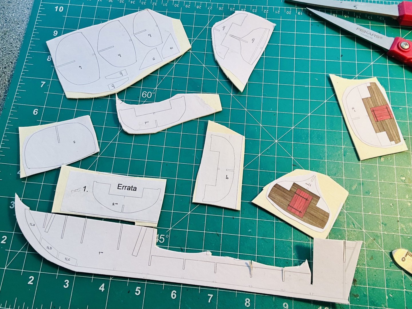

I may, or may not, have used Little Debbie snack cake boxes and cereal boxes for .5mm card.

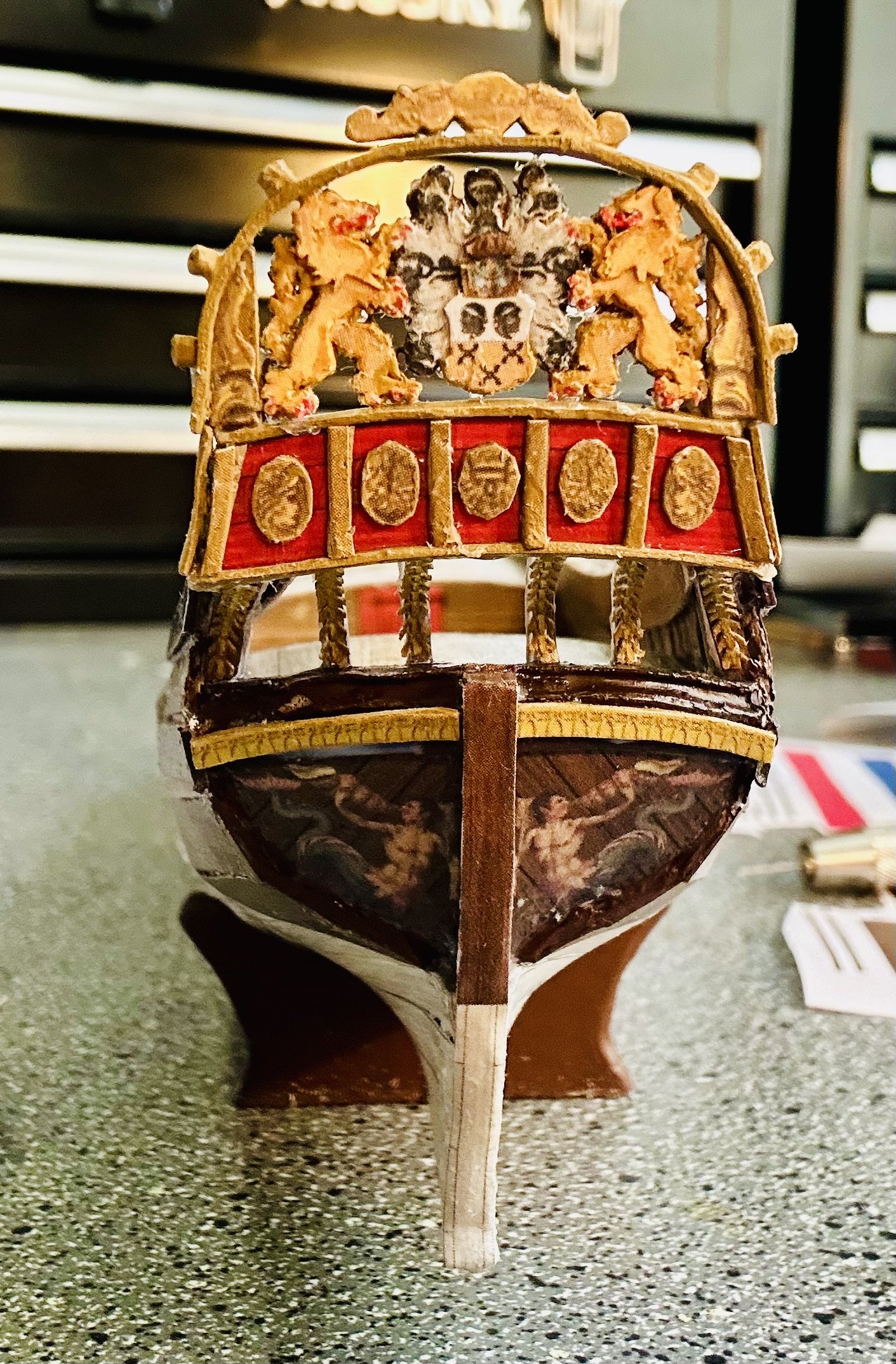

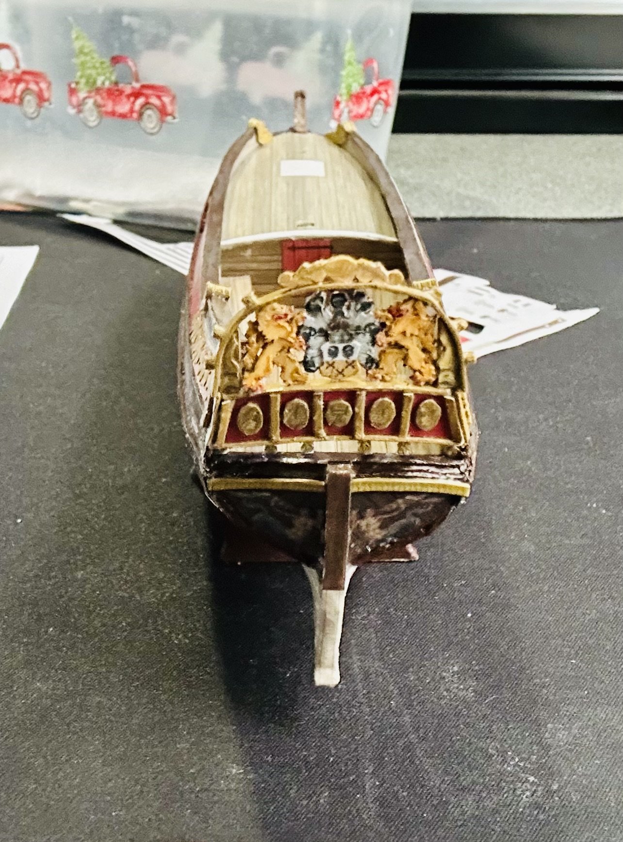

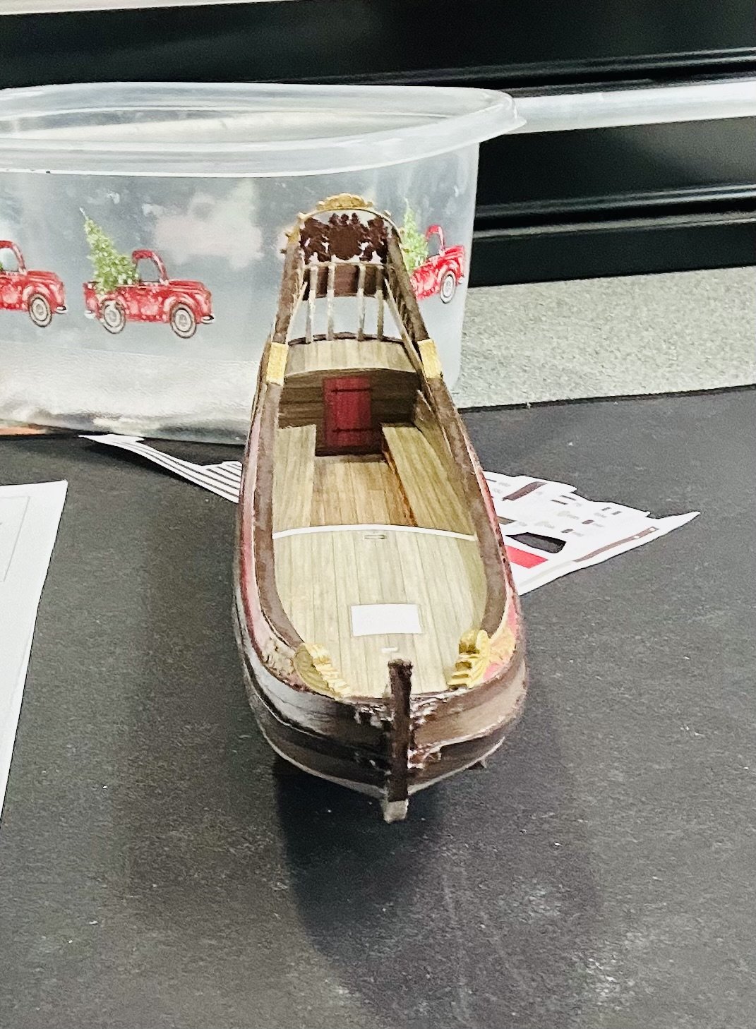

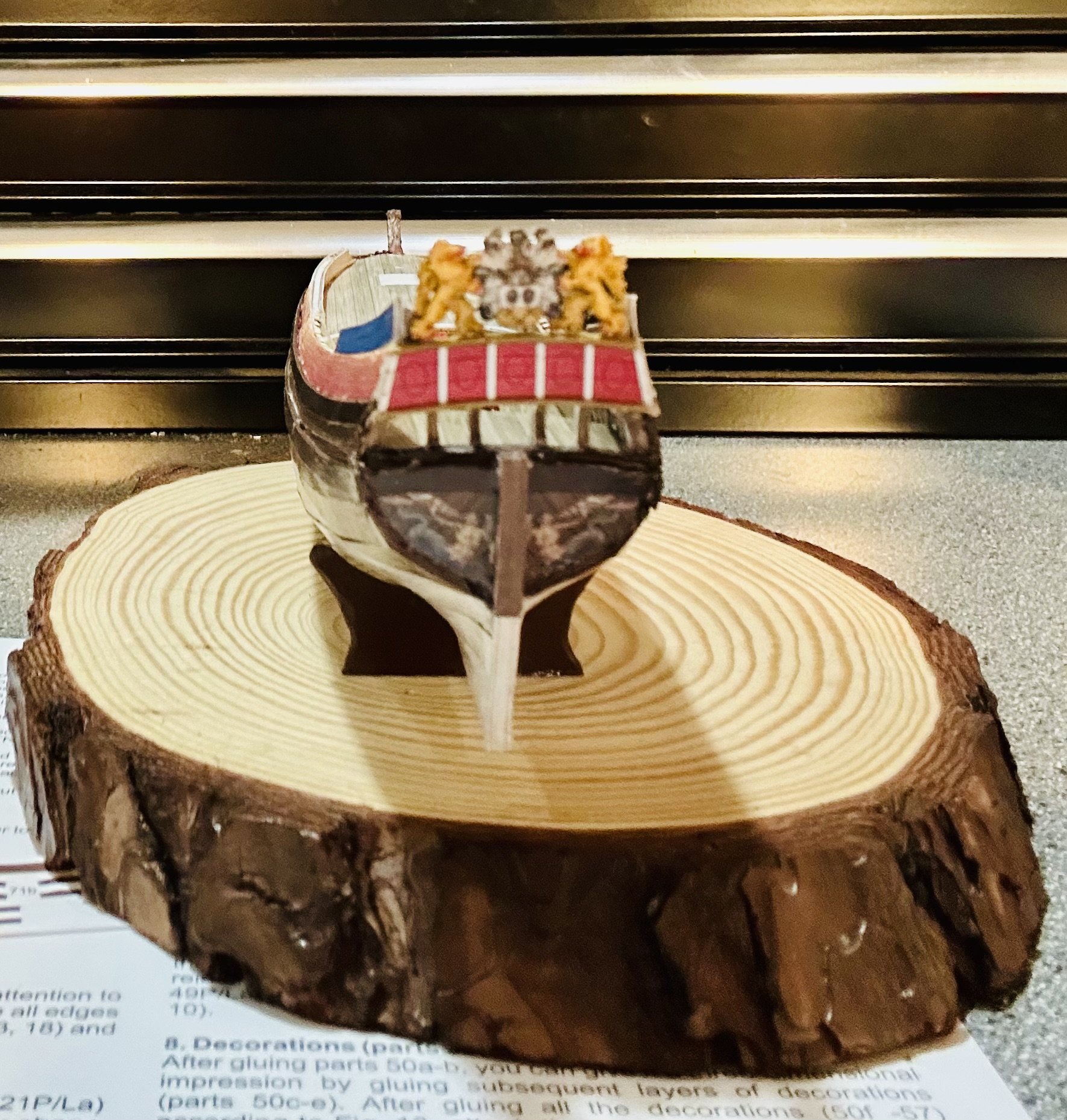

The stern decorations are on!
To give an idea of scale, the lions are approximately a half inch, or 12.5mm tall.
I took it off the base because the base wouldn’t fit in my curio cabinet.
I am going to cut out and install the quarter badges, which depict fish, next.

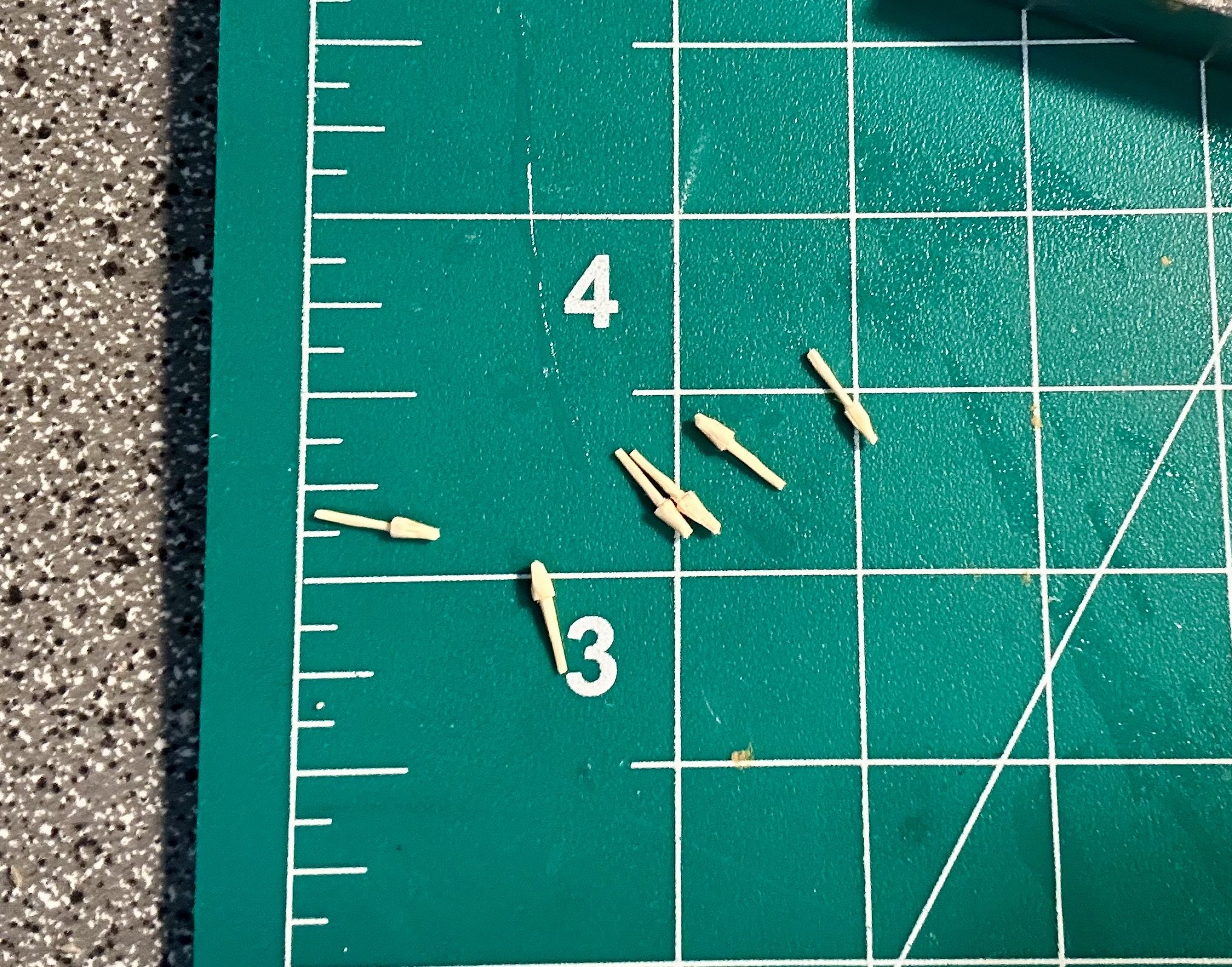

Quick money saving tip:
Toothpicks make great belaying pins.
I just carve them with a scalpel while slowly rotating the piece.
I cut the finished belaying pin off the end of the toothpick after carving it.
It can get tedious if you have many of them, but it is no worse than any other high volume part that we use.
I have done a full galleon’s worth before, and it wasn’t too bad.
That batch is shared between the HMS Revenge and my Dutch Cat Ship.
In my opinion, they look better, and are more to scale, than what is generally commercially available.

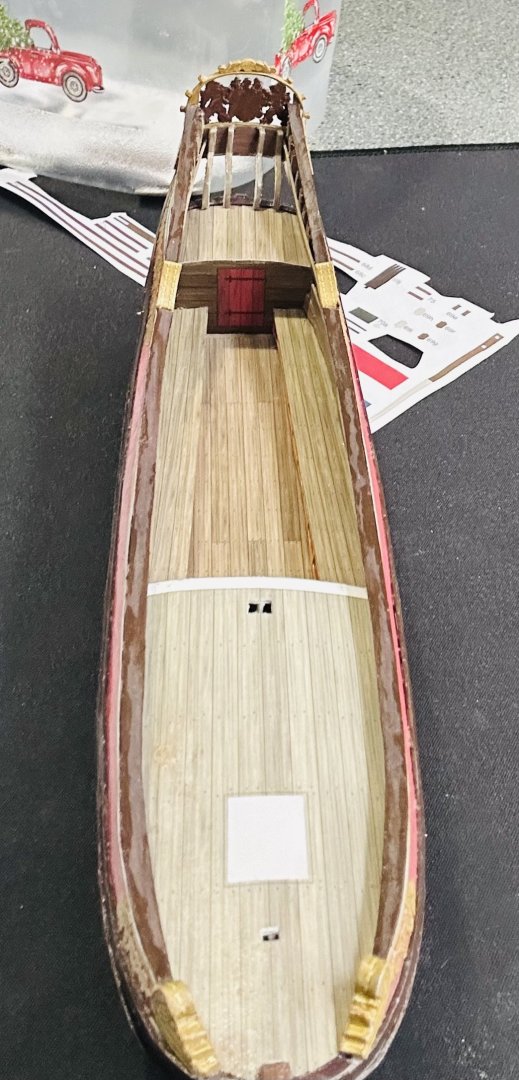

That’s the quickest set of interior and deck fittings that I have ever made:
Moving on to first the rudder and then the leeboards.
I’m pretty much just building sequentially, following the part numbering.
Building:

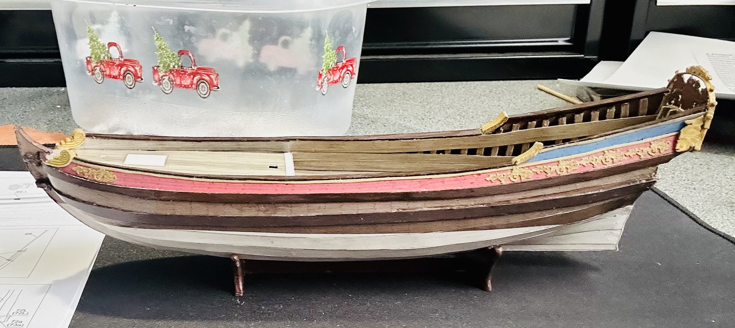

One very rough rudder:
Once it dries thoroughly, there will be some trimming and minor painting in its future.
Building:
The rudder is done and installed.
The starboard leeboard is finished, installed and rigged.
I scavenged some blocks out of my bits bin too.
I didn’t really care for the paper ones.
I think I may let them dry overnight next time.
But this one is getting leftover wood blocks.
