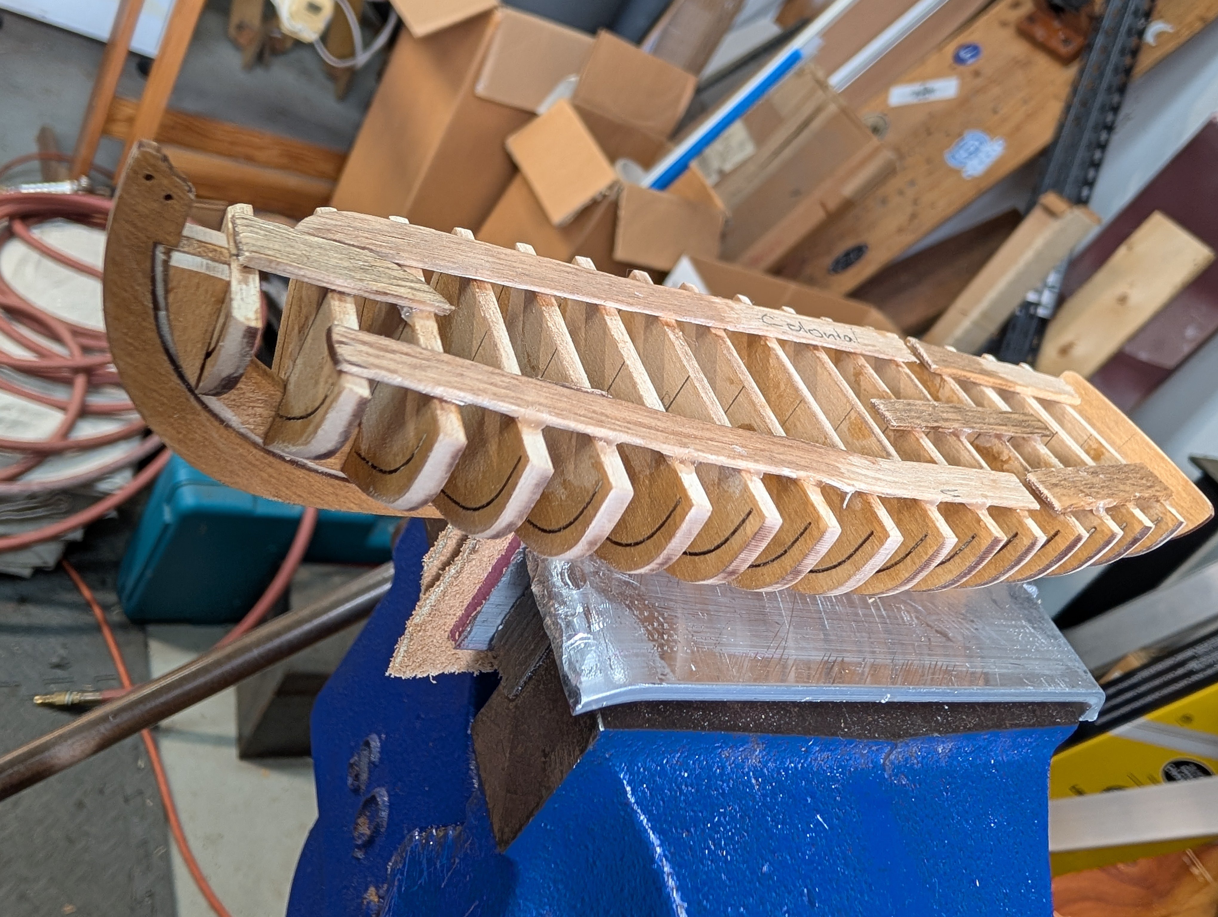

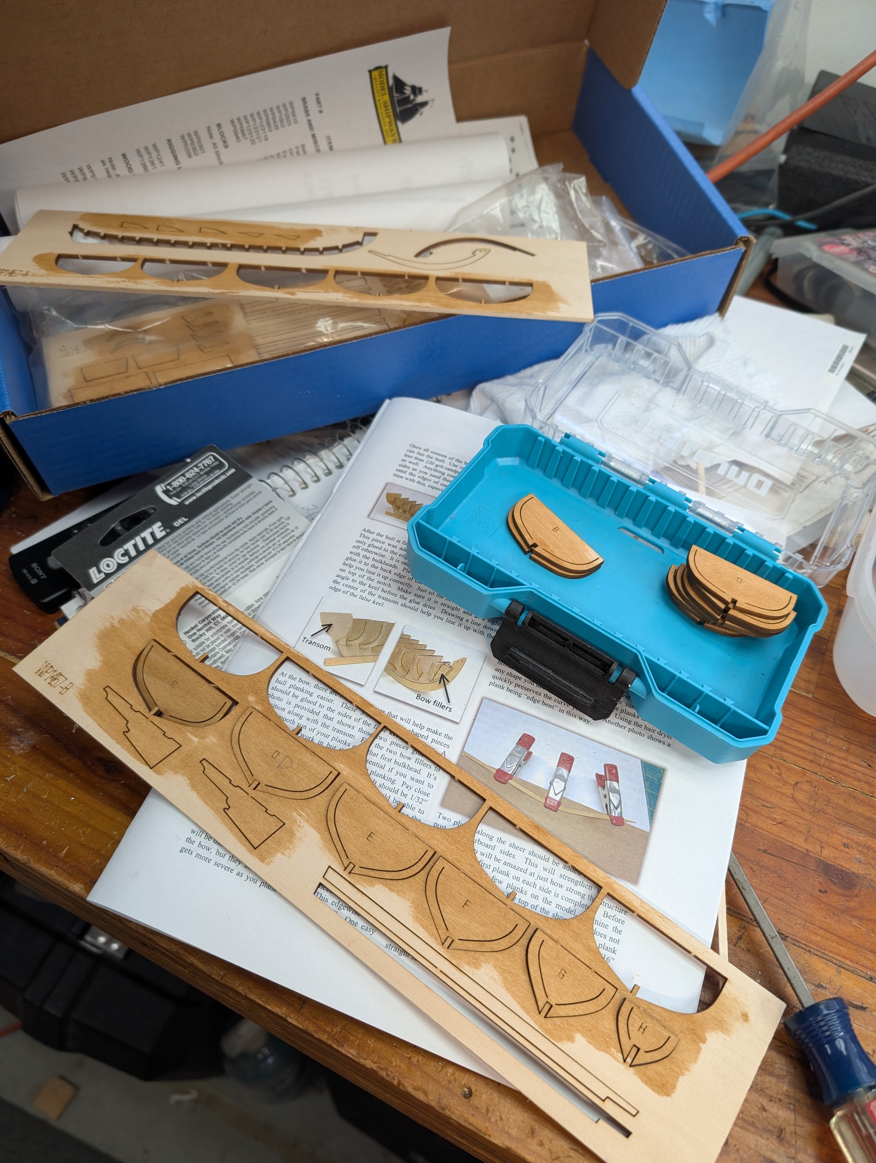

Part 1: Framing

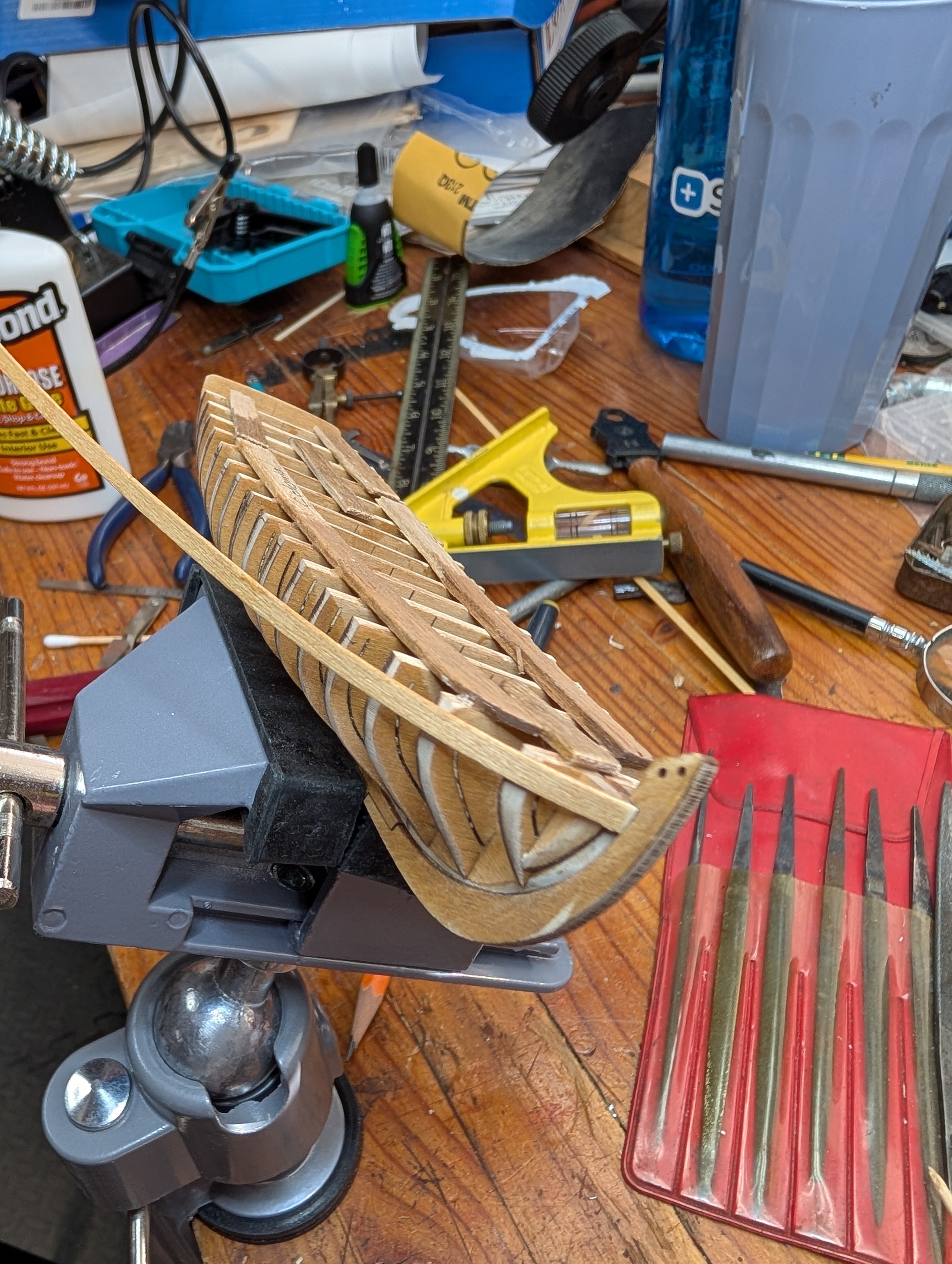

Seemed pretty straightforward to get the frames straight, parallel and flat across the top. See other build logs. Do pay attention to the rabbet in the keel, this is were the edge of planks will fit in and help hold them and hide the edges. I kind of tested the rabbett by just laying the side of a straight plank in it.  I Pre-stained the frames before gluing them up on the keel with Minwax water based English Oak, full strength.

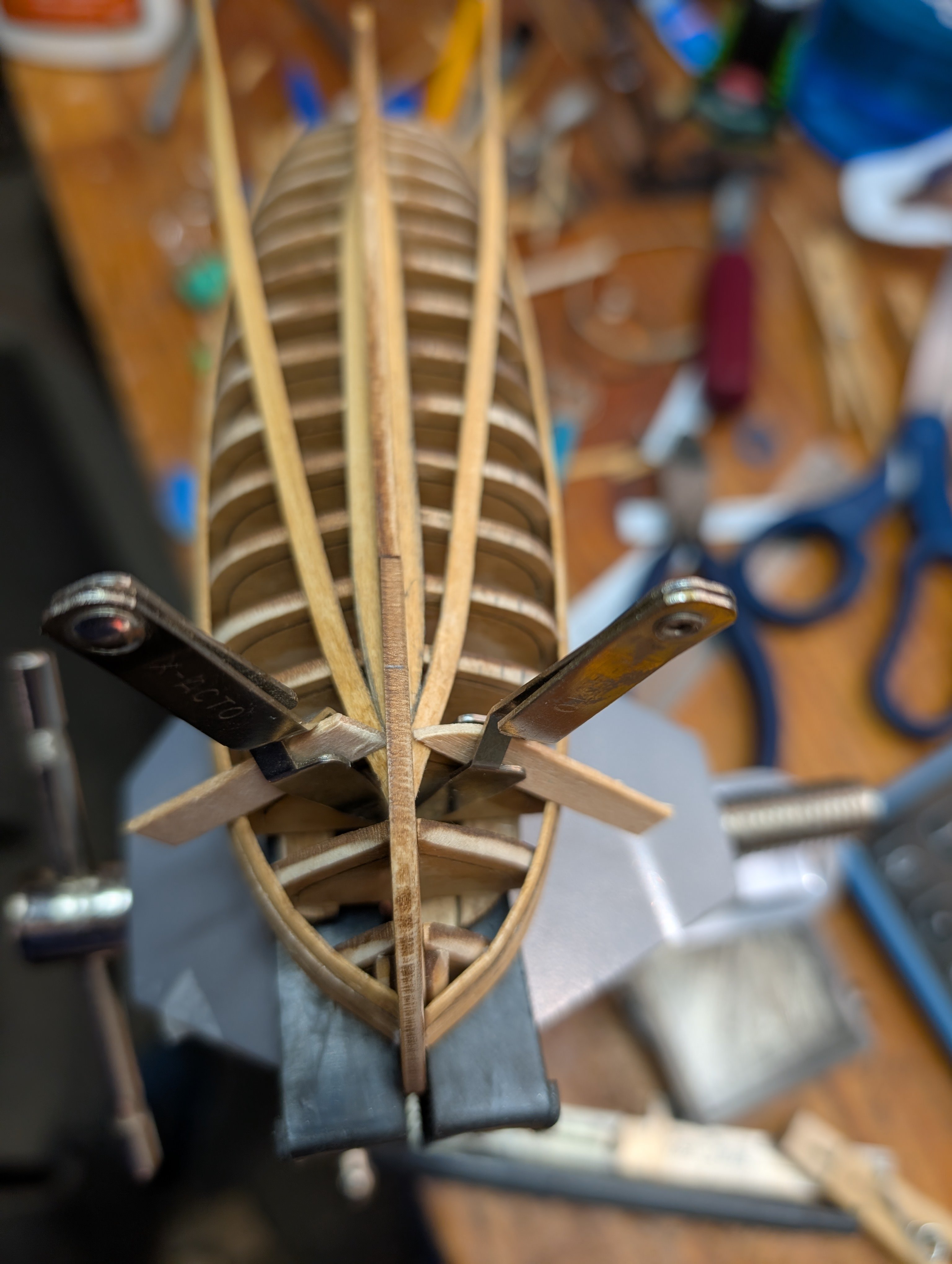

Here is one of my first mistakes. Impatience. I was very excited to get started and did not spend enough time on fairing the frames and REALLY paying attention to laying down that first plank. I don't think I have enough shear and it gets a bit flat at the bow. The shear is not smooth and I think this caused trouble for the rest of the planking. Regarding planking: none of my attempts to pre-bend the planks worked. I did not like this part of the build. It was very frustrating and I almost stopped right here. I tried heating, clamping, bending , steaming before mounting... Just about everything I could find online and I always ended up with a kink in some section of my planks. or the curve would bulge and gap. Also, trying to draw, or lay out plank lines, and plank calculations didn't work out well. So, I ended up using a brute force method by gluing the planks onto one or two frames at a time. I did this by wetting down the plank like a sponge, then massaging and twisting it into place. Ugh. I do NOT like planking. Fortunately I have lots of sandpaper, though this small boat has very thin planks. BTW, I was also worried I would run out of planks from the kit because I had ruined so many. Not so, the kit has lots of extras. So, I pushed through and assumed I would hide the mistakes somehow.
Note: I did prestain all planks. I used Minwax water based English Oak, full strength.

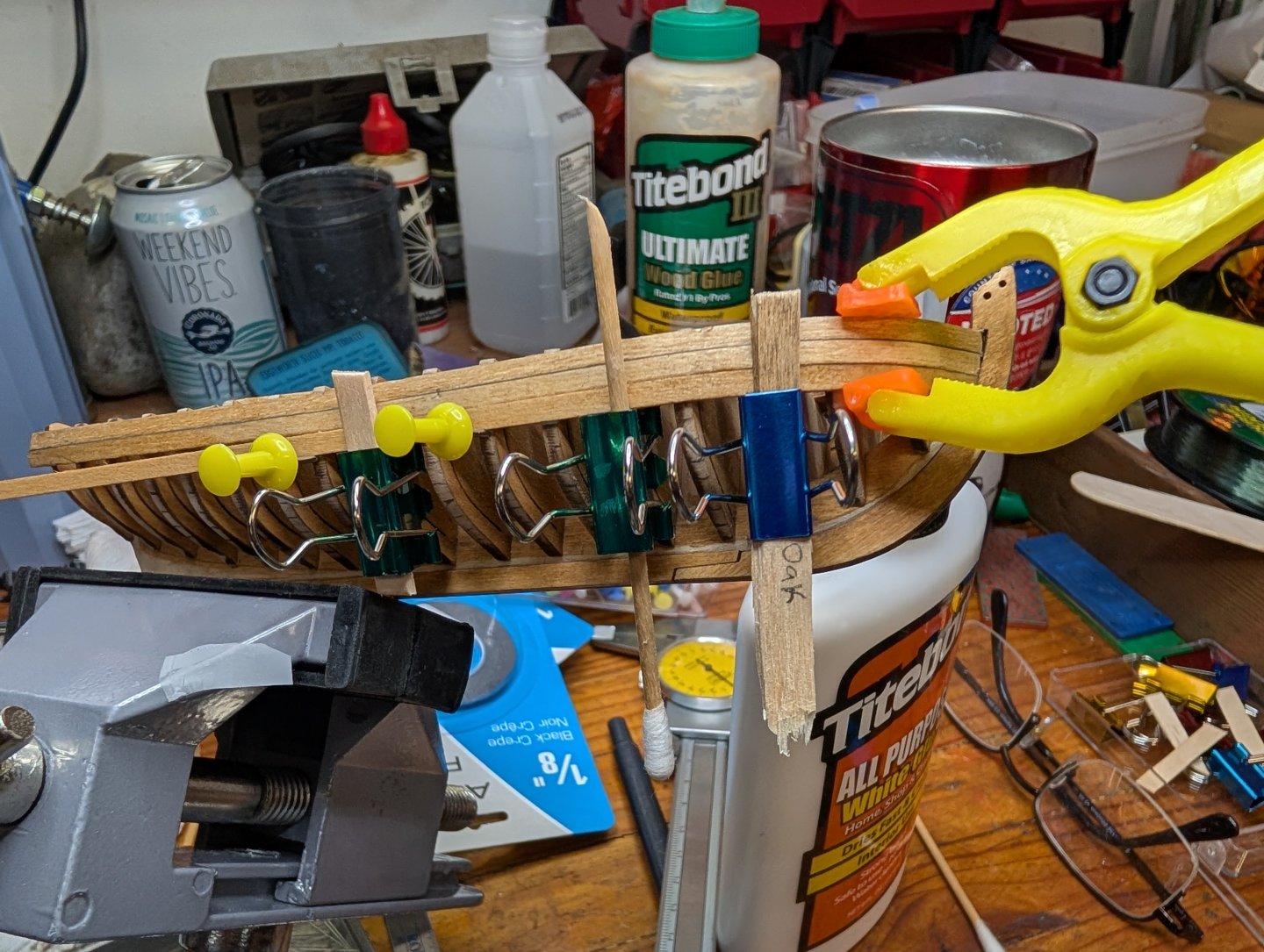

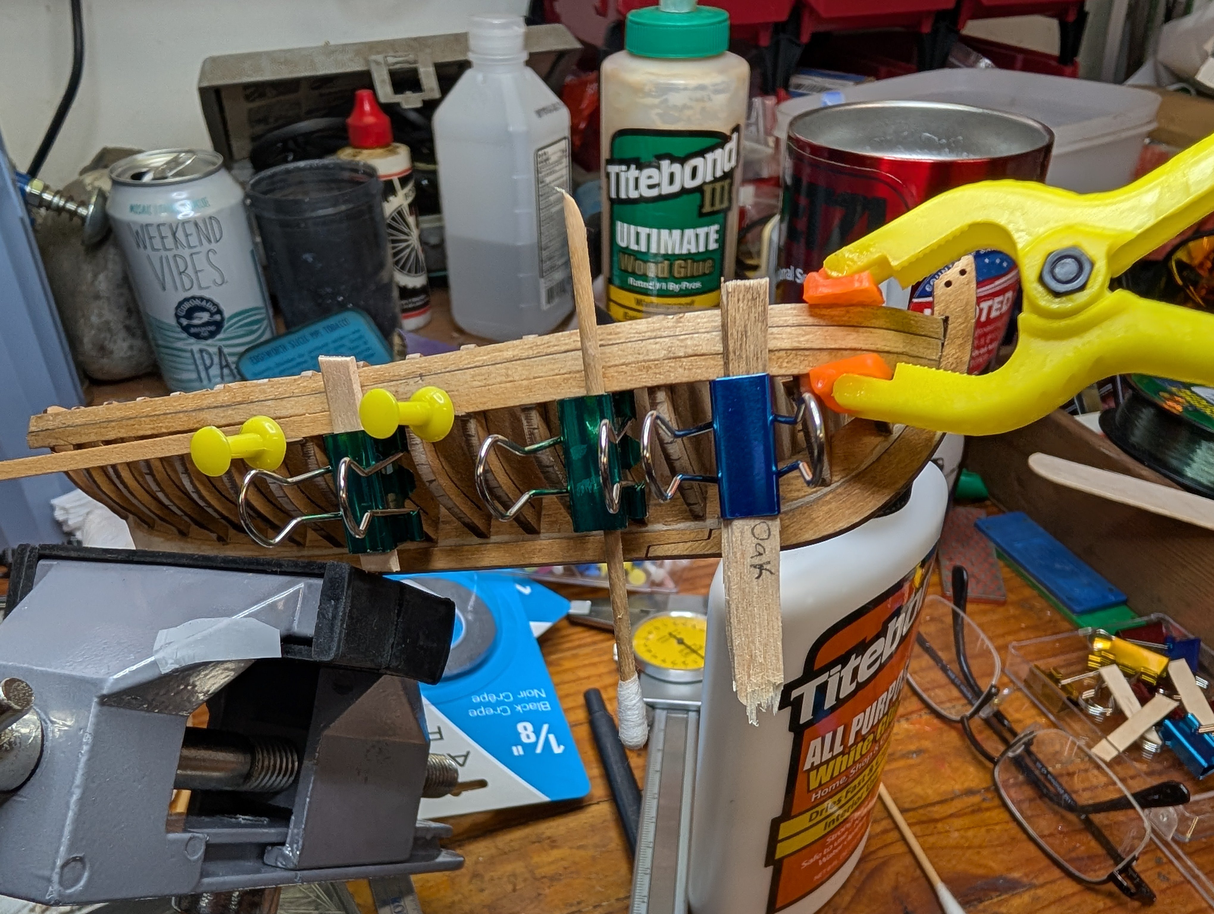

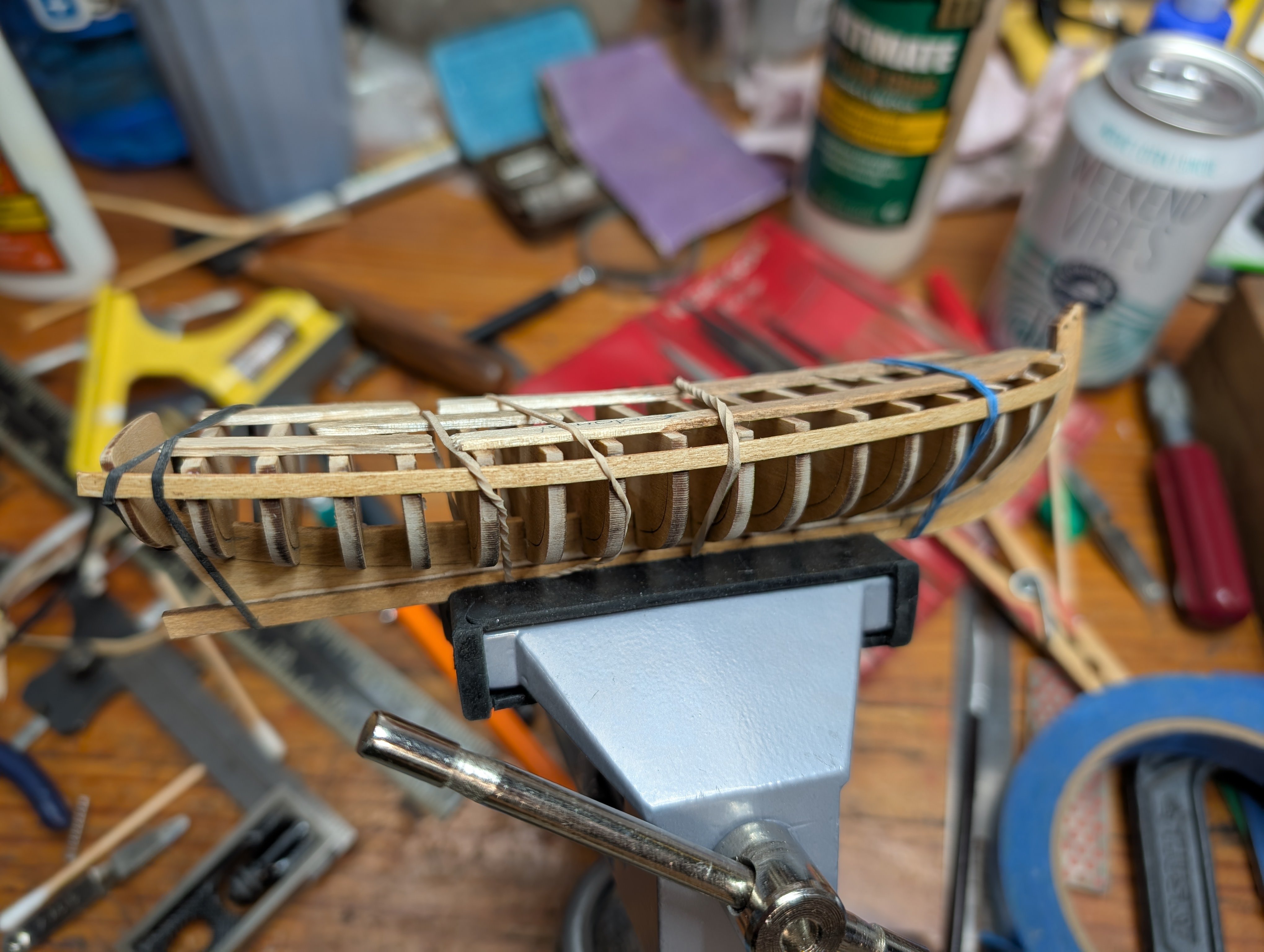

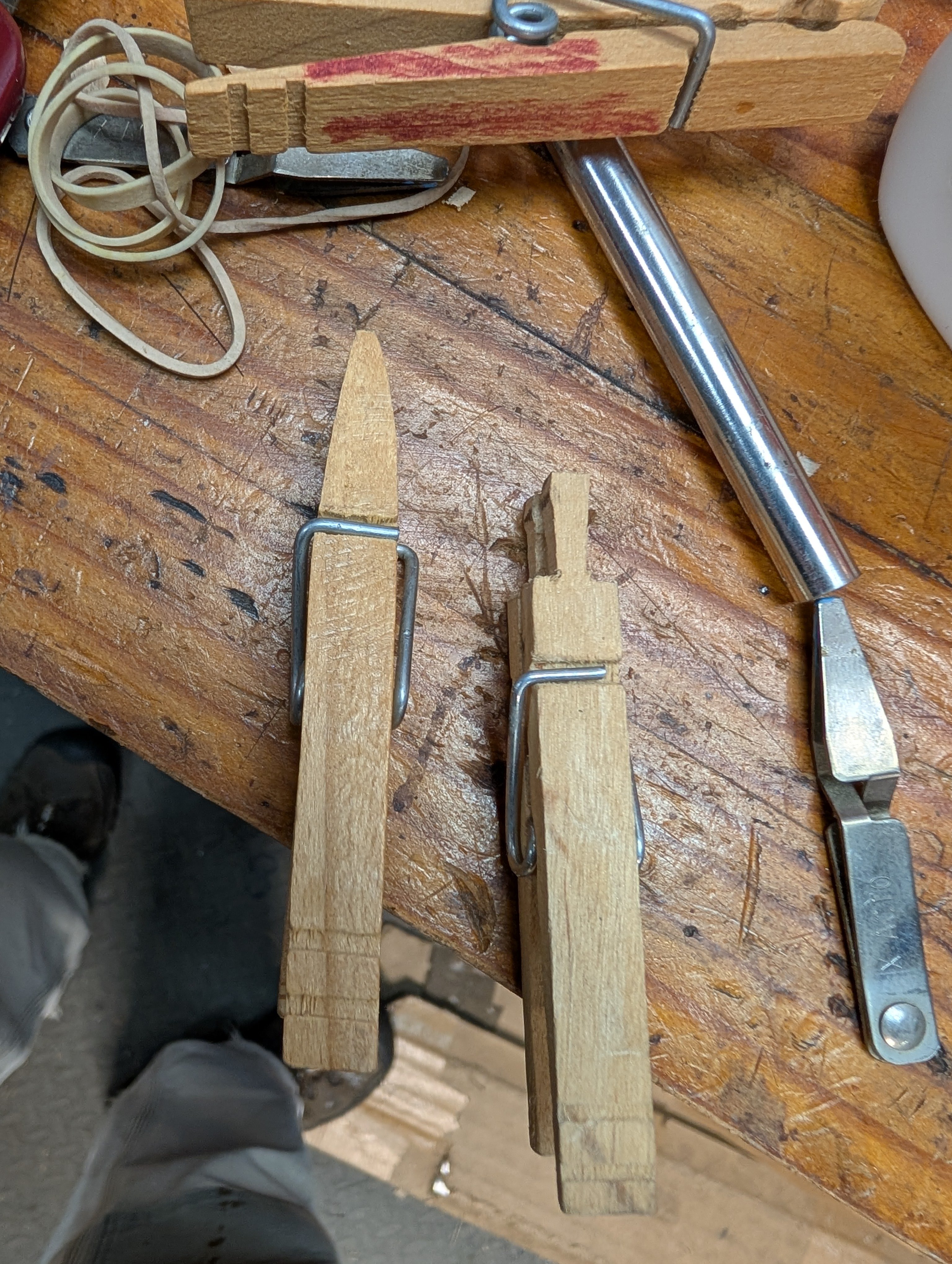

I don't have a lot of modelling tools, most beginners won't, so I adapted paper clips, rubber bands and modified clothes pins I saw in other build posts. Jamming a scrap stick under the large paper clips actually worked very well.
Laying the first Garboard plank also felt tricky. I had no idea where it should end and this plank drives the bend and location of all planks above it. What worked for me was examining other post pictures and guessing 🙂 I ended up ending it at about the third frame in (see pic). The other tip is to give it a long taper and build the second plank at the same time to be sure it can follow that taper. After that I layed down all the planks from the top. I tried laying down tape for all the planks, but that didn't work well. I simply measured my remaining gap and divided by the width of the planks in the kit. I wanted to make sure that I would not have a 1 mm plank to fit in as the last plank. I turns out I may have, but there was a wider plank supplied in the kit (for floorboards I think) and I was able to use file and sand that oversize one as the last plank. Thank goodness that part was done!

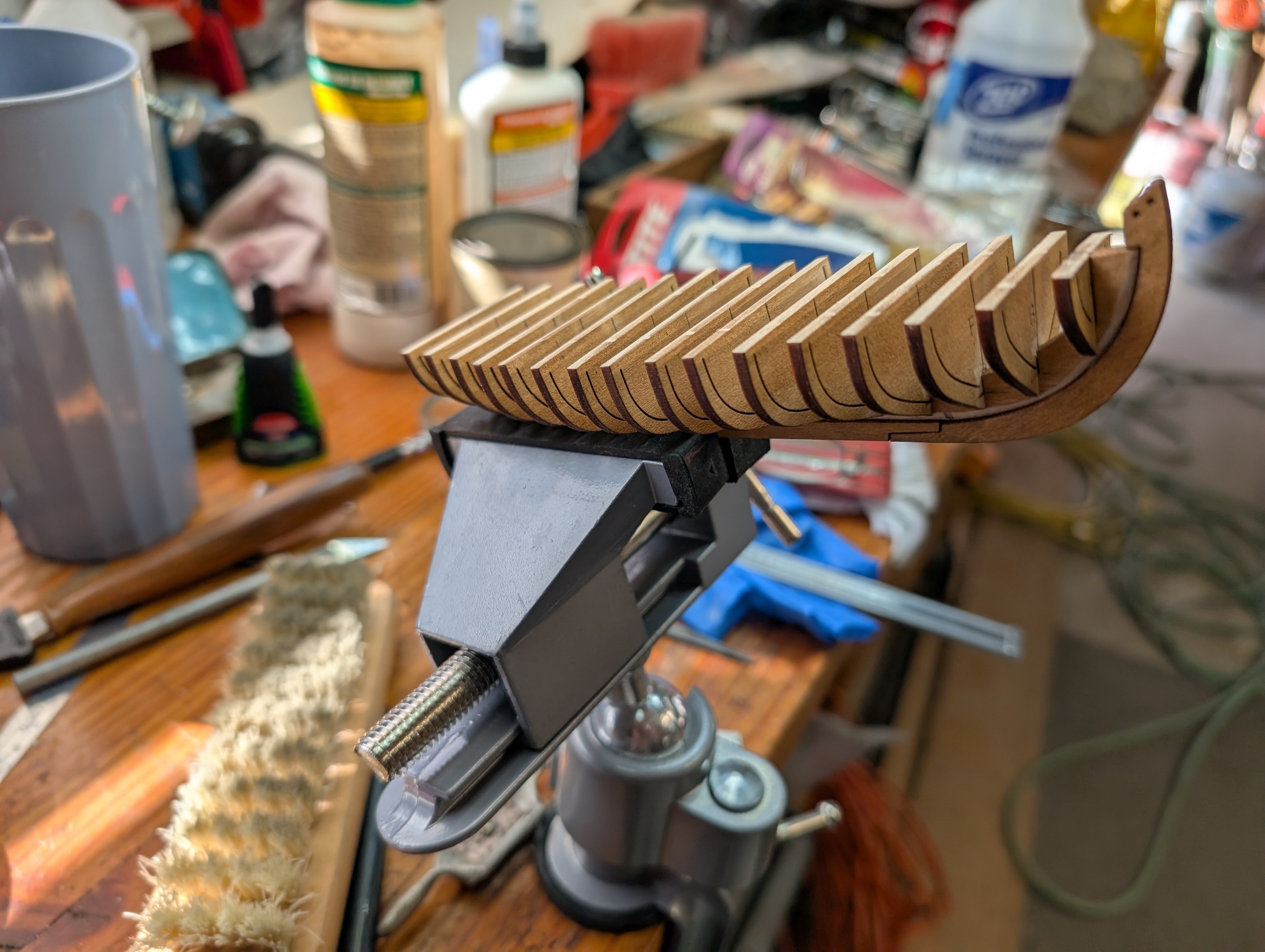

The instructions say to file the frame molds off the frame. I found this tiny saw online and got a couple. It worked well to separate the frames, and to trim them flush with the shear strake. https://micromark.com/products/special-hobby-ultra-smooth-saw-blades-package-of-5
I used a combination of dremel sanding bits and steel grinders to get rid of the laser char and smooth out the keel and frame junctions. The frames and planks were pre-stained so I only had to touch up the tops of the frames after sanding. If you zoom in on this pic you can see a plank that is slightly off color. That is the oversized plank I shaped to fit in as the last plank. You can see it is kind of wobbly, fat in the center and thin towards the ends. But it worked! I knew that its near the bottom, would be below the water line and painted, so in reality will never be seen.

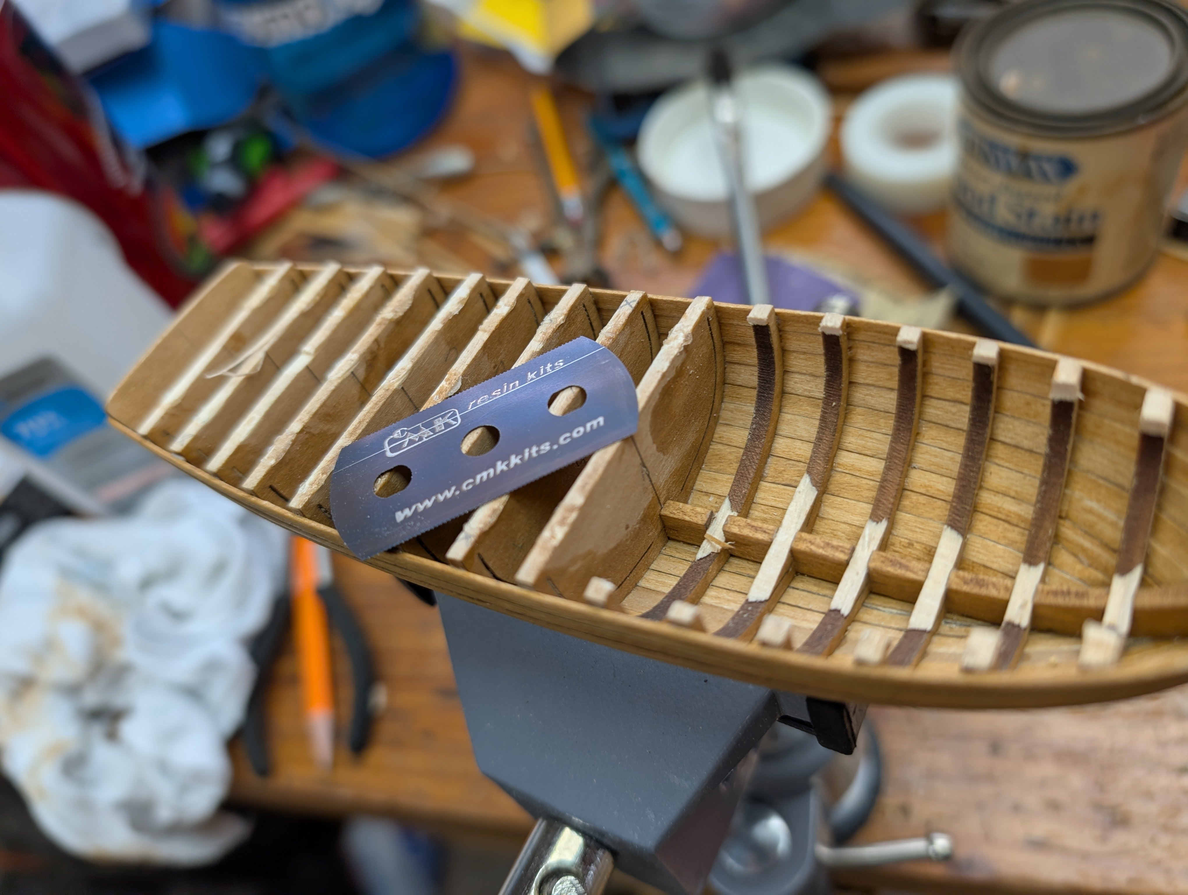

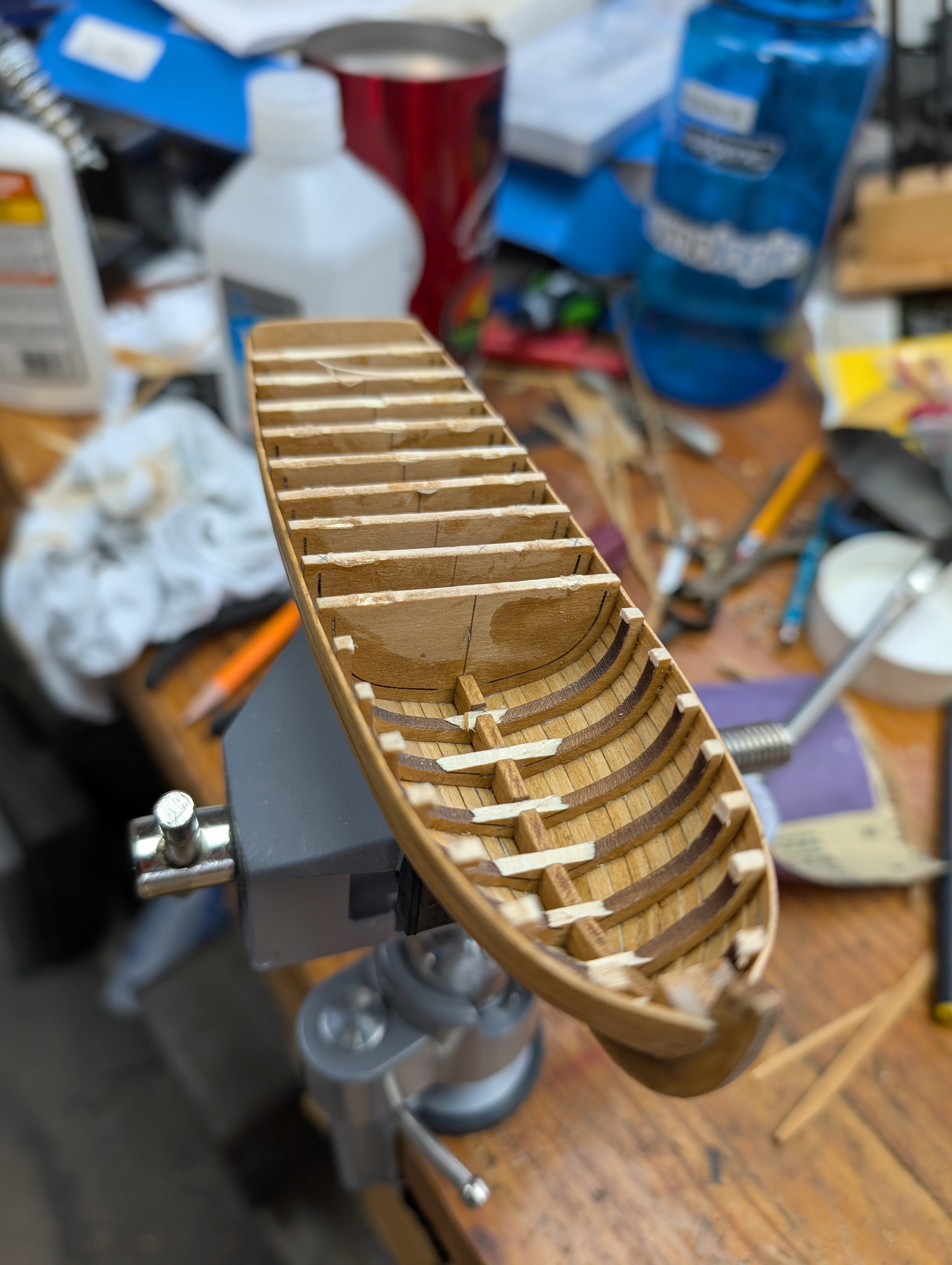

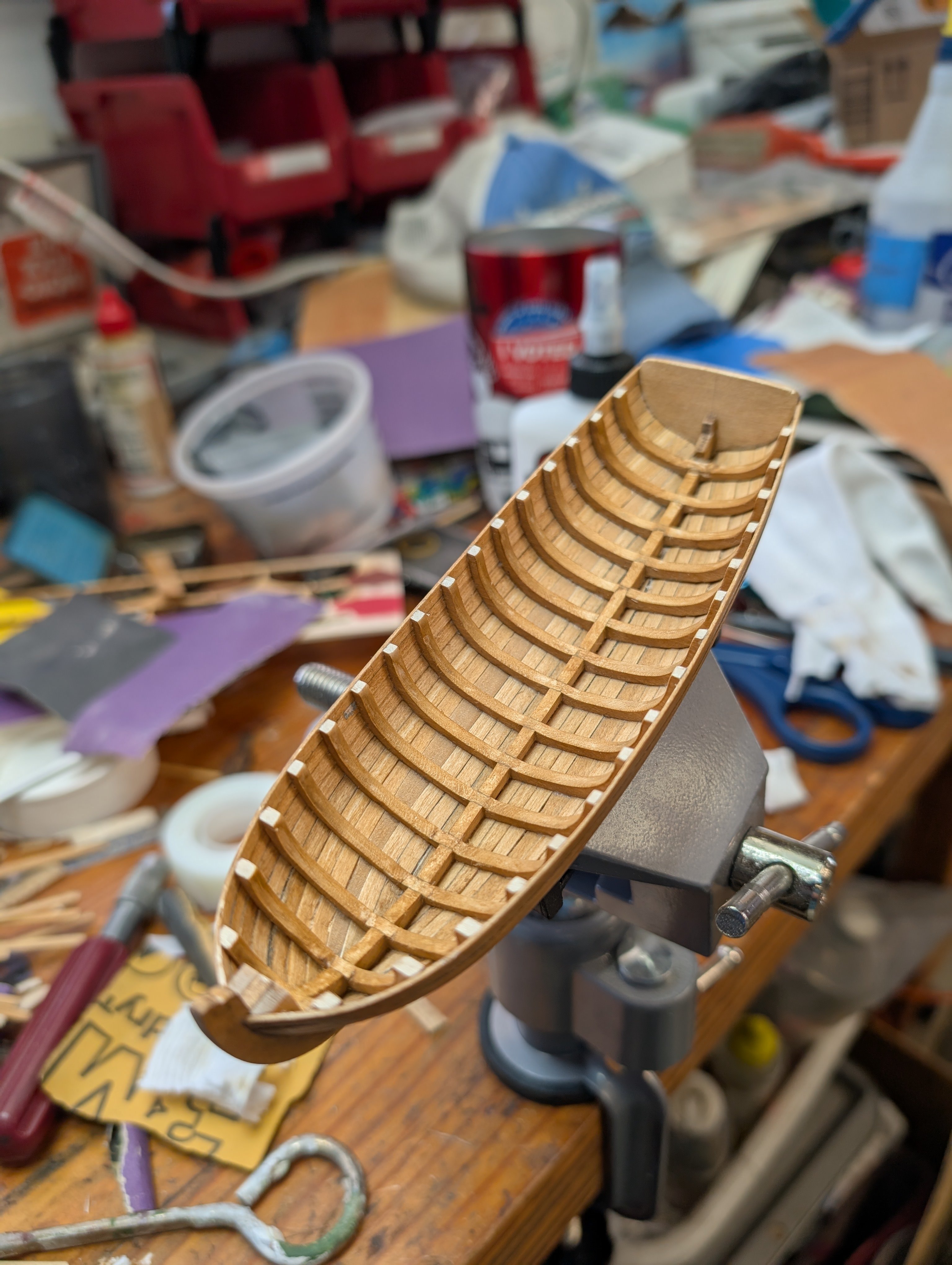

I did prep all the bits that go inside. Got all the planks out for the risers, floorboards, decks and thwarts and pre-stained them all. I realize part of the reason for doing this is also that I had limited time to work at one stretch. So, made sense to do all the staining, then walk away and let it dry. I wanted a lighter interior and found that diluting my English Oak Minwax with water gave me the tone I was looking for. I think the instructions suggest mixing two stains. I tried a few I had on hand but preferred the simpler diluted version.
Next... Started by adding the little indent shown in the instructions for thwarts and risers. I simply "eye balled" were the detail should go and laid down a straight edge, roughly were I wanted the indent, and scribed a long line near the edge. I started with an awl, but that was too sharp and didn't show well. Then found a pick with a slightly blunt tip and that worked nicely. Seemed pretty easy and is a nice detail.
When installing the floorboards I did moisten them slightly before laying down to help it follow the curves. Once you have one good floorboard down, and glued then adding the others is pretty easy using some scrap planking as a spacer. I was able to use the binder clips clamped to a frame on the side and pressing down the floorboard down while gluing.
I thought fitting the fore and aft decks might be tricky, but I found using a small bit of card stock to make the template worked out well as described in the instructions. I made the template in two halves. I roughly cut out two oversize pieces, one for a left side one for right of both decks. Laying in the rough cut and putting pencil marks at the frames them slowly trimming back the insets for the frame made it easy to fit. Once each side was fit, then I put them in place and taped them together to form the template. You can see one side of this one is not done and needs adjusting, but the other side is ready:
I made up the decks, and after gluing I did run a thin pencil at the joints to highlight it a bit. You'll notice in the next pics that I had to add an underside support, as well as taper and trim the supports holding the floor together because some of the initial supports either hit the sides of the boat or ended up right at a frame.
Do glue in the floorboards before adding the risers 🙂   I found a piece of plank that was the correct width for the offset on the risers. So, was able to clamp that in place and then put the actual riser under it. No measuring needed!

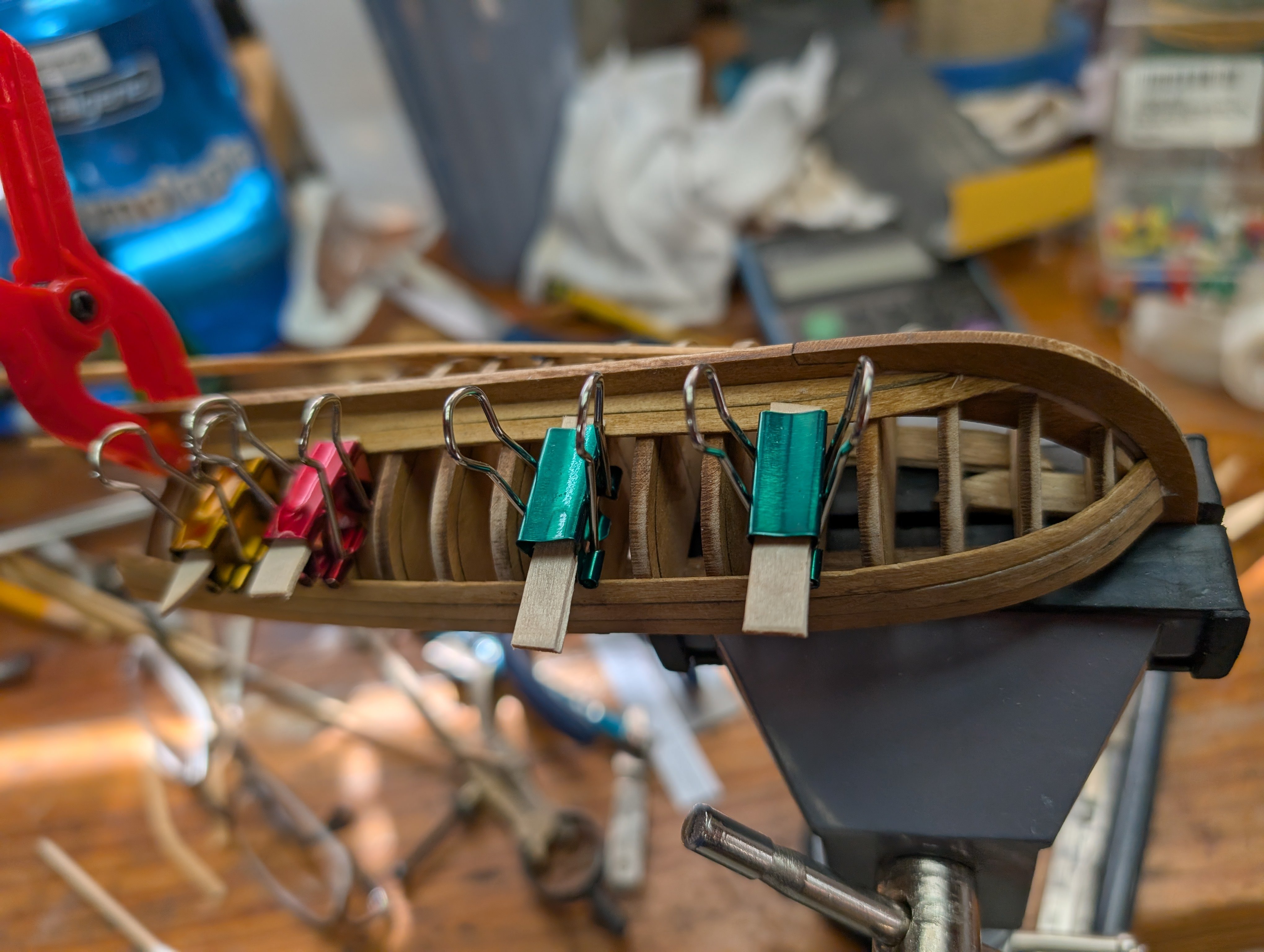

The caprail. Again I used some stiff poster board and made a couple templates as described in the instructions. The only tricky part was making sure the lengths were correct and that it met the stem and stern correctly. I made the bow section of both caprails meet behind the stem. I think the instructions use a filler piece at the bow joint. That would be easier to fit because you don't have to be so exact were they meet. Everything else is sanded into shape after it is installed. One tip I saw on the forum was to use wood strips to glue down the cap rail. I had some paint stirrers/tongue depressors which worked great with a couple rubber bands. Once glued on it just took a bit of sanding to get the final fit.
