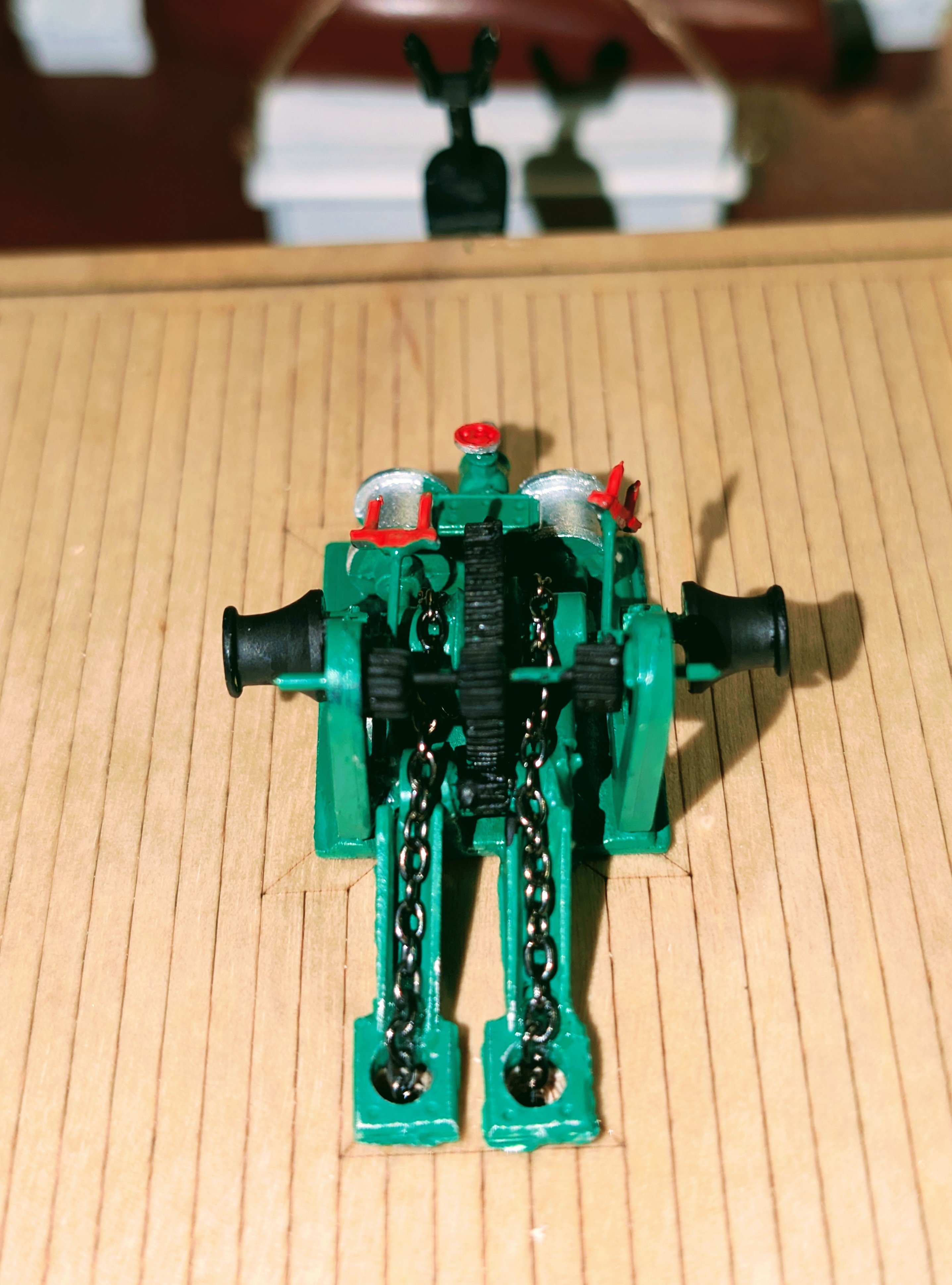

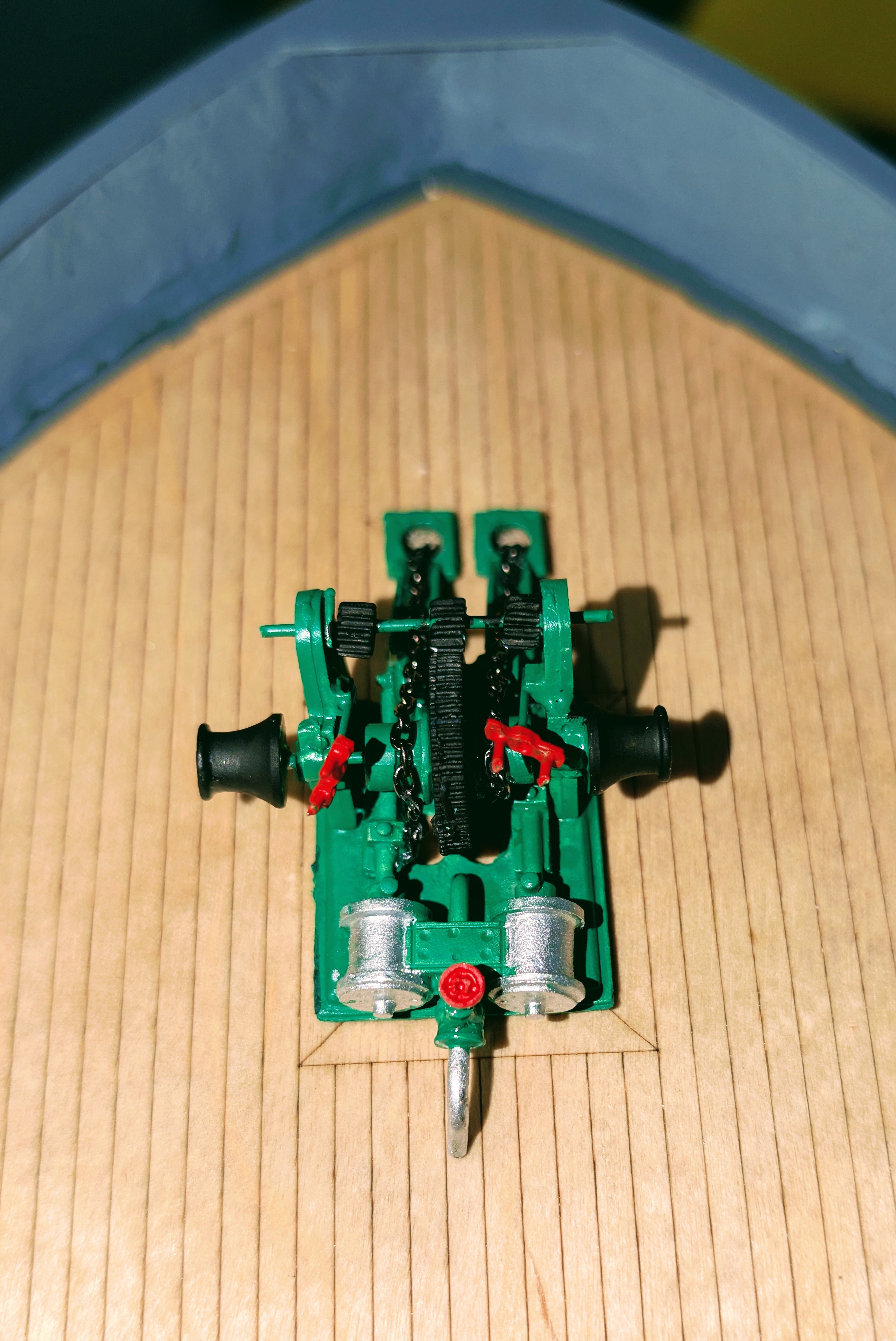

  1. Here's the anchor windlass, which is a nice-looking assembly, completed and glued in place on the fo'c'sle. I really like this kit -- it's a fun build, and as the ship nears completion, it looks really nice. But it blows my mind that a kit from Caldercraft that costs as much as this did (over $600) doesn't include parts such as the anchor chain, or ANY rigging line. They aren't missing -- I have searched the parts list electronically and there is no anchor chain included. So given the ambiguity of the instructions that I've mentioned several times above, this is a kit for experienced builders for two reasons: first, you have to decide on your own how to build a lot of things, and second, you need to have built a bunch of kits so that you have a good spare parts box. 😁 That's where the anchor chain shown came from, and that's where my rigging line will come from. Regards, David
