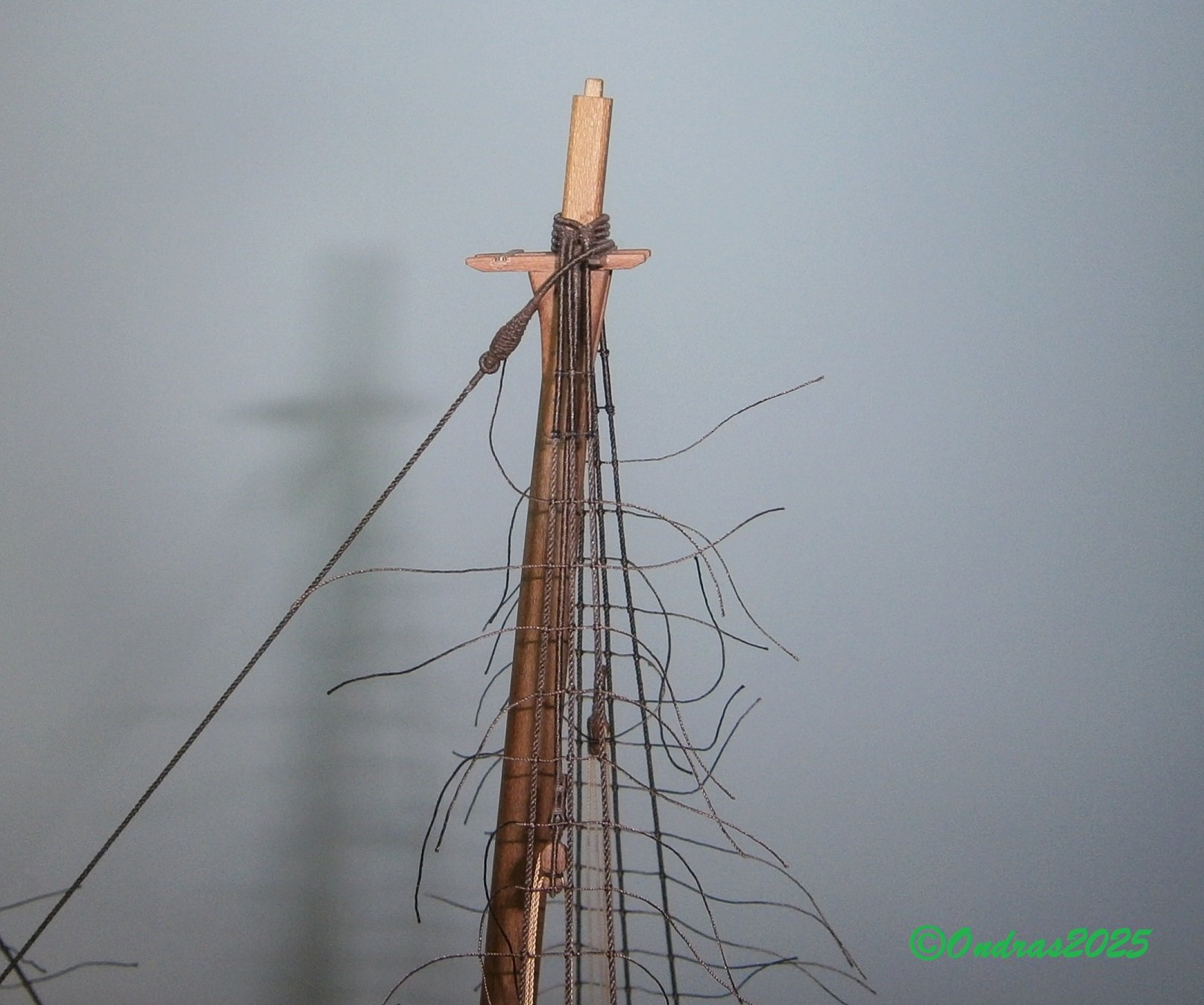

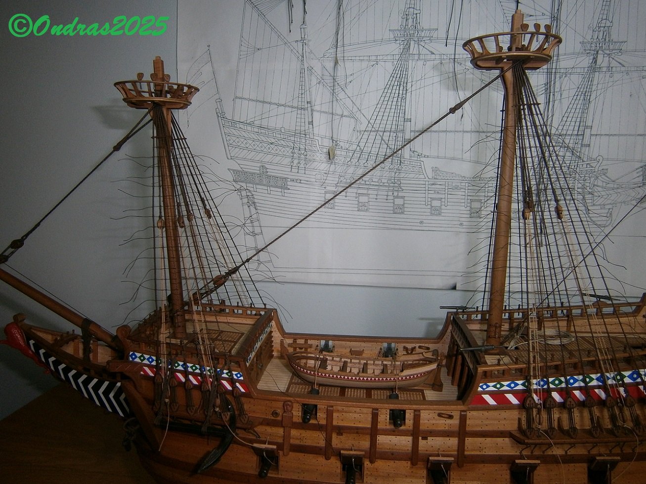

Thank you very much Mark, I wish the same. So in the new year, I measured the Topmast shrouds..🙂 Tied up temporarily. Topmast will be removed.. -

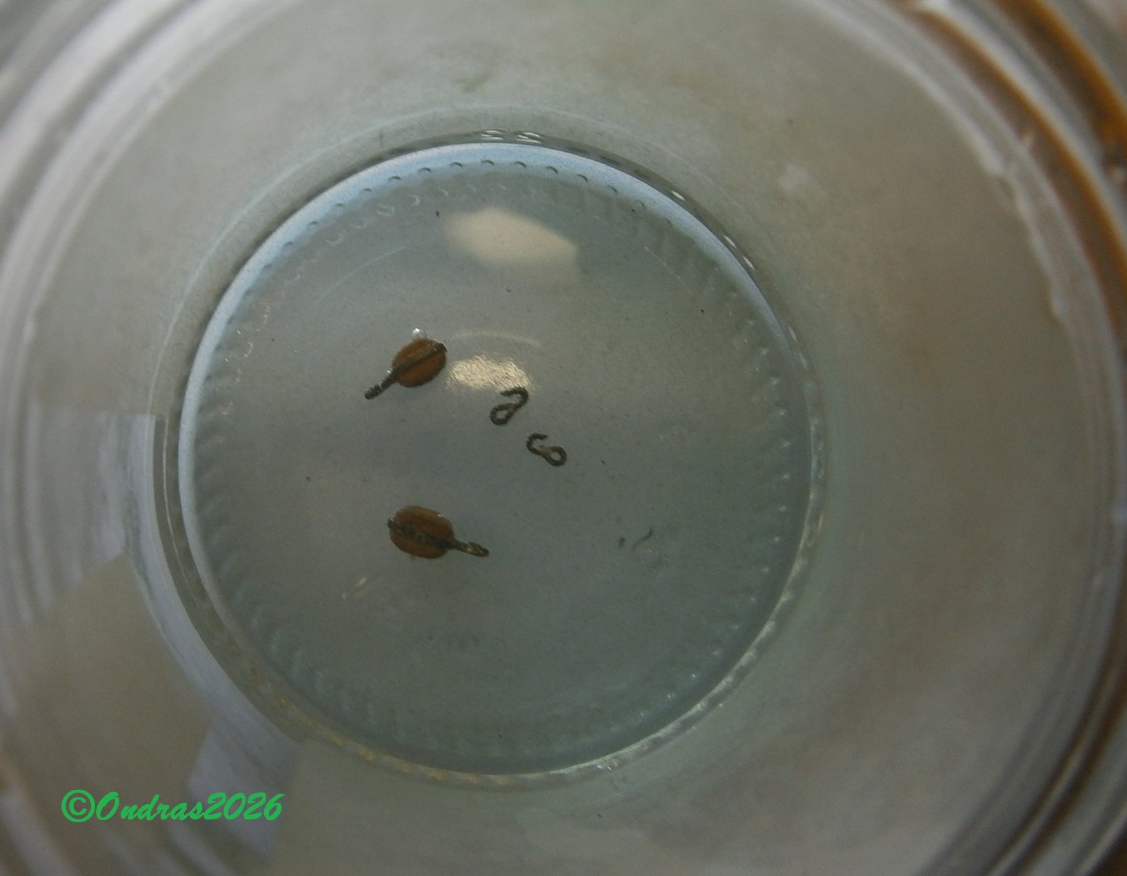

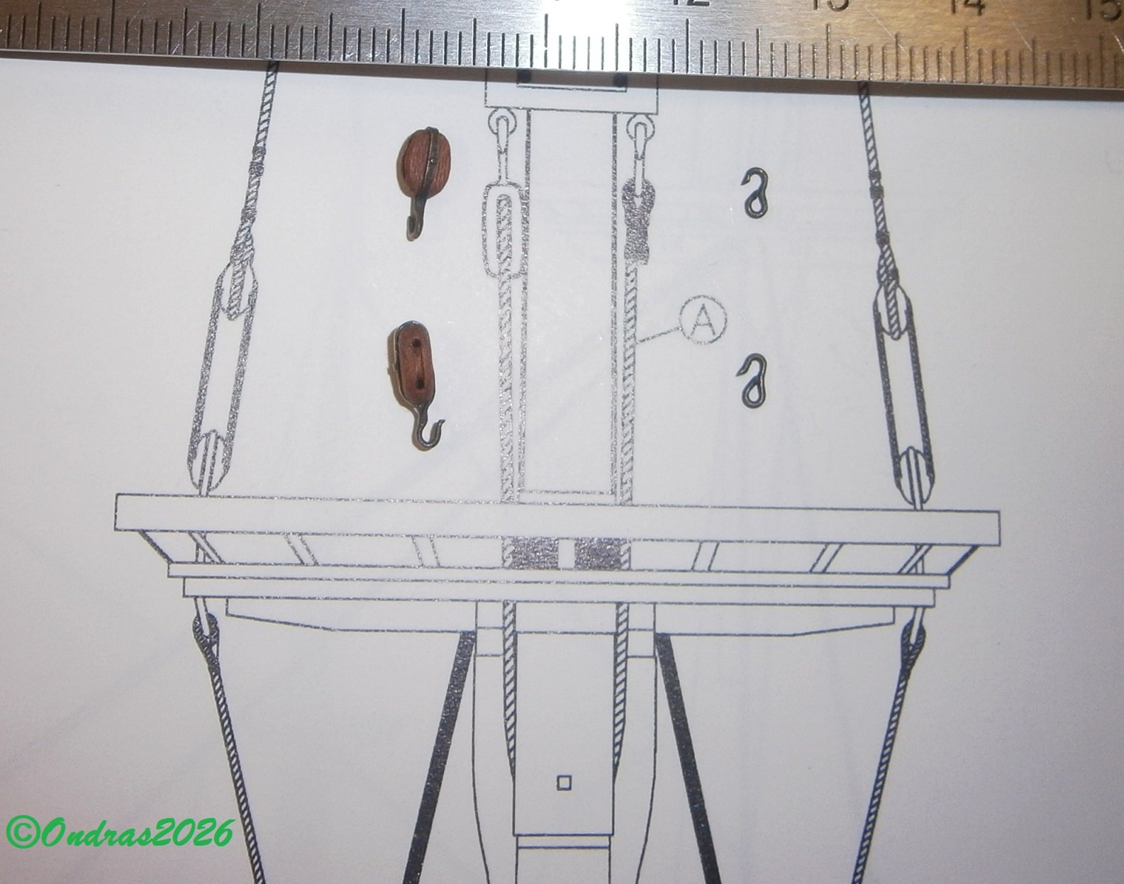

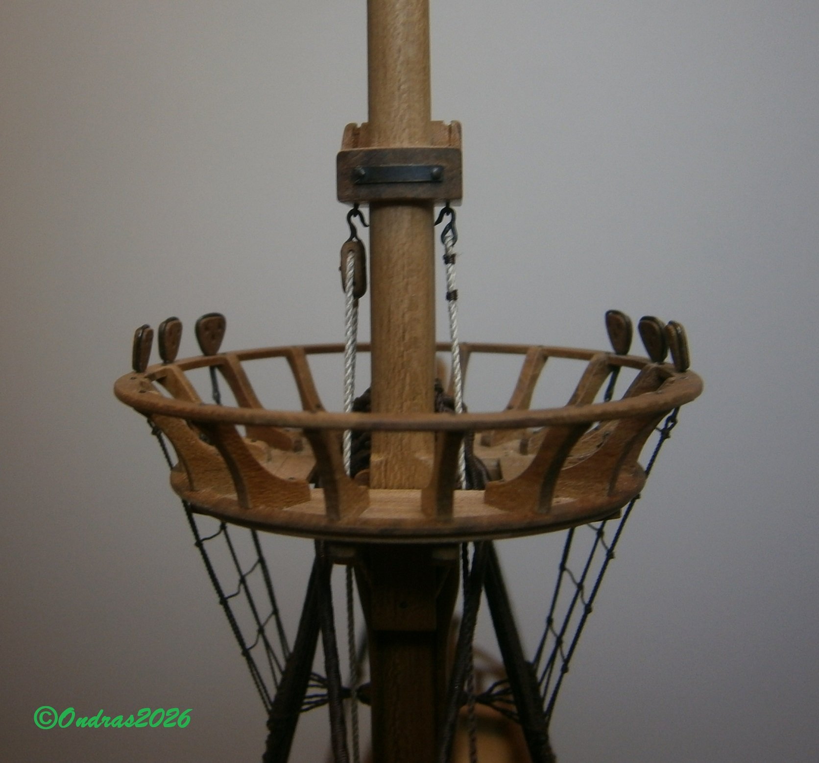

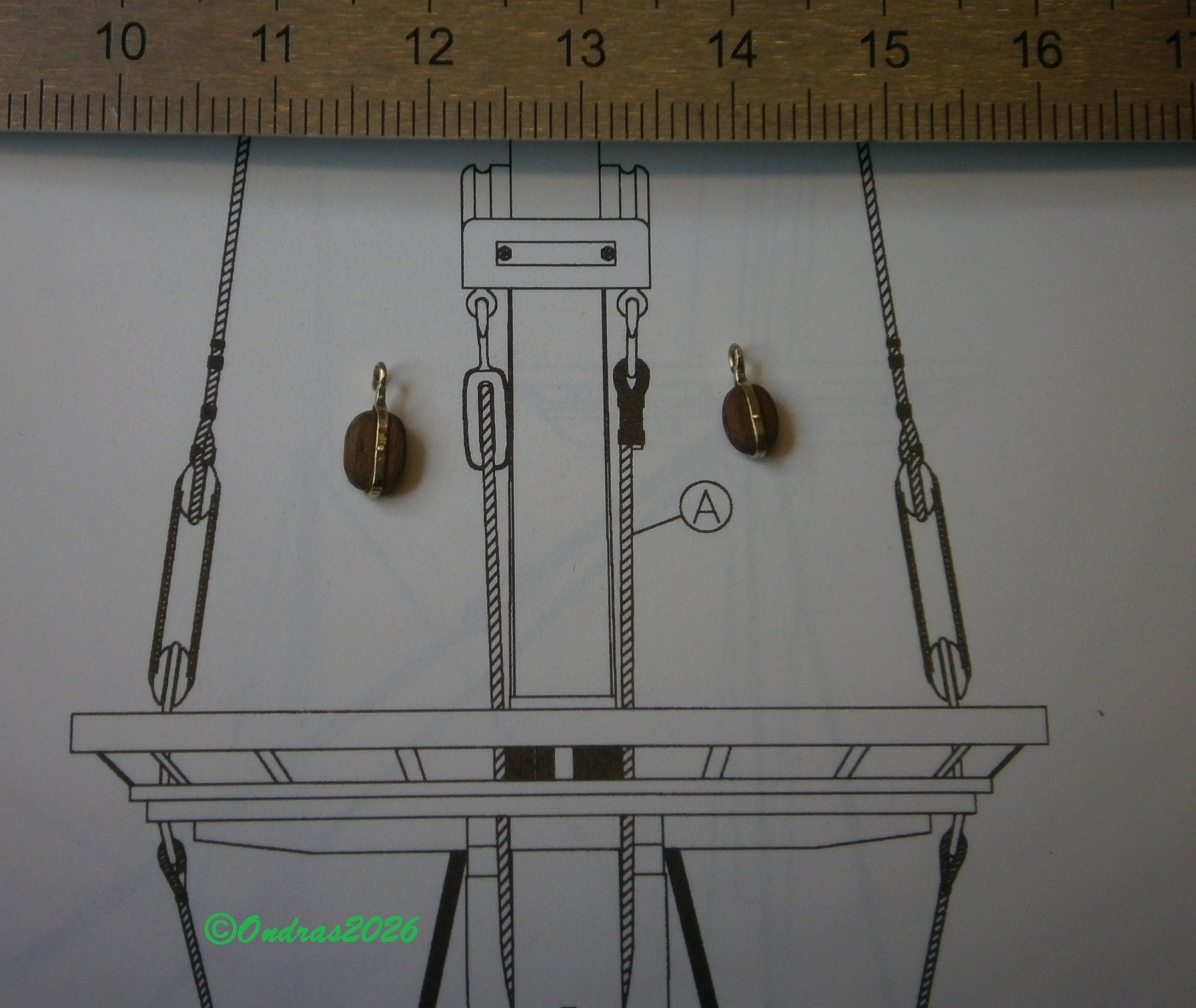

Thank you very much Kirill. Definitely useful for many modelers! Another component. Removable loading hoist "Stay tackle".. It was nicely discussed here by modeler Mati and the author of the book "The ships of Abel Tasman" Ab Hoving. https://shipsofscale.com/sosforums/threads/pinnace-papegojan-1627-1-48-completed-build.7055/page-2#post-159810 On the last day of the year, I wish all modelers a lot of peace in their construction, personal well-being and, most importantly, health until 2026. Ondras -

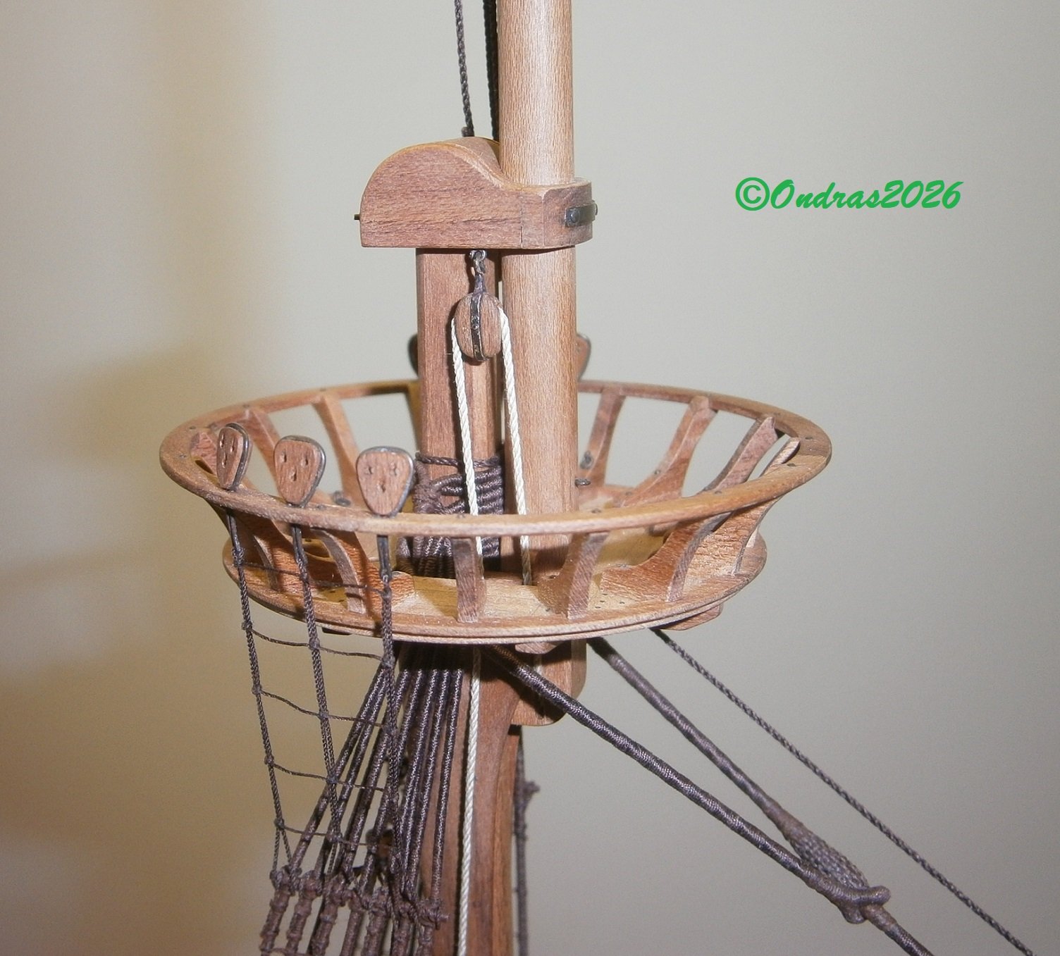

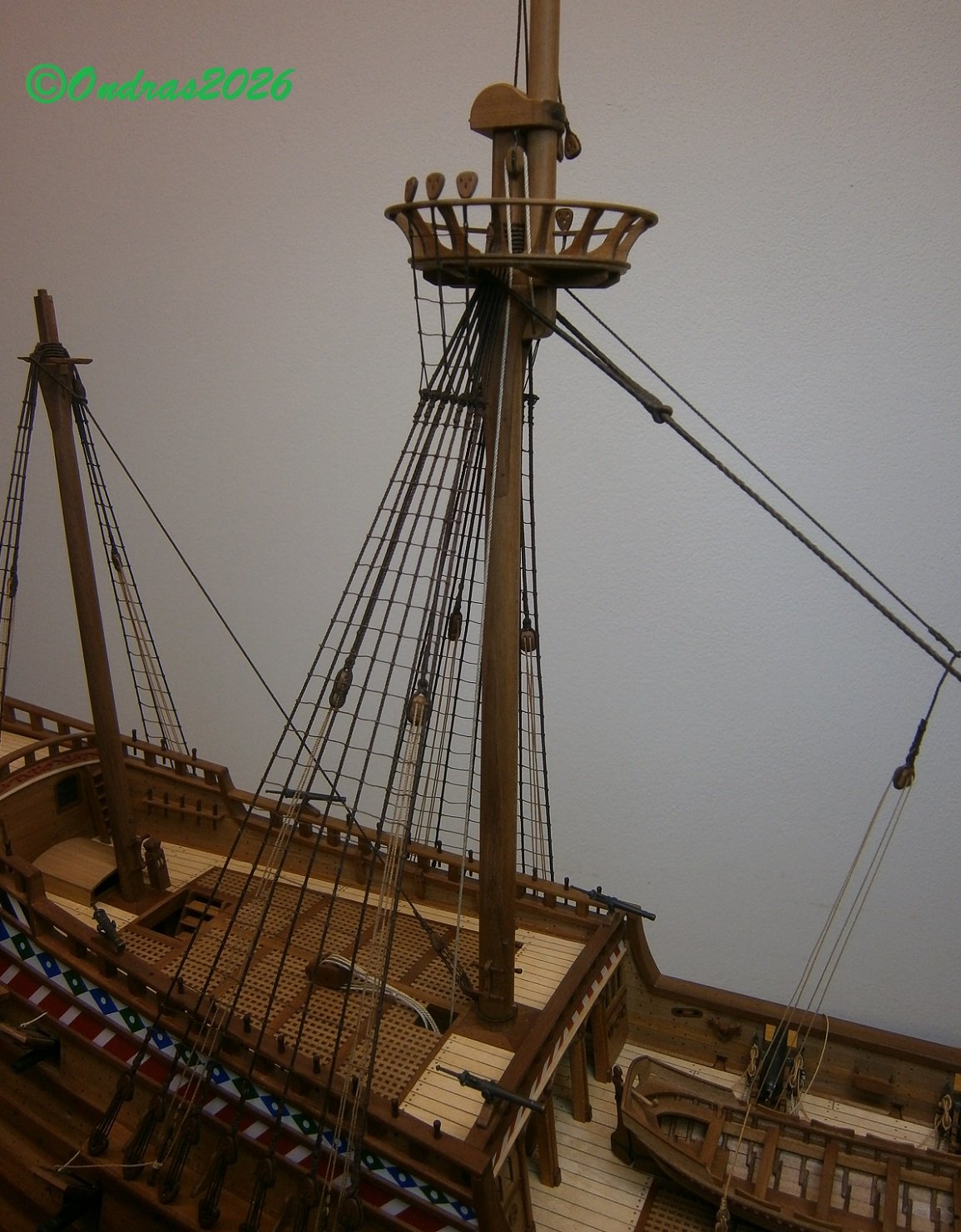

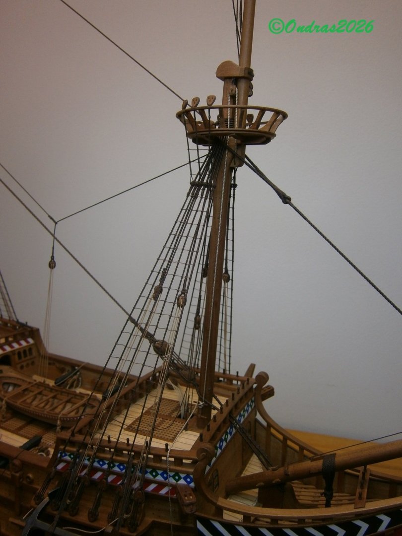

Thank you very much Ronaldo. Thanks for the like. Lower Ratlines finished..🔥 Next is the Catharpins component, seen from the William Rex ship model.. -

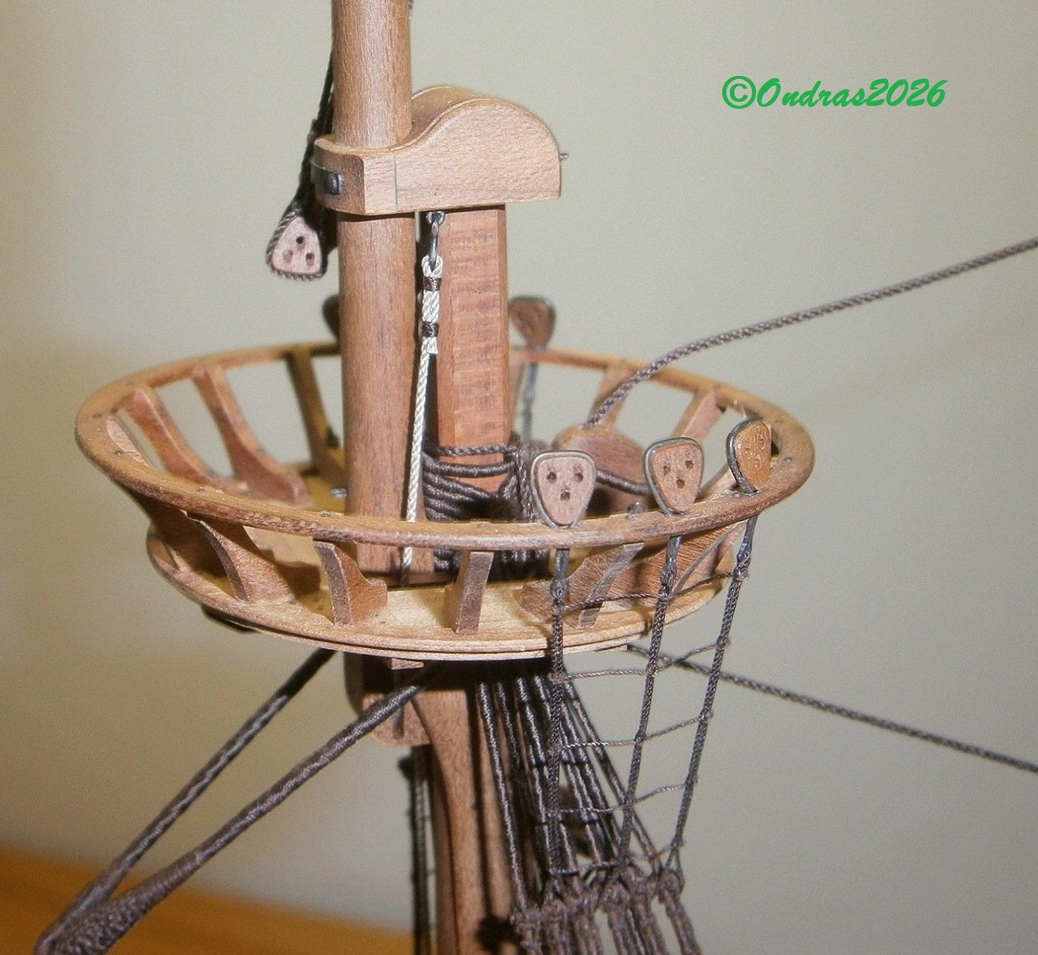

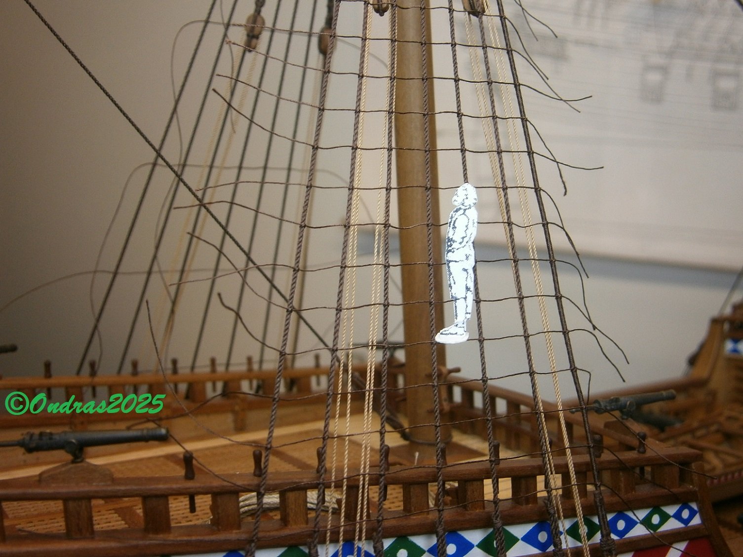

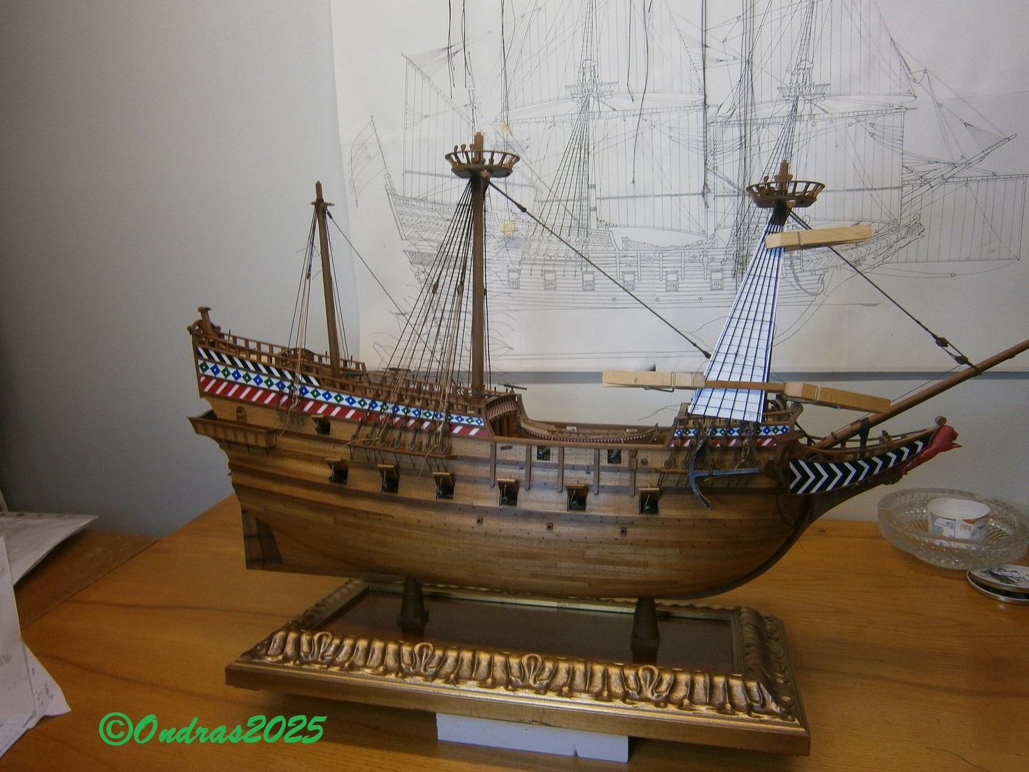

Bottom Ratlines strung..🔥 ..compare again, glue the end knots and cut..🙂 Measurement by the figure of a sailor.. Sometimes a rung had to be replaced.. This is how Ratlines are knitted on the replica "De Witte Swaen"..💥 At 6:00 minutes... -

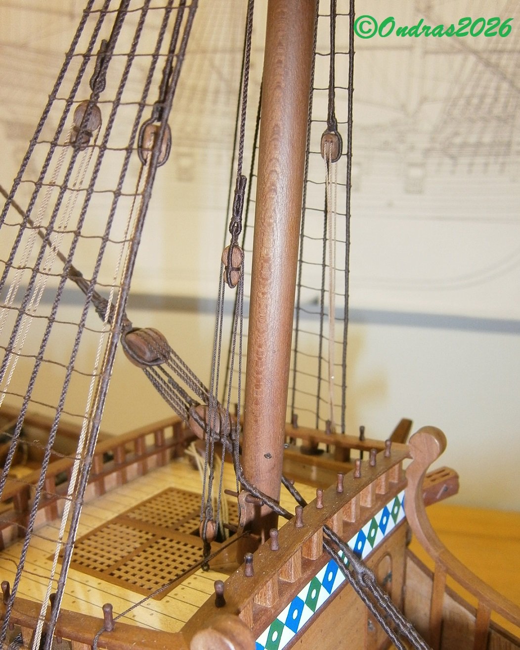

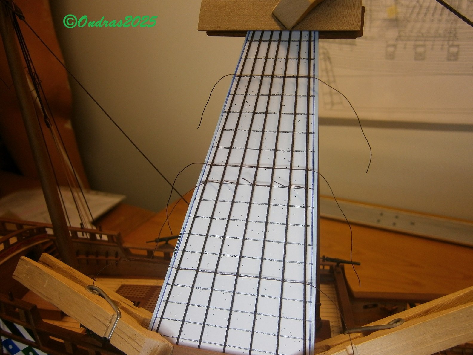

Bowsprit equipped with blocks.. Ready and tight Stays.. Added Ratlines metal crossbar (Futtock stave).. Ratlines knot tying begins.. -

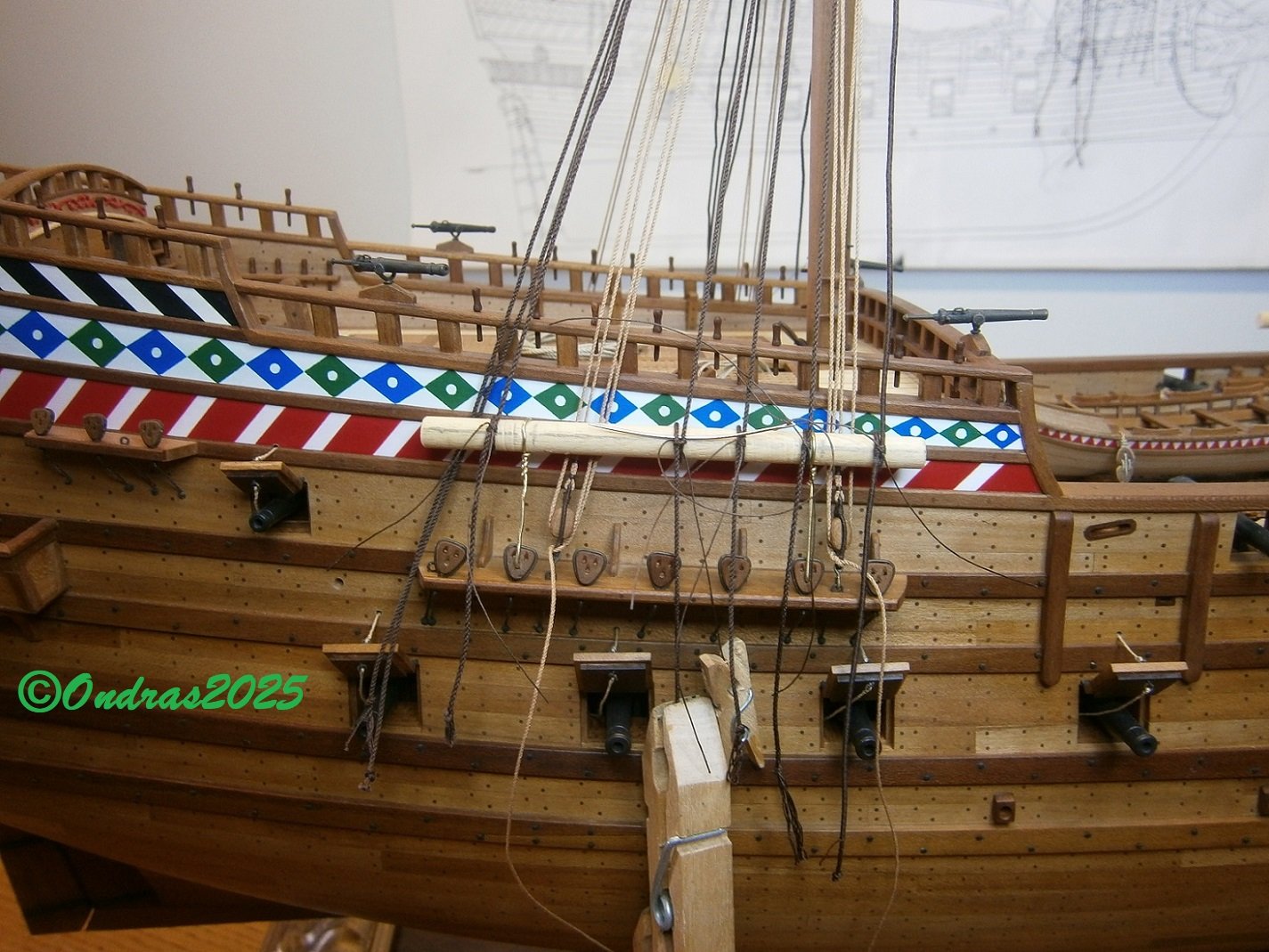

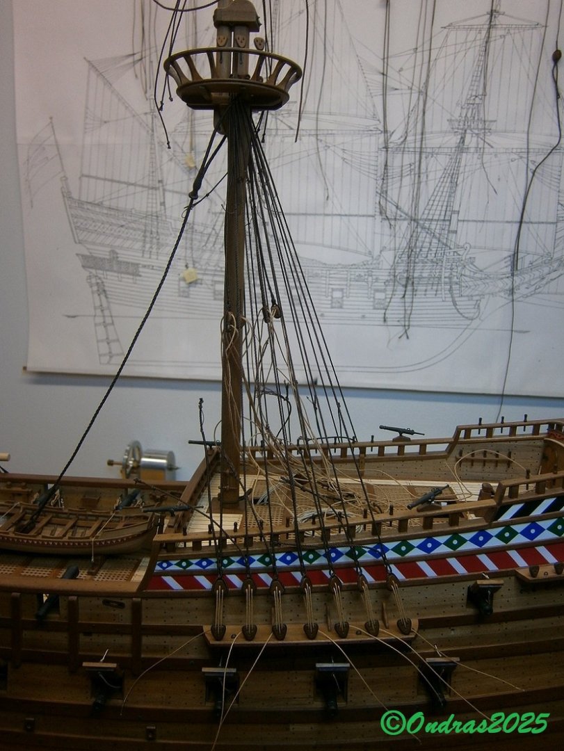

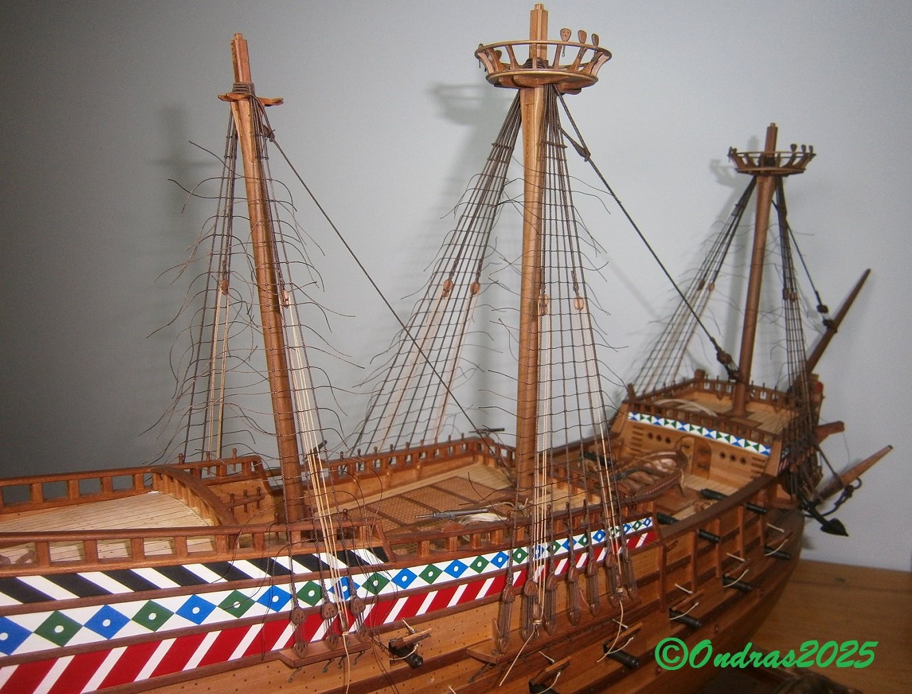

I continue tying the deadeyes. Mizzen mast..🔥 After measuring and tying the deadeyes to the shrouds, I glued the masts.. "Tackle" and Deadeyes tied cleanly. Just need to adjust the height..💥 -

Hello Johann. Thank you for the compliment. I admit that I didn't recognize the groove, I only saw a thick line. The groove is really needed!!🔥 Hello Bella. Did you mean this crossing of blocks? Fortunately, the distances are fine.💥 Before gluing the masts, I tied the boat up, as Kirill had pointed out. I put in a thicker rope and immediately created smaller deadeyes.. All sizes created by me.. Deadeyes of the foremast measured.. -

This is how I tie the Deadeyes to the main Shrouds. Due to the different distances between the upper and lower Deadeye, I used the system that modeler "archjofo" uses when building his beautiful rigs. It is a log with a diameter of Deadeyes, which is at the correct height even with different inclinations of Shrouds..👍 Then another binding.. Result ok..💥 -

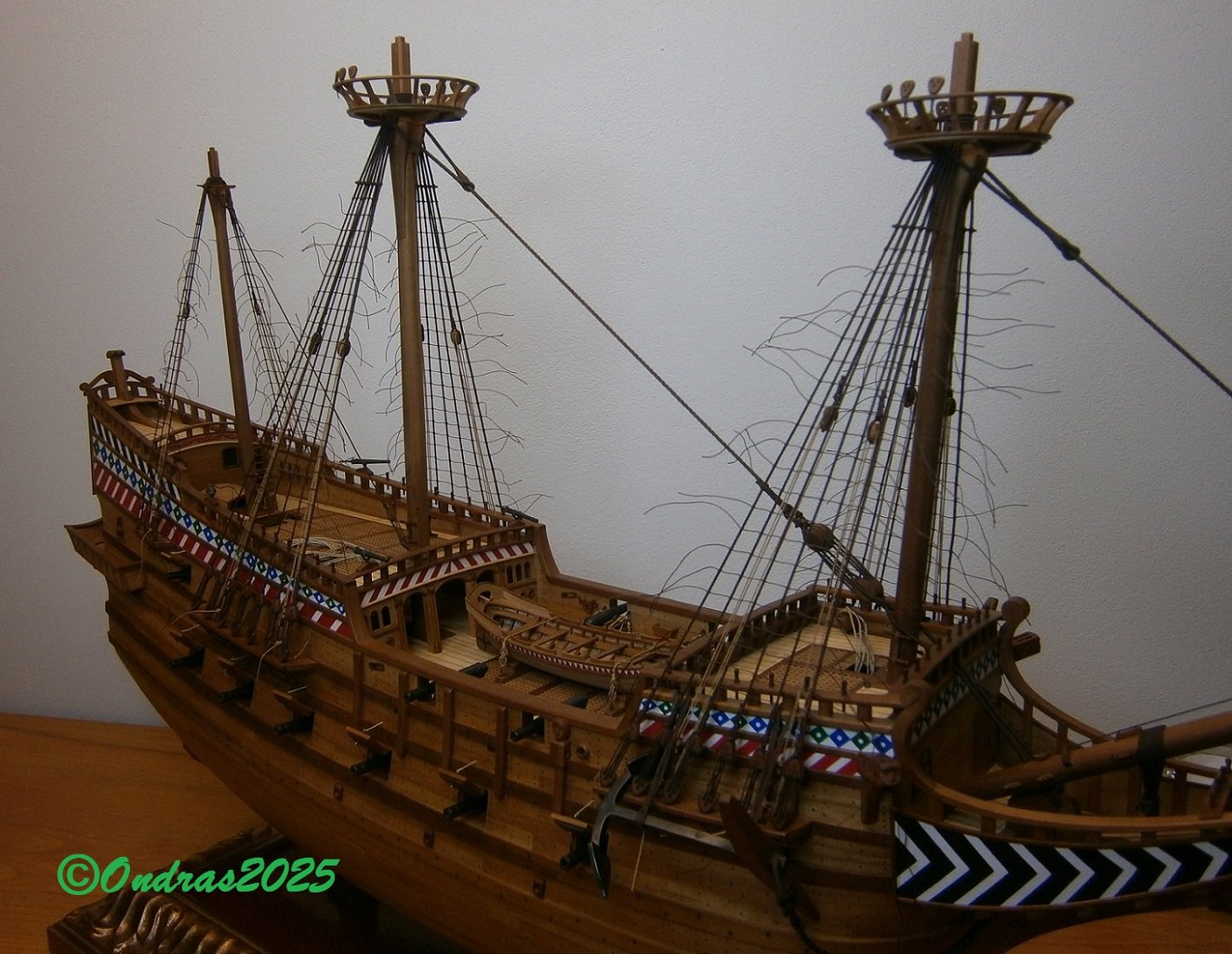

As I reported, I enjoyed a weekend in Sweden with the main goal, the Vasa Museum. https://www.vasamuseet.se/cs I had been preparing for this for about 40 years and it was worth it. When I arrived, my watch reported increased blood pressure and heart rate... I spent over 4 hours here, I could have stayed longer, but I took into account the company of my son. I walked around the ship several times and compared the beams and planks with the strips from which we model them... Having the ship about three meters away from each other is unreal. I tried to look at and photograph every detail. Simply indescribable, at the end a very long viewing with contemplation..🔥 I've made some progress on the boat. Front and main tackle finished, I'm tuning the Stays and the Schrouds are waiting for me.. -

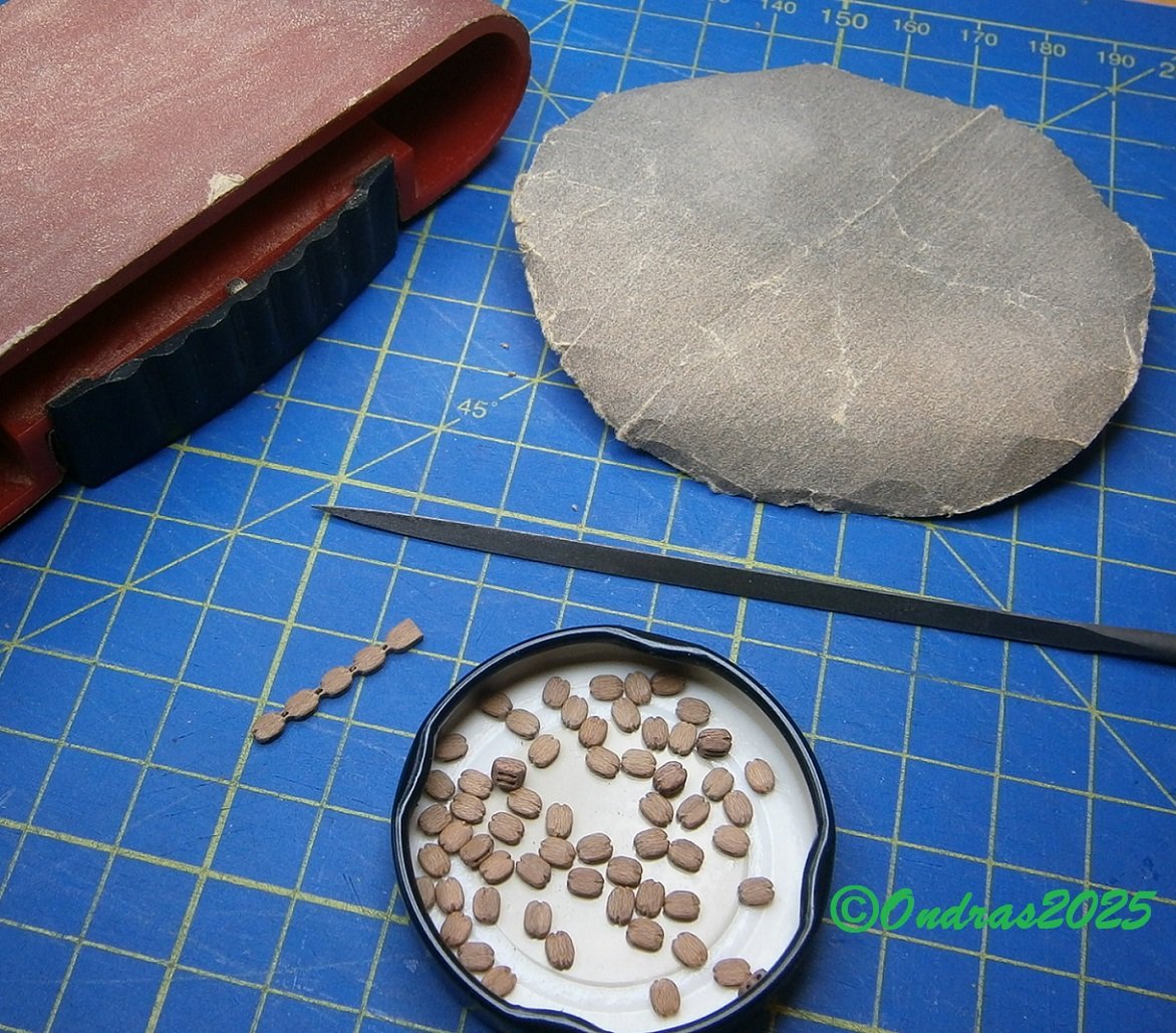

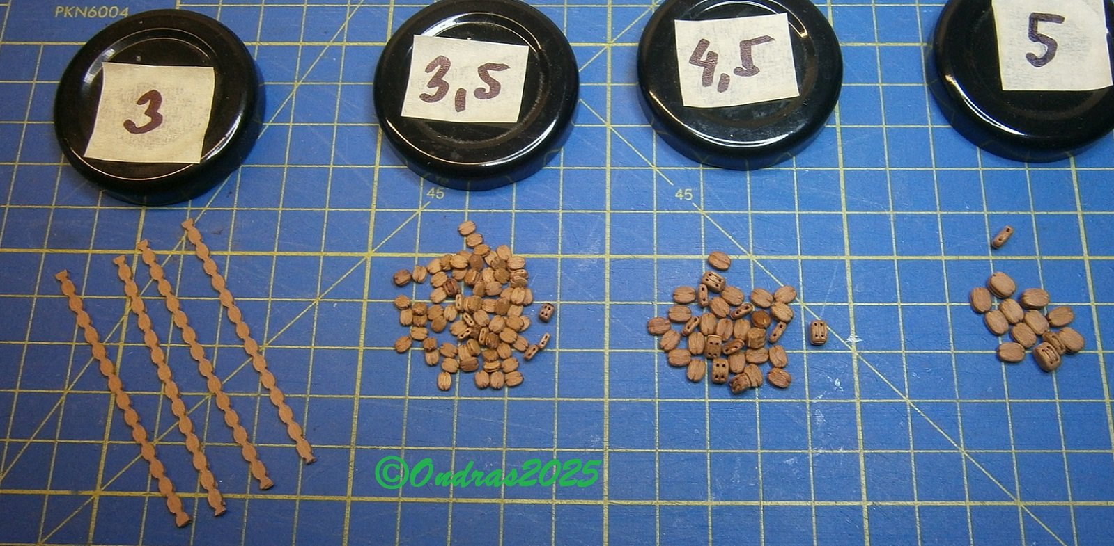

A short break in construction. Czech Republic Championship competition and model exhibition in the beautiful surroundings of the Czech Doksy Castle..🔥 https://www.klom-admiral.cz//id:12346/micr-sekce-c-2025-zamek-doksy I continue to produce other blocks of smaller dimensions. "Machine" production with shaped cutters.. waxed... I'm gradually getting smaller and smaller. There will still be a lot of manual labor here..😴 -

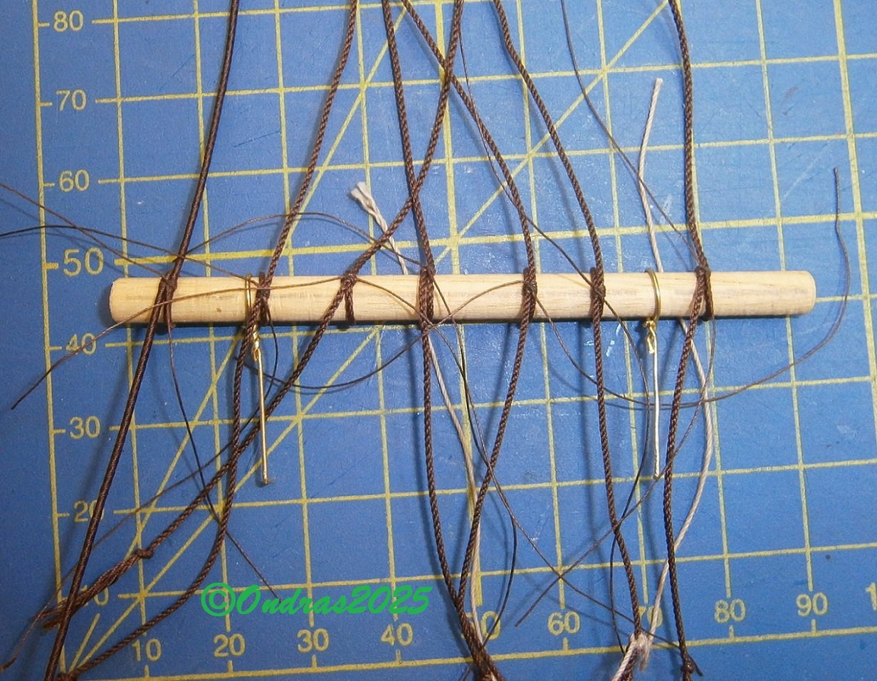

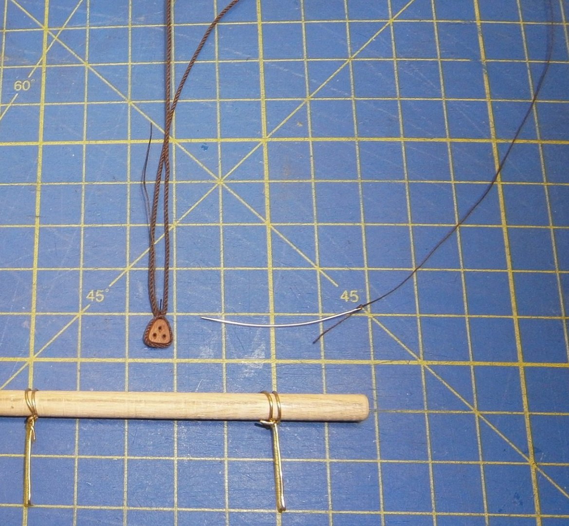

I studied the Stays Mouse braiding system. I created a jig from scraps. I used two systems I found..🔥 The ends are tied on a rope wrapping machine. I gradually weaken the wrapping thread until it is gone..💥 Stays mouse on Main stay done..💥 -

I am familiar with the Rope wrapping machine. I must confirm that the author Roman from Poland has mastered it with great craftsmanship. Super gears with gentle resistance prevent untangling. Polished material brass and aluminum. Interchangeable parts for many different activities. Very pleasant work... I wrap weaker ropes directly, strong ropes filled with thread.. Fixed rigging ropes braided..👌 Other work halter shrouds, eyes and Stay Mouse basics.. Dirt from superglue patinas well with brown bitumen.. Now I'm going to braid Stays Mouse. I found this work 1:1 on Duyfken replica.. -

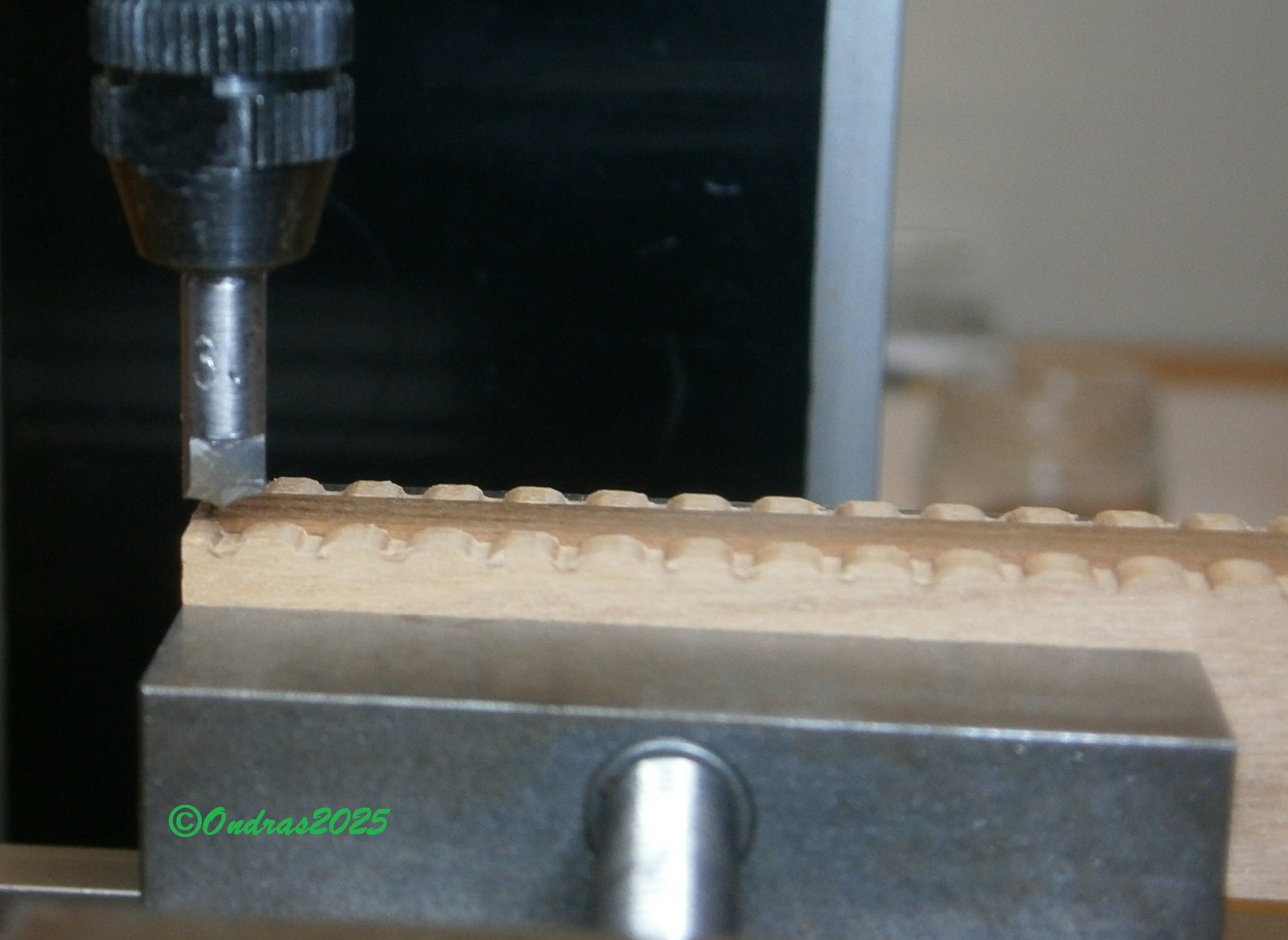

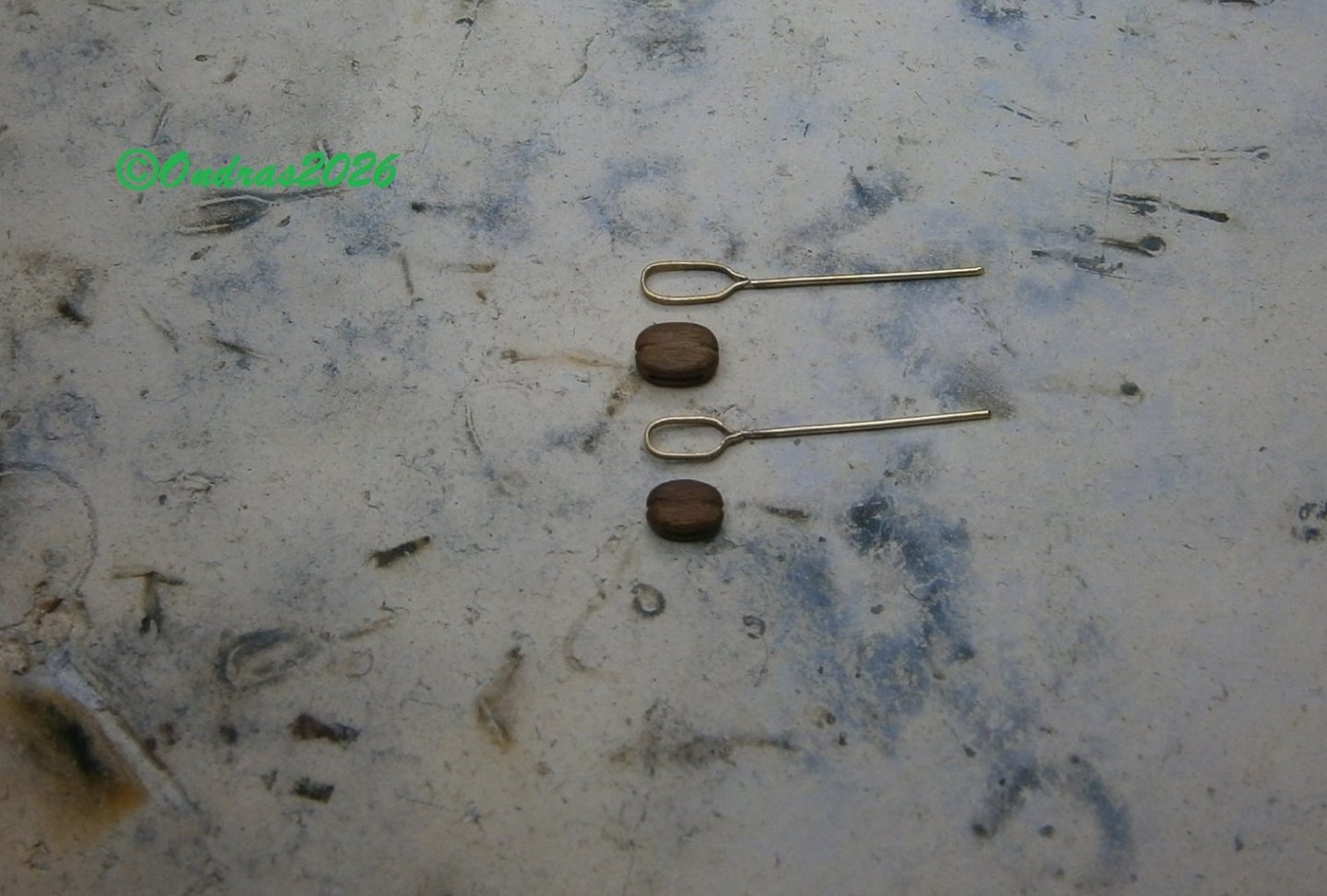

I started making blocks. First large sizes, there are only a few of them, and then non-traditional shapes. "lift block", "sheet block" and "fiddle block"... The base on the milling machine, then hand-made..🔥 I plan to produce small-sized pulleys "by machine" on a milling machine using shaped milling cutters..😴
