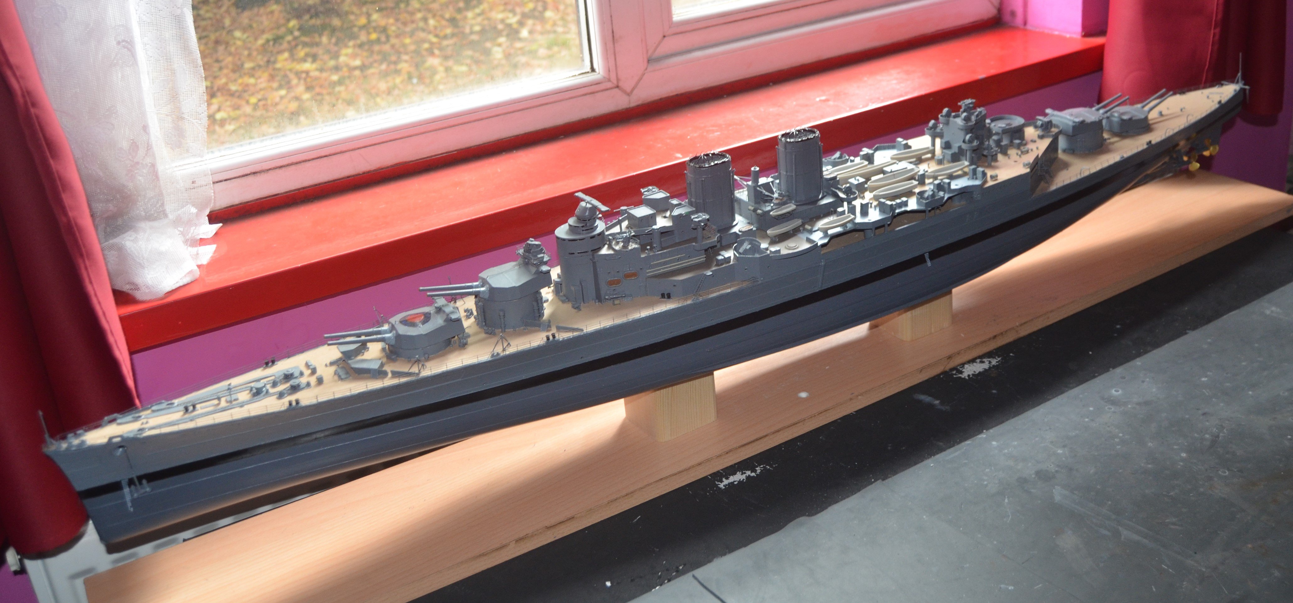

Double checking through the instructions and I had omitted one small detail. There are various ladders going down from the deck which I had fitted. For some reason I forgot to add the hand rails and have now added them. Luckily I managed to add them in the cramped space on the deck and only knocked one very small part off. I have also added the lumber to the funnel bases as suggested on the HMS Hood web site. Also have been adding various hand rails around the hull. All the guns and rocket launchers are in place. I am adding various details to the deck before starting on the ships boats then the bridge and masts. I will also have to make a decision on the ladders going down the hull. They where dismantled and stored when at sea. And I have to admit I don't like them as they take away the sleek lines of the hull when the model is displayed. I may add them on the side that will not be seen once displayed and decide if I like them or not.

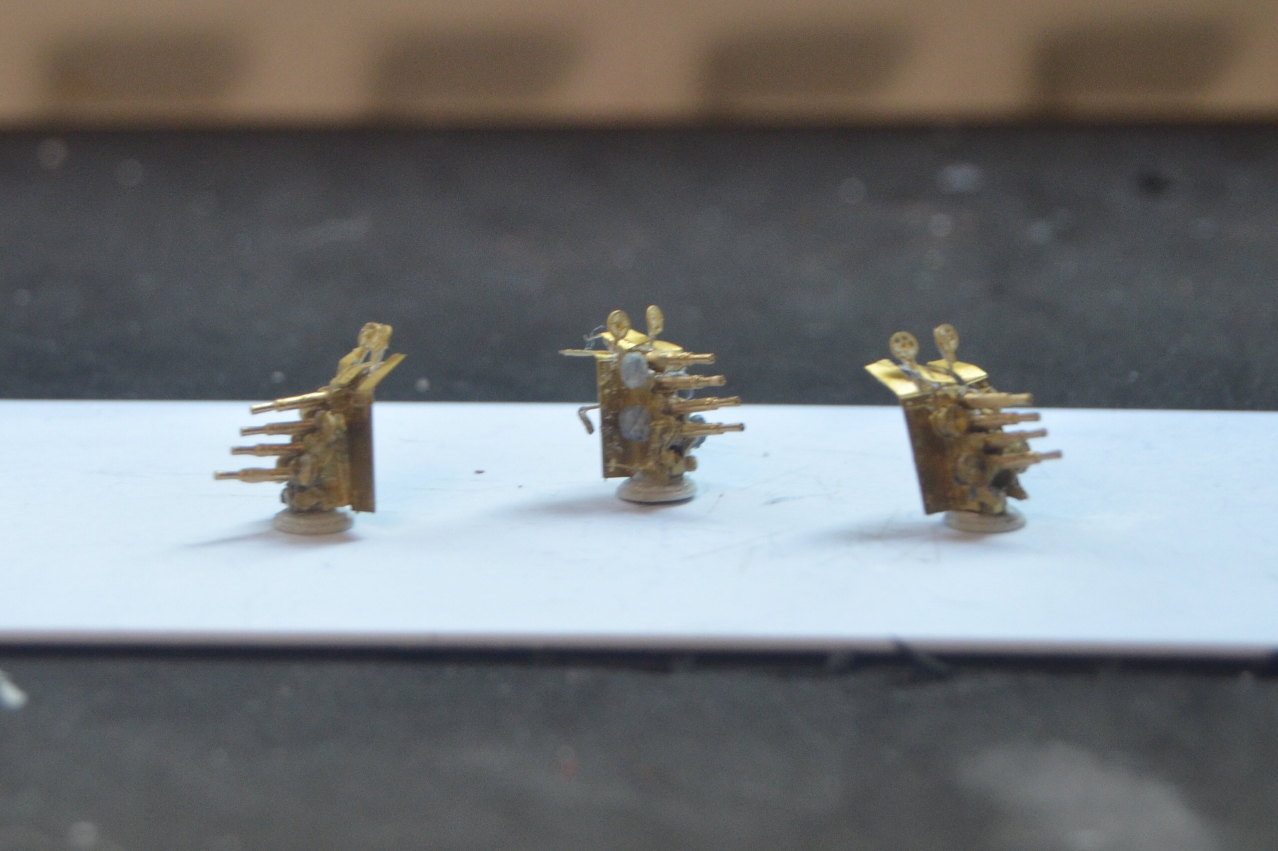

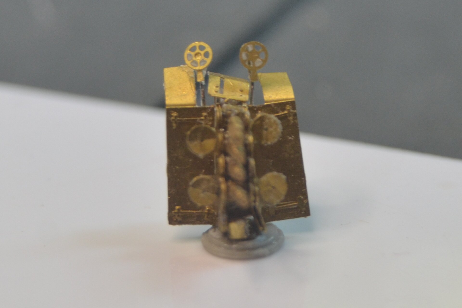

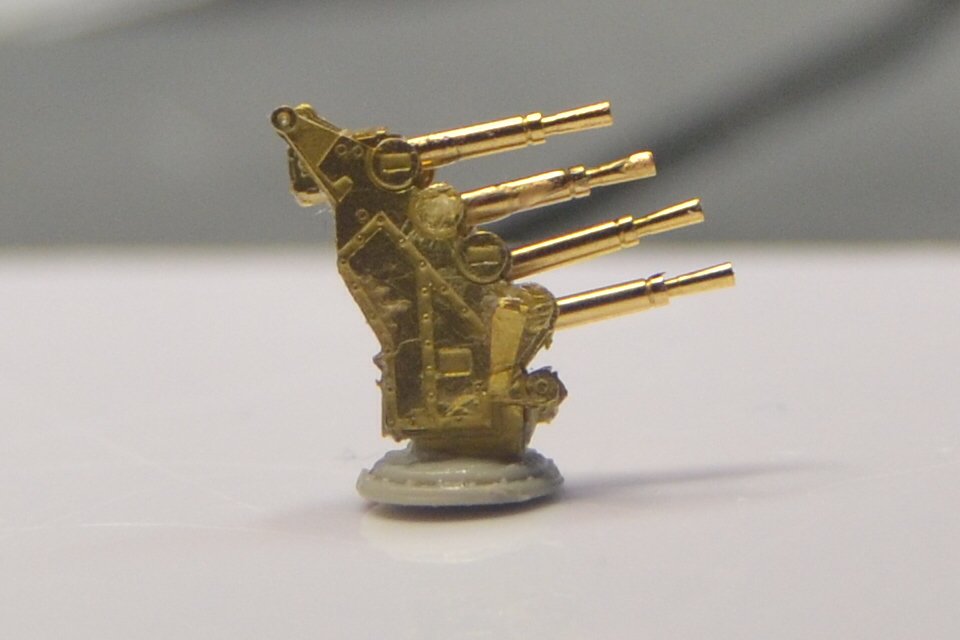

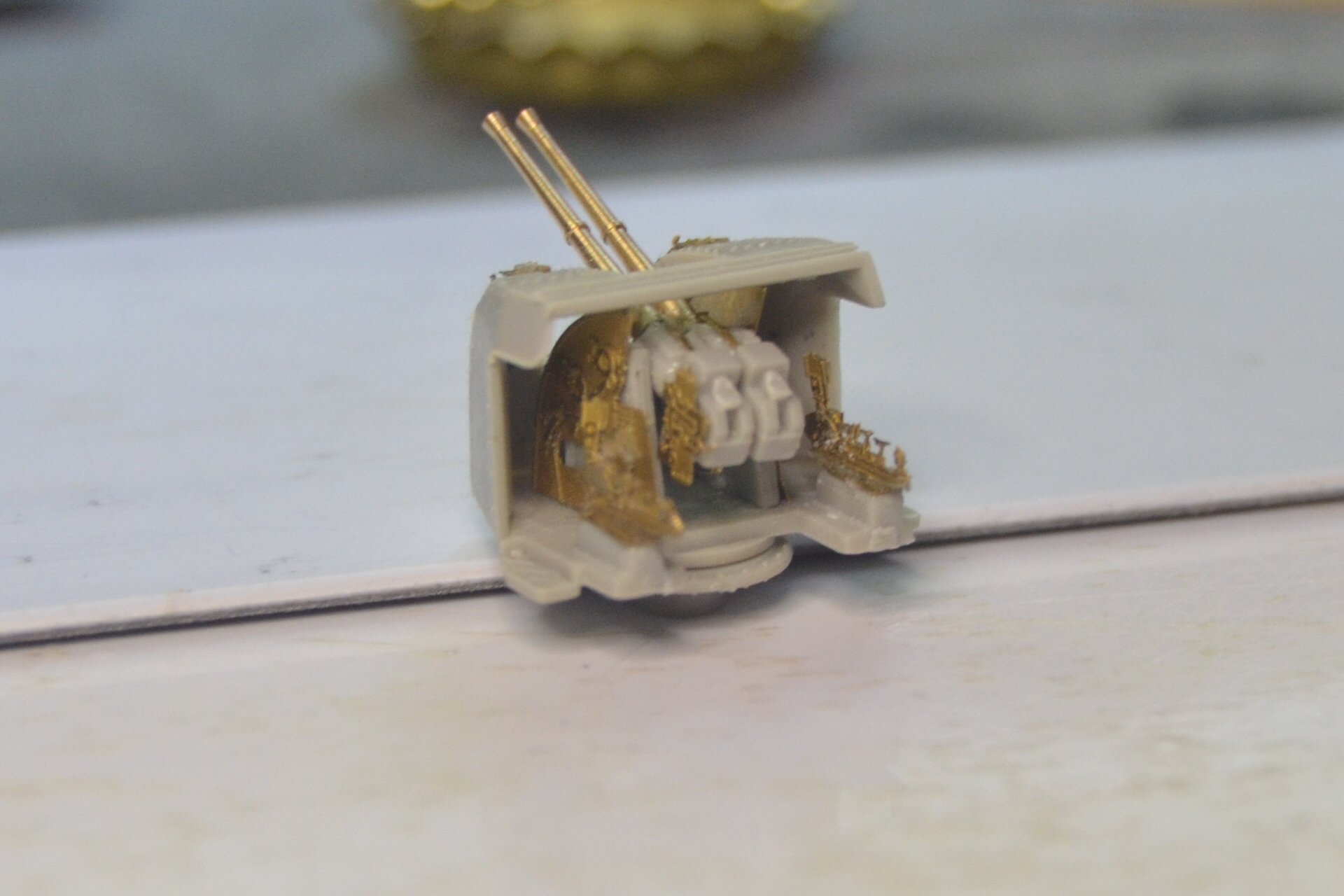

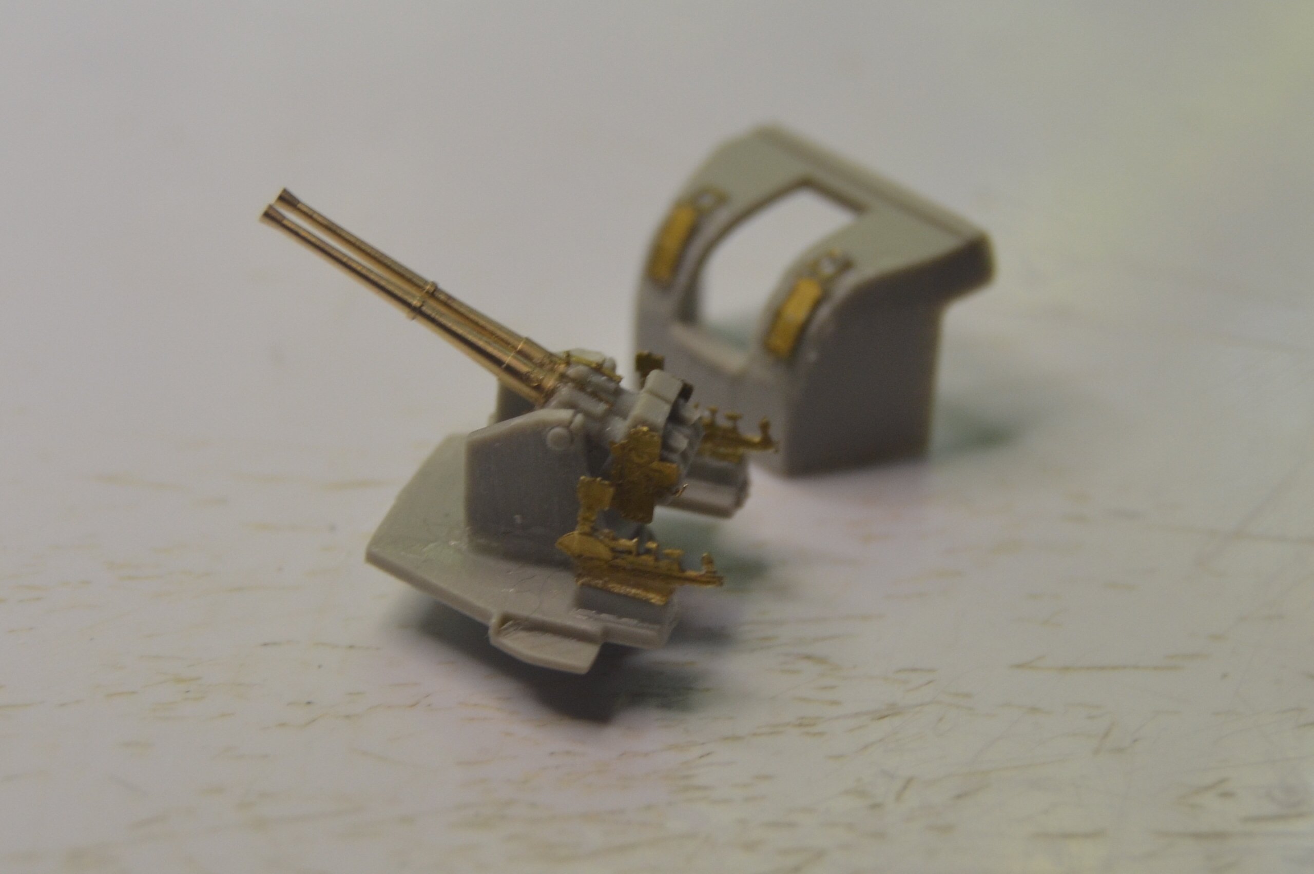

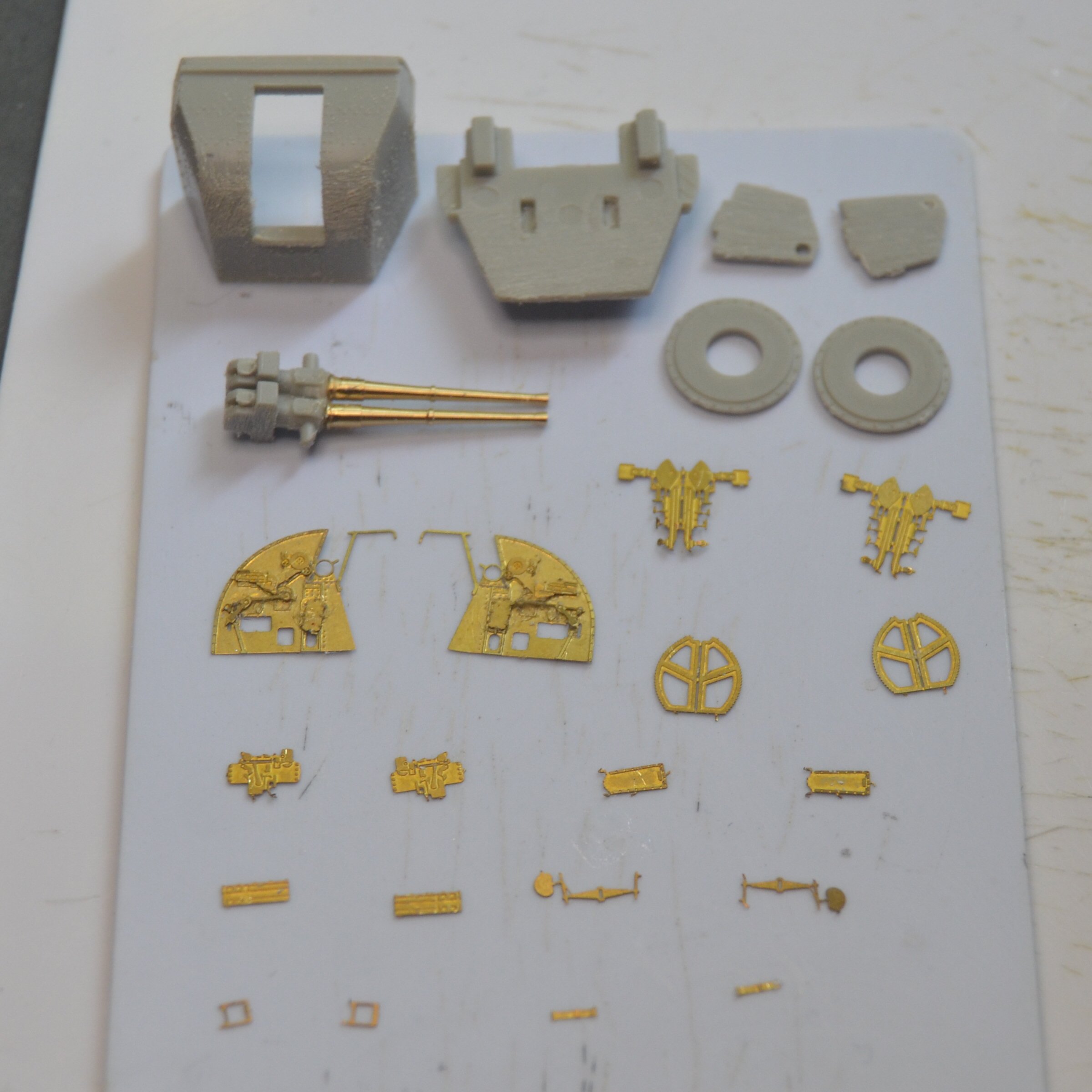

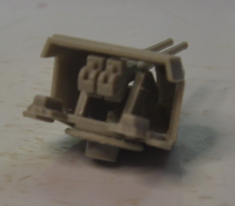

The 3 pompoms made up. To say they where frustrating to build is an understatement. There are 44 pieces of PE added to the guns. Working in a very cramped area was hell. Pictures 1 & 2 are how they would look built out of the box. There would just be the hand rails to add to them. The top of the ammo boxed are the shells for the gun. The final picture is how they where supposed to be built following the MK1 instructions. Once the boxes where put together there where 8 longer boxes that went into the back. I did make one up but it just did not look right. So I used the plastic guns and built the PE around them. They do look a lot better when viewed normally and although not perfect by any means they do look far better for all that PE.

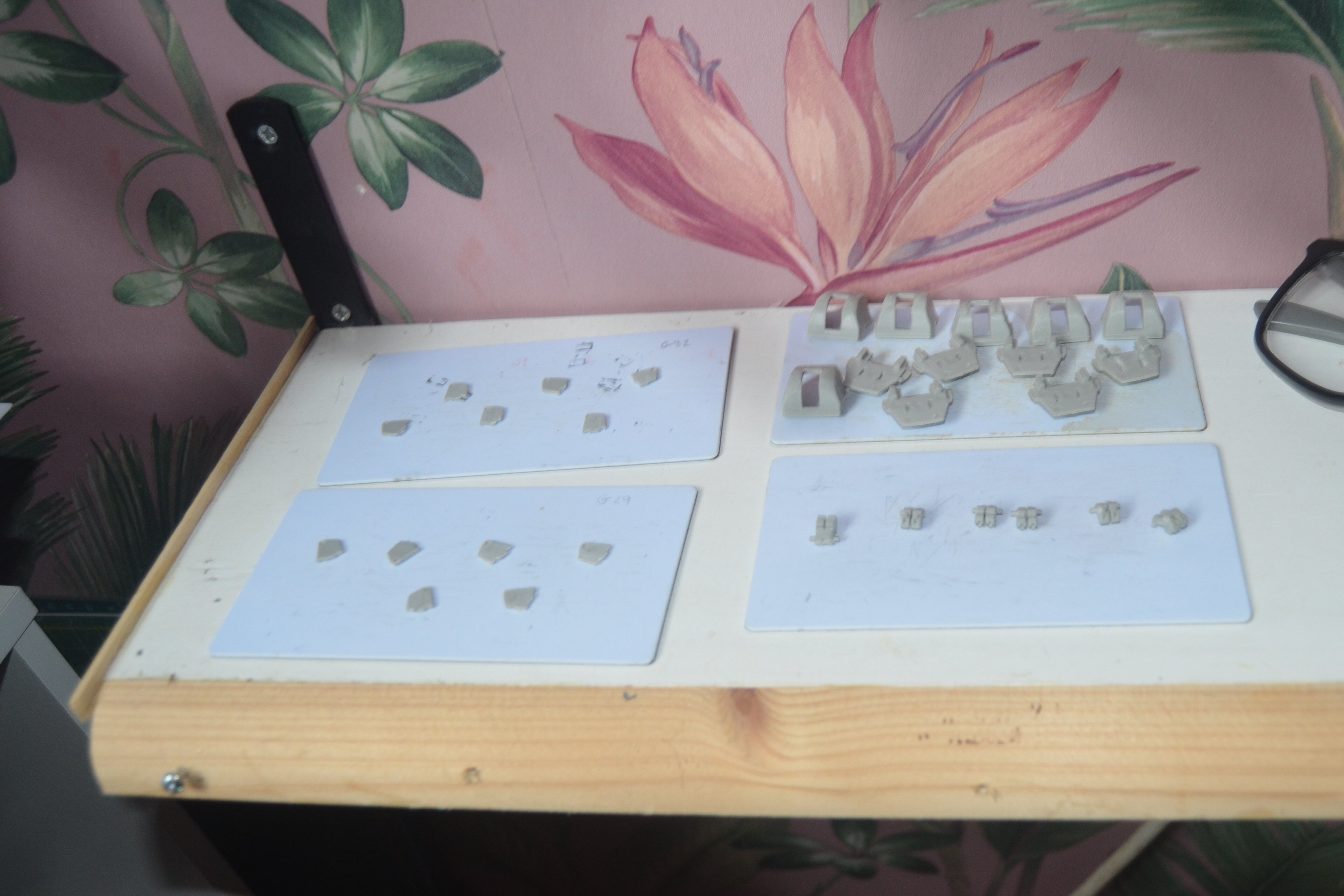

Work area pictures only
