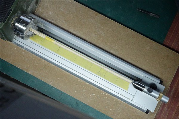

Tidying Loose Ends There seems to be a shortage of the particular colour (1712) of Gutterman cotton thread that I use for serving and seizing standing rigging. It has not been available in shops locally so while I wait for more supplies from that well-known on-line supplier, there’s some tidying up of the shrouds and the addition of the boomkins to keep me going. I check the tension of the shrouds, tightening the lanyards where necessary before tying hem off with a couple of rounds of thread. The shrouds themselves are finished of with a ‘seizing’ using the last remains of dark thread that I have: a simple clove hitch around the tail before trimming them. The boomkins are 3mm dowel tapered to 2.5mm on the lathe and a 2mmwide groove added at the end to accommodate the boomkin stays and the forecourse sheet block. A brass pin is glued in the end of the completed boomkins and located in the holes drilled in the bow. Stays are 0.5mm rope. I have 0.45 or 0.6mm. I prefer to go heavier and use 0.6mm. The 5mm single block is added to complete them David

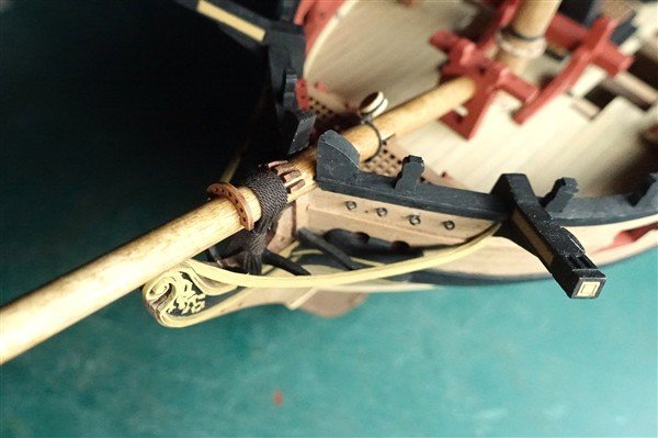

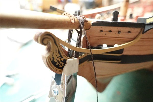

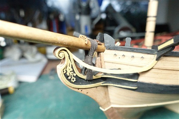

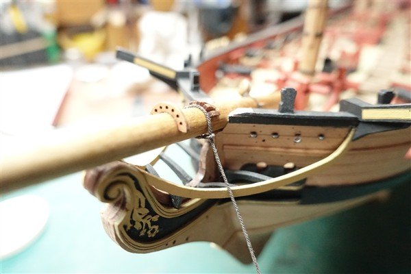

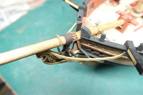

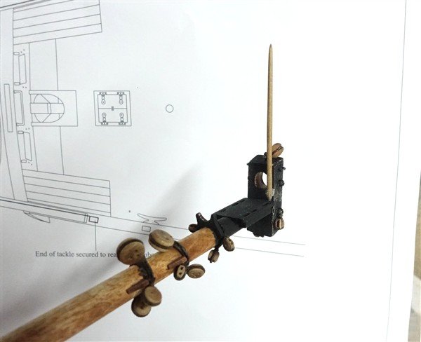

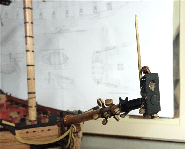

Completing the Bowsprit The cap has been cut to size. A groove is formed on the starboard side of the cap for the jack stay. The blocks and eyebolts are added to complete the cap. The cap and staff won’t be fixed in place until I’m ready to add the jib boom. With the blocks added and the jibboom made, I fix the bowsprit in place with the gammoning. I estimate how much rope I will need by making five wraps with some thread. It works out at about 1100mm so I cut 1200mm of 0.7mm rope to be sure. I begin by making an eye splice in one end and thread the other end through passing the resulting loop over the bowsprit. The eye sits on the port side. Wraps run forward on the ‘sprit and aft-wards through the gammoning slot, putting a twist in the wraps. Ten wraps fills the slot. In theory I should take ten frapping turns around the wraps but nine fills the space. Finally the end is seized to the first wrap using 0.1mm thread. I can now move on to rigging the lower masts, beginning with the tackle pendants. David
Bowsprit The maximum diameter of the bowsprit is at the bed: where it sits on the stem and according to Lee’s, is about the same as the main mast at the gun deck. I have settled for a compromise of just under 7mm with a taper to 6mm at the step and 5mm at the cap. I have temporarily removed the knightheads to sand back the hole for the bowsprit at the stem. The gammoning cleats, jib saddle and various cleats are added and then the variety of blocks and deadeyes. I have made bee blocks to go under the bees using some 2mm pear fret. First and most straightforward is the main preventer stay deadeye. I measure the length of rope needed to go around the deadeye and bowsprit and the required length is served. In reality I can serve three strops in one length on my machine. I’m using 0.4mm polyester thread served with Gutterman cotton. The deadeye is siezed in to the bight of served rope and the tails of unserved polyester are threaded into each other around the bowsprit to form a false splice. Each single or pair of blocks is secured in similar fashion (life is hard enough without attempting to fit more than two blocks on one strop). Jibboom The inner part of the jibboom up to the cap is an octagonal section. I used an 8mm dowel which I first planed square and then formed the octagonal. After further planing and sanding, the round section taper was finished on the lathe. This basic form of the jibboom is now used to check the measurements for the bowsprit cap. Bowsprit Cap The cap is scratched from some spare 4mm pear wood. I have made it 20 x 10mm: wide enough to accommodate the flying jib and jack staff. The holes for bowsprit and jibboom are formed at an angle so that the cap sits at right angles to the waterline. The cap will be cut to final size with top and bottom cut to follow the angle of the bowsprit before adding eyebolts and blocks. David

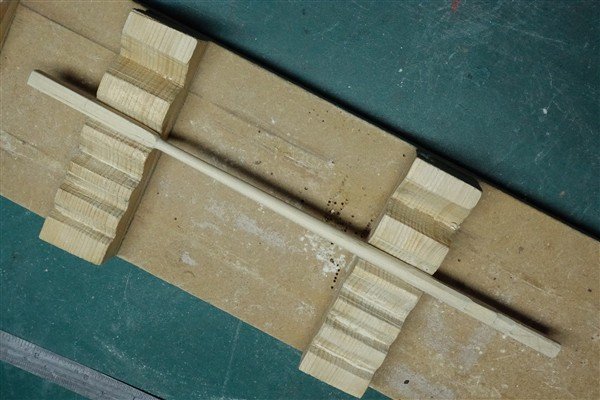

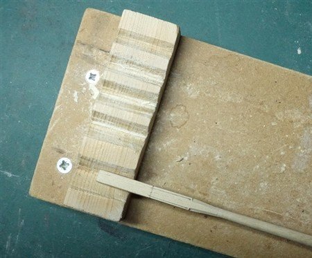

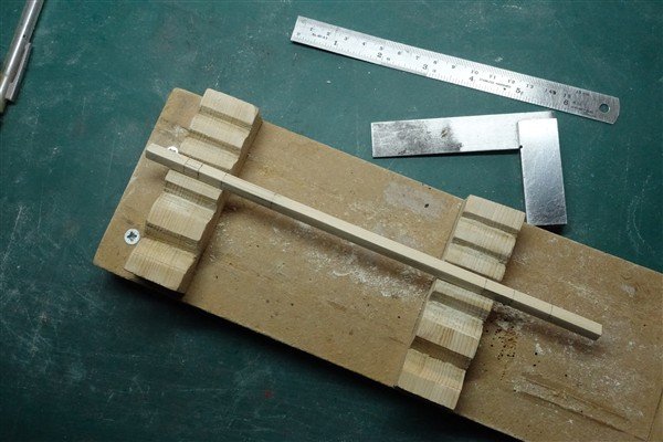

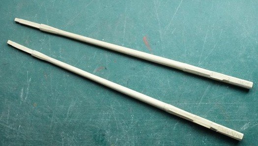

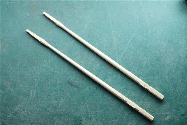

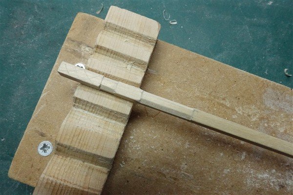

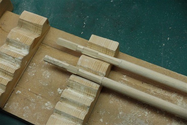

Topmasts The plans are a simplification of the base of the mast with no block or octagonal sections and I redrew them to the proportions given in Lee’s. I start with 8mm ramin dowel and squared off the section between main mast top and cap at 6mm and then cut the octagonal sections using the 7:10:7 rule. This done, I use my lathe to reduce the main part of the mast to 6mm and then taper to 4mm at the hounds. I wasn't happy with the results, especially the main topmast so decided to remake them using a different route. I began with the same 8mm dowel but using a plane and sanding sticks, made the entire length 6mm square. I marked out the octagonal and square sections of the block and heeling using the 7:10:7 rule and cut the octagonal sections with chisel and sanding stick. It's difficult to measure such small faces accurately and the diagonal was coming out oversized. The face of a 6mm octagon is 2.48. I set this on my calipers and score down the partially cut diagonal faces and then sand back to the correct width. I cut the hounds into a square section of 4mm at the base increasing to 6mm at the beginning of the head. The bulk of the mast is prepared for the lathe by roughly sanding it from square to octagon and then to a hexadecagon before finally sanding it round on the lathe. The hounds are finished to an octagonal cross section as before and the head cut square with a taper from 4 to 3.5mm at the cap. Finally the cap tenon is cut at 3mm square. It's left slightly long to allow for the final trimming. I have marked the rough positions of the fid and also the top and bottom top rope sheaves. I'll remove the waste wood at the base of the masts after these have been cut. This is much longer process than trying to work with a round section but I’m much happier with the results. With a bit of extra work, my previous efforts might serve as spare masts on the deck. David
