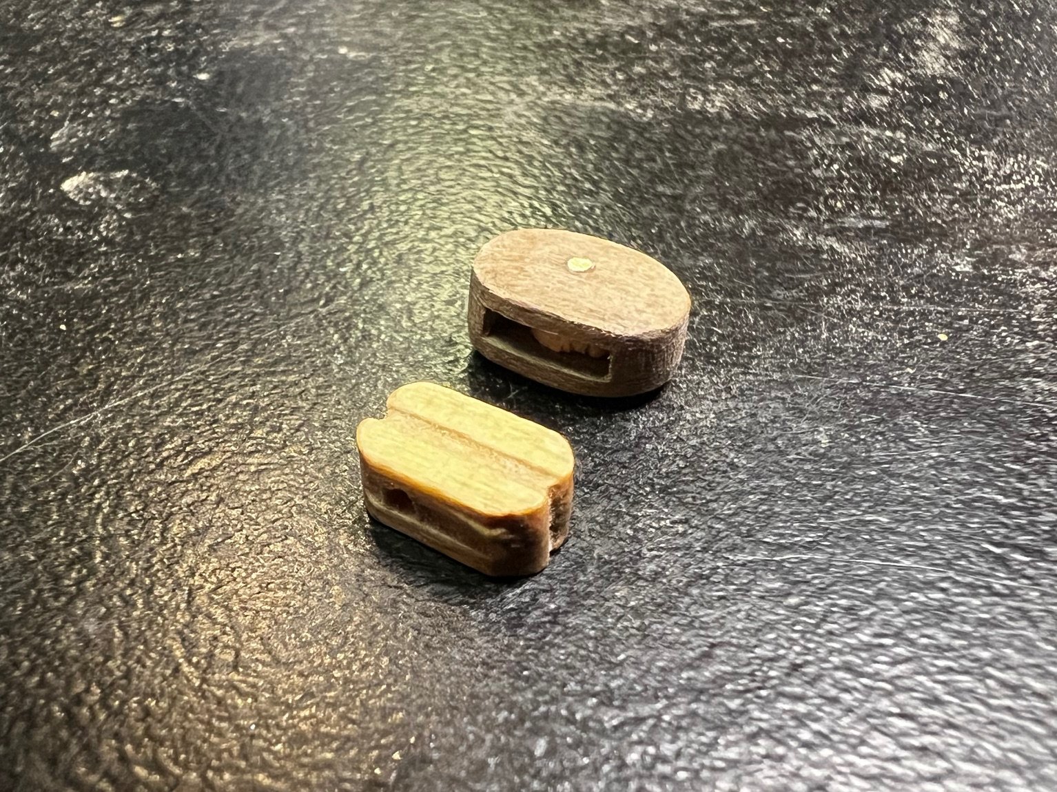

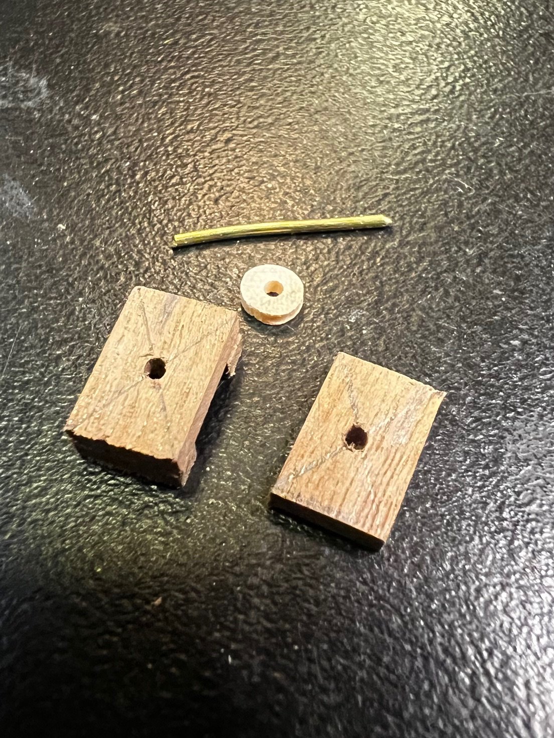

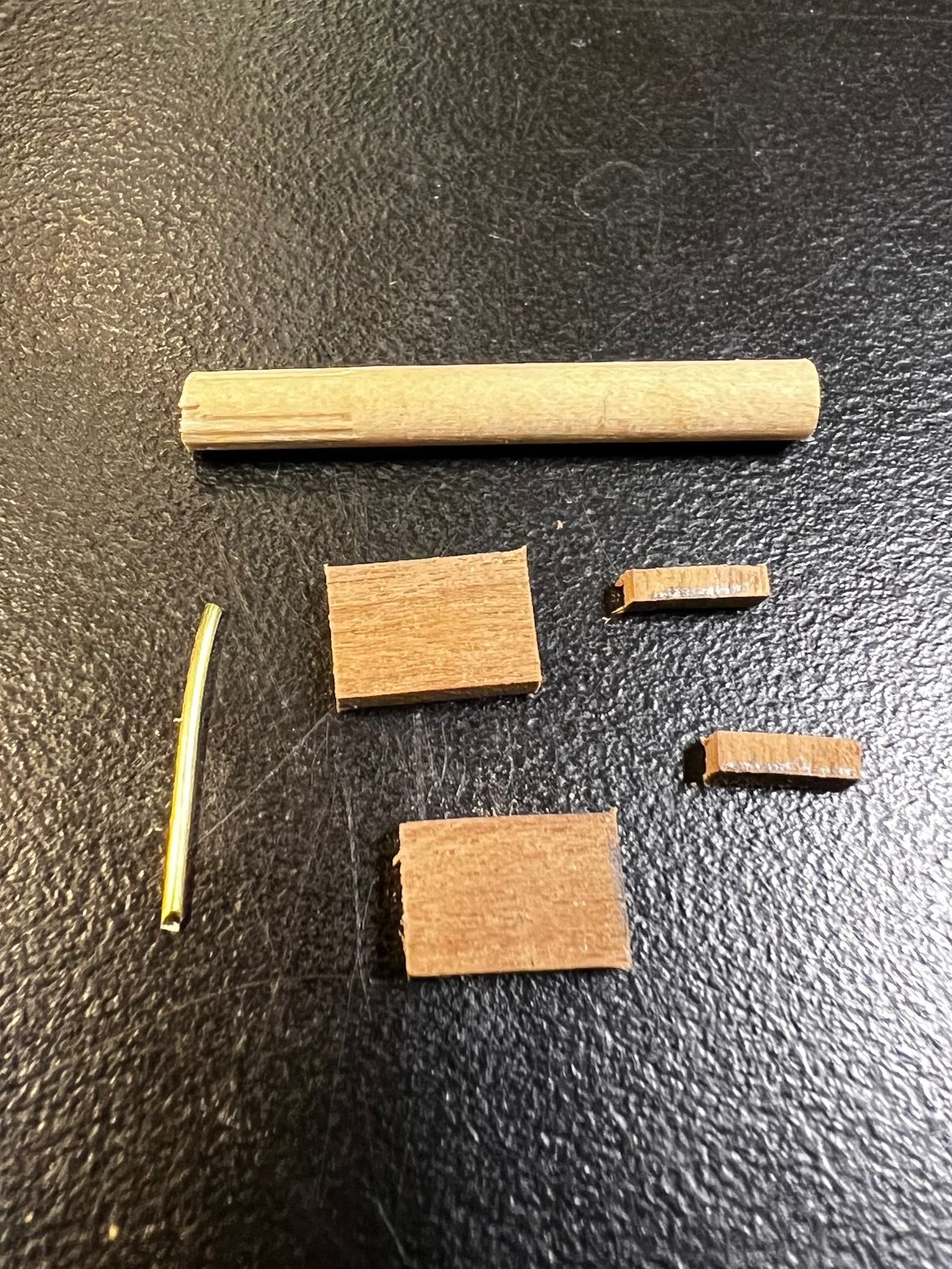

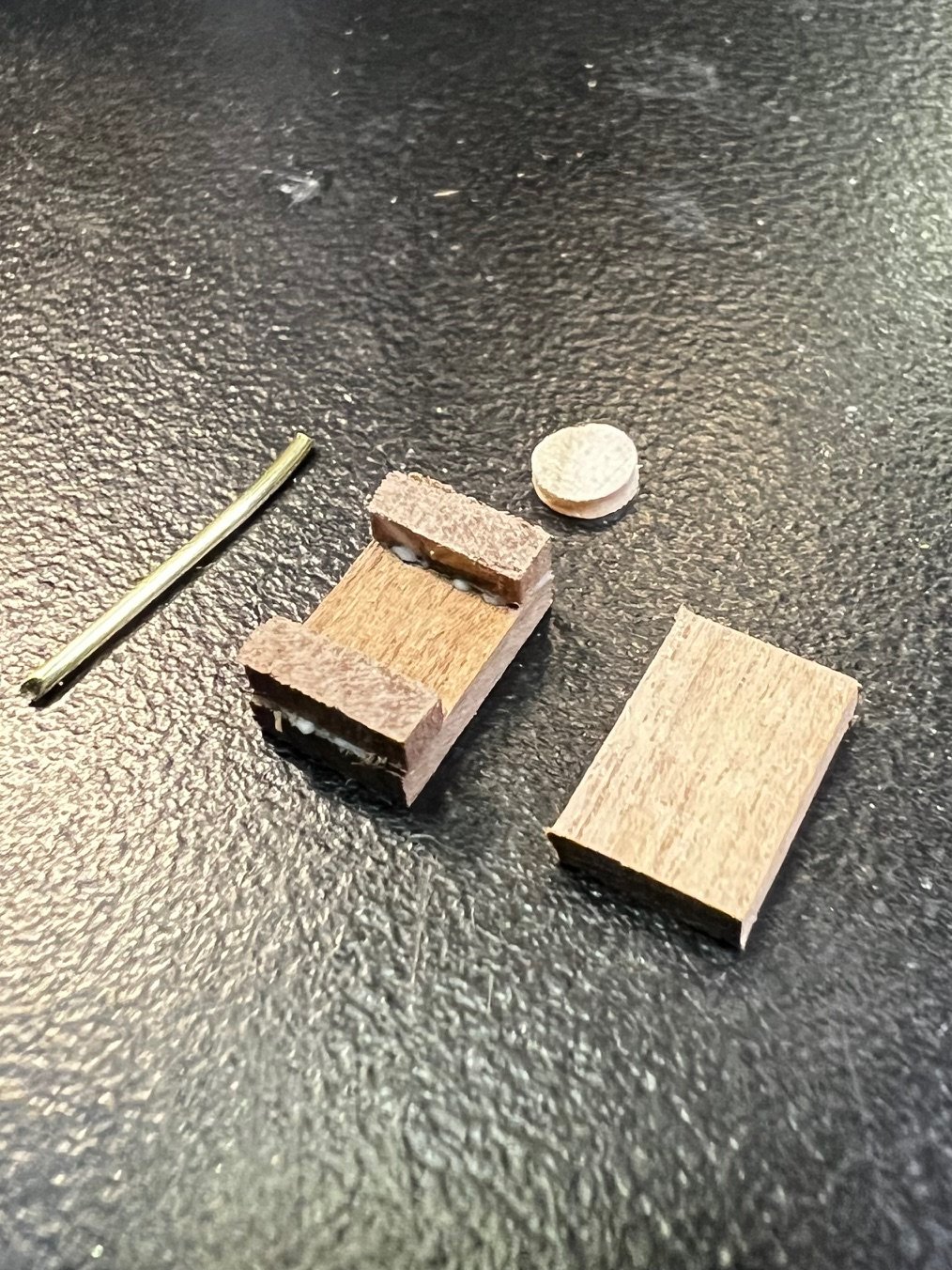

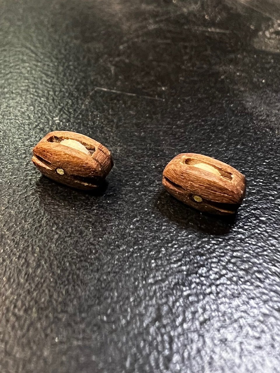

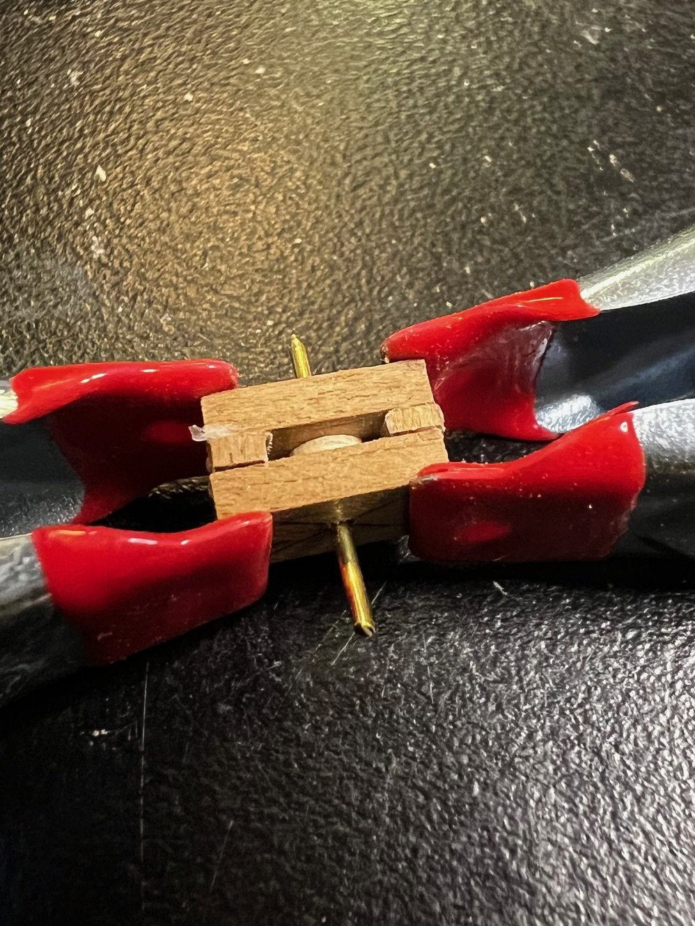

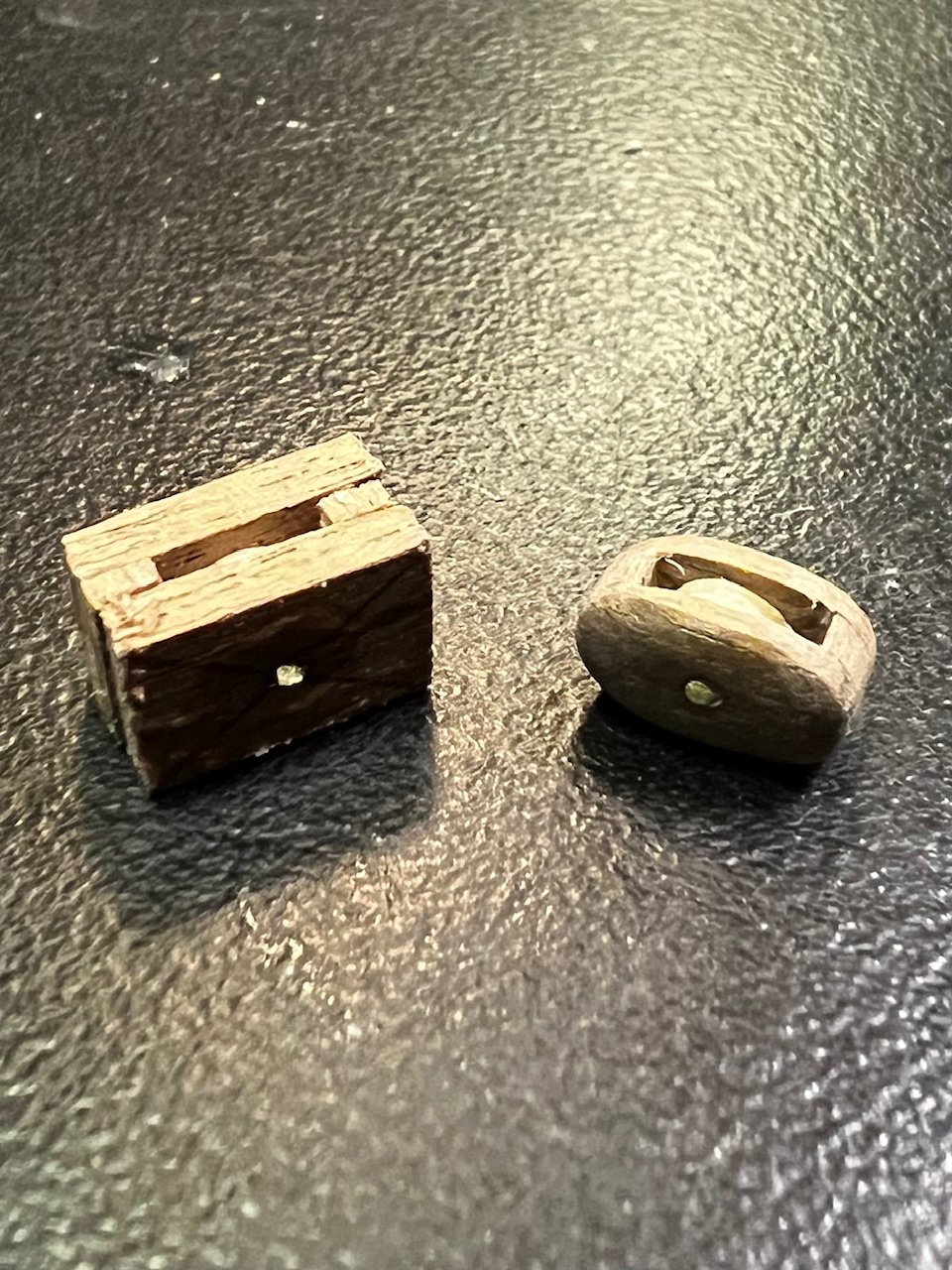

  1. I wanted to try making functional single sheave blocks to replace the supplied blocks. The following pictures are my process.

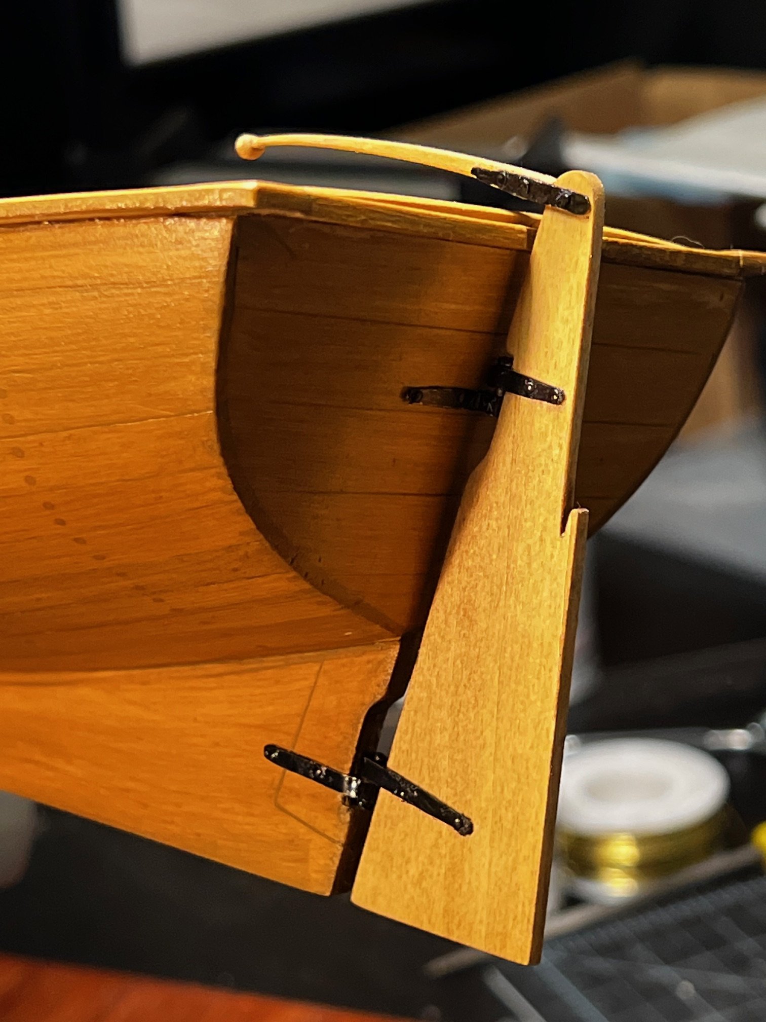

  2. Rudder and tiller are installed. I used a scribe to mark hole locations and a Dremel to drill. The parts were attached with short pins and final coat of black paint.

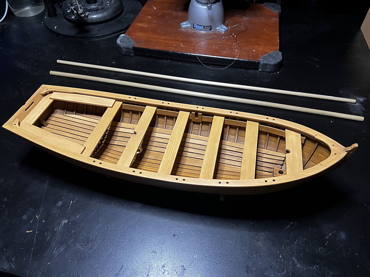

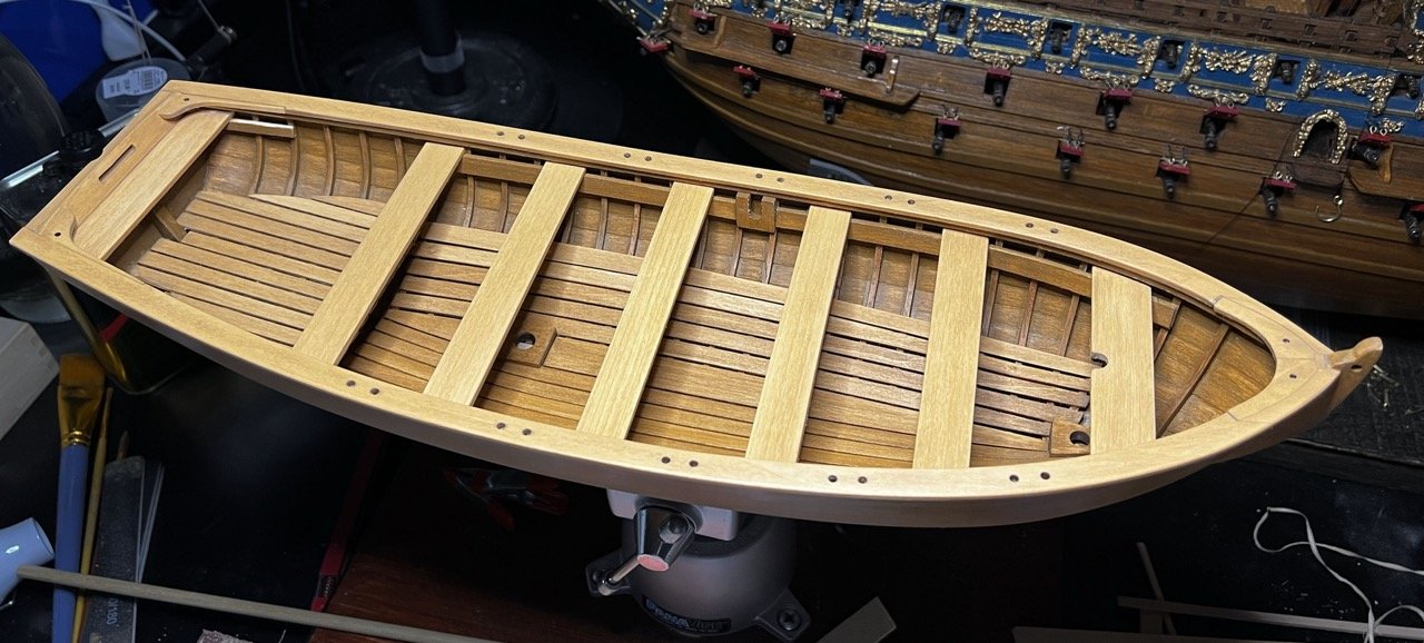

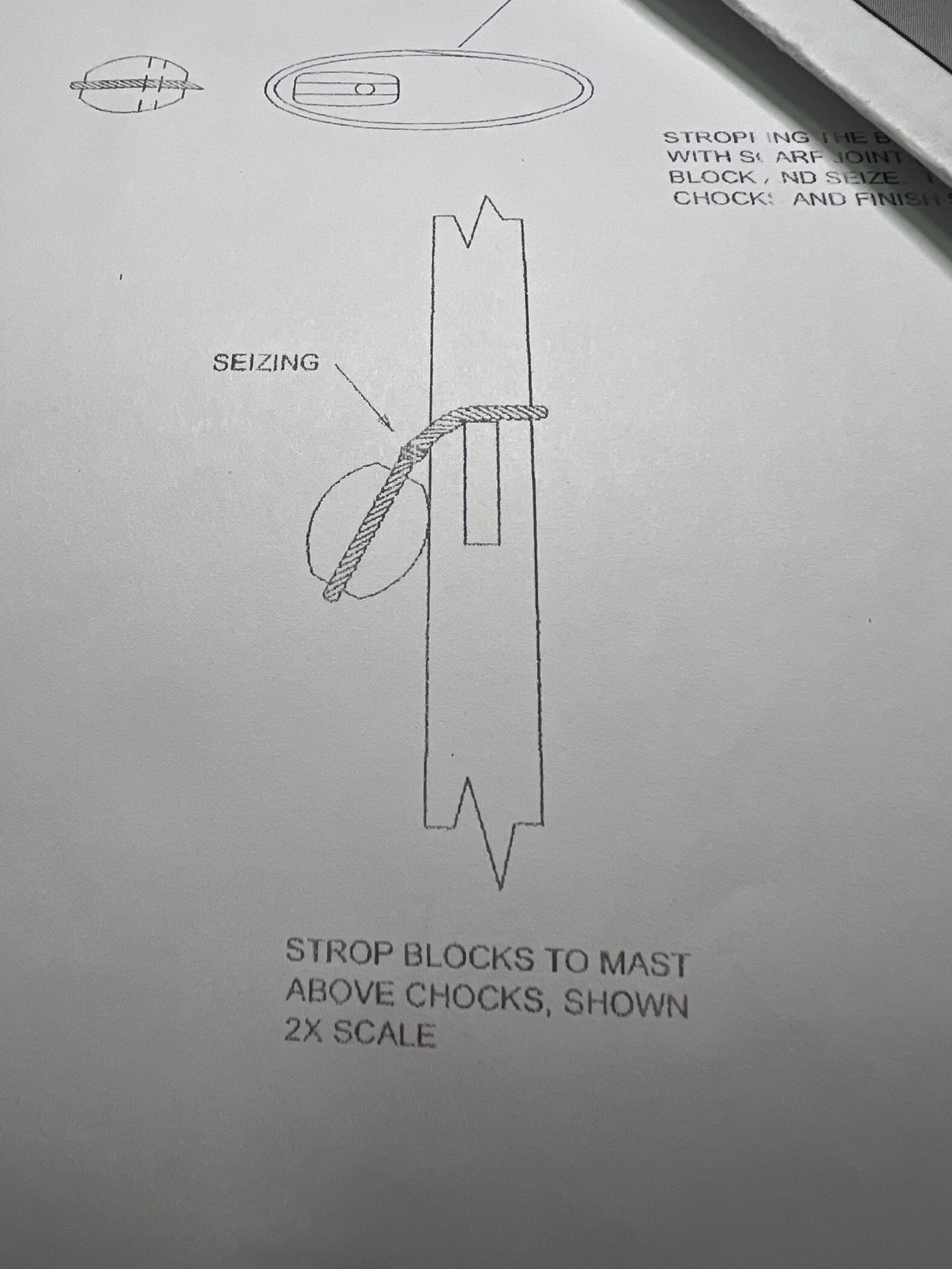

  3. Not that there aren’t belaying points but their location. I have seen a few discussions and a few examples that gave me enough pause to do more research. I believe that the full size replica in Norfolk has no holes in the thwarts.
  4. In thinking ahead, I need to do some research on how to handle the rigging. I didn't drill holes in my thwarts to add belaying pins because I thought I had read somewhere that this would not have been used on the real boat. Am I correct or not? And if so, would anyone be able to point me in the right direction for proper rigging attachment points?
  5. I installed the thole pins and mast partners. These parts were straight forward, not much to add regarding the work. I also decided that the decking was too similar of a color to the thwarts so I added a darker gel stain to get more of a contrast.

  7. Thwarts- Mast cutout added, clear finished, and glued in place. Before I move on, the next big step was cleaning up my work area. It gets cluttered quickly.
  8. I made new thwarts to fit the slightly wider hull. More to do, but I roughly placed them to compare the stain color to the rest of the boat. I'll add the cutout for the rear mast and clear finish them.
