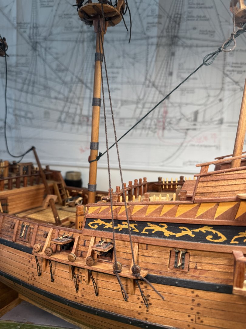

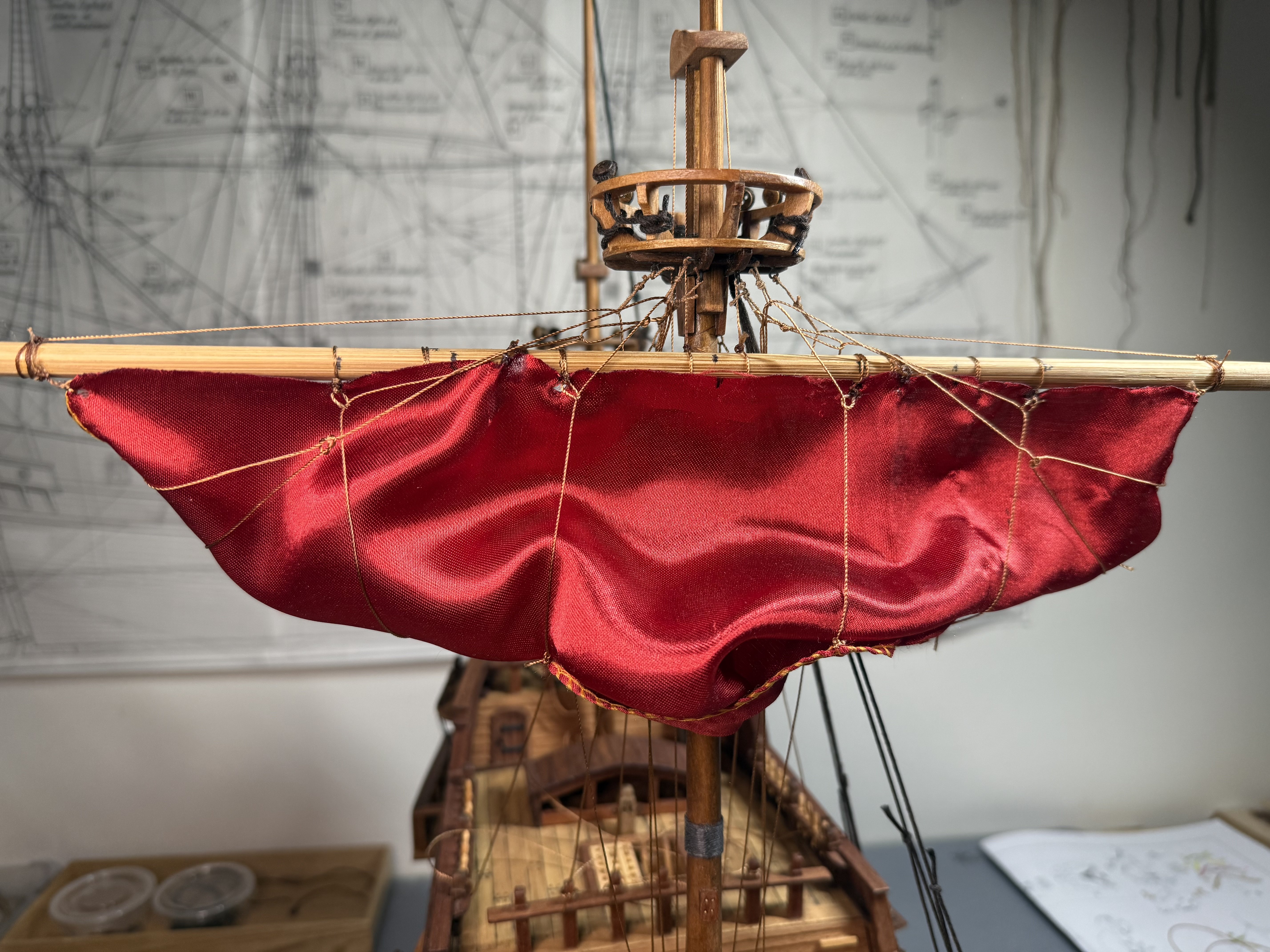

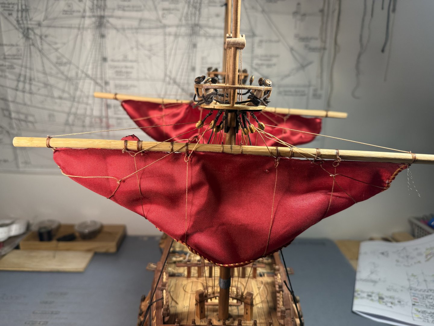

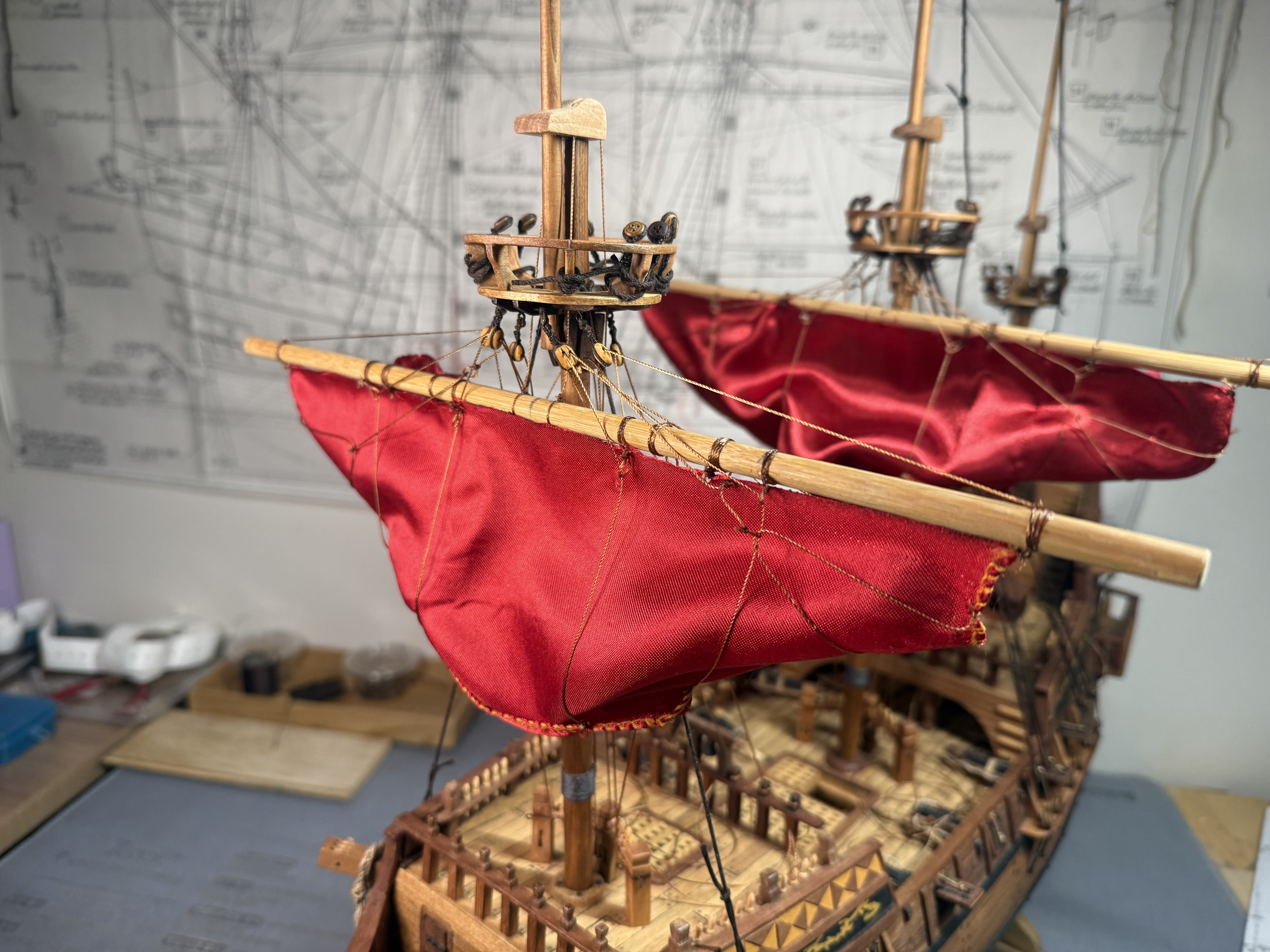

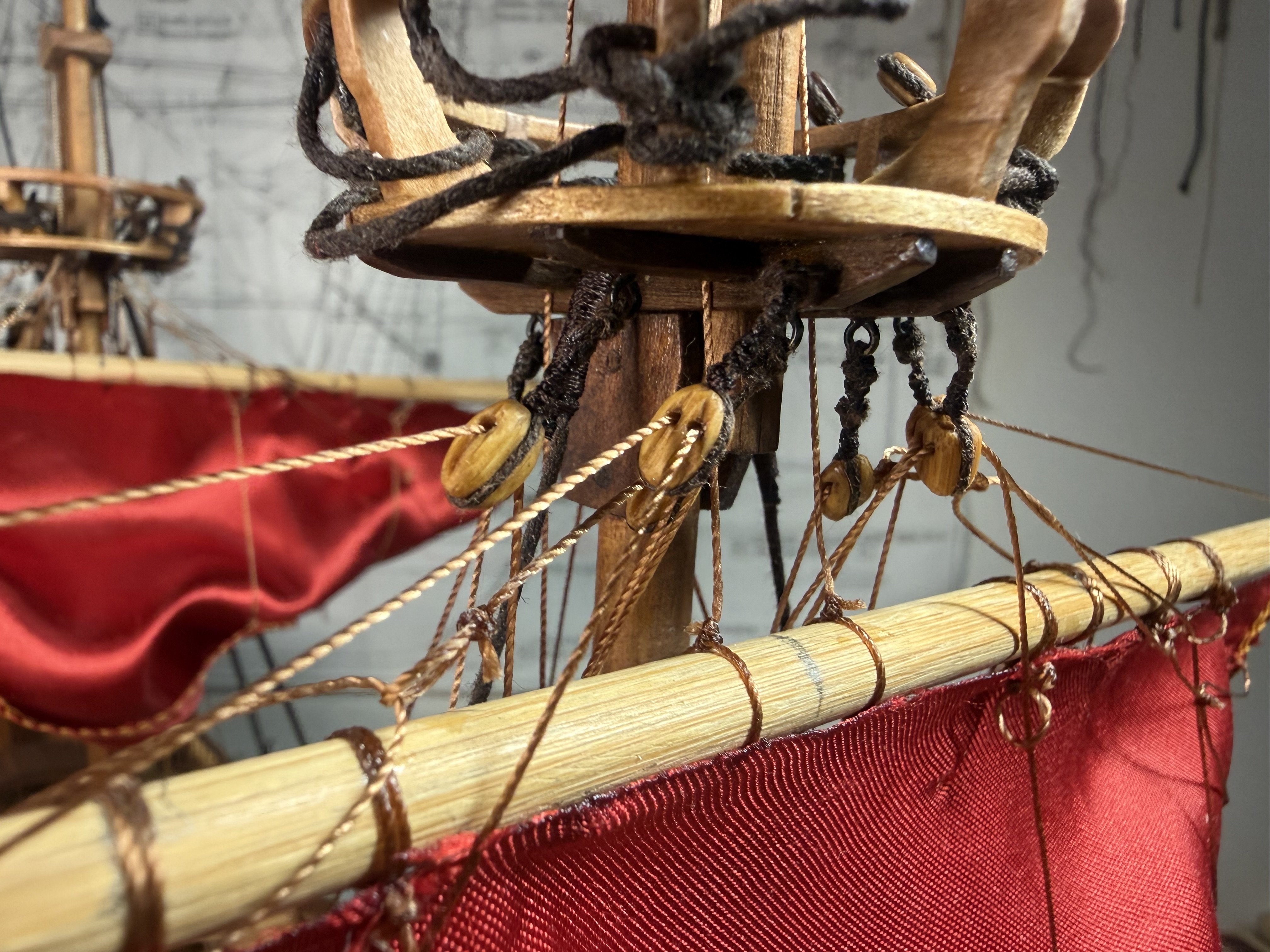

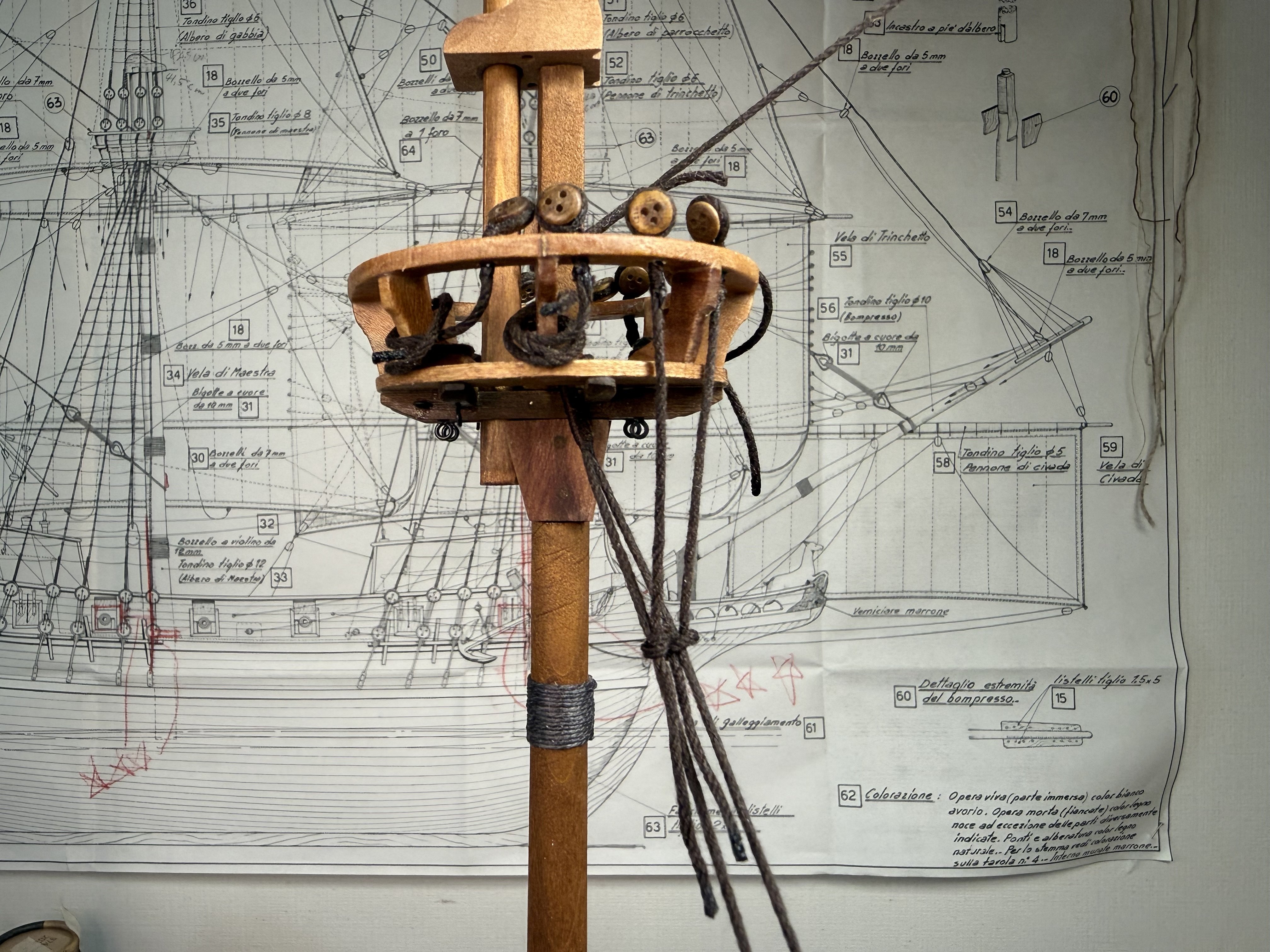

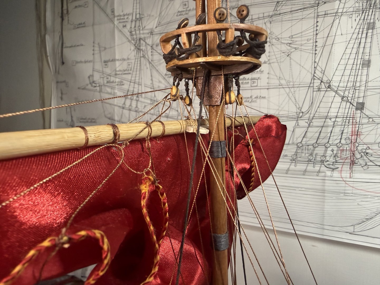

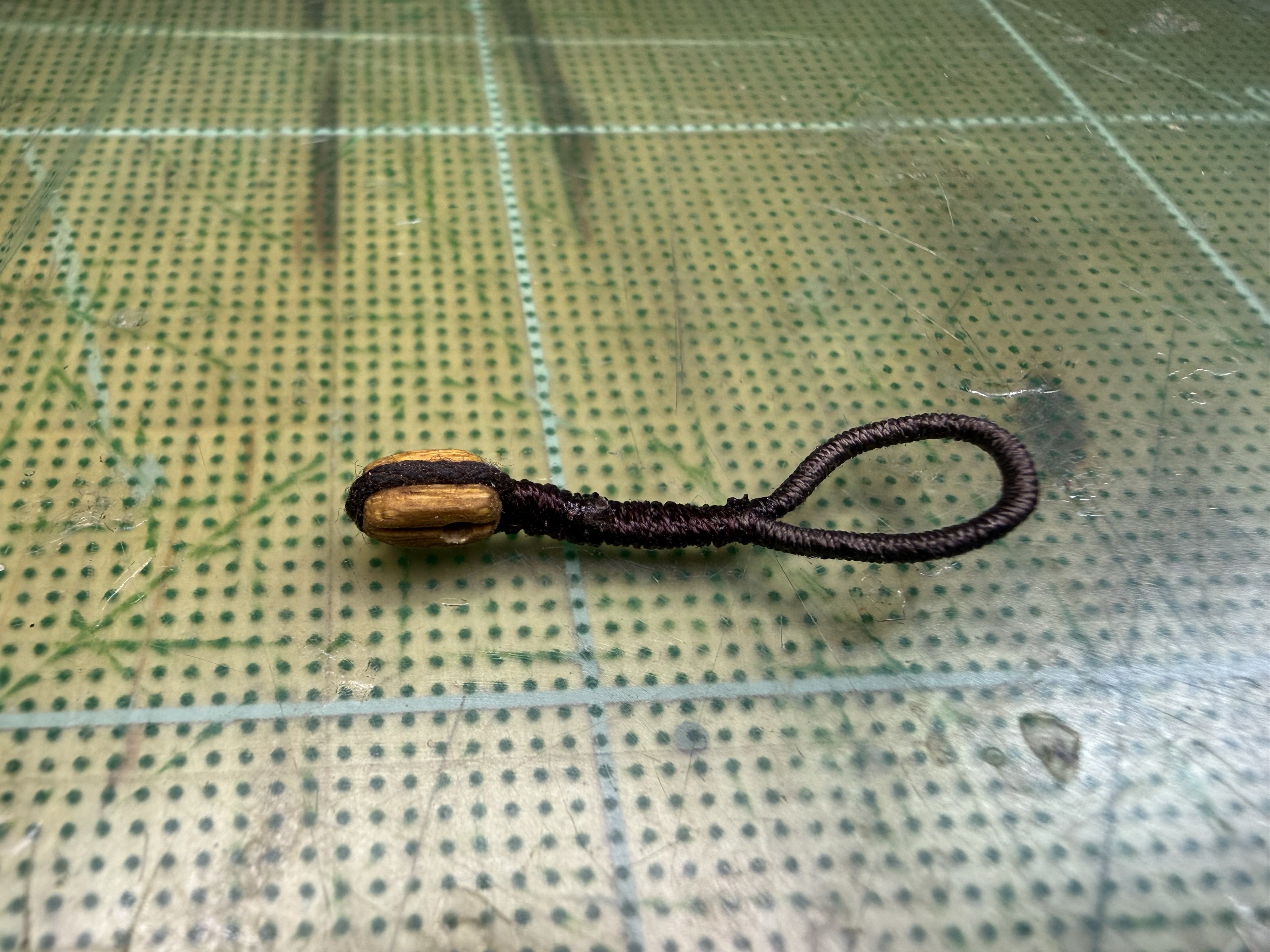

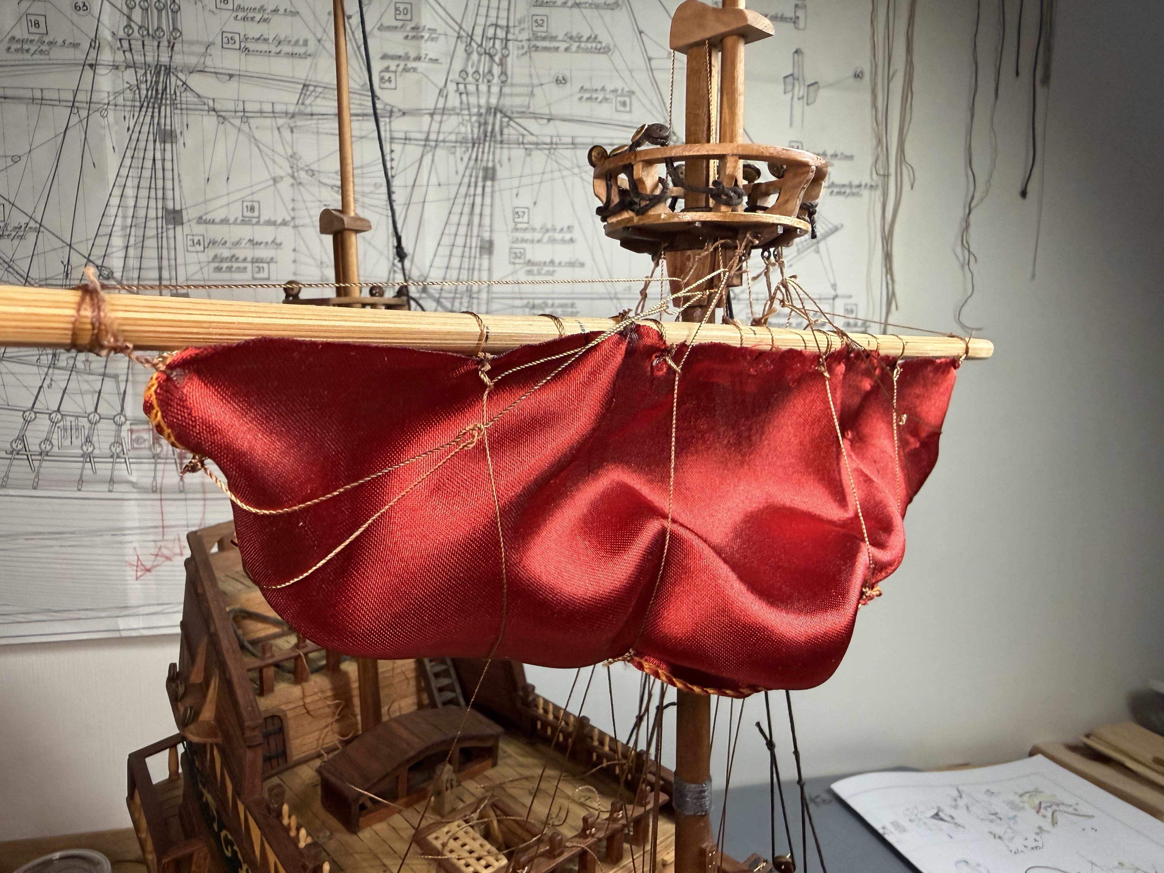

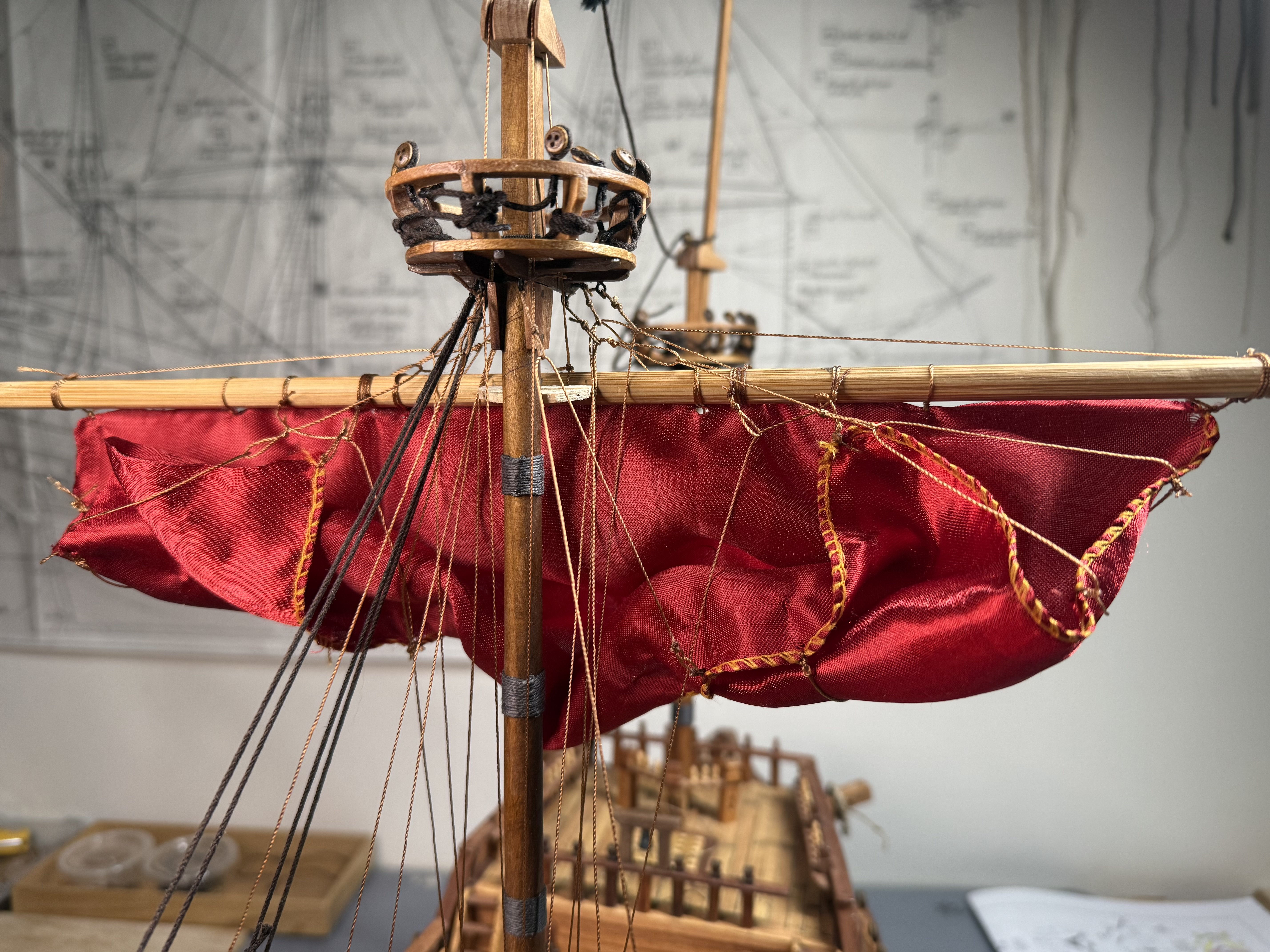

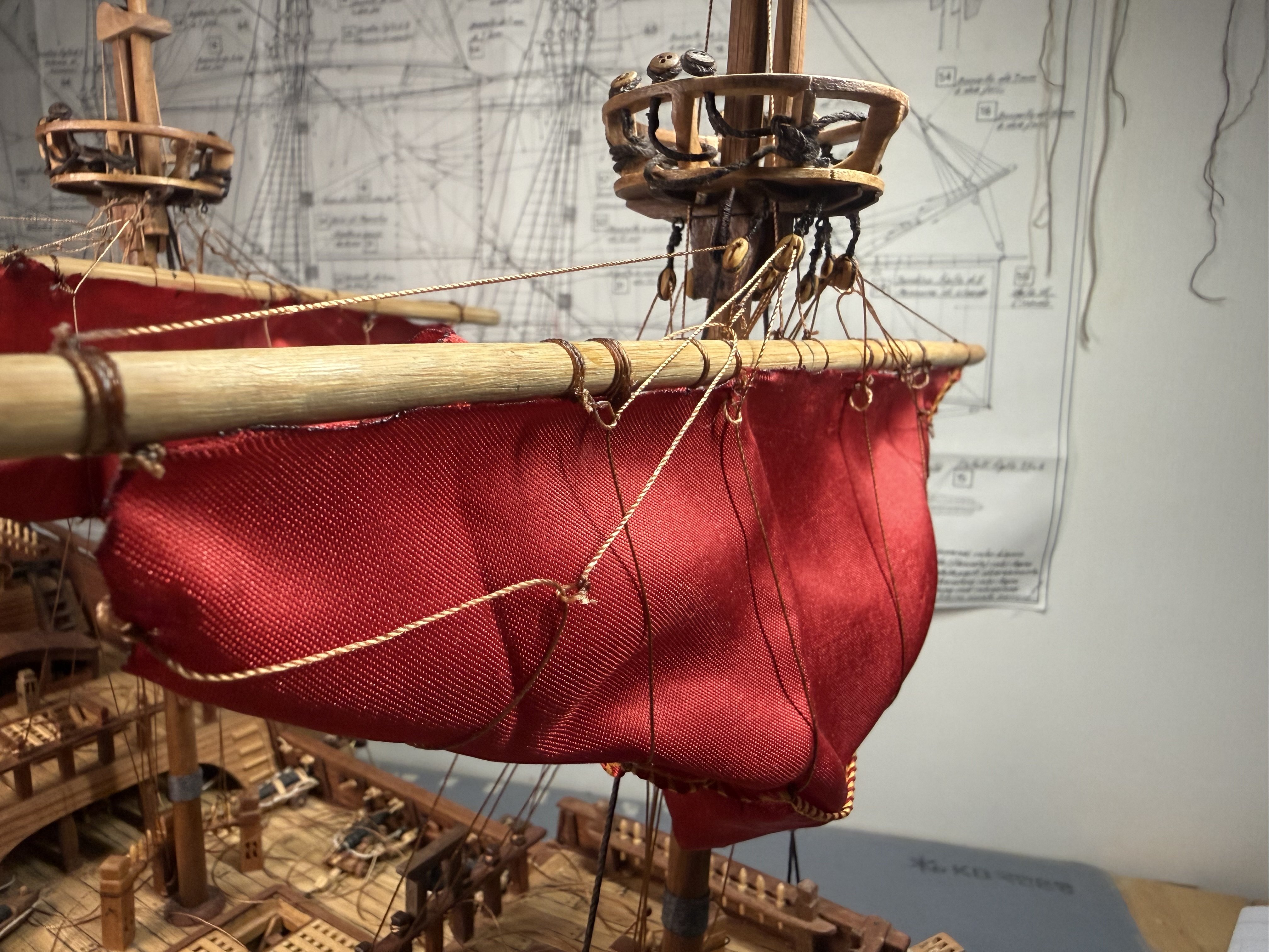

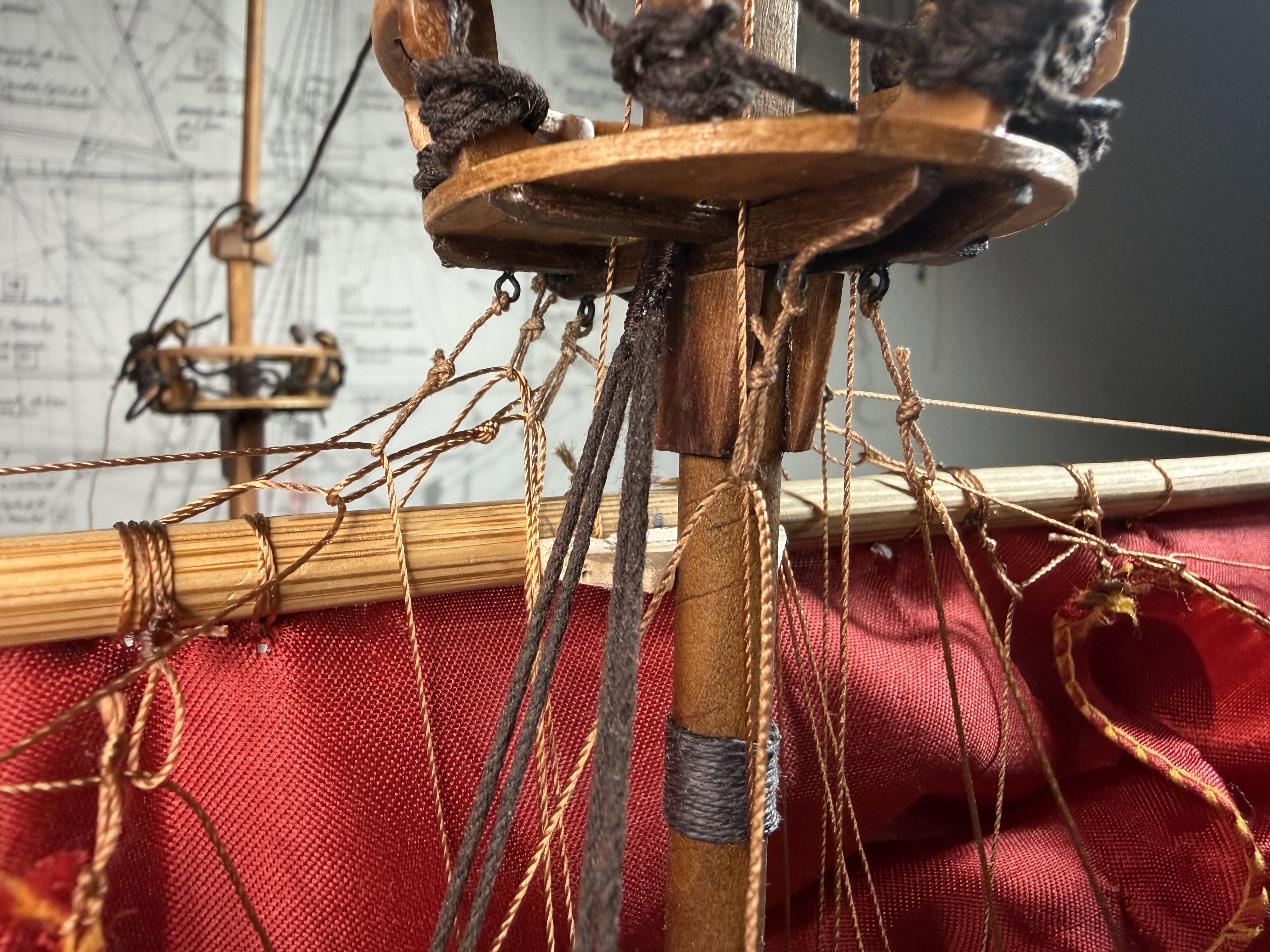

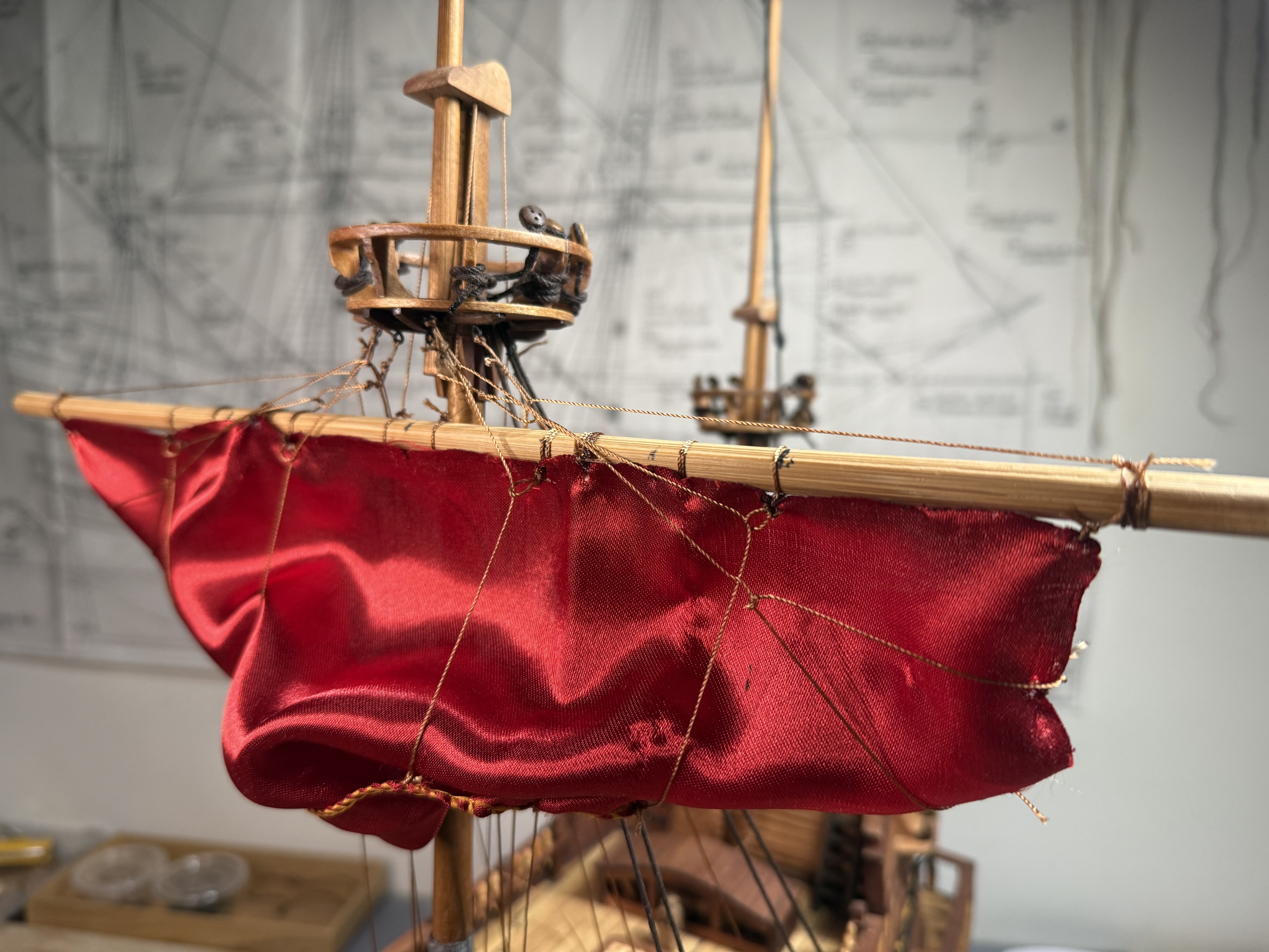

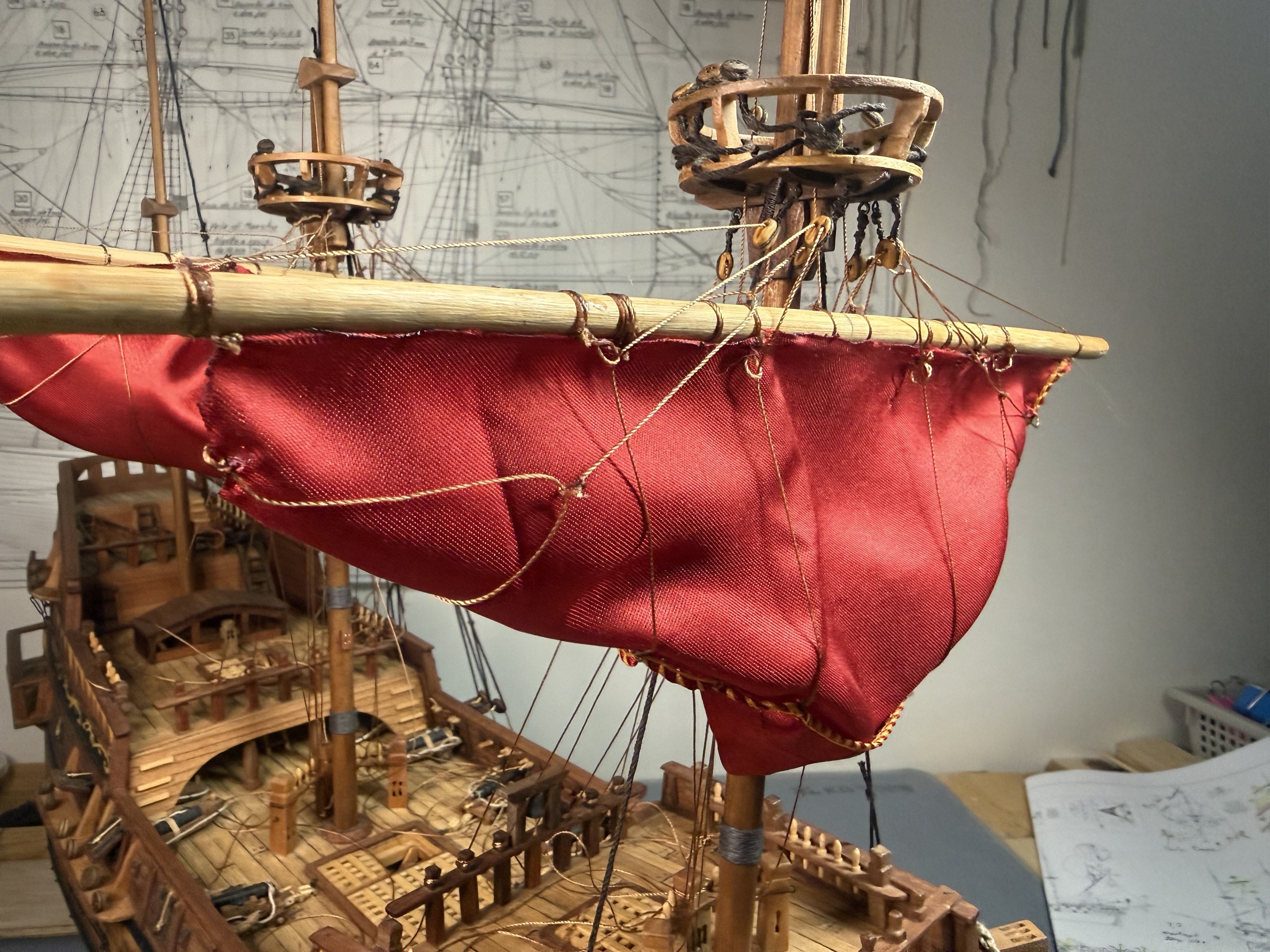

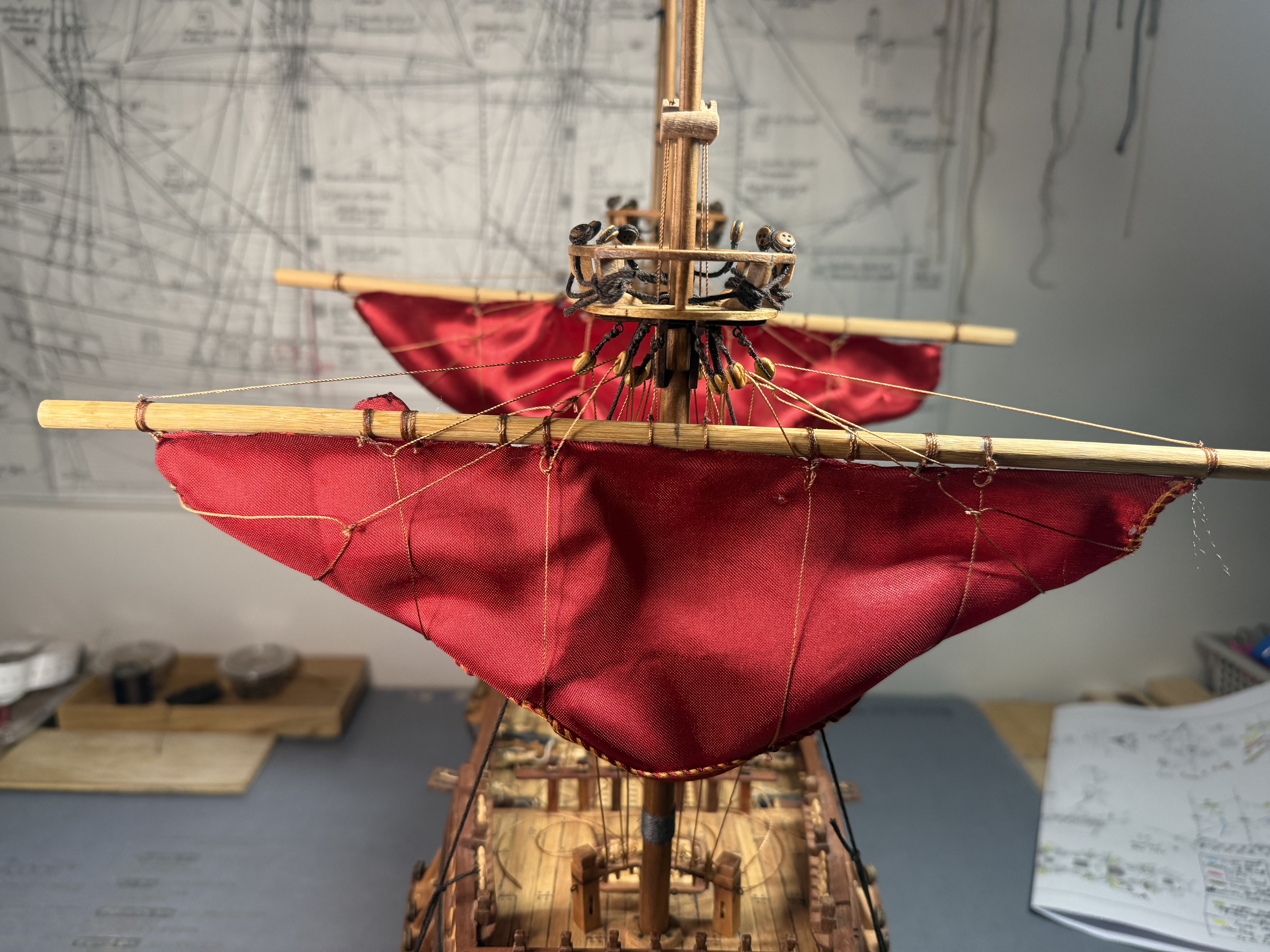

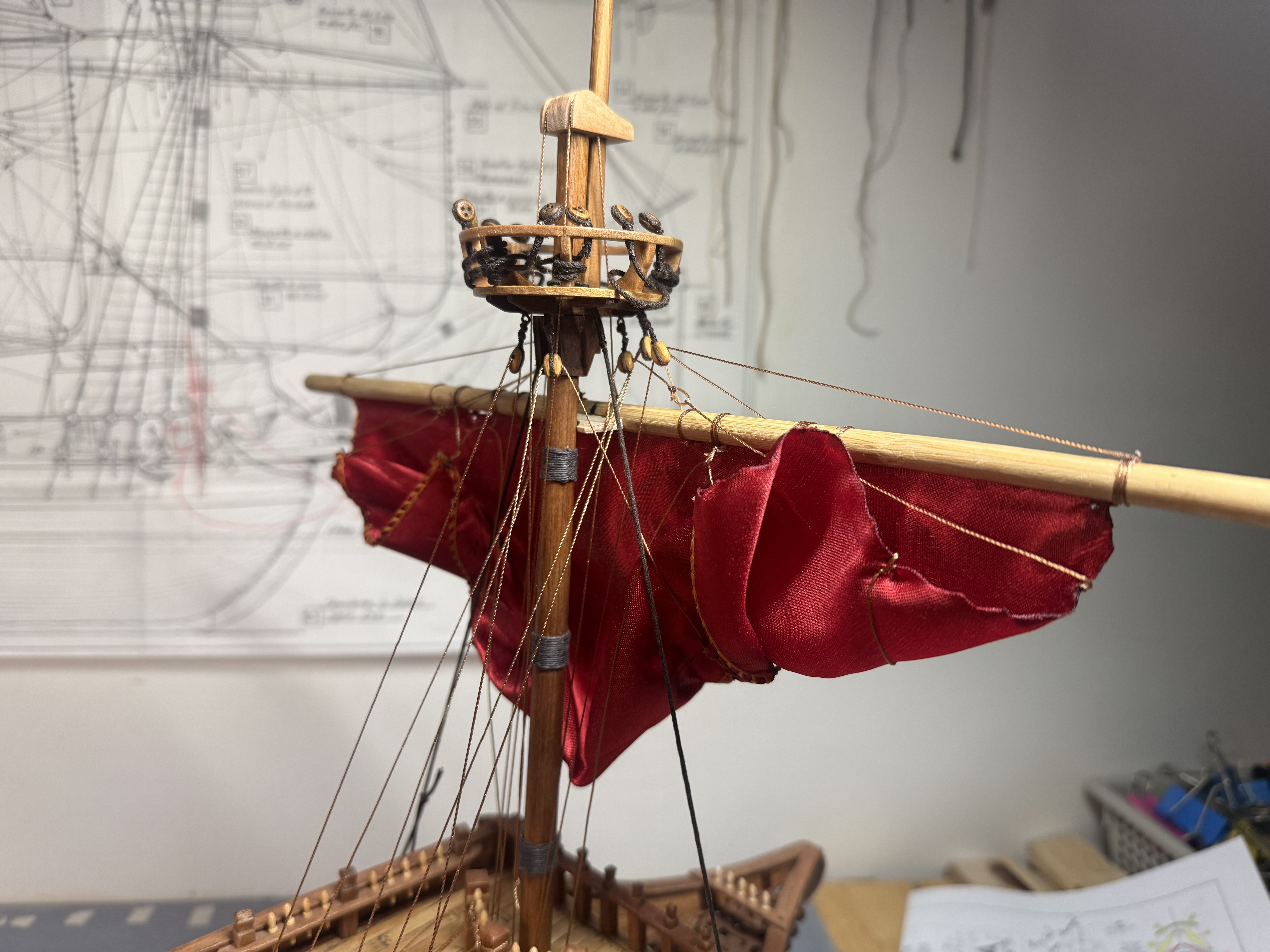

  2. Lastly, I decided to go through a dry run of rigging on main sail and fore main sail as the Aeropicola plans do not provide much rigging details. I did substantial research on this through internet and YouTube - quite helpful. However, regarding the belaying positions on the deck level, I had to combine my common sense (or imagination) with the belaying plans of my previous build (Corel Endeavor). Forgive my choice of using red colored material for the dry run sheets. This red Korean traditional silk fabric was the most similar material (in terms of thickness and softness) to the ultra thin cotton fabric that I intend to use for the actual sheets. Below are the pictures of main sheet trial without blocks (with just temporary threads in place of actual blocks). Initial proof of concept on main sheet done and moving on to fore main sail dry run, this time with blocks attached. As you can see from below pictures, I employed two buntlines that run through single blocks (here represented by thread loops) attached on the yard, and passing through double blocks attached underneath the crow's nest. I also applied a slab line (at the point between the two buntline positions) on the back side of the sheet, running directly through a single block beneath the crow's nest (on the stern side). Which is then belayed to the rail behind. Let me know if this method should be reconsidered for a better and more historically accurate one. That's all for this update!

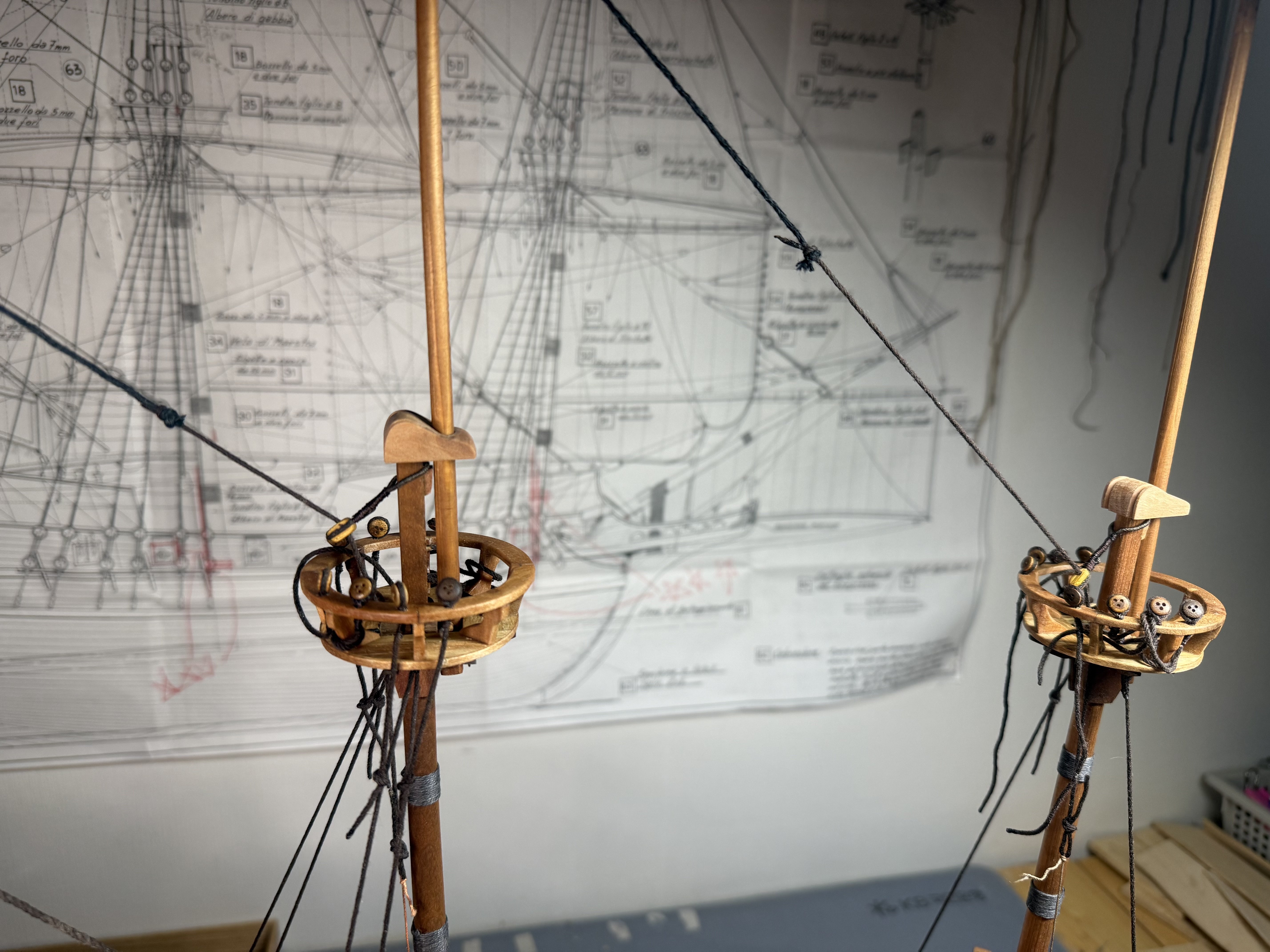

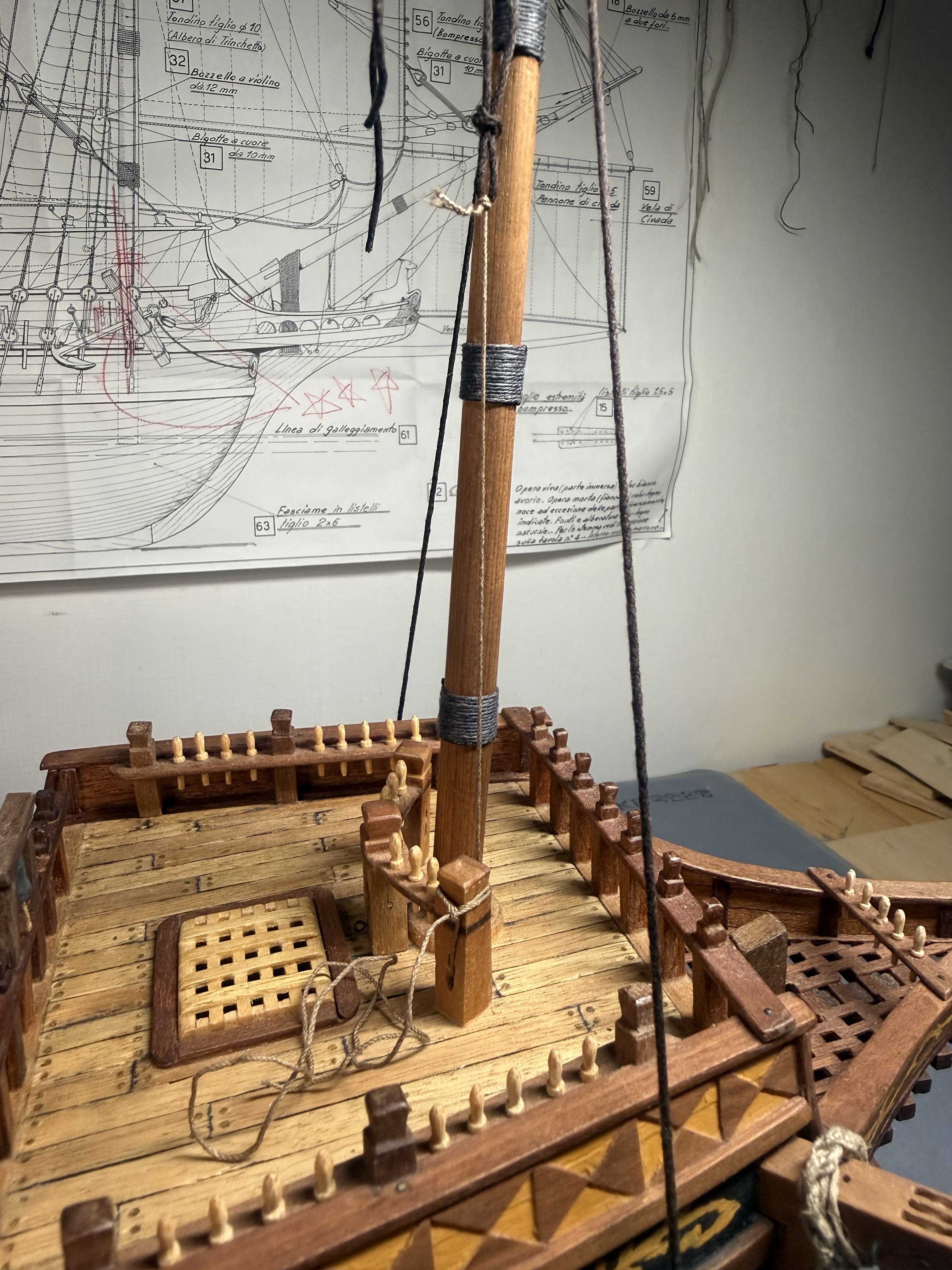

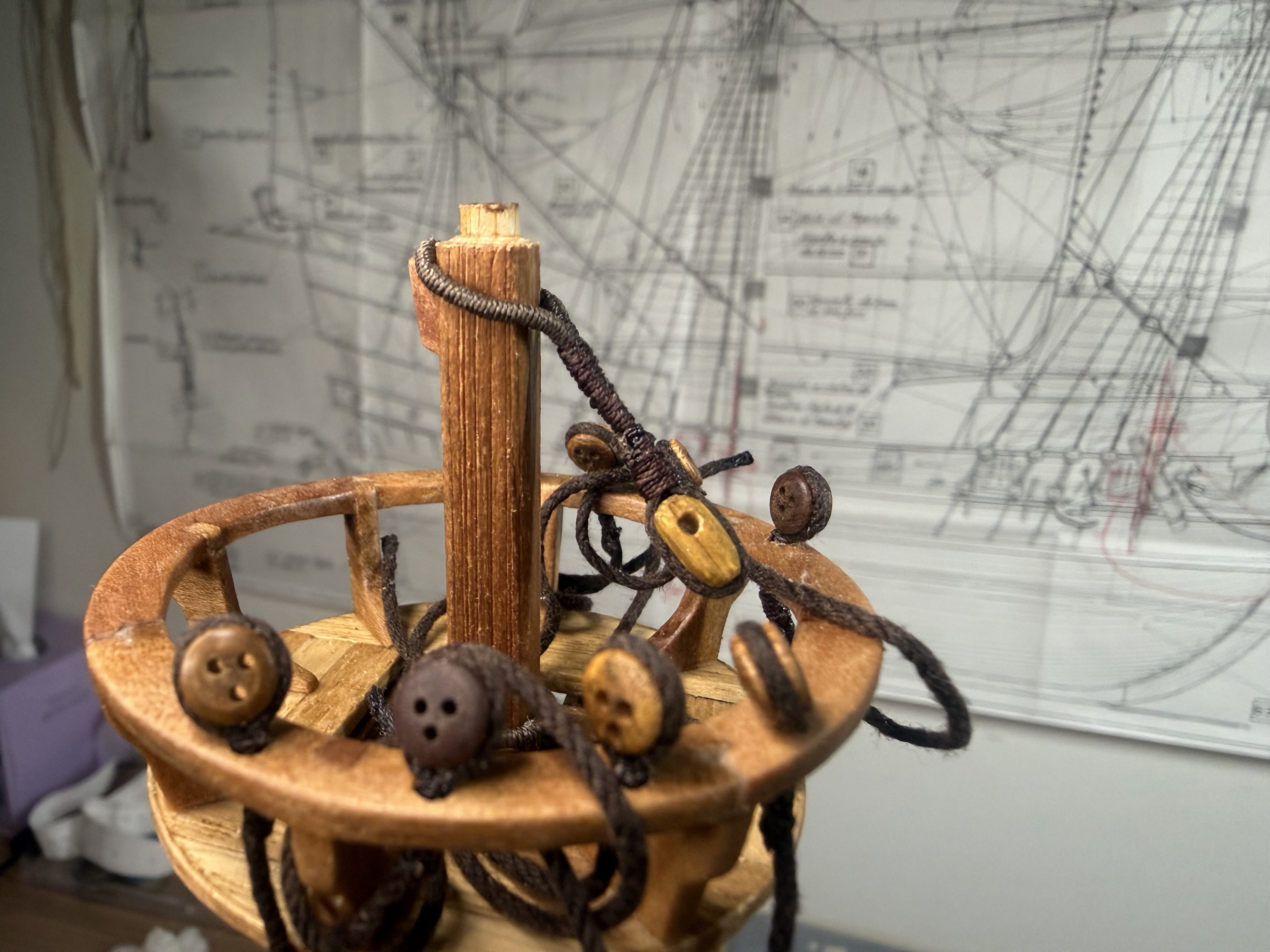

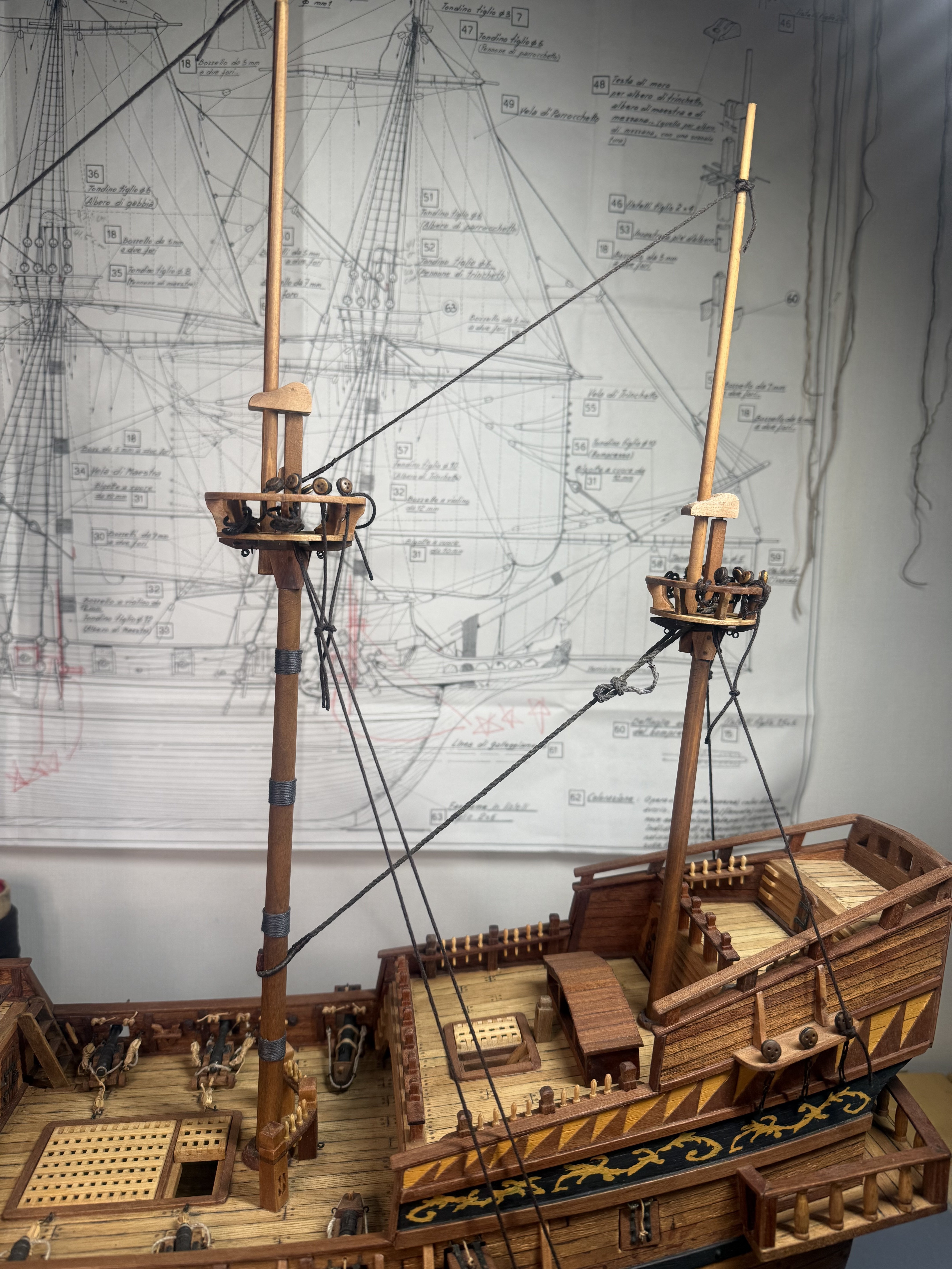

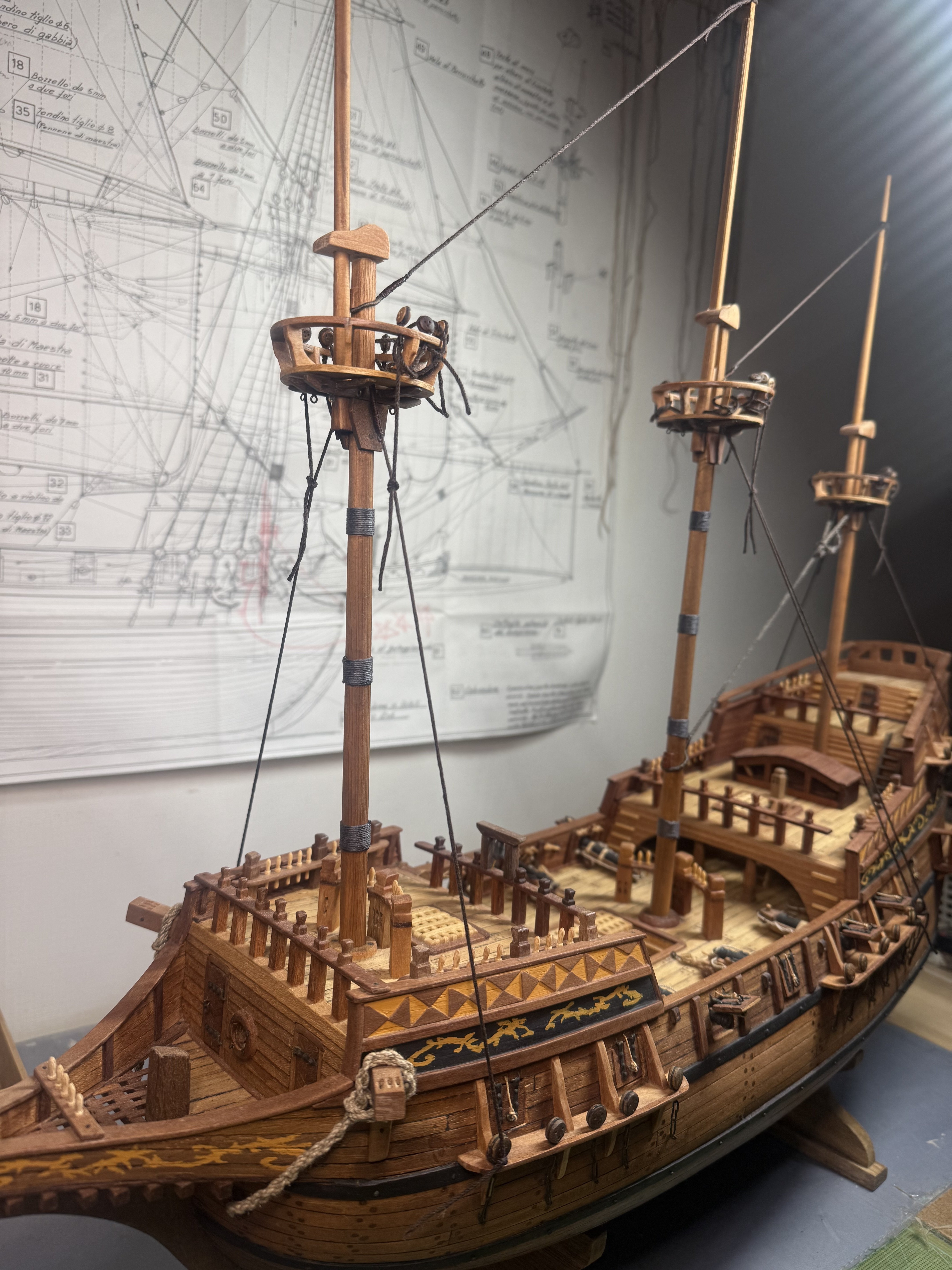

  3. Continuing with the shroud and stay try-outs. I decided to deviate from Aeropicola’s topmast stay related plans as they do not seem reasonable. For this change, I had to reshape and rearrange the topmast stay stoppers. Below are the pictures related to these work streams. Some more testing and try-outs on shrouds as below. Repeating these try-outs with GH2 as well.

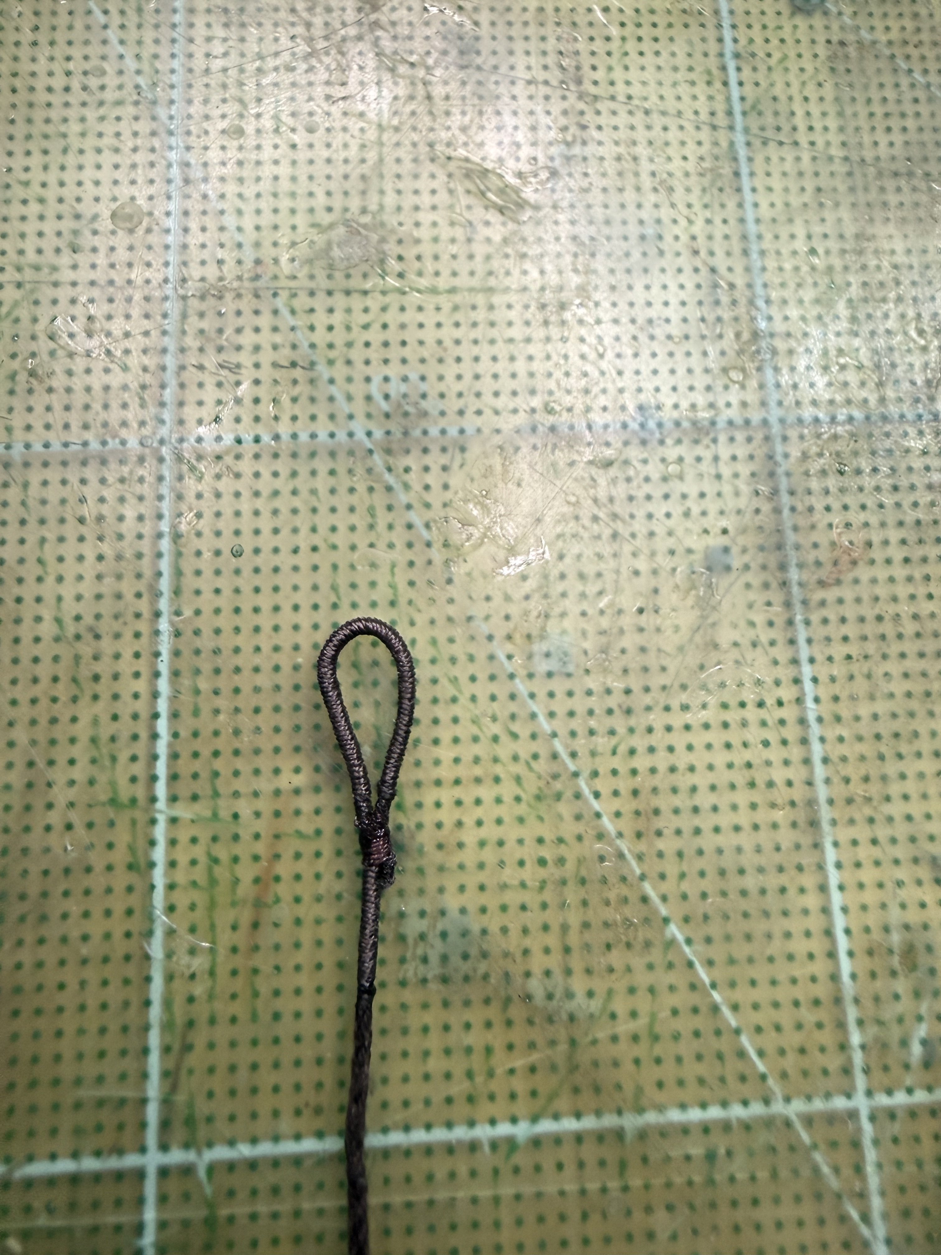

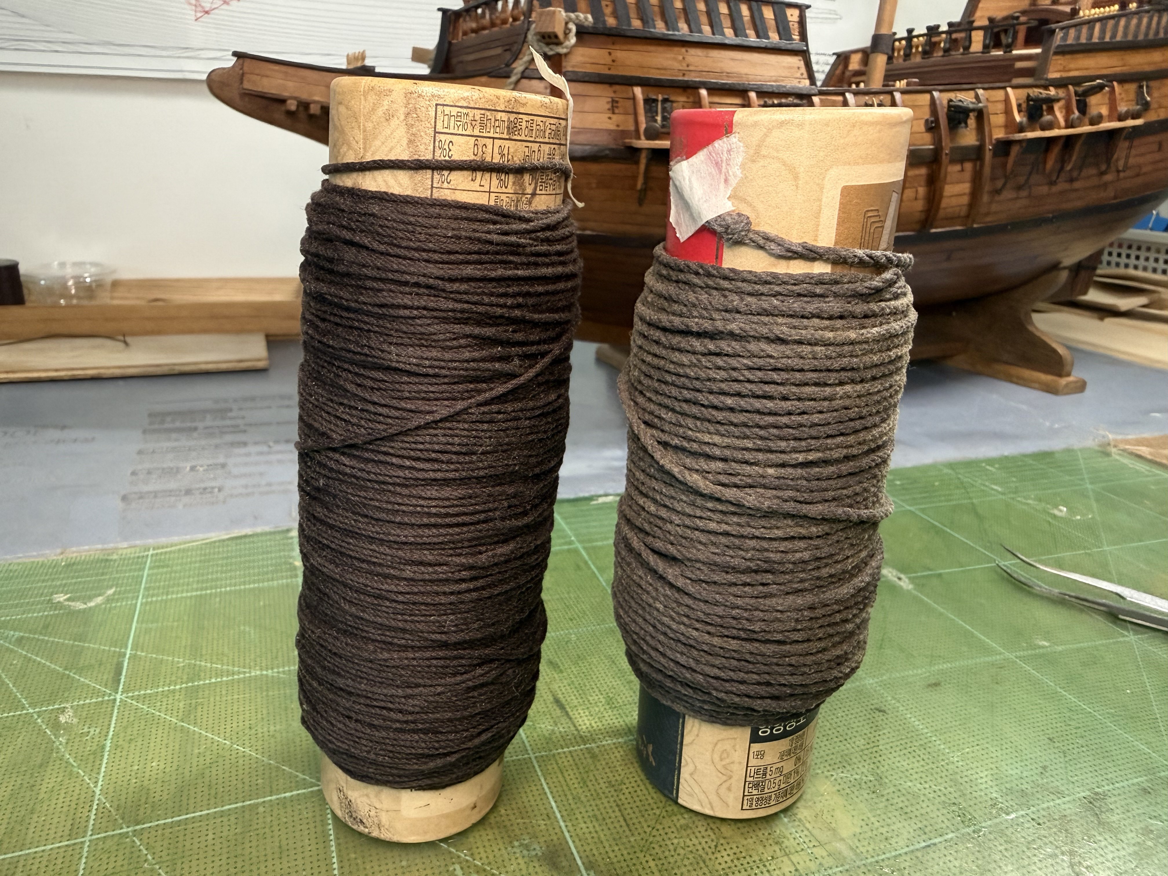

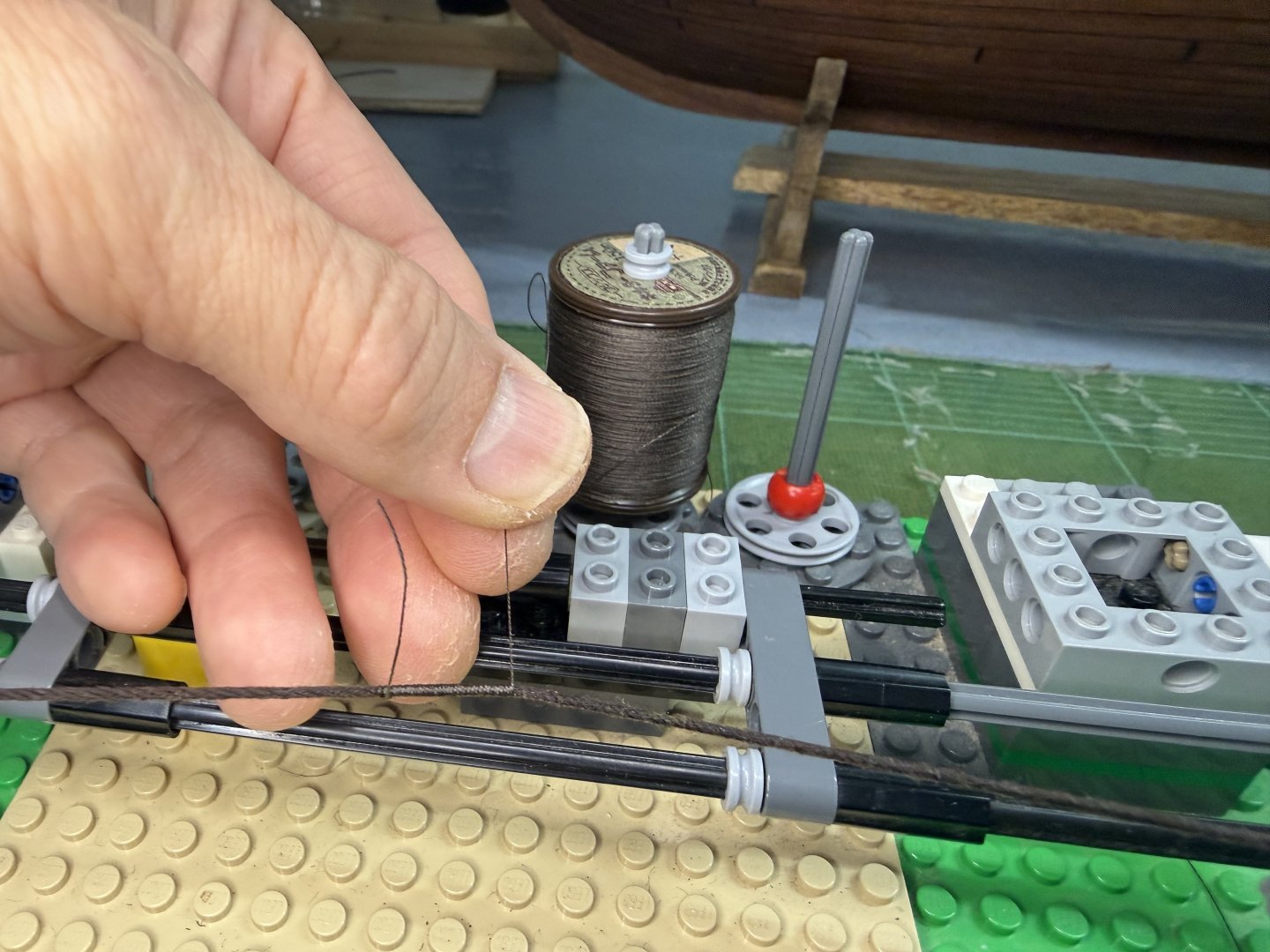

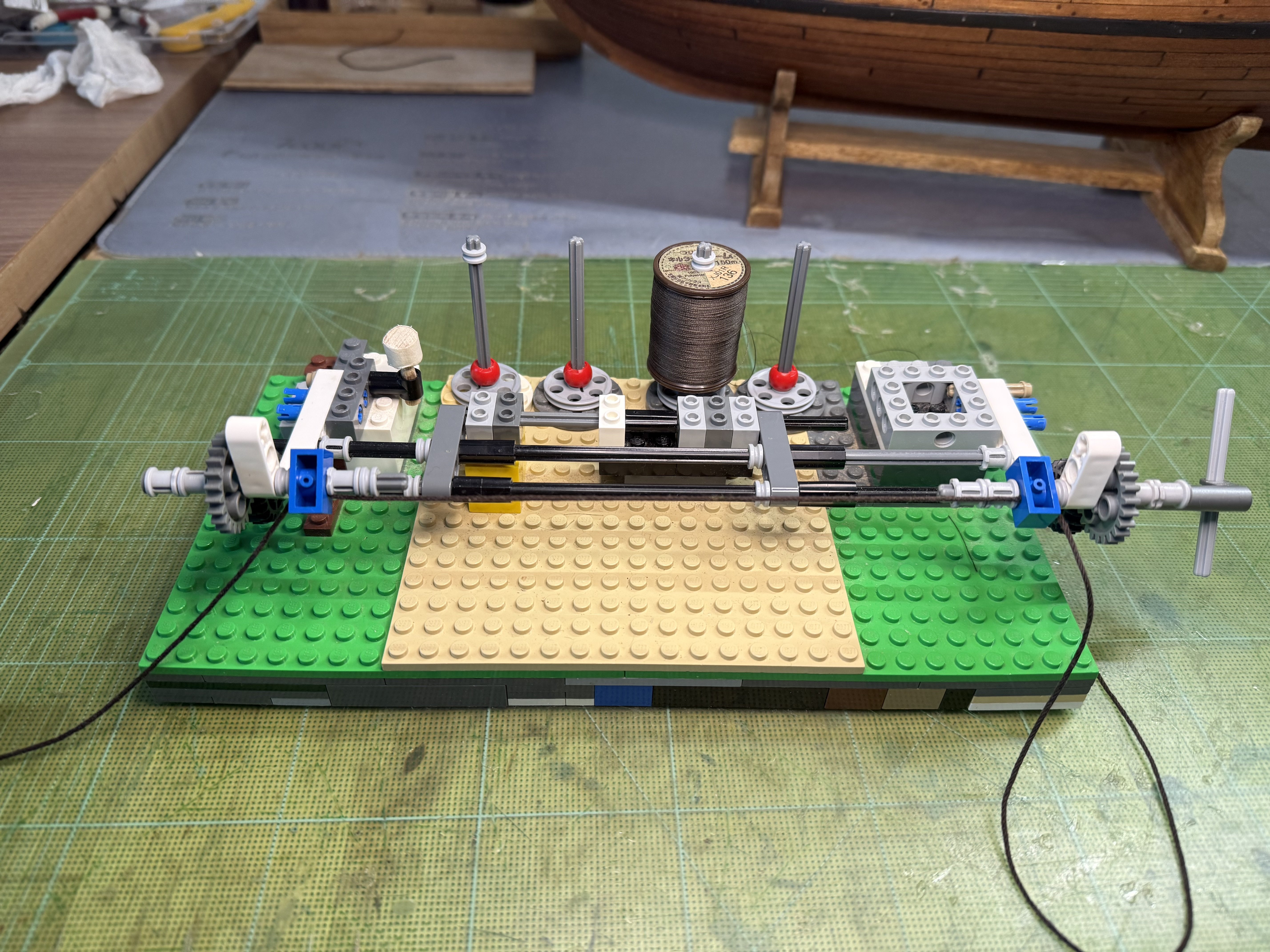

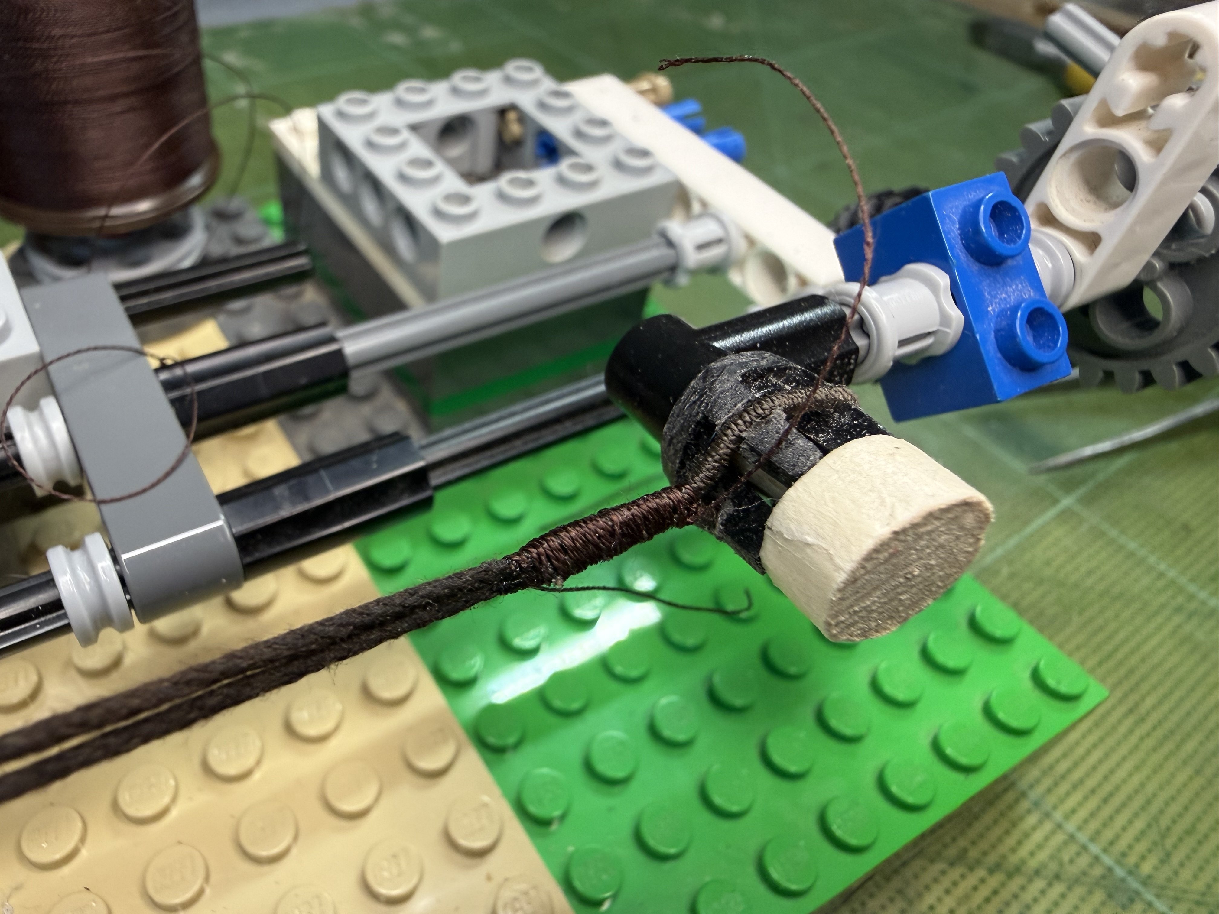

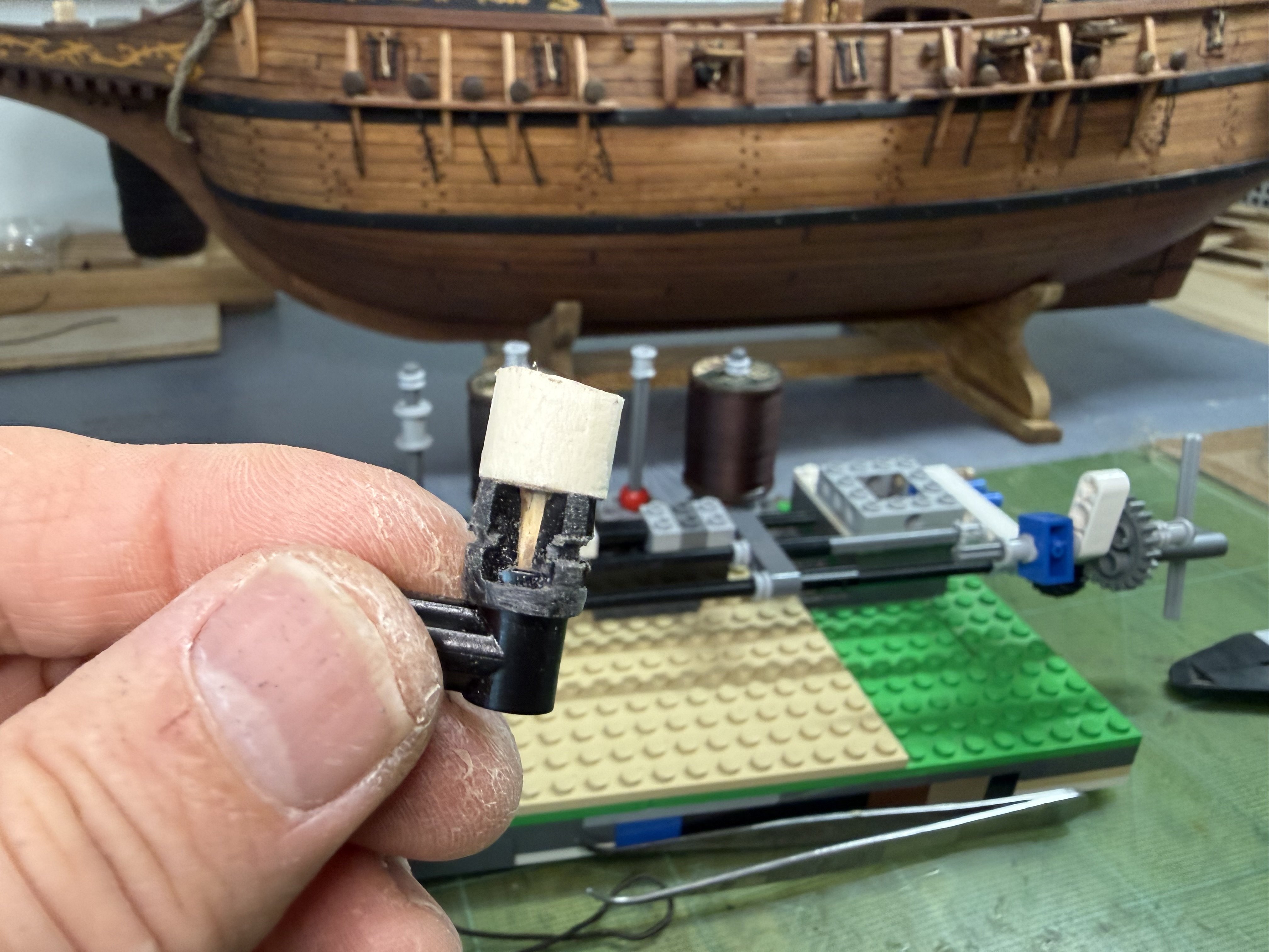

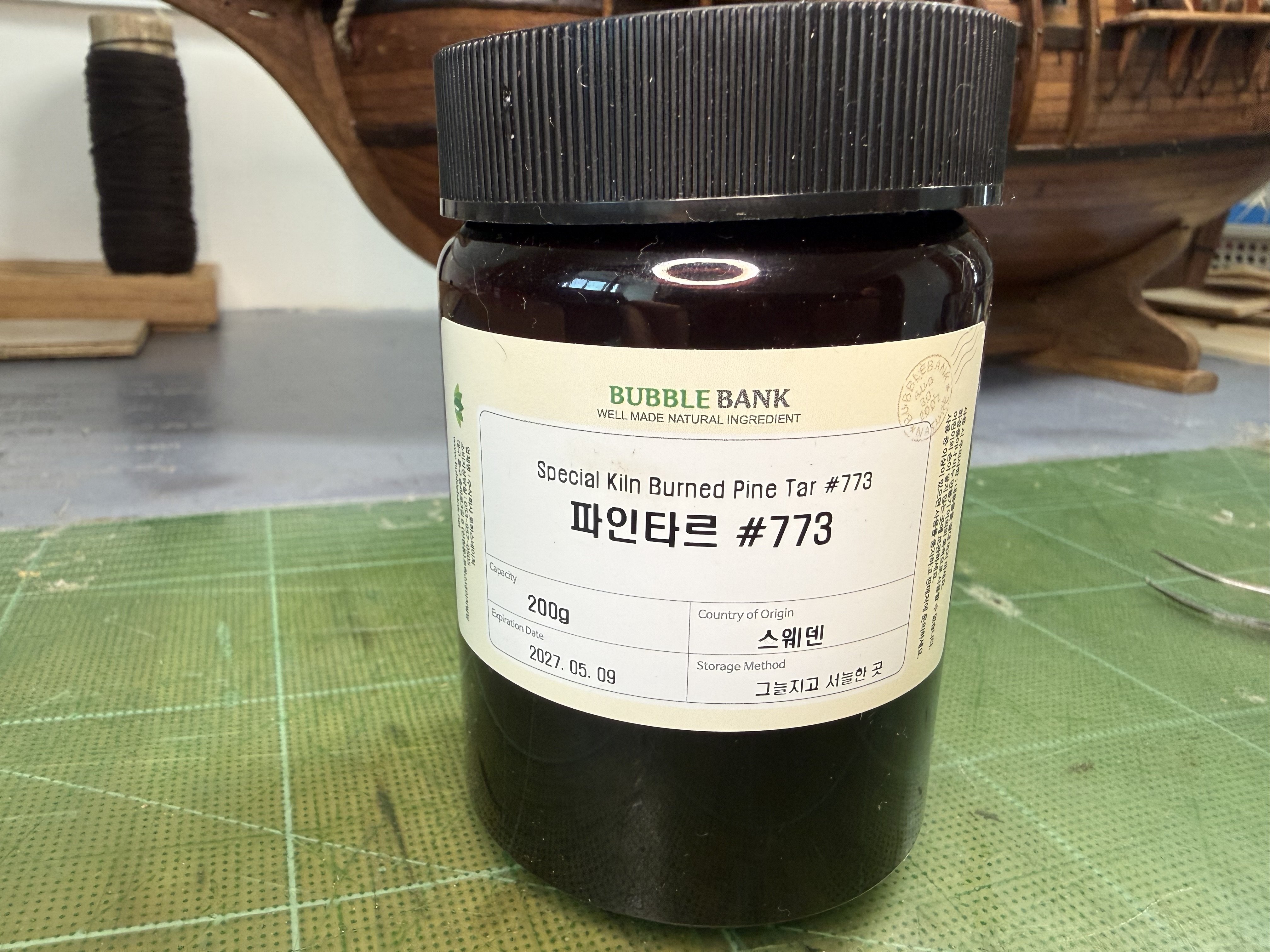

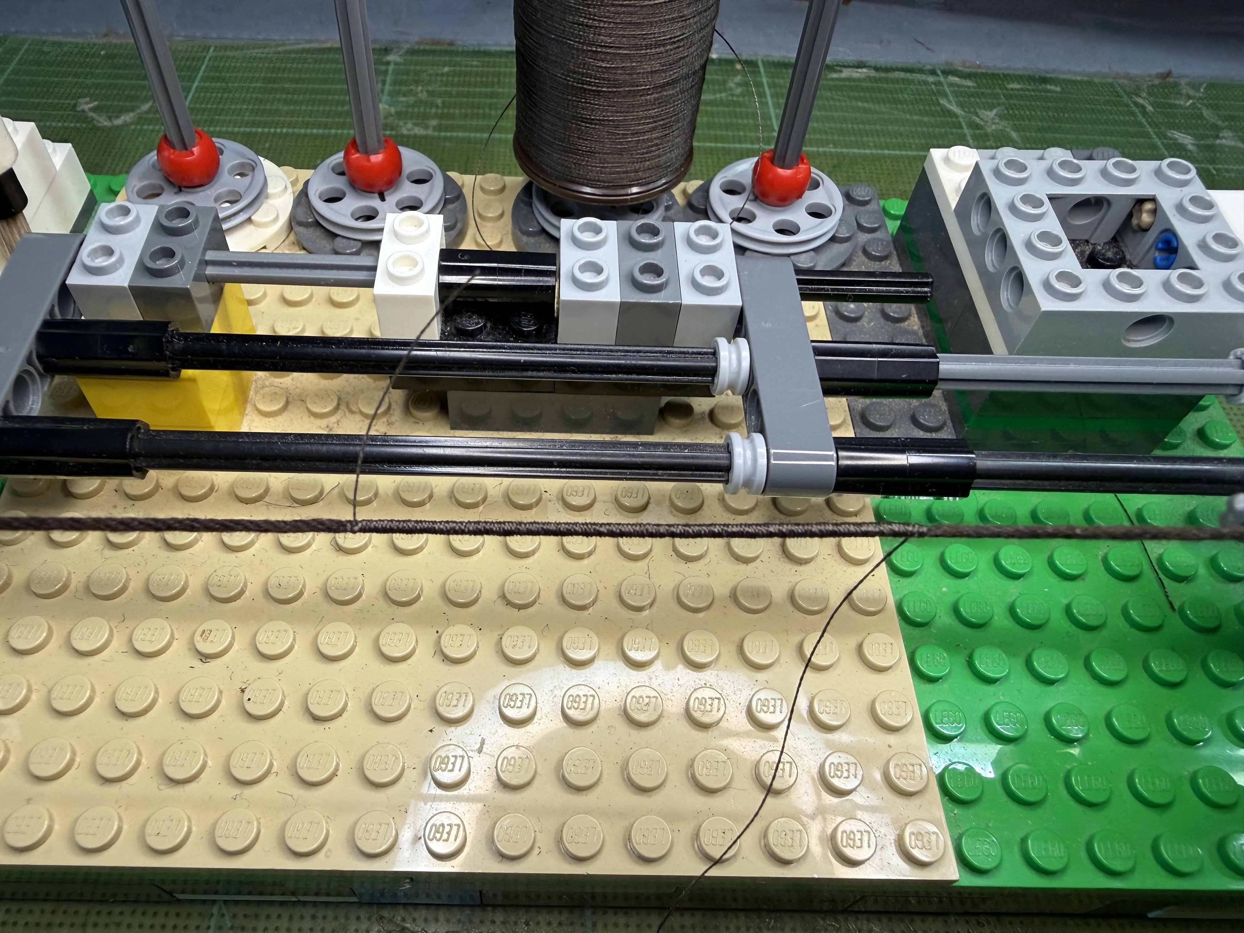

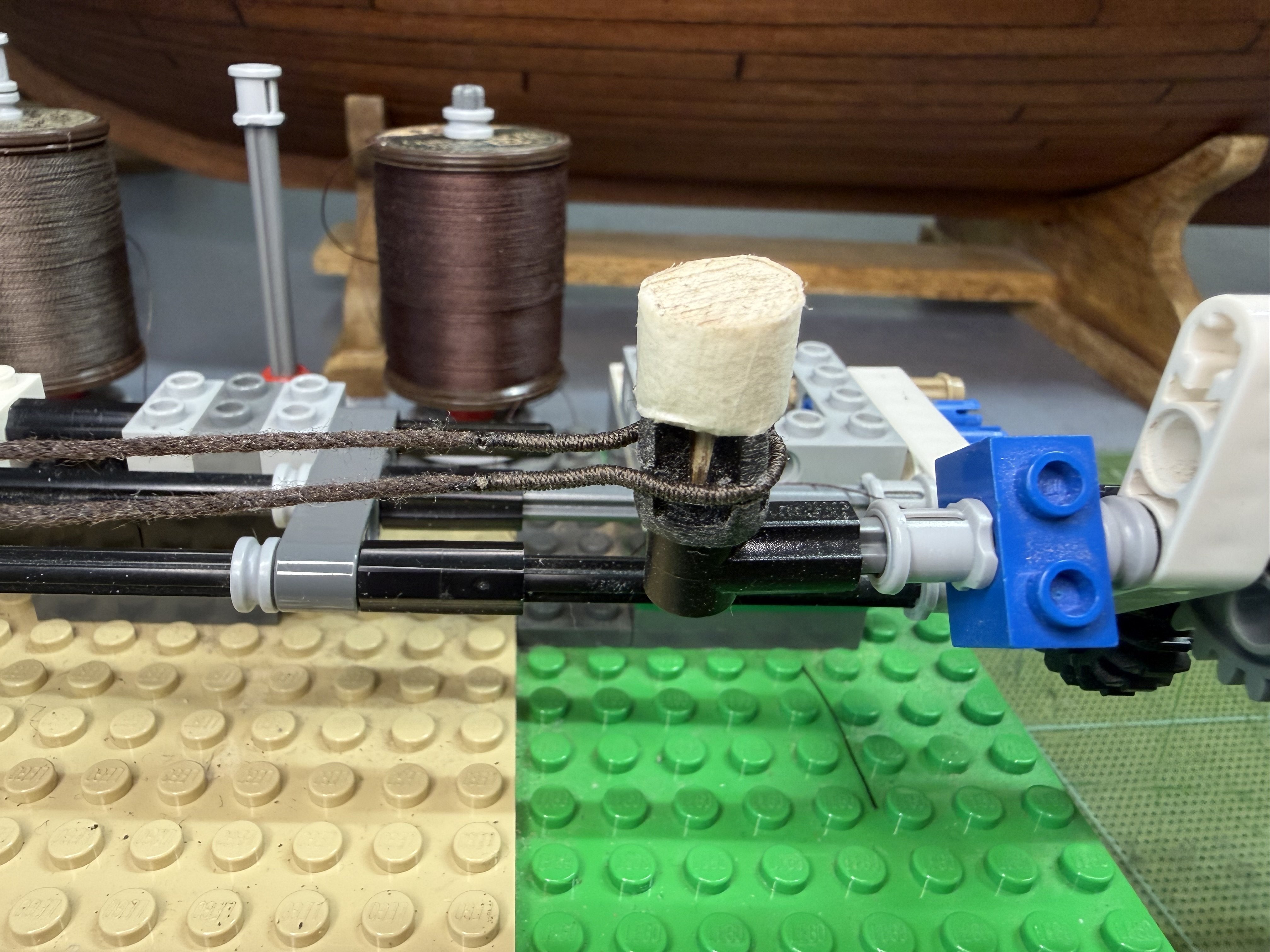

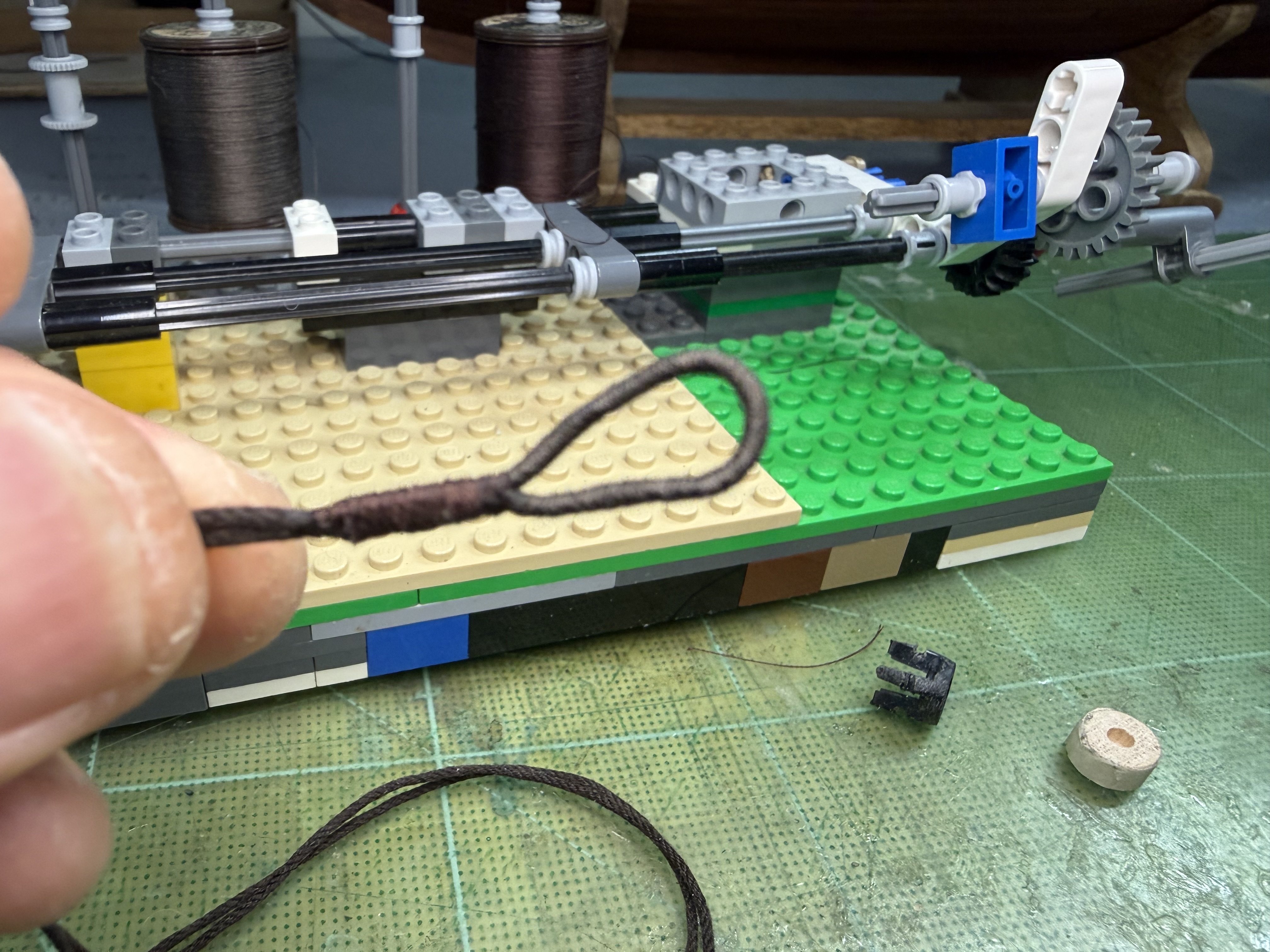

  5. Hi All~ Progress report on GH1 & GH2 : quite a lot of testing, trying out various stuffs, proof of concept kind of activities were carried out since my last update. These include 1) trying out pine tar treated threads for stays and shrouds (vis-a-vis the appropriateness of color, thickness and ease of serving with my newly procured dark brown polyester thin threads and etc.), 2) trying out various methods and positions for the stays and shrouds, 3) dry runs in regards to the rigging of some sheets for the purpose of pre-determining overall belaying positions and also to assess (to some degree) if the current number of belaying facilities are enough or not. The below pictures show the end results of pine tar dyeing of two types of threads. Thinner one (about 1 mm in diameter, for shrouds and upper mast stays ) was originally light brown cotton thread - dyed using 1:1 (pine tar : thinner) proportion. This one took about a week to touch dry. The thicker one (about 1.5 mm in diameter, for lower mast stays ) was originally white cotton thread - dyed using 2:1 (pine tar : thinner) proportion. This one took about 3 weeks to touch dry. Testing serving on couple of samples (shroud lines and stay related blocks) on my Lego serving machine- to which I added more function to enable other tasks. First try-outs of the served threads.

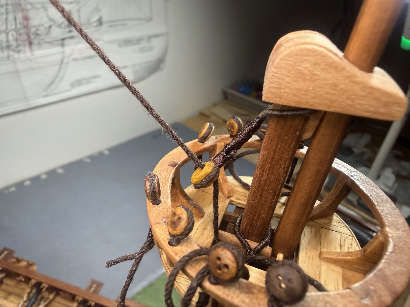

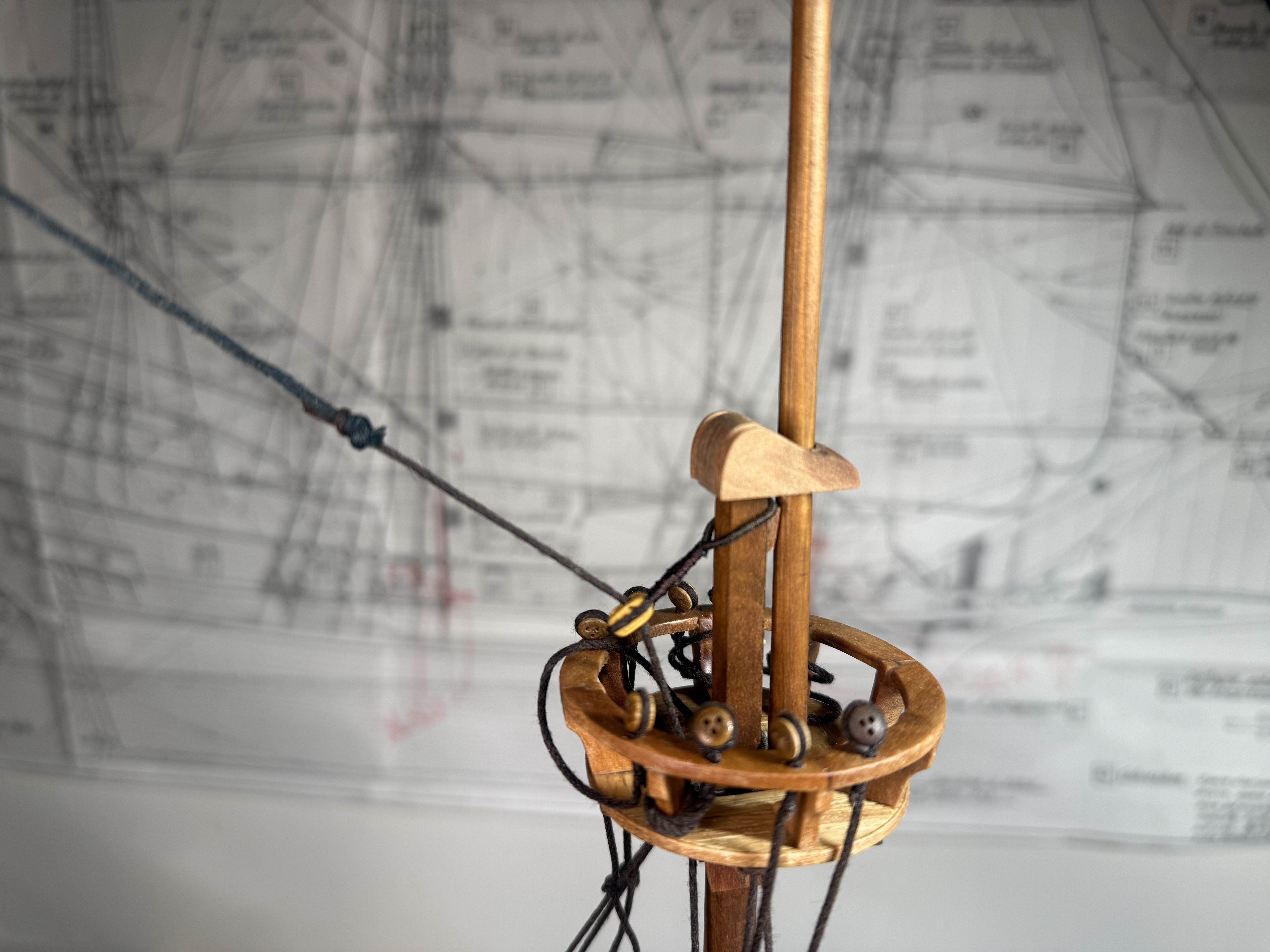

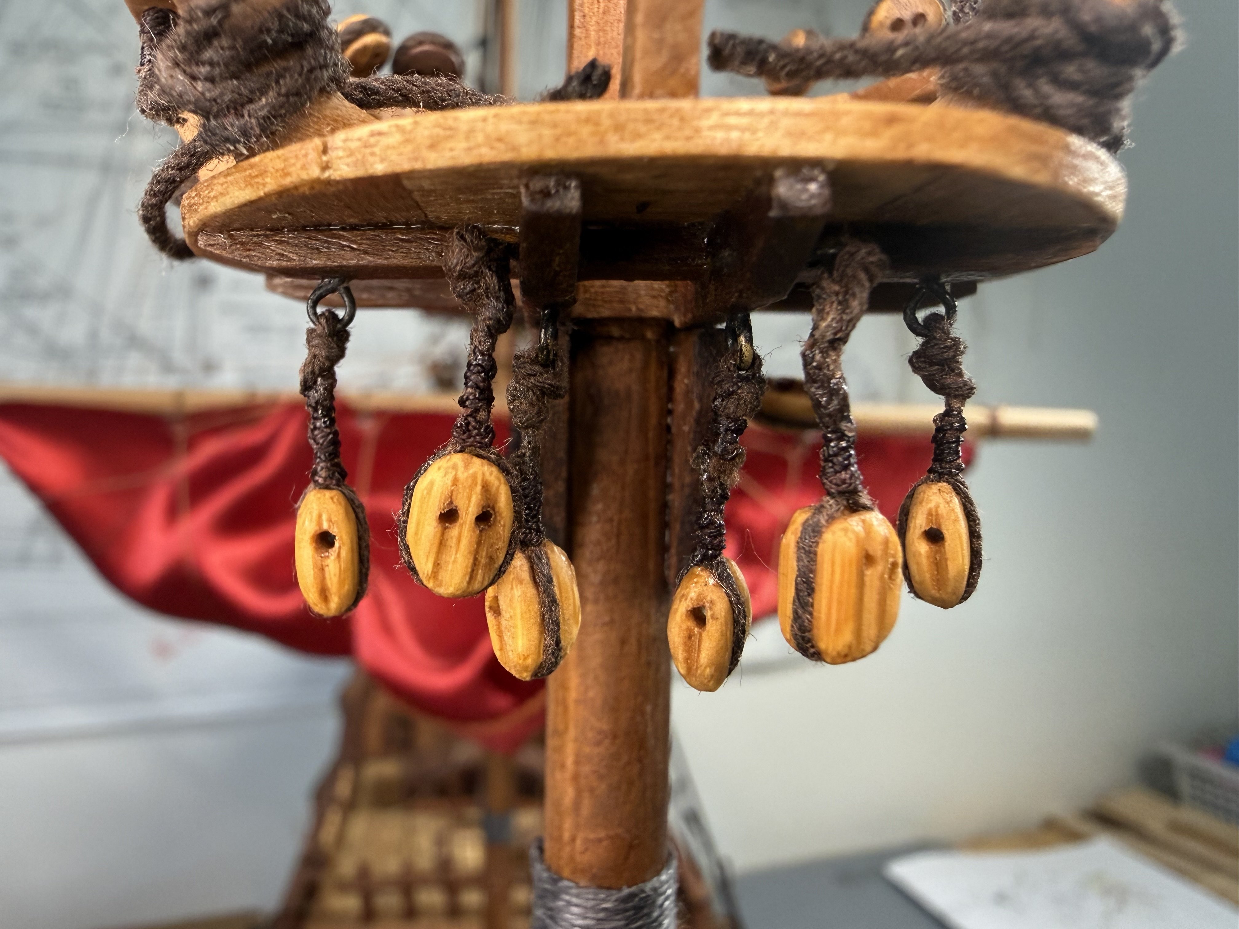

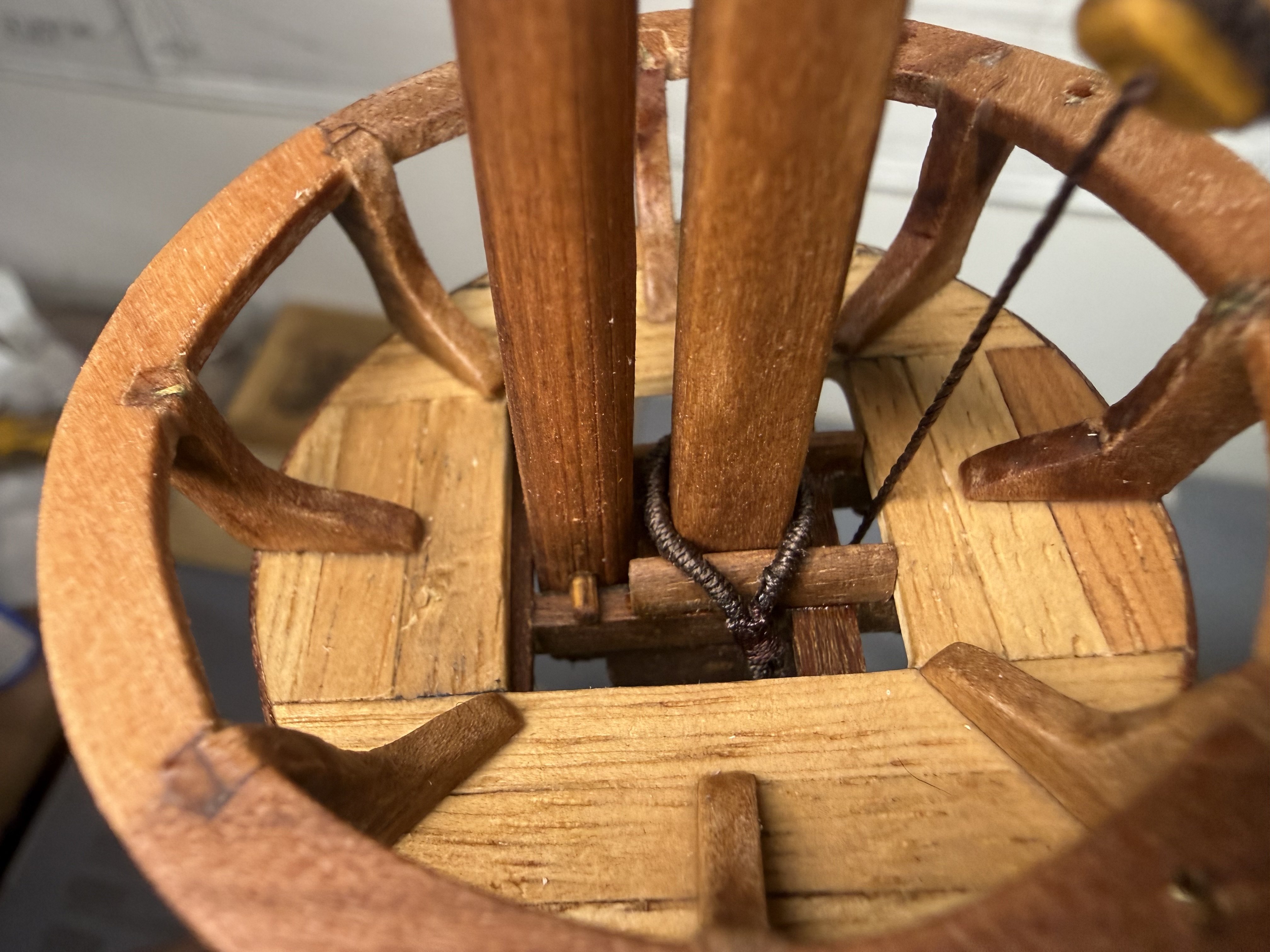

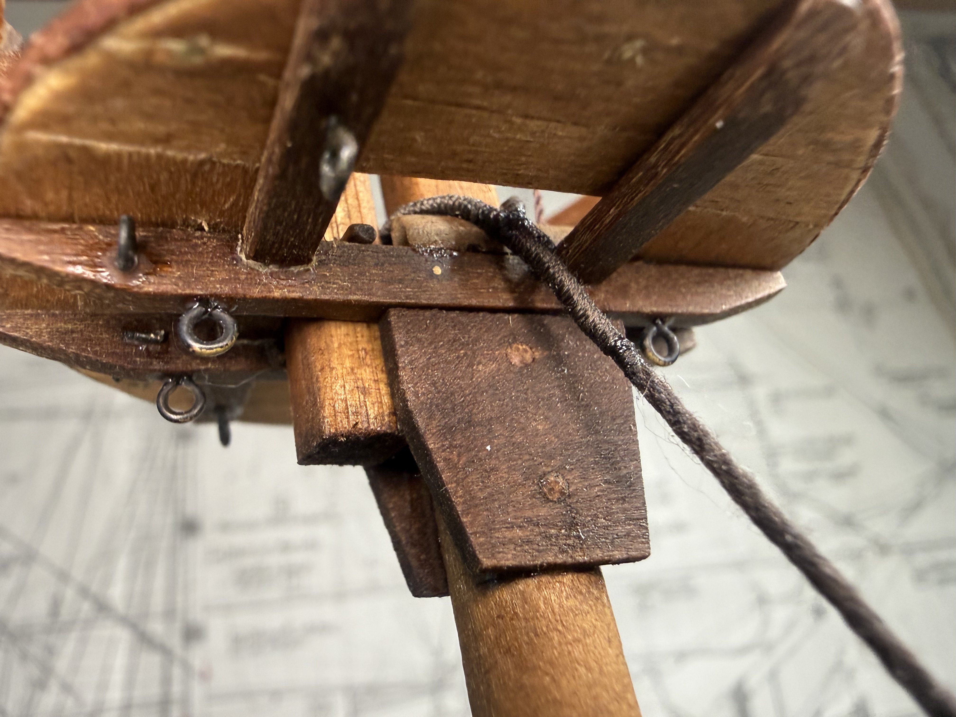

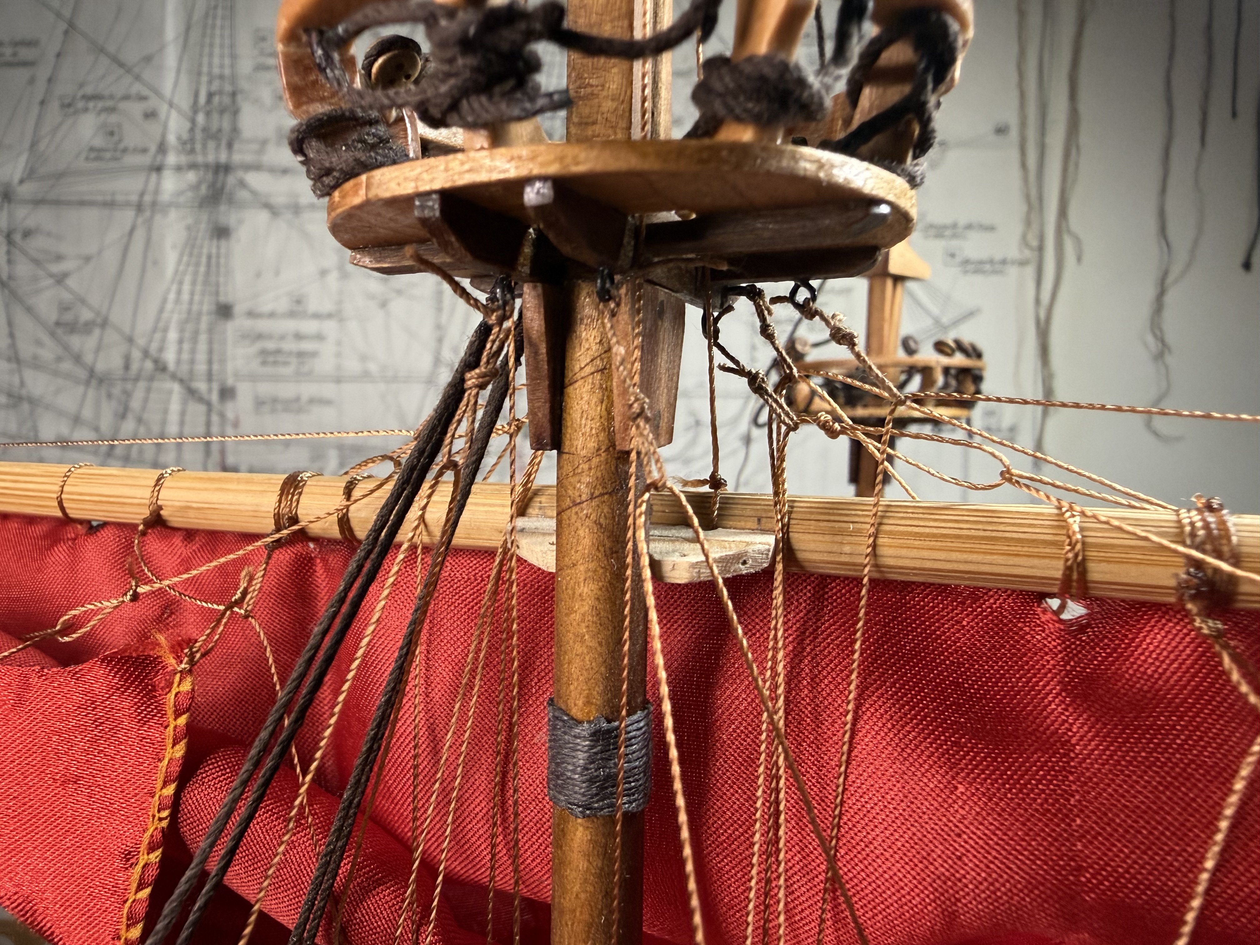

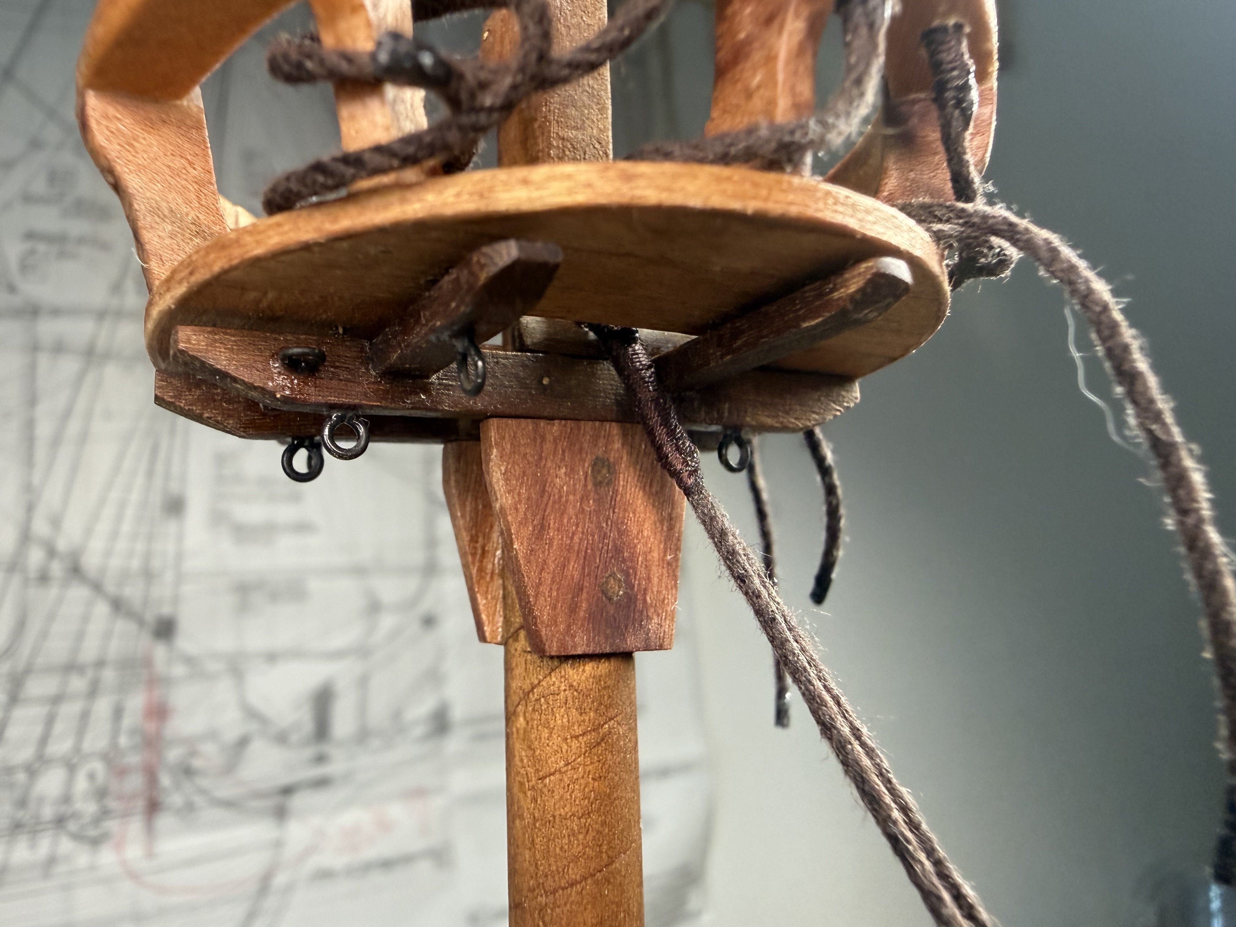

  8. Next, the fore and main upper stay stoppers : small single stoppers applied. Now the dead eye fixture on the crow’s nest. I decided to follow the original plan - fixing the 5mm dead eyes with cotton thread instead of bronze. Finally, minor additions to crow's nest supporting structure.

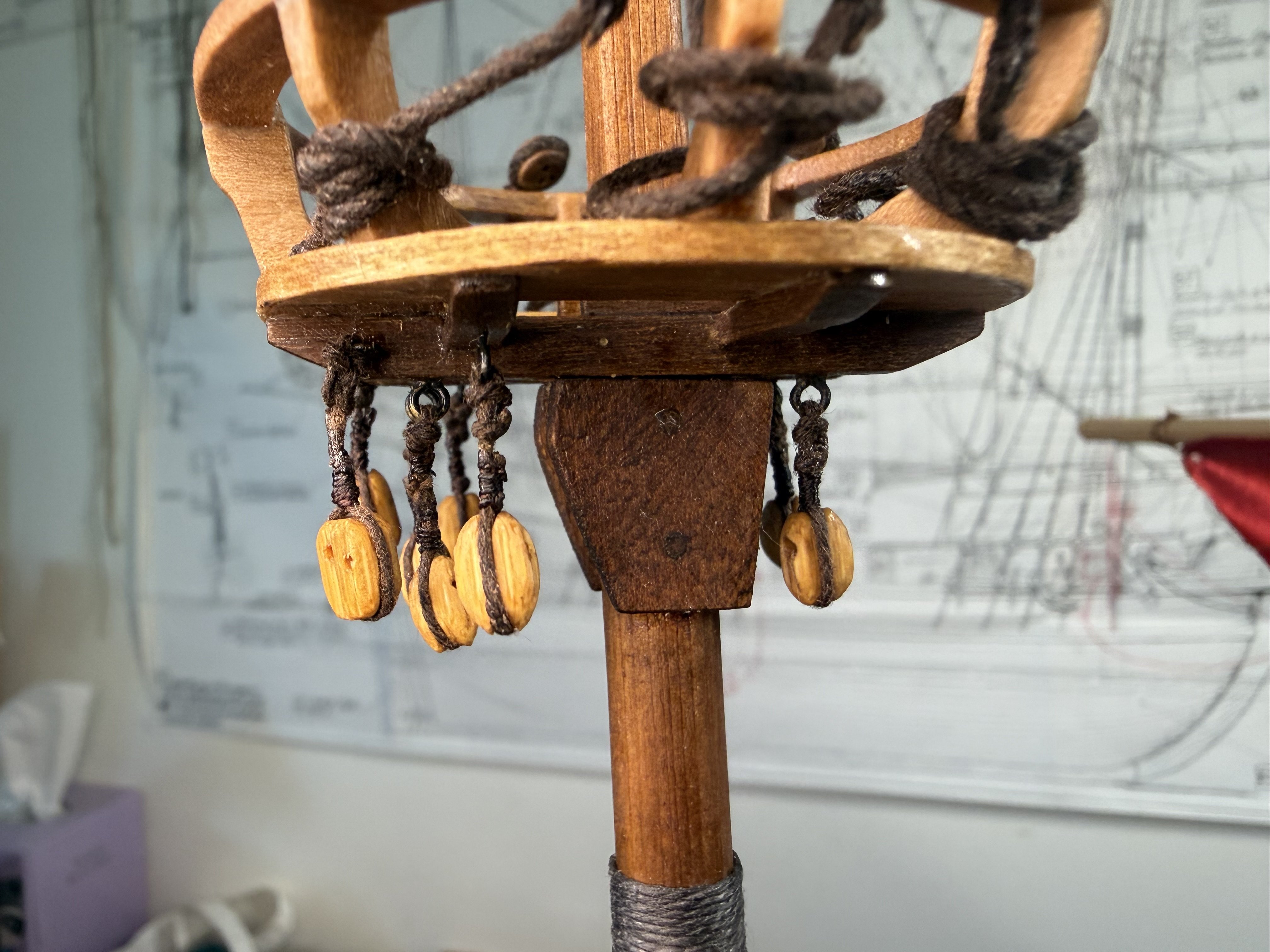

  9. Hello shipmates! Latest progress report on GH1 & GH2: prep work for crow’s nest underbelly rigging (installing bolts for block attachments), installment of stoppers for stays, deadeye fixture on the crow’s nest, and some other minor additions. First the bolts on the underbelly of the crow’s nest. I started our with 4 (2 on the front, 2 on the back), but later I decided to add 4 more bolts on the front side (just in case). Next, the stopper for stay (between lower part of main mast and mizzen mast) For this one, I devised a larger and wider single design instead of applying multiple small stoppers. Same procedures applied to all masts for both GH1 & GH2.

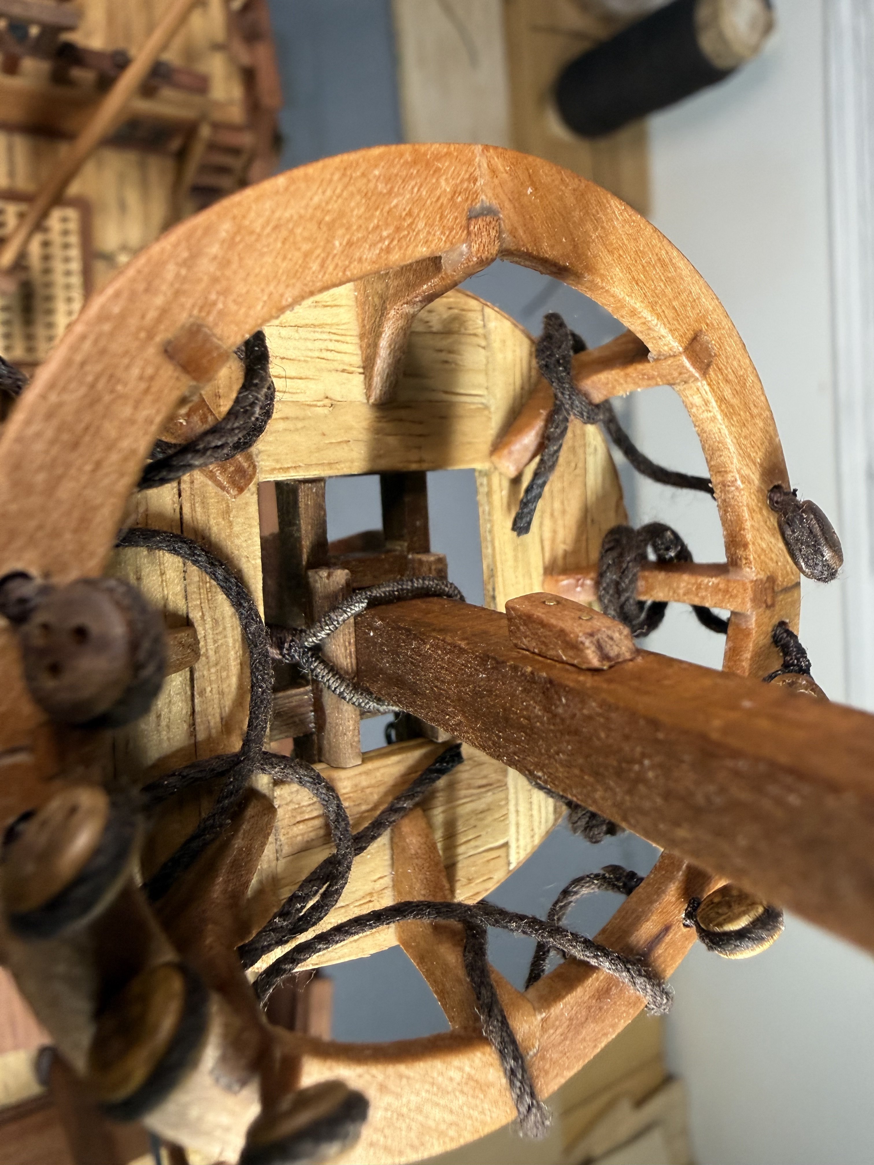

  13. Hi shipmates~ Relatively short updates on the progress of fighting top. Firstly, the process applied to GH1 has been replicated in GH2 as below. Followed by mizzen mast fighting top work on both GH1 & GH2 as below. At first, I planned and designed the structure of fighting top as below. However, I soon realized that the 30 degree interval between pillars was making the floor of the fighting top too crowded. So, I changed the design to reflect a 45 degree interval. With the first templates made out of the wooden hanger material, the tedious work of making each pillar and quarter piece continues. I was pretty sure that I needed to do some reinforcement work (possibly near the floor area) as there are just 8 pillars (instead of 12). But, the end result with just 8 pillars is surprisingly robust. So, no further modification seems necessary. Finished second fighting top and continuing with the tedious work streams.

  16. Next, the deck of the crow’s nest. I decided to use quite different design from the plan in order to provide some room for rigging lines and etc. at the back of the crow’s nest. For this, I had to shift the whole structure a bit towards the stern, making the crow’s nest appear to be located more in the middle of the mast (instead of slightly forward protruding towards the bow). Repeating similar procedures for the foremast.

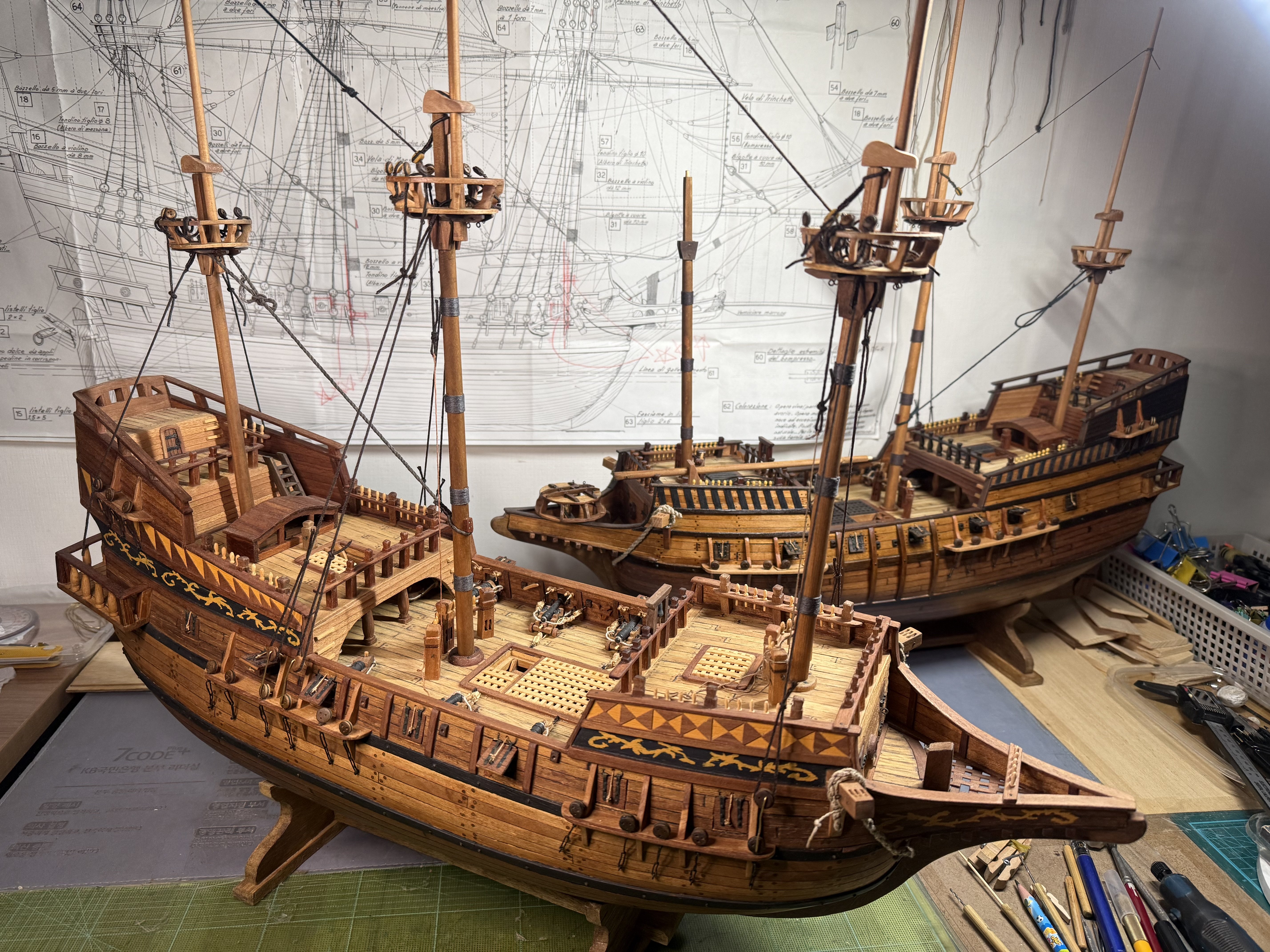

  17. Moving on to the upper level of the main mast and mast cap, I realized that I almost ran out of the wooden hanger material from Ikea. And since there are no more broken wooden hangers, I had utilize a perfectly well functioning wooden hanger - for which I obtained wife’s permission.
