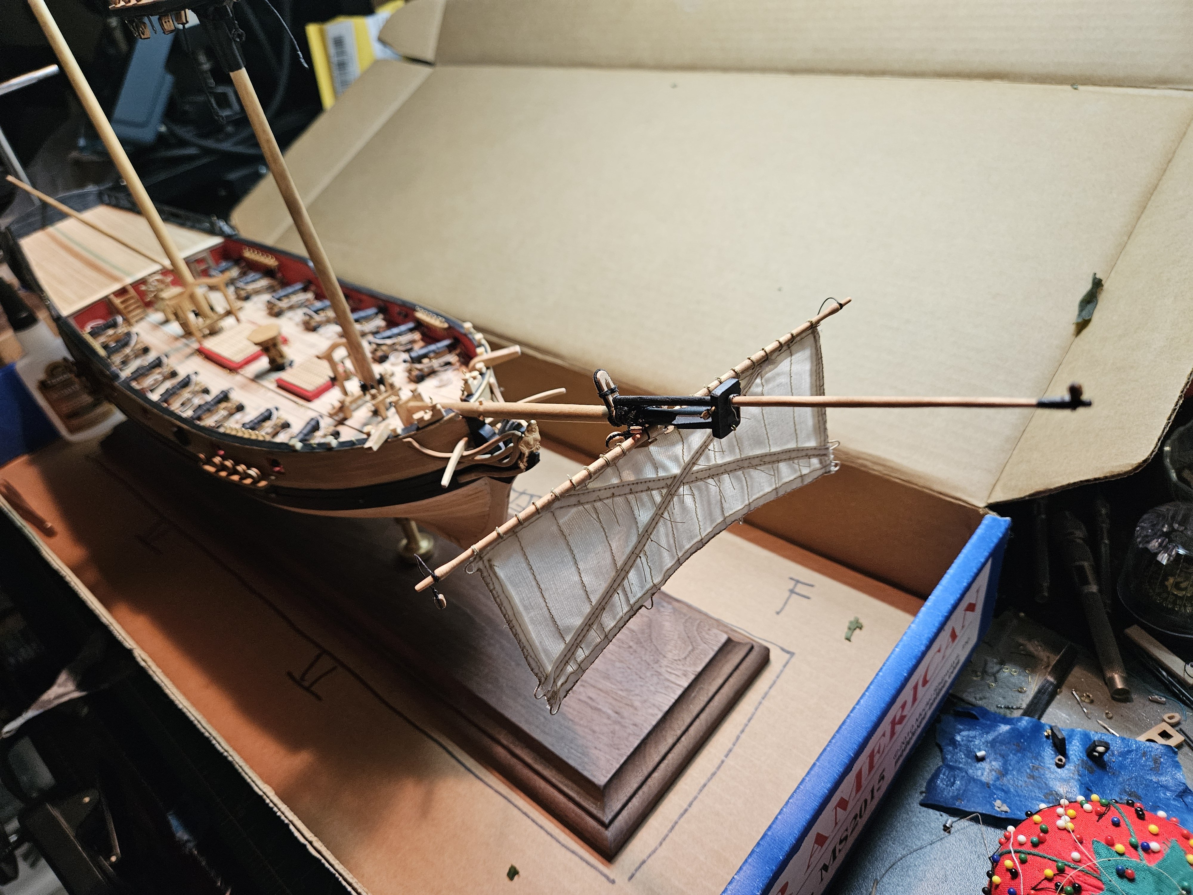

Bending Spanker Sail and relevant rigging for the Fair American.... Lot of content this post, and a lot I didn't get good pictures of along the way, or any at all. So, much of this is after the fact and not as detailed as I would have liked. But, that ship has sailed... Before I rig the shrouds for the Main Mast, I want to tackle the spanker sail while I still have access to do so. I rigged/bent the sail to the main gaff, using robbands as before. I also added two single 3mm blocks and one 3mm double block for the brails. These have to tie off somewhere, and my instructions don't say where, so I've added some cleats to the main boom. Starboard forward is the brail cleat, starboard aft is for Inhaul, port is outhaul. I saw this in Petersson, so I'm adopting that here. Additionally, I added two black standing ropes for inhaul/outhaul and blocks (not shown). Furthermore, I also added the peak bridle, which I'll reeve through its block later. NOW I'm ready to start...I hope.... First up was a parrel for the gaff jaws. My instructions don't say how to do this, so I'm using small beads, as before and a rope parrel seized around the main mast, similar to what I read in Lee's. There are holes in the jaws, so after pass through the beads, the rope goes back in again, and seized on the other side. I also added a block for the throat halyard. It's ready to go when I rig that later. I temporarily tensioned the peak bridle to see where the gaff would raise to. I didn't want the bridle to sag unnaturally, so once I got the height approximated, I can see where the sail falls - I want it close to the main mast so I can attach the robbands. These are probably meant to be rings, so it can slide up and down the mast, but I want to move along in the build, so not this time. I made sure the sail wasn't bunched or overly stretched beyond the where the boom hooks to the mast. What I'm most pleased with is the measurements of the sail, when sewn, has turned out to fit! I had to scale the dimensions of the sails to fit my model, down from an online source. For the Peak Halyard, the running end goes to two double blocks, then up to the pin. I've attached the bottom/deck block to an eye bolt, which I'll glue on deck, as per the instructions. After reeving through the 5mm block on the mast cap.... Now it gets seized with a 4mm block, with the tan running rope end starting here. After trying and failing to feed the rope through the double block on deck, I decided I needed to do this ''off-deck'', then hook the block after. Little tough to see, but I managed to get it reeved and started belaying to the pin, holding some tension while I glue with a dab of CA. Now I can do the same with the throat halyard. I've previously attached the single 4mm block to the top, so this was the easy part. You can also see the double 3mm block in the foreground for the spanker brails. Its seized to an eyebolt so that it faces and hangs correctly and the ropes will go straight down to the cleats. I belayed the throat halyard on the starboard side, as per the instructions. I made a crude rope hank/coil to hang on the pin. These were tough to make, and this was before Chucks recent rope hank tool he shared. I later made a little jig of my own to make rope hanks - it still a work in progress for this scale. I attached the running end of the outhaul rope to the sail cringle.... And the inhaul to the same cringle, as shown in Petersson, then to 3mm double blocks. I also added the boom topping lifts with black rope, which I later changed to tan after reading the instructions. Yes, my basement storage is in plain view in the background. I didn't have a spanker sheet big enough to hide it 😉 When running rope through the blocks, they ended up being 2 inches short of the cleat! I underestimated how many turns it takes through the blocks before the cleat. I fashioned a little rope extension, which will be small and hidden behind the boom. After tying with fine thread, small dab of glue, and trimming very close, the end result isn't bad. Almost invisible... So now it reaches the cleat. After a little dab of glue, it gets trimmed close with a razor blade later. Tweezers help hold tension while the glue dries. I kept the tweezers in place while I did the inhaul side, so the sail is balanced and extended on the boom. You can see the outhaul tackle under the boom. What also has happened, is the head of the sail buckles slightly. It's not perfect, obviously, and fiddling with it will just make things worse. I'm hoping when I add the boom sheet blocks, it'll pull the sail back a little more taut, but I won't force it. So I have the outhaul and inhaul tackle tied off. Now to tackle the brails. Both will go to the same cleat. I'm using the tweezers again to add tension to the rope while the glue dries. I'm not pulling hard on the brails, so the sail stays flying and doesn't bunch. Each brail line was seized to the bolt rope, then rove through the single blocks to the double block, down to the cleat. There's another rope extension in the picture below. Can you find it? I'm also still deciding whether these cleats need rope hanks or not. Thoughts? I also attached the Spanker sheet tackle to the quarter deck, as per the instructions. This I intentionally left a little loose, so as to not pull the peak bridle and other tackle too tight. So now almost all the elements for the spanker are in place. The vang pendants still remain, but I'll add those later. I'll be able to do the main shrouds now, without bumping into them. Getting access to the cleats and tackle would have been difficult (for me). This is the fun stuff I have been looking forward to - the rigging. It still amazes me how sailors back in the day would have to handle all these lines in order to make the ship go! More to come soon. - Jason -

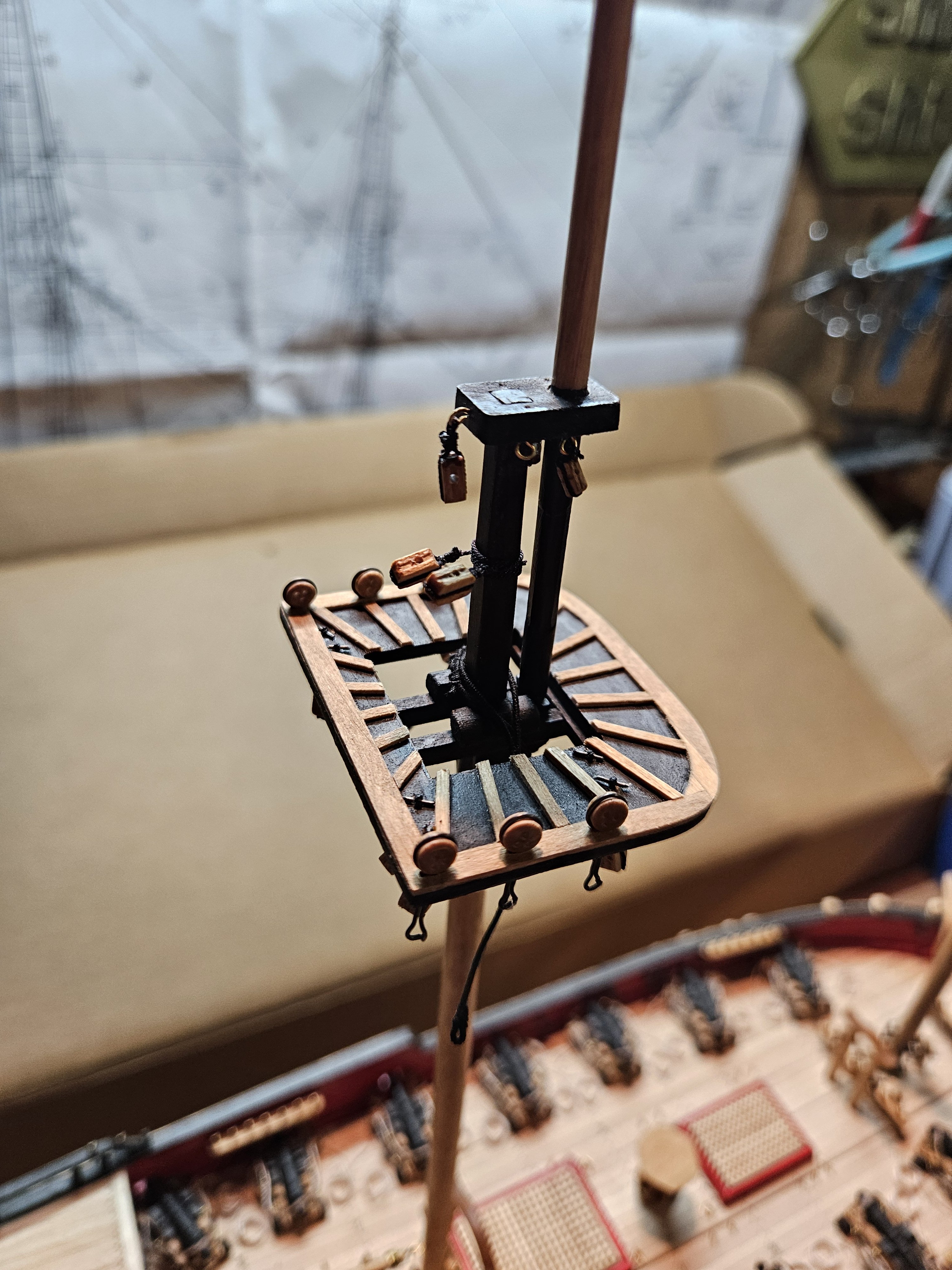

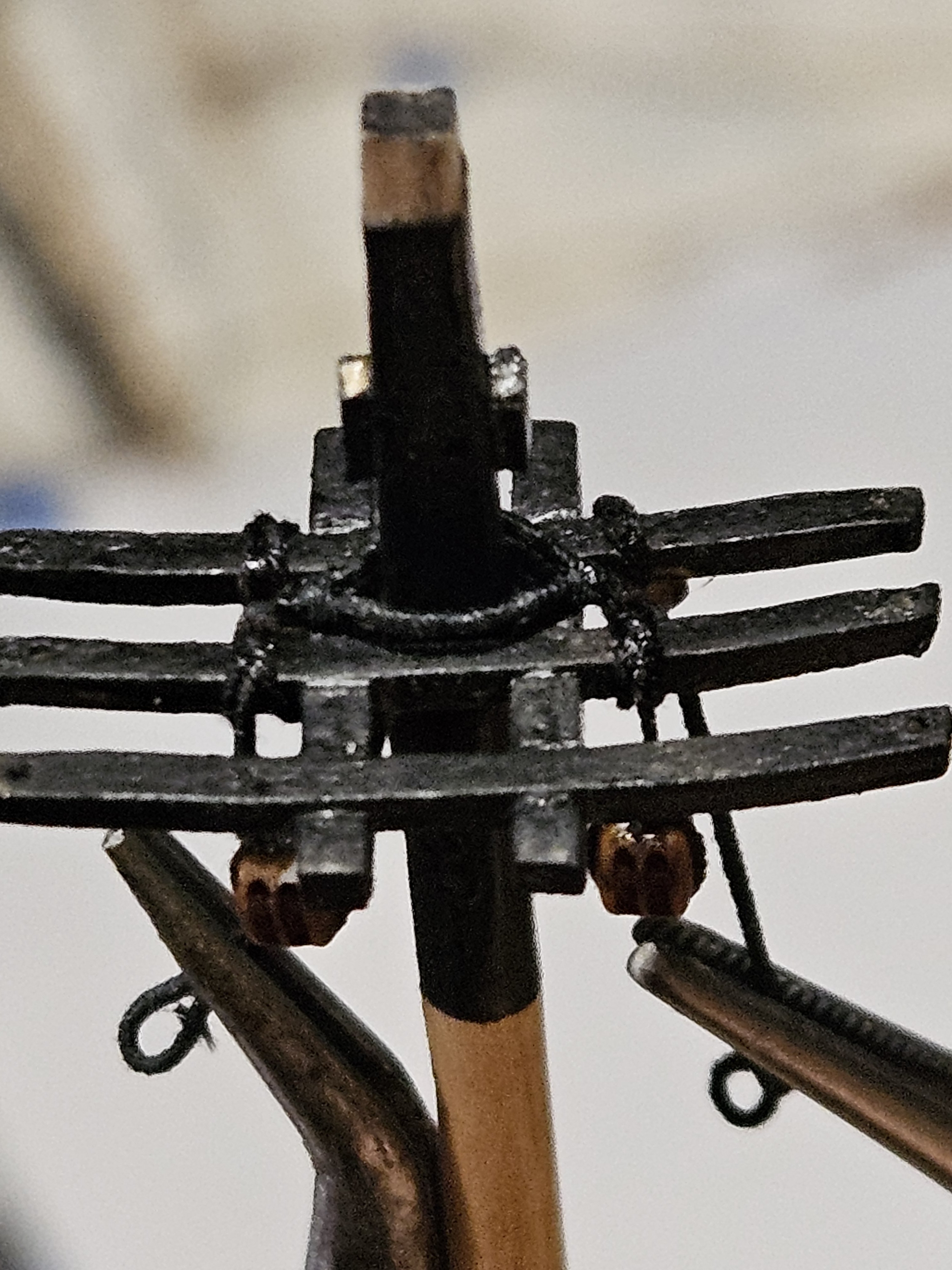

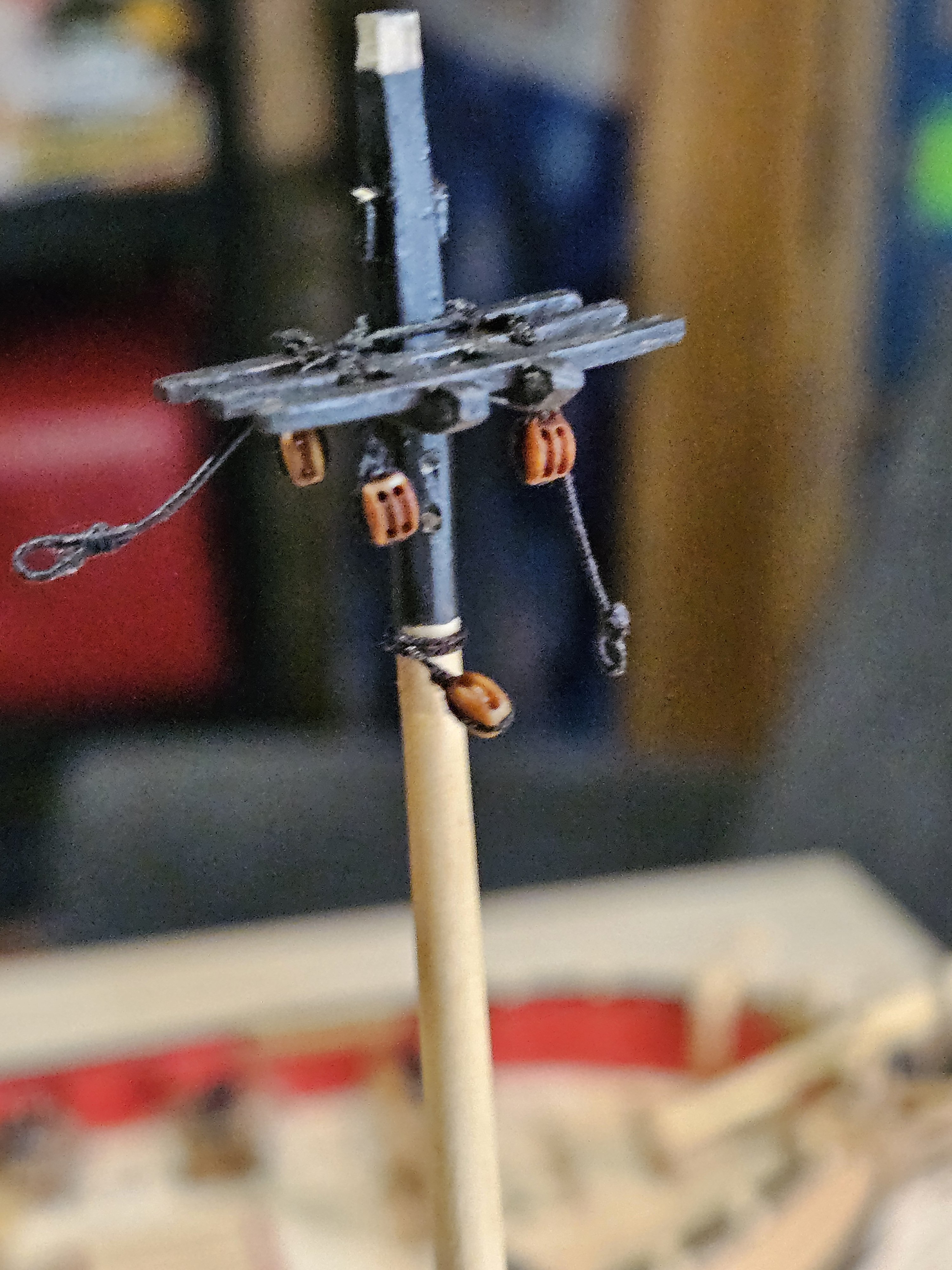

Moving along with the Fair American build... Had a nice Christmas with the families, so shopping, wrapping and interruptions abound! From Petersson, the Topgallant bowlines go through sheaves in the trestle trees, then down to a rail. My kit obviously doesn't come with one, so I built on with some scrap basswood . It couldn't bee the entire length of the top, because it'd run into the deadeye. This is before gluing... And after, with the belaying pins in place. This thing is delicate, and broke of several times, so here I added some more white glue at the bottom to further secure it to the top, then stained. Some other elements I'm adding are belaying points for the Staysail sheets - I'm using a cleat here. And the Topmast Staysail sheet.... Here they are installed on the inner bulwarks. I'm finally moving onto the shrouds, starting forward. According to the instructions, the 'head' is served, so that comes first. I purchased some more of Chucks rope (.030, .035, and .045in) - he's go the good stuff. I'm measuring out approximate area of 1.5in to serve with flags. Then, starting with the starboard side, making the first shroud pair. I added a blot of CA glue to tack them together, then used fine thread to start seizing. This needs to be tight, so I'm using tweezers to hold the ends taught while glue dries. Hard to see, but I did several turns and a single thread cross seizing. About as secure as I can make it. The end is long enough that when I add the deadeye later, I've got enough rope. I kind of have only one shot at this, to get the length right. After the starboard side, I did the port side pair. Using a fine needle helped tremendously with the seizing. The other ropes and lines I had in place and coiled got somewhat in the way, but I was able to work around it. After finishing all the pairs, alternating sides, I've got them all done, or 'ready' for deadeyes anyway. The seizing thread is the same size as the serving, so it blends really well - I think that's the point. Once all the shroud pair are pre-paired, lol, I am adding the deadeyes. As per the instructions, I made a little tool with some steel wire to space it out, according to the plans. I rotated the deadeyes, so the middle 'eye' is in the middle, and not crooked. This will make the lanyard neater and straighter - I hope. This part was tricky to figure out how to do. I failed several times. I ended up using the reverse tweezers to grip the rope above the deadeye.... Then tack with CA glue using a toothpick, towards the back side to 'hide' the glue. I let it dry for a while, so it wasn't tacky before I let go with the tweezers. The spacer tool fell out VERY easily, so I had to keep lining it back up all the time - a real pain. I also started a knot with fine thread to do a 'throat' seizing.... In Petersson, this throat seizing looks a bit odd. I'm not entirely sure how it's done. Something like an over-and-under technique. Mine doesn't quite look the same. Its more of a throat securing, rather than a seizing. I also want a little hole underneath for the lanyard to pass through later. Now that its secured, I want to terminate the ends. On the rigging sheet, this termination is rather short - <0.25in long. I want enough space to show off the lanyard coil, so I'm making it ~0.375in long, using a flag as a guide. I added two seizings with fine thread, and CA glue to the very end of the rope so it doesn't unravel when I cut it. Of course the termination is supposed to be on the aft side of the shroud, so I had to flip it. All the other deadeyes were terminated on the correct side after this. I could have seized with tan rope to make it stand out more, but this works fine for me. That's one! I have 15more to do. It's tedious, and I did it over several days, as time allows, but I got it done. Next up is the lanyards. These should be fun. Thanks for reading. Have a nice New Years, all! - Jason -

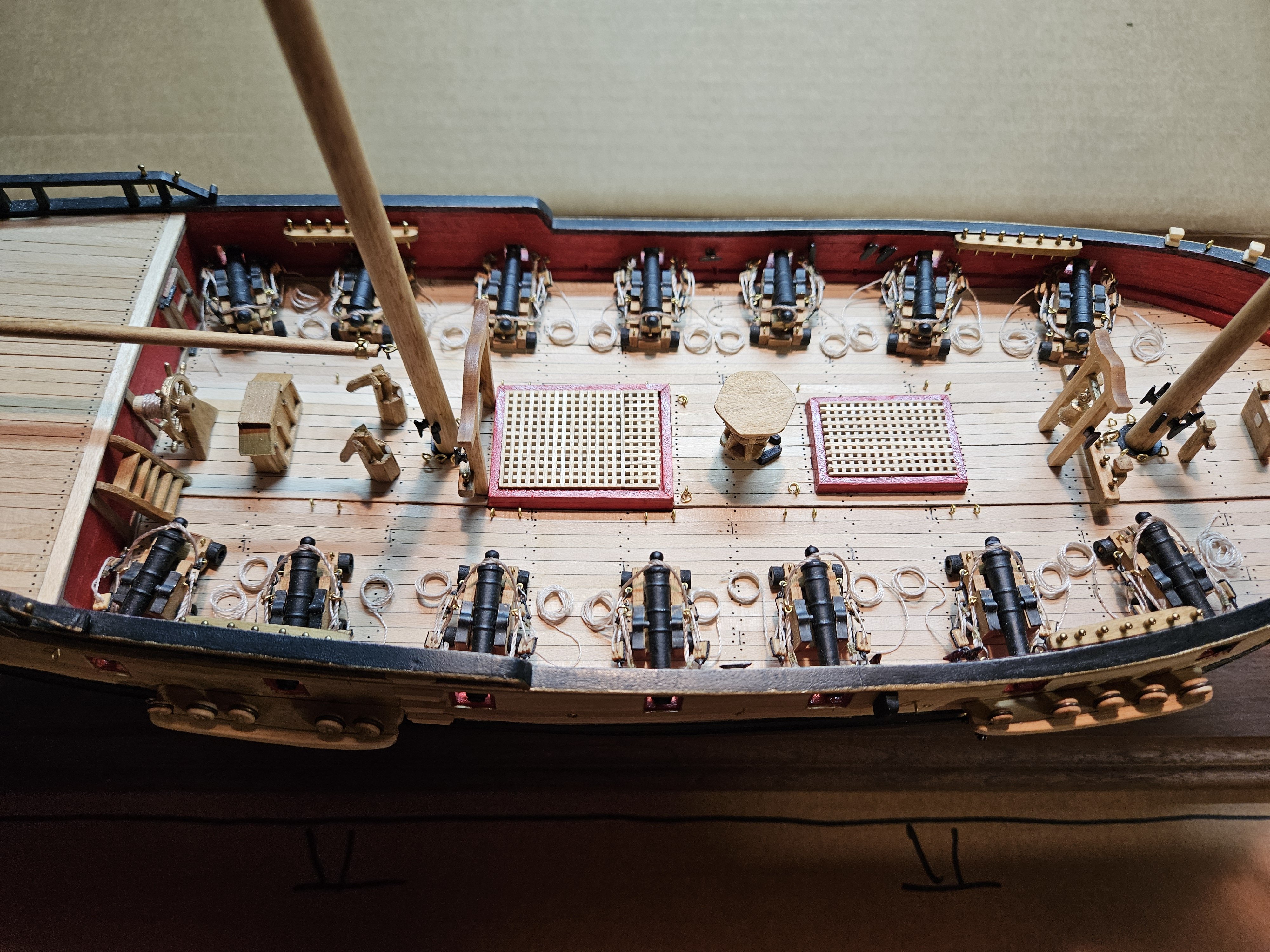

More steady progress with the Fair American There were some elements needed to be added on the channels, looking ahead at the rigging plans. The original rigging sheet shows eye bolts for lift blocks and halyards inboard on deck, but there really isn't room with the cannon right there. So, I'm adding eyebolts, etc on the channel instead, which is what is shown on the rigging plans. These sheets don't match, I'm finding. Also, adding eyebolts and blocks for the tackle, as needed. Once the shrouds are up, there won't be easy access for these later. Pre-drilled these holes for the eyebolts. I've learned, from doing the cannons, that its easier to attach a block FIRST, then put the eyebolt in. If you try to seize a block to an eyebolt after it's already installed, there's no access. So I hope I'm being forward thinking enough. Making the Fore Topsail Halyard ahead of time. This is the tackle; the brown rope end will go on an eyebolt BEFORE gluing it in place. The running end also starts FROM this block, so I coiled it for when I need it later. Its difficult (for me) to create a satisfactory becket at this scale, so I'm just going to make the 2-rope hook end look representative. I made a hook with some annealed wire, then looped the rope back over itself and seized near the block and the hook. I estimated the length from the plans. Once seized, I added some CA glue to stiffen just a little. Now they're hooked in place and ready for use later. I've also managed to add the Main Topsail to the yard, complete with bunt and leech lines. The reef points don't look as good as I'd like. I used pretty small (lower quality) rope at the time. I may elect to change them all out with Syren rope. There were so many!!! Next up was the Bowsprit Horse Netting. I doubt I'll get it to look anything near this, but the instructions aren't too bad. I made a crude, but to-scale drawing of the attachment points and features of the rope. I made measurements on the actual model for this. I'll use this as a template. I want to make the rope from one piece, so i don't use it all up, and I can serve it in sections, with extra. Thats the plan anyway. Sort-of like this. I added 'flags' to approximate where to serve, since the instructions call out the ends being served, not the whole length. After serving, I laid out the rope where I needed it, and taped in place. I'm using toothpicks as wooden spreaders. Now with the template, every thing is located how it will be on the model. I also raised up the toothpicks so I have room to weave underneath, and not directly on the board. I tacked the heavy ropes to the toothpicks on the marks I made and let them dry overnight. Then carefully seized with fine thread. These need to hold the rope spread, and not let go, so I made them pretty tight. Making little marks on the board for where the thread goes, helped somewhat early on. Clovehitching the ends was a bear - especially while holding them taught. Really tricky. The result is not very neat at all. The weaving took forever and the spaces are not consistent. The rope bowed inward, due to the tension. My fix was to glob CA glue on the rope, and push it outward with tweezers to let it dry in a semi-straight state. It helped a little bit, but could have been better. I attempted to dab the cross over points with glue and move them to position. After everything was dry, I stained the pole with some MinWax dark pine and trimmed the ends off. I didn't want to paint it black. It didn't turn out bad, but I wanted to do better. I won't install it until I have the stays in place, so it'll be stored for later. Next time, I'm doing the shrouds - another milestone! Deep breath! - Jason -

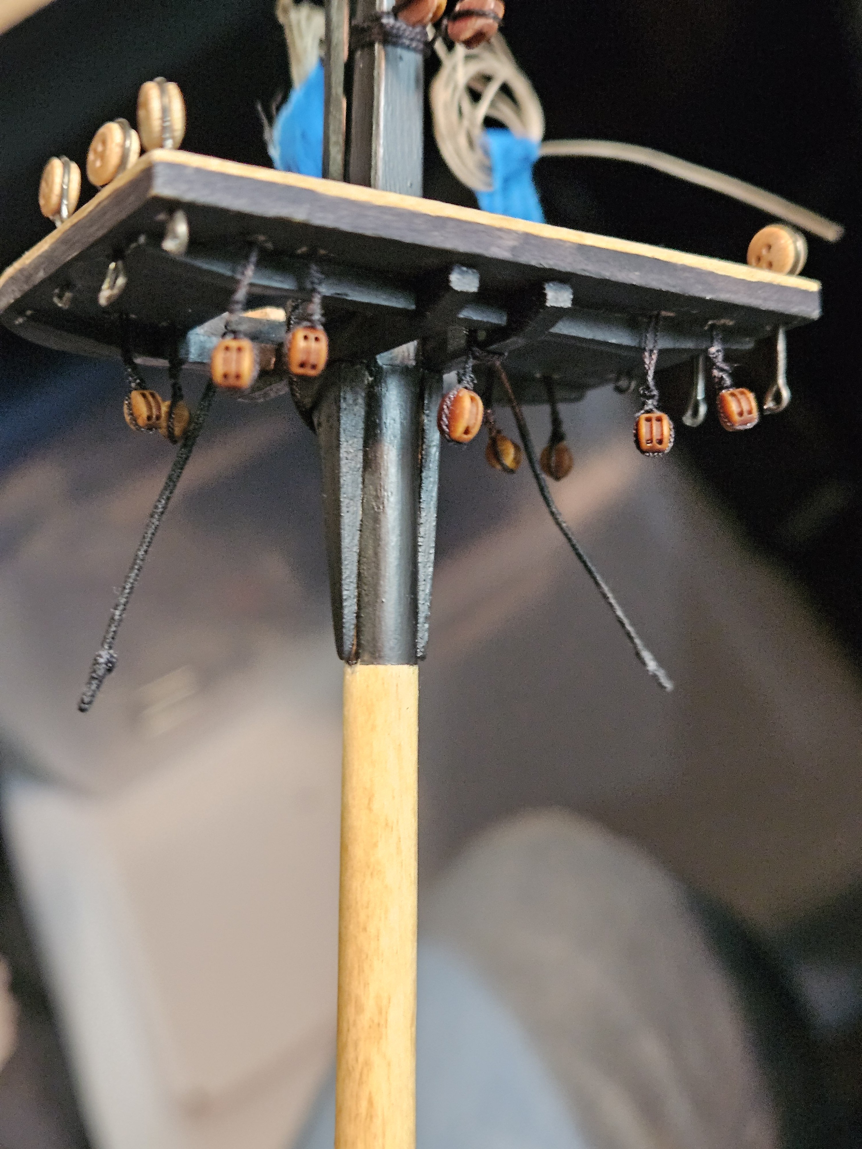

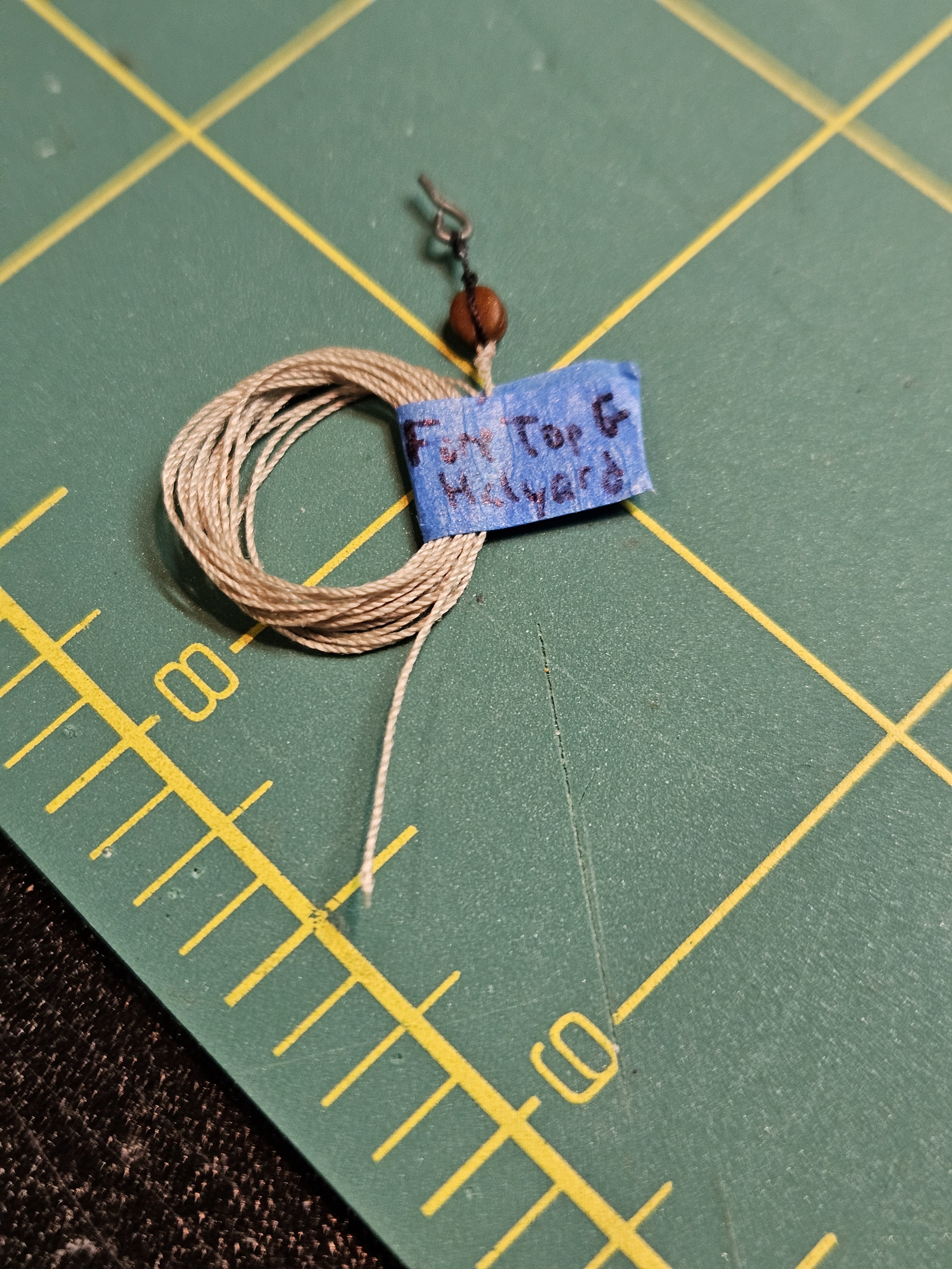

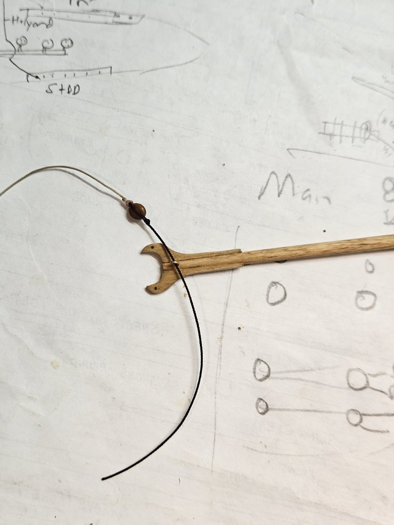

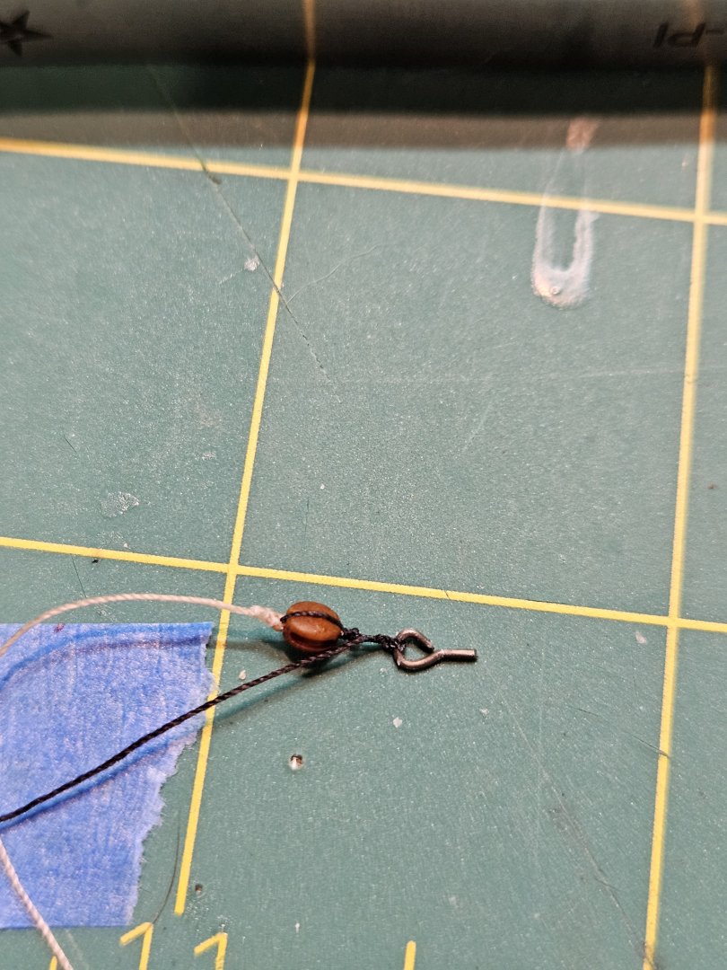

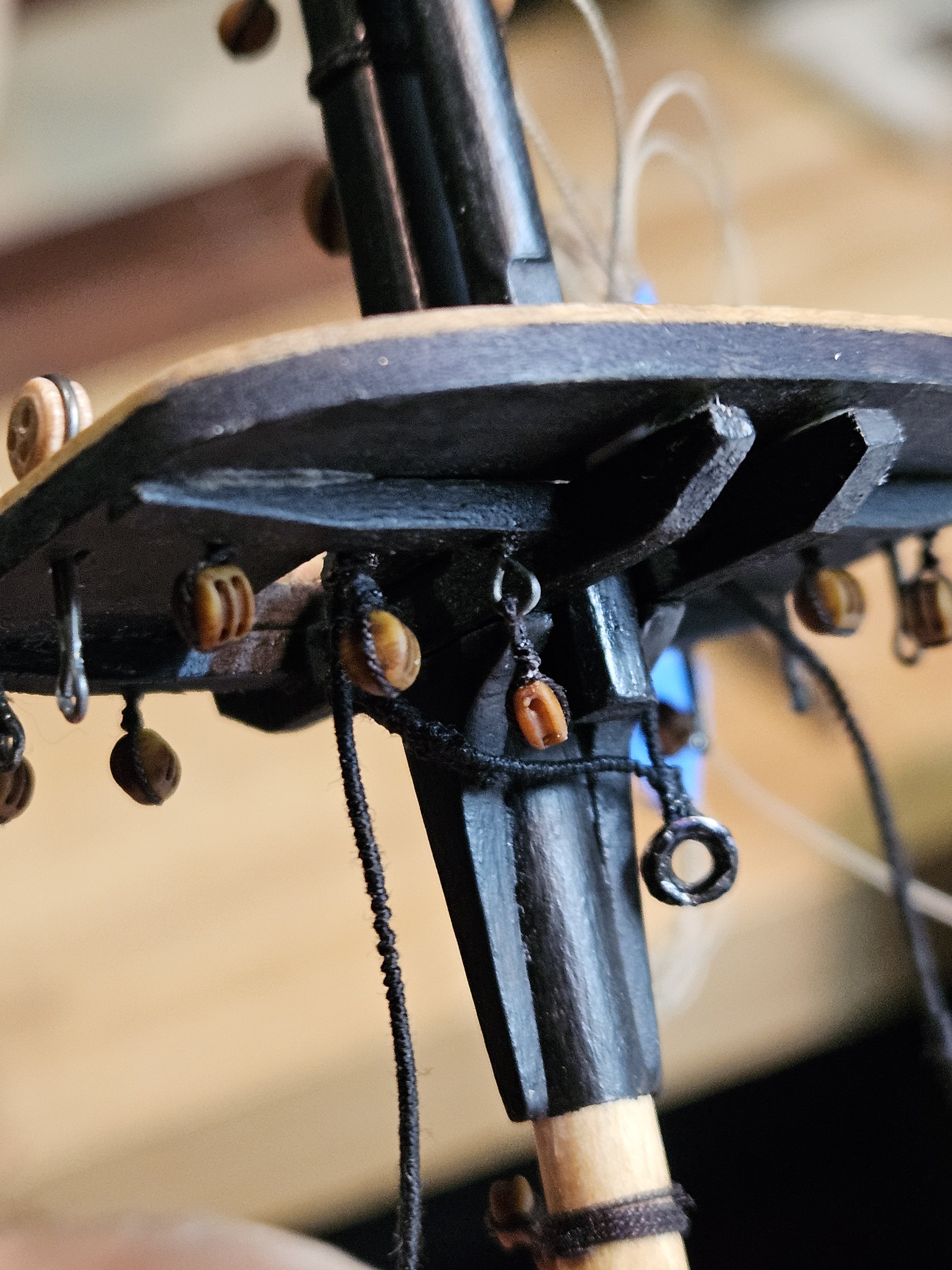

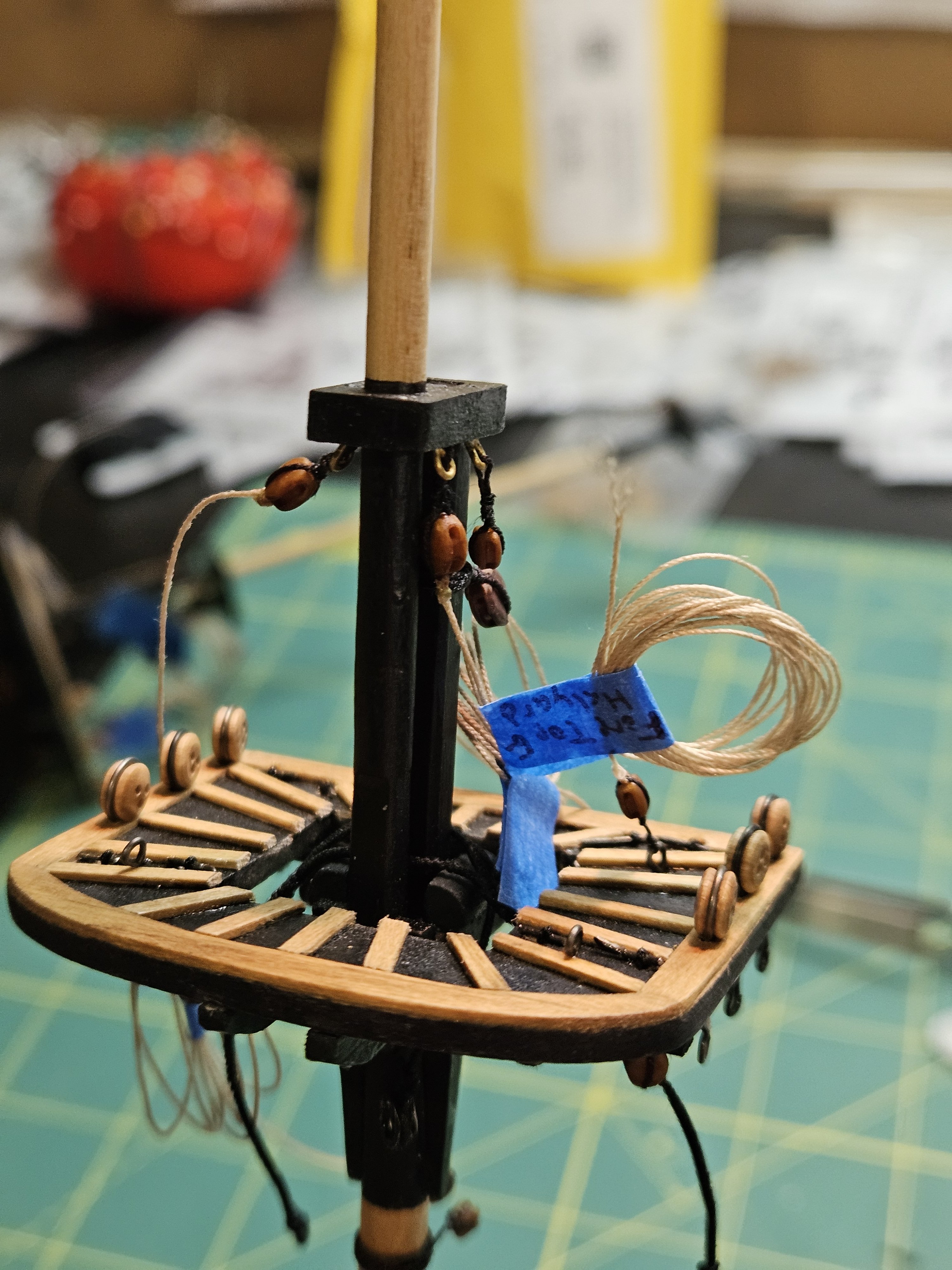

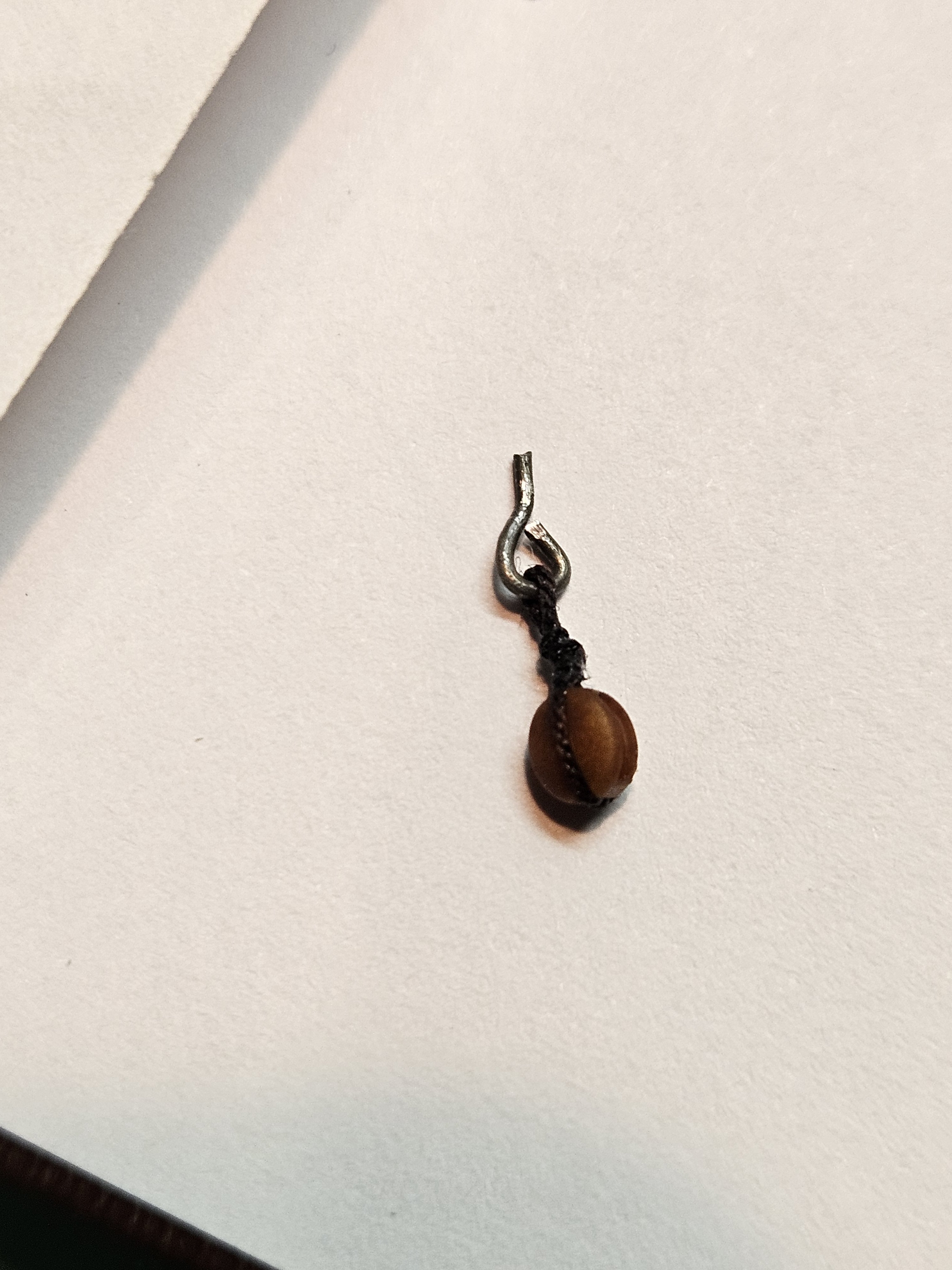

Continuing to pre-rig the Fair American model ship. Before the shrouds are rigged and in the way, I want to get as much on the masts and hull as I can. There will be sails needing additional halyards, so I'm attaching those now. The jib and main stay sails are first on the list.... For the stay sail halyard, I'll need a single block on an eye mounted under the main top....just a small one... I bend these by hand using the ultra fine long needle nose pliers: wrapping annealed wire around the very end of the pliers, then close the eye and then bend the stem straight. Trying to attach a block once the eye is in place will be near impossible to reach, so I'm attaching it to the eye first. Then it gets glued under the top, on one of the cross trees. I moved on to the fore and main burton tackle pendants. Based on the plans and estimating how much length needed to go around the mast head, plus some extra. I wrote the dimensions for Fore on top and Main under. I used the serving machine to make the .030in rope needed. I'm now using the fine black thread for serving, but I still struggle to make satisfactory eyes without them looking bulky, like the right one. After measuring lengths and taping in place, I'll cross over to form a middle eye, add some CA glue and 'tack' to each other. Then follow with seizing with fine thread. The result, again, isn't as neat as I'd ideally like, but it'll have to do. I'm figuring this out as I go, with no clear instructions on how to do this work. When slipping over the top mast, I ran into a problem with the fore burton tackle. the chocks. They were just wide enough to give me trouble sliding the eye down. I REALLY had to work on it, without breaking anything, but I got it down. Used reverse tweezers to hang the ends so they dangle more naturally. They're on there now! Before I do the main lower shrouds, I'm going to need to have access to the gaff and main boom for the spanker sheet now. The throat halyard is in a particularly tight spot. I made a very crude drawing of what I'll need: A block on the gaff jaws, and under the main top, a runner to another single block, with starting tackle for a double block attached to an eyebolt on deck, then belayed to the pin rail. Lots of lengths to get right, so I make sure to add in extra, just in case. You'll remember from several posts back, about how I attach the running and standing rope end (tan and black respectively) to the same block. The reason is the running end has to START on this block and go down; the rope needs to be attached to the block ahead of time. Now I can feed it through the eye made in the gaff jaws for hauling (halyard) up the mast. I'll need to figure out how to do a parrel of some kind later on, because obviously the instructions make no mention of one at all. Seizing the standing rope end over itself with a few turns, then trim close. That's as clean a job as I can manage. And on the after end of the main top, I added a single 4mm block, similar to the stay sail halyard block. This one was tied to the trestle tree and trimmed close. Still working on halyards, and the burton tackle pendants had to attach/hook somewhere on the top. I made a crude schematic for that too. Again, I won't easily be able to access or attach these blocks later on, so I'm making the blocks with running ends, and attaching to eye bolts and attaching the eye bolts to the top now. I won't let the running end of the halyard just hang there, so as with other rigging, I'm coiling it up and labeling with painters tape for later. Here is the finished result. You can see the empty eye bolts for the burton tackle ready to be hooked later. These details are not shown in the spar plan, so I'm discovering these as I go. So it may not look like a ton, but making all the blocks takes time. Plus double checking the measurements and looking at books and the Niagara plans as a guide of how rigging is done takes time. These details can't be rushed. I realize much of what I'm doing is probably not historically accurate, but rather made-to-work-for-me. Do other modelers have this much trouble knowing where everything goes, or is it just experience? As a model ship newbie, I'd love to hear how others have faired. Thanks for reading along. - Jason -

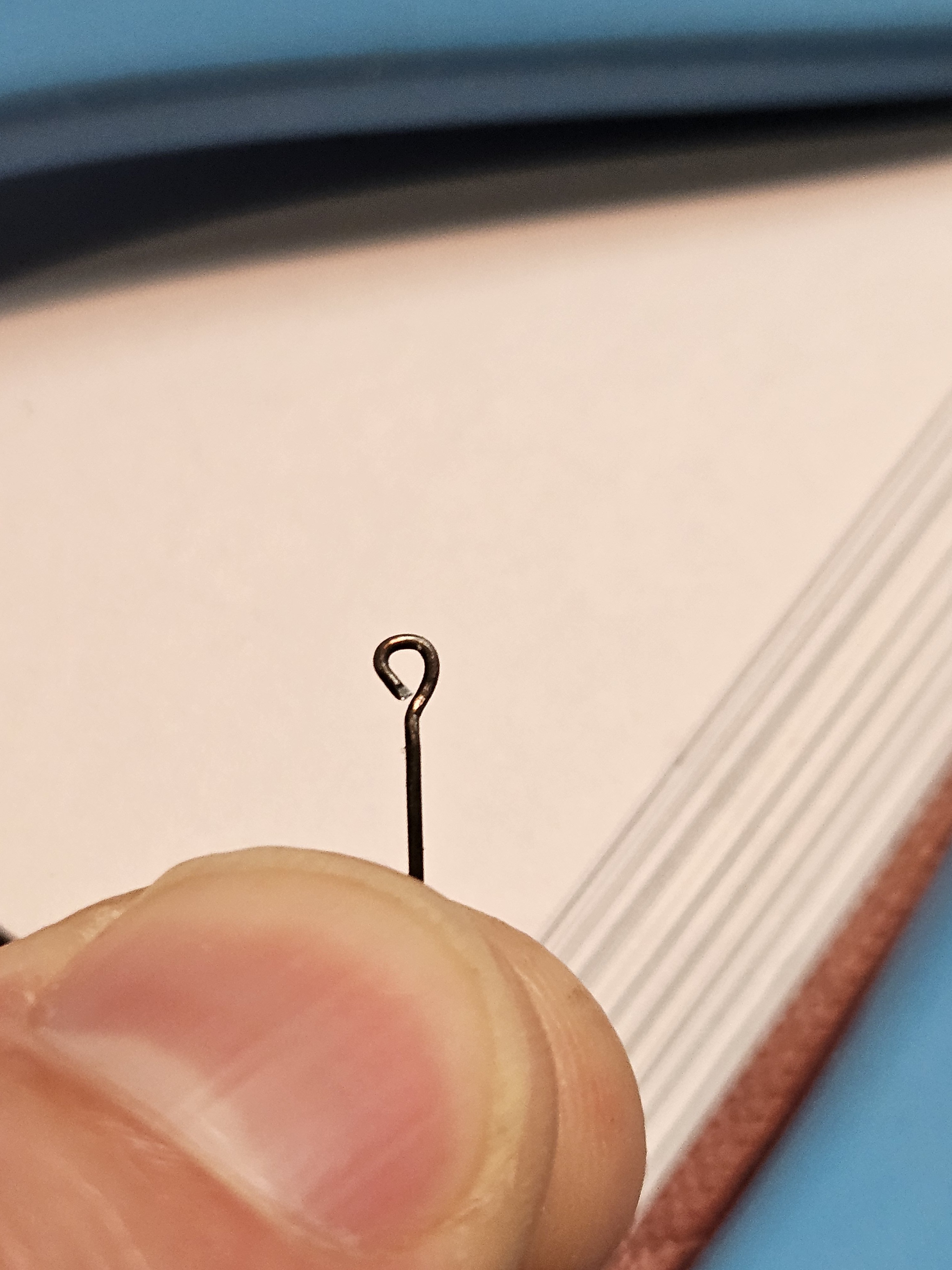

More progress on the Bowsprit of the Fair American: Now that the Gammoning is done, I've moved onto the Bobstay and shrouds. First I needed an eyebolt on each side of the bow stem. Just using some annealed steel wire to make little eyes. Once you get the hang of how to make these with the needle nose pliers, its not so bad. I apparently forgot to mount this years ago, so I'm adding it now. I also made hooks that will 'hook' the eyes for the shrouds. The bobstay will be the first to be rigged. I made a long length of .018 rope, and served it, leaving the ends long so I have enough to trim and mount later. I have a bag of deadeyes waiting, so this is the first one, since i mounted the fore and main deadeyes to the channels and chain plates years ago. Hard to see, but I wrapped the deadeye and tacked the ends close with CA glue, making sure to fold the ends over each other. Once they were tacked, I made a makeshift throat seizing with fine thread, then added two more short seizings mid way and at the end of the rope. Afterwards, the thread gets trimmed close with a razor blade. As shown in the plans, I made a little lanyard spacing tool to go through the hole in two deadeyes for a consistent distance every time. I measured the spacing from the plans a close as I could. The other end gets fed through the hole in the bow stem (which I had also forgotten to drill until now), then back over itself to form an eye. I pulled this tight, and tacked with CA glue and pinched with tweezers to hold until it dried. Once tacked, finished seizing with fine thread and later trimmed. For the lanyard, I made a sort-of figure 8 knot, as per the instructions, but added an additional knot so it wouldn't pull through the hole. I'm using .012in tan rope for the lanyard. After the lanyard is reeved, using tweezers to add some positive tension, while I tacked some glue on the bottom side of the rope to keep it from unraveling. From Petersson's book: Rigging Period Model Ships, it has this really drawing of the deadeyes. I am using this as a guide for how I'm going to do mine. So, after feeding above the deadeye, I made a few turns of the running end of the lanyard, CA glue tacked to stay in place, then seized the very end with black thread. Again, using tweezers to hold the rope in place until I'm ready to trim. It makes a very nice little lanyard. I prefer the tan rope to the black for this part, and I like the contrast it creates. Now for the shrouds, I added hooks to the ends to the eyes mentioned earlier. I have to somewhat guess at the approximate space for the deadeyes to go, since the plans show only a side view, but it has some lateral orientation, so its actually longer than is shown. As before, once I had the deadeye seized in, I have the whole shroud ready. Starting the lanyard and using tweezers to hold in tension while I tack with CA Glue on the underside. And finishing the lanyard with a few turns, to make it look all nice. When I repeated on the port side, it must have been an 3/16" longer, and the deadeye on bowsprit shroud must have been a little twisted higher, when seized: the port shroud is higher and longer than the starboard. Its not horribly obvious, but and obvious mistake on my part. I would likely have been whipped for this, back in the old days but luckily this vessel will not actually be put to sea. As long as you don't look down onto the ship from 3ft above the fore mast, you can't see it. I have a lot of other details to add to the ship to get it rigged, so I will move on. More pictures of progress soon. - Jason -

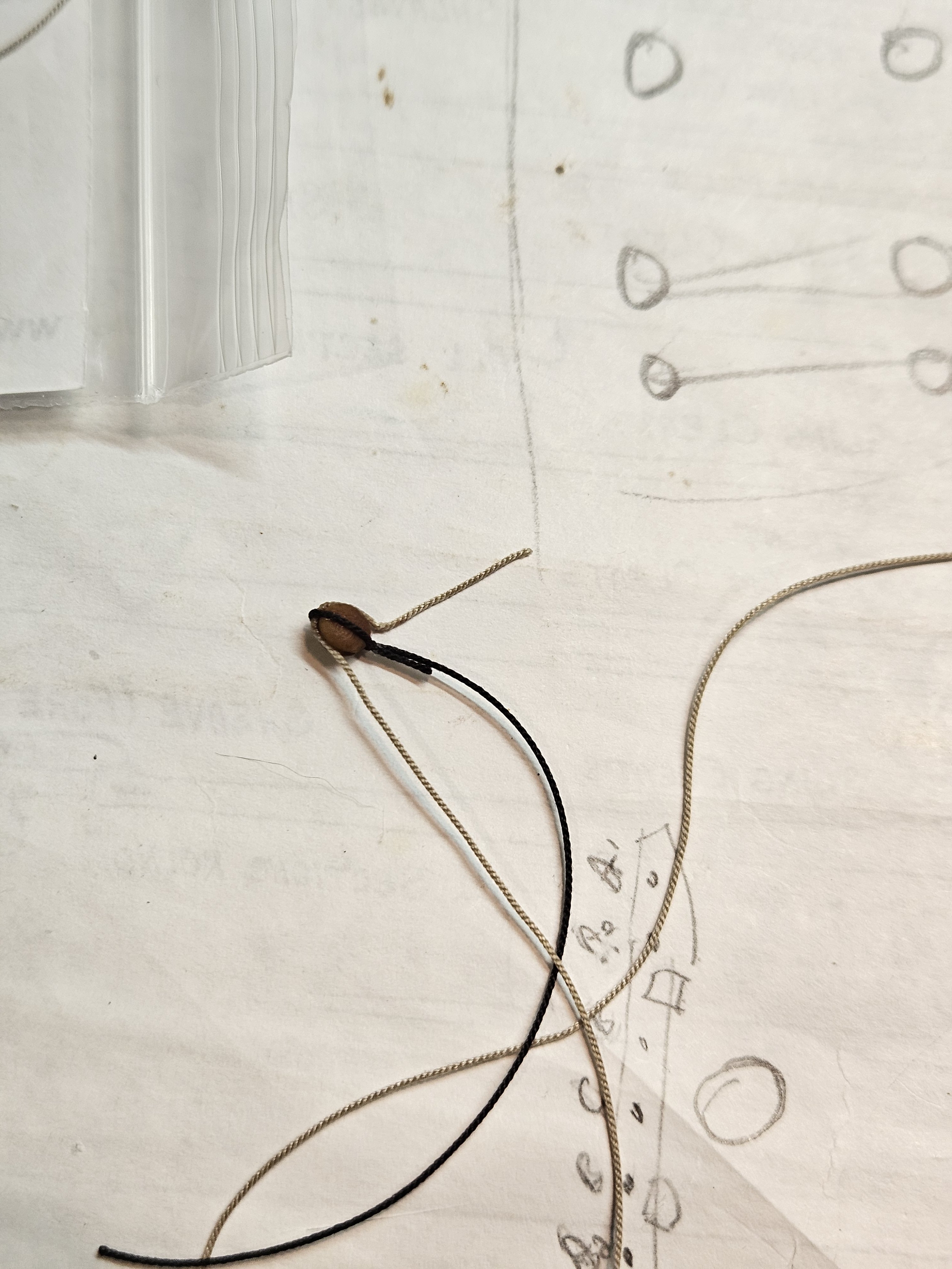

Mounting the Bowsprit to the Fair American: This is the first ''mast'' that will be added to the ship. Once this is glued and gammoned, it isn't coming out, so I have to get this right! According to the instructions, I need 9 turns for the gammoning, using .025in rope. I could only manage 5, as you'll see... To start, I needed an eye, so after roving it through itself, I seized it with fine thread. And then trimmed it close. I doesn't need to be super pretty, since it will be primarily hidden in the gammoning, all said an done. I noticed one problem though: the bowsprit is very close to the head of the figurehead. According to the plans, it is supposed to be farther raised up. So I needed to fix this somehow. My solution was a small chock of 3/16" wide scrap basswood. With this underneath the mast, it looks more correct. So after sanding and painting, it actually matched up pretty well, even though this is a really close-up shot. Much better. I feel confident in the placement, so I can move on with mounting. I glued the bits to the deck, and the bowsprit to the bitts. This is my one shot to get it right, I can't/won't unglue it after this. I've been putting this off for a long time, so that I had all the blocks and other pre-rigging done before attaching this. While it dries, I propped it up on a little lathe tool box so that the bitts doesn't dislodge from the deck. I have to be EXTRA careful as I move the ship around now, so that I don't bump into the bowsprit and break something off. Up until now, I've been able to remove the bowsprit whenever I wanted. Now its time to start the gammoning. Making one turn over the mast, and then through the gammon hole. Following the steps in the instructions for working forward on the mast, and backwards on the gammon hole. After each turn, I would dab the rope with glue and let it ''tack'' before starting the next turn. I wanted this to be as neat as possible, so I'm pulling on the rope end as it dries so it won't sag later. I'm also tacking the gammon hole with glue so that the rope doesn't fall out of place as I wrap it. You can see how I've used reverse action tweezers to add tension while it dries. When I got to the 4th turn, I realized the gammon hole is not long enough to carry 9 full turns. I might get 5, if I'm lucky. There's no way for me to expand this now. The rails are already in place and I am not taking them off. There's no angle for a drill or a file to reach either without damaging existing rails. I'm going to resort to just 5 turns. This was a oversight 6yrs ago when it got drilled. The 5th turn almost broke me, and the ship. The 4 turns of rope were already really stuffed in the gammon hole, that I couldn't get it through. I literally spent 2 days trying before I fed it through. This consisted of stiffening the end of the rope with CA glue and stuffing it in the hole. Then it got stuck....majorly. I also attempted to use a needle to push it through - wouldn't budge. I also couldn't grab it with tweezers, because it wasn't long enough. I had to walk away one night, and come back the next day or I'd lose my cool. Finally after 3hrs of pushing with a tiny drill bit, there was just enough of the end peeking through that I could grab with tweezers. After it came through, it was really shredded. What a relief, though; I got it through. In the process though, on the port side, some things broke. Nothing important of course.... I decided to deal with this later, after I took a few days off to cool off. I needed a mental break. Of course, I also didn't make the gammoning rope long enough to finish the cross seizing, so I just tacked it in the middle on the port side. I used a separate length of .025in rope to do the cross seizing, then trimmed it short. The bitts needed to be glued some more, since it came loose. I just used some white glue on the deck line which dried clear overnight. Even though there are only 5 turns for the gammoning, it still turned out okay-looking. Last thing was glue the rails and knee back in place A lot of frustration, but the Bowsprit is mounted! A milestone for me! Now I have to not bump into it and break off the jib boom. Its starting to look like a ship now. Thanks for following along - Jason-

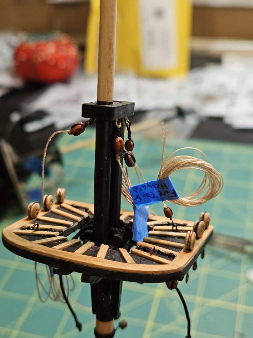

Continuing to make progress on the Fair American: Prepping the fore Topsail with buntline and leechline blocks. It's much harder to clovehitch these underneath the sail, once the sail is on the yard. I could have attached these first, and tucked the sail underneath, but I felt that they'd get in the way. I ended up using a needle to help feed the rope under the boltrope of the sail. Sort of worked, but still difficult to 'grab' the ends and also have them dangle in a way I was happy with. But it's done, and I'm happy with how the blocks hang. The leechline blocks are about halfway along the head of the sail, on the yard. The buntline blocks are not directly above the cringle, but just inward. I also placed it between other existing ropes for clue/sheet blocks, which are aft. In continuing to prep for the sails and all it's components, I am also going to add bowlines. The blocks for these need to be in place on the masts before I really get to the rigging. I'm doing all of this up front - i hope it pays off. We have the Fore Topsail bowlines, which go forward to the bowsprit cap ''somewhere''... The Fore Topgallant bowlines, which go to blocks on the Jibboom And Fore course bowlines reeve through blocks behind the Fore Stay... On the Jibboom, I already had a block for the Topgallant stay, but I am repurposing it as the Jib staysail downhaul, and the existing holes/sheaves will be for the stay itself. There is VERY little room up here, so attaching the block(s) were extremely challenging. The strop-rope kept un-looping. itself. Kind of crammed in there, but I got it done. Two bowline blocks ready for 'service'. Though they don't exist on the original plans for the bowsprit cap, I added two eyebolts to attach the topsail bowlines blocks to. Forced some room in for the remaining Fore Course bowline blocks. I'm looking at the wealth of books and plans I have for the belaying points for bowlines. With the existing pins on the ship now, I may end up doubling up on some pins. More on this later. Moving on to the preventer stay and heart next. Once the lower shrouds are rigged, I won't be able to get access to attach this little guy, so I'm doing it now. I'm not sure what size standing rigging rope to use here, so I'm going with .018in. After serving it with .005in Mara 220 thread that Chuck suggested, that adds .010in in diameter, so it's about .028in I carved the heart to this very specific shape and dimension. It was very easy since the plans and instructions provide absolutely no measurements whatsoever. This is best attempt. I'd wrap around the mast, and add a drop of CA glue and ''tack'' the rope ends together, and let sit overnight. I don't want it coming apart when I add the heart. I added some turns of 220 thread to keep it together. Then I spread the running ends out forming a 'flat' of sorts, and a blot of glue to tack the heart in place. It worked initially but then kept falling out when I went to finish the long ends around. VERY annoying. The serving also started to unravel, so I needed to fix it...somehow. I ended up abandoning this two rope end approach, and cut one off. Instead, I wrapped the long end all the way around the heart past the flat spot. I fashioned a sort of throat seizing there. Getting it tight enough and not-falling-out-enough was very difficult. Tweezers and rope and fingers got in the way everywhere. Finally got something satisfactory, and kept seizing with fine thread. Trimmed the end close....It turned out better than I thought, but what a pain. I also added a small drop of glue to the mast below where it will finally rest, then slid the loop down. I don't want this thing sliding up and down the mast, so it's where it belongs now. I also managed to add the main topgallant brace blocks, for the running ends to the Fore trestle trees. The final thing I went about making was the Lead block for the Main Topmast stay (Letter I.) This needed to be a 3/16in block, so I used .018in rope to secure it to the mast. Because of the square cross section, it was difficult to clove hitch and have the block at center, so having it just to one side, and a slight tail - it will be centered enough. There were no chocks on the mast to support its height, so just a few dabs of CA glue, blotted with my fingers was sufficient. That's all for this week; I plan to post more progress next week, if I can. I've got some momentum going... Thanks for reading/following along - Jason -

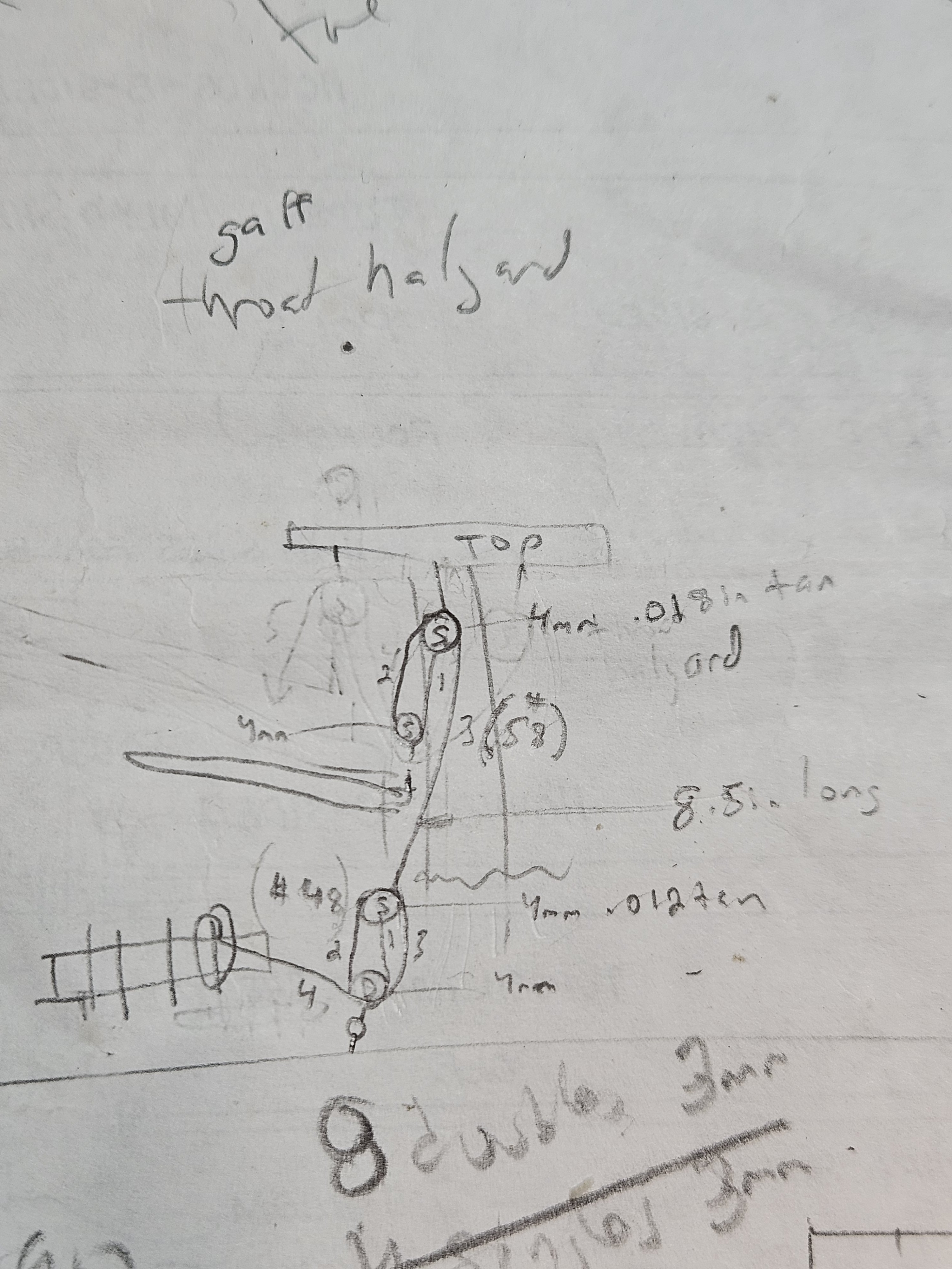

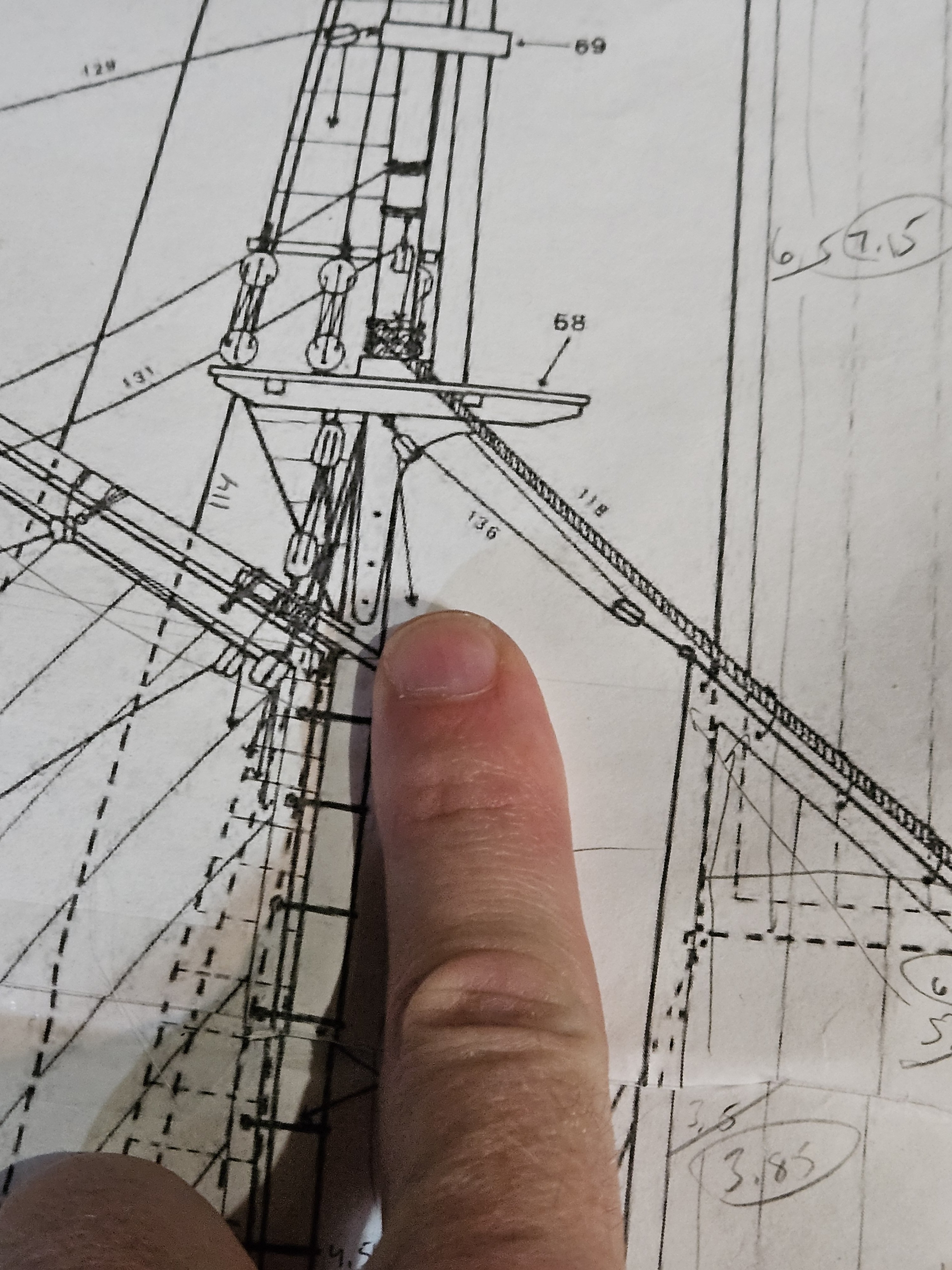

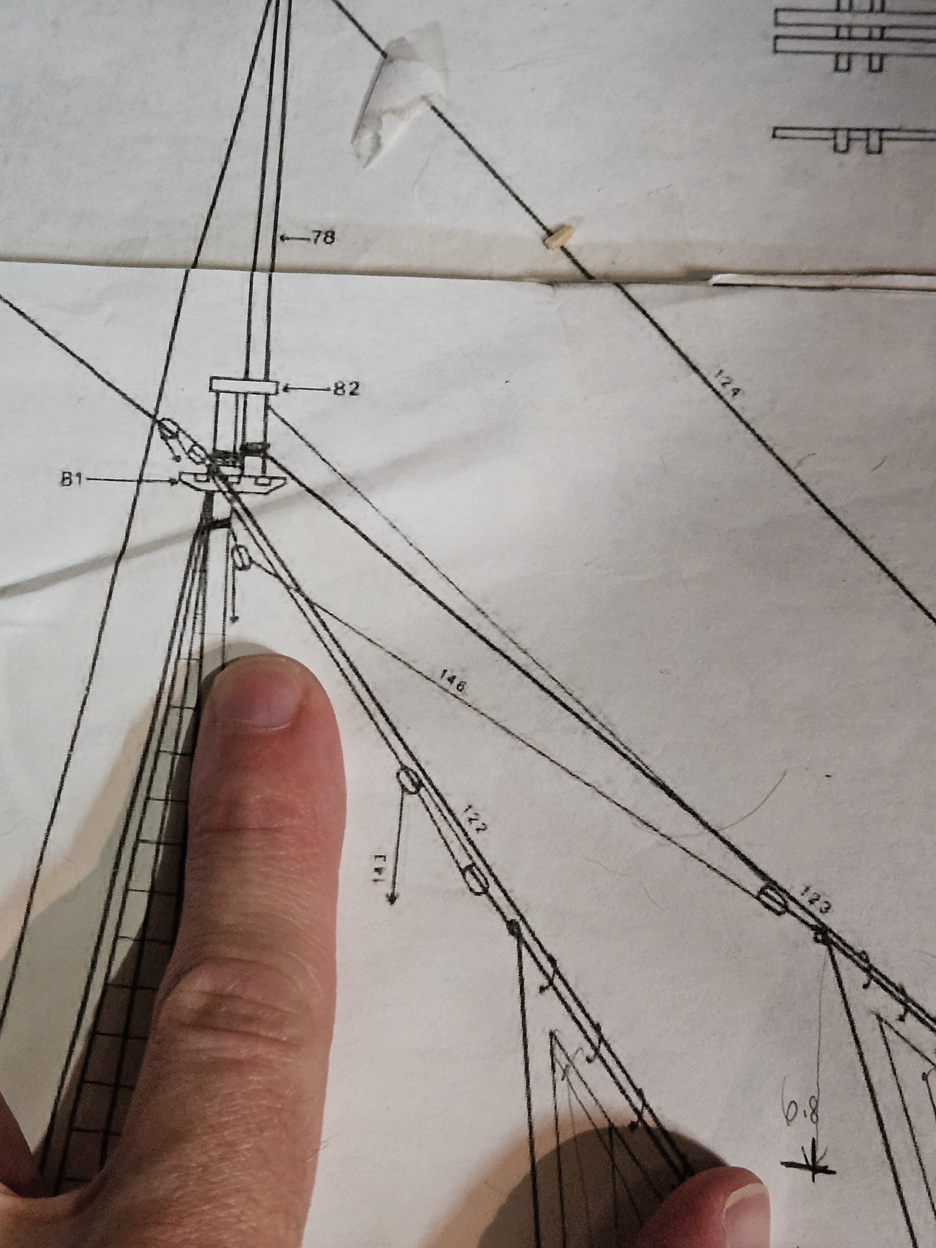

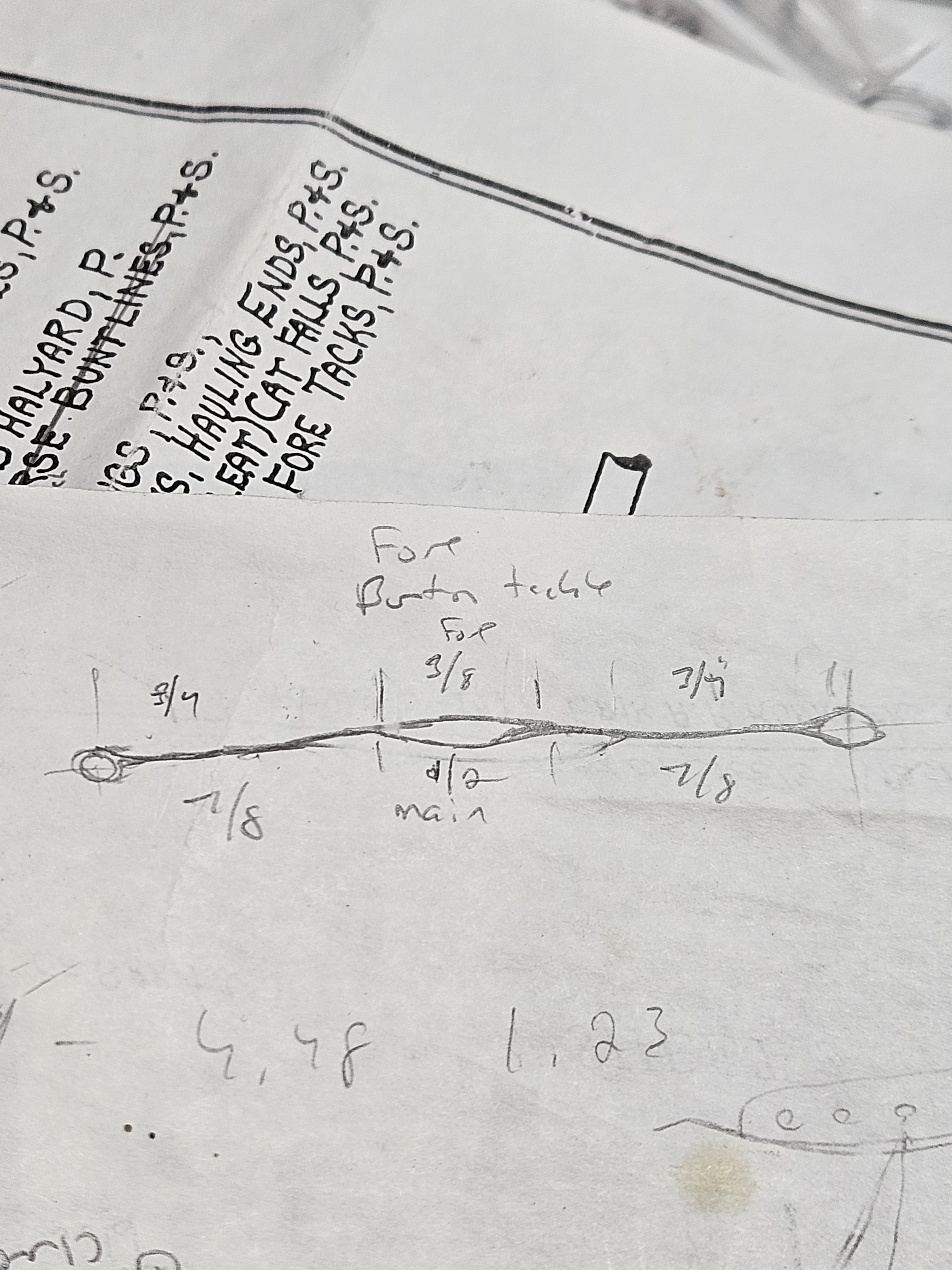

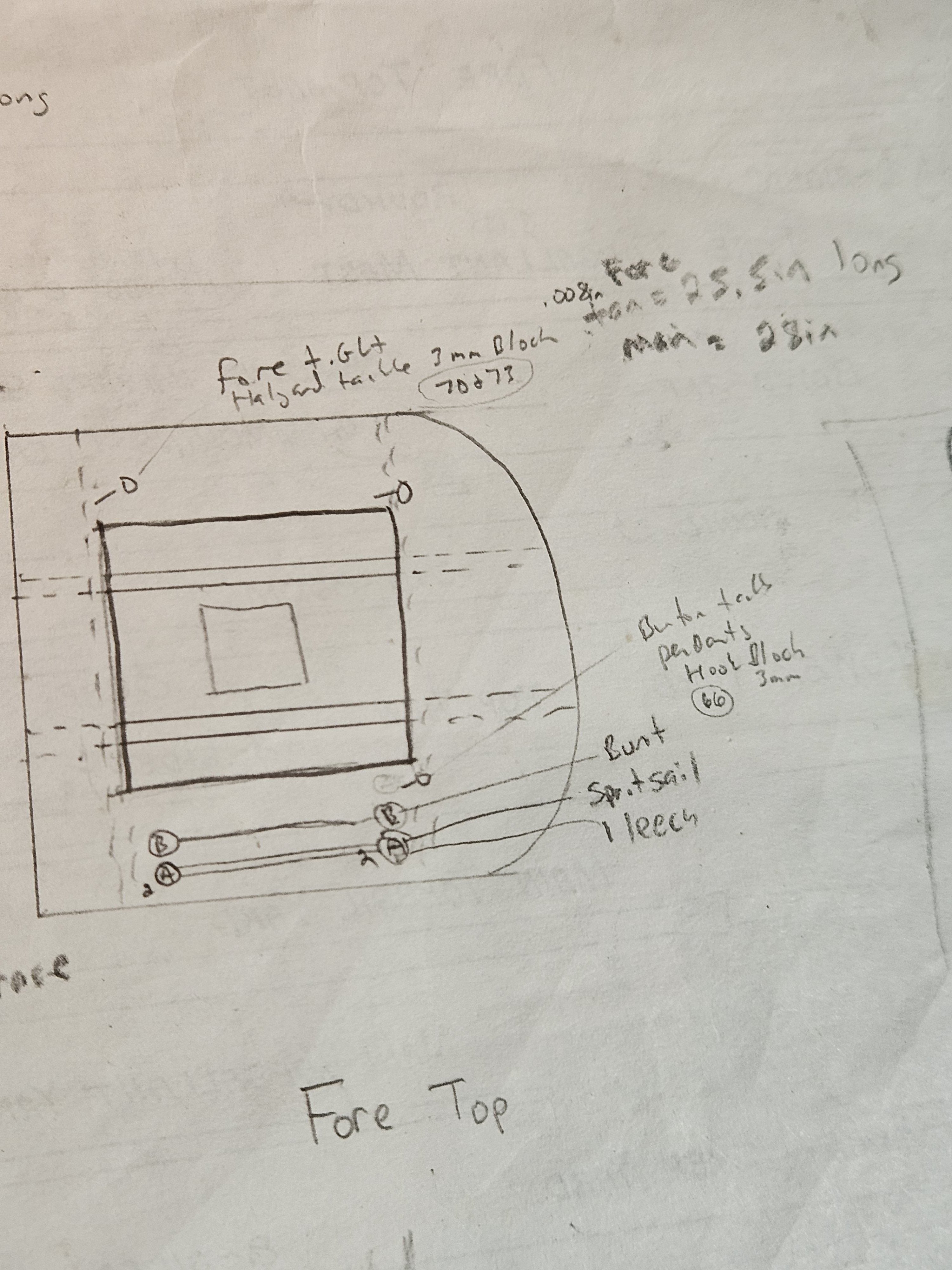

Continuing with Fair American mast preparation.... Lot of progress this time... I've moved on the to the Fore Topsail Yard sling. I had to study the plans to attempt to understand how it's rigged. I made a drawing of how it looks like it goes. The runner goes to a single block, which then goes to tackle on one fall, and the other fall goes ??? somewhere. The instructions are no help either. I cannot for the life of me, understand where this fall goes. Because of this, I'm going to omit the runner block entirely and have it go directly to the tackle double block. This will not apparently be accurate, but I will be able to sleep at night. For the tye, as per the plans, I turned it round the topsail yard, and double seized it as neatly as possible, and made the running end extra long, so I can seize a double block for the tackle later, once its gone through the topmast sheave. Getting all the blocks and ties on the yard, before I attach the topsail. Using the Vulcan trim technique I described previously, I also made the lift blocks for the topsail yard. Coiled and labeled for rigging later. As before, looping the standing end rope through the eyebolt and over itself again, before seizing with fine thread. When it's done, it will hang and move more freely once the lifts are rigged. Again, making it as neat as possible. I did both sides, then hung the cap on the topmast until I'm ready to secure it with the topgallant later. Moving on the the yard parrels. These will go around the topmast and down. I am not adding the yard yet, so I'll build the parrel and loop it around just one side for now. I'm going to try to make the eye small, by looping one end through the rope itself, then seizing with thread. It didn't turn out too bad, but I was only able to get one loop through, instead of the two I wanted. It just means I'll have to trim the end off super close. Best I can do.... For the beads, my wife had some small ones for making bracelets. They come in a set of many different colors and shapes. These little 1/16" ones will do just fine for me. The ribs for these things are really small. I had some left over 1/32" planks, so I just roughed out a shape from there. I drilled the holes first before shaping them. I won't be able to hold these little things to drill later... This is what a scaled rib looks like, compared to the instructions. I used the needle files to make the B shape, while it's still attached to the plank. I need 6, but I'm only making 5, since I broke a couple. Frustration is winning out here. Finally cutting it free with a scalpel, then I'd grab the round ends in my fingers, and file the flat end straight, since the cut is a little crooked. Once they were all made, I fed 5 ribs and 4 beads/trucks through the top hole, up to the eye. Then around the yard between the cleats on the starboard side. So that it doesn't come unraveled later as I handle the yard, I eventually run the running end through the eye temporarily. After the Tye and parrel is done, I went about securing the topsail to the yard. I used my ''clamp one side, and robband the other to get it started'' technique as before. I add two robbands per strip of canvas. I make sure the sail is mostly forward, and not hanging under the yard too much. The thread gets trimmed close, once the dab of CA glue is dry. The scalpel makes 'sharp' work of that. The scissors can't get close enough, I've found. The Topsail bunt and leech lines go to a double block, attached to the cross tree. I'm also following Steel/Peterson for where the blocks should reside. Those were just 3mm double blocks, one for each side. I make the standing ends an inch or two long, so that I have enough to clove hitch them to cross trees. I'm attaching them close to the mast. Afterwards, I'll blot with CA glue twice to make sure the knot doesn't come undone. Then I'll trim the end close. While the glue dries, I use tweezers to grip and hang the blocks so they're not sticking forward. They actually need to hang. The finished product makes them look like earrings. I was off the Labor Day week on vacation (at home), so I got a lot done. I've been riding the momentum as much as I can, since I want to finish by the end of the year. This is a fun project for me. I'm enjoying all the challenges and skills to make a fully rigged model. I can't stop now!!!! Have a good week, all. - Jason -

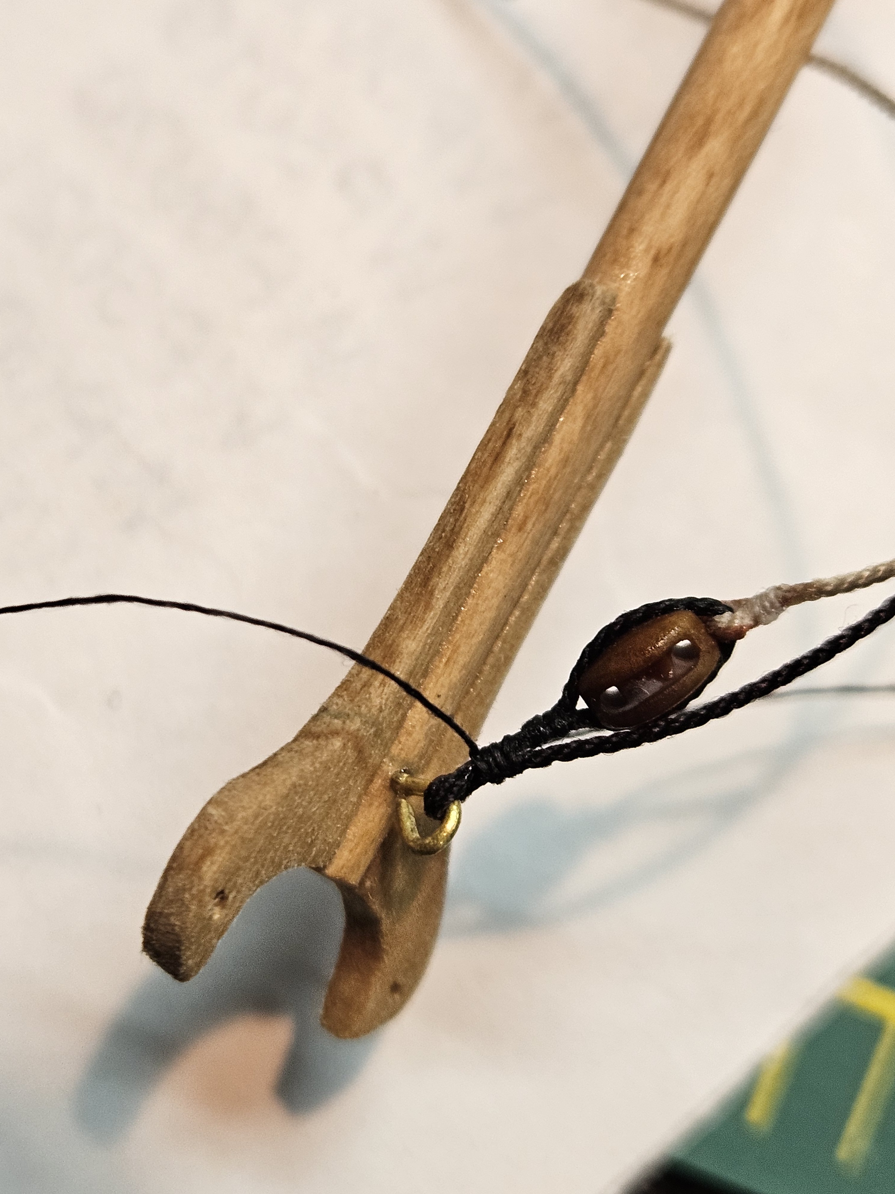

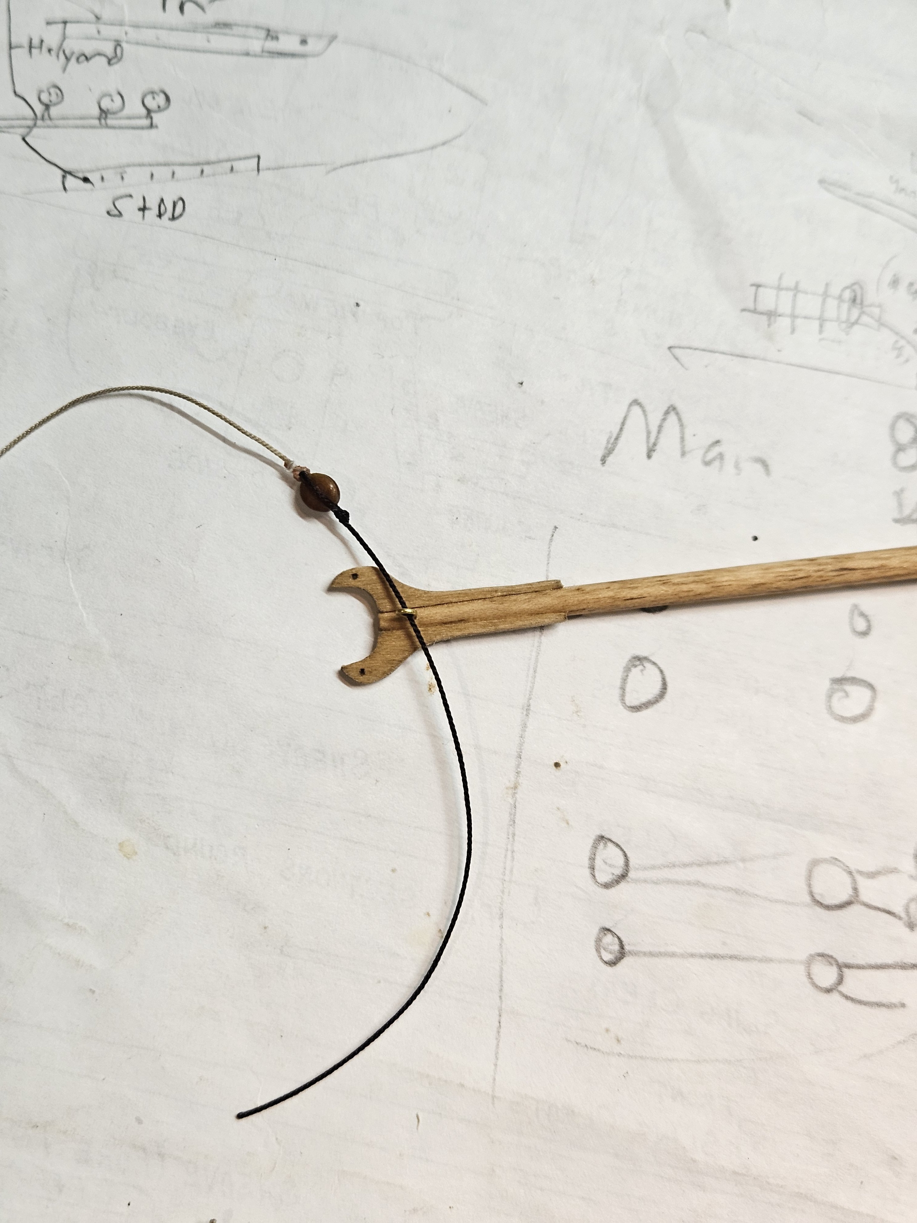

More rigging prep on the Fair American... Replaced buntlines and leechlines for the lower yards. I'm using clovehitches to attach each block to the yard, and leaving a short tail so it moves more freely with rope. Once tight, a drop of glue and blotting with my finger a few times so it isn't too shiny, then trimmed short. Also, the sheet and clue blocks turn out looking very nice now. As stated previously, the main lower yard braces are rigged forward, not aft. I added two 4mm blocks to the foremast, again leaving some short rope tail to allow for natural movement once running ends are fed through. You can clearly see the kit's wonderful rigging plan drawing of these blocks between 24 and 59. Moving along with replacing on the topsail yards with new Syren blocks. According to the Fair American plans with sails I found online, the topsail yard lift has two blocks, one on the mast cap. So I'll need to add some eye bolts there. I've shown this a long time ago, but I bent the eyes myself with fine needle nose pliers. They look crude up close, but they're rather tiny as you can see. The cap isn't glued in place yet, just visualizing where it'll be. As before, I made a drawing of the rigging layout, approximating where the yard will be, once raised. Also making sure to measure correct length of rope for the running end, which starts at the mast cap lift block The following is an account of how I stropped blocks from here on out. Now that I have the ultra fine thread, I can make very neat blocks. I'm sure there are many other ways to do this, but its the most effective, yet tedious method I came up with. I have to attach the running/tan end first, where the black stropping rope is going to loop around later. My method is to wrap the running end around the block, perpendicular to the notches, covering the holes in the block. I'll pinch it in place, and add a drop of glue to 'tack' it, then blot with my finger a few times, so it's not too shiny when it dries. Now it's tacked on there and won't fall off while I do the next part... Now I can wrap the black stropping rope around, feeding it into the notches, and going OVER the running end, trapping it. On the opposite end, I'll add a small drop of glue to the black rope Before it dries, I'll pinch the ends together with my fingernails. When I release, it's tacked together temporarily This allows me to make an overhand knot with fine thread, and pass it over the pinched ends, up close to the block. I'll make two overhand knots, pulling tight. Afterwards, a dab of glue, and blot with my fingers a few times so this 'seizing' is set. Then it gets trimmed close with a razor blade - both the thread ends and the short rope end. Once that's done, I can fold the running rope back over itself again so I can repeat on that side... Dab of glue, and pinched between my fingernails until dried/tacked. Adding two knots of fine thread, as before.... This is the key technique for trimming that works the best (for me): I hold the block with my thumb and forefinger. Using my pinky and ring finger to hold the thread end, and pull down by stretching my fingers. This is the Vulcan-Trim. Star Trek comes in handy here: ''Live Long and prosper" I'm doing that with my fingers, practically. It adds tension to the thread. I'll take a scalpel and slice the thread as close to the knot as possible. Then I'll flip and do the other side. I have to remember to keep the thread ends long, so I can grab them. Too short, and my fingers won't grab. So that's how it's done. A stropped block with a running end seized-in, Vulcan-Trimmed. Its tedious, and that's just one, but I feel very confident in the method. I give the ends a good tug to make sure they're snug. I make sure to coil the running end and labeled properly, so I know what it is later. An finally, secured to the mast cap on both sides. It takes a while to do all this, but worth it in my opinion. I'm doing as much block rigging as I can, off-model. Once the masts are mounted, I won't have near the accessibility to these components. Lets hope it pays off in the end. Hope you enjoyed reading. Have a good week! - Jason -

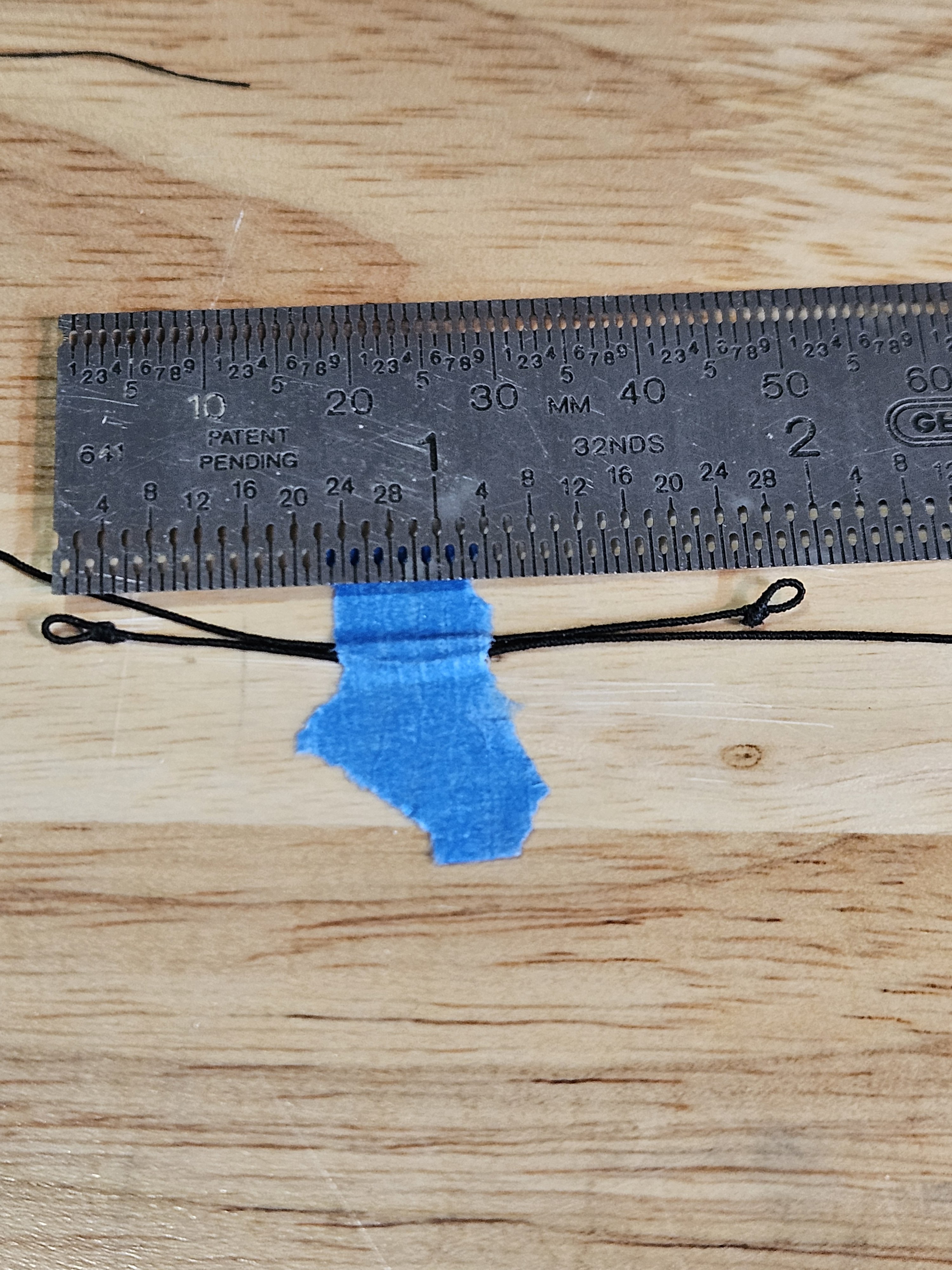

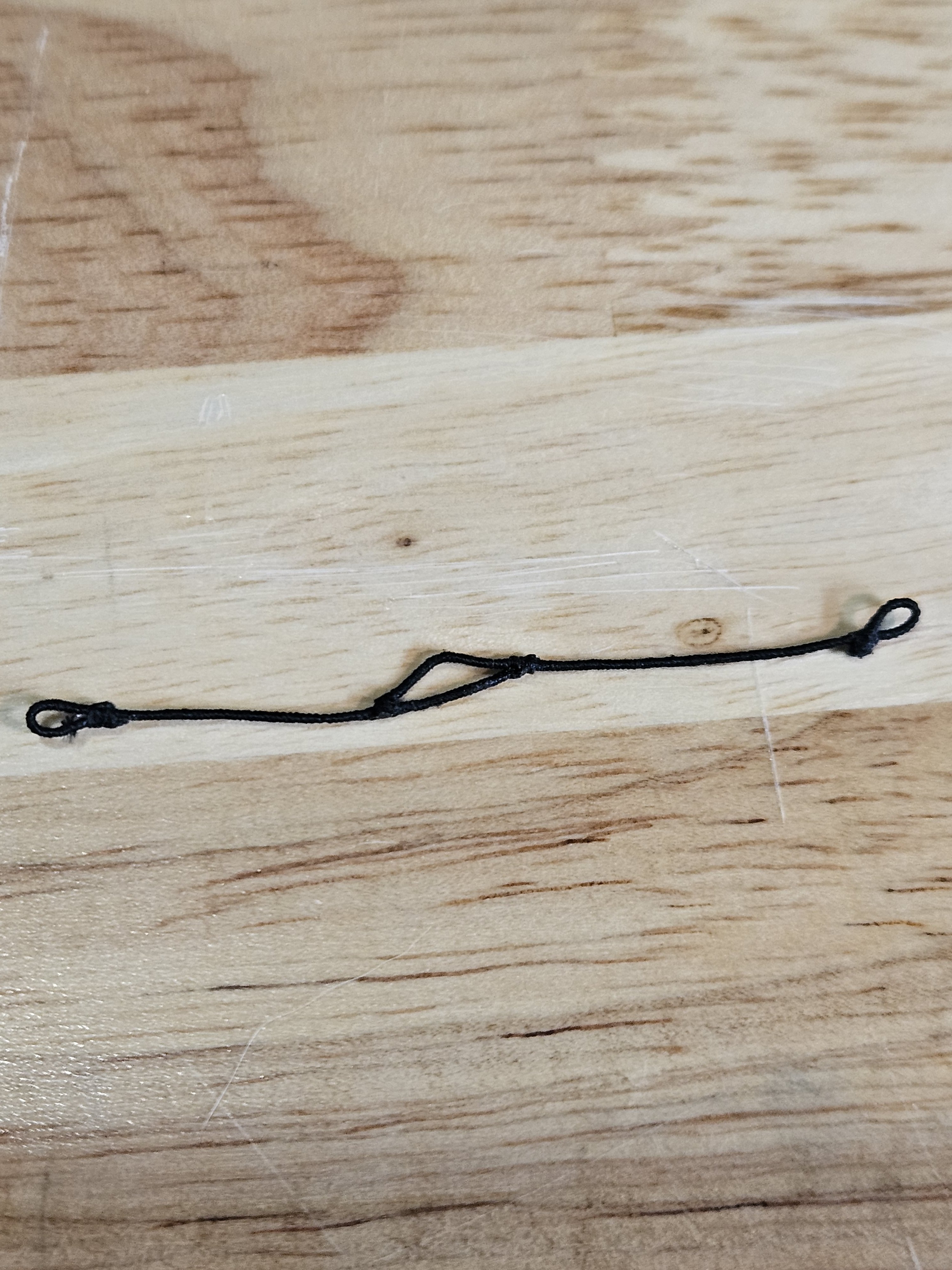

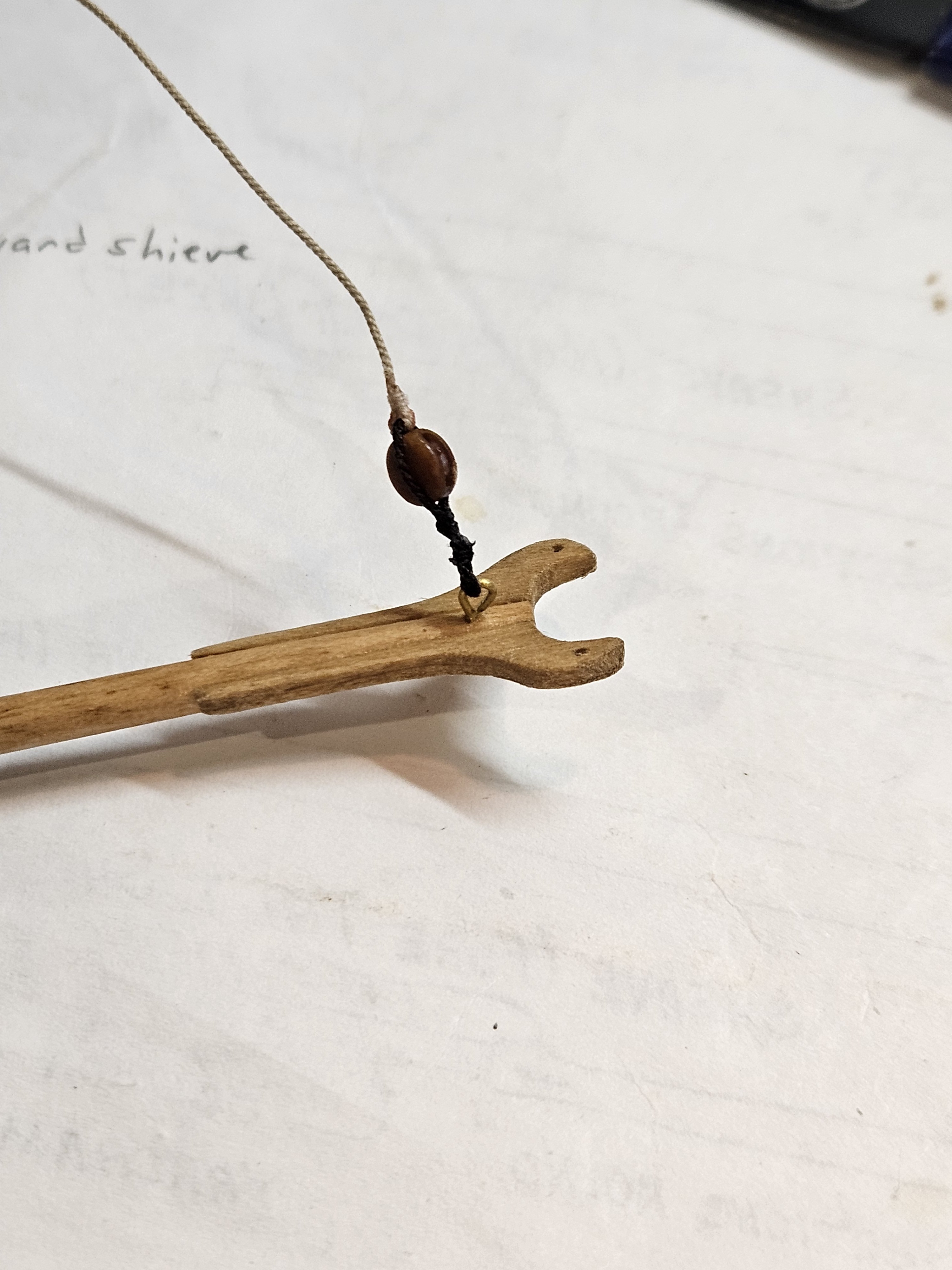

Additional progress on the Fair American, prior to the Conference: The Fore Yard Sling was next up to be added to the mast. Like with the Main Mast sling, seizing a metal thimble into served .018in rope. Making tiny eyes, and measuring the length right, to wrap around the mast.... Looping around the first eye to form a second, and seizing it with fine black thread. Holding it at the right height with reverse action tweezers was challenging, while tying everything, but I got it done. Using a needle to help serve/seize the ends made things a lot easier. I wouldn't be able to do it with tweezers as readily. After its done, it's kind of a knotty mess, especially having to trim things close. Again, I wanted to make it as close to how its shown in the instructions, all perfectly blended and served down. The bobstays were up next. Again, like the main, I served .018in rope in two lengths. Then tacked on side together with CA Glue, so that the middle was at the right distance I needed, or estimated from the second. This is just to hold it together for when I seize it with thread. I let it dry over an hour just to be sure it didn't pop apart. Afterwards, I'd seize one side with black thread, as neatly as possible. Then I'd wrap the other two ends around the top mast, and seize the other side, tacking with glue first. Once both sides are done, I'll use tweezers to hang the ends so they drape in a more natural manner. Also started stropping 3/16" single blocks for the Main boom. It wasn't easy to see from the rigging plans, but apparently there are two. One for each side. Since they'll both be attached nearby to each other on the Main Mast, I can't really understand how they'll be useful - they won't act like braces. Anyway, I'm using .018in rope to strop the block, and seizing with several turns. Then once its got some CA glue, I'll trim the threads close. A matching pair of Main Boom Topping Lift blocks. These aren't pendants, but long stropping rope to hitch to the mast. The rigging plans don't show HOW. The best way I could see to rig these to the mast, was to use a simple clove hitch as close as I could with the each block on either side.... You can see each blocks have their hitch on one side, so they're not crammed together. After they've been glued, I'll trim the ends close, so it looks neat. Next post will be with me beginning to replace ALL the blocks with higher quality Syren Ship Model Co. ones, as per Greg Herbert's suggestion. Have a great 4th of July, if I haven't posted by then. - Jason -

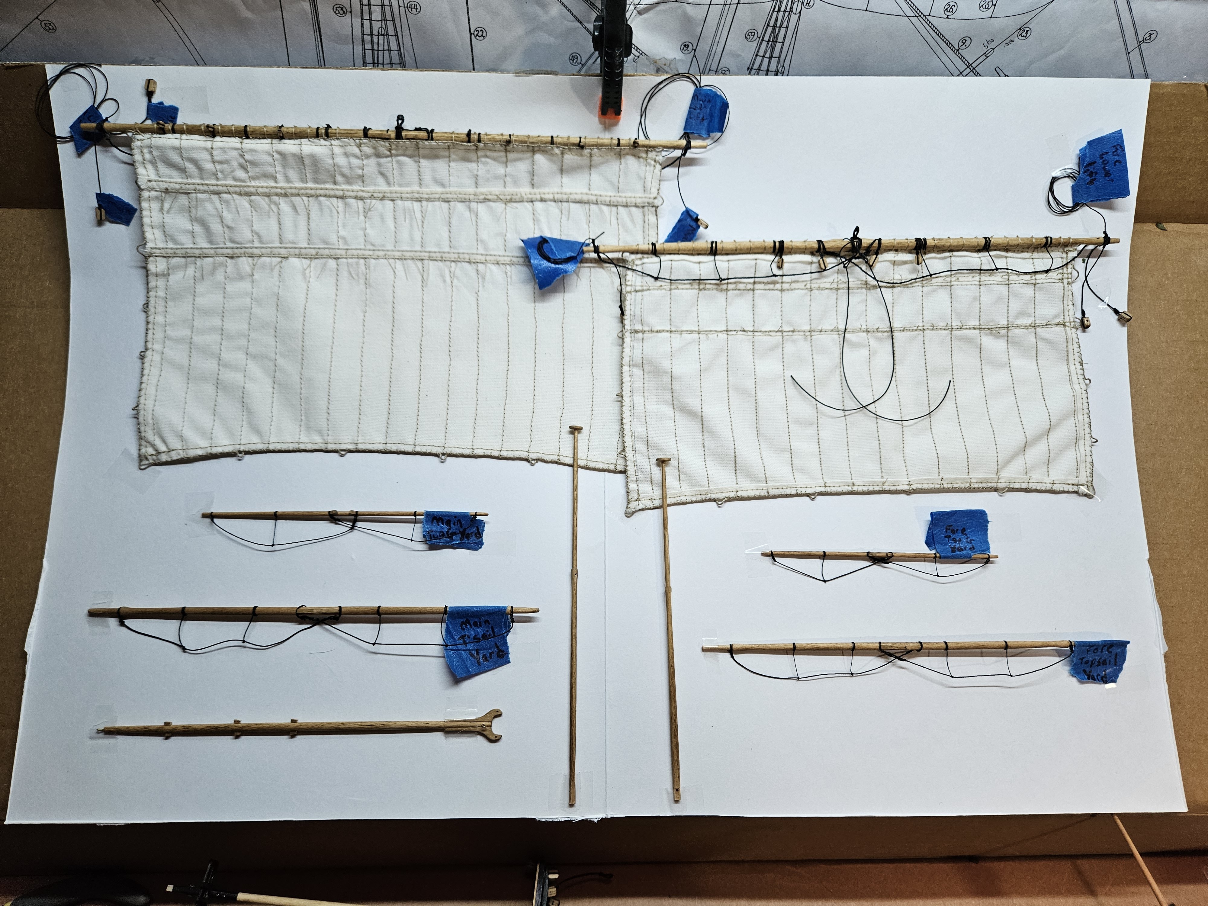

Progress on the Fair American Its been a while since my last post - I wanted to include some back detail on the Main and Fore Lower yard and sails, which happened before the Conference. In short it went well. Of course it rained on the day, so had to get creative on how to cover things without breaking them, but I got all set up. First time displaying my ship felt pretty good - not museum quality, but proud to have it there anyway. Fellow modeler Cisco set up shop right next to me - his all Holly AVS is pretty impressive work, I have to say. Conference was better organized than when I went 2years ago. Having talks and demo's in a separate room and distinct times made the day go smoother. The last 5min packing up was the most attention I got. Several people apparently were building this ship, or had. Greg Herbert, was kind enough to send me his two Fair American Instructions, and suggested I replace the kit blocks with some better quality ones. I have since started doing that - more on a later post for the Main Lower Course, I held either end of the lower yard with some old magnetic lathe stands and some painters tape. Crude but effective. I'd star with tying a robband around one corner of the sail... And then the other side. Now I have it suspended, and I can finish the robbands, working from either end. I followed some illustrations of the robbands from Steele, where it showed two per strip of canvas. So that's what I did, using a needle to make 2 turns around the yard, through the same hole, and finished knot on top. Tedious, but I got it done. Preparing the Fore Lower Yard was next up. I added all the bunt line 1/8" blocks to the yard, with clove hitches and trimmed close. I tried to angle them in such a way that when they are rigged, the lines wont chaff the yard, but instead belay to the blocks under the mast top directly. This means they stick forward a bit. I also made the Fore Lower Yard Braces, using 5/32" Single Blocks. They are about 1.5in long pendant, so I seized the eye so that it would fit tight over the yard end. I add some simple tape labels so I know which block is which. I fashioned the yard trusses from .012in rope. Seizing the individual eyes close enough to the yard was very difficult. You only get one shot, to get them the right length. Also didn't forget the Fore Lower Yard Tackle Block. This one was 5/32" Double block, and the pendant was about 1.25in long. I had to remember it's only on the starboard side, as per the plans. In a similar manner, I suspended the Fore Lower Yard between the stands. It really makes it easier to handle and rig certain pieces when you don't have to also hold other things. There's a lot of stuff going on near the center of the yard: cleats, slings, trusses, footropes, Sheet block, clue line block, Like the Main Sail, I attached one robband on one side then the other. I had to use a clamp to hold the port side, while tying the starboard. You can see a close-up of the starboard side robband. Once they're all rigged, the sail is secured! I did make sure the sail was a bit forward on the yard, so it didn't ''walk'' aft and get in the way of other rigging elements. The seam of the sail loosened a bit on the aft side. In hindsight, I probably should have dilute-glued it to keep it down. I might do that later As I've mentioned, this is my first time with all of this, so I'm figuring things out as I do them. Its all great learnings for my next one. I'll be posting again soon with more rigging items I completed before I took the ship to the conference. Have a good week. - Jason -

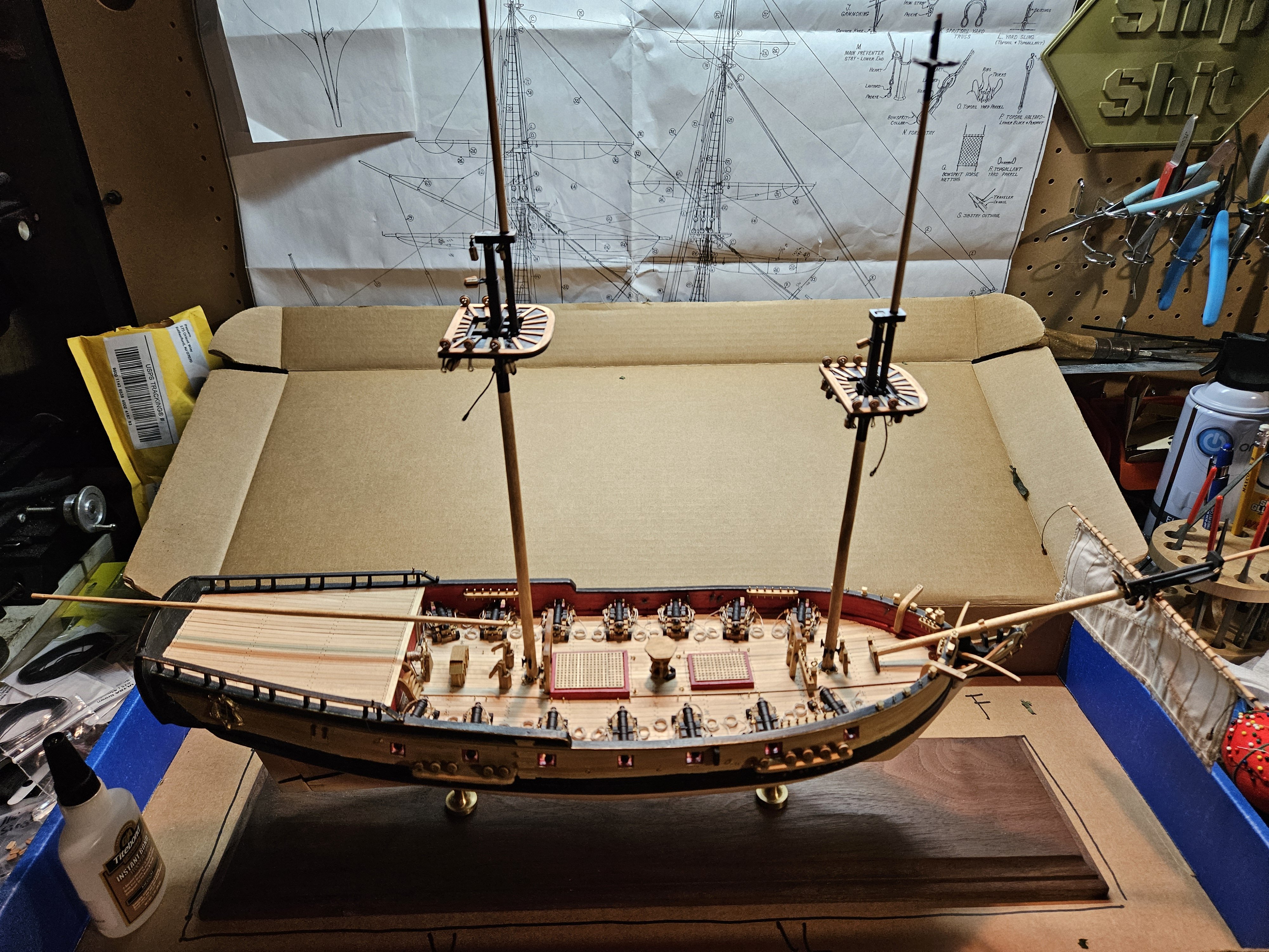

Displaying the Fair American at 42nd Annual Joint Club Conference in CT... I decided to bring my mid-build model to the conference this Saturday. Fellow model ship buddy Cisco will be there too. It actually fits in the original kit box pretty nicely - I'll be zip-tying it down to keep from moving, and I'll have the Bowsprit, Main and Fore mast tucked inside for traveling. The remaining/loose yards I've taped to a white carboard sheet to display nearby. They'd be all lonely by themself if I left them at home. Not museum quality, obviously. It's meant to look mid-build, and I'm proud of the work thus far, so I'm bring it along. I mostly worry if it'll survive the car ride up. Fingers crossed! - Jason -
