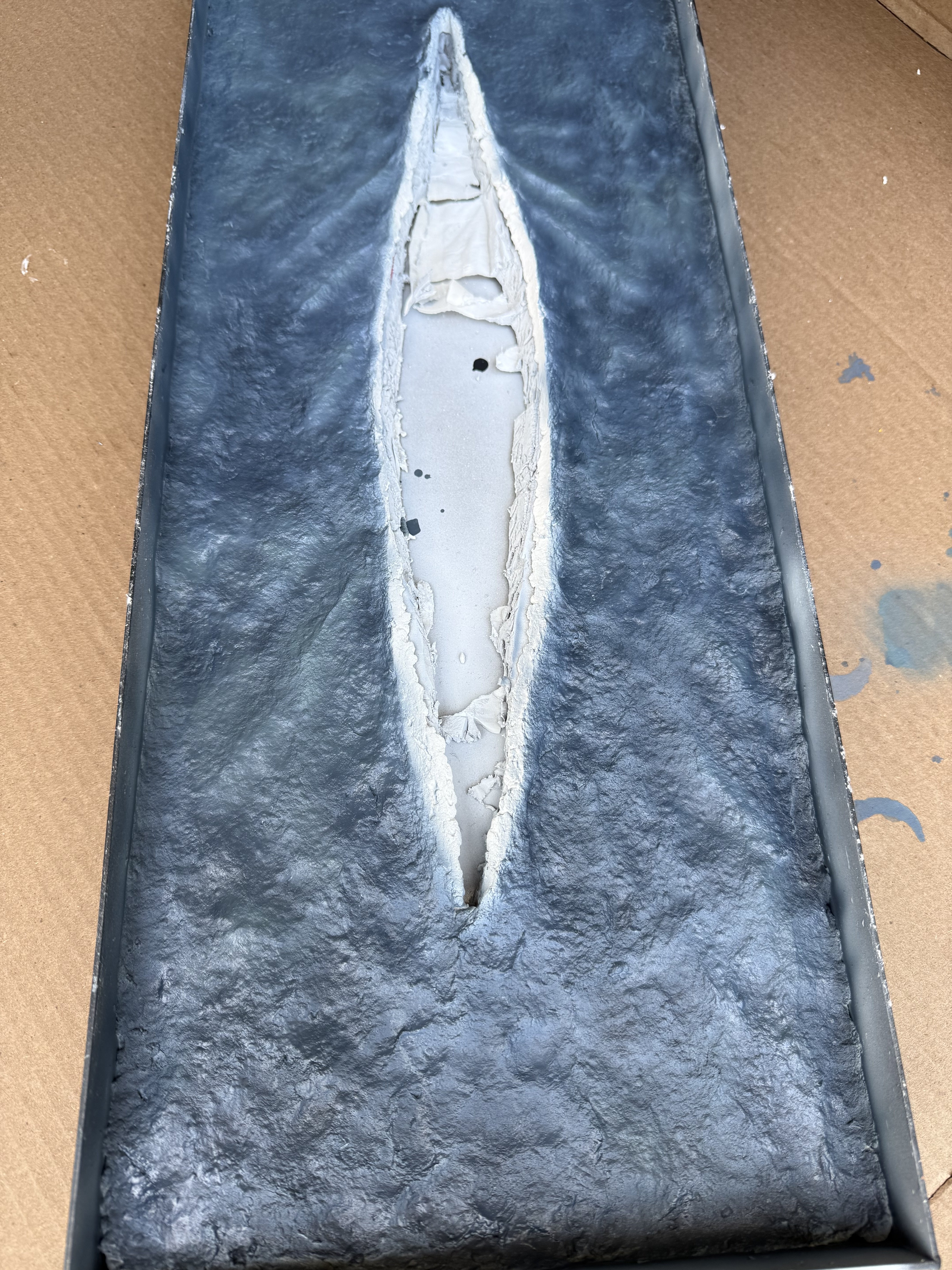

  4. very small update. The ship is in. Now, have to fill gaps, add some white for whitecaps, wake, etc. Then a few coats of Future Floor shine to bring out the water. Thanks to you all for the suggestions. Will try in incorporate that to make the sea look better

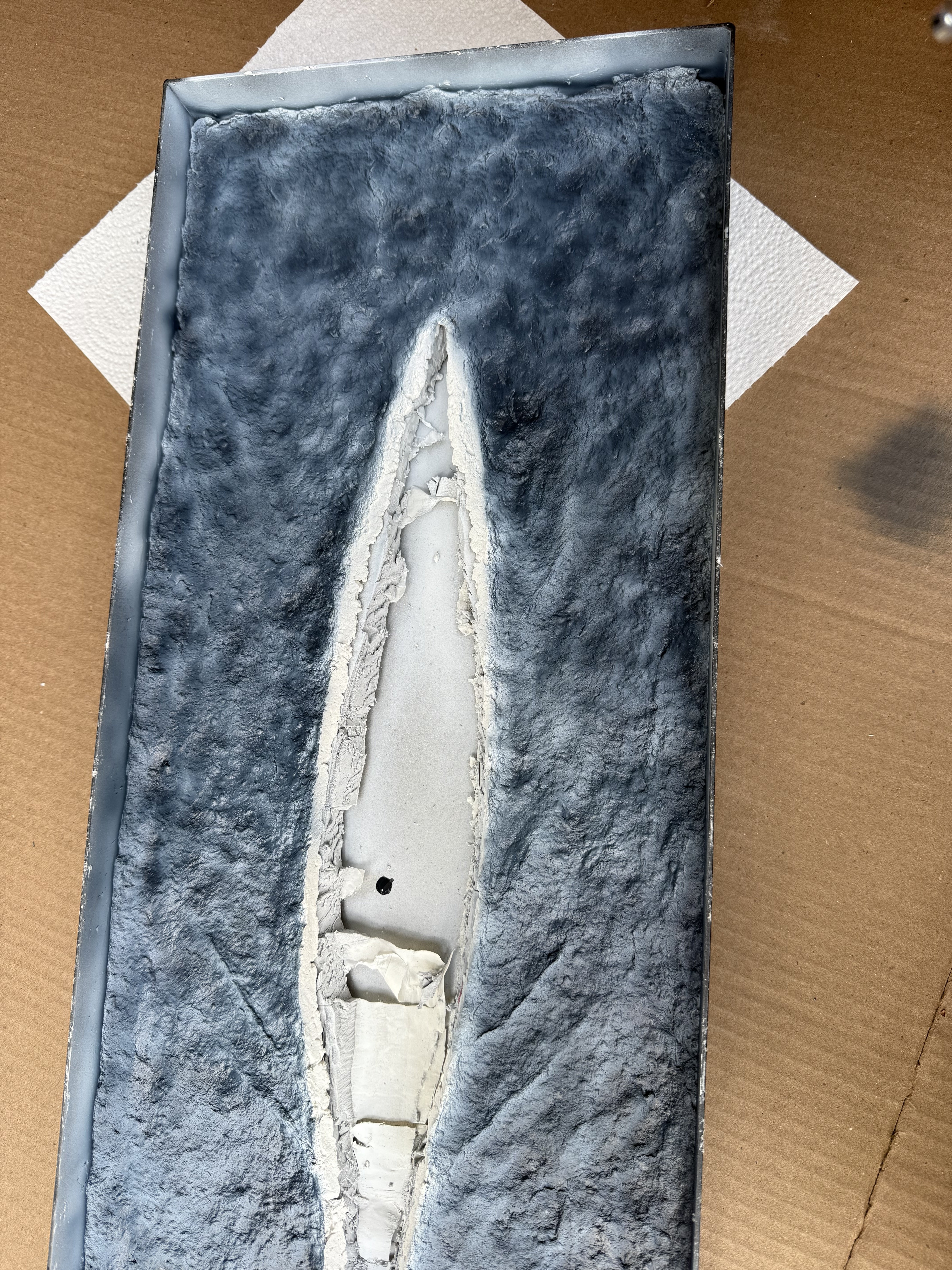

  5. Small update time - my attempt at painting ocean water, something I pretty much suck at. Started with overall dark with the depest parts the darkest. Mixed lighter colors for the upper wave parts. Too light? Too much contrast? After an hour of painting, I’ve had enough for the time being. Maybe I need to go back with dark blue and blend it better. Thoughts/criticisms appreciated. After the paint dries, I’ll gloss it Paints used: MRP Sea Blue, Intermediate Blue, white and Hataka Yellow.

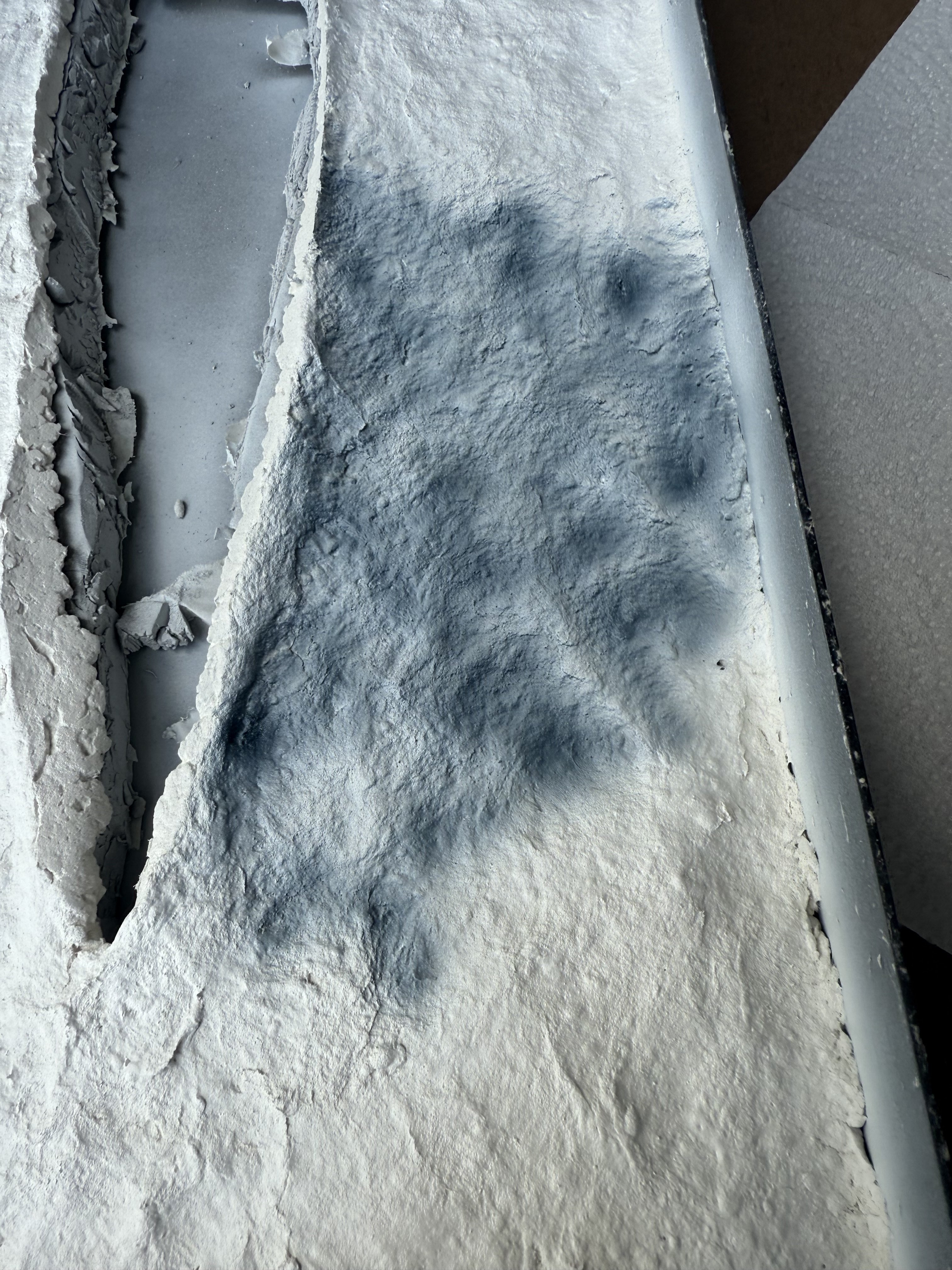

  6. Update time. Aside from a few repairs for minor broken parts, the ship is done. The air wing is, too. Still painting a few figures and deck tractors, but I'm calling this one. Current part is making the water base. I'm using Celluclay for the water. I studied pictures and tried to replicate them, but I'm not that good. After the cellulcay dries, I will seal it and then paint it. Will be using varying blues and whites for the ocean.
