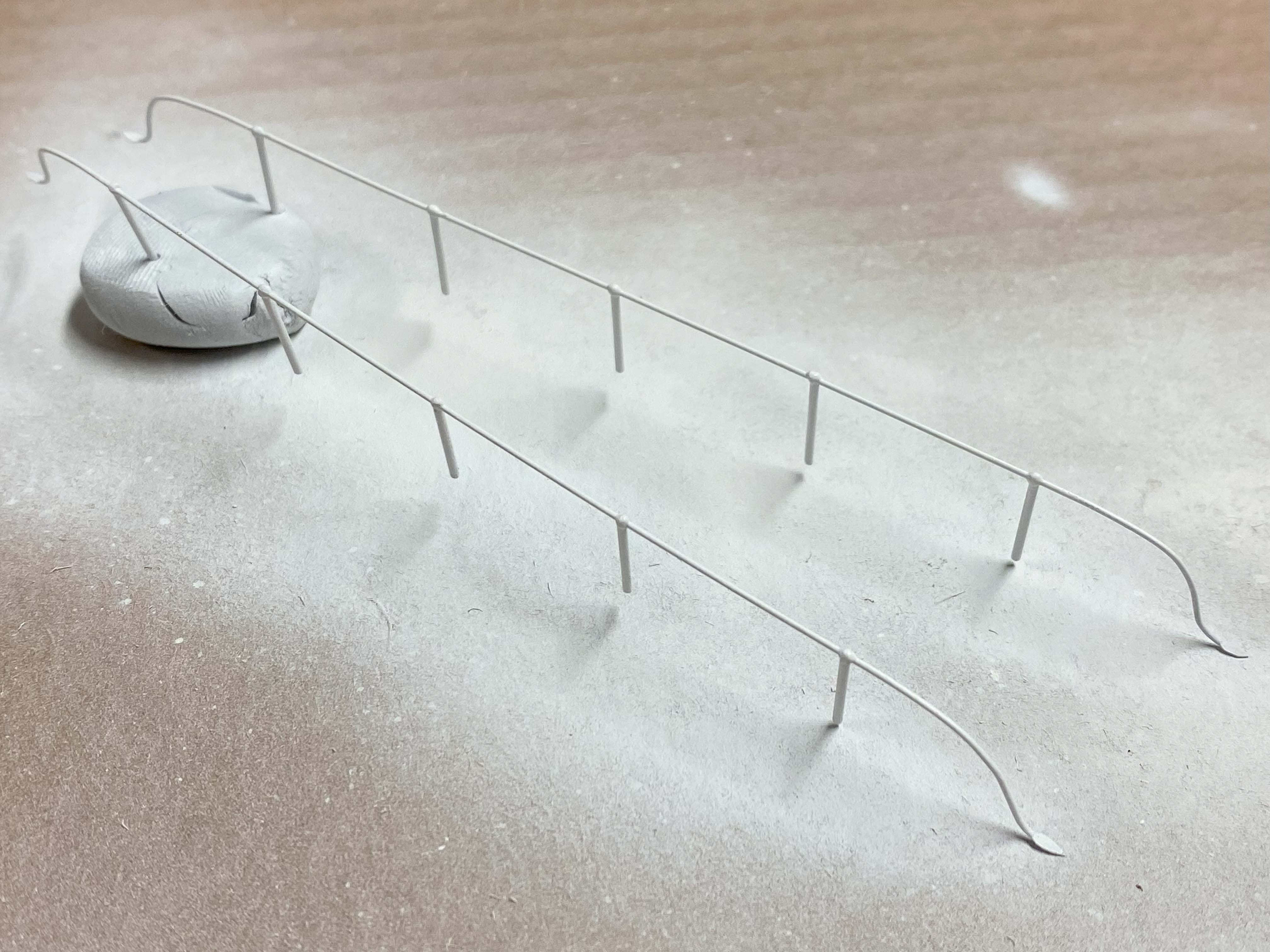

Finished the outer railings and am happy that is behind me. The job required a little trial and error but worked out in the end. Started out making all the stanchions using the same methodology as in post #48. This wasn't so bad. Trying to accurately place the second course rail turned out to be the trick. Like with the top rail I wanted to evenly, and symmetrically, crimp the brass rod before drilling. This would make it easier to drill the second hole and also give the solder a place to build up to yield something of a spherical look. My attempts at flattening the junction with a punch sort of worked but was far from repeatable and definitely not symmetrical. I ended up partially sacrificing a small pair of end nippers to do the crimping. I gradually ground out a gap in the jaws until I could crimp the rod to what looked like a good depth. Trial and error. The tool worked exceptionally well. Next came drilling the hole, which for the second rail is 0.45mm. Top rail is 0.5mm. As was suggested to me, I made up a prick punch out of a 1/16" HSS drill bit. I ground the end to a sharp point. Trouble was, the target is so small I could not accurately guide the punch to the correct spot due to shadows, my eyesight, fingers in the way, etc. More importantly, even lightly striking the punch would tend to fold the rod at the flat and seriously weaken the intersection. In the end I had little choice but to free hand the drilling. Took a while and only ruined about 3 stanchions in the process. I made a little jig to hold the stanchions for locating second railing hole. Kind of crude but made a really nice crimp. The crimp. The process elongated the stanchion by 1mm. I also added a reference mark that would be top of wood rail and one for total length. Pretty small. Looks like a string of firecrackers. Before trimming to length. I pressed each stanchion into a drilled hole (no glue) and then strung the wire rails. On a tight radius I had to feed the stanchions on one at a time. Once everything was in place I went around and soldered each intersection. Once everything is soldered, I could carefully remove the whole assembly to file imperfections and paint. It was surprisingly durable. Once painted I simply reinstalled.
