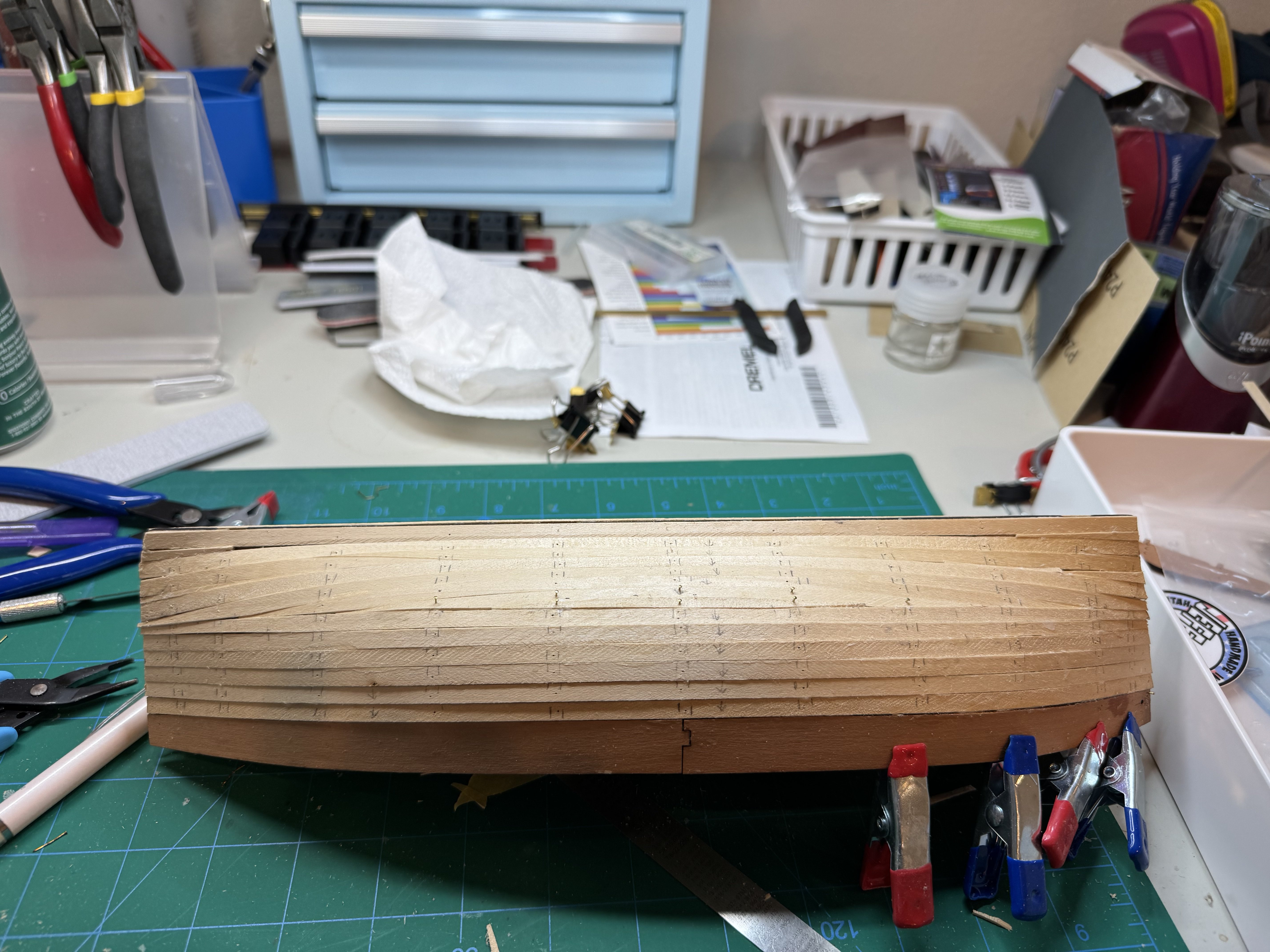

Good afternoon I have completed a milestone. Step 70 is now complete -- planking the hull. With my planking process I would will apply the glue to the plank. But I found it became more tedious that necessary. Instead I ended up running a bead close to the adjoining plank, and then use a toothpick to spread it out. I also ended up using push pins to apply pressure to the planks while the glue setup. From there I would sand along the join lightly to generate some dust to help fill in the gabs. I also found that I was able to from the top down and bottom up to speed it along. As a side note. I realized my glue fits in my pencil sharpener so I could keep it primed all the time. As I closed the gap I ended up using a template to fill in the last plank. I used tamyia tape to help hold down the final plank. I also sanded to improve the gaps. The finished product is as follows Next step is to add some filler, and let it cure over night. Then the sanding begins.

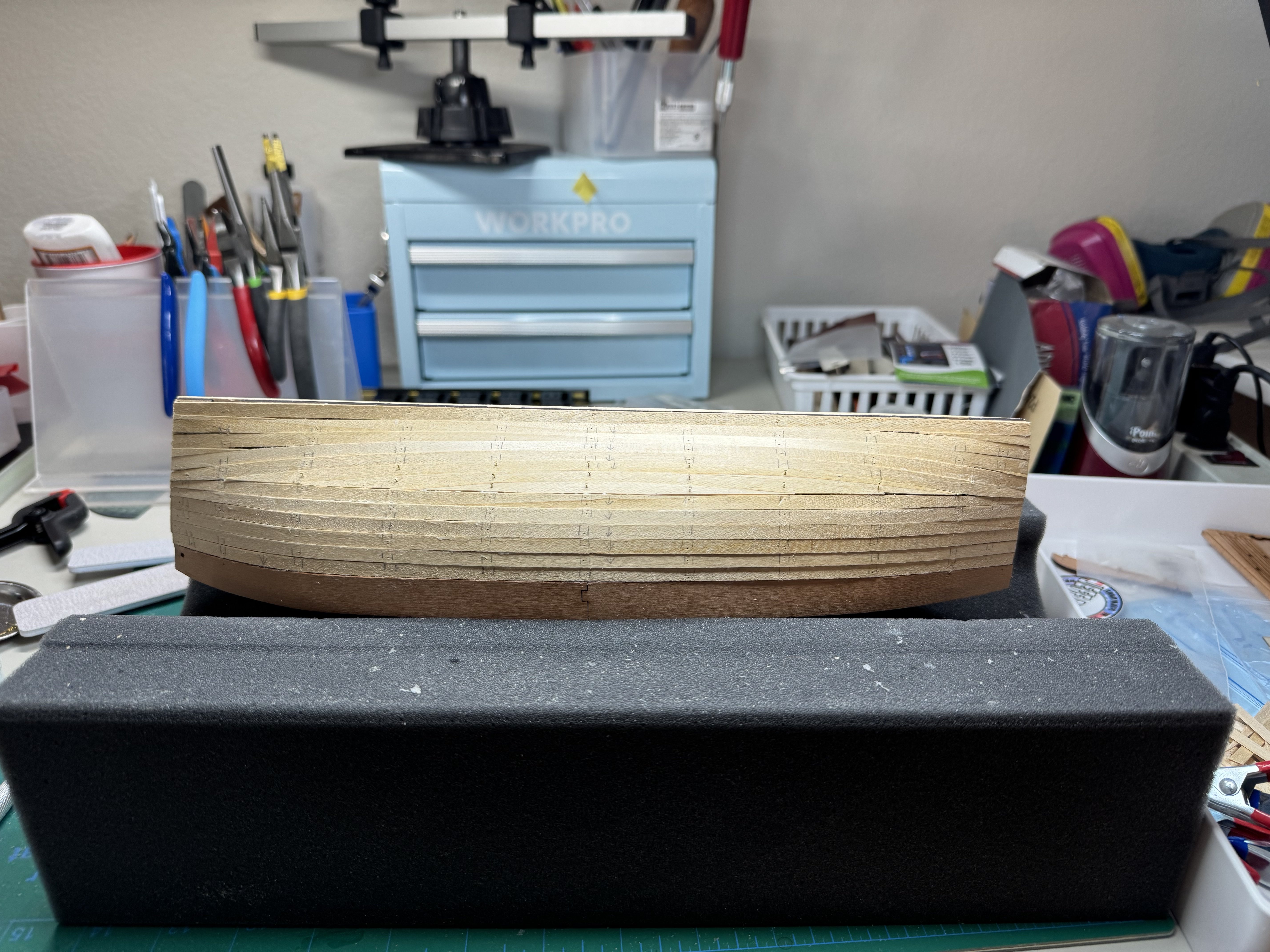

Good morning. I am progressing nicely with the second planking of Lady Eleanor. I did mark and drill the holes once I finished the planks. I used a 1 mm as a pilot then extended to the 2 mm bit. Starboard and port are complete to the same number of planks.
