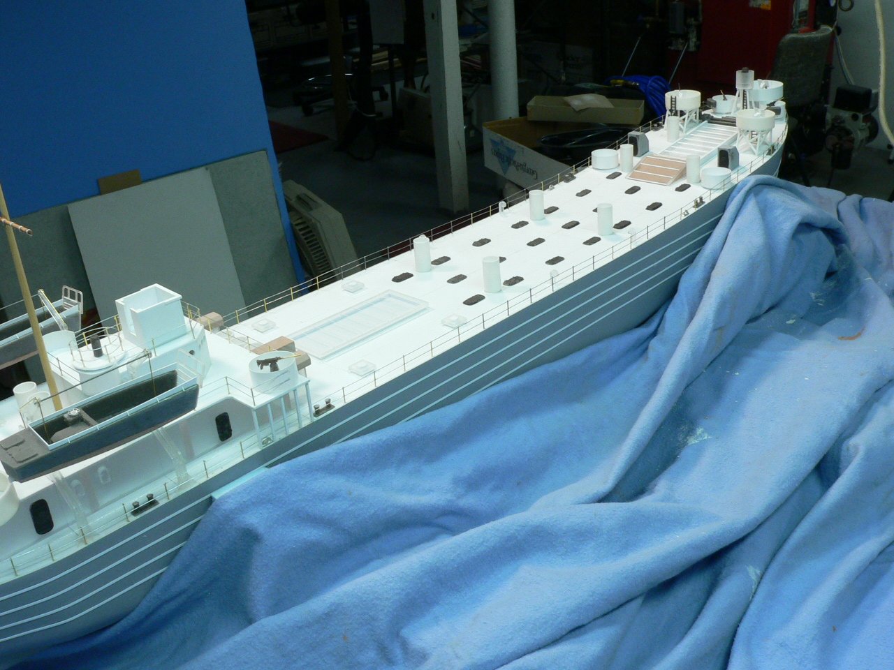

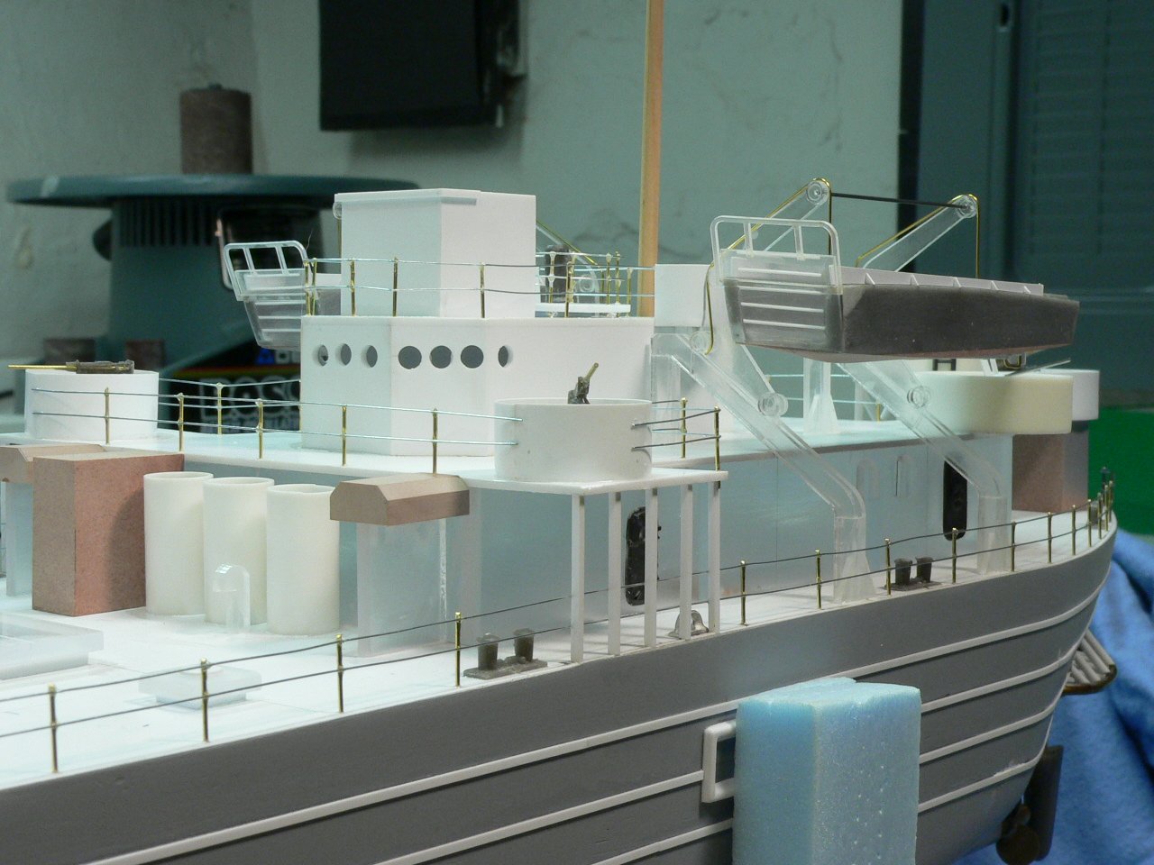

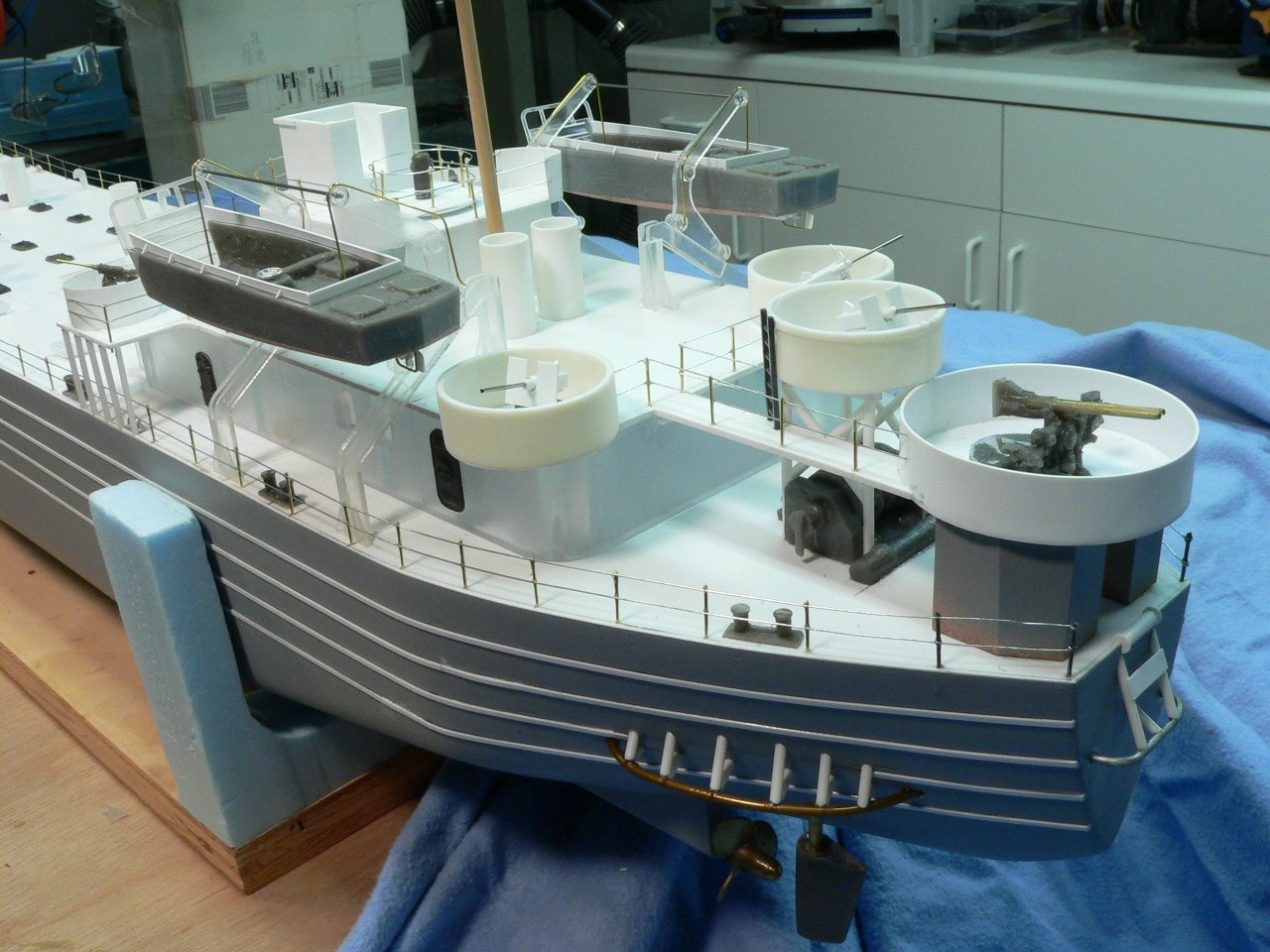

As promised here are more detail photos from this phase of this build. Here you can see the prop guards, built up with coat-hanger wire and styrene rod, as well as the stern anchor guide: I'll add that, as I mentioned about the kit-supplied LCVPs, they were quite crude and had no bottom definition at all as they were flat-cast; I had to add planks of REN Shape and sculpt the bottom contours; you can't really see the nice curves that Higgins designed into these work-horse crafft, but they are quite elegant, and I did my best to model them... Thanks again for checking in. Next time - paint! Cheers all; Jimbo

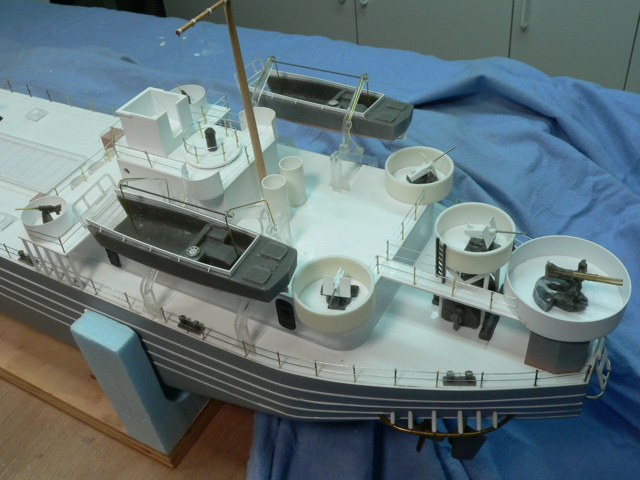

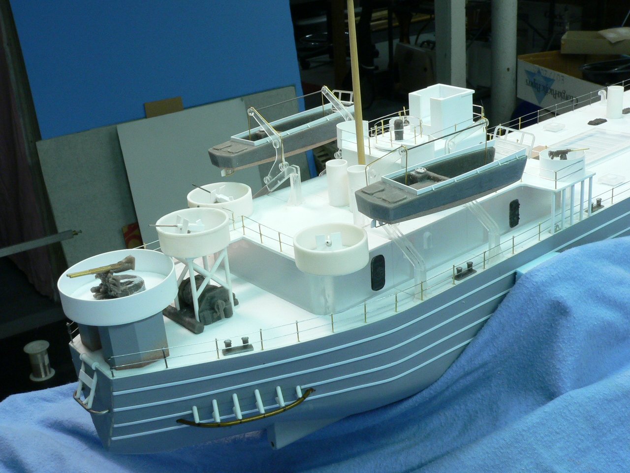

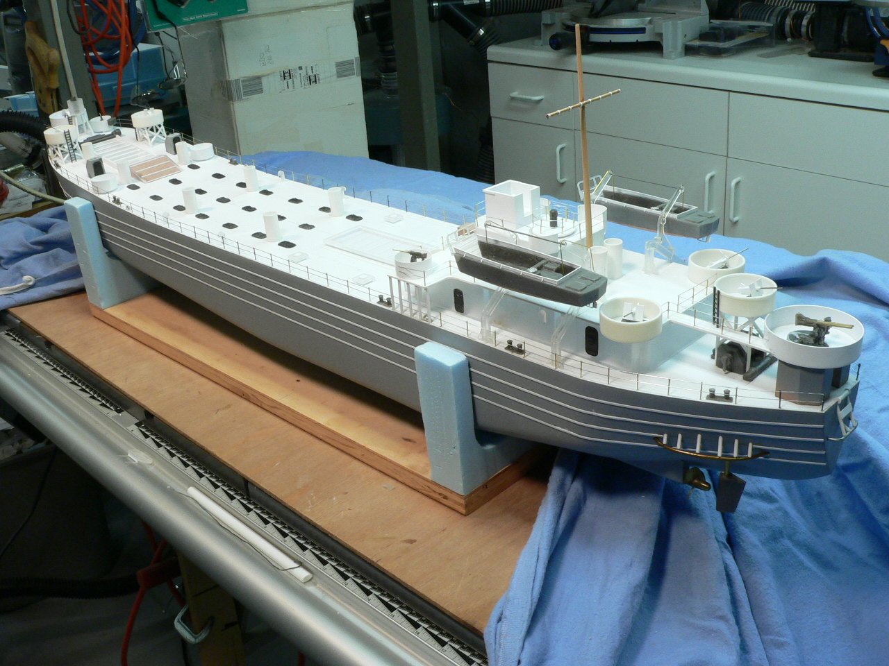

Thanks fellows, so much. Here's my next update. The build progressed significantly since the previous set of photos (the elapsed time between the last photos and these was about 2 months). Here you will see a lot of detail additions. First a couple of overall photos: And some close-ups, where I'll explain the additions. Next you can see the guns have been installed in the gun tubs; some were kit parts and others were complete scratch-builds. basic, to be sure, but they get the idea across. Also seen are the railings, which are simply thick wire stanchions with thinner wire strung along them, and glue/paint thickening the attachments. Also you can see the side rub-strakes (?), here added with styrene strip: Next a close-up of the stern area. Again, guns in their tubs, railings, the mast and, most importantly, the LCVPs in their davits. I drew up and laser-cut davit parts and built them up in layers, approximating their detail as bast as I could. As for the LCVPs, I used the kit-supplied cast resin hulls, which were very rough, to say the least. I cleaned them up as best I could, and added styrene detailing, laser-cut bow ramps, and steering wheels (from model railroad brake wheels): I'll add a couple more photos in a follow-up reply so as to not overload this one with photos. Thanks for checking in! Jimbo

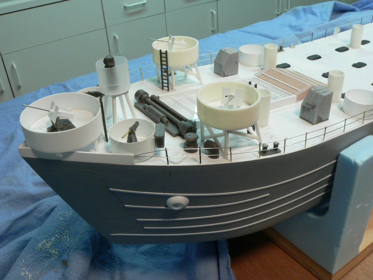

As mentioned previously, I upgraded the deck to styrene so I could more easily attach plastic scratch-built assemblies. Here are some views of that process. Gun tubs and vent tubes are either cut from styrene tubing or fabricated from styrene sheet. The forward deck ramp is a composite of the aforementioned REN Shape, acrylic and strip styrene details. The bow winch, ammo boxes and companionway housings are kit-supplied resin castings: Another view; you can see I have begun drilling holes for the railing stanchions... Here are a couple of stern views; you can see that the kit-supplied resin LCVP davits are sorely lacking in detail; they are just posed here and will be replaced with laser-cut acrylic assemblies for far greater detail. Thanks for looking! Jimbo
