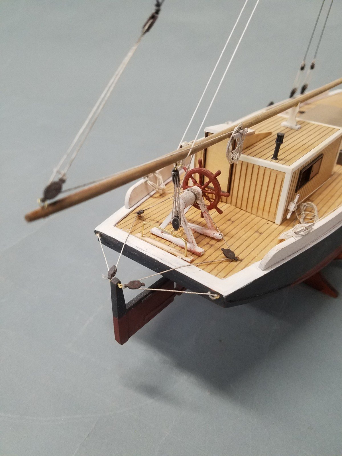

  1. Now that Nic has finished rigging it (looks great up close!). I'll finish up adding a couple details and she's done. After that, I have to adjust the plans a bit, finalize the instructions, do a cost analysis, get Josh to set a retail price, and she'll be ready for release. The kit will probably be available early Spring. Here are a few detail shots.

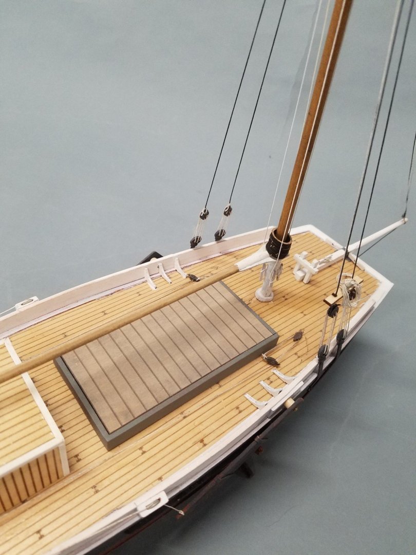

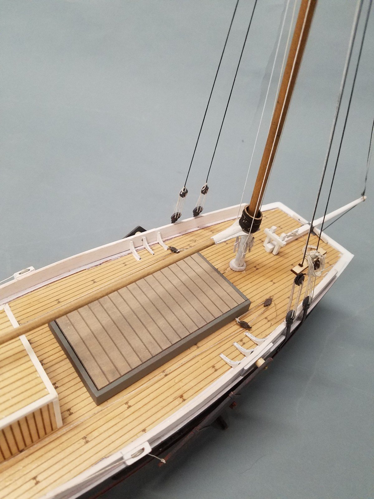

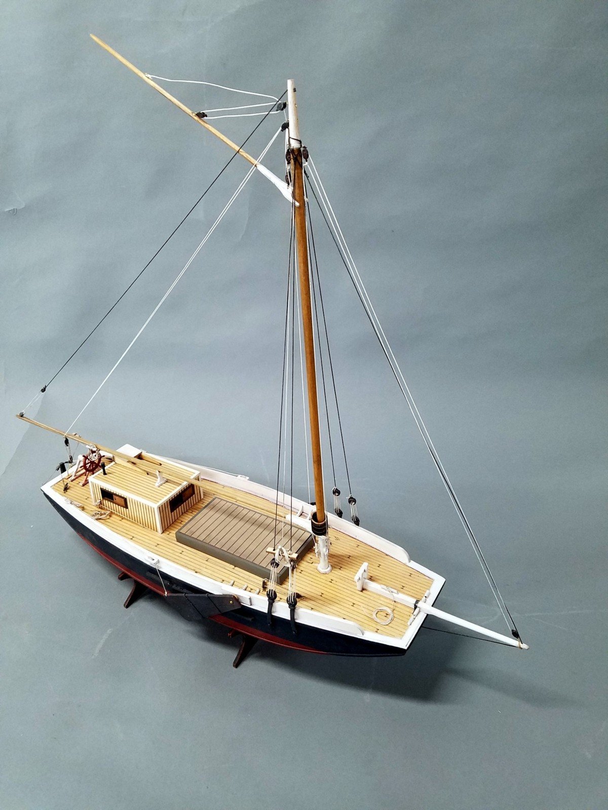

  2. I recently reworked what had been an old Laughing Whale kit, the Square Toed Frigate. This was a 30' version of a typical 19th Century scow sloop, so the kit is in 1/24 scale. It's plank on bulkhead with lots of laser work including a deck with simulated trunnels and butt joints. Planking mimics the original - longitudinal side and transverse bottom. It's available now @ $199 plus shipping. Kit #K1119.
