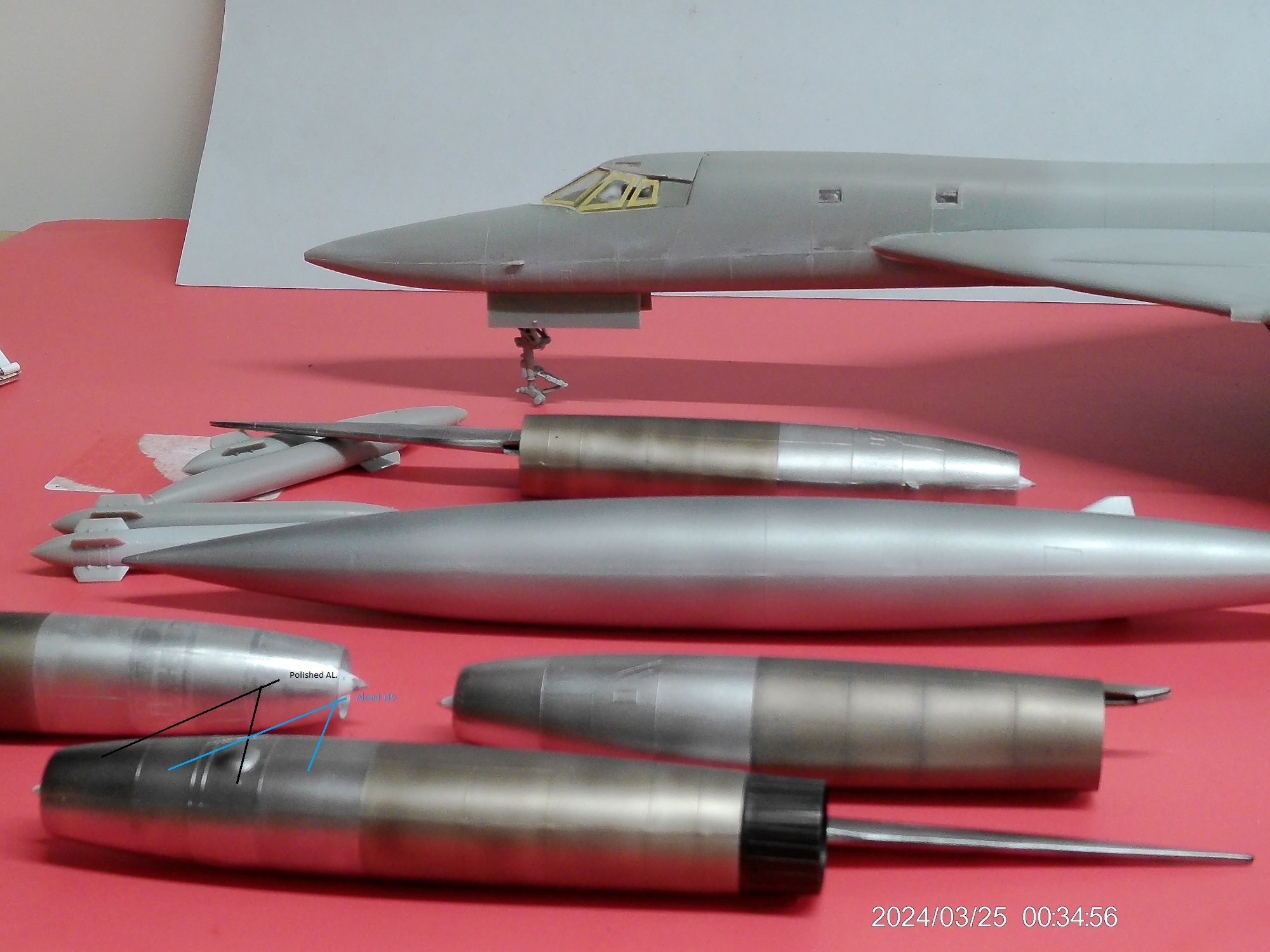

Now I have the Trumpter 1/48 F-100C main color is Alclad #126High Shine AL. Rudder is Alclad #101 Basic AL..The tail are was first Alclad Exhaust manifold,Pale burnt metal a darker Burnt metal all applied in a vertical motion if I had a blue vary sparing some of that would of happened.I had to do some touch-ups on the 126 from paint and I started noticing it was just a tad different and I started doing verticals on the fuse.I hope it last overnight and stays just breaks up the scheme to my liking. This build will be quick guys shoot I have maybe 3/4 hours thus far easy kit with a Nice fit

I will clear coat tomorrow with Pledge thinned with Mr.Leveling thinner makes it lay smooth and drys much quicker .The engines are what they are I got a no seam in what you look from the outside but inboard side I did not mess with.I found out doing the belly tank just putting putty and paint does not work still looked white in a sense.I painted a hairline color of black on the engine seams to the wing sprayed AlClad 105 and all was good.I think once all said and done it will not be a bad looking build giving it a B grade.🤨 The F-100C is the Trumpter kit got good vibes on this no seams hardly at all.

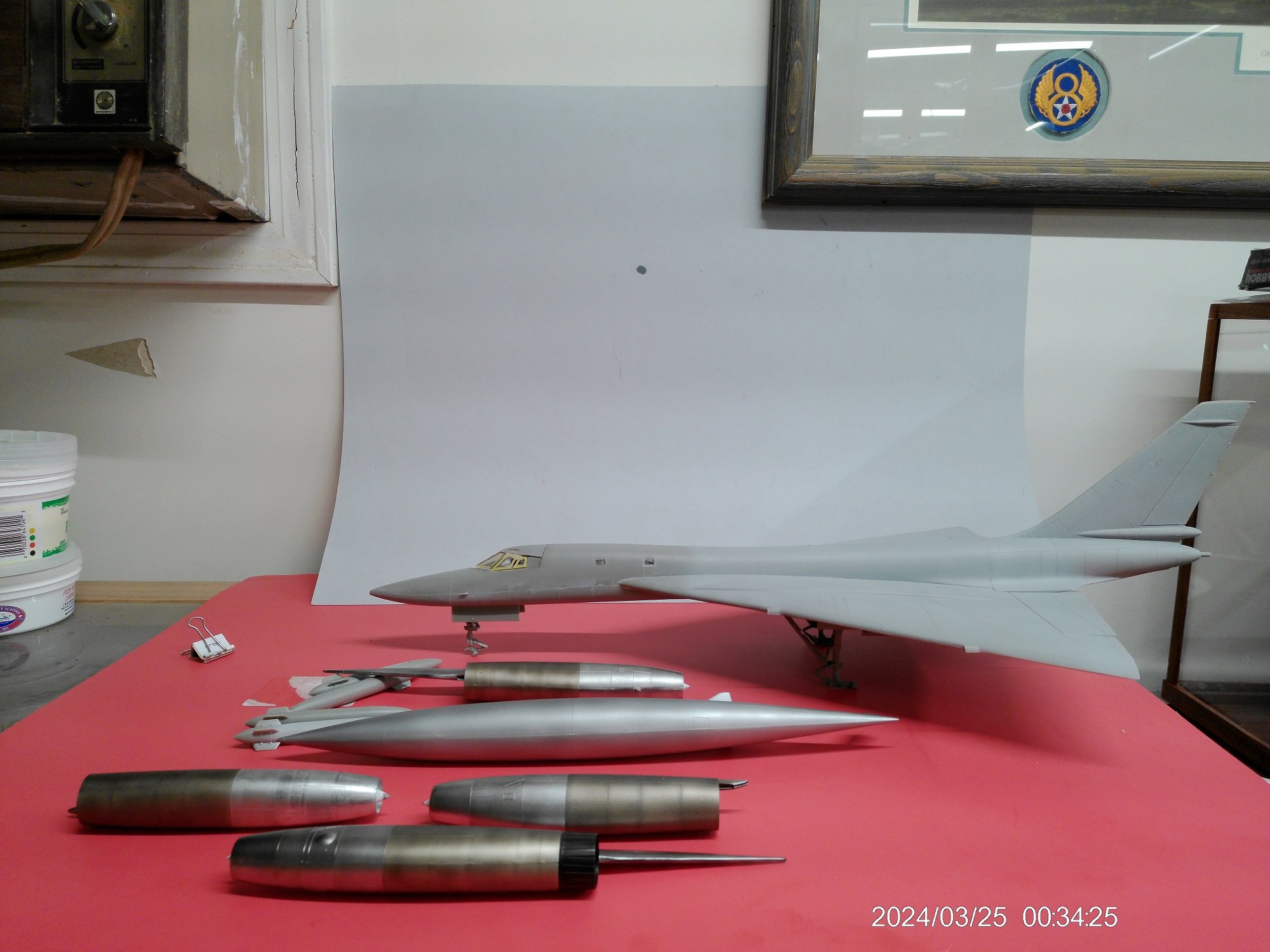

Thanks Alan I did one per night took 1/2 hours each evening now lets see if the rest of the plan works out.The idea is to primer the whole plane then buff and apply the gloss black then go polished aluminum .The next step will be to pick out panels,flaps and rudder.I will then SG the pods on fill the seams and retouch the paint.🤨 apic of panel colors
Progress has been slow but steady lots of sanding old molds/technology.I painted the engines primer,black,polished silver,silver119(panels) pale burnt metal,paneled line with rubber,pale metal(very thin) then burnt iron.The body of the plane has only been primed up top ATTM but is silky smooth after using a worn out 800grit scotch brite

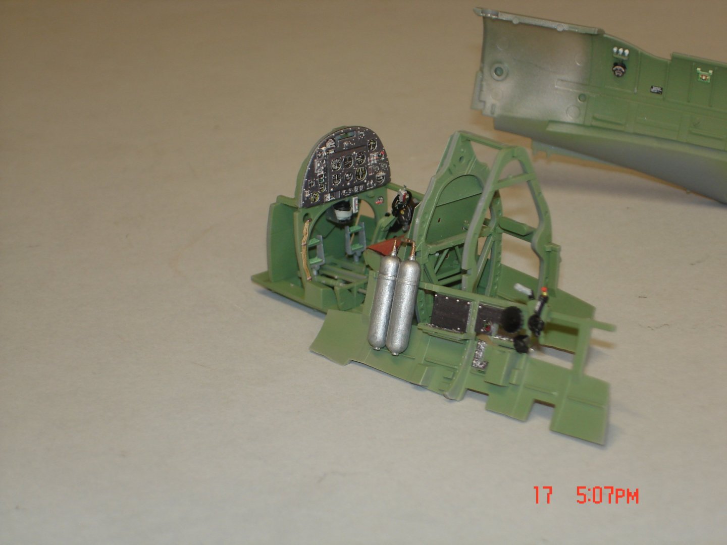

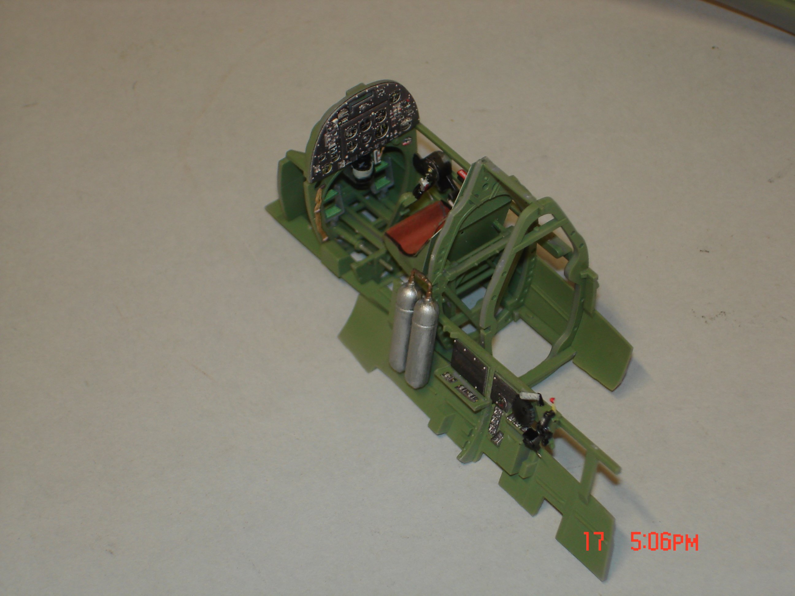

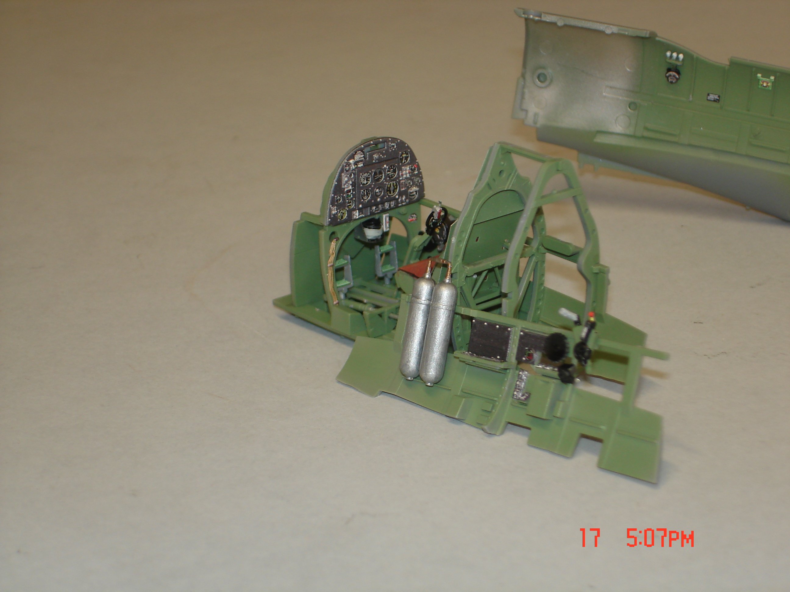

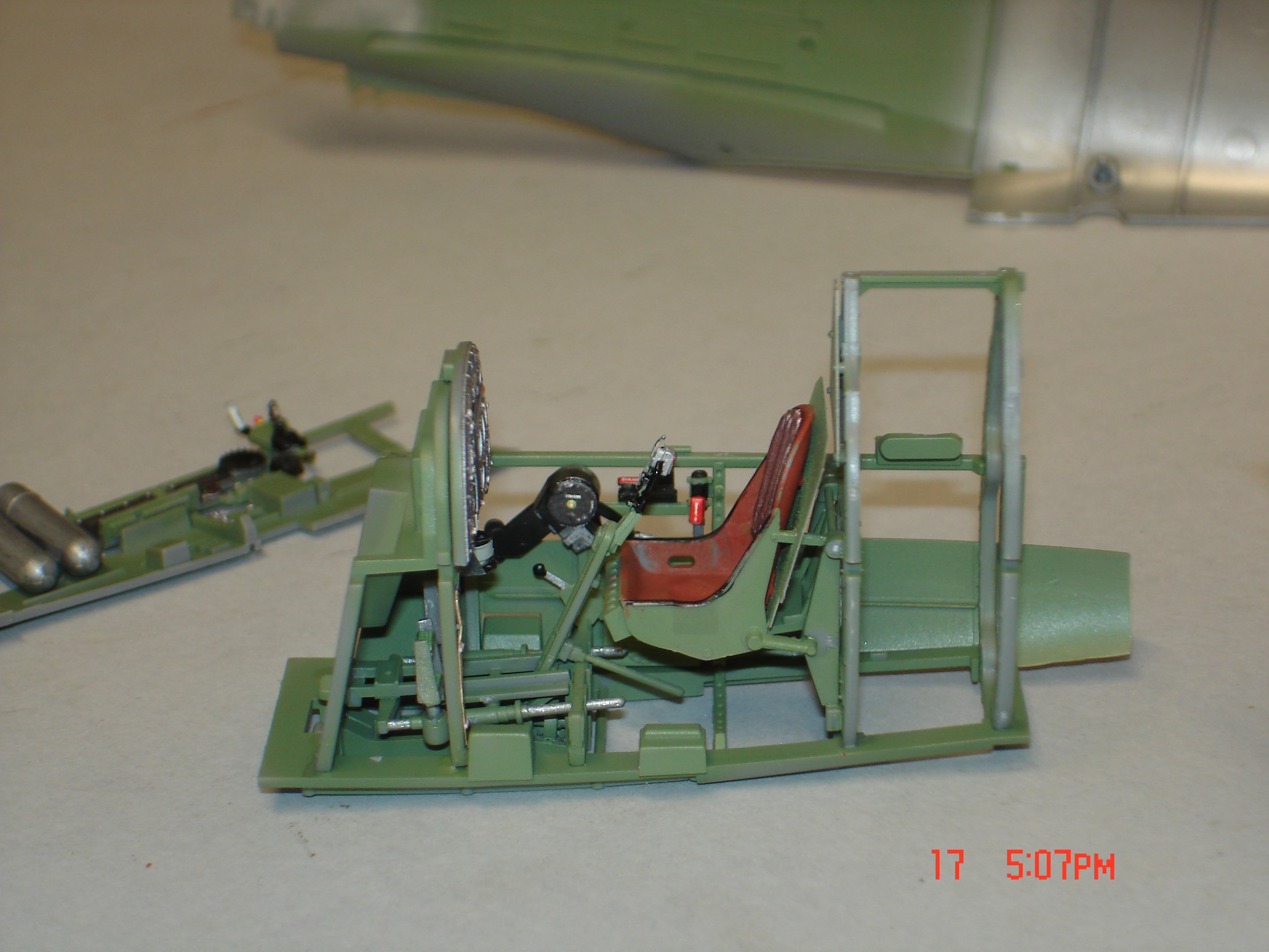

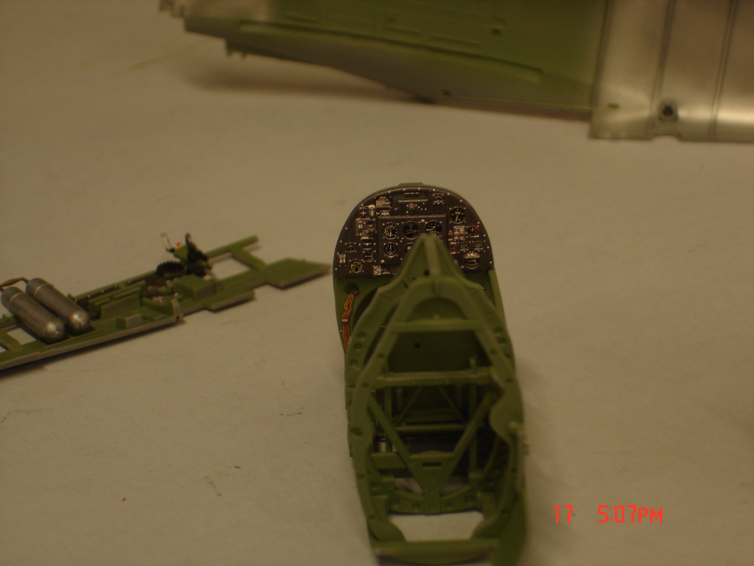

I have been assembling a lot of the sub assemblies LG's,Pit and the engines.The LG's though it does not look like it have been repainted into a light grey poor lighting on my part and nighttime on the shots,The copit was laft in the US Naval Dark Grey which really looks like RLM 02 in my eyes.The copit ATTM has been installed with a couple of lead weights just in case.I cut the nose pitot tube from it's attachment inside the nose and installed onto that a hollow tube it worked and is straight no breakie on that part I am thinking yellow/black for that part.I have been thinking since last night these engine pods need to be painted before they are installed to bring out panel effects masking and such is still swirling in the head?Too I am going black base the plane and maybe paint the bottom do panel and then attach the engine pods.Yves this plane is not hard at all to build just lots of sanding and some raised panel lines go away for me on the pods were most happened doing different panels should fix it.Just one pic ....
