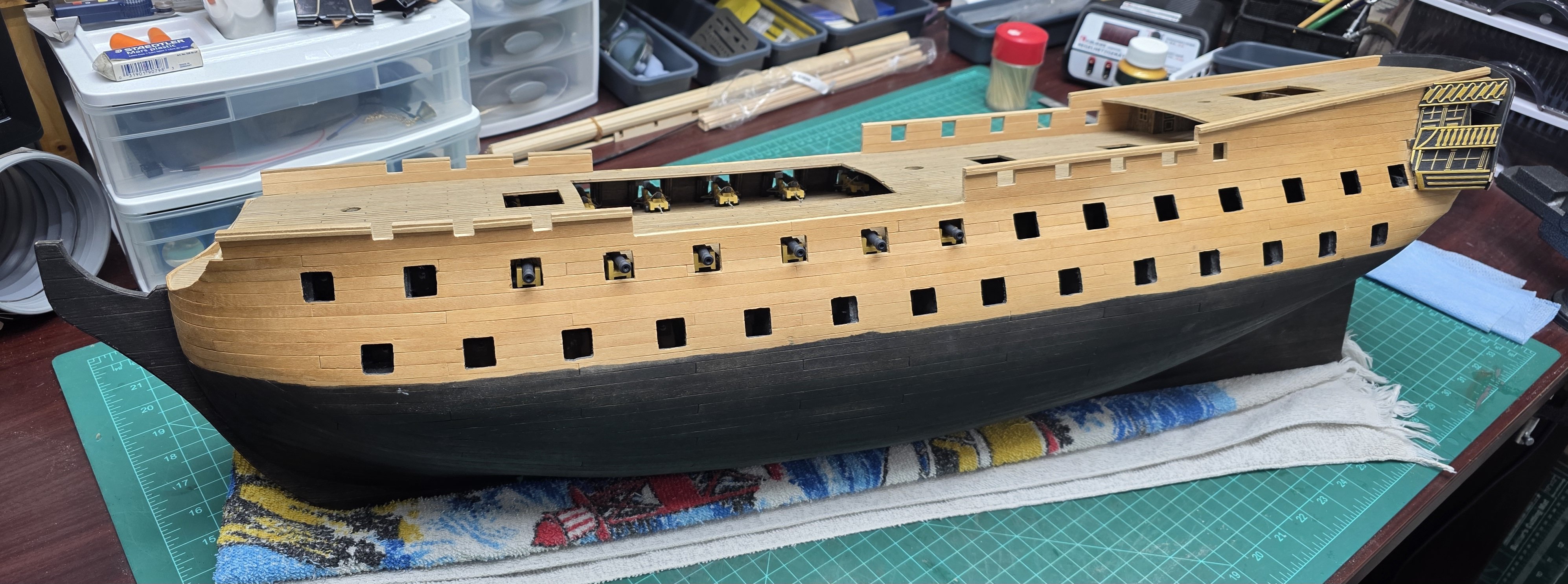

These are the pics that i found for now. Keep in mind that it's still a work in progress, so it lacks a lot of finishing touch.
Almost all of the boat will be stain and not paint, so it's normal that the hull is not one tone black.

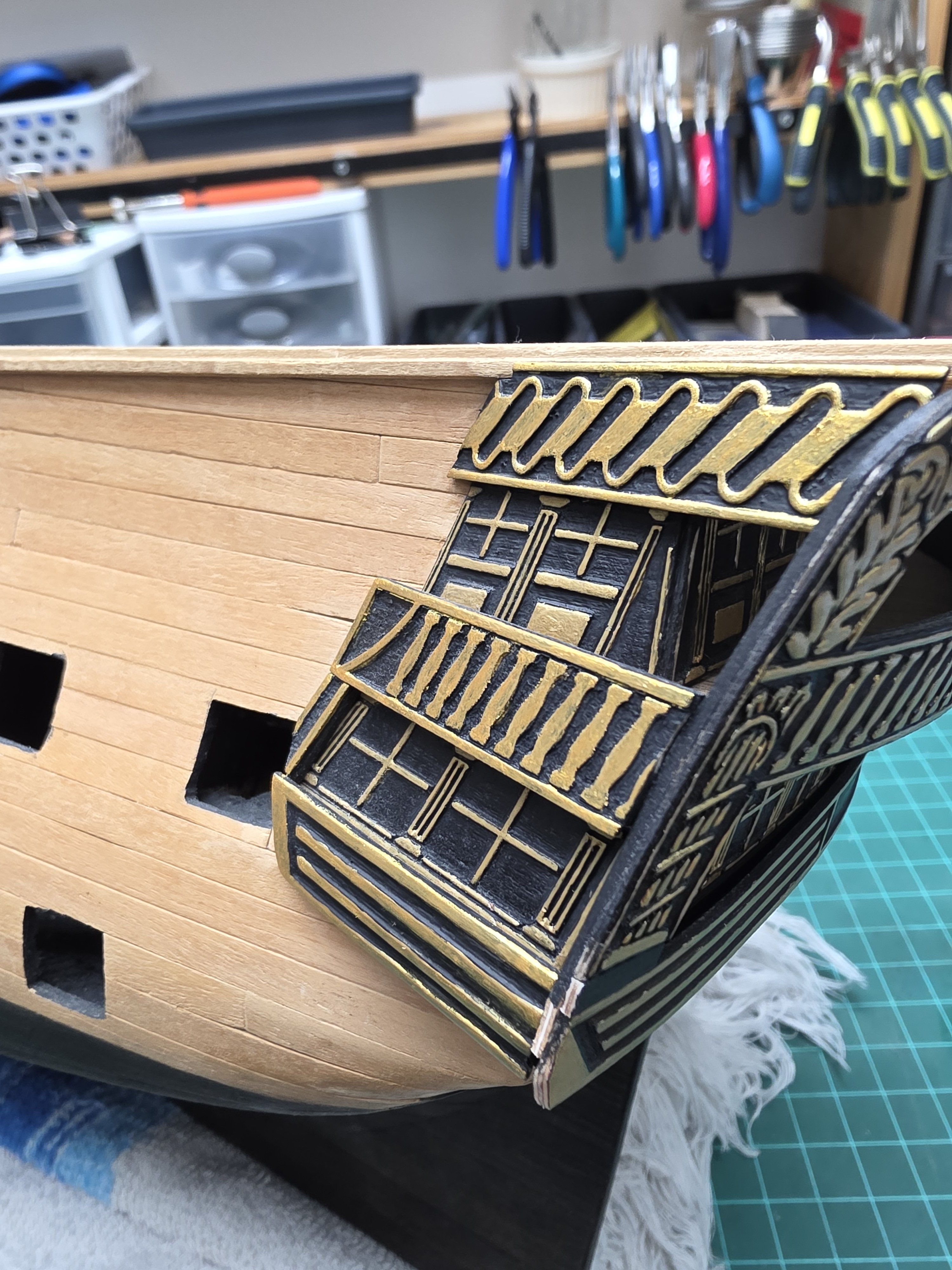

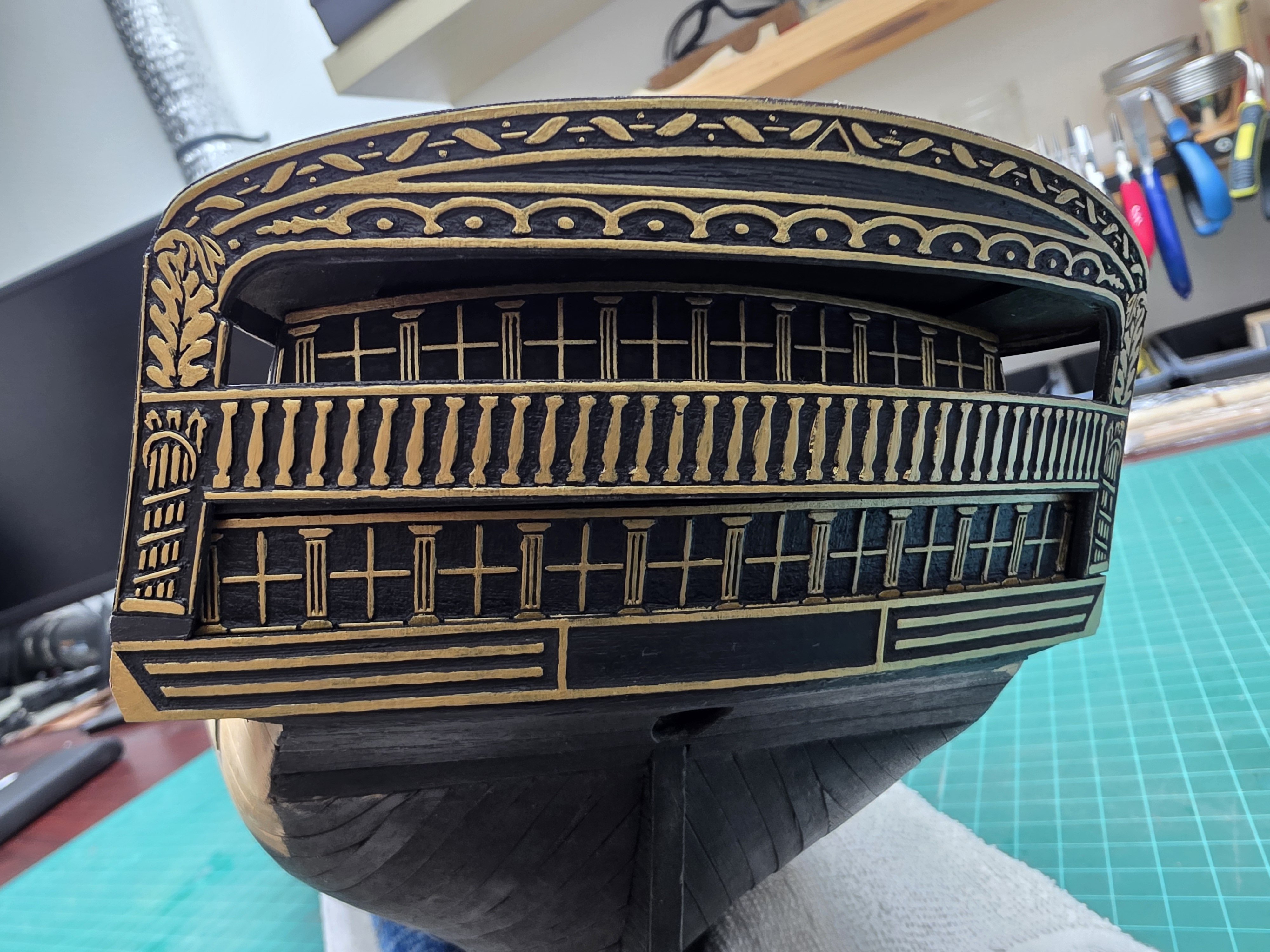

Hi Kevin, I've at the stage of figuring out the stern galleries, & like you, have found the supplied etchings on 1mm ply tobe utter c--p. I tried your way, but I reckon mine is a much older kit (bought pre-owned). No way could I get a decent paint finish. After three times sanding back & painting it hit the bin. I milled a piece of pear wood to 1.5mm &  scratch built the panel to my own design using walnut strip, 1mm dia. & square, 0.75mm dia. brass, & walnut columns. Next step is to redo the side galleries.

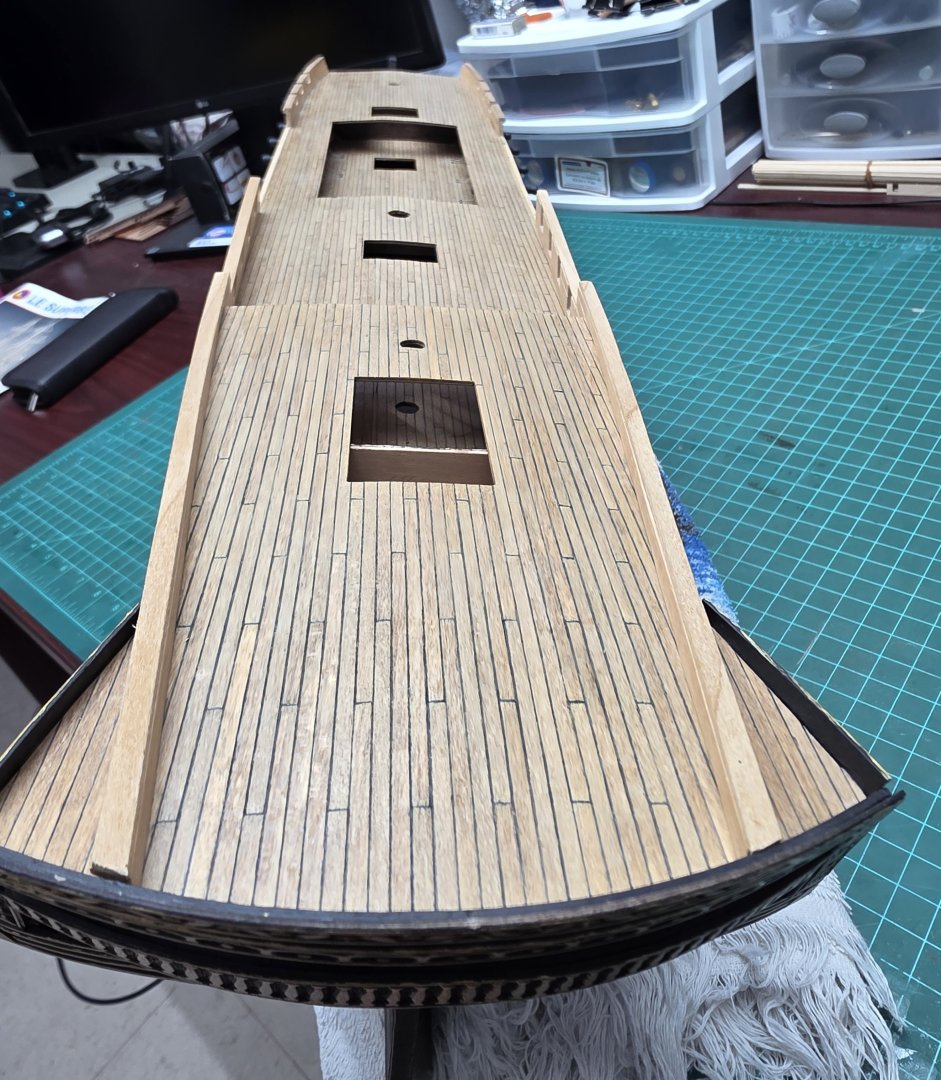

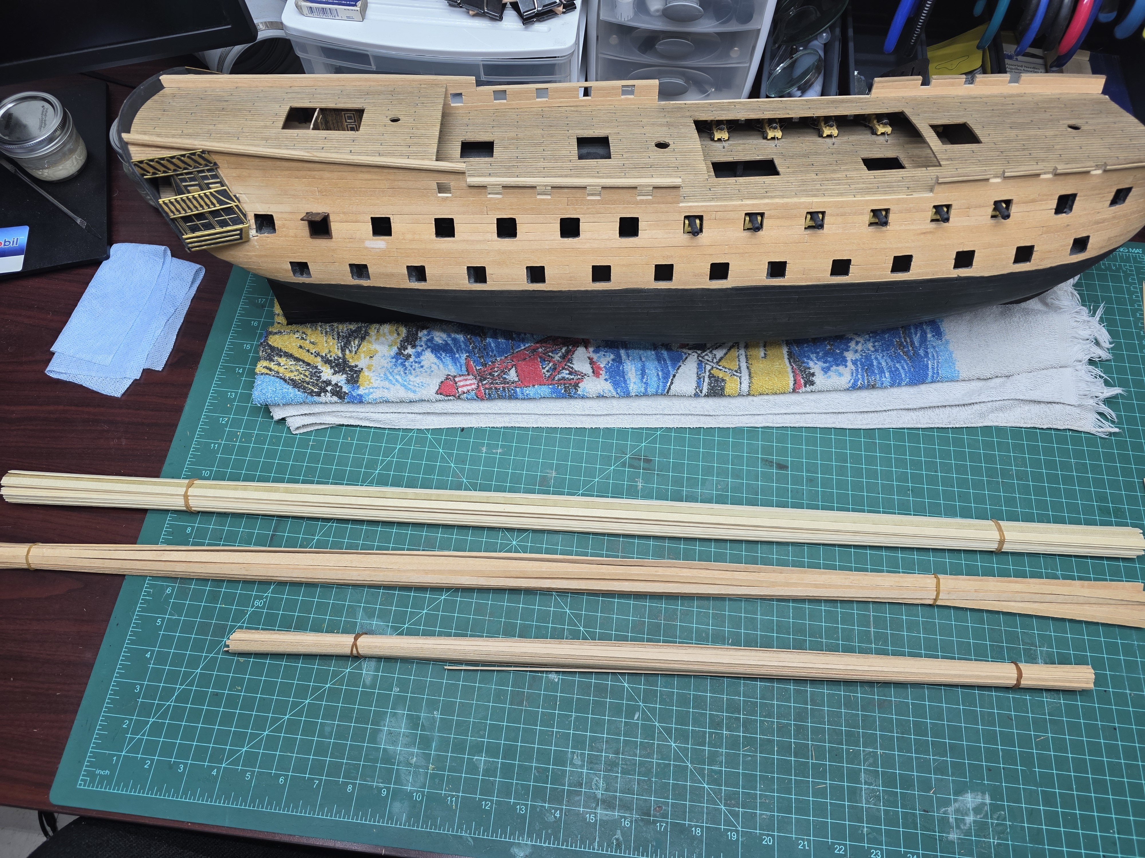

Some overdue adjustments...
Before:
After:
Even if most of the improvements won't be visible after the next few steps, i feel better looking at it now!
