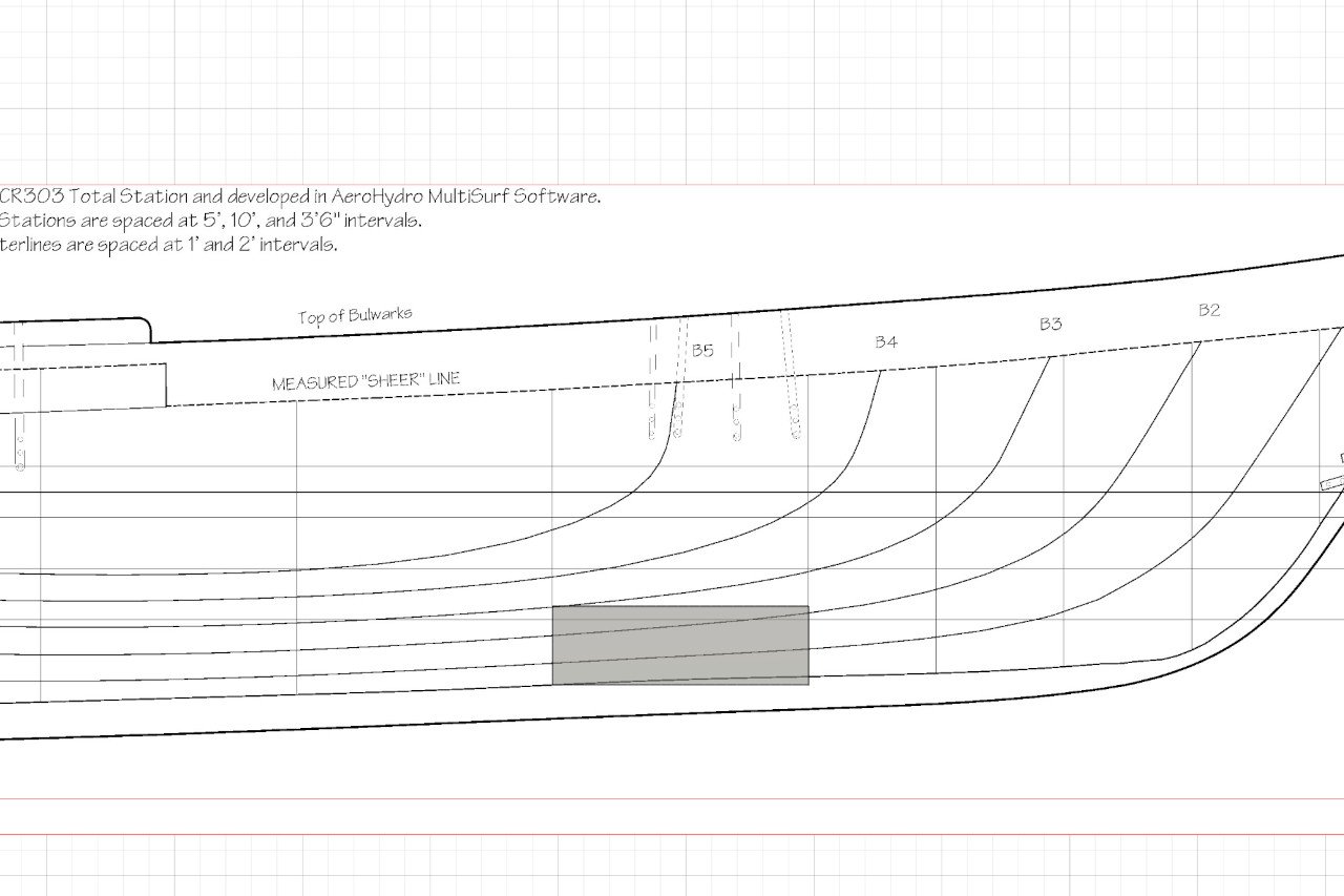

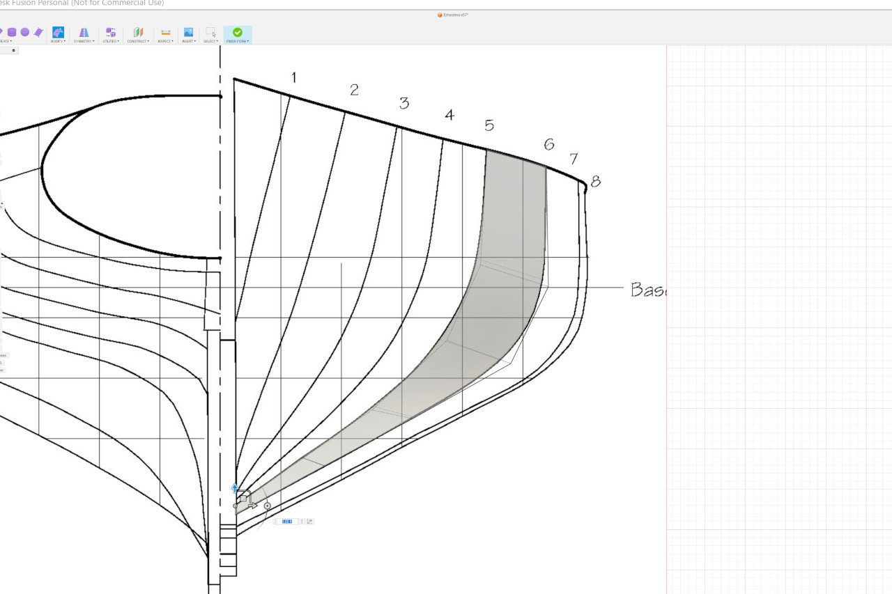

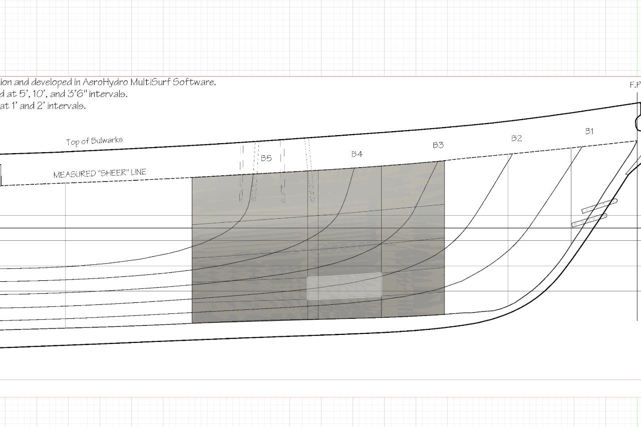

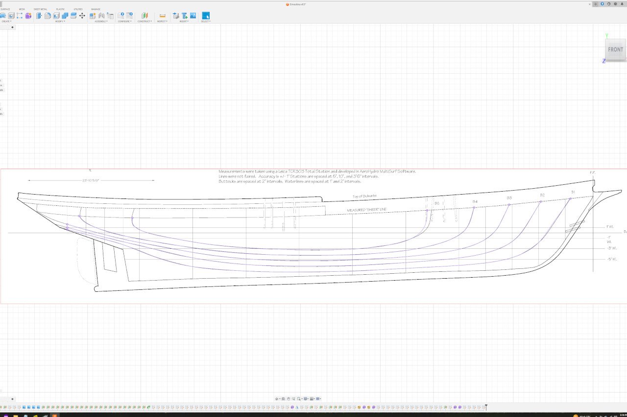

I finally got around to experimenting with Fusion's form environment.  Here's a log of a method that gave me decent results.  (At least, decent enough to get a form that I can slice at will to make patterns for a plank-on-bulkhead model.  As you'll see, it doesn't give me a clean form for 3d printing or rendering a picture.  But making bulkheads is my goal.)

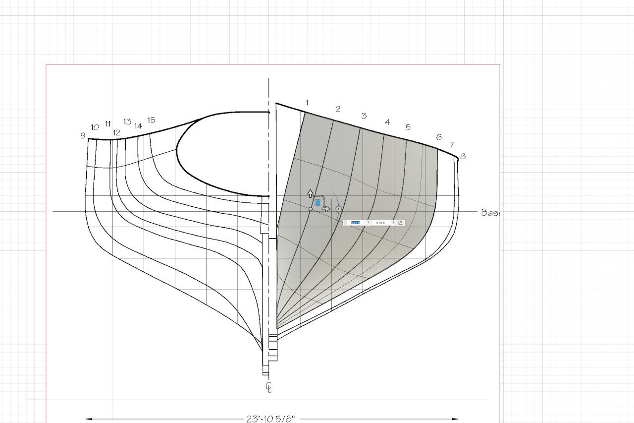

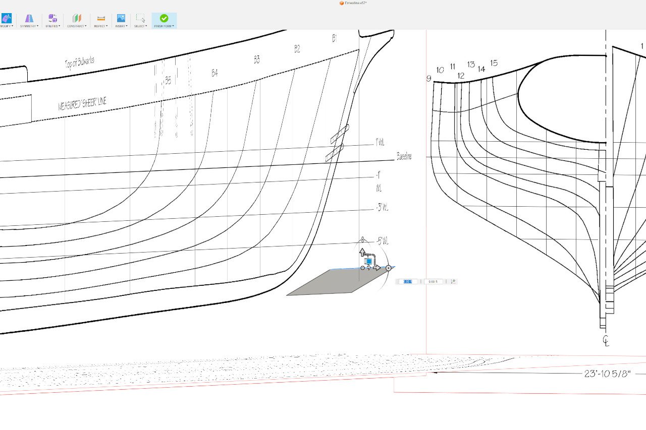

I start by going into form mode, and creating a simple rectangle.
I grab the upper edge and lean it out a bit.
Then, holding Alt as I drag I extrude a few more rectangles.  Here you can see how things exist in the forms / t-spline environment.  There is a grid of control points (black lines) which control the smooth form (in gray).
In the Y-Z view, I adjust the curve of the edges to that they match up with the correct station lines.  Fusion allows this to be done either by moving the control points or by dragging points on the curve itself.  I found dragging the points on the curve to be much easier.
Here is the hull section viewed at an angle and from the side.

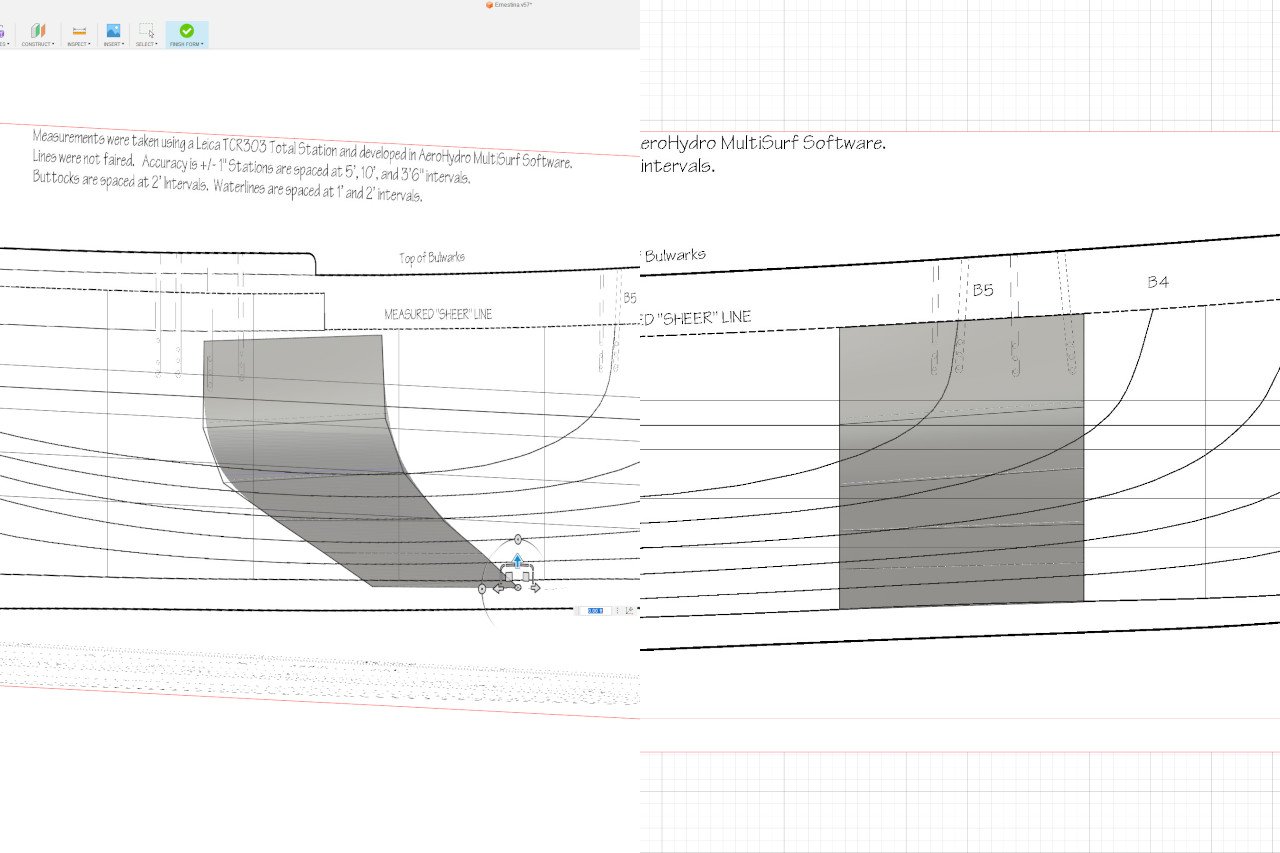

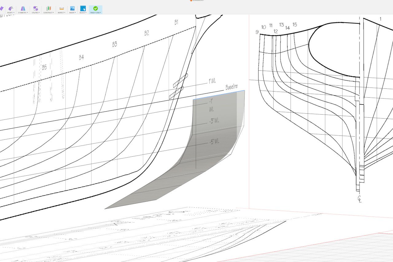

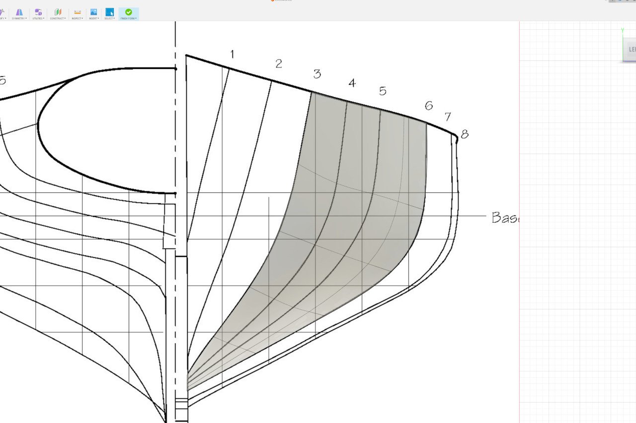

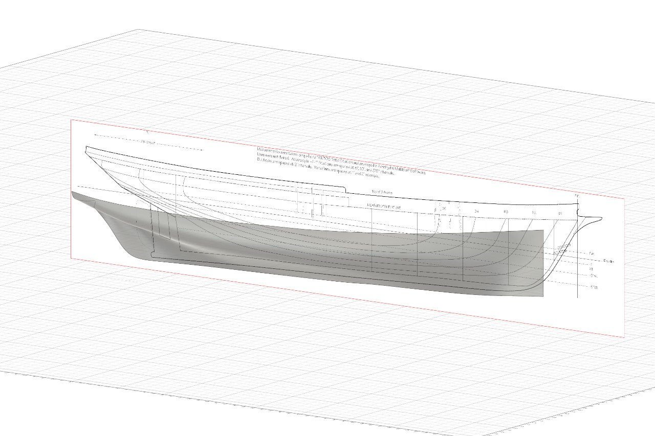

To continue, I extruded (added another row or column of control grid points) in the direction of the bow.  I adjusted the curve of the new edge to the station.  And then another.
ernestina_tspline_06.jpg.aa4854699714a3033d5761b4e7924740.jpgernestina_tspline_07.jpg.4ea1b6709eebceebcfaeb49249e13ac4.jpg
Working my way toward the bow.
ernestina_tspline_08.jpg.d09a7c5e7579fc31ed2b23d4777777ef.jpgernestina_tspline_09.jpg.1c255cf947c9ae2f8c63c804b904a4b1.jpg

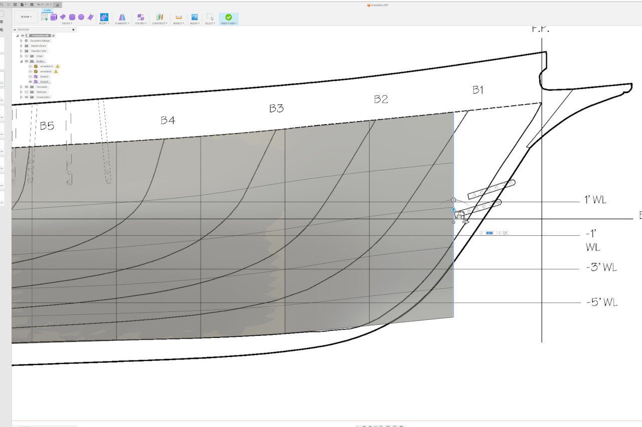

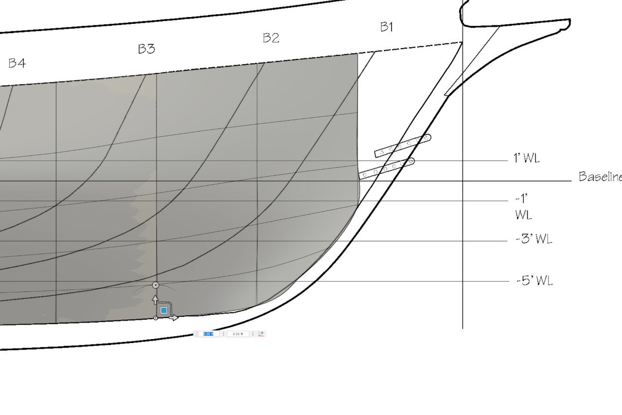

At this point, I tried to match the edge to the stem, but things started getting wobbly and I lost my clean vertical lines, which I need to match each station.
There must be a way to cleanly end forms, but for now, it eludes me.
So instead I just kept extending the form forward as it was.
The process going aft was basically the same.  (I forgot to take screenshots.  Oops.)  Near the rudder I did curve things in a little.

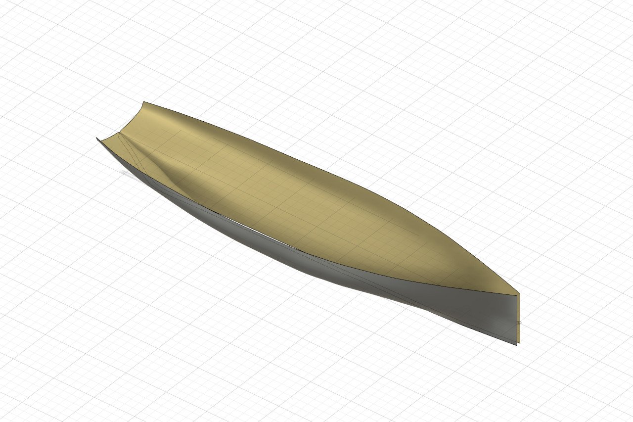

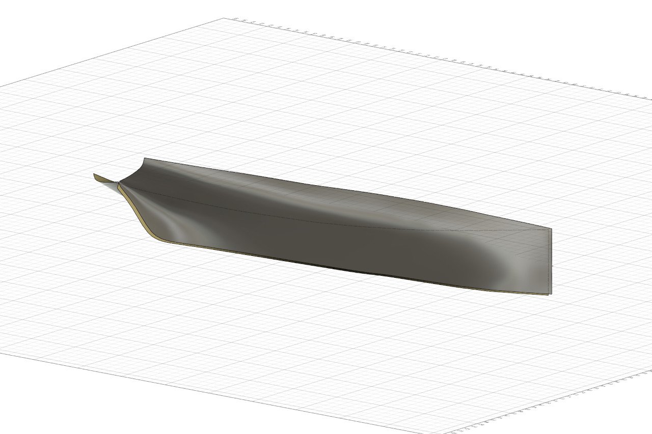

The form was completed and mirrored.  It looks pretty clean.
ernestina_tspline_13.jpg.c1101f23b1ce2087cfc7752745047c2d.jpgernestina_tspline_14.jpg.4f82c9f340e751b93617fee544b8e80b.jpg

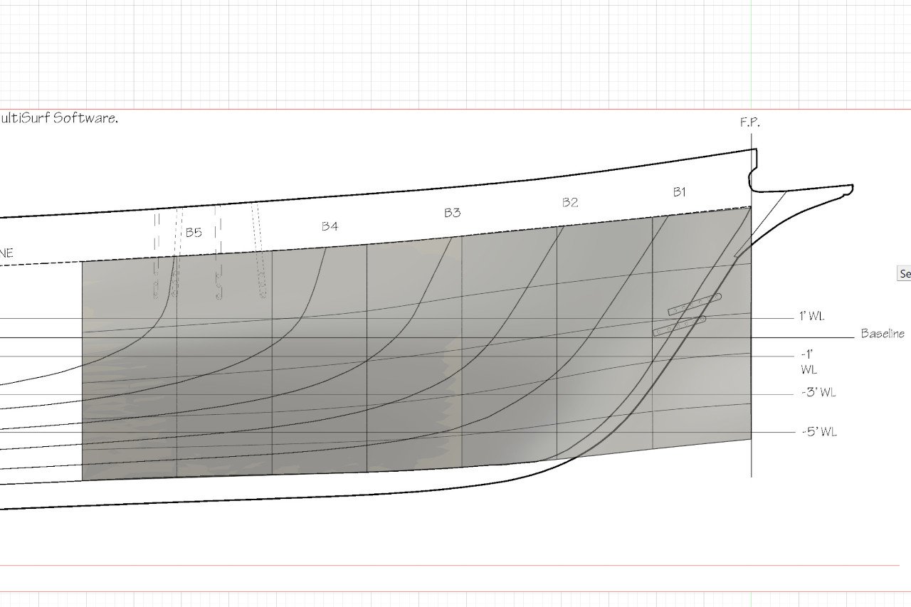

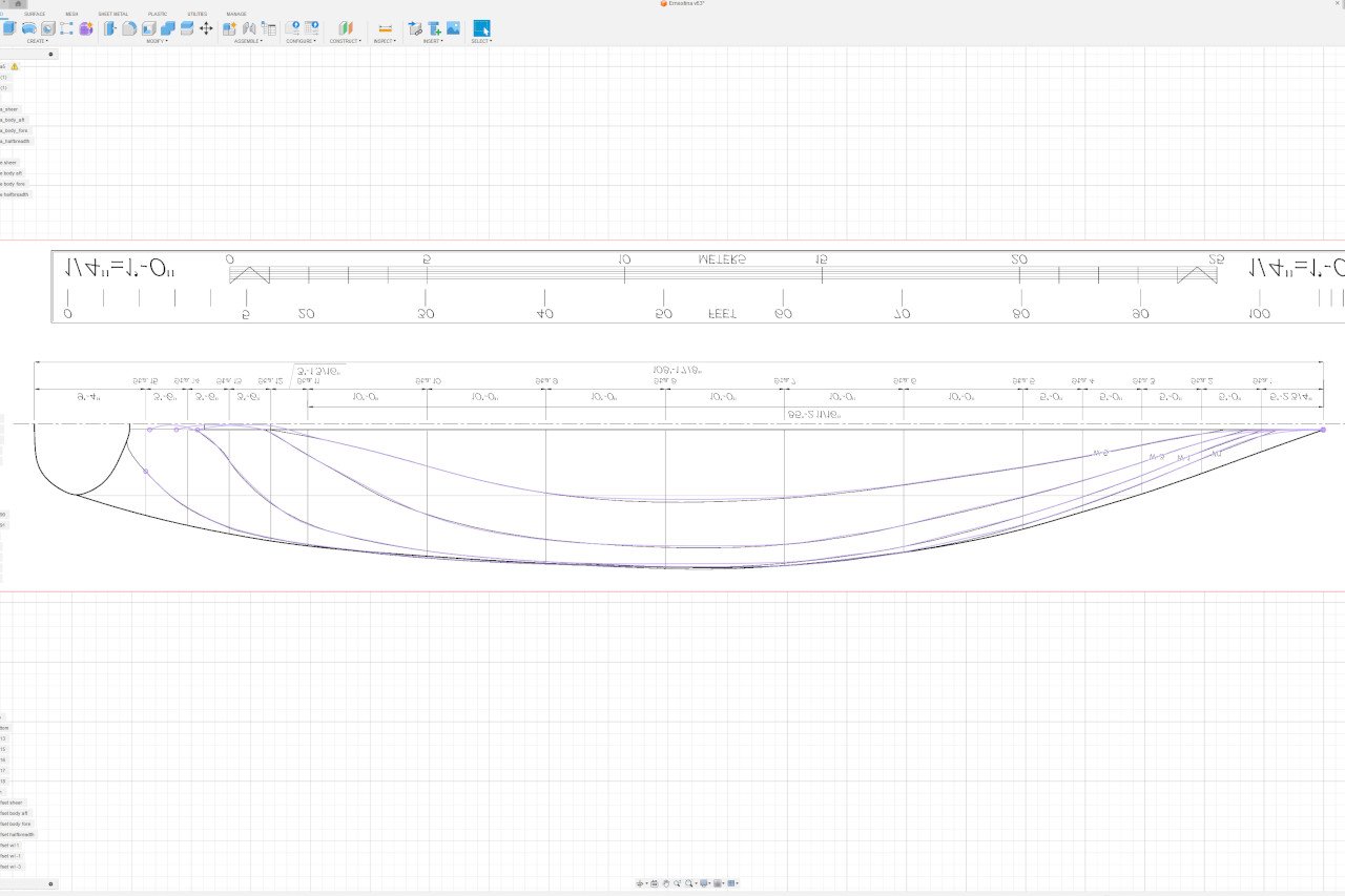

The true test is to see how it holds up if I derive lines from it.  I created new lines by plotting the intersection of the waterline planes and buttock line planes with the new surface.  The results look good.  The only significant deviation I see is the forward end of buttock line 5.
ernestina_tspline_15.jpg.aa6d3ba41fad5d94d5f1262fb989b31e.jpgernestina_tspline_16.jpg.439e2360e50554e5eb5551fe13be033f.jpg
