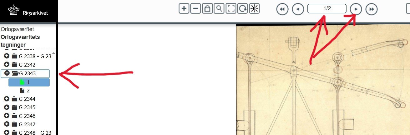

Hello Francois,
There are several other drawings in the Dansk archive as well.  They are all together, numbers G2343 to G2390.
Here is the link to G2343:
Arkivalieronline
Use the control on the top bar and the list on the left side to view the rest of the series.
Here is the link to the library index cards, the process is the same.
Arkivalieronline
Have fun, there are thousands of images!
Bruce
