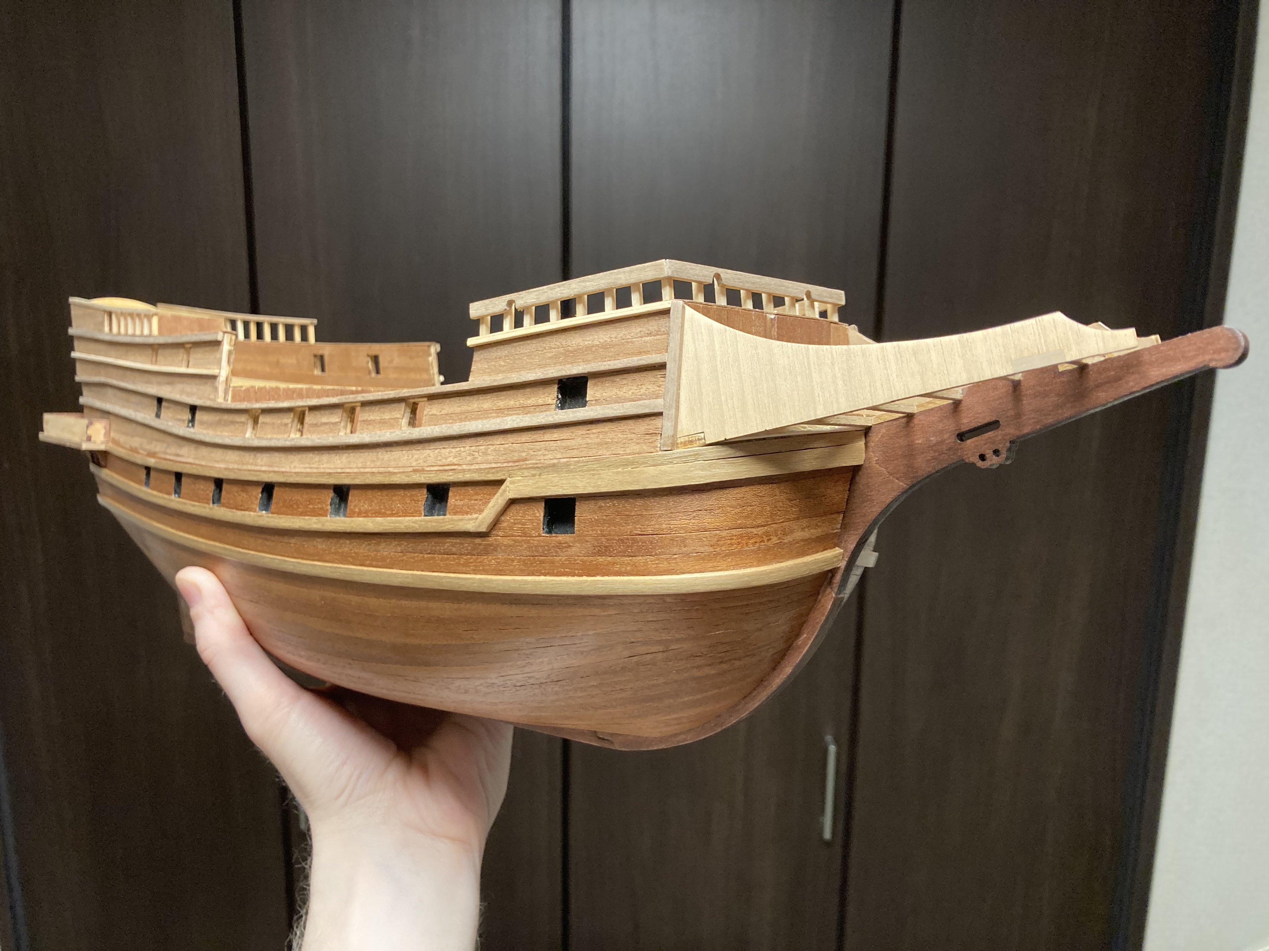

I just wanted to reassure everyone that this build has not been abandoned. Over the last year I made some progress, getting the keel and beak and some of the trickier wales on. And the gallery.
It’s hard to come back to this project now as I have evolved a bit as a modeler; I realize just how much of a “product” these kinds of kits are and how many corners they cut to make a kit cheap and attractive to lazy builders.  It may make business sense, and to be fair this is one of their older and cheaper kits. However it is important for us as modelers to unlearn the myth of straight-cut planking; and plywood has no business in our ship models. At least for the visible parts.
Still, I mean to finish this kit, slowly, with some more research. I look forward to the rigging stages. For some reason that seems to be my favorite part.

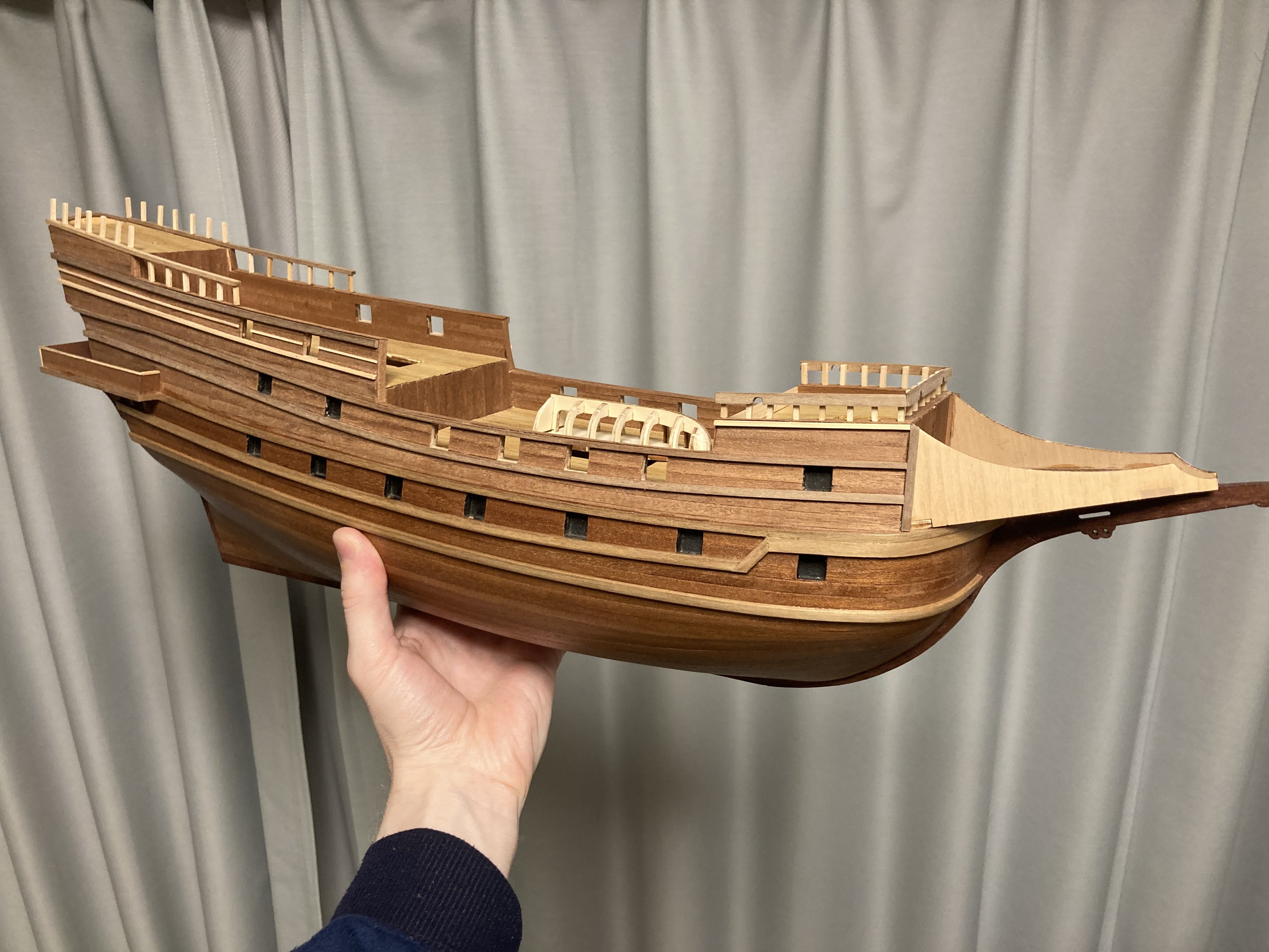

I got around to gluing my re-engineered beakhead together and started putting the rest of the wales and sheer strakes on.

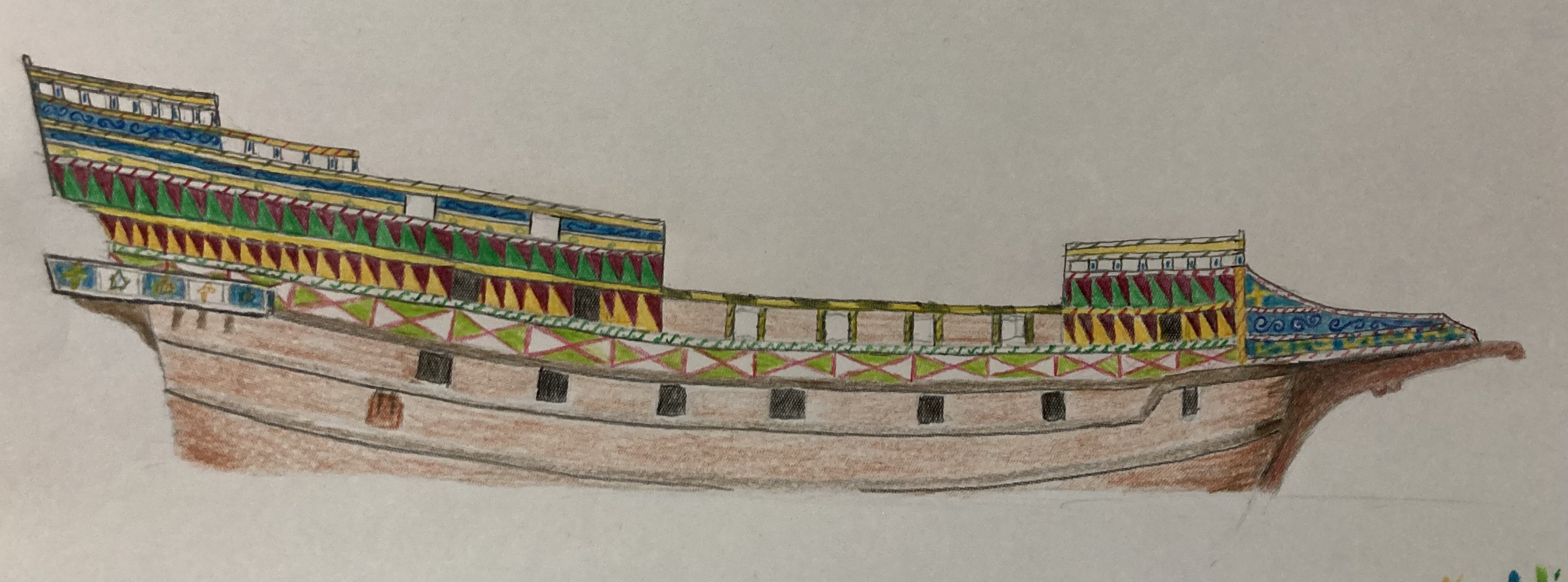

Then I got to thinking about where to actually go with the look, thinking about changes I could make to steer more in the direction of realism than the Occre manual. I got out my colored pencils and reference material and started visualizing.
I decided on a color scheme that strikes a balance between contemporary references and how I’d actually like to paint it. Greens to maintain the Tudor connection, deep yellows and reds because they look great together, and an elegant peacock blue to adorn the beak and upper sterncastle.

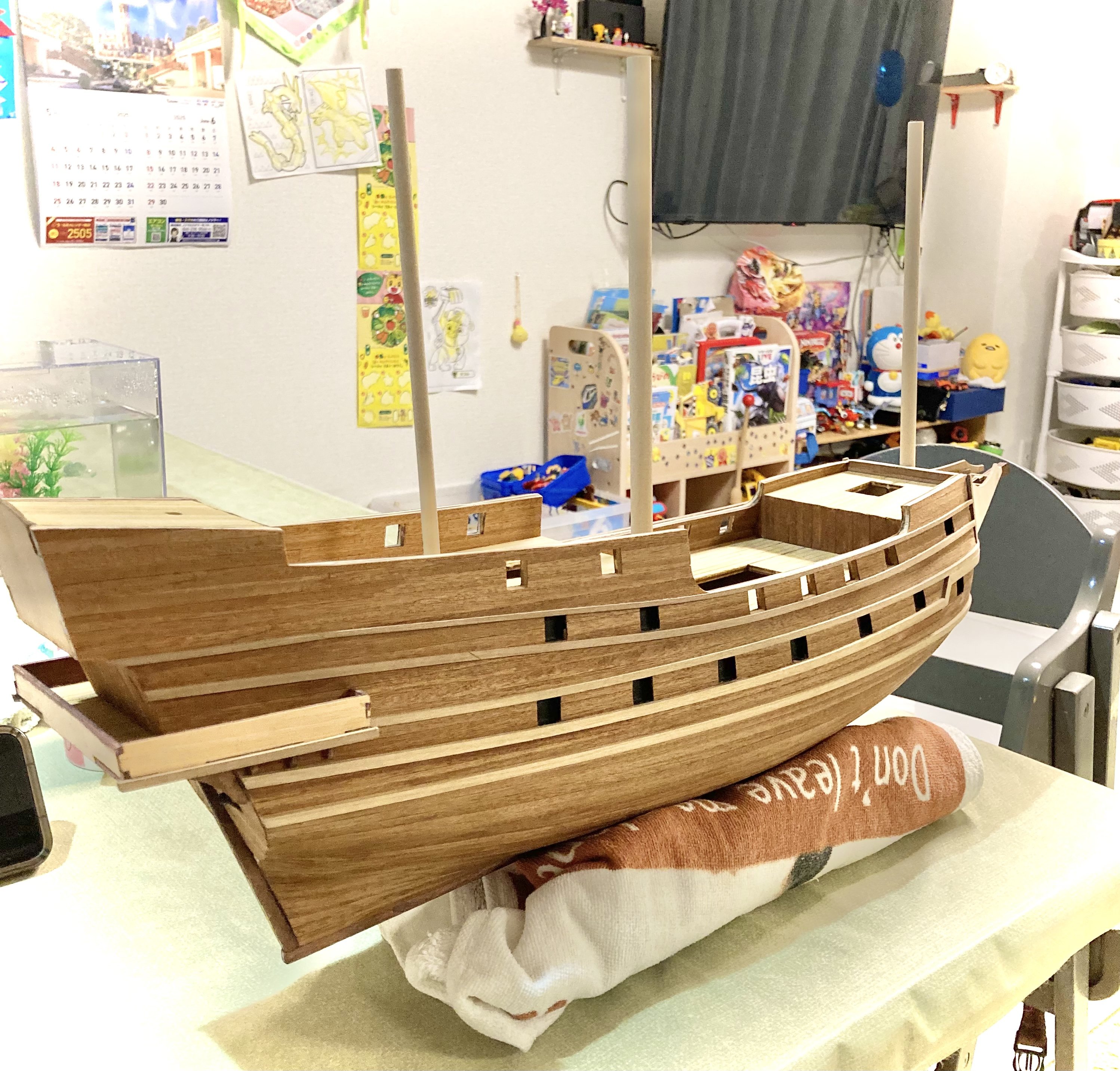

I got all the sheer strakes and rails on as well as I could, making lots of adjustments to the hopelessly out-of-scale suggestions from the Occre instructions. I used a lot of 2x2 and 1x1 mm stock instead of what the kit offered. Now I have lots of leftover African walnut.

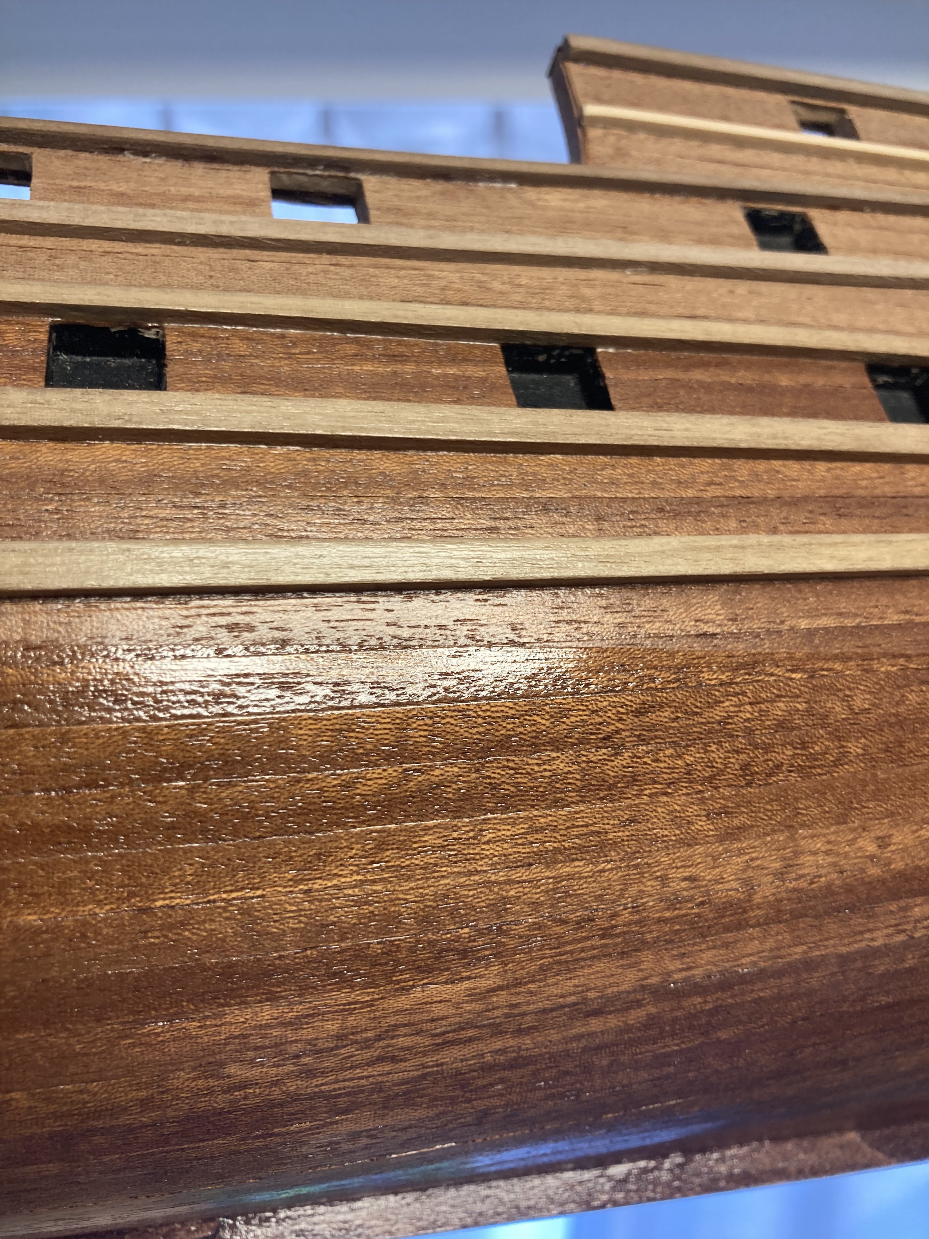

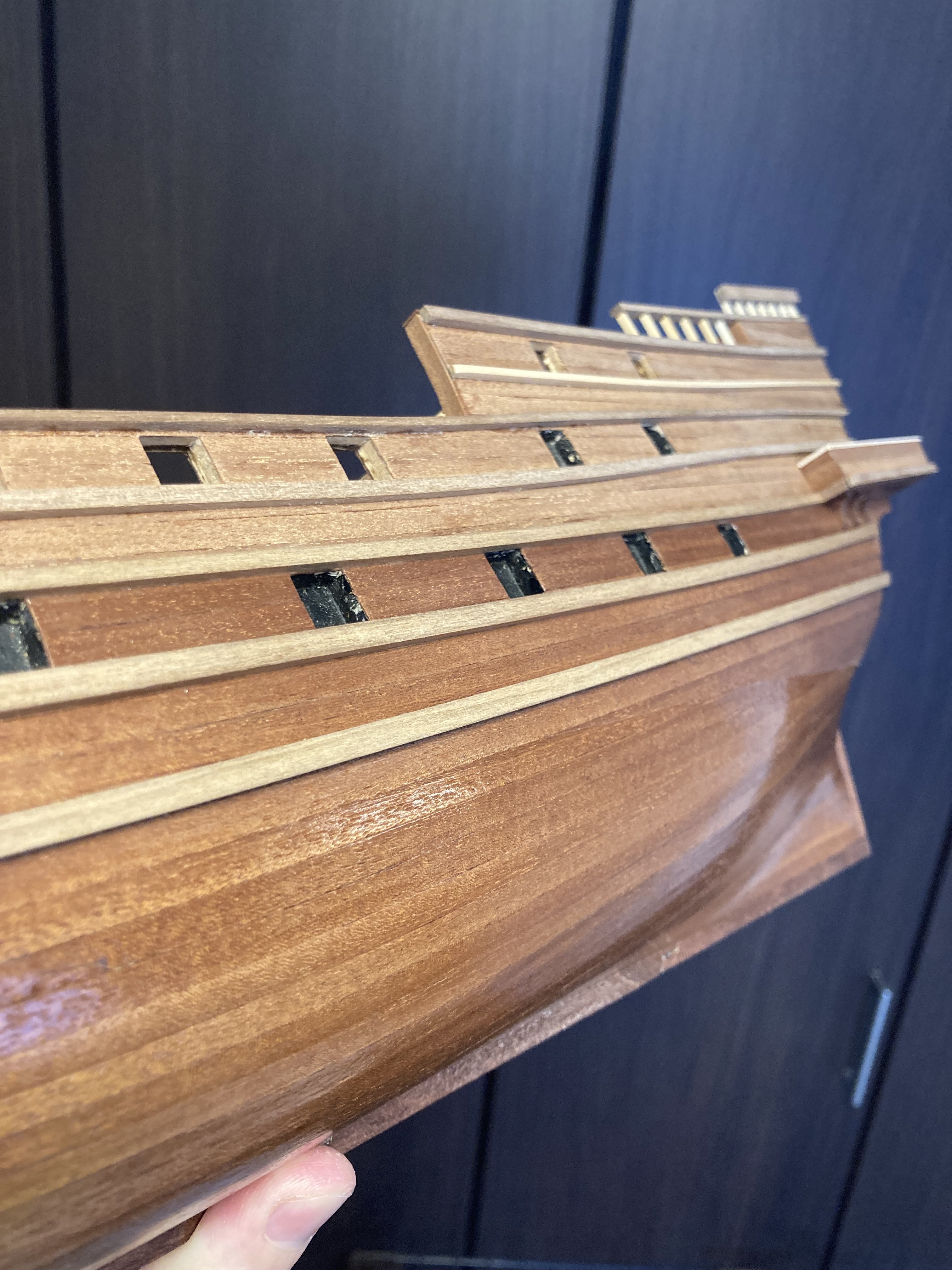

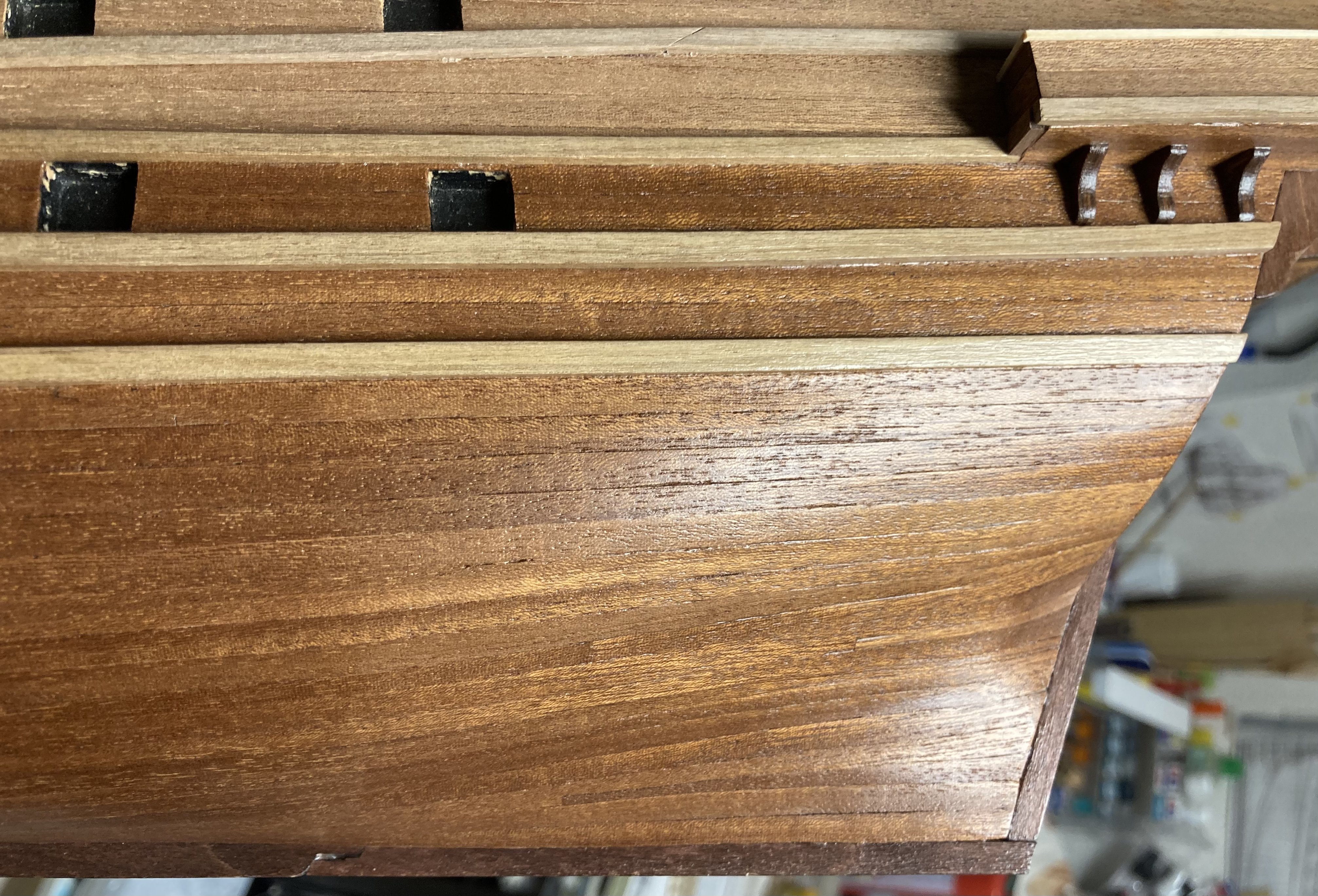

I then managed to apply sanding sealer and a coat of matte varnish (water-based polyurethane) to the lower part of the hull after sanding it for several hours, working from 240 to 320 to 400 and 600 grit.
18E20354-CDD1-47BA-917E-87472DA9805C.thumb.jpeg.84466cde4c60a2caea8cb89de31ccedc.jpegAF064B2E-D2A2-472E-929D-EB185A9B98F1.thumb.jpeg.5fccf2b0e3818b162001f2ac552bc732.jpeg

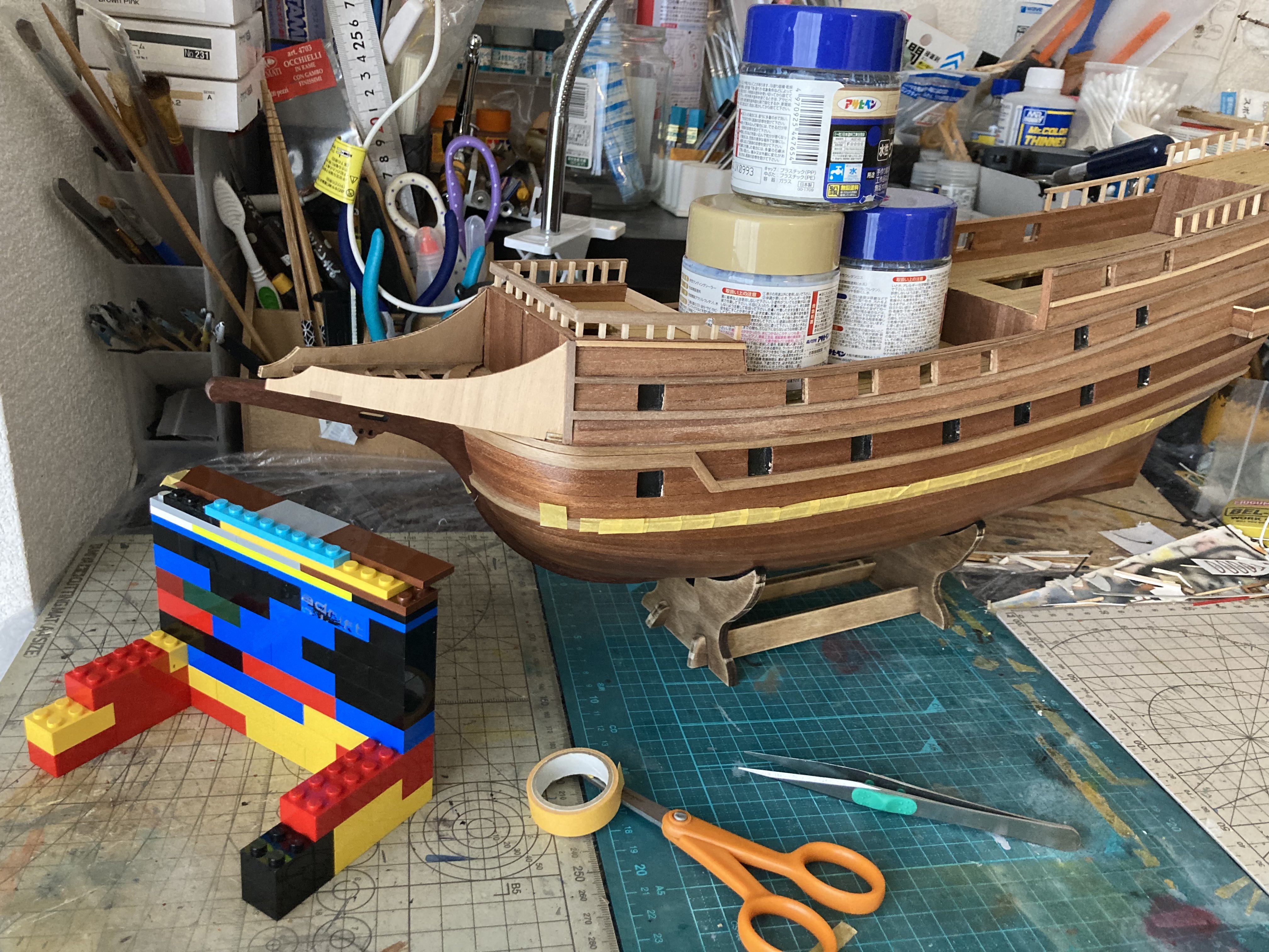

Last, I present my waterline gimmick.
I masked the waterline, using a Lego jig built to the right height. I also applied felt to the stand beforehand so as to protect the underside surface.
After masking, I applied another coat of varnish below the waterline, this time using gloss varnish. It worked well enough, but the difference isn’t as stark as I had hoped. Still, it delineates the waterline if one wants to see where it should be, and displays the sapelli grain in the planking that took so many hours to do. Sorry Kirill4!
I know in reality it would have been painted off-white in a wavy pattern. Ultimately, it’s more a piece of furniture than a scale replica, and I am happy enough with the look.
