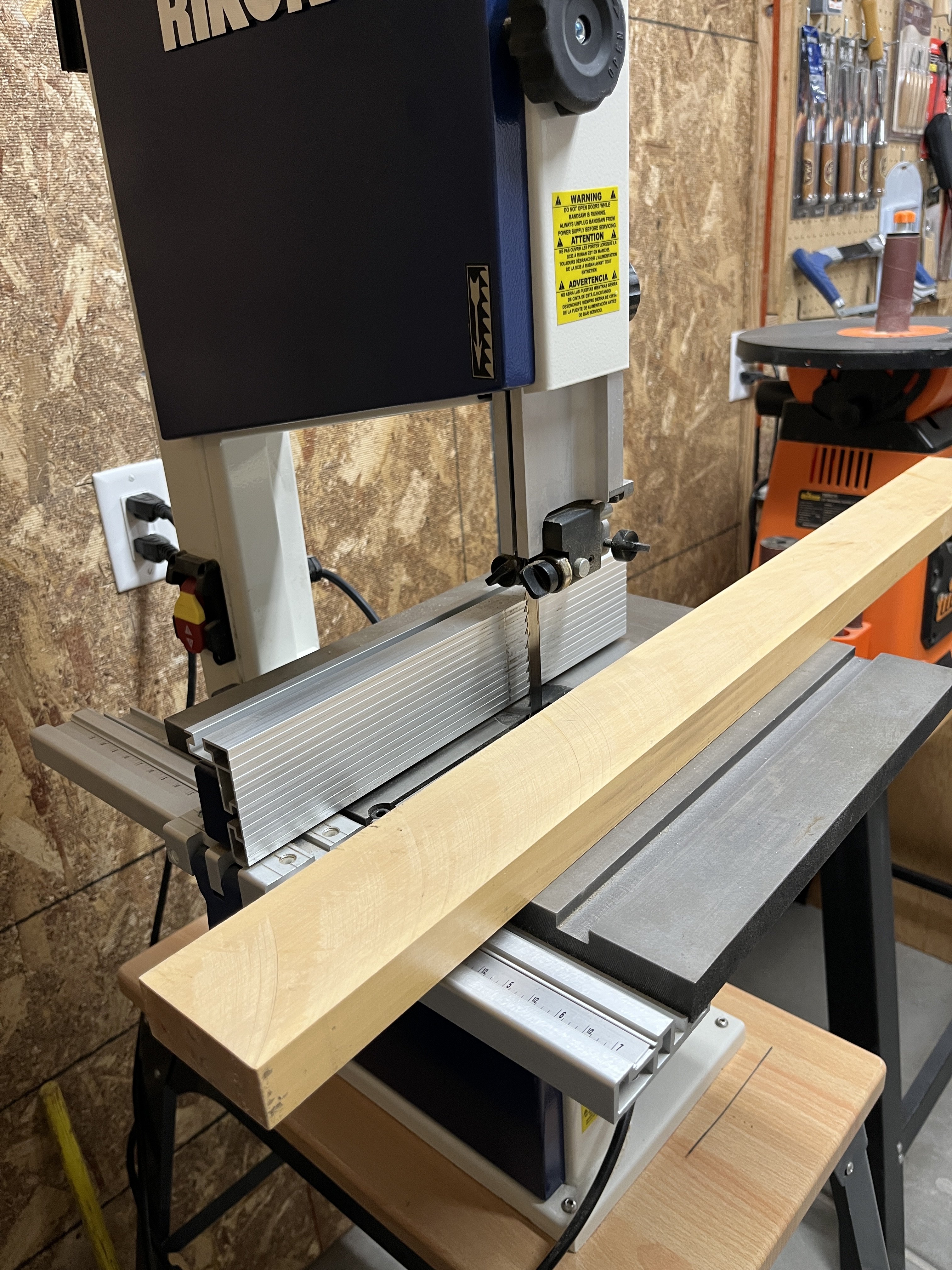

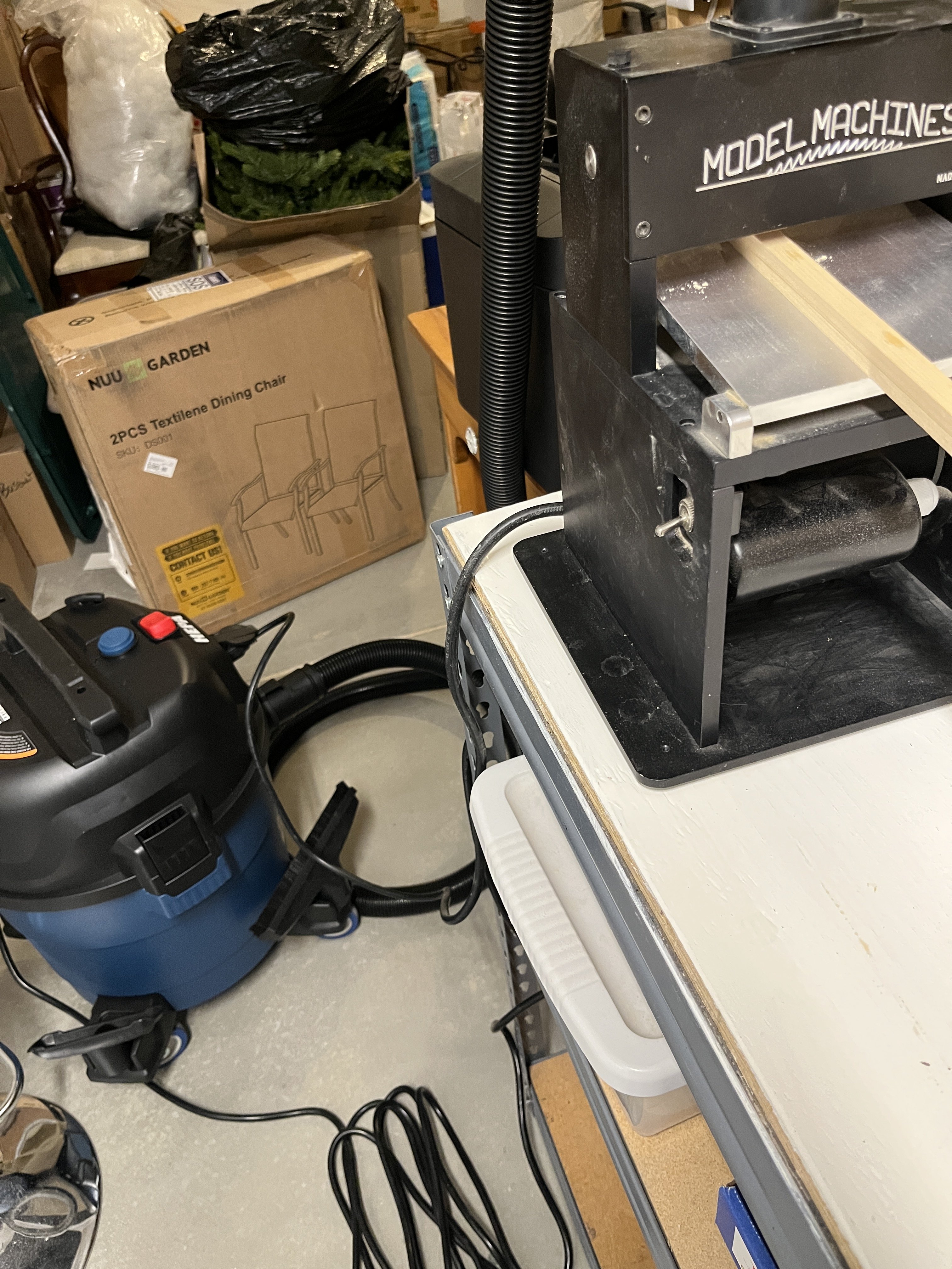

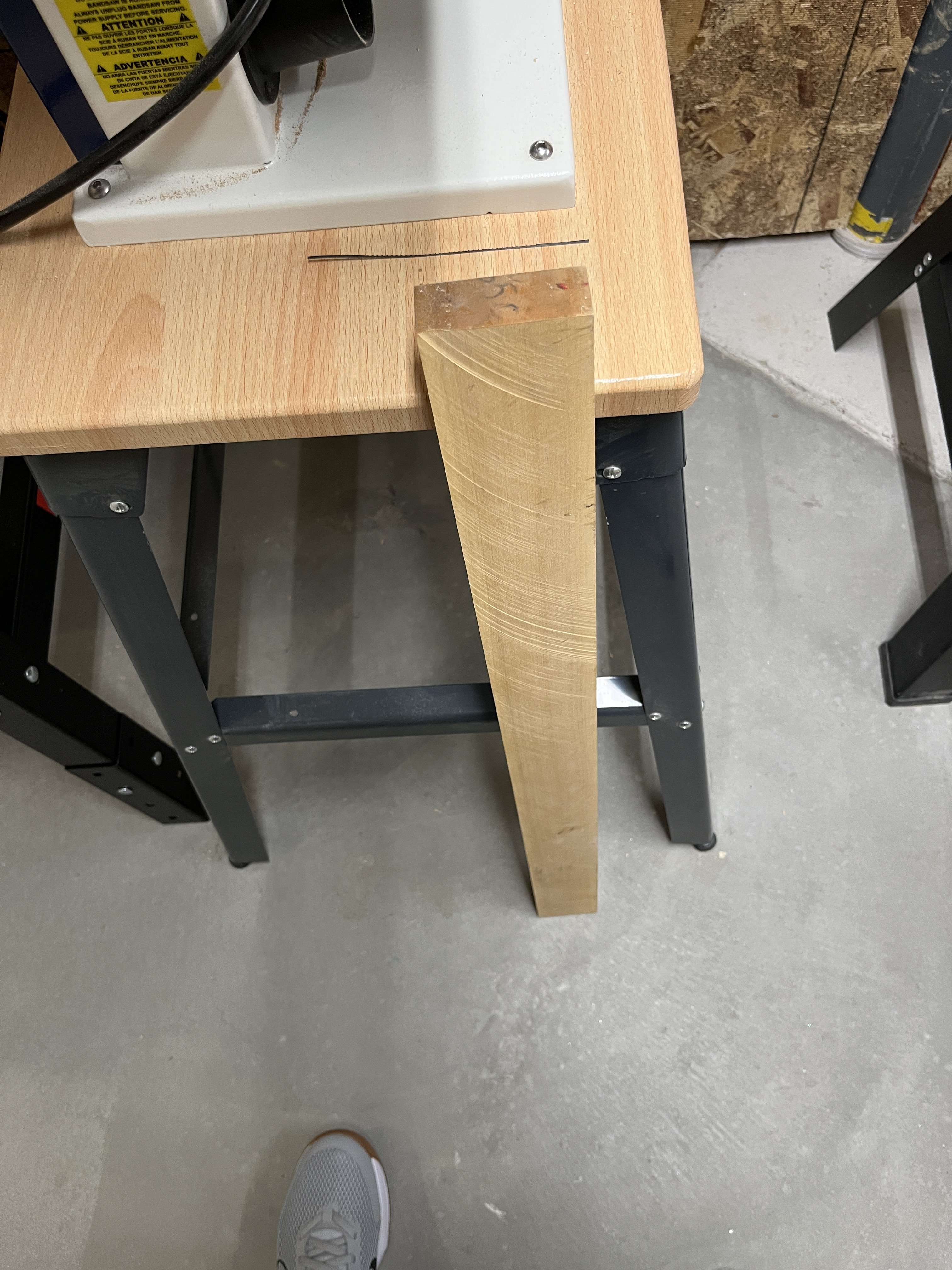

Started out by finding I didn't have the wood. Needing a 5/16" thick AYC or boxwood which I didn't have left me two choices
1) ripping boxwood plank
nIMG_2120.thumb.jpeg.7c51b7d8e0b15fd6706f5af6db041742.jpegIMG_2120.thumb.jpeg.7c51b7d8e0b15fd6706f5af6db041742.jpeg
wasting a large piece of wood for such a small part
or

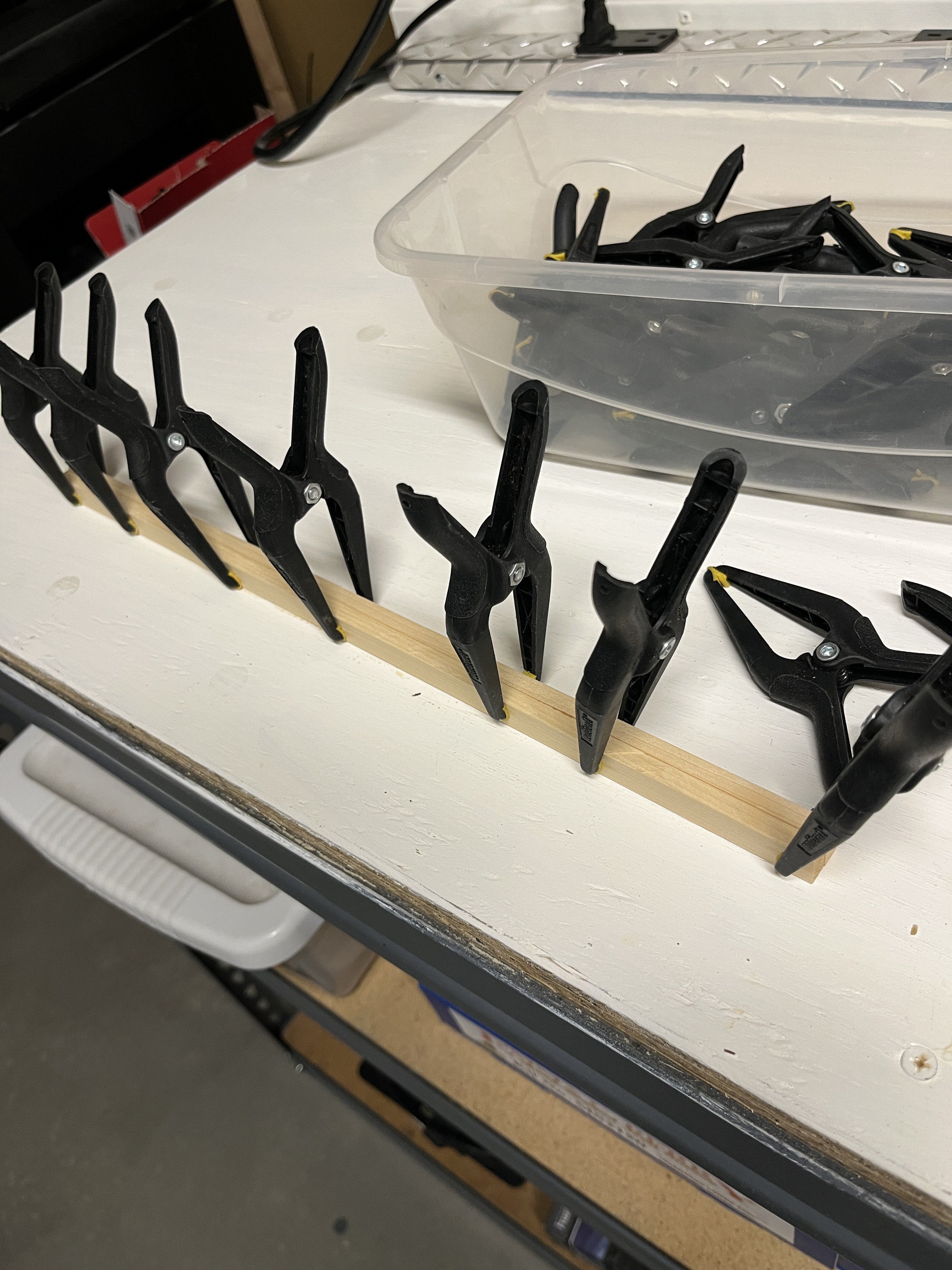

glue two pieces of 5/16" together after ripping and cementing together making a 5/8" for the mast

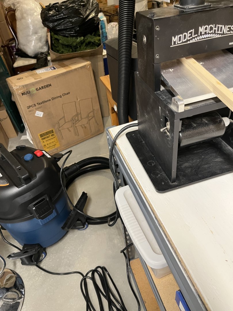

IMG_2144.thumb.jpeg.d61bfe29c41ee1b56e1af5f12387bf52.jpeg.

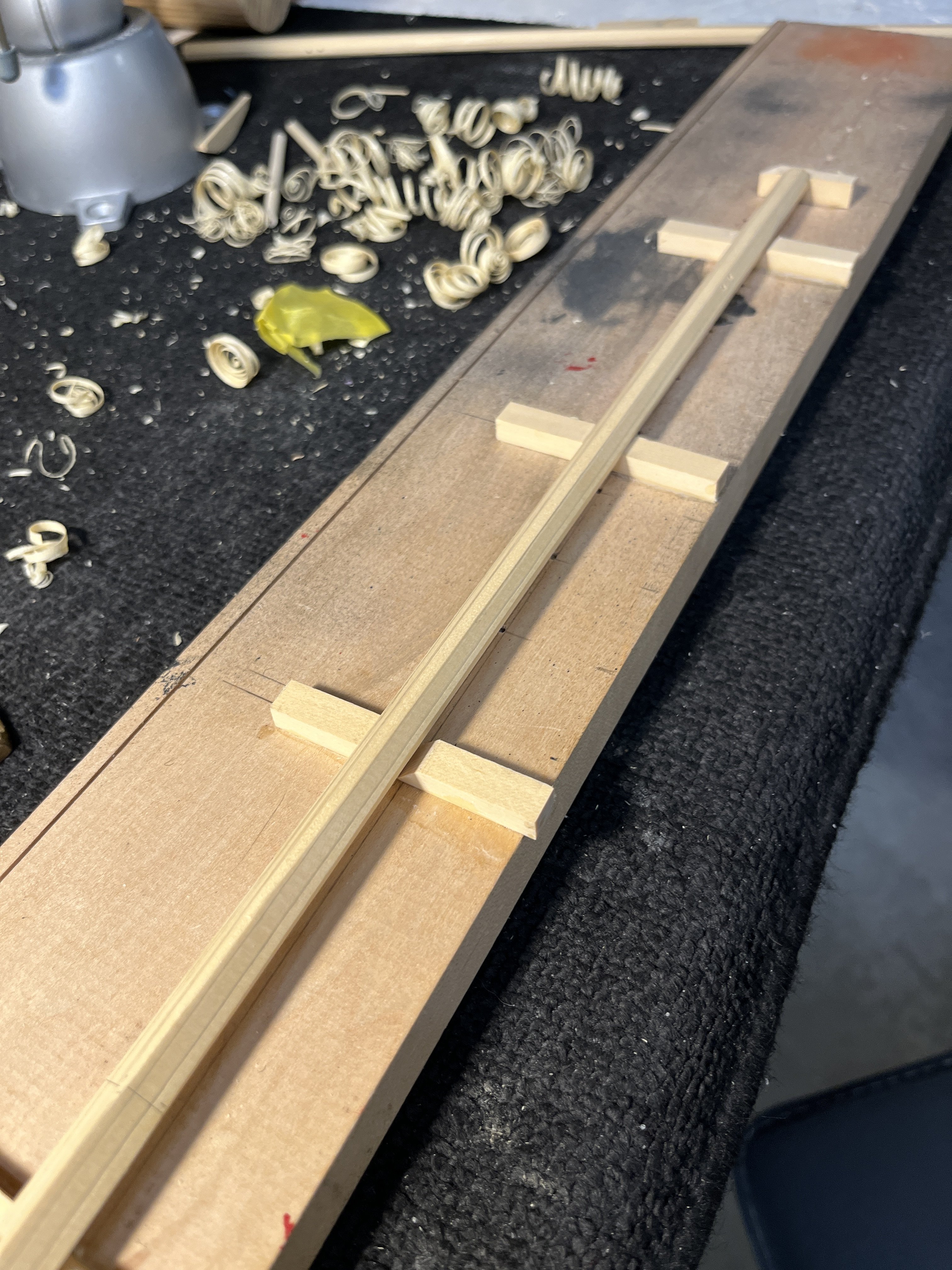

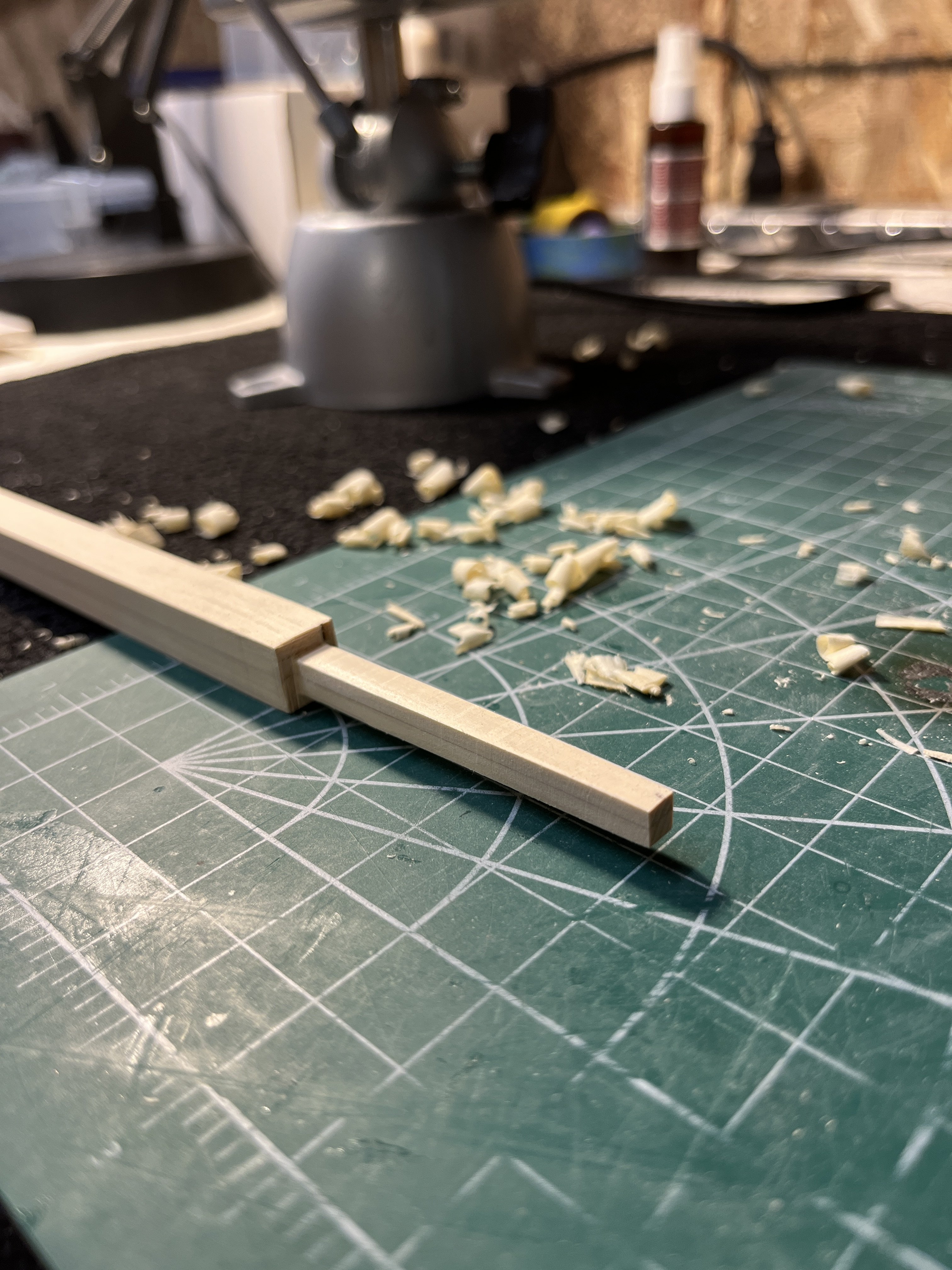

Using the Byrnes sander making a piece 5/16" square
IMG_2145.thumb.jpeg.3febe8725949851d1e2c37d6475d1908.jpeg r
Ready for the square portion of mast

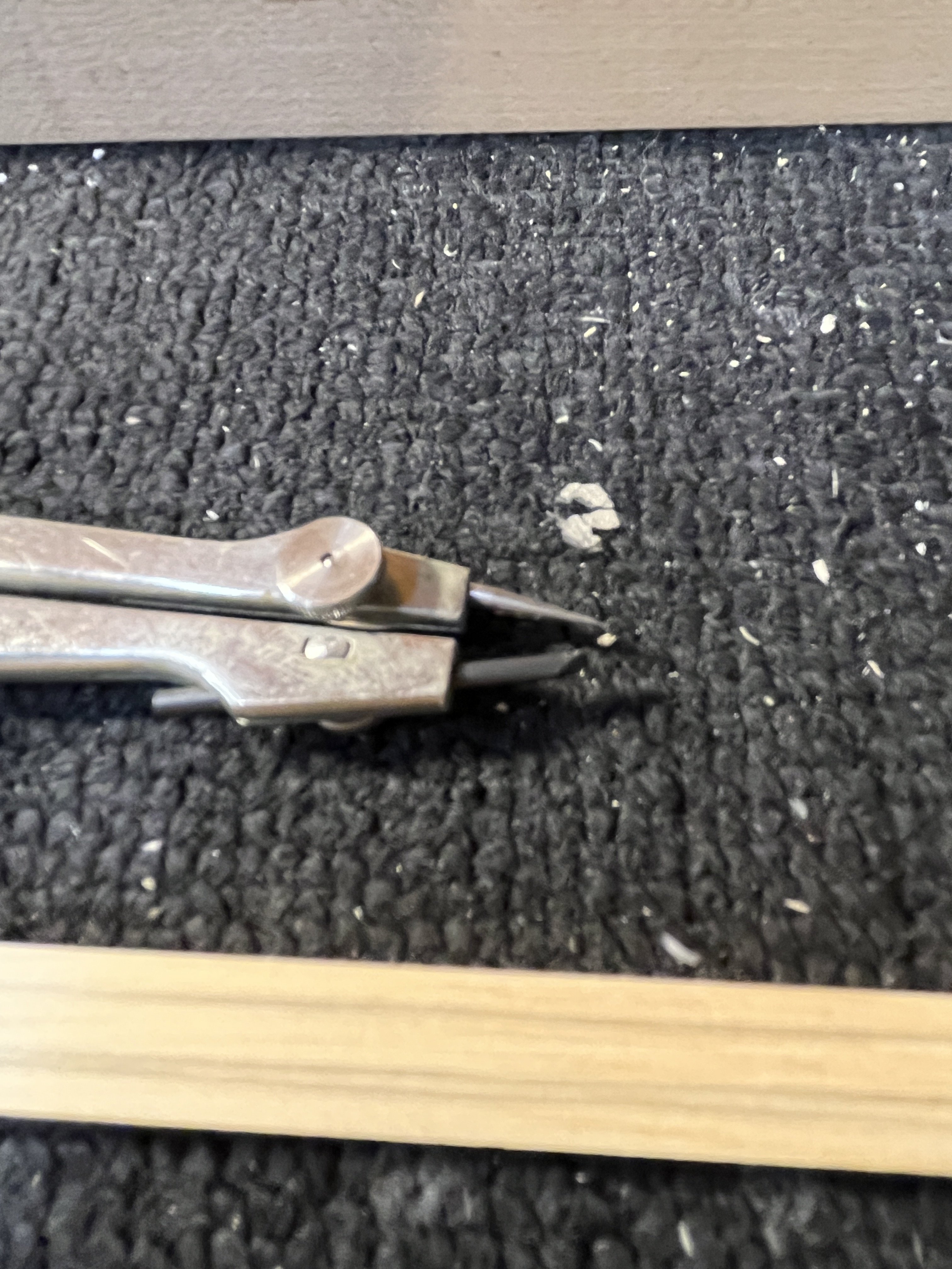

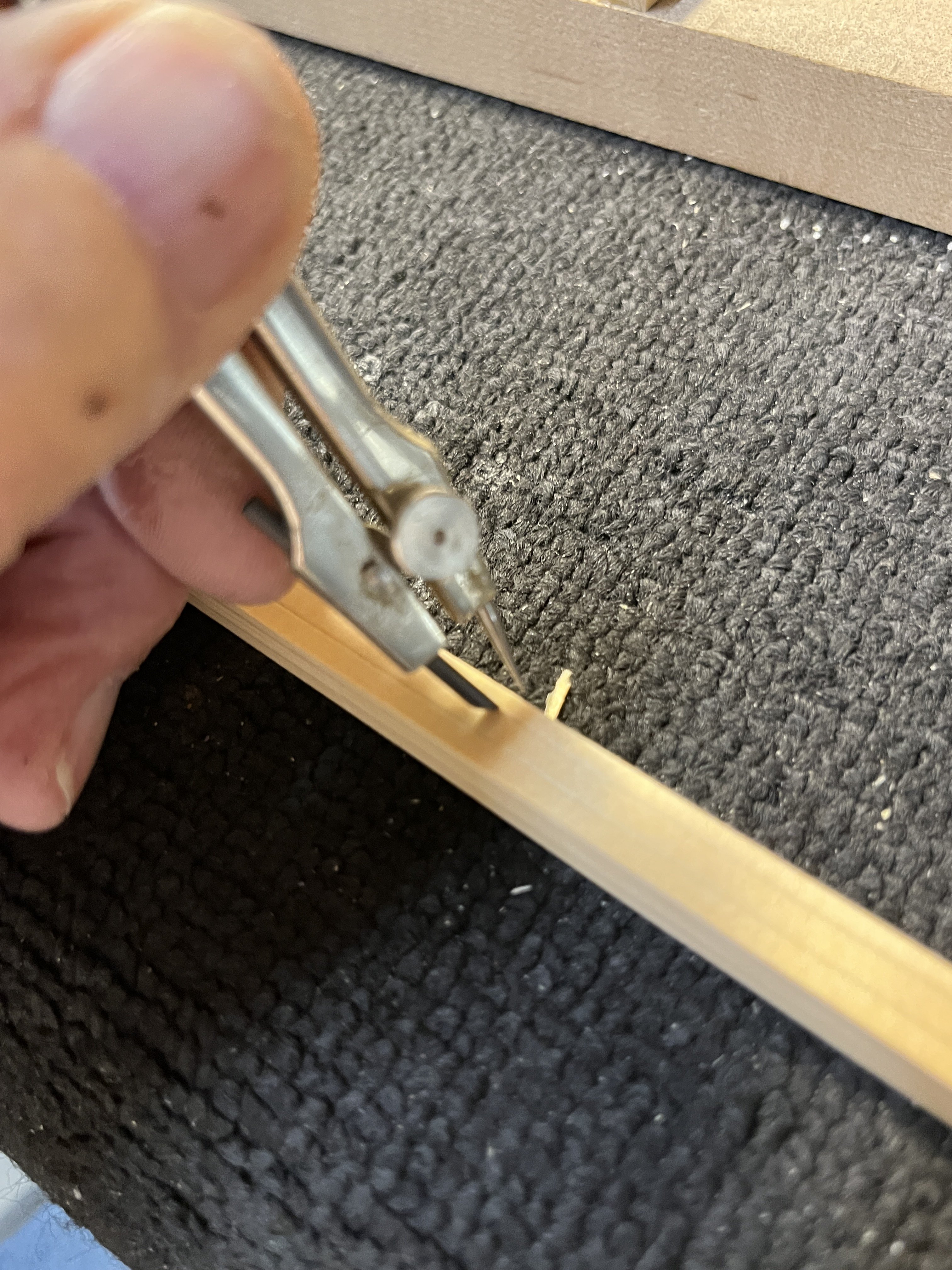

Next using the 7/10/7 method to make an octagon ready for the lathe.
IMG_2079.thumb.jpeg.1d23bad2f217a73221b46422536491ef.jpegIMG_2081.thumb.jpeg.89af3fdfa4aeafe938bce0c823d711df.jpeg
using plane cutting to the marks and into the lathe into the finished mast

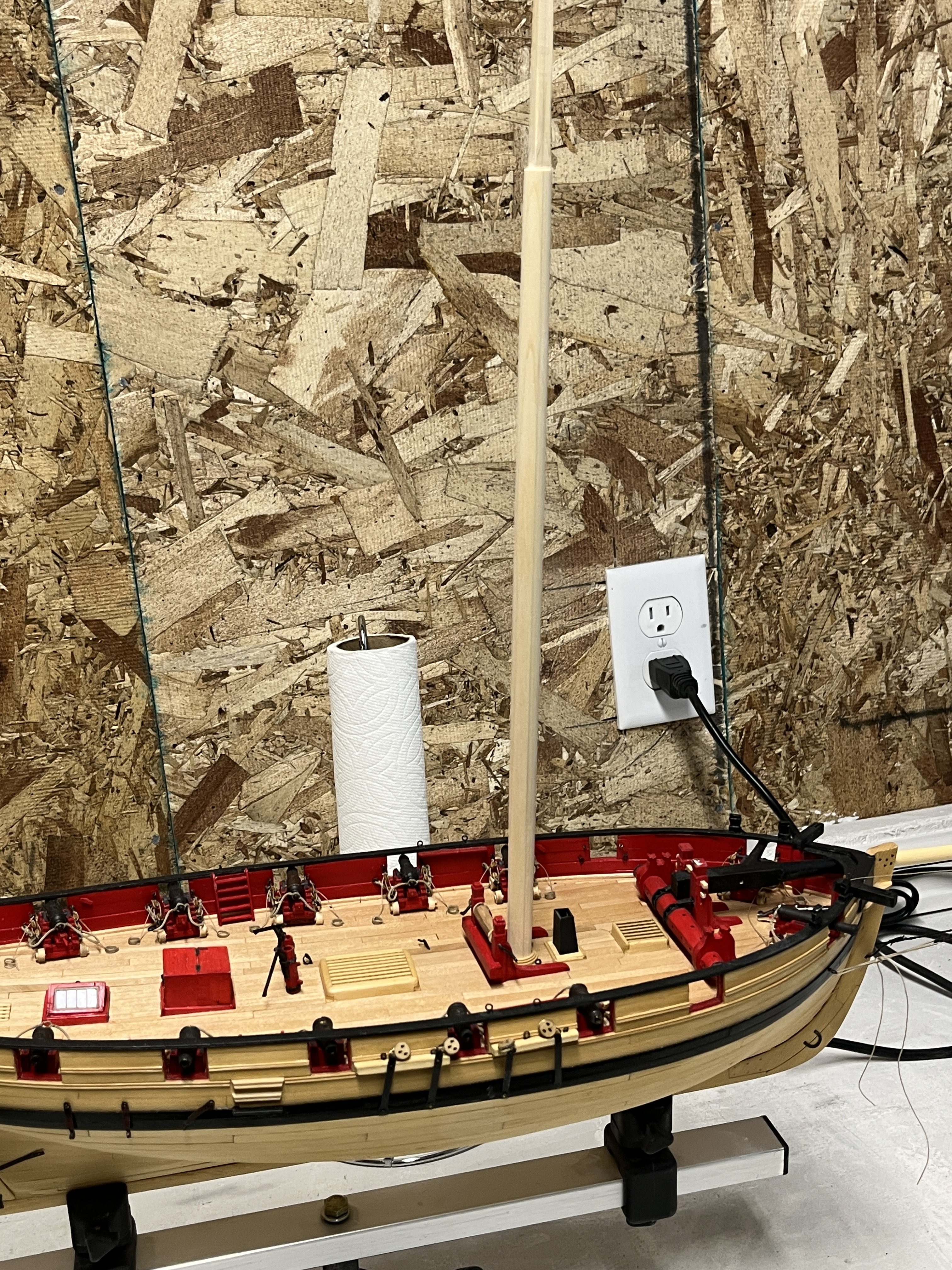

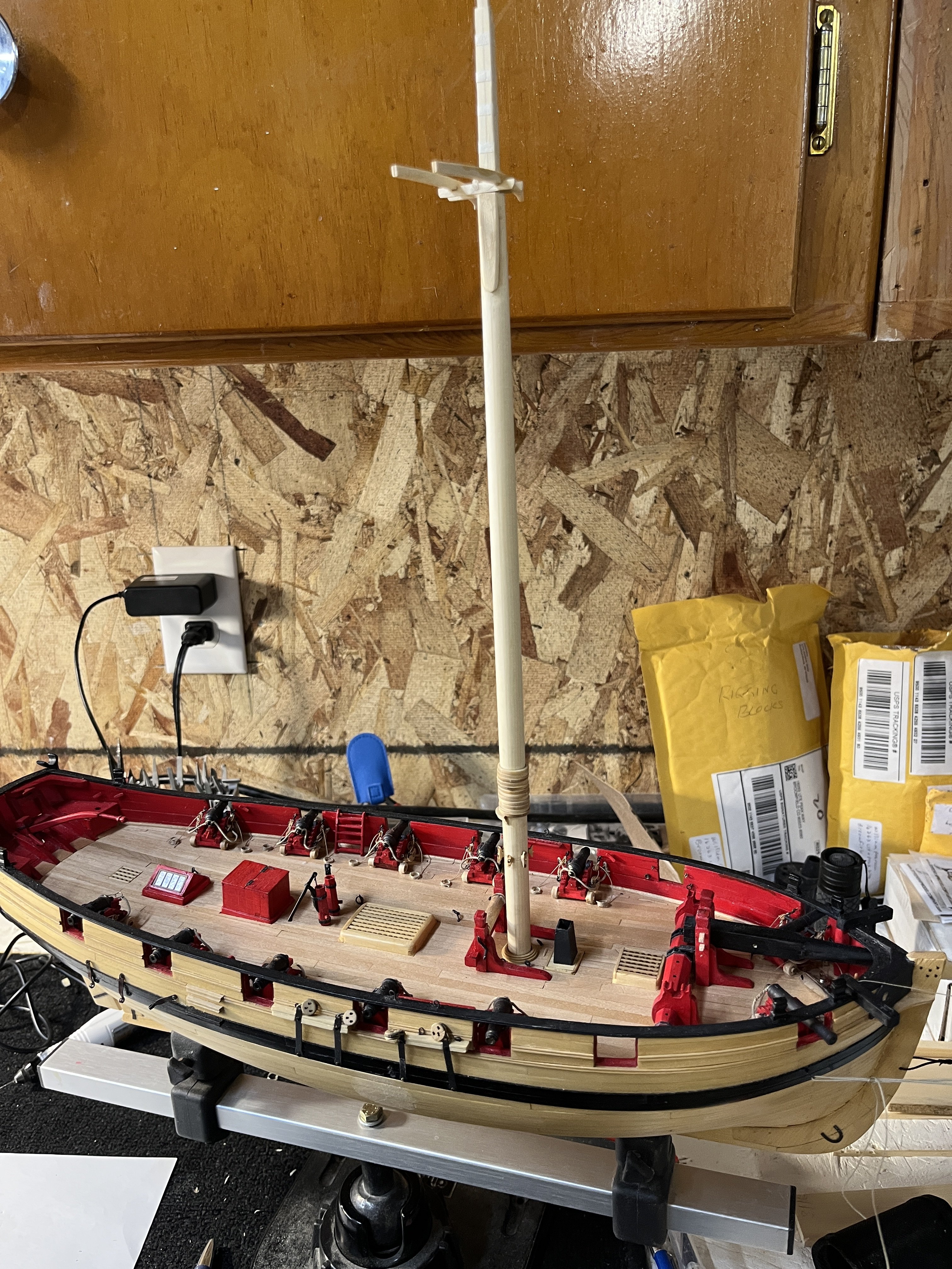

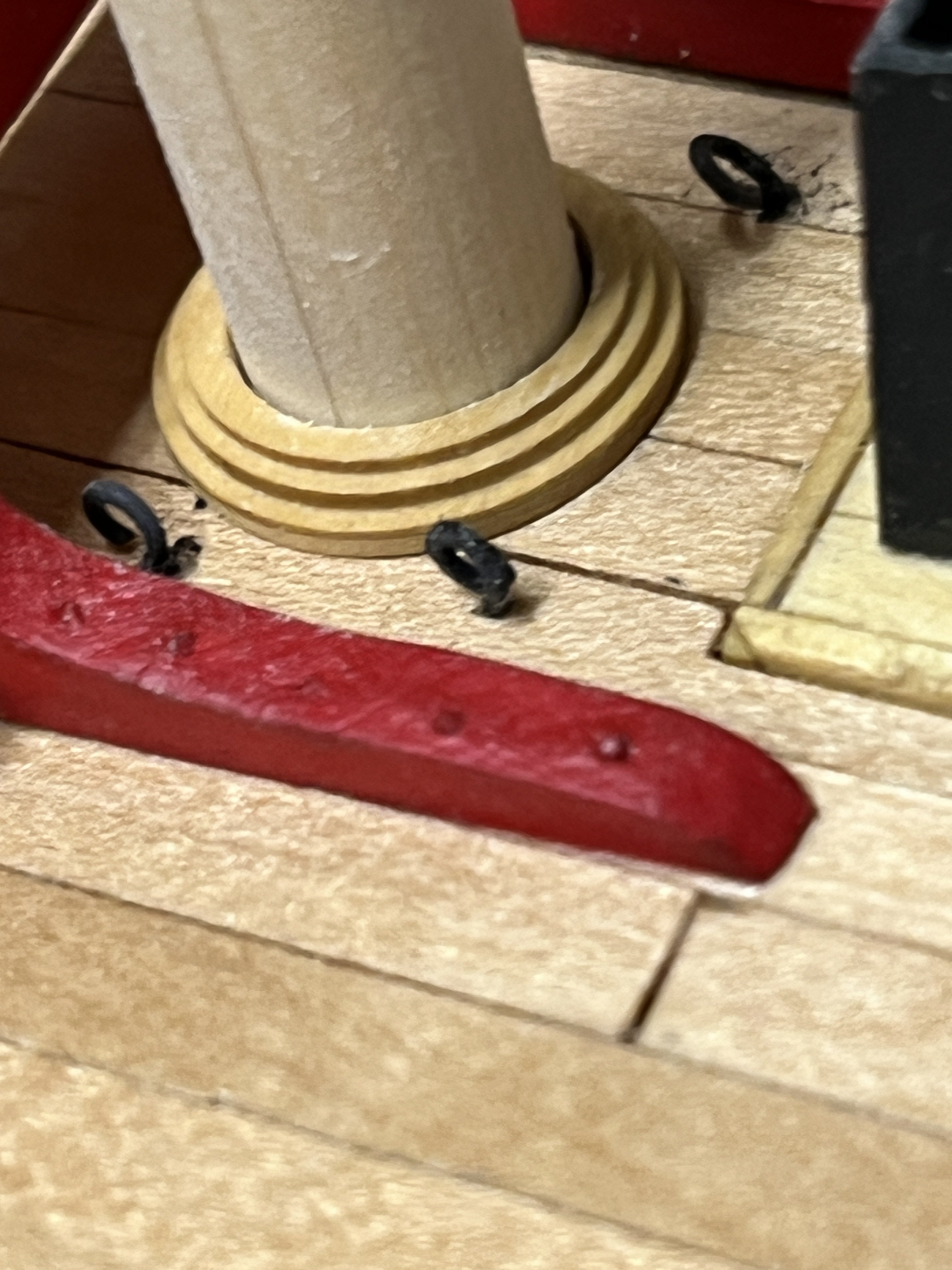

Lower mast was completed last night so now on the to the upper mast and not much to report except how good it looks. No work today except for taking down the Christmas tree and decorations ending the season.
