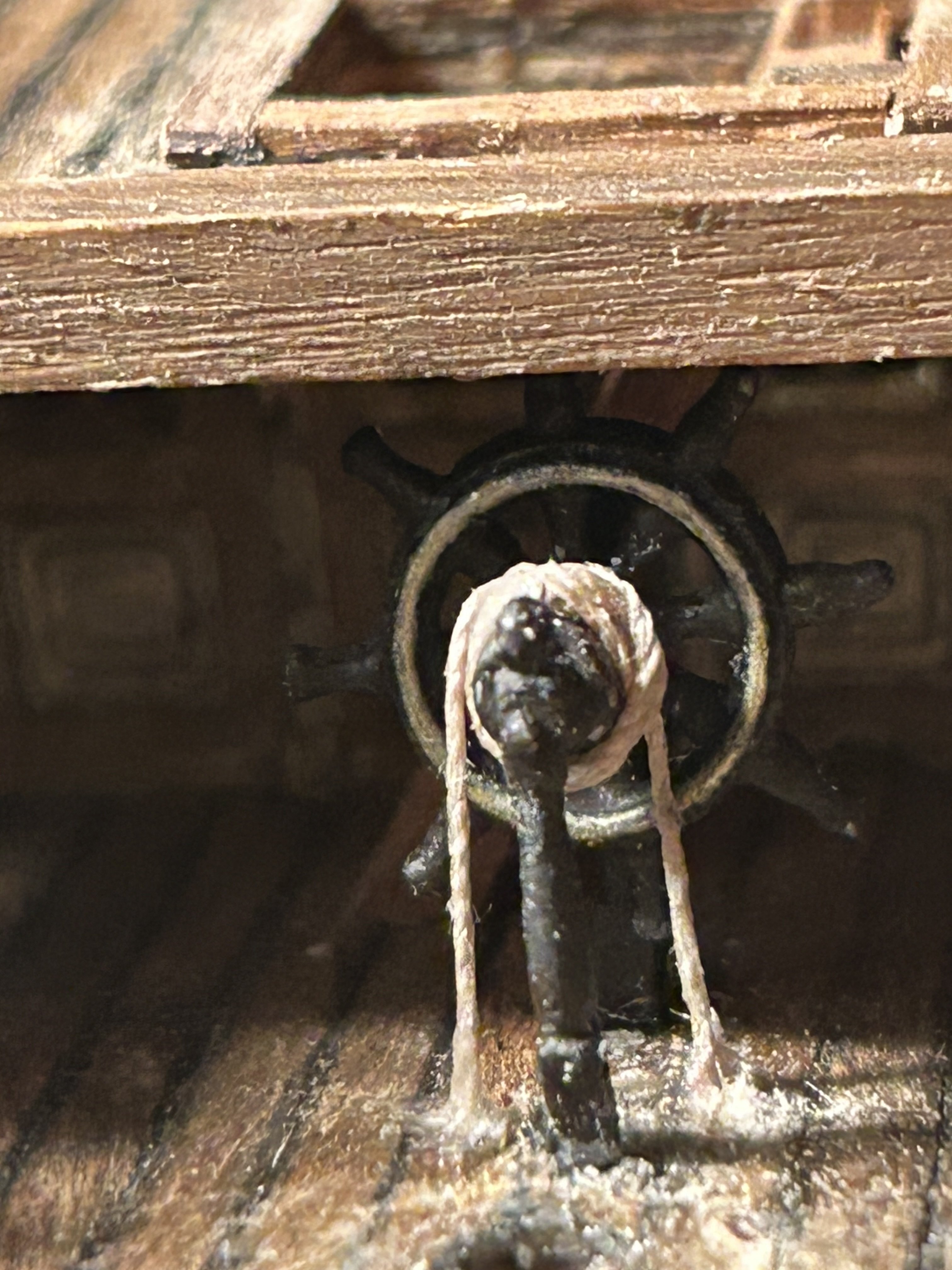

So far, the deck is far less trouble. At this point, I've glued on the cannons, wrapped the wheel in rope, and thanks to @harlequin's advice, I've been able to put all the cleat hitches in place.

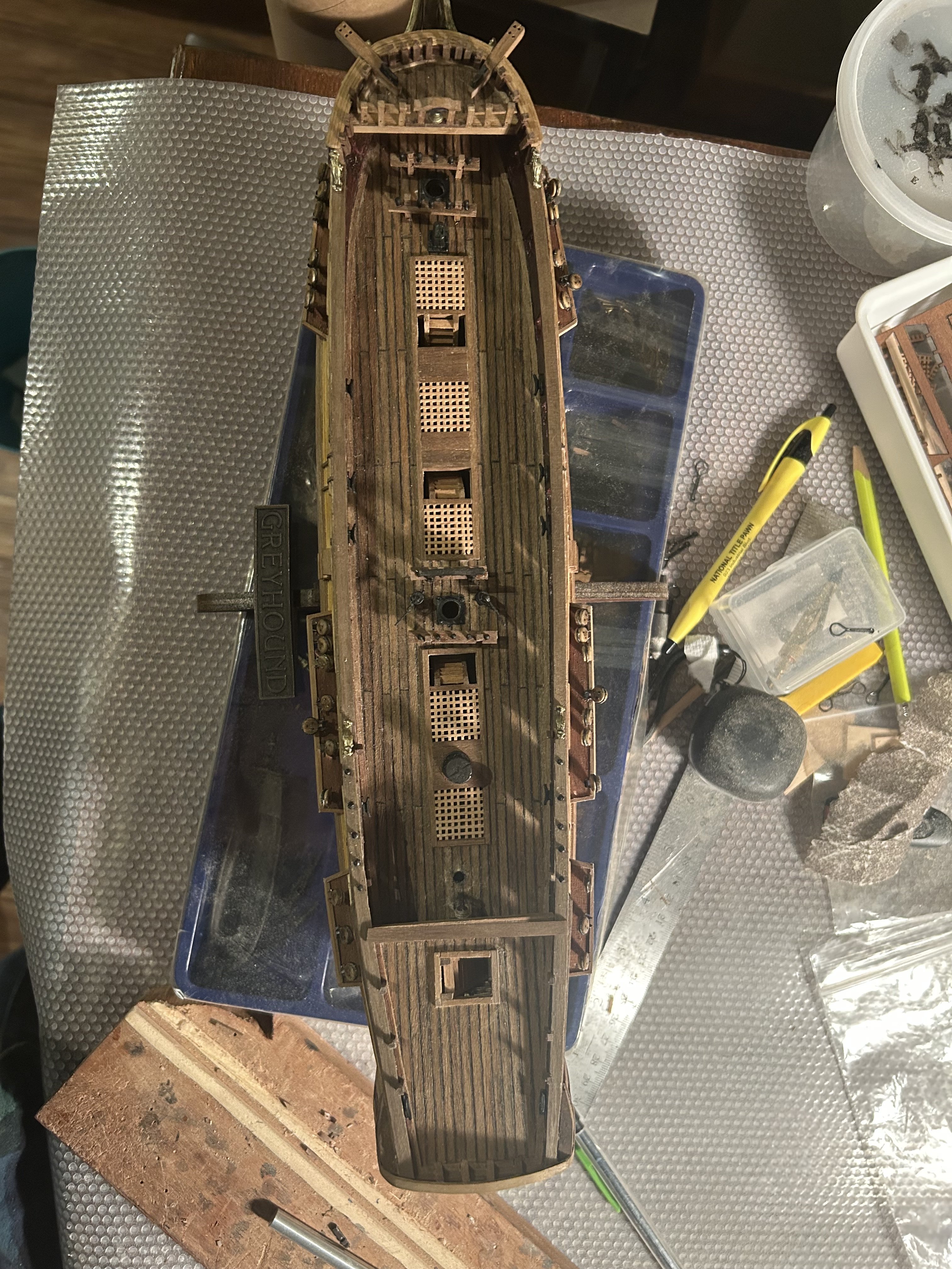

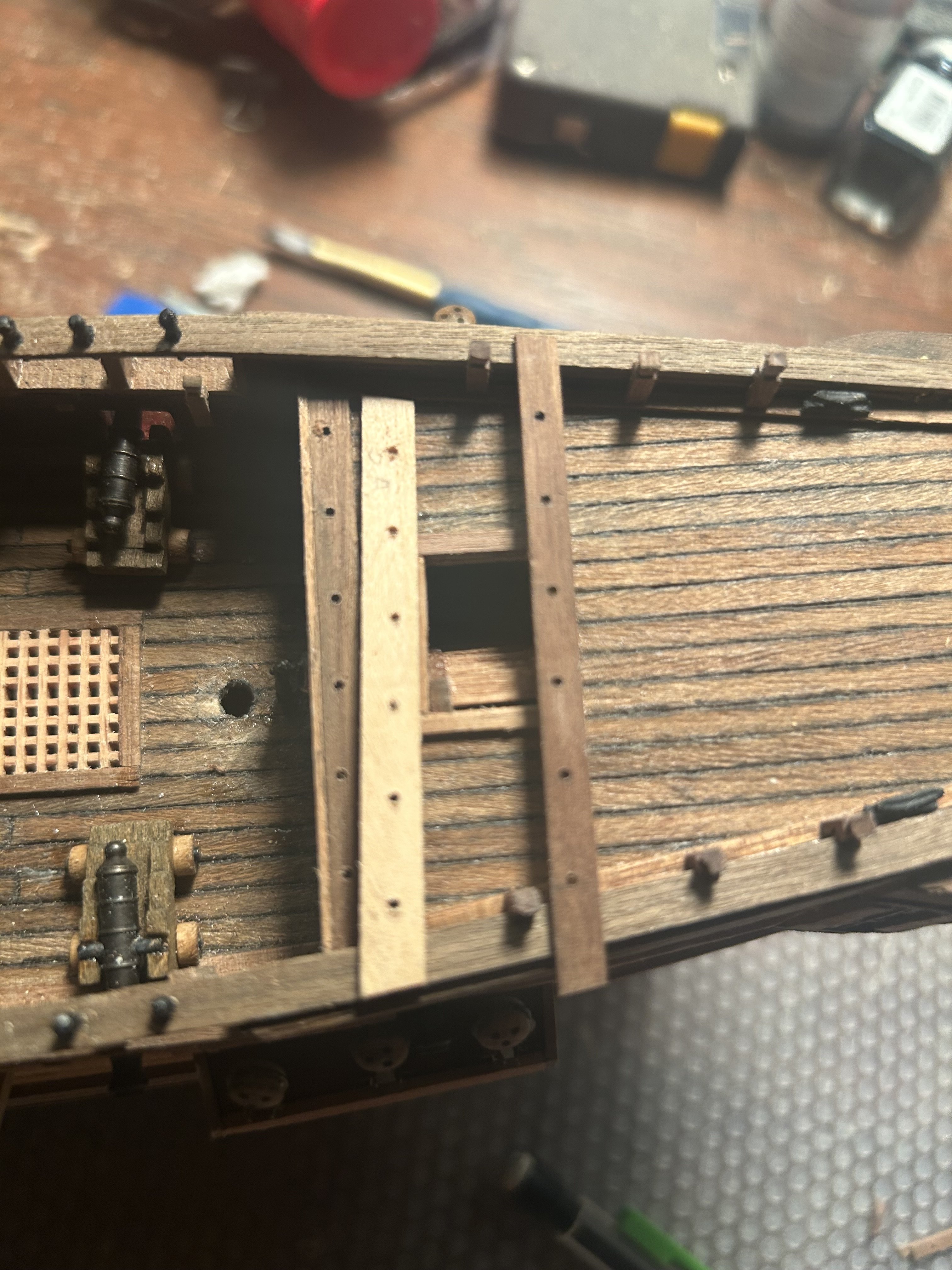

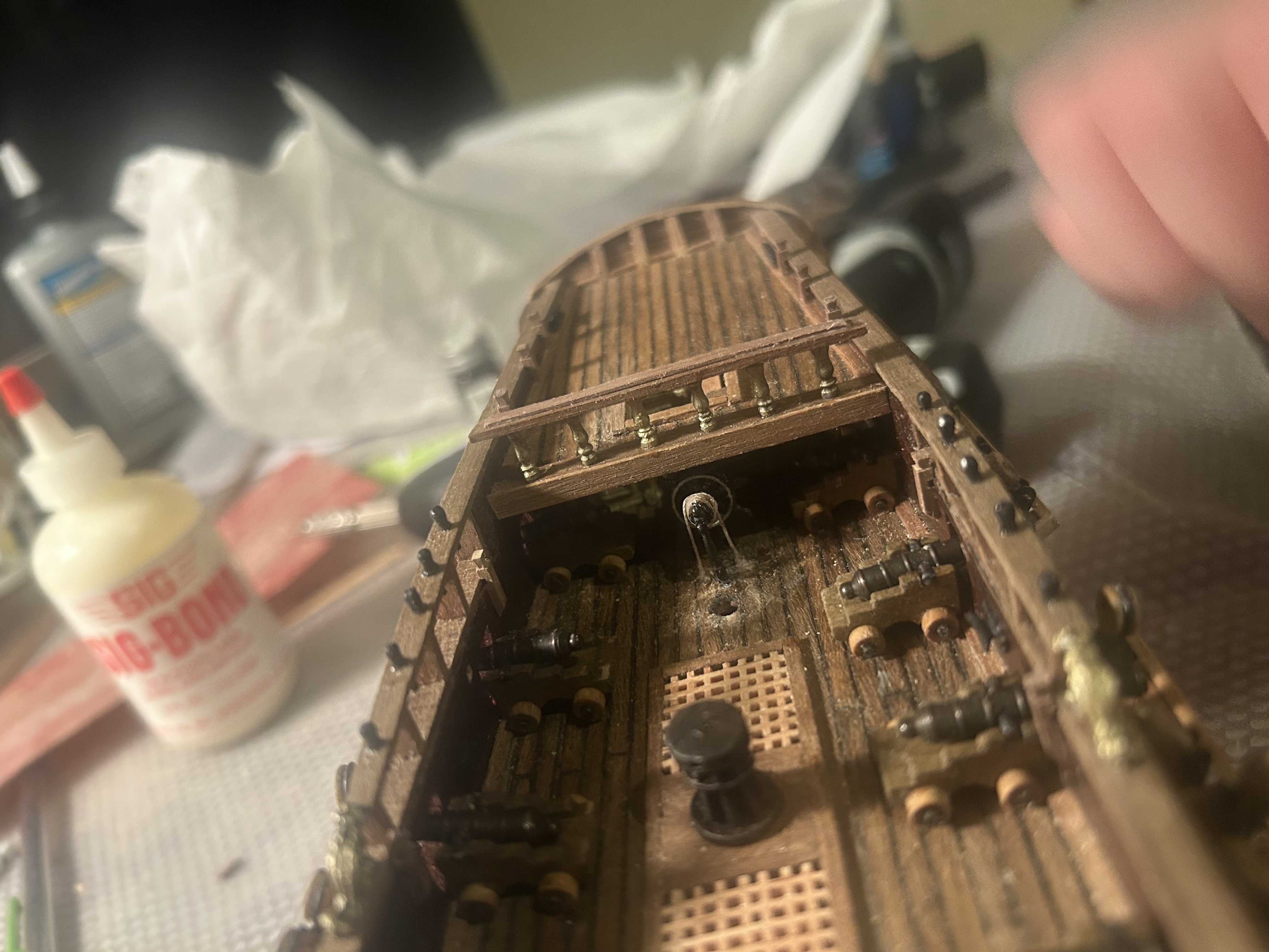

While gluing the cannons on, I discovered they often aren't quite even. I fixed the problem by running them over light sandpaper until the wheels were all level. It's hardly noticeable, and having four glued points of contact on the deck is a great benefit to their long-term stability. 78490429118__A2B4A3CB-A758-4A53-B1CF-1E2CB8F4E7DB.thumb.jpeg.5e605e19dc96846f0b70c874725de9db.jpeg
I assumed Corel's instructions were right, so my forward deck knightheads were slightly too wide to fit the foremost two guns. Don't believe the manufacturer on this model. Instead, carefully evaluate everything they show in pictures of the ship and reason out how it all ought to fit together. Measure distances yourself.
The last thing to do is the rail on the quarterdeck. I've measured everything, and I'm going to start drilling holes to slot the pillars into soon. It will be finnicky to slot six different apertures together into two seperate pieces of wood, but I think I've got it.

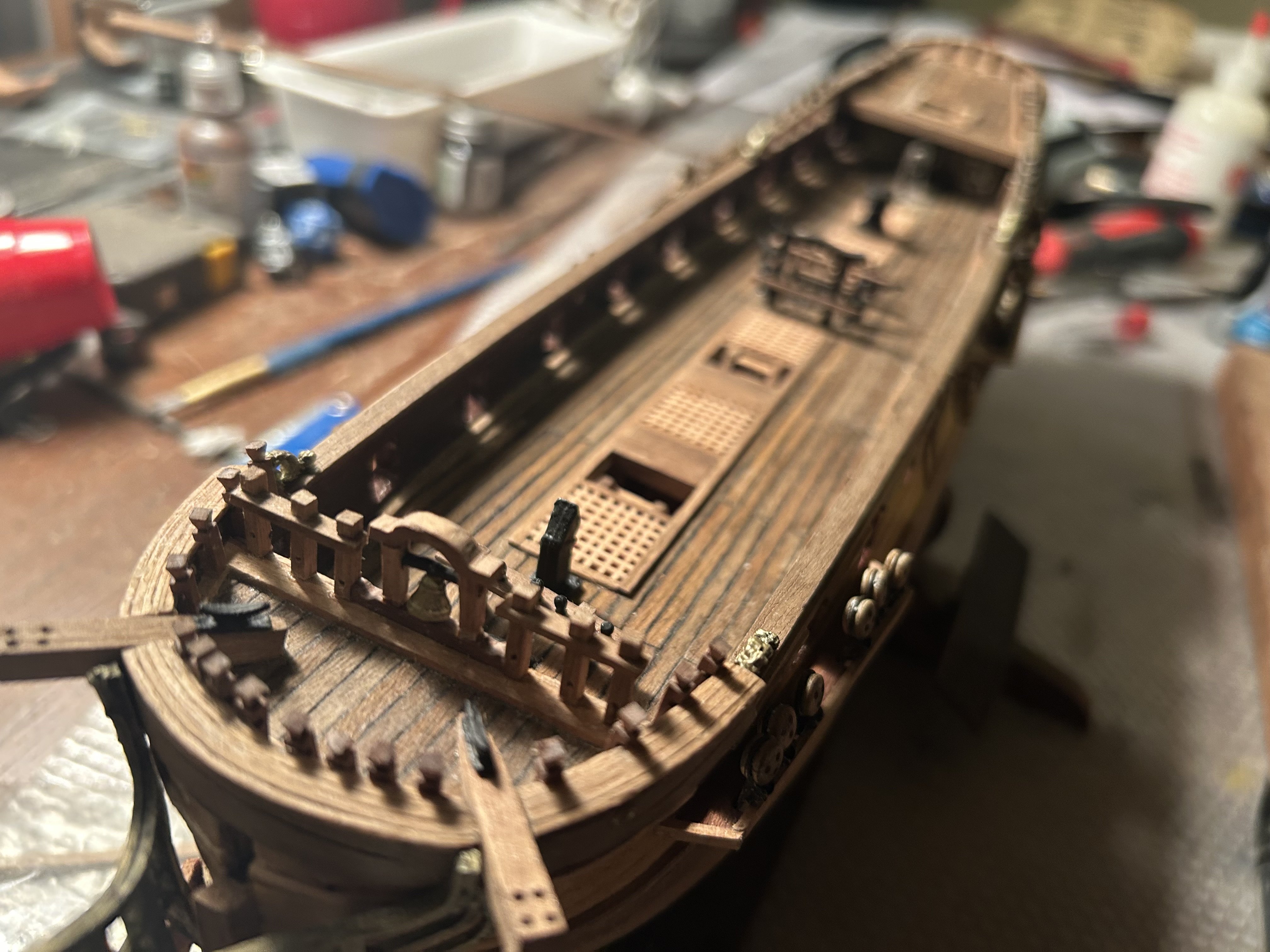

A note to other beginners: The best way to do deck furnishings is to start at the lowest area. Finish it, move higher, and don't touch the places you've already completed. Also, build the complex stuff first. You're more likely to accidentally break an easy deck fixture while working on a difficult one than to do it the other way around. I found myself wishing there had been some way to complete the main deck before putting on the quarterdeck. It was endless trouble to drill and stab holes for the ship's wheel underneath a roof.

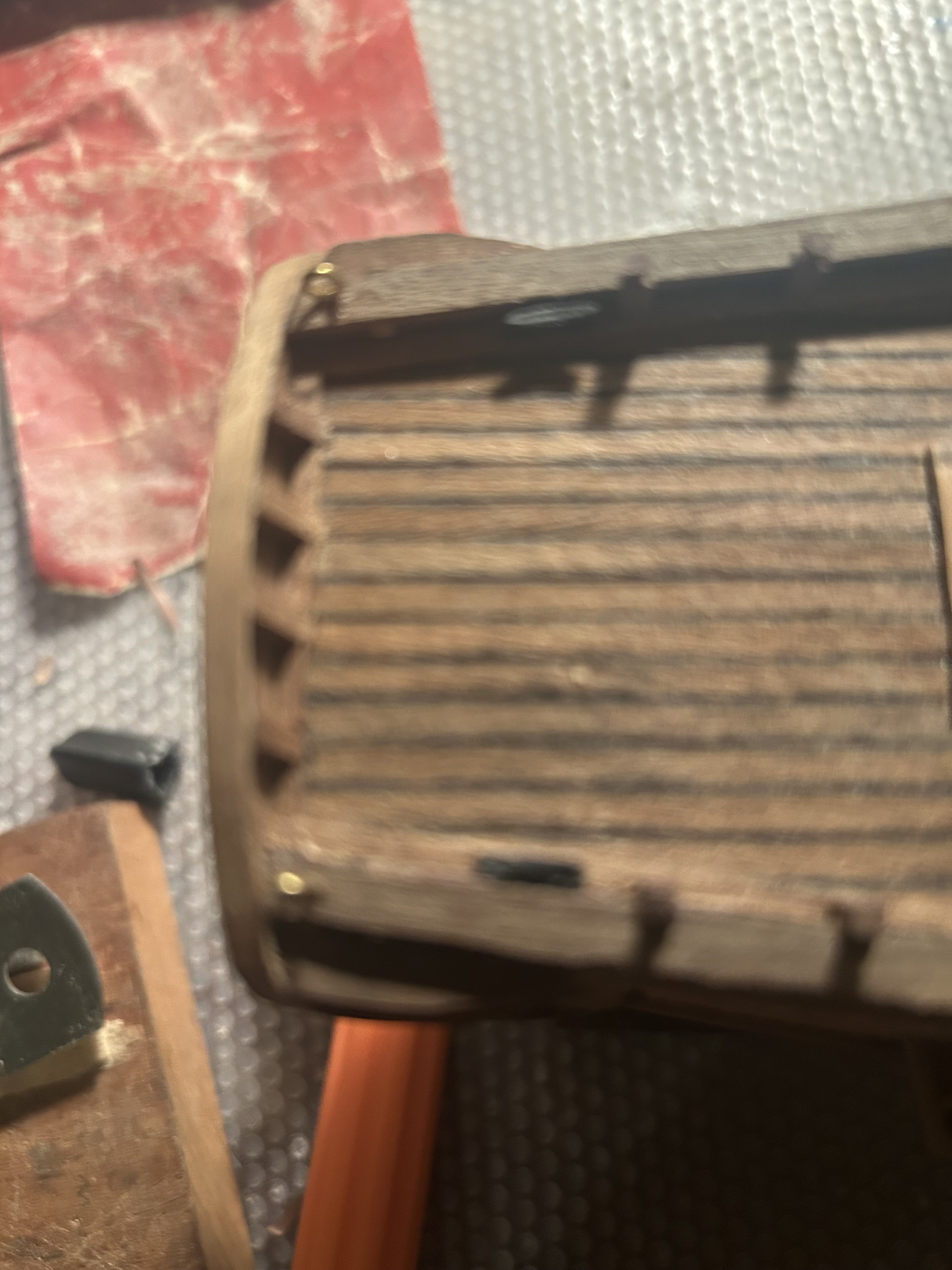

I've attached the quarterdeck rail. This step looks particularly elegant. At the same time, it's puzzling to see how two pieces of wood can be made to fit together so precisely.
As usual, the answer is that these things are simpler than they appear. I made the rail by using a template made of some of my scrap wood. It was a simple matter of drilling holes in the template two mm from its edge, then putting it on top of both pieces to guide the drill.
After that and a few gentle nudges, the metal pillars perfectly connected the two wood pieces. All that was left was to put a little slice of veneer scrapwood over the top to hide the holes.

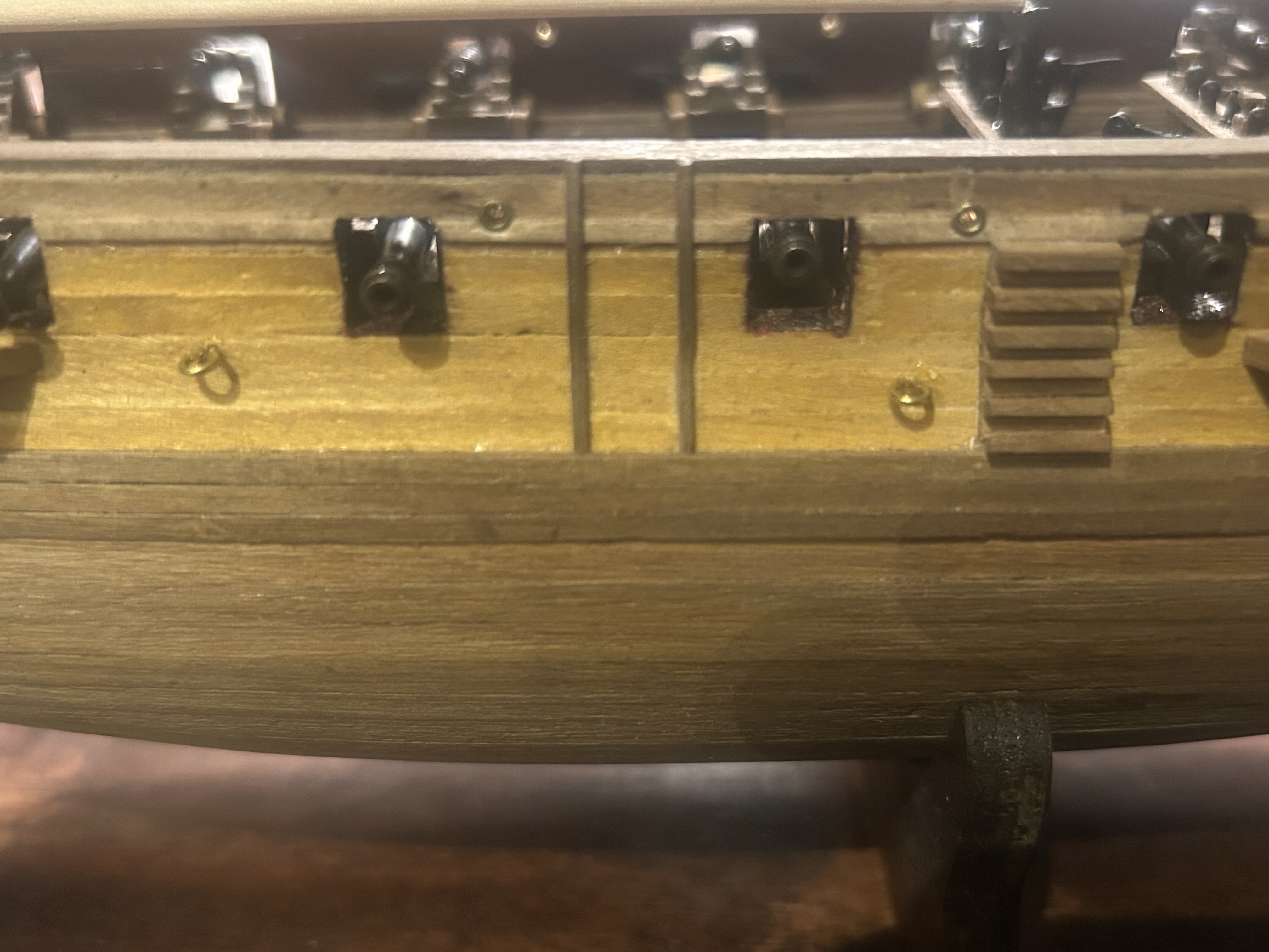

I was working on the six brass pieces to the side of the ship. I'm not sure what they're called because Corel's instructions don't mention them. As they are too weak to be pushed into the side like a nail, I was drilling holes for them, and my smallest drill bit broke with four more to go. I'll be buying a new one Sunday at my local hobby store.

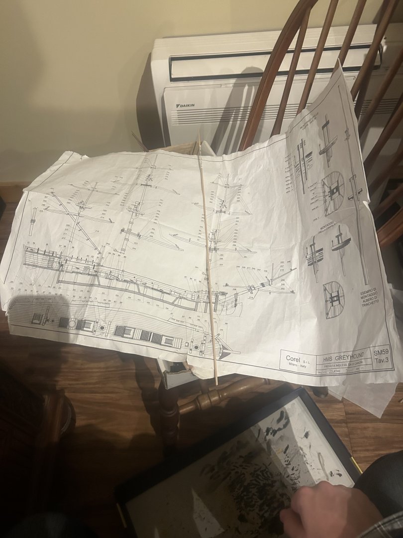

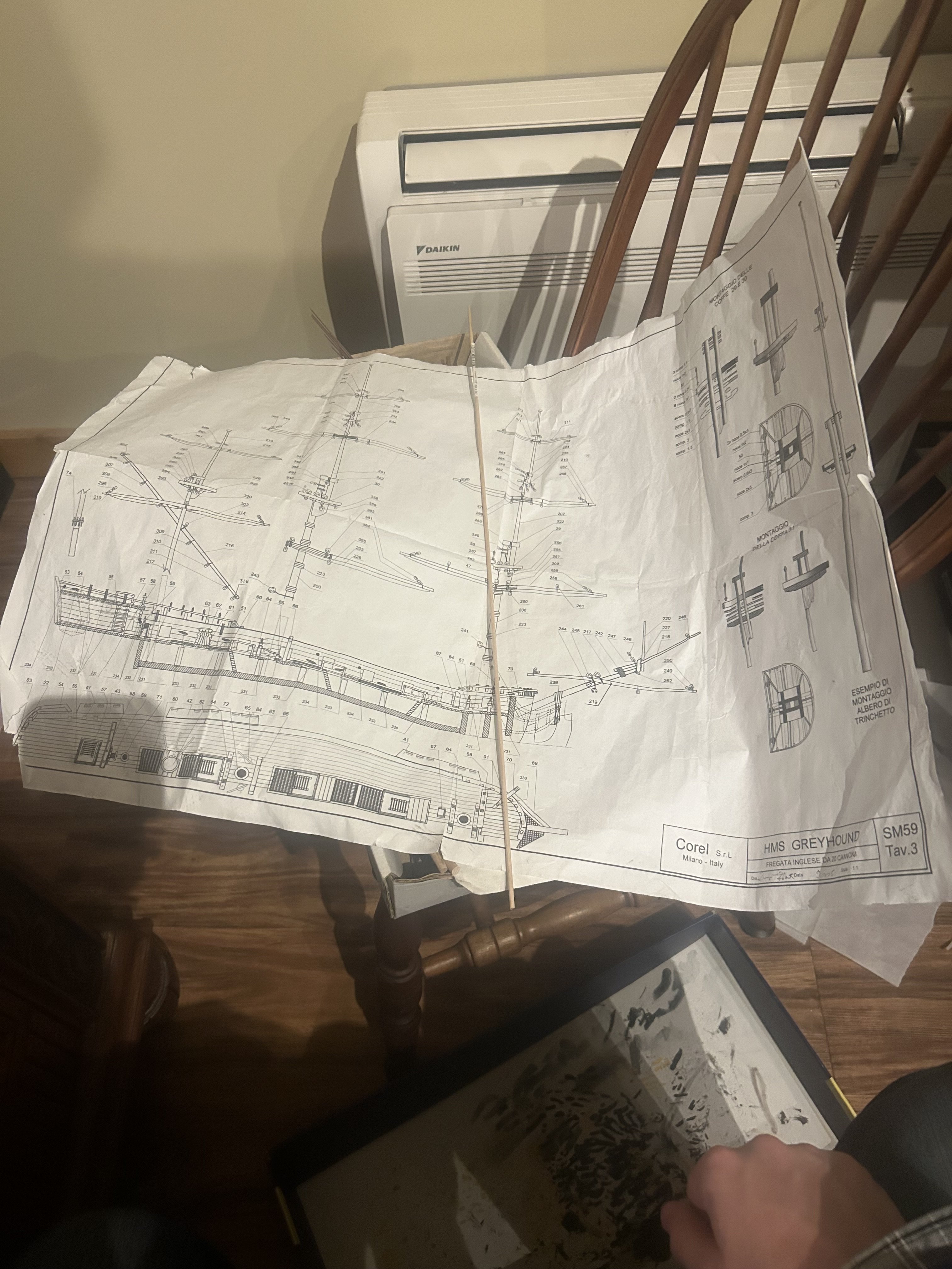

For future Greyhound builders, the masts get virtually no instructions or measurements in the packet.
That's why you should go to the large diagram labelled SM59 Tav. 3. This exact-sized diagram should allow you to figure out the lengths of all the pieces for this step.
It looks like this:
The kit also won't mention that every mast and spar is designed to taper gently from bottom to top. This tapering allows the mast pieces to actually fit together, and the yards to look prettier.

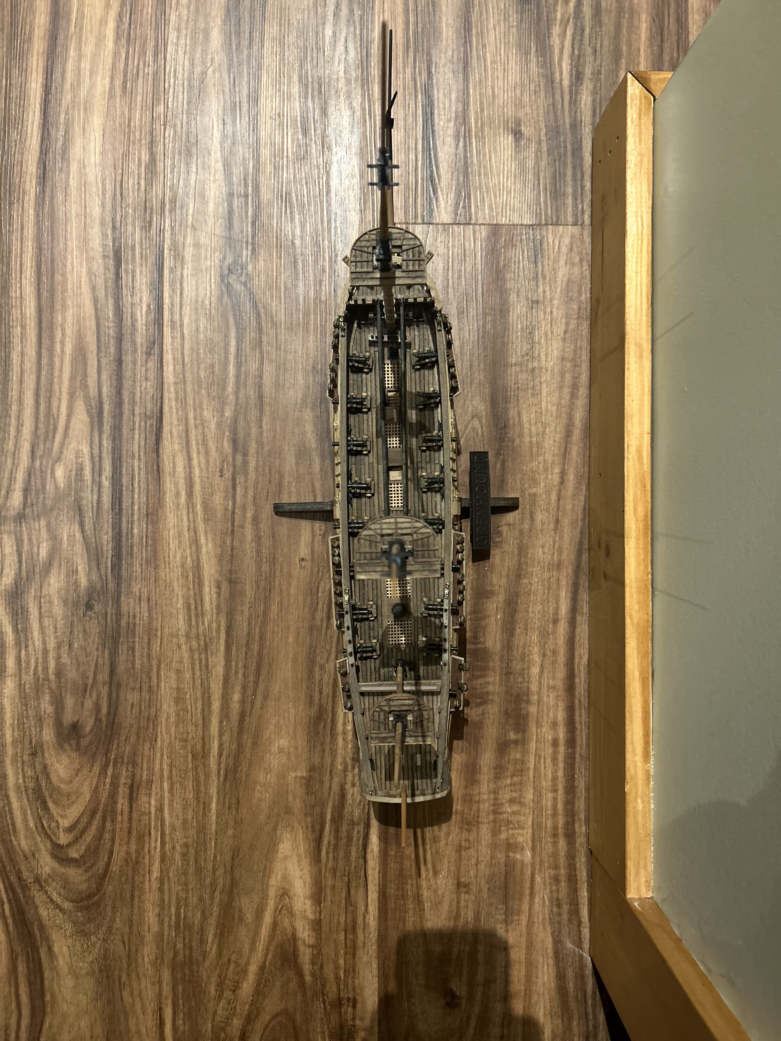

Things have been going great. I glued in the mizzenmast and the bowsprit. The foremast and mainmast are waiting to be wrapped in twine before they're glued down.IMG_2861.thumb.jpeg.df4d0335a141b66e6d7e6770ce6fb824.jpeg
For those making the Greyhound in the future, I strongly advise that you cut or sand out the hole before you put the bowsprit decorations on. It was frightening to attempt to create a serviceable hole without breaking the stuff already in place, and I did have to use superglue to fix a couple of breaks.

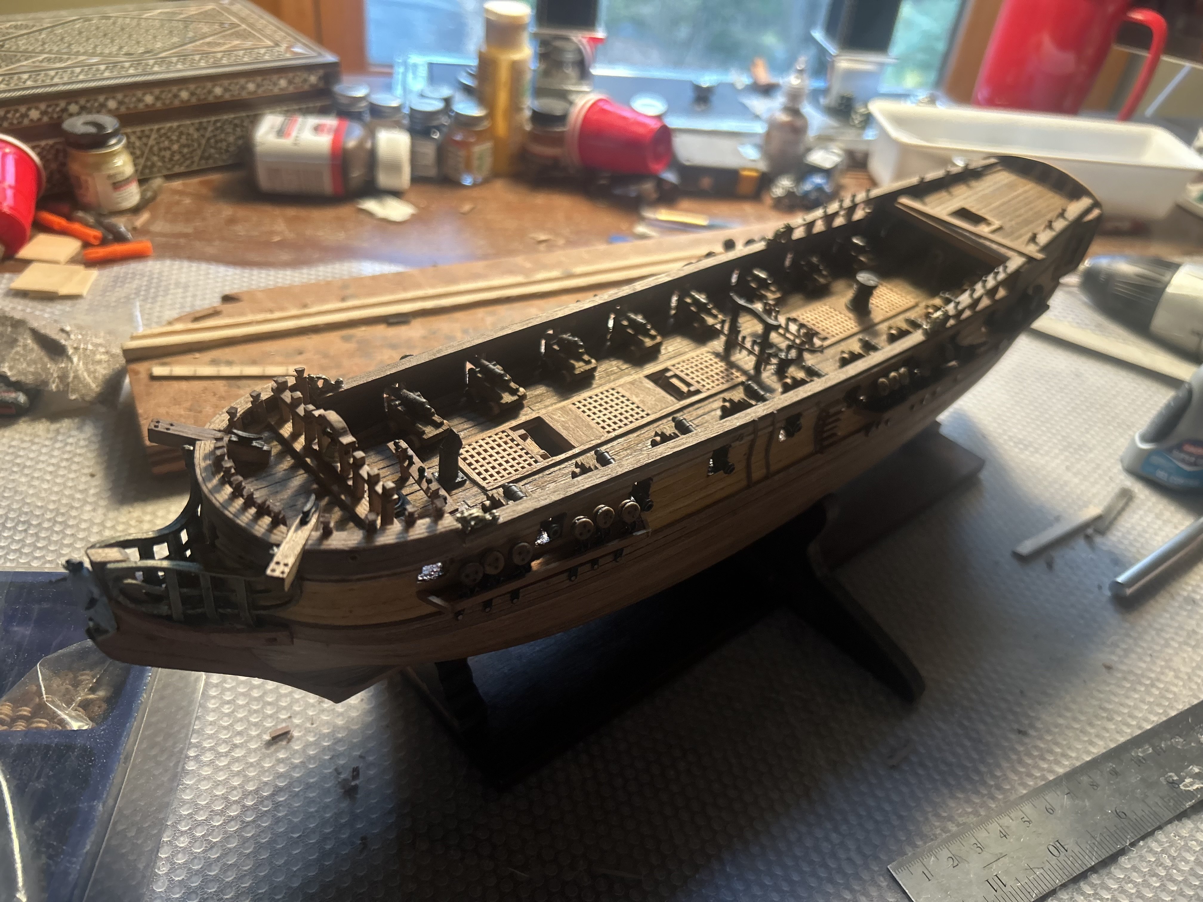

In just a little while, I'll be gluing on the mastheads. They're awaiting their final portion of black stain.IMG_2863.thumb.jpeg.cebf097fc8f3e7bcb91f59ccfcec32df.jpeg

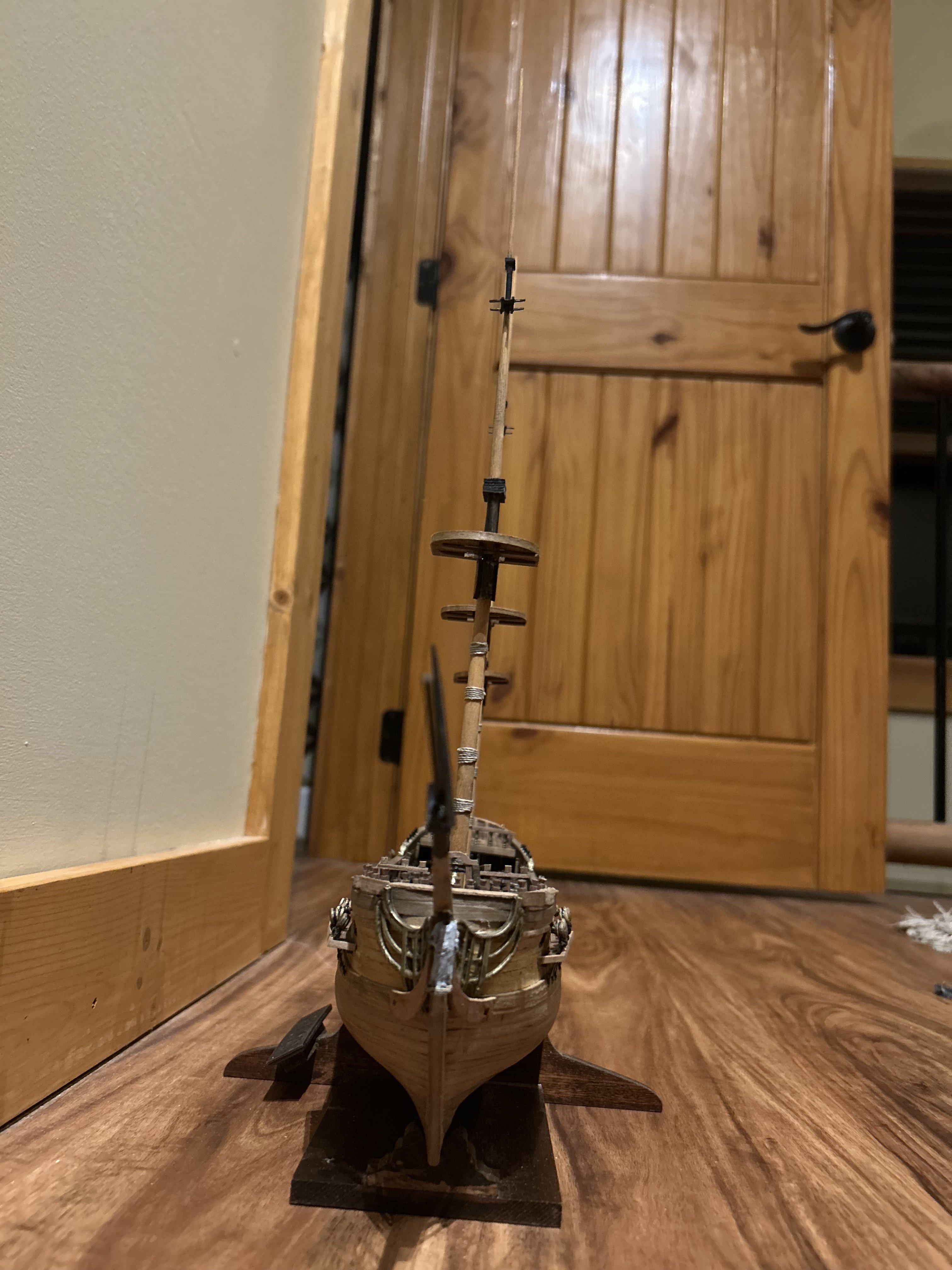

To cover the tops of the masts, I've been using the remainder of the deck planks, as well as 1mm by 1mm pieces. I put them on in much the same way as the deck. The final pieces that wrap around the top come from the same deck planking, and have been applied with my customary boil and bend technique. I've finished the bowsprit, the mizzen mast and the mainmast. I am now working on the foremast.
I'd advise anyone working on the Greyhound to try and dry fit the tops before trying to glue them. I found the masts were slightly wider than the wood that fits around them. I had to sand the 3x2mm pieces and cut out a small curve to rest against the map. I have a picture below that shows what I mean.
The end result is magnificent. It's also much taller proportionately than my intuitions would suggest. But this makes sense. There are very few ships in the world today built to carry three yards of sail on a single mast. It must have been a truly enormous task building them in real life. It must have been the project of years planning, building and outfitting a frigate.

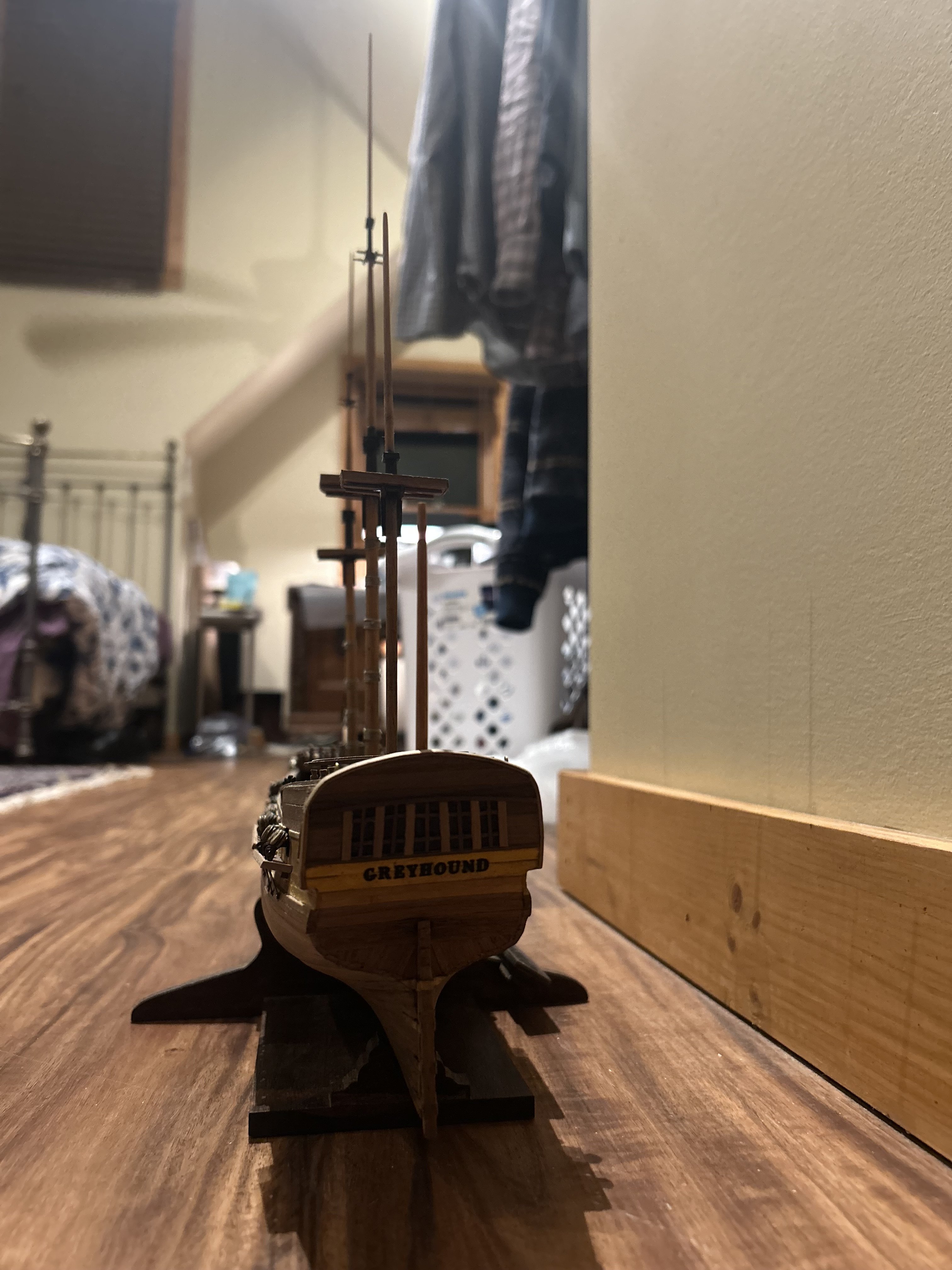

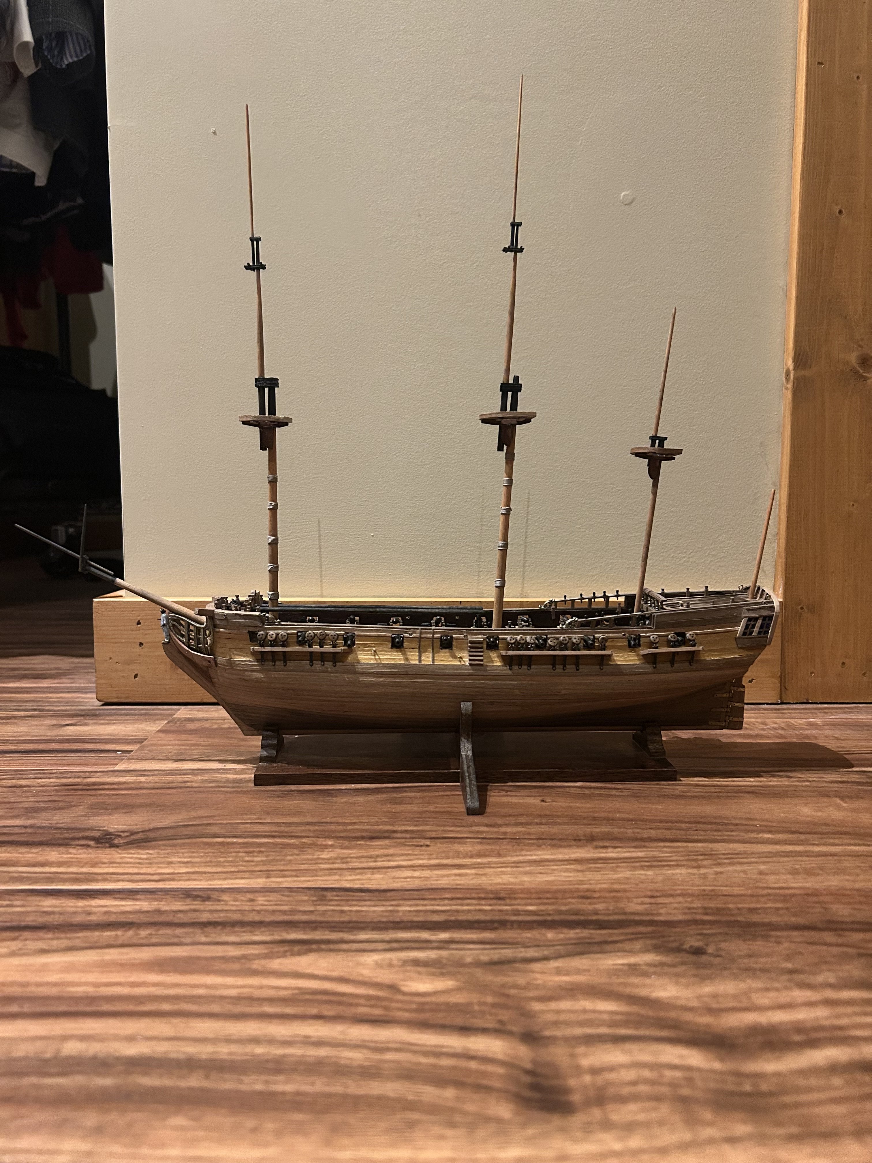

Finished at last. Every bit of wood and metal that needs to be glued to the ship is now glued.
The masts are done. I will give the ship a nice coating of tung oil. Then it will be time to start the shrouds and rigging.
