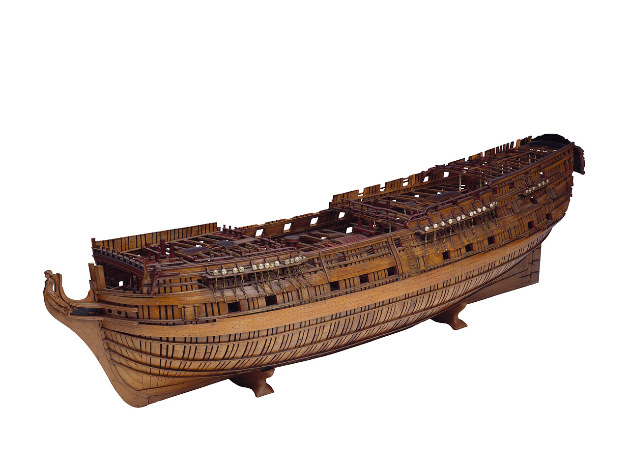

(The image below is of the HMS Eurydice of 1781. HMS Eurydice was cited in the AoTS book as the source material for Pandora's framing profile.)

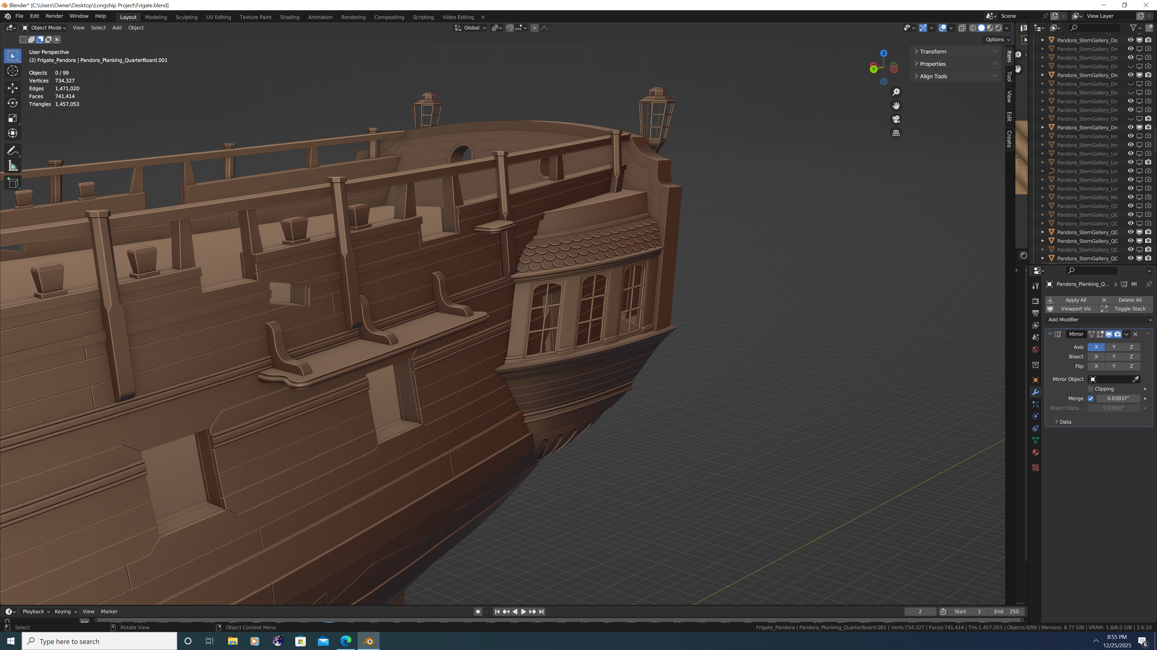

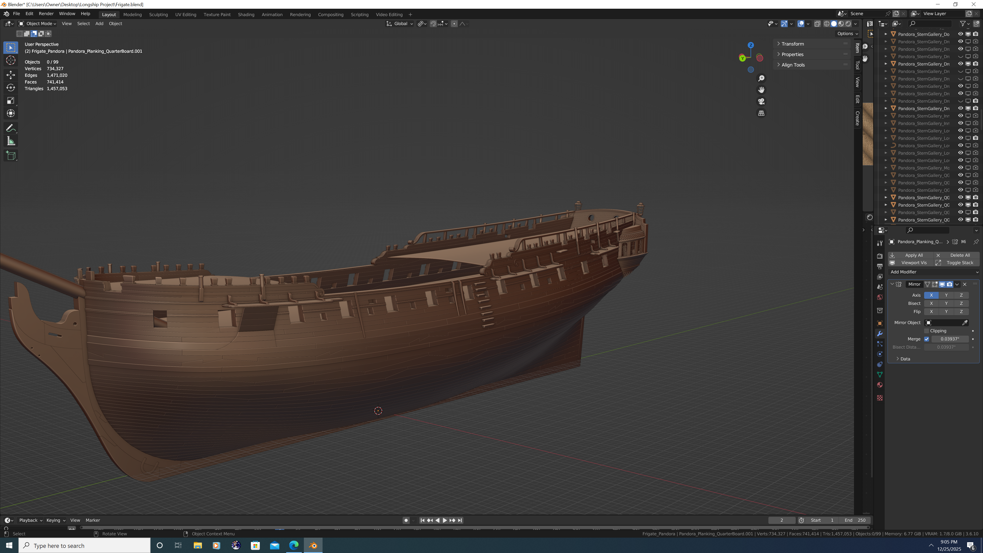

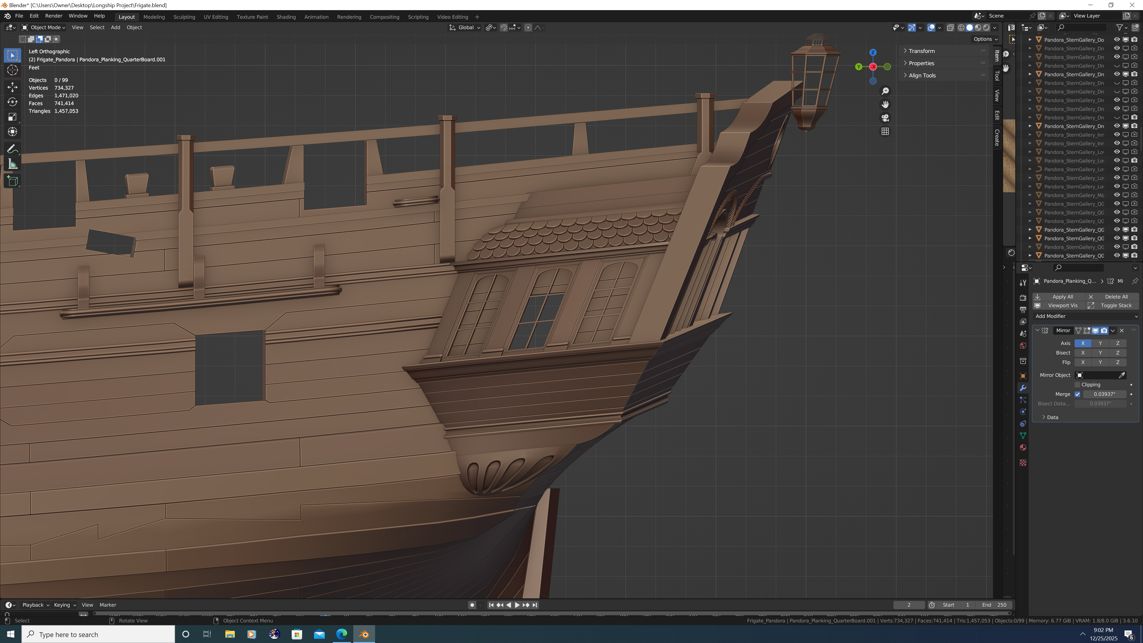

Working on the galleries. I remember one particular ship in the RMG archive of the Porcupine class was illustrated with arched windows on the quarter gallery and I really liked the style.
Still working on the drops - getting the shapes correct has been a bit of a crap shoot 🤣🤣
Bad puns aside, I'm getting excited now that some of the more fine details are starting to come out.
The internal planking has been completed through the lower deck. The decks themselves are merely placeholders at this point.
That's it for now. Happy Holidays All!

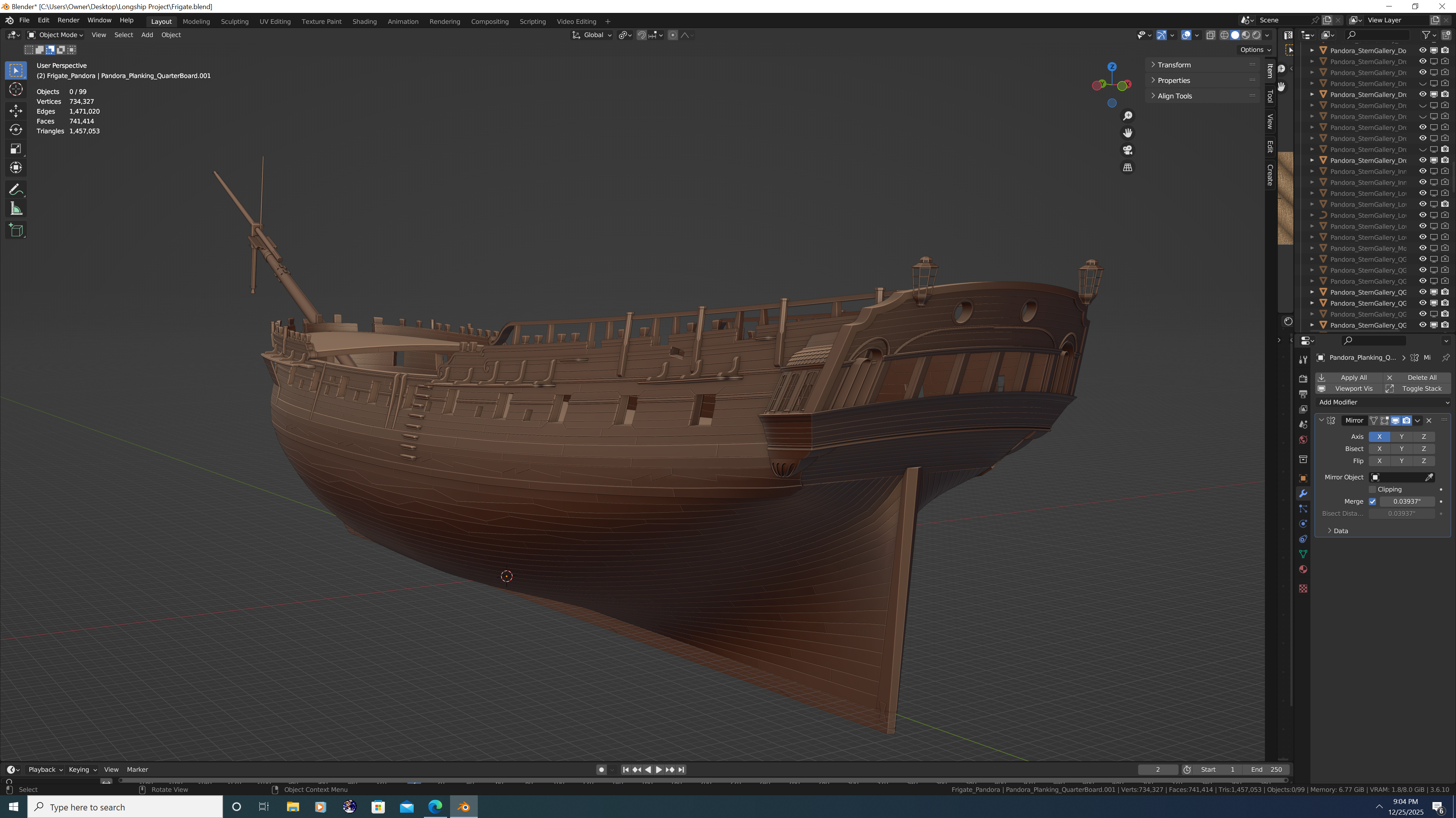

Hey Folks,

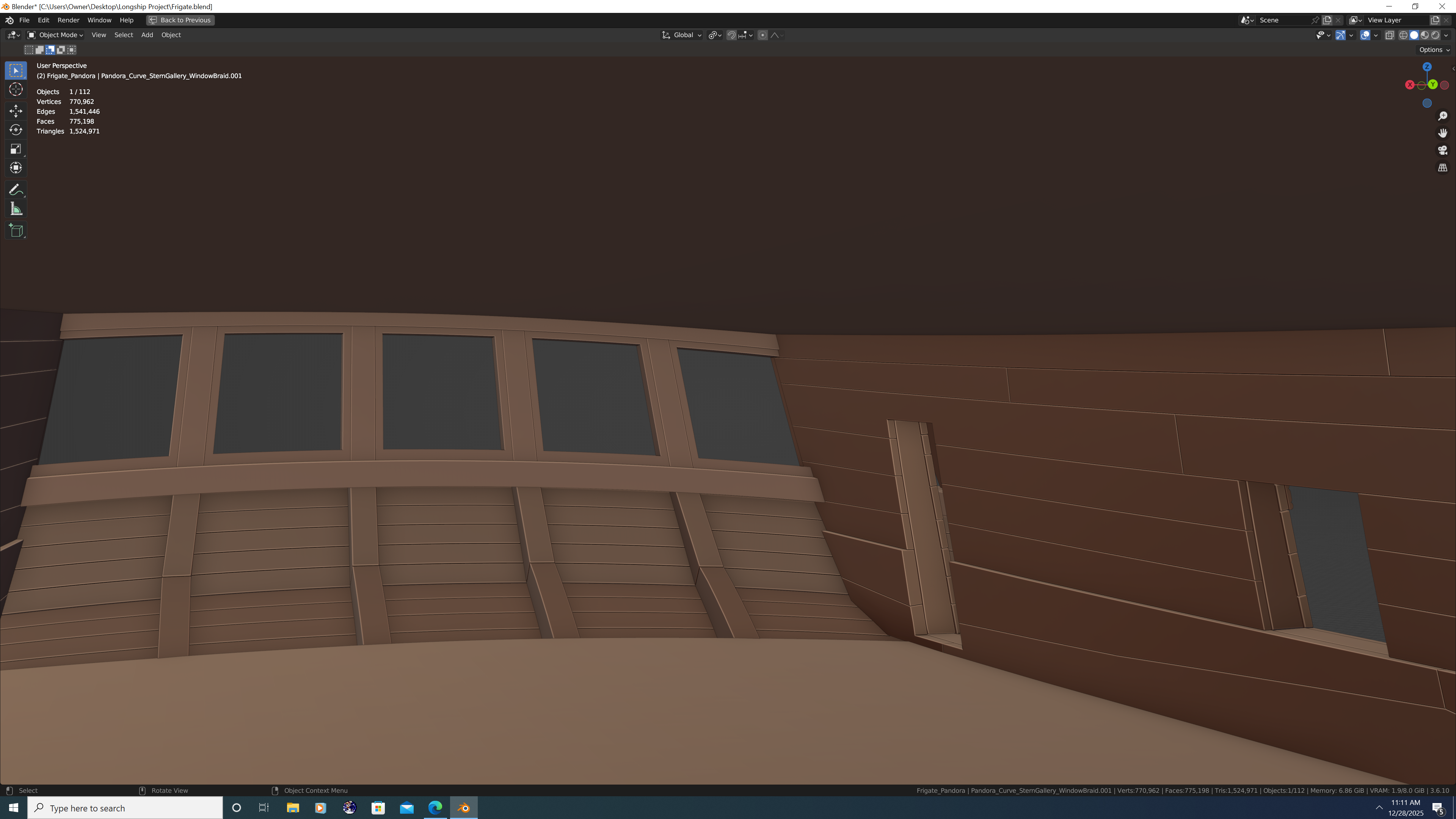

I could use some help regarding the inside of the great cabin. I'd be much obliged to anyone who can answer any of the below questions.
First, an image of the inside as it currently stands... And for clarification, I have not yet modelled the Bench, Bench Step, or Rudder Head Cover as I will have additional questions about those once I get the interior situated.
On to my questions:

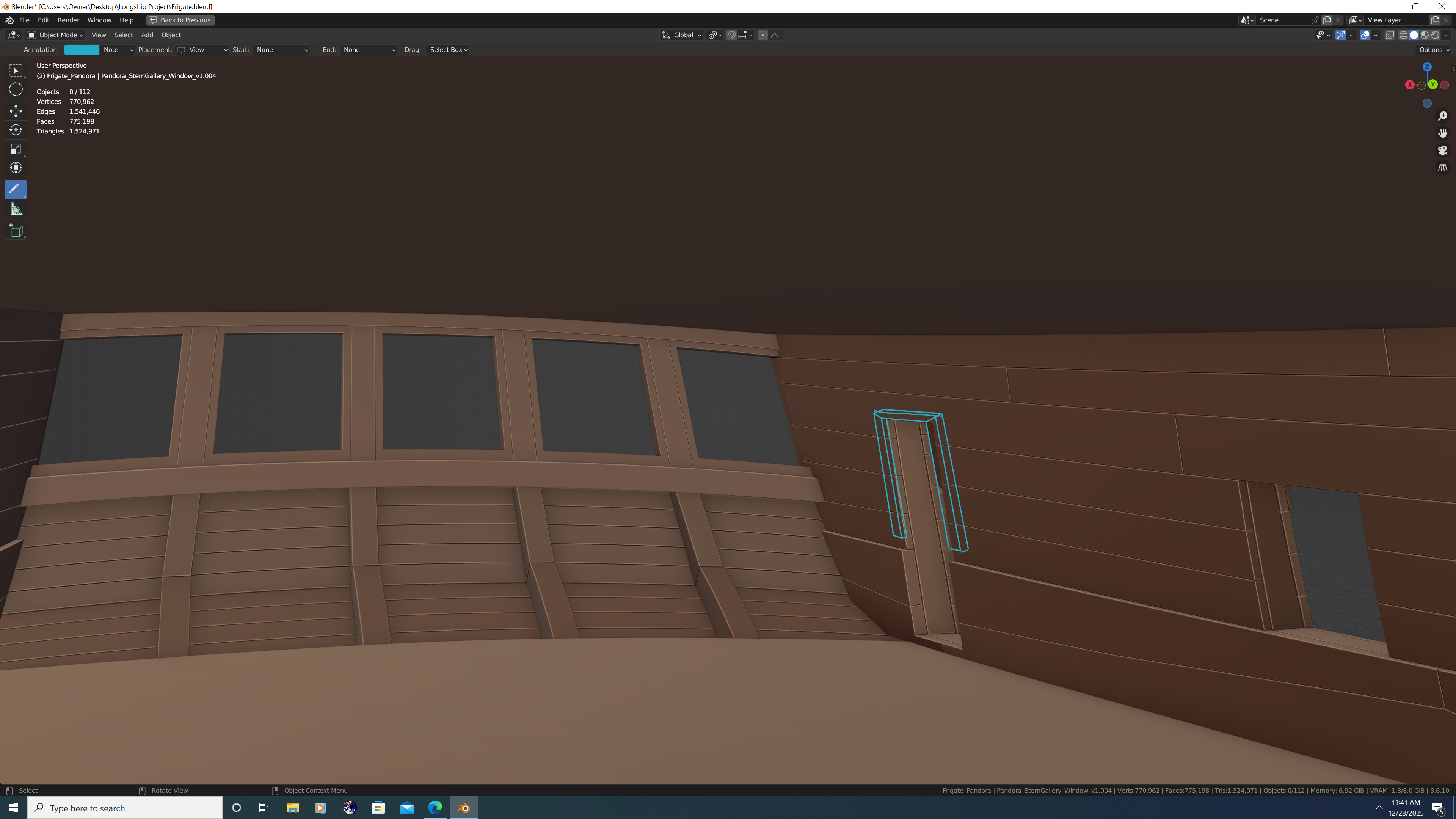

  1. Are the deckhouse doors really only about 4 1/2 feet tall? I think it's perfectly plausible given Pandora was a small frigate and people were shorter back then, but I thought it worth seeking confirmation from you fine folks.

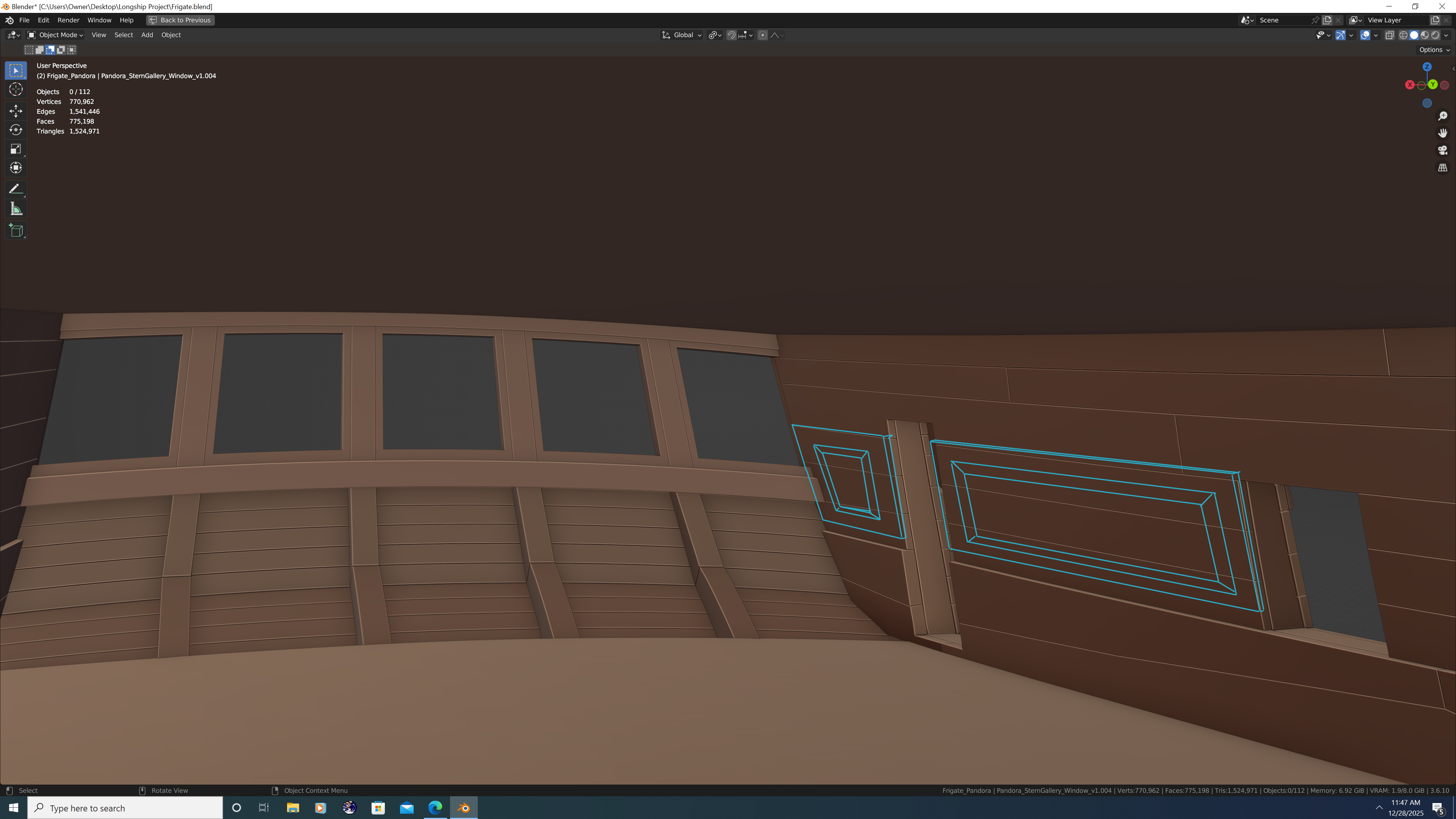

  2. Because the interior planking is thinker near the deck clamps, ceilings and waterways (latter not yet modelled) how is a door actually mounted there? The hinges would need to be mounted on an even perch to allow the door to swing open properly, correct?
    If so, is this accomplished with a large door frame to even things out?
    Or perhaps the paneling in the great cabin brings the two sections flush?
    Or perhaps it's a bit of both? (no illustration provided as you get the idea)
  3. Speaking of paneling - is my basic assumption that it sits on top of the inner planking correct? Put another way, the internal paneling is in addition to and not in lieu of the internal planking in the aft cabin. Yes?
    Thank you all in advance,
    -N.

Thinking a bit more on your main question:
If the hinges were aligned with the shape of the hull, the door could not open towards the cabin, as its outer edge would swing down when opening and would soon hit the deck. I doubt it would open outwards, as there was so little space in the quarter gallery. So the hinges would have to be arranged vertically, with the bottom of the door near the cabin-side edge of the ship's side and its top near the outboard edge.
A thought though: Wooden ships twist and bend in a seaway. A close-fitting door can jamb -- which would be very embarrassing if the captain found himself shut in his gallery! I wonder whether the doors had wide gaps all around or perhaps were taken off their hinges and replaced by curtains when at sea.

One assumption in the frame-grabs is that the lower sill of the doorway to the quarter gallery was just above deck level. Looking at contemporary inboard profile plans, the sill was about 12" above the deck. Should the quarter gallery get carried away, it might prevent too much water entering. Form follows function.
Edited by druxey

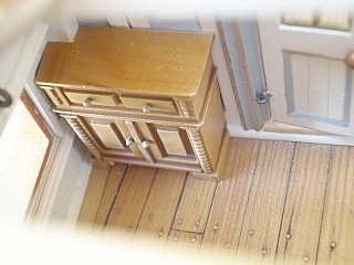

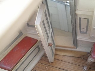

I don't know how accurate this model is, but it might give you an idea how to tackle this problem:
https://www.shipmodell.com/index_files/0PANDORA2.html
not the same door but still, there's a frame that could accommodate the hinges
Edited by herask

My point was that, with the higher sill, as the door hinged inward, the lower corner would not hit the deck. Also, beware of modern models' reliability! Try to depend on contemporary sources which are readily accessible through the internet nowadays.
