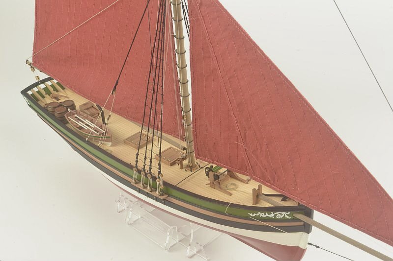

Hello - further progress. All bits and pieces that are for the deck installed along with the Bulwark Capping Rails.
The winch / cleats / hatches / tiller / stove pipe etc
A close up of the Winch
Overall view
Thank you for looking

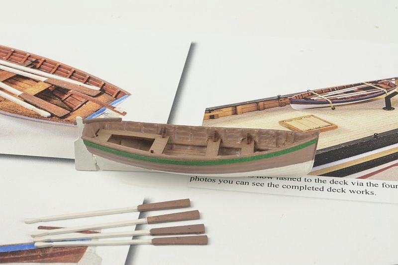

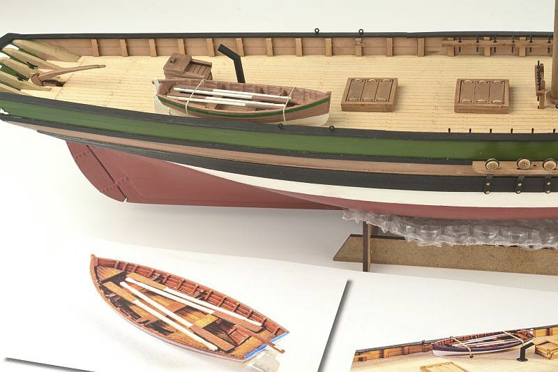

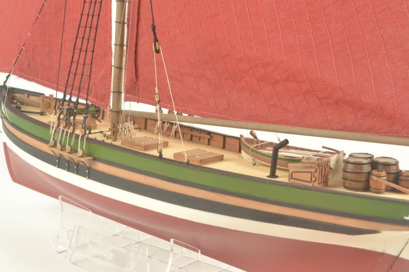

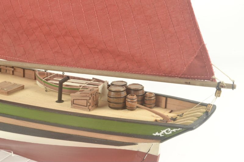

Hello - Channels / Blocks / Chain plates all fitted in place plus decorations.
Small boat assembled and painted. The green stripe is tape.
The small boat roped down as instructions.

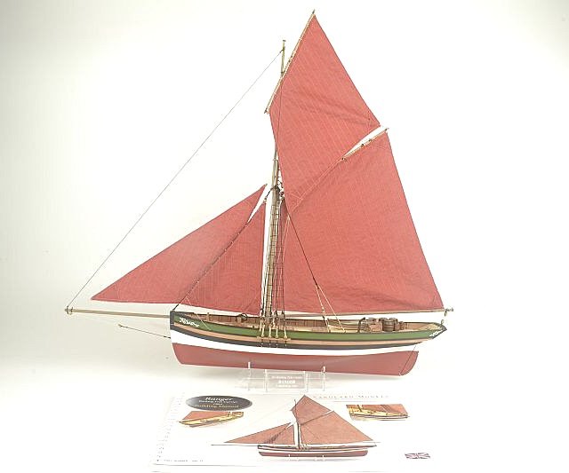

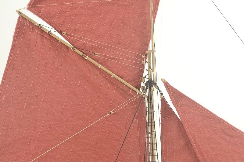

Hello - small update. Main mast shaped / assembled with various eyebolts / blocks
Must refer to plans for what blocks and where as the illustrated instructions book has blocks on all eyebolts which does get corrected later on in the book.
Main Gaff and Boom plus Yard all shaped and ready with blocks attached etc.
Sails next I guess. Again thank you for looking.

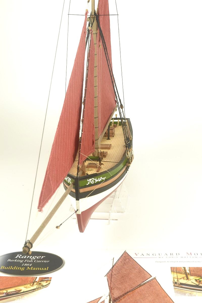

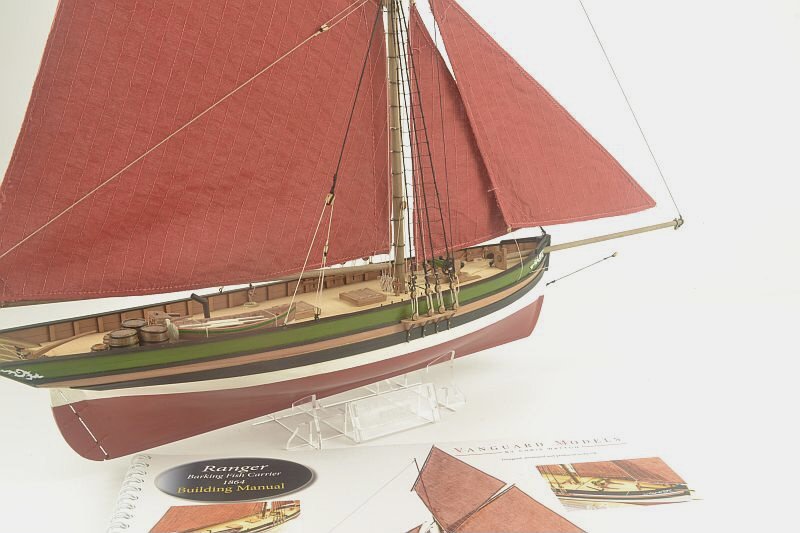

Hello - a small update. Sails all dyed using Rit cocoa brown and scarlet (equal mix of each). Wanted a deep red to match the bottom of boat.
The Main Sail secured to Yard, rings added and fitted to Mast.
Doing the Shrouds before fitting the Top Sail unlike the instructions.
Thank you
