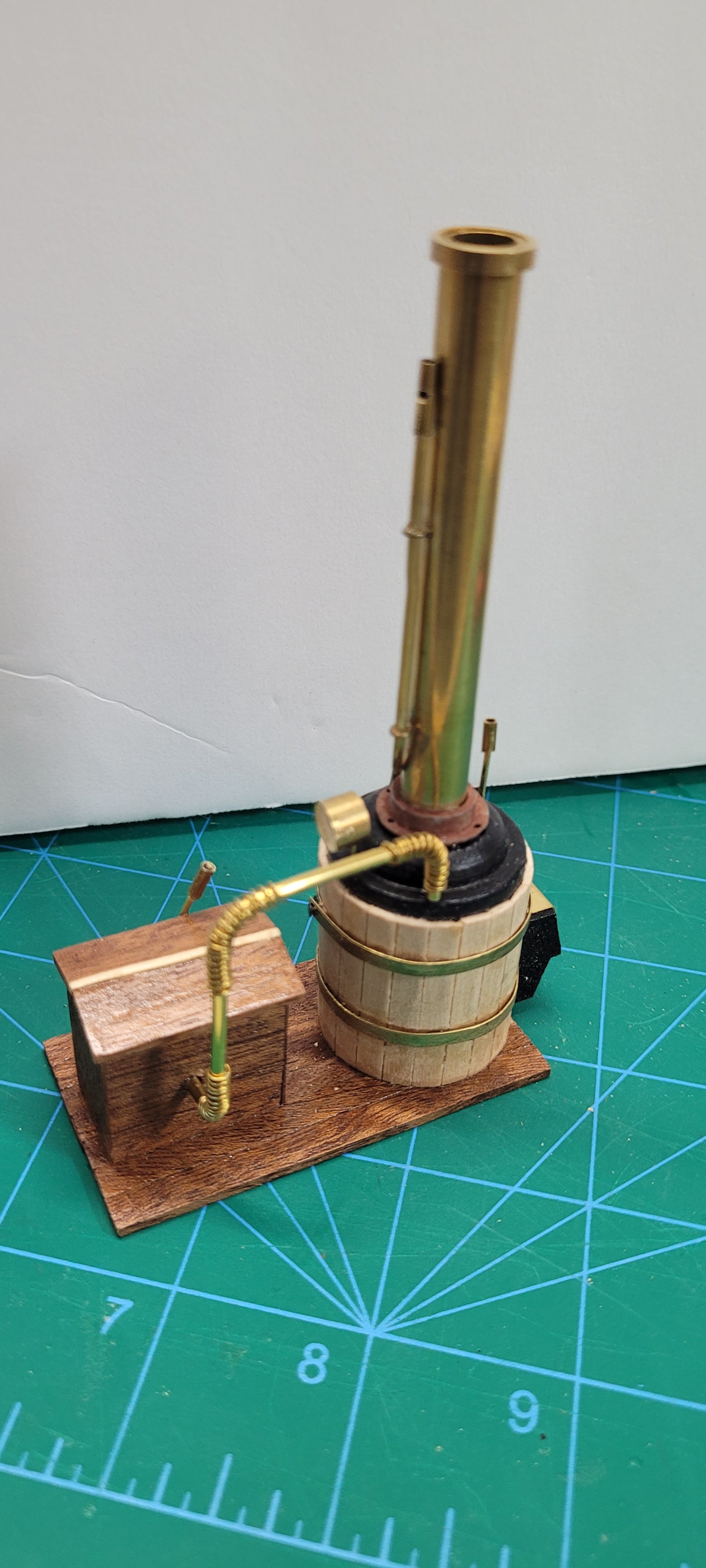

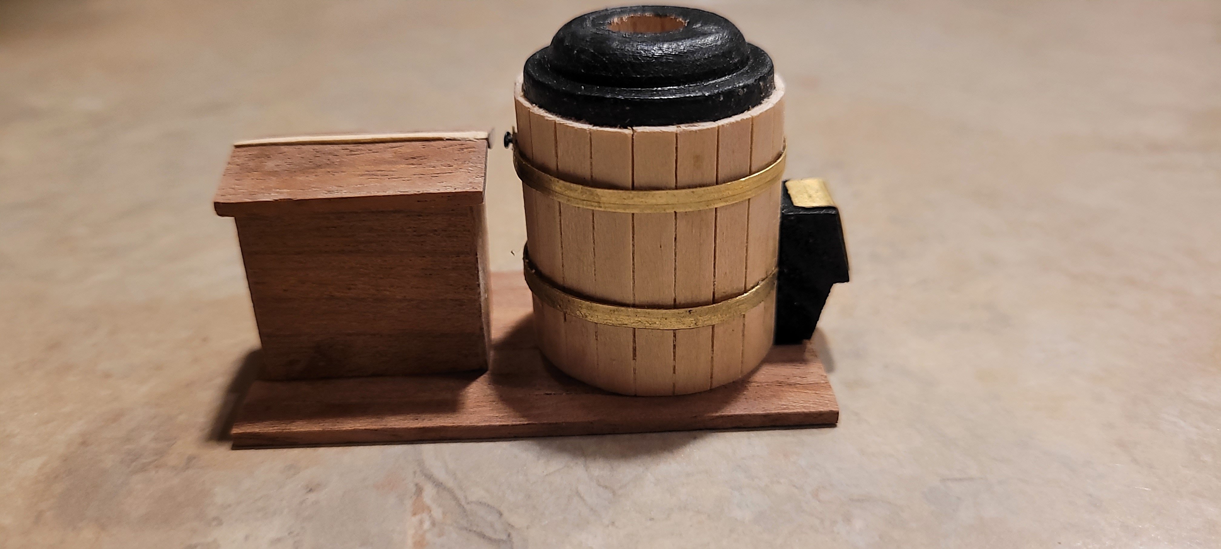

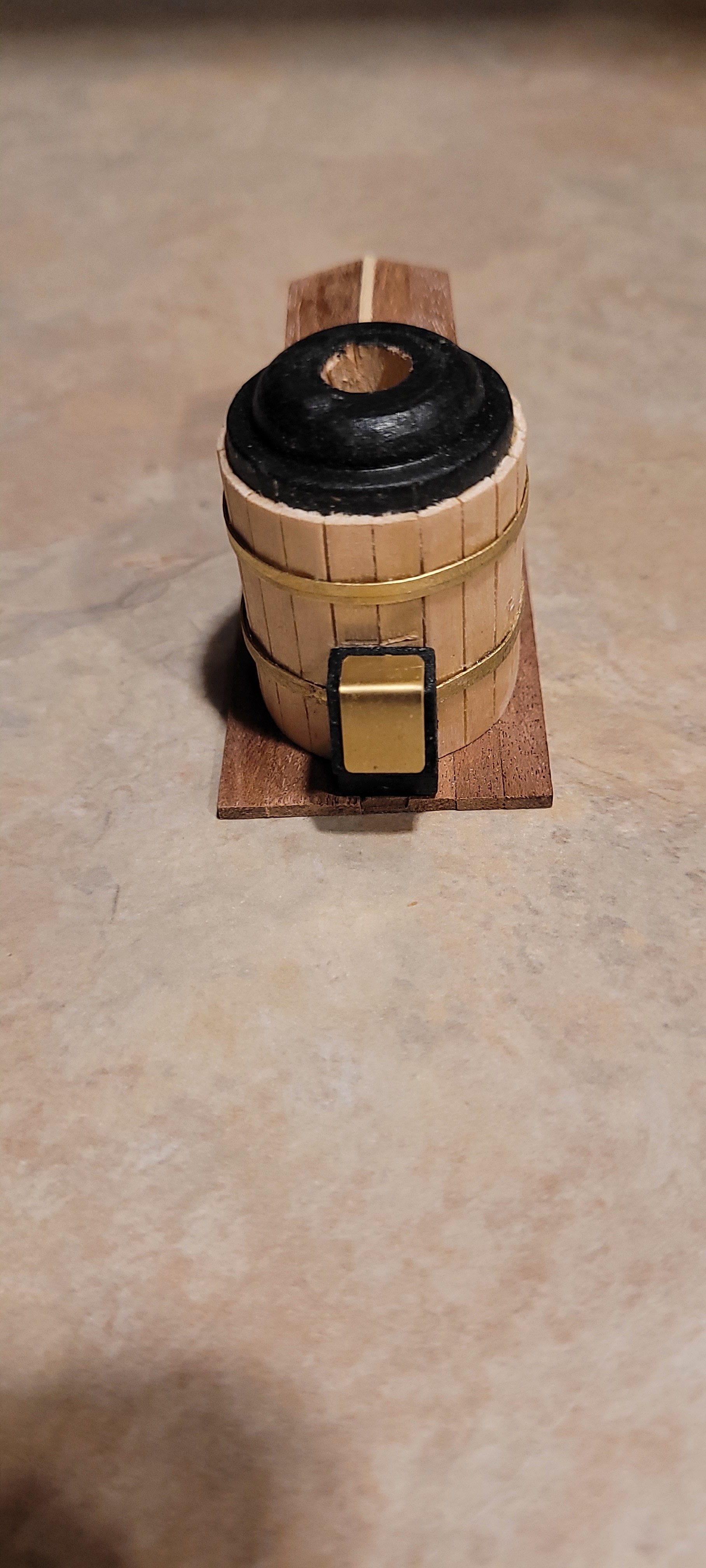

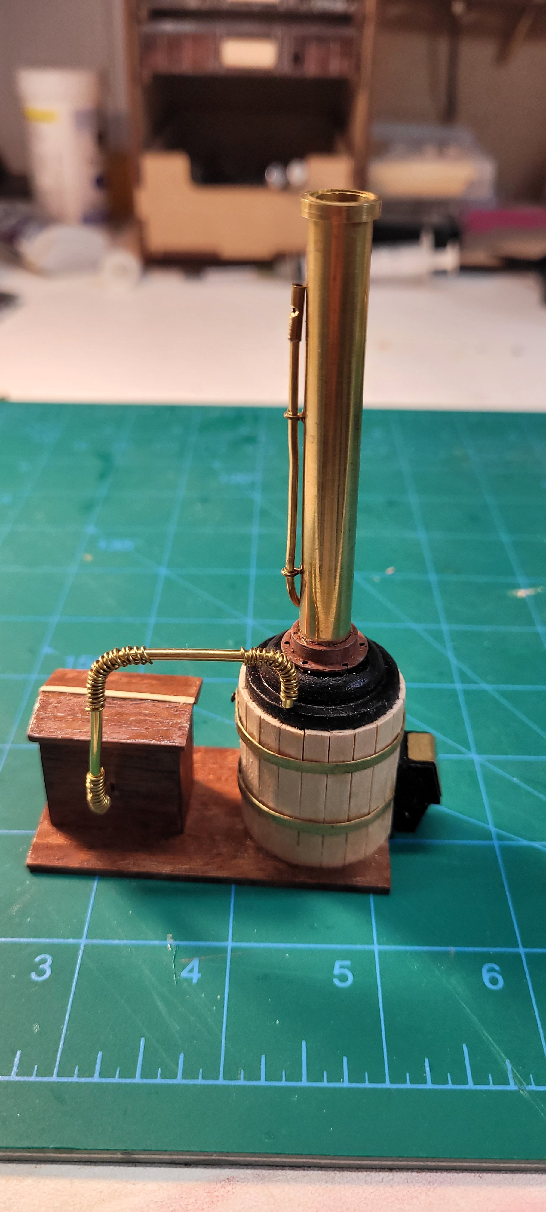

Engine Fittings Challenge: Assembling the small, non-functional steam engine and boiler components was surprisingly tricky. The kit uses thin brass wire to represent piping, but much of the wire was supplied already bent and kinked. I had to spend frustrating time straightening the wire completely before I could even attempt to shape it into the smooth, aesthetic curves required for the visible piping runs.
