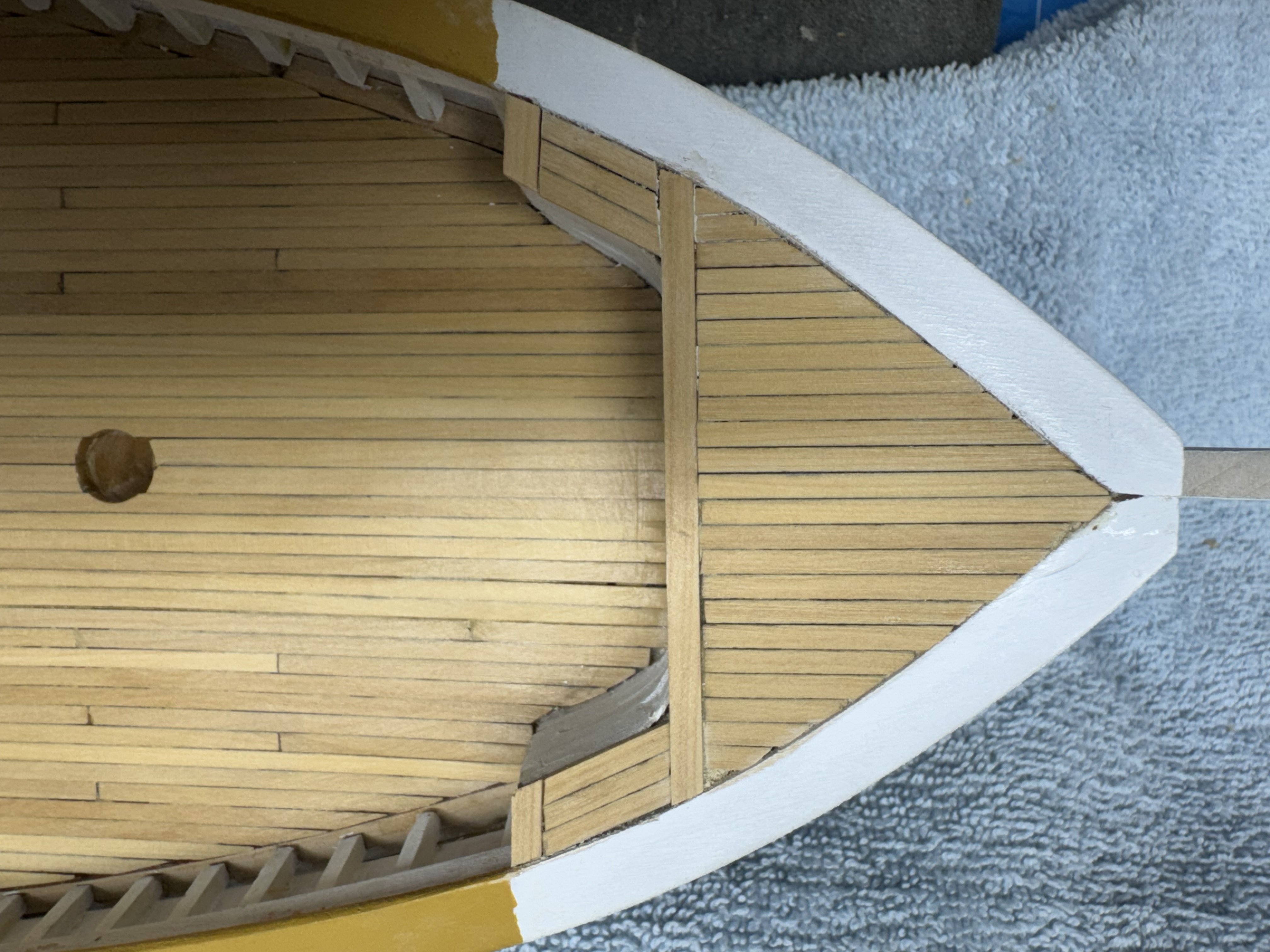

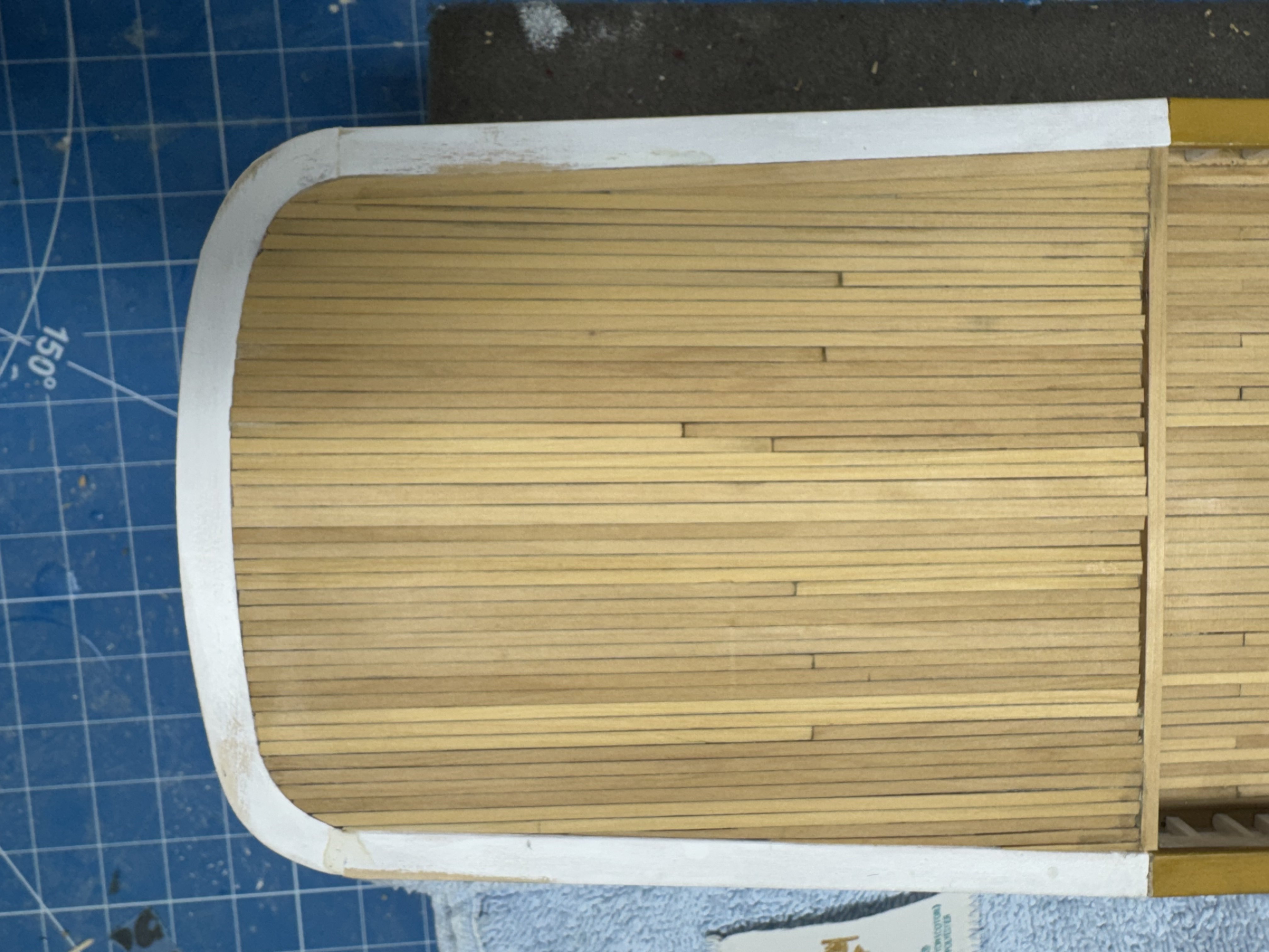

I got the qdeck planked and two coats of WoP. If I had it to do over again I would start at the edges and curve the planks to follow the cap rail. Then they meet in the middle starting at the stern and extending probably about a third of the way forward. As it is I had to make three very sharply pointed pieces on each side. If I had started on the sides the pointed pieces would have been covered, at least partially by the wheel house and associated grating, which, by the way is not mentioned in the instructions either..
I also planked the forecastle using my "best judgement" on how to deal with the unusual shape. it has one coat of WoP now, more to follow. i had to resort to filling in the outboard pieces with sawdust as the space that was left was too small (for me) to be able to cut a very tiny piece and somehow get it into the opening.

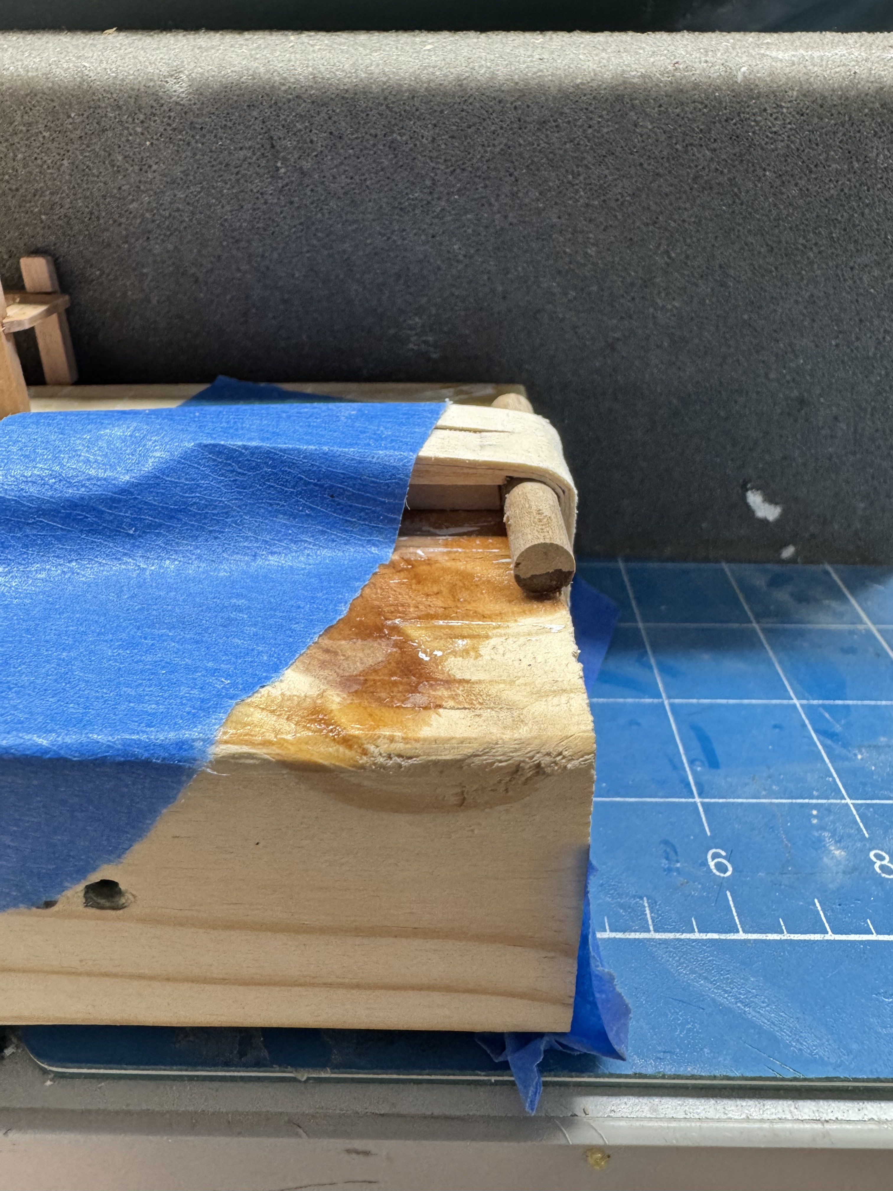

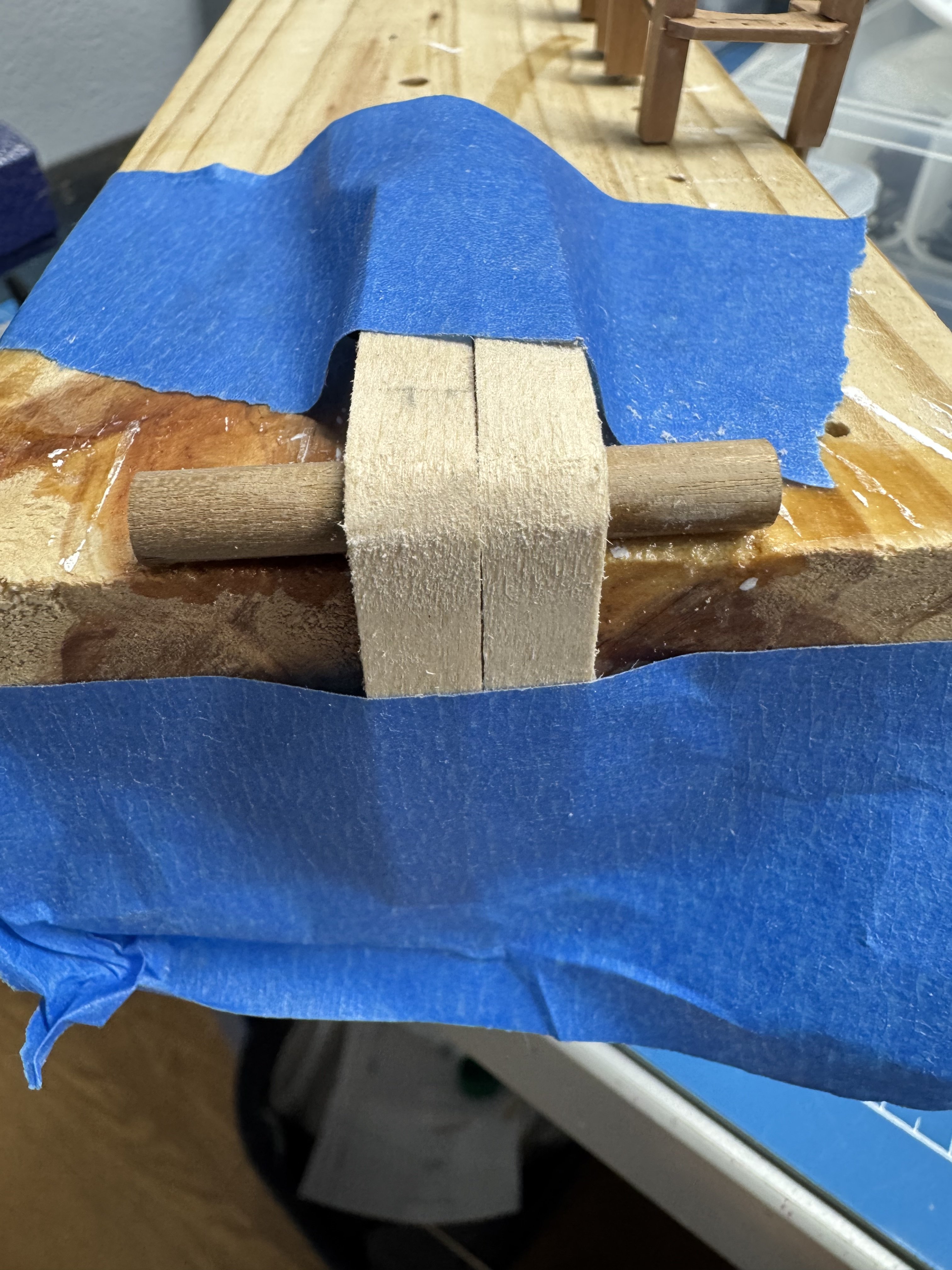

I saw from the drawing that there is supposed to be a curved piece of the stern rail that meets the cap rail to make the transition from the stern rail height to the cap rail. No mention of this in the instructions that I can find.
Clearly (to me) there is no way to make 1/16" basswood bend 90 degrees in 3/16" (the height of the stern mid-rail). At least none of the basswood i have will do that; I tried.
So I thinned down some 5/16" wide basswood so that it took three pieces to get to 1/16" thickness. Then I built a little jig to hold them in place after soaking in hot water. The jig is below but I used clamps not masking tape to hold them while drying.
After they were dry I used 60/40 PVA/H2O to bind the pieces together and then taped them back on the jig to help keep the shape as I noticed they tended to want to unbend a bit if left "unrestrained". I need to paint them orce to match the main deck cap rail then cut them but not until I get the stern rail completed.

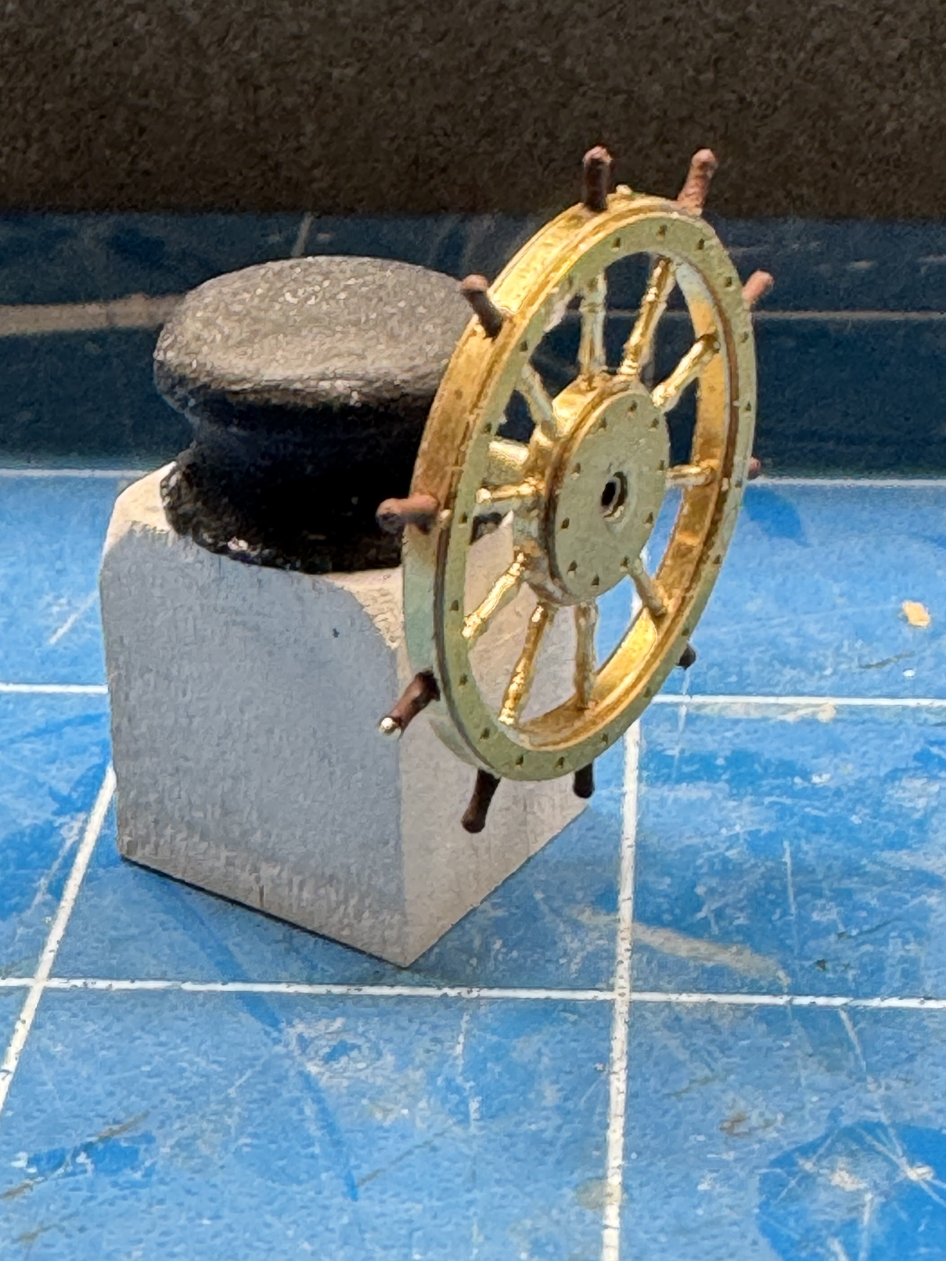

The wheel house now with the Caldercraft 24mm brass wheel which is about 2mm bigger than the Britannia cast wheel provided with the kit.
The instructions with the Caldercraft wheel say to paint it walnut but after getting all the nice detailing I did not want to hide it under paint so I just painted the "handles dark brown and will leave the rest brass.
I probably also need another coat of black on the upper "housing" and clean the CA off the wheel face - don't want to do too much with the CA solvent as that is what holds the whole thing together..

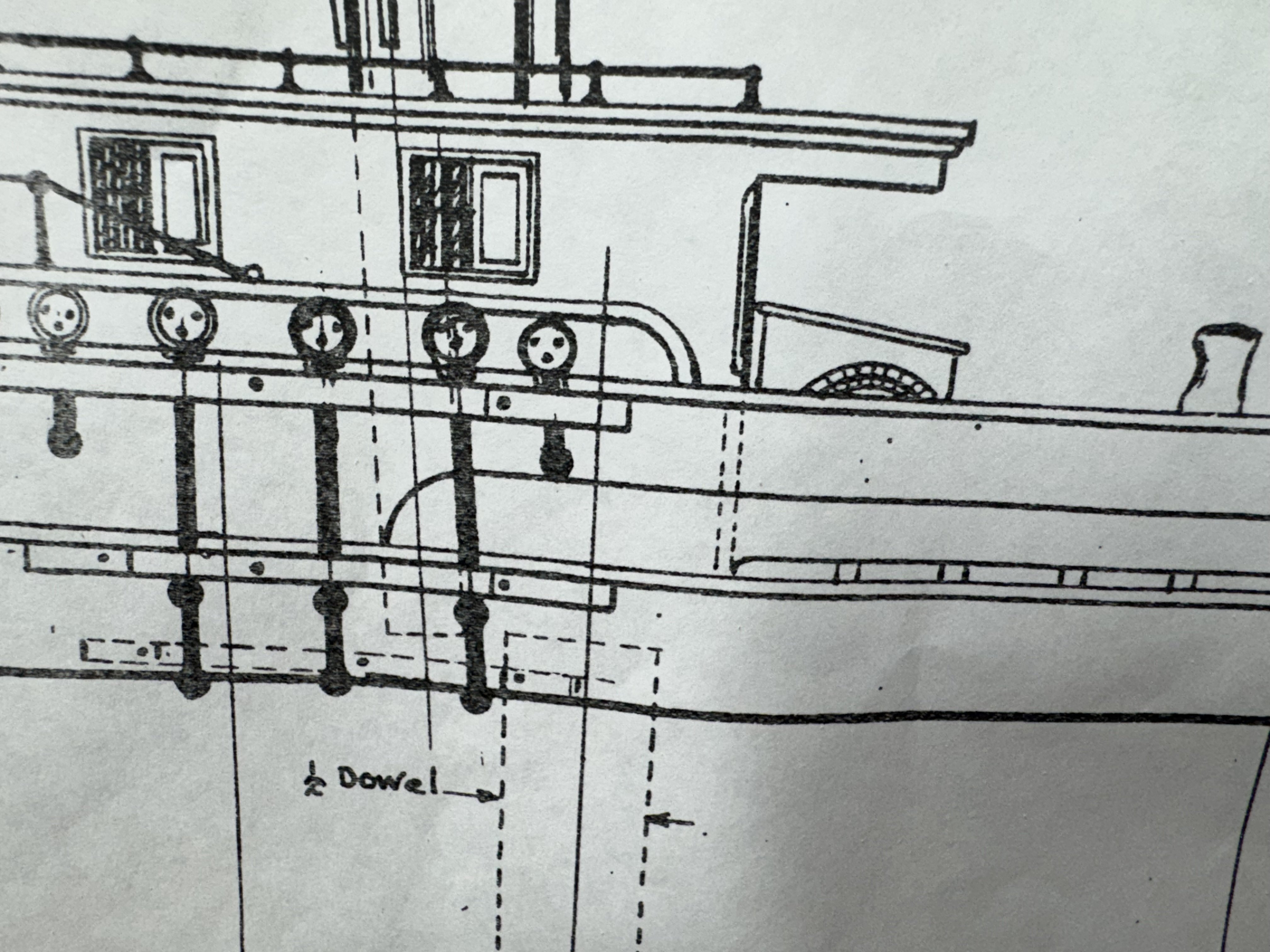

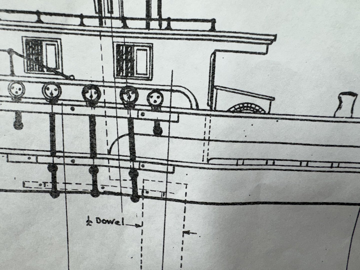

While waiting around for the pin rails which were just installed to get "set" I started looking ahead to the channels.
Here is the picture from the plans for the channels/deadeyes/chain plates for the main mast.
And here is one of the kit supplied chainplates with a deadeye mounted using 26 ga wire (no mention in the instructions of how the deadeyes are supposed to be attached).
I measured and my waterline is within 1mm of where it is shown on the drawing so it would seem that unless I want the chainplates and the backing link down to the turn of the bilge I need to find anther solution.

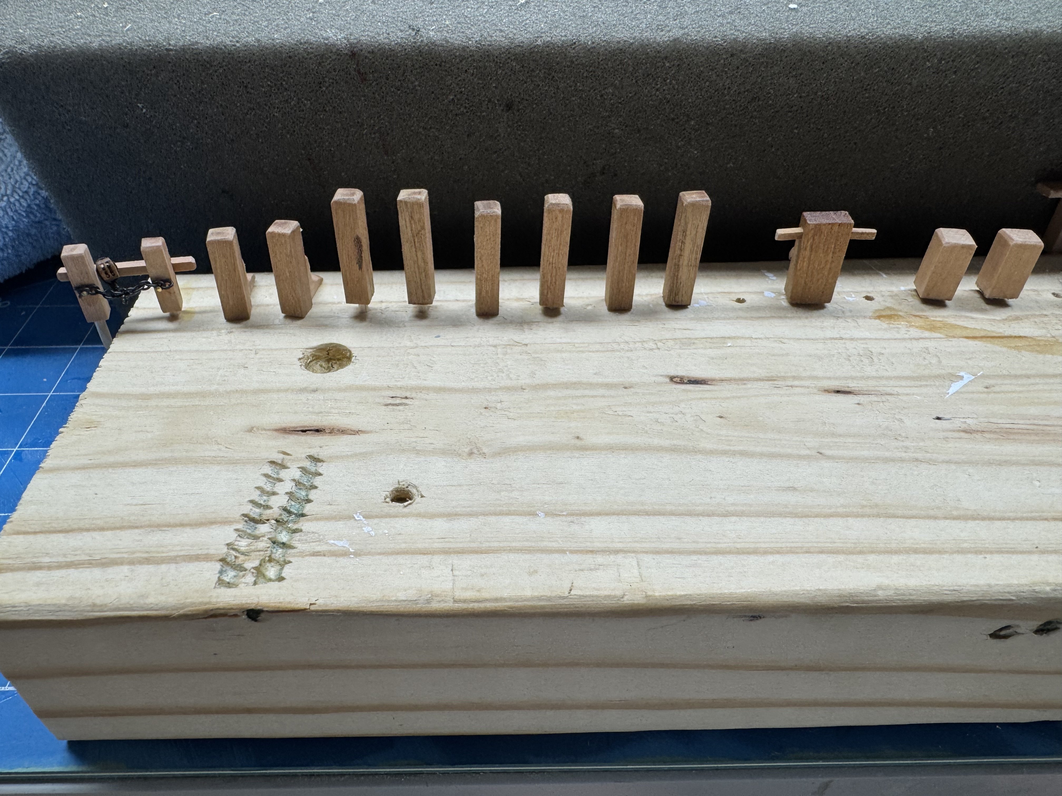

I set up a little jig (two pieces of .039" piano wire set vertically into a 2 X 4) and tried making the backing links out of 24 gauge annealed steel wire. Actually I tried 22, 24 and 26 gauge wire but decided 24 gauge was "best".
Here are the selected chainplate and the two alternative backing links. I made the replacement just a bit shorter (assuming I can replicate the length more or less exactly - yet to be established) so it will (in theory) hit the waterline the same as the drawing shows.
One down and 21 left to go.

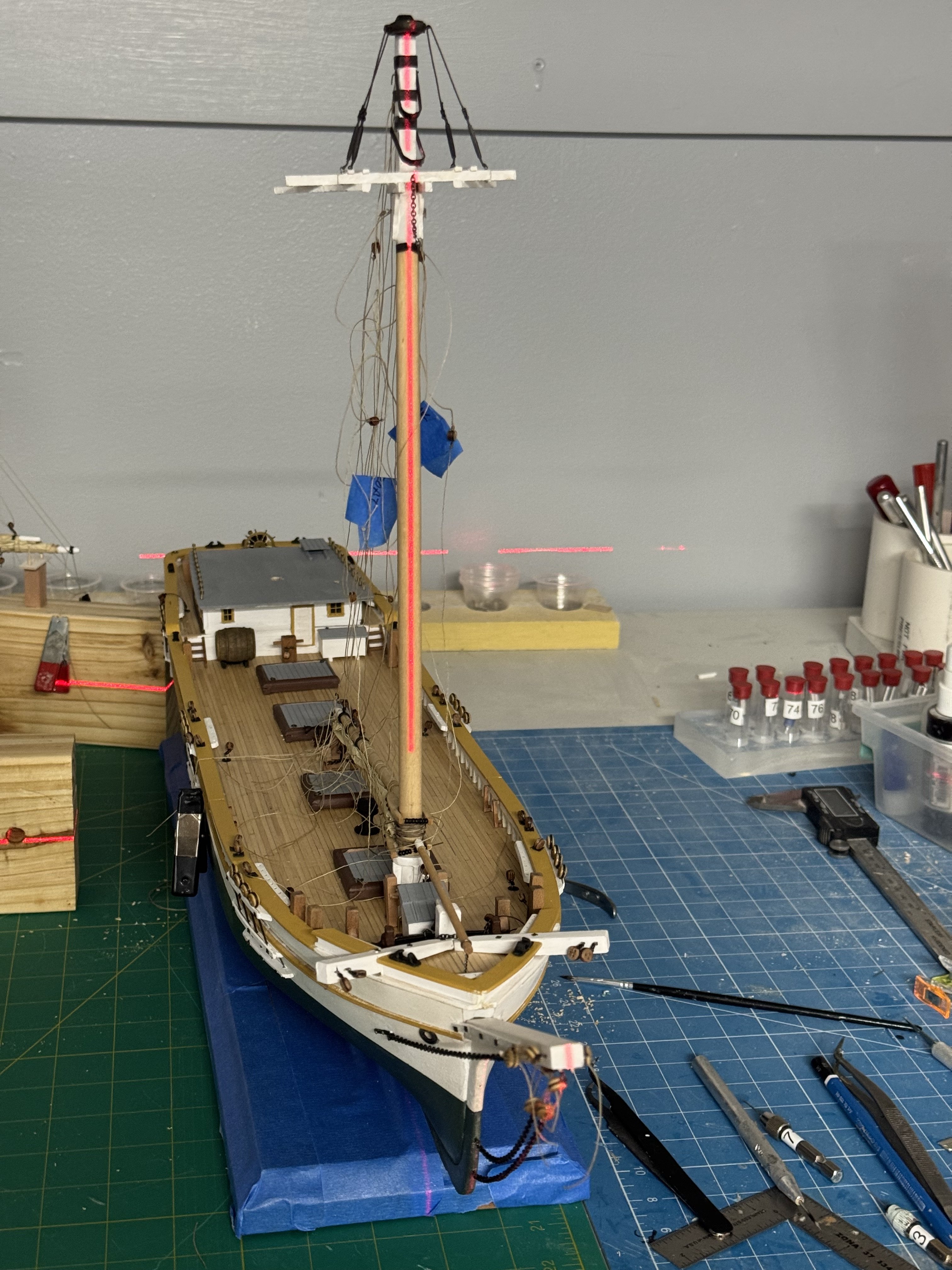

I believe I have the lower Fore Mast about as complete as I can get it at this stage.
The throat and peak halyards are rove and the block and becket/line are in place for the hauling end of each.
The topping lists (there are two, one on each side) and lazy jacks are in place as well. All of the lines are still adjustable as the boom is not on the boom rest so all the lines have plenty of slack as they will all need to be elongated when the mast goes onto the hull. I have not yet connected the yard sling chain as I may need to remove the yard to add the furled sail.
I had to fabricate a "yard truss" to hold the fore topsail yard (the only yardarm on the vessel) as the Britannia item was too flimsy (IMHO) and I wanted the ability to swivel the yard "out of the way" as was done when these vessels needed the extra clearance next to the pier. I am also considering putting the furled fore topsail on the yard but need to make a "test jig" as the sail has a "notch" in the center to clear the fore stay. I am not sure how all this is going to work out so I need a way to rig the sail, furl it then rotate the yard. I will do it "off ship" first then maybe transfer the furled sail to the real yardarm. The sail is only held at the head and at each end - no complicated lashings so this might actually work
But first I need to get the other two masts completed to the same level as the Fore.
Do not ask me how I know but drilling out the deck hole for the fore mast to the 1 3/4" depth shown on the plans will come perilously close to going out the bottom of the hull.

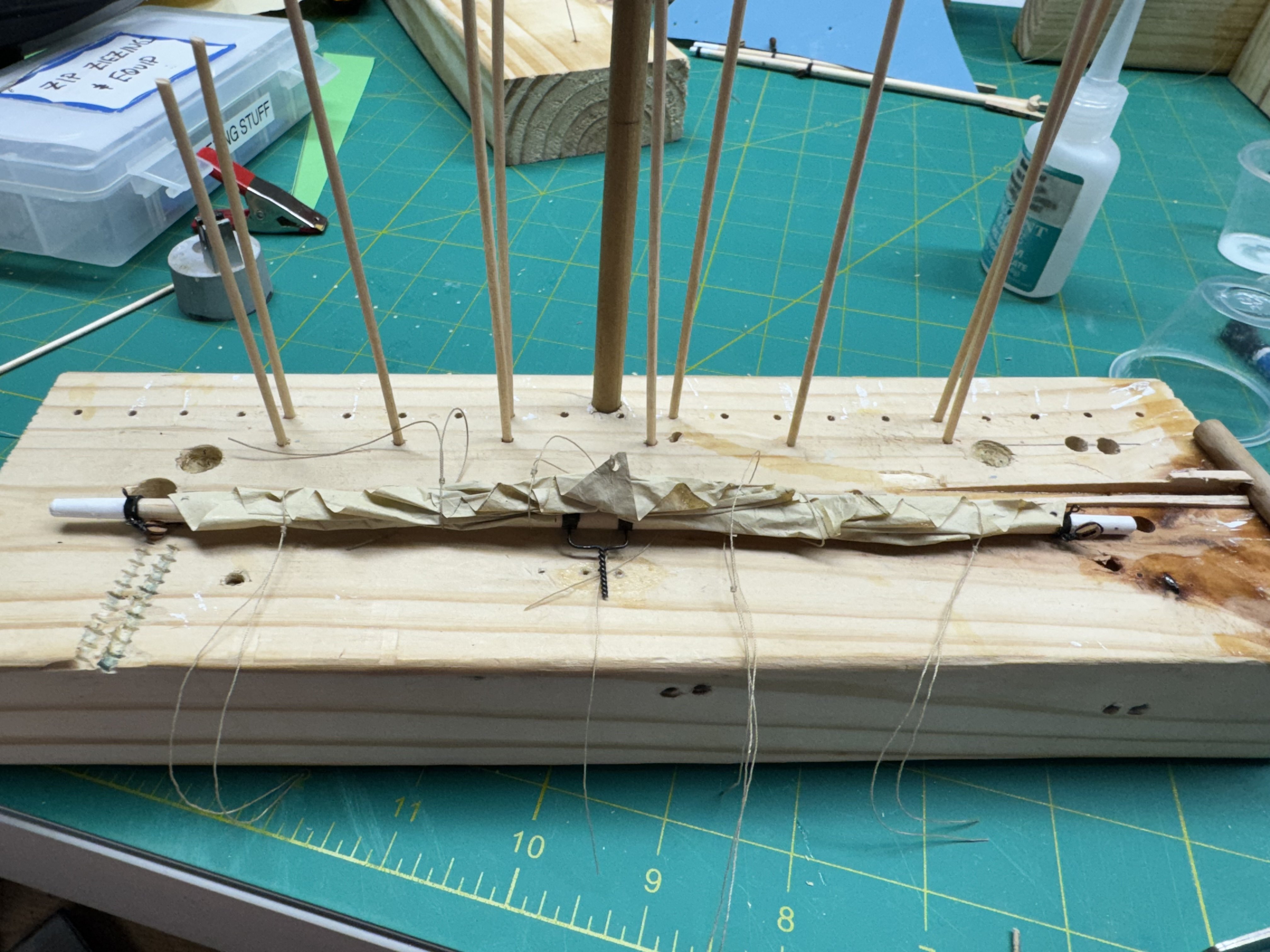

Main sail is completed , attached to the spars and mounted on the "Furling jig".
The sharp eyed will notice that one of the mast hoops has become detached from the sail. Not that hard to do (IMHO) but given it will be in the "middle of the pile" of mast hoops it is probably no big deal. I will have to use a smaller dowel for the Mizzen as that mast is 5/16" instead of 3/8" like the main and fore.
Now to the "fun" getting the sail furled without doing further damage. After it is furled I will remove it (carefully), use some rubber bands to keep it "together" and transfer it to the real main mast, add the boom rest and mast coat and then start the throat and peak halyards and topping lifts just like on the fore mast.

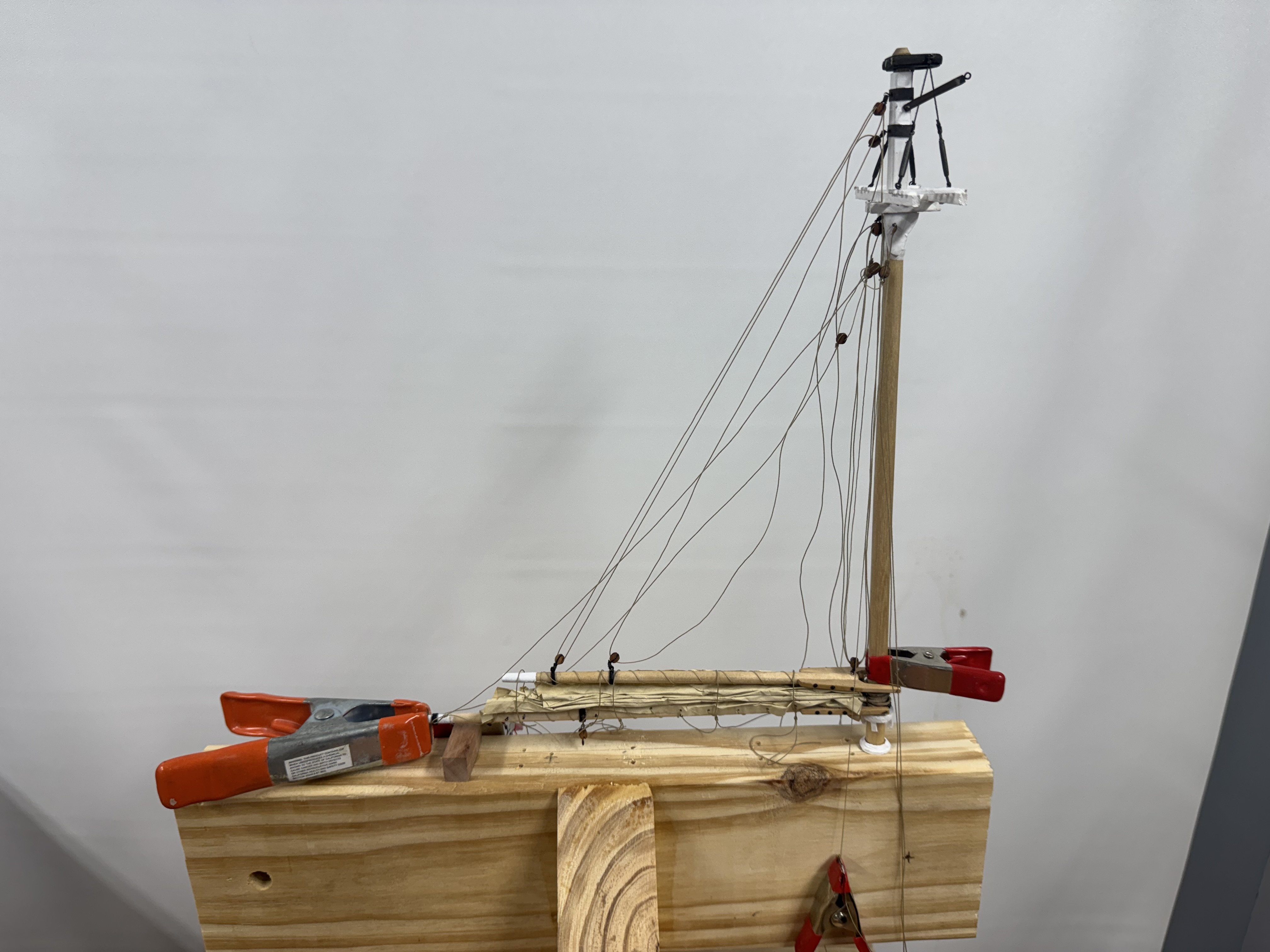

Main sail and mast completed to the same "degree" as the Fore.
You can see my "mast support 2.0" here (the 1.0 version is in the background).  I have learned that a 2X4 is not all that stable, especially when the sides are not sharp (as they generally aren't as purchased from Home Depot, etc.).

While the raffee sail was drying after cutting it out and applying the reinforcing parts I looked at the mizzen sail.

After several starts and restarts I finally got the raffee furled on the yard arm. not the neatest job but serviceable, at least for now.
The potential fly in the ointment is that the fore stay has to pass through the raffee to connect to the fore top mast. I built a jig with a mast, yard arm and fore stay to try and furl the raffee on that but it proved unworkable, at least for me.
I wonder just how the crew managed to furl the raffee since there are no foot ropes shown on the yard arm and there are no ratlines on the top mast stays/back stays. The only thing I can figure out is they used the yard lifts to tilt the yard so they could reach it, one side at a time, from the lower mast ratlines and trestle top. Must have been interesting in rough weather. Hopefully the skipper only used it in good weather and furled it well before rough weather.
The jig I used is shown below, the vertical dowels acted like lazy jacks to keep the sail contained more or less over the yard arm.

Mizzen mast is almost done. I have not rigged the lazy jacks yet and think I will wait until the mizzen mast is on the hull to do that.
I "think" I have the boom at the correct height above the deck (top of deckhouse actually) on the mast stand but want to be sure it is in the correct place. I may have to rerig the fore mast as I originally rigged it with the boom a couple of inched too high. When I lowered it I think some of the lazy jacks may now be too short.
Not really a big deal just disappointing that I was not smart enough to figure that out in the first place.

Fore mast is mounted on hull.
I used the laser level to check that it is truly vertical and then added the glue and some pressure to keep it in place while the PVA dries.
Tomorrow I will see how the rigging looks before adding the shrouds. I just "love" doing deadeyes.

I have the lower Fore Mast, boom and gaff in the hull and the halyards and topping lifts/lazy jacks in place. I decided I would mount all the lower masts before starting the shrouds and other standing rigging for the lower masts. I am not sure this is the "optimum" sequencing but if it isn't I will surely let you know.
So I placed the lower Main Mast in the hole I drilled in the hull and - either the main mast hole is too far aft, the mizzen mast hole (or maybe the whole deckhouse) is too far forward or the boom is too long by about 9mm. Or at least that is how much I cut off. The main boom will just not have as long or tapered ending as the fore and mizzen.
So i have shortened the boom (see cut mark above) and am working on getting a new band built and eyebolts installed as this is where the topping lifts terminate.
