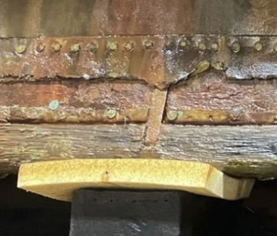

3. The next photo provides a detail that I did not expect at the join between the hull and the keel: the plates on the hull and the plates on the keel both have a tight row of nails at the edge that is at the join. This suggests that the plates butt against each other and there is no overlap. However, the photo above shows an edge above the tight row of nails at the lower end of the hull plate. Perhaps a narrow copper plate was placed over the join, overlapping the hull plate and possibly underlapping (if that is a word) the plate on the keel. (See also the fourth photo.)
4. The fourth photo shows more of the join between hull and keel but does not answer the question about what plating was placed there, if any. It does look as if the copper went over the main keel but not the false keel - it appears to run into the gap between them. I might be completely wrong about this.
That's how it looks to me. Yet the narrow strip is gone, presumably from being more vulnerable to long-term corrosion. I wonder whether bending it to fit the angle between keel and garboard introduced micro fractures, which then promoted corrosion. Or perhaps the narrow strip came from a different batch of copper and electrolysis across the dissimilar metals attacked it.
Yes, it looks that way. And the copper on the keel seems to cover the (bronze?) staple that held the false keel, where that lay across the keel but not where it lay on the false keel, so the copper plate was presumably trimmed around the staple. Yet that would mean that the false keel was in place when the coppering was done, so the edge of the lowest plate would have been pushed in, between keel and false keel, then nailed.

I believe that the diagonal nailing pattern Trevor refers to was British practice. Perhaps what we are seeing here is Dutch. If the copper was in good shape when the ship was captured, it would not have been replaced, as this was a major expense. The copper still looks in pretty good shape!
I seem to recall reading somewhere that the copper plating fit between the keel and the wormshoe (false keel). The wormshoe was a sacrificial piece to protect the keel and was replaced when necessary.
It looks like the bottom of the keel was coppered first, then the wormshoe was stapled to the keel. Then the copper plating was placed on the keel.
I can't tell from the photos, but perhaps the angled strip along the joint between the keel and garboard strake is there, but under the plates on the keel and those on the garboard strake?
I don't think so. What looks to have been the upper edge of the angled strip is still p[resent and outside the lower edge of the plates on the garboard.
Could be. I was looking at:
I think that's one of the staples (is that the right term?) holding the false keel. The copper plate on the side of the keel looks to be overlying the staple, while there seems to be a break in the nailed strip along the lowest edge of the keel, where the staple passes. But, even if I am interpreting the image correctly, the bottom of the keel could have been coppered, then a rabbet cut (so that the staple would lie flush) into keel and false keel, cutting through the copper in the process, with the coppering of the side of the keel following.
There's probably multiple other examples along the surviving keel remains, so whoever is working on the material may be able to figure out the sequence.

How was the keel plated?
My guess about this is that plates were laid lengthwise on the bottom of the keel, a single plate wide with the edges folded up over the sides by an inch or two unless the keel was wider in which case two plates would run in parallel. The photos placed above show copper coming from the keel-false keel join and extending enough up the side of the keel to give a tight row of nails. This row could be hammered in place after cut-down plates had been fitted to the sides of the keel. The plates on the side would have their top edge trimmed and bent to go over the lowest hull plates and were hammered down after the first hull plates were fitted. This sequence ties in with the bottom-to-top rule and the rule about lower plates overlapping upper plates. I have not tried to fit in the staples to this sequence and might return to it later if I feel brave.
