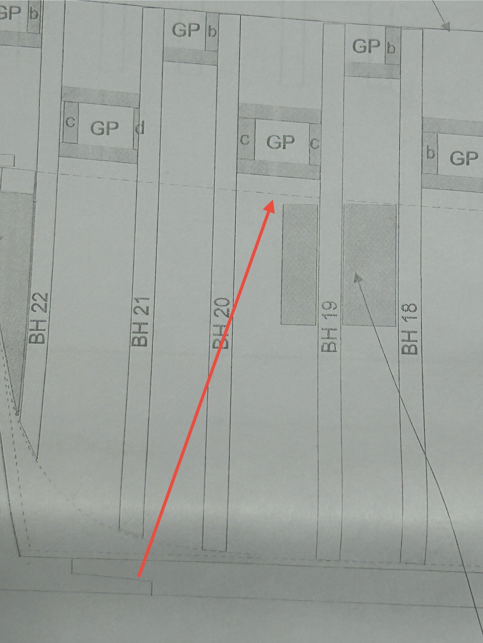

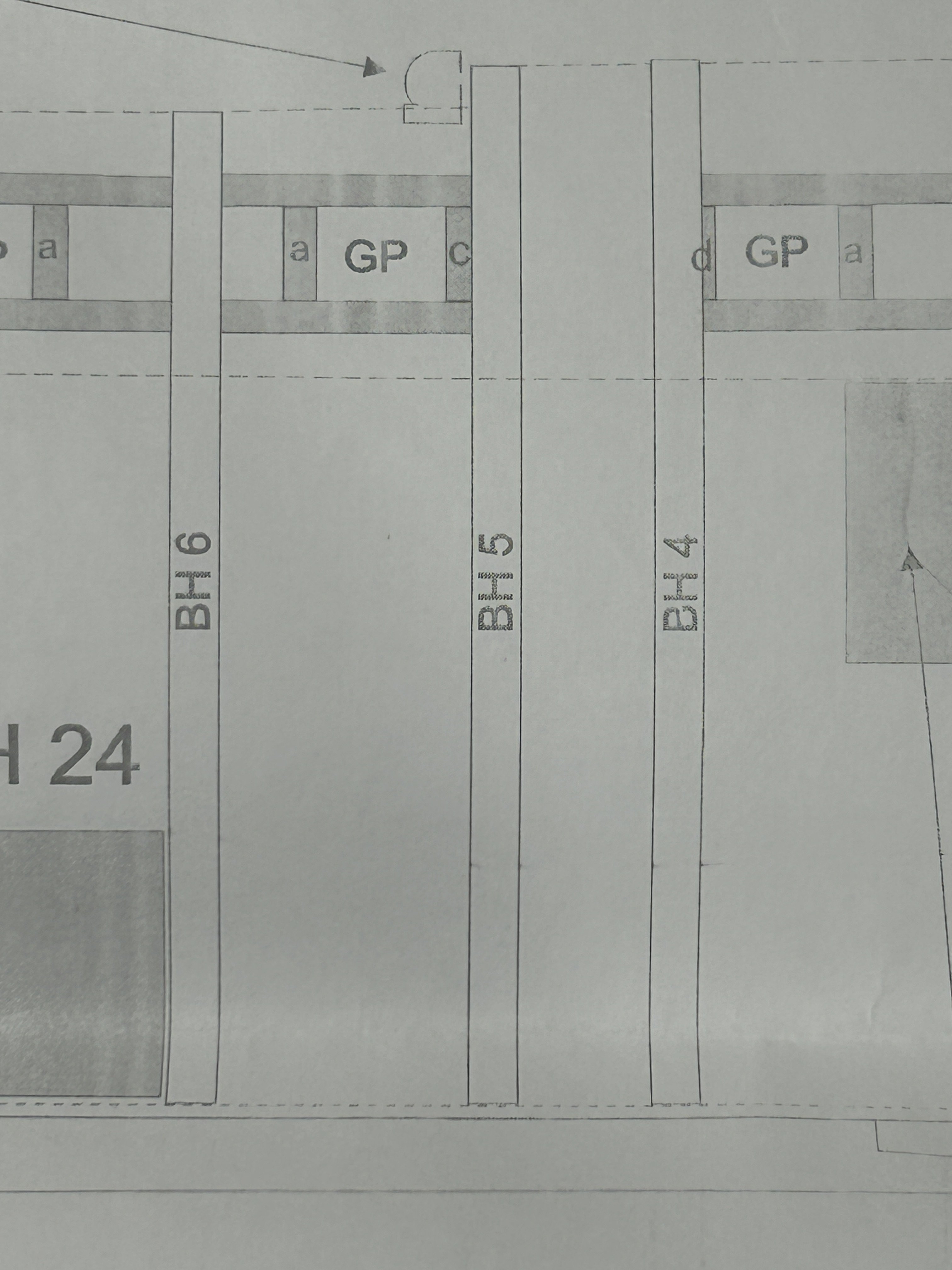

I am currently building the USF Essex.  I am a few steps away from framing the gun ports, but I have been looking ahead at the instructions and plans for the gun port framing.  I am 90% sure I know the correct answer, but I am a little puzzled by the instructions and plans as it relates to the gun ports.  This ship has a deck that slopes up as you approach the bow and the stern.  At midships the deck is flat at the sills and lintels of the gunports can be added 1/8 inch above the part of the bulk heads that will support the deck and the sides can be installed parrallel to the vertical portion of the bulk head and you end up with a rectangle shaped gun port.  See image from the plans below.

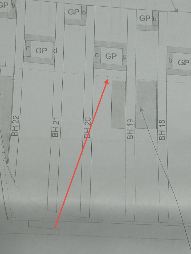

But as you approach the bow and stern, if the sill is placed along the line of the deck (as the instructions say) and the sides are installed straight up and down (as the instructions say), you will end up with a parrallelogram instead of a rectangle,  The plans seem to show the the gun ports as parralellograms as they approach the bow and stern.   See photo below.  The arrow points to the line that represents the run of the deck.
There are references in the instructions to building a plug to aid in the placement of the lintel and sides after the sill is installed.  This would only be useful if the shape was consistently a rectangle.  The kit also comes with laser cut parts to use for the gunport hatches and they are all rectangles.
As I said at the beginning of this post I am 90% sure I know the right answer, which is to build the gun ports shapes as rectangles and not as they are shown on the plans, but I would love to hear if others agree with this approach.  I will attempt to place the sill so that the center of the gunport sill is the proper height above the deck with the midship side higher that the middle and the bow or stern side lower than the middle.  The gun port sill will be approximately parrallel to the water line.

A quick clarification.   I will definitely make the gunports rectangle and not as a parrellogram as they appear on the plans, but should the sills be parallel to the water line or slope upward as the approach the bow and stern follow the deck.   Even if they are parallel to the water line each one will be progressively higher as they approach the bow and stern following the slope of the deck.

Cut the sills and lintels slightly longer than needed, Then chisel, file, or sand the angle in the ends.  Each piece
needs to be custom fitted.  After a while, with practice, the angle cuts will get easier.  Glue will fill any tiny gaps.

Thanks for uploading the drawing.   Based on this and the image of the model on the cover of the Anatomy of the Ship book, along with the specific direction to keep the sides “straight up an down” in the instructions I will make the gunport sills parallel to the water line.
They are parallel to the sheer of the deck to allow the gun to train without restricting depression or elevation at the extremes. The sides are parallel to the frames, which may not be perpendicular to the waterline. This results in each port having a different (non-rectangular) shape in practice, this is fairly minor except right forward and aft, but there is a reason each gun, carriage and port-cover was specific to a particular port.
