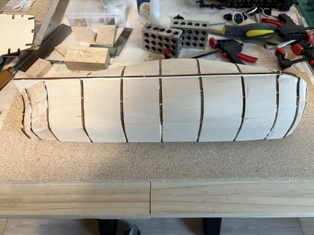

Currently the hull is sitting in the hull jig and is getting a next level of shaping / smoothing with a rasp:
I plan on smoothing close to the shape given by the kit's bulkheads and then will make refinements with the aid of the body plan in Betts' book. As pointed out by other builders of this kit, there are some extreme changes in the hull shape as you move away from midship near the turn of the bilge.

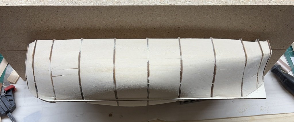

I've been spending a good deal of time each day (at least a couple of hours) shaping the filler blocks. Slow going! I'm finally getting close / starting to bevel the bulkheads. So the extreme fullness of the model has not been addressed yet. In this picture, I don't like the way the lower hull aft changes from convex to concave. Hopefully this will become a more graceful transition as the work continues.

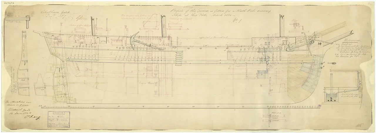

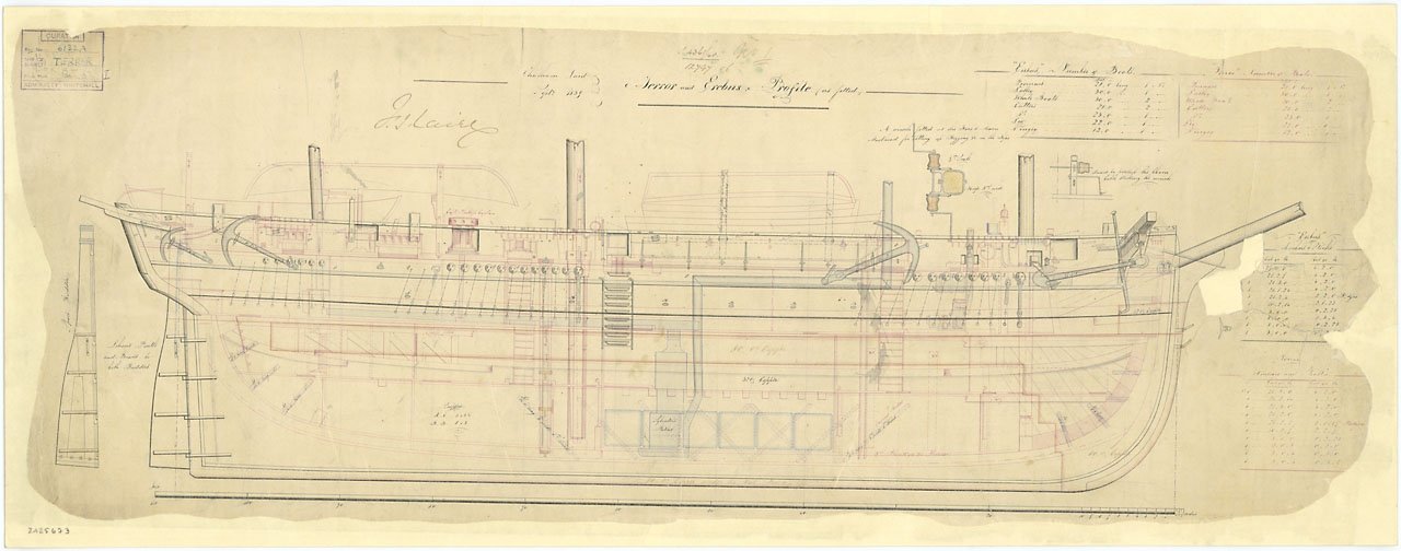

So you are (partially) referring to these draughts?
Before screw added:
After screw added / bowsprit moved:

The 2nd plan shows exactly what i was referring to- note the ice plank supports and railing stanchions for terror on the 2nd plan compared to the upright position on the plan for Erebus (1st plan above)
