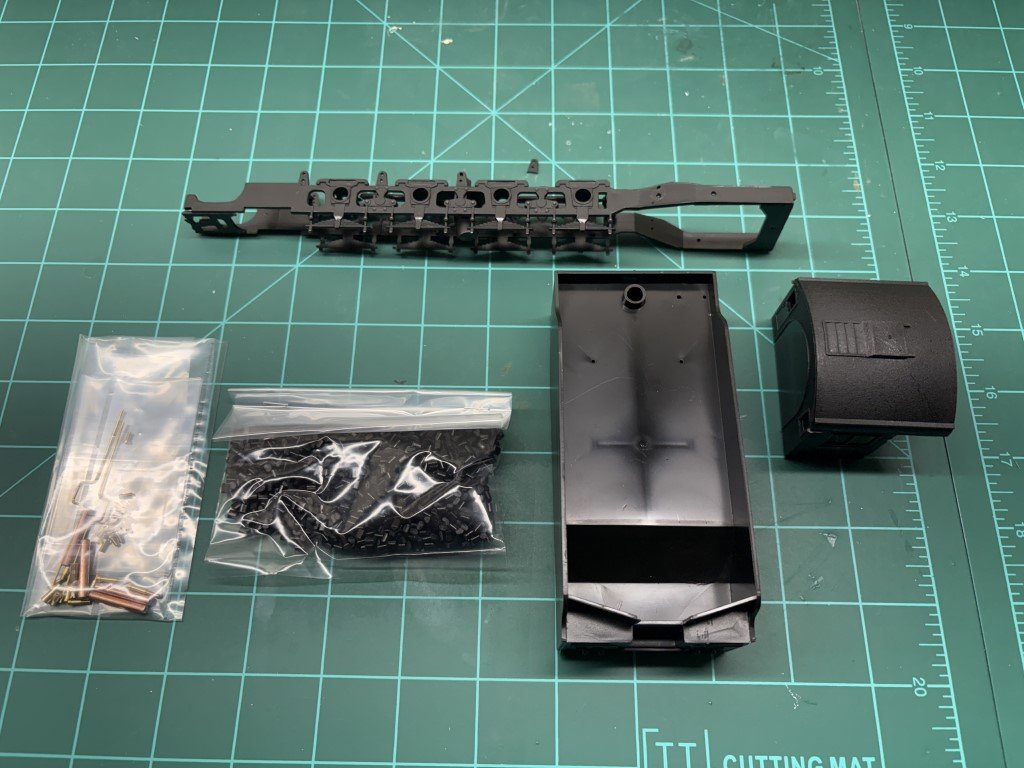

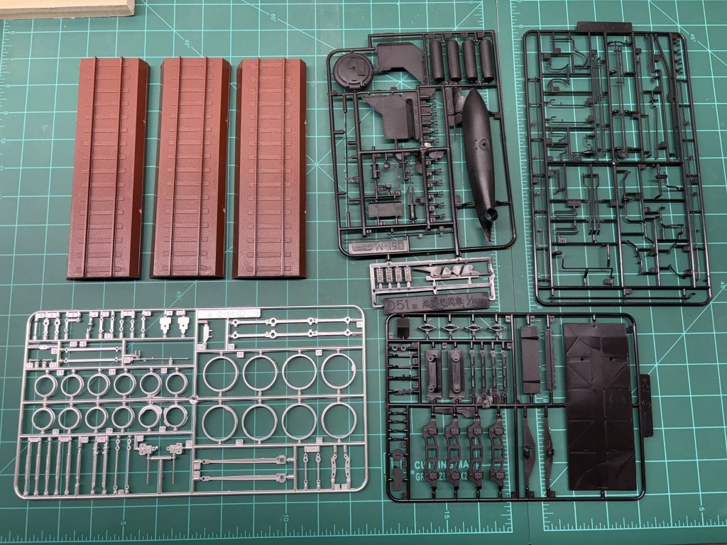

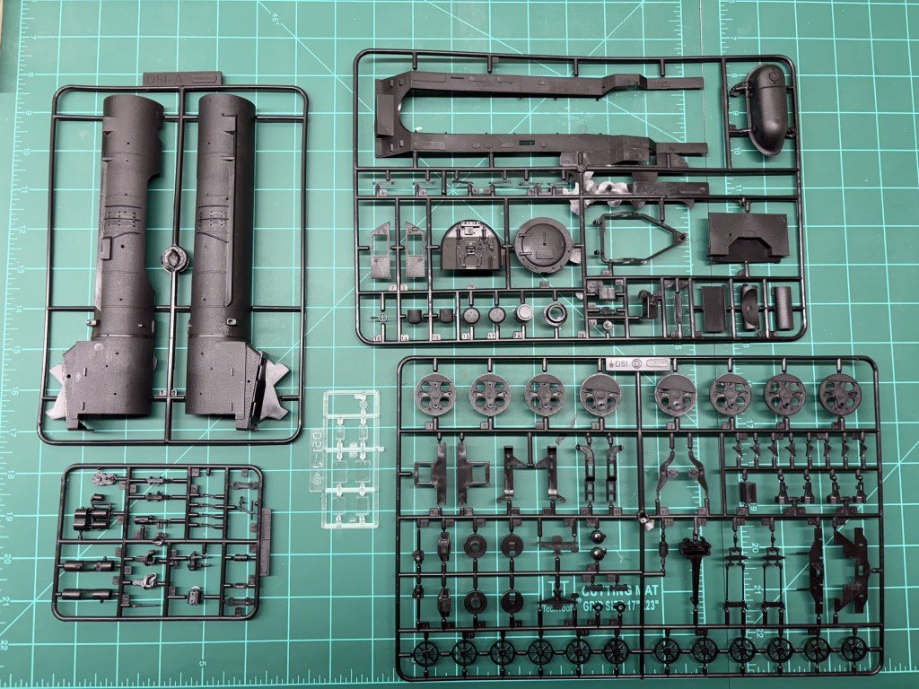

Here is what the kit looks like / includes:
D51SlagBox.jpg.65df87554d290c41eca0eb0fdcba163e.jpgD51SlagContents1.jpg.ee39f599bebd5d1b8e4e5130d23c090e.jpgD51SlagContents2.jpg.26d168cbf3eeea3245b2540e102b6340.jpgD51SlagContents3.jpg.fe6ff3387598da8b2c96987f43539ccf.jpgD51SlagInstructionBooklet.jpg.560d6307610e13d2a95100480b58e327.jpg

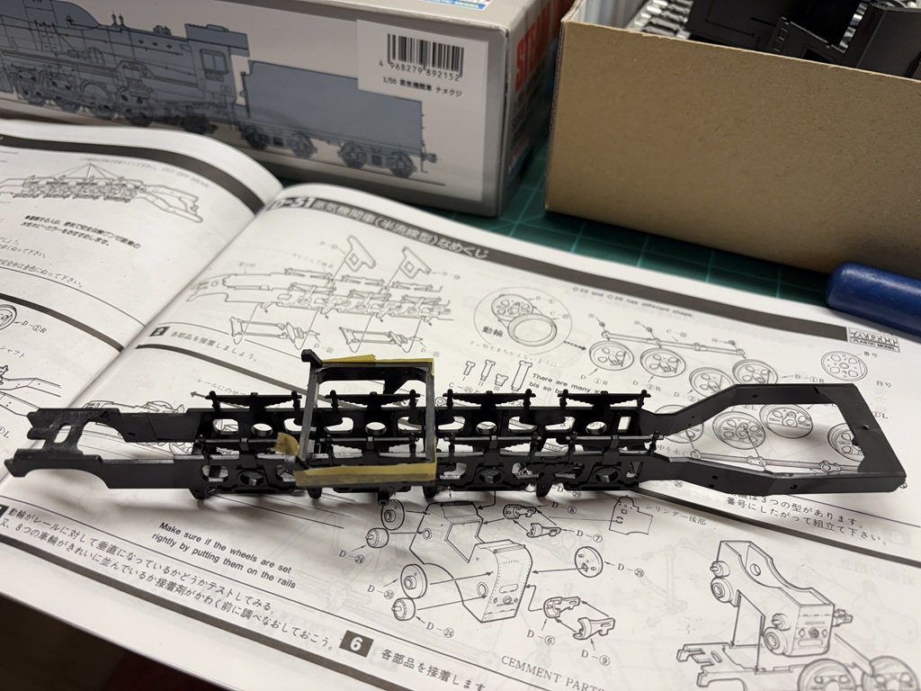

I started with the chassis as directed by the instruction booklet. Clean up took the most time as it is mostly in one-piece with a few details / parts to be added - two bulkheads and part of the brake system. Here is the assembly from above and below:

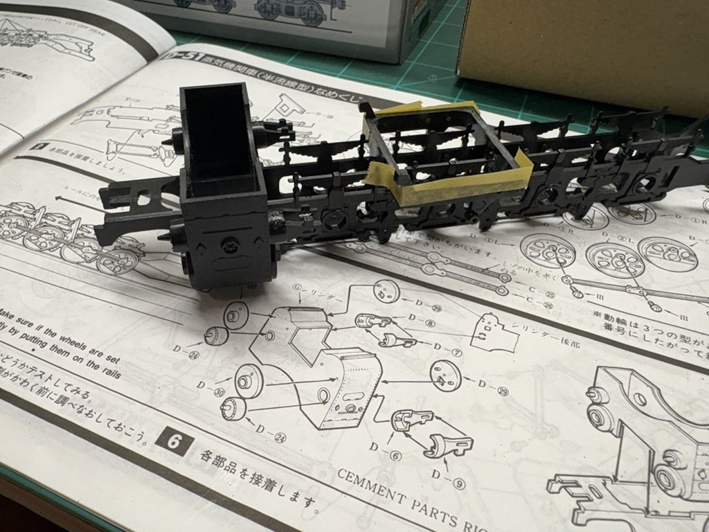

The cylinder assembly was put together and attached to the chassis next. It would have been nice if the structures D 6 & 9 and D 7 & 8 had alignment pins between one another, but they didn't and you need to pair them by sight / feel although they are indexed to the cylinder body.

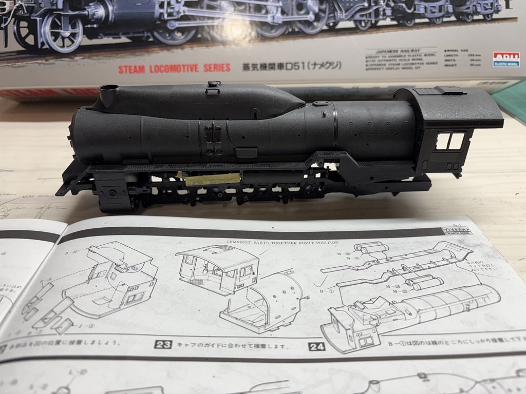

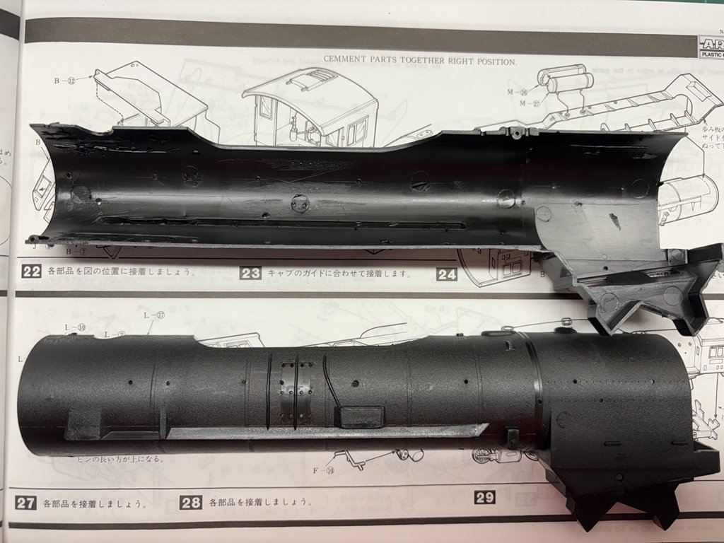

 Since that didn't take much time, I jumped ahead to start on the boiler. The two halves looked fine to me after I cleaned up the flash. The challenge for me was getting these together with just 2 alignment pins!
Fortunately the two halves mate well in terms of details such as the bands encircling the boiler. I ended up using the smoke box door as an aid to putting these parts together along with several clamps and some tape. [Aside, the kit came with two different steam box doors - I wonder if some parts of this kit are used in another.] Below is what the boiler looks like sitting on the chassis and having the cover sitting on top of the boiler. The cover still has some flash, but I can see that it will mate nicely with the boiler (which I think is impressive).

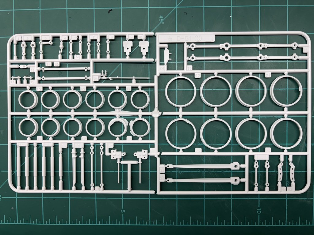

Today's progress was mostly in the removal of the chrome on one of the sprues. I cut the sprue into two parts and bathed them in an industrial purple degreaser - the one called Zep is available where I live and worked well. It took just under 30 minutes to remove the chrome plating and revealing a nice clean white set of parts.
RemovingCromewithZep.jpg.a65cbf01a5de29ee495961305797d3d7.jpgCromeRemoved.jpg.68fc8ee87a4a6866b47ebdcc11e15834.jpg

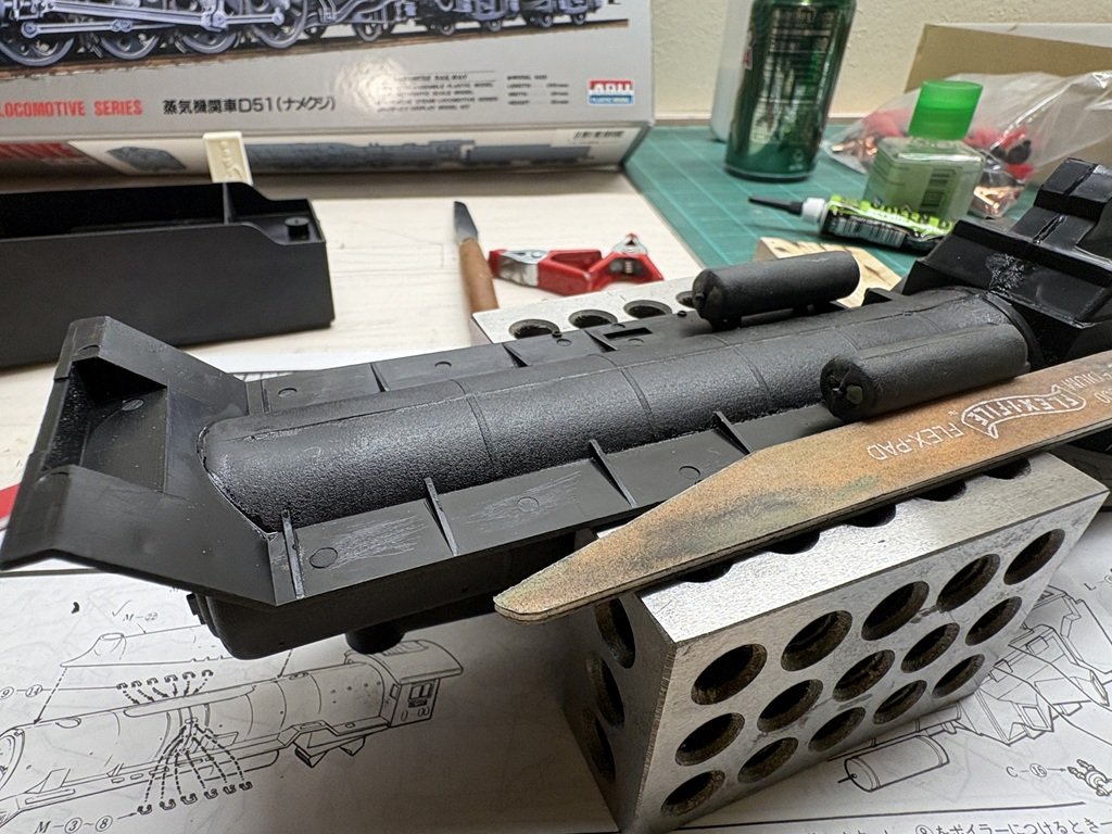

The boiler walkways were actually added before the rungs. This is one piece and it had a pretty good warp to it. Fortunately the plastic is flexible and there is a boiler length ridge / protrusion that this piece attaches to. So I started gluing by the cab and inch by inch one side to the other I made my way to the front.
In the above picture, you can see a tank under the walk. There is one on each side and each had depressions that needed to be filled and smoothed - I used Green Putty for the job. The tanks have two very small diameter / short locator pins. They do not keep the piece in place very well, so I needed to keep the tanks propped in position as the cement took hold.

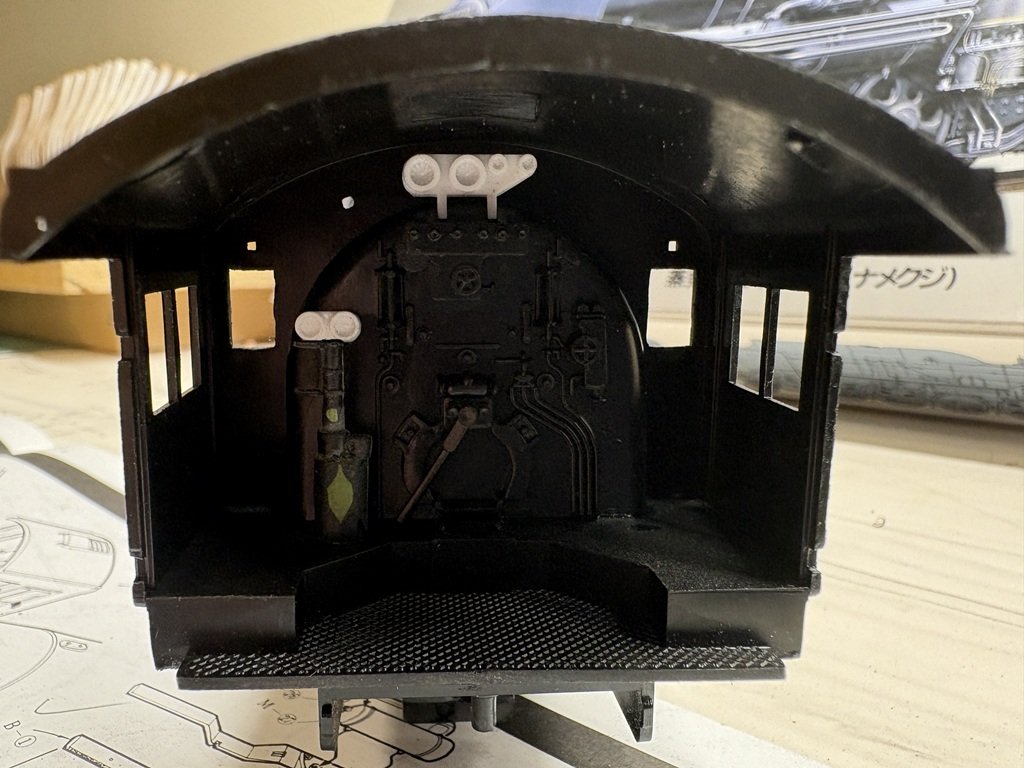

Actually, before all this took place I did some work on the cab and joined the assembly to the boiler:
A little more Green Putty!

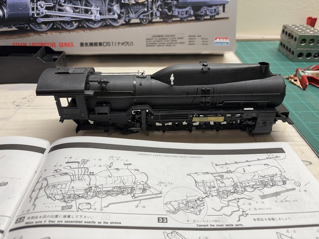

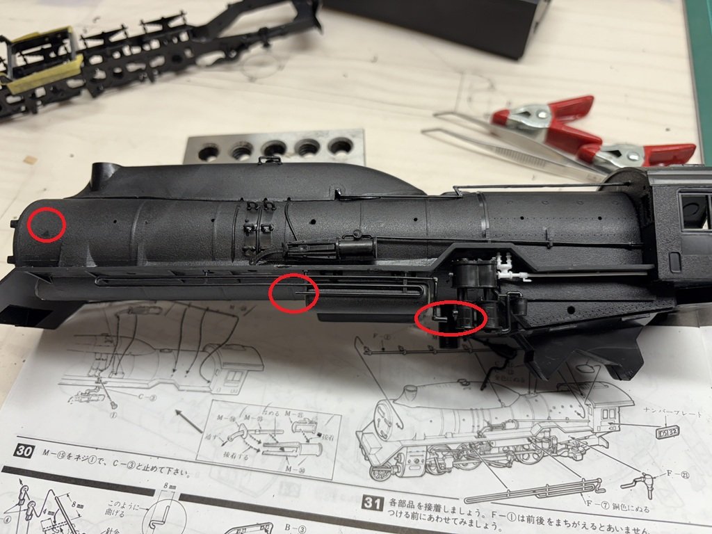

The last couple of days I've been adding the exterior detail parts to the boiler. I am mostly done with one side of the boiler now, but it has been a challenge with several pieces not fitting as expected. Here's where the engineer's side currently looks like:
A couple of the issue I have run into (there are more) include, from left to right, no front hole for the walkway rail - easily corrected; tubing missing 90 degree bend / extension to meet front end of under walkway tank - still to be fixed; gap / misalignment of connection - has been fixed. The connection fix involved shortening the downward section and then lengthening the horizontal section. Several other parts also needed to be modified a bit to achieve a reasonable fit.
This side of the boiler won't change much prior to priming and painting.
Most of the fireman's side details were added today. This is work from steps 32 and 33 in the instruction booklet. There are a number of parts that fit below the cab on this side - mostly associated with future connections to the tender - that have not been added currently. These three pieces wrap around / under the chassis and will be added once the boiler and chassis have been attached to one another. As with the engineer's side, several parts needed work to fit as needed. The biggest issue on this side is the long boiler rail; it was not complete at the fore end - the last station and bit of rail will need to be (re)modeled and added. Fortunately the problem is at an end and even better that it will be mostly hidden behind a fairing!
I fixed / added to the boiler rail by modifying an un-needed kit part. It seems that the base kit is for a later D-51 and the D-51 Slug makes use of common parts plus those needed to change the boiler appearance. So I was able to take a boiler linkage that had the same diameter as the rail and do some cutting and filing to get something that worked.

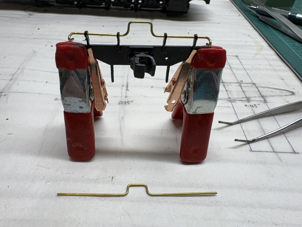

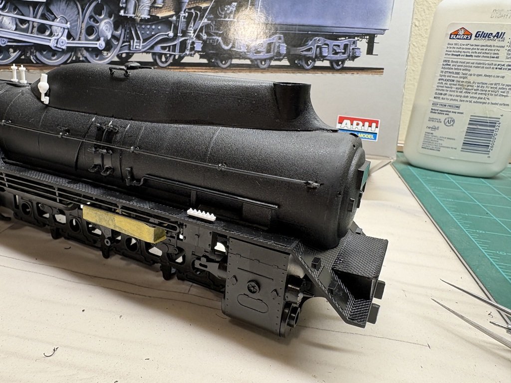

I also did some further work on the front of the boiler unit; the strangest being a railing (?) above the front coupler - for some reason, this is made from a piece of brass wire unlike all the other railing. There is an identical part for the tender that needs to be made. They came partially shaped. Getting the four plastic stations lined up is proving to be dicey process. I actually would have appreciated the unit (wire and stations) to have been molded as a single piece (which would be consistent with the rest of the kit).
Today I learned that the rail gauge for this locomotive (common in Japan) is Cape Gauge 3' 6". Wider than U.S. narrow gauge of 3', but not as wide as our standard gauge of 4' 8.5".  I did a little 'research' since the included display track just didn't look much like O - gauge track as I was expecting since the model is 1/50th scale and thus close to the 1/48th scale.

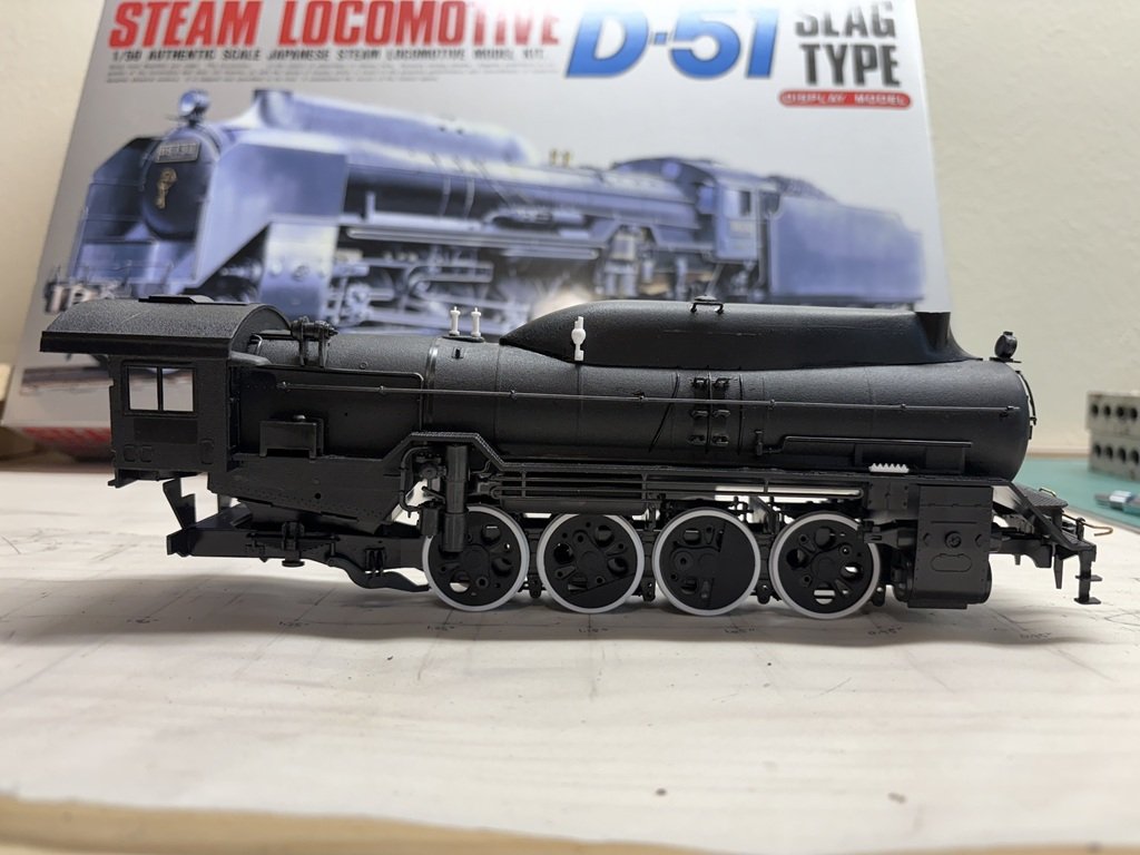

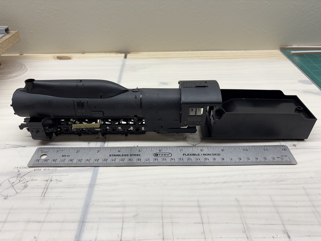

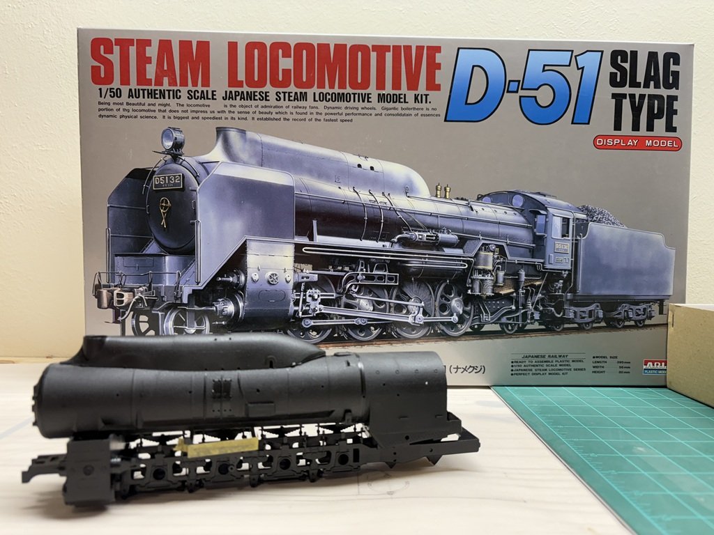

A few more additions to the boiler - rails on the front, steps up front, headlight, ... . Also cleaned up the wheels and tires and did a test fit to see the locomotive 'off the ground'.

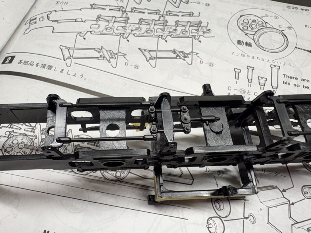

Two things of note here. First, the instructions have the builder attaching the wheels / tires to the chassis before the cylinder assembly is added. I have already added this assembly because I wanted to paint it with the chassis as a complete unit - almost a very bad idea! Its hard to see in the above picture, but there are pieces that extend to the back of the cylinders and are part of the running gear. Turns out that with that in place, there is not enough space to slide in the first wheel / tire as one. Fortunately, if the tire is removed, the wheel just makes it into place and then the tire can follow!

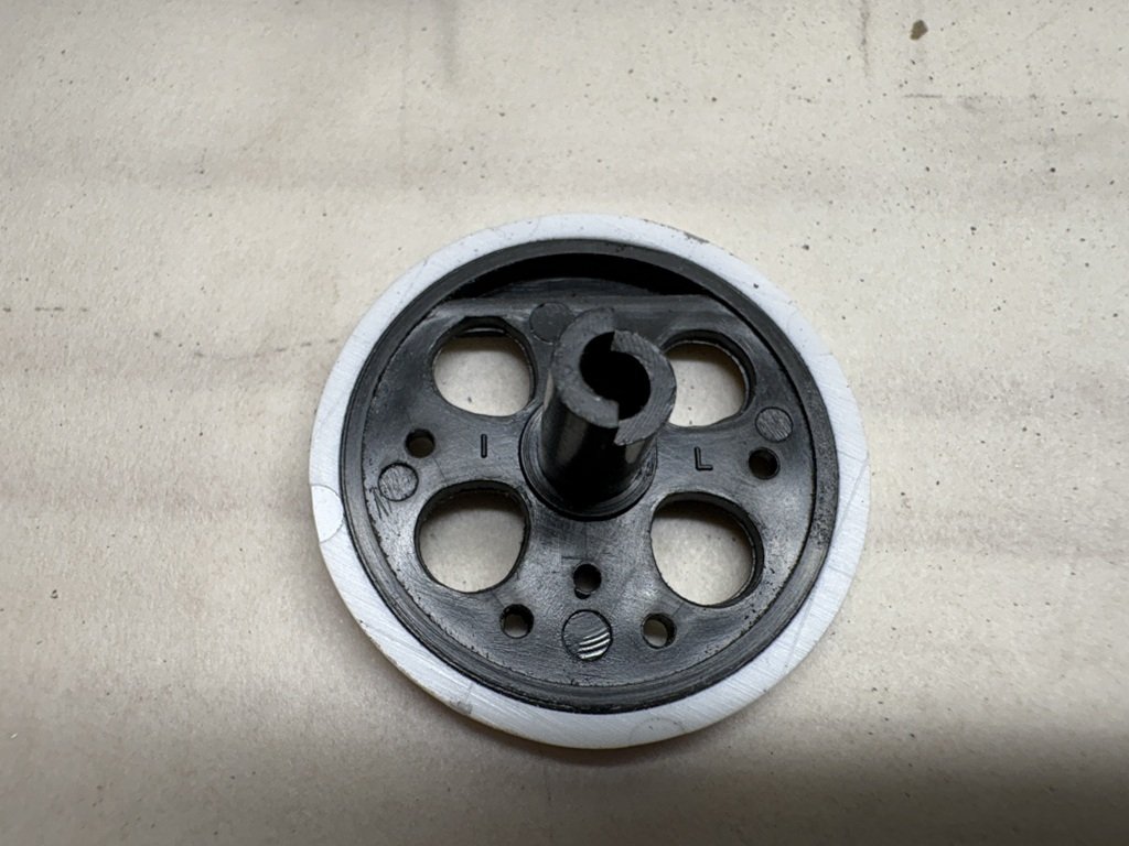

Second thing of note is an unexpected aid in how the wheels have been molded. There are three types of wheels for each side; the instructions label them as 1L (2), 2L, and 3L (similar for the right). While you can tell the difference by carefully looking at the counterweights, the model creator's molded the designations into the back of each wheel - a very nice touch.
Generally, I like the look of the drivers on all locomotives, but even more so the spokeless drivers like those on this machine. It continues to amaze me how precise the wheels and tires needed to be machined so that the tires could be heated and slipped onto the wheels prior to cooling.
