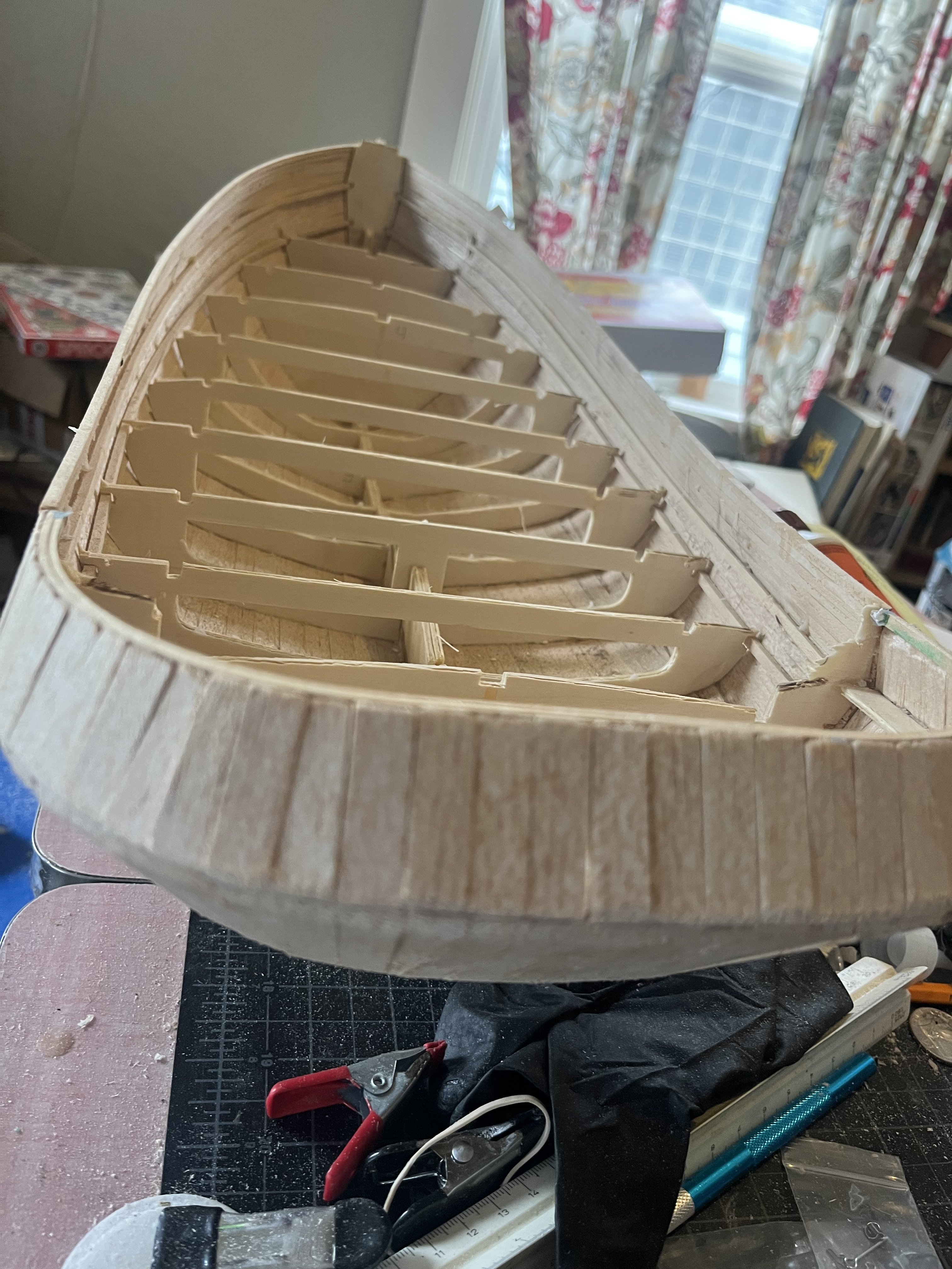

About halfway done with the first phase of planking and it’s moving along nicely I am enjoying the instructions on this one very nice plans and instructions making me feel more relaxed about not being 100% perfect as it will be sanded and faired before fiberglassing. I may not be the fastest at this and the manual says it took him 24 hours over 4 days to do the planking so I figure I’ll be done eventually

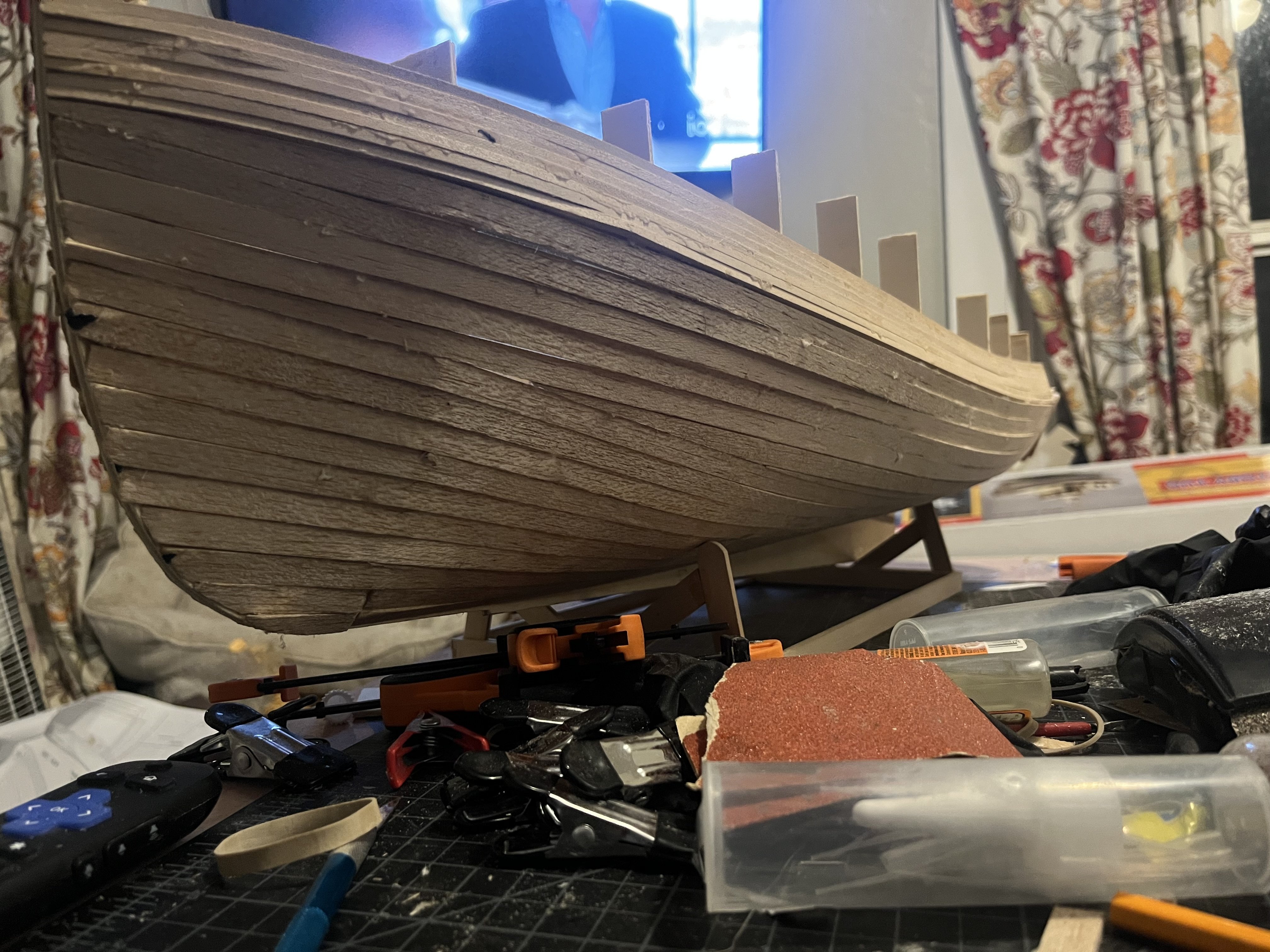

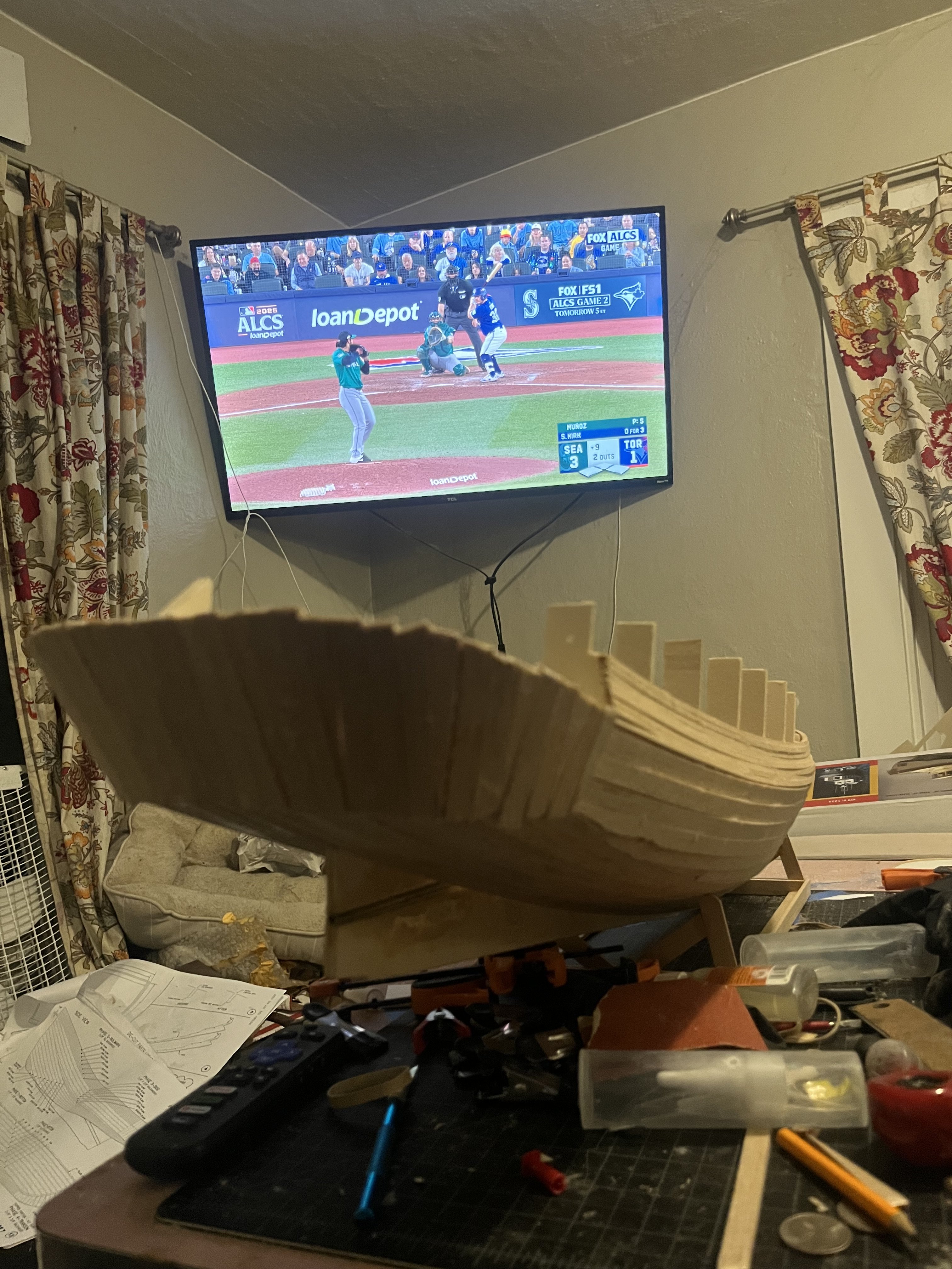

Middle of phase 3 planking and I am sure glad I have these handy clamps. It’s going slow as I’ve been way distracted with baseball this week so with the mariners having a week off before post season I hope to get this thing planked this week with any luck. It’s starting to look more and more like a tugboat hull to me
Still so distracted by October mariners so this is going a bit slower but I worked a good amount today finished phase 3 and started phase 4 planking the transom it looks rough right now but I haven’t sanded it flush yet but I finished the lower transom just as the Mariners won so I’m going to call it a day

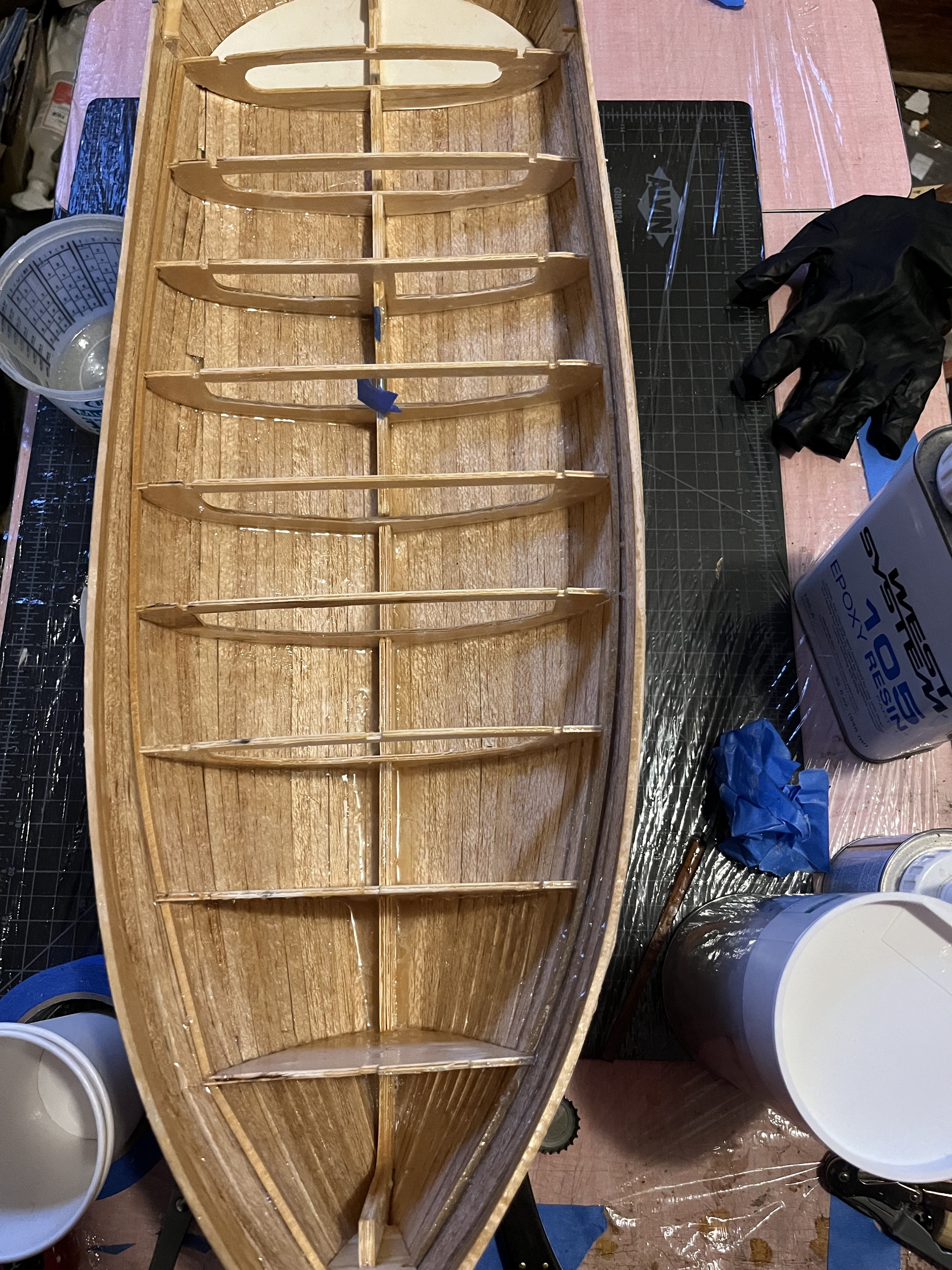

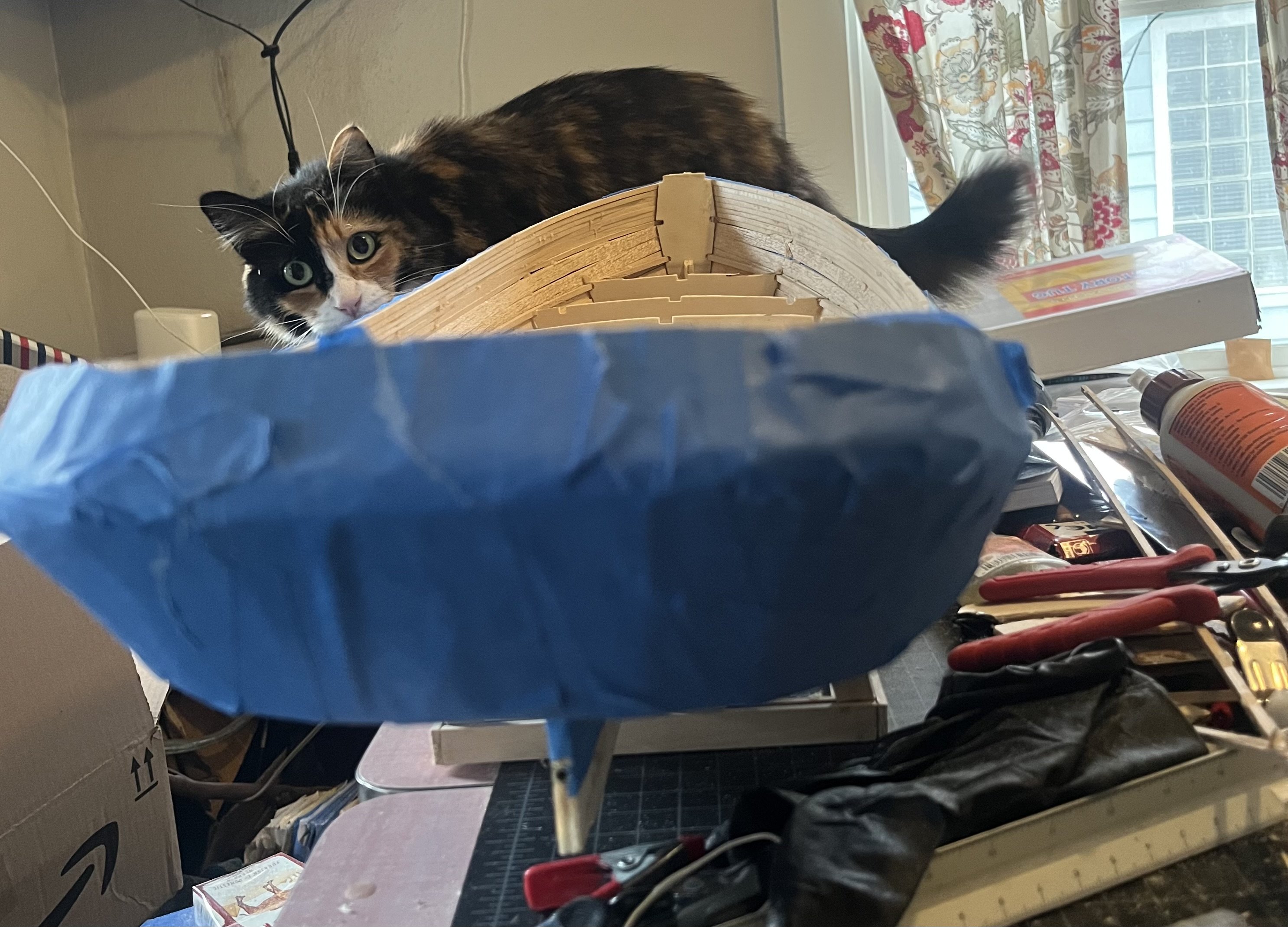

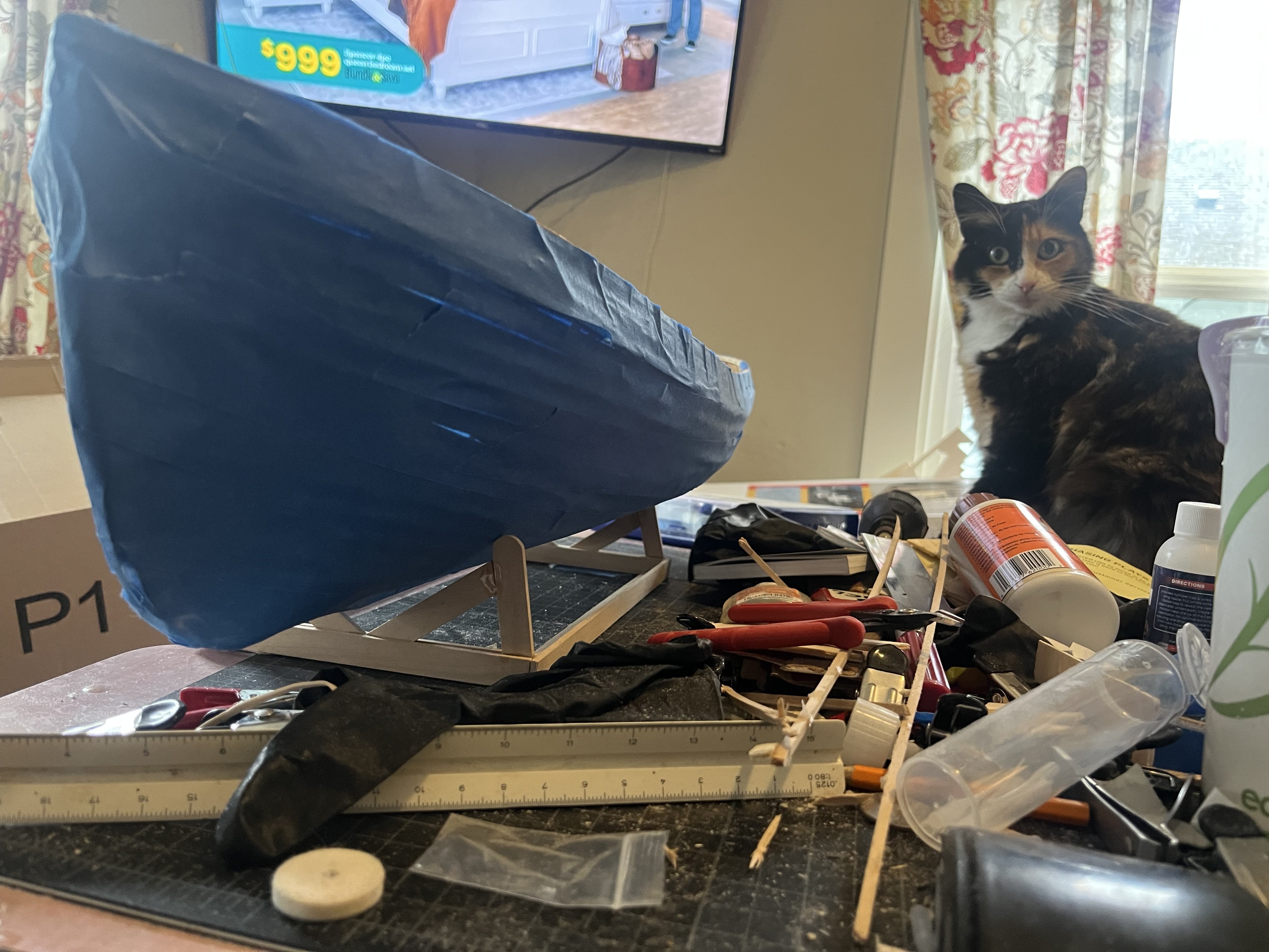

Hull has been planked and the feet have been removed down to deck level. I now covered the hull in masking tape and will be sealing the inside with epoxy I need to order some fiberglass for the exterior of the hull.

Andrew, your cat seems to be very interested in of what you are doing.

Oh no, the dreaded shipyard inspector..... to make sure you are following the protocols.

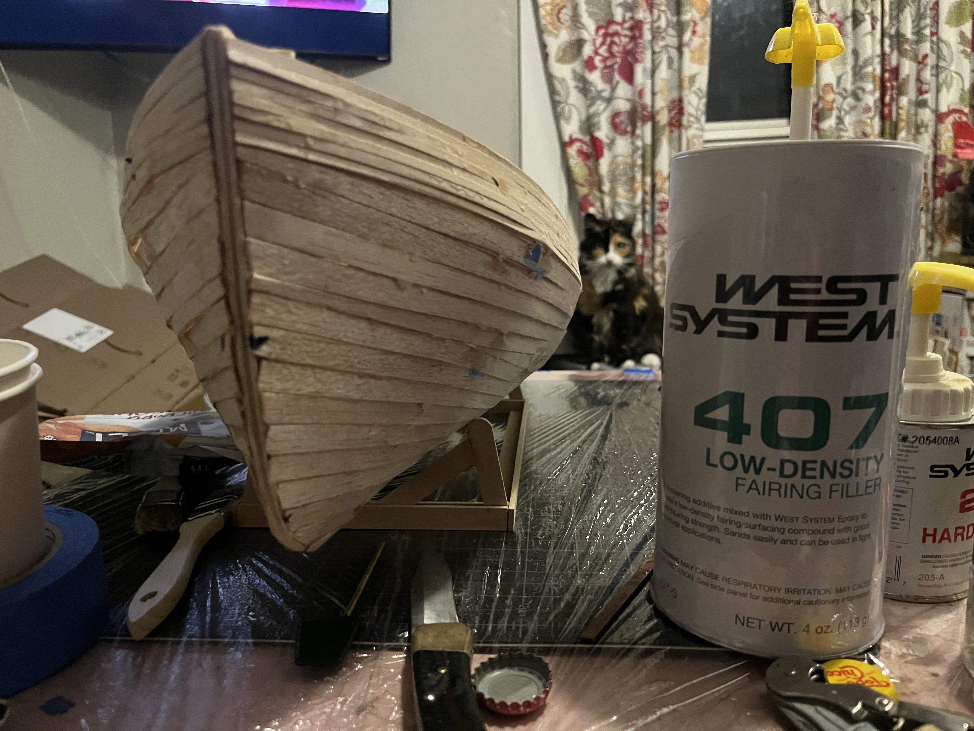

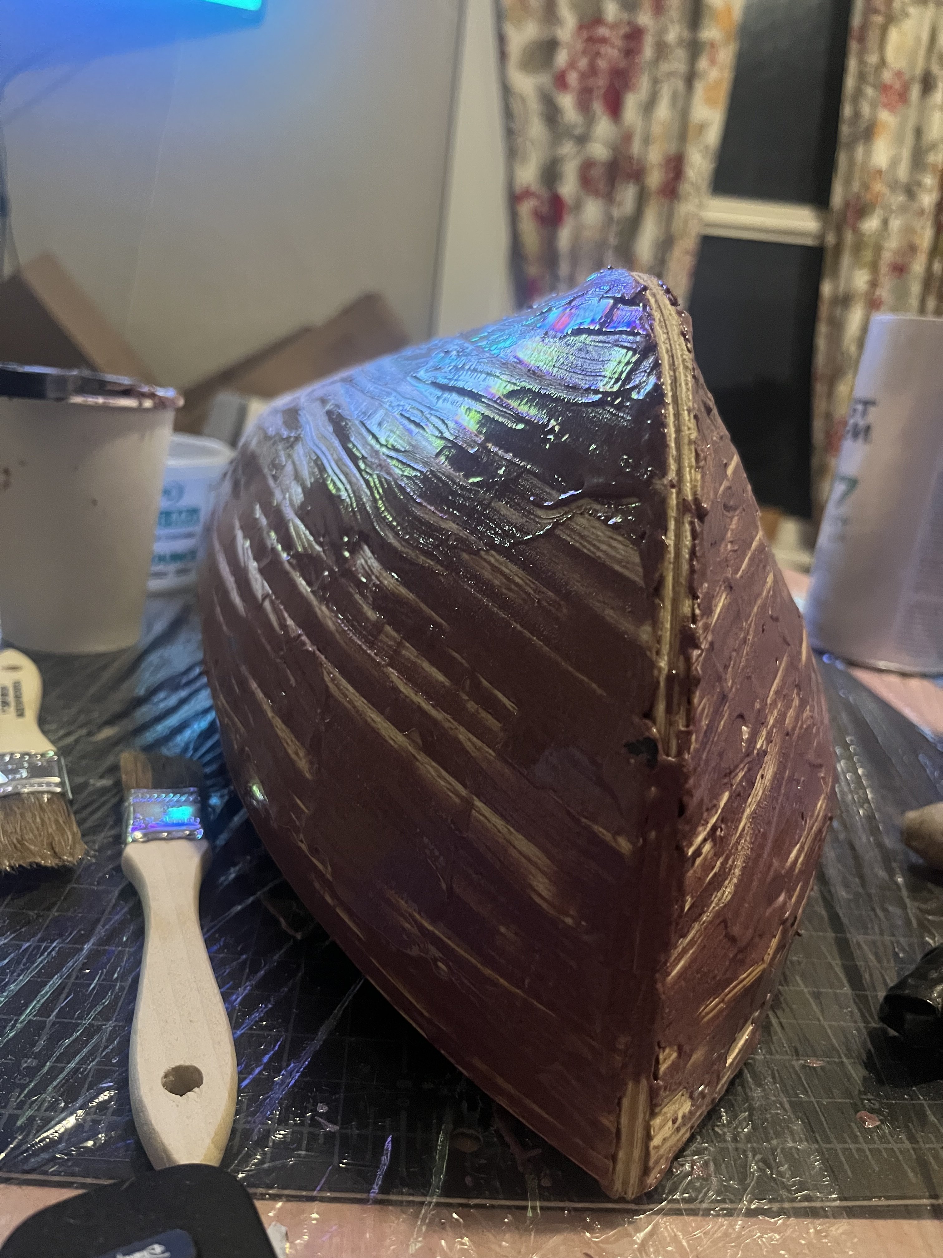

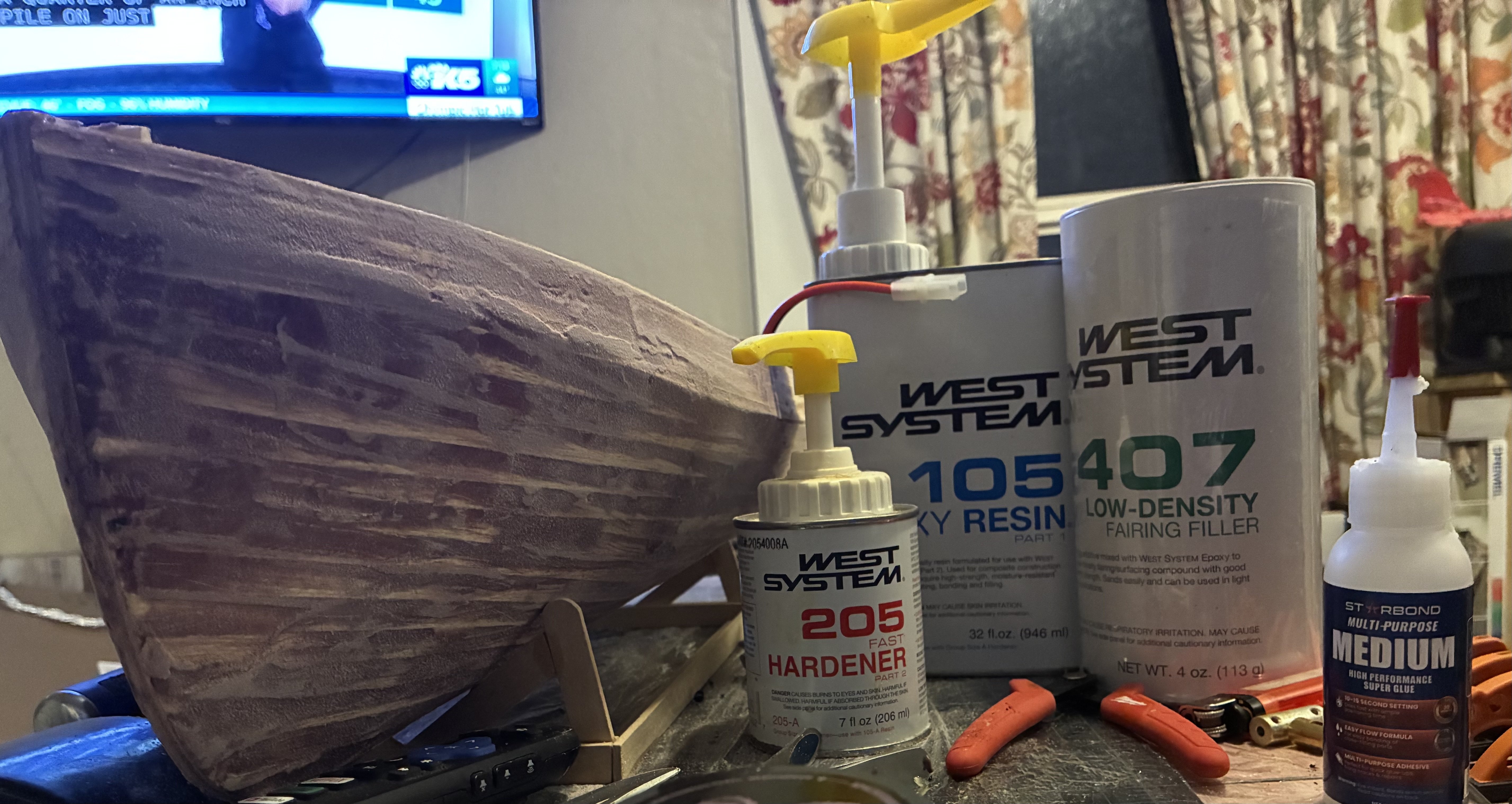

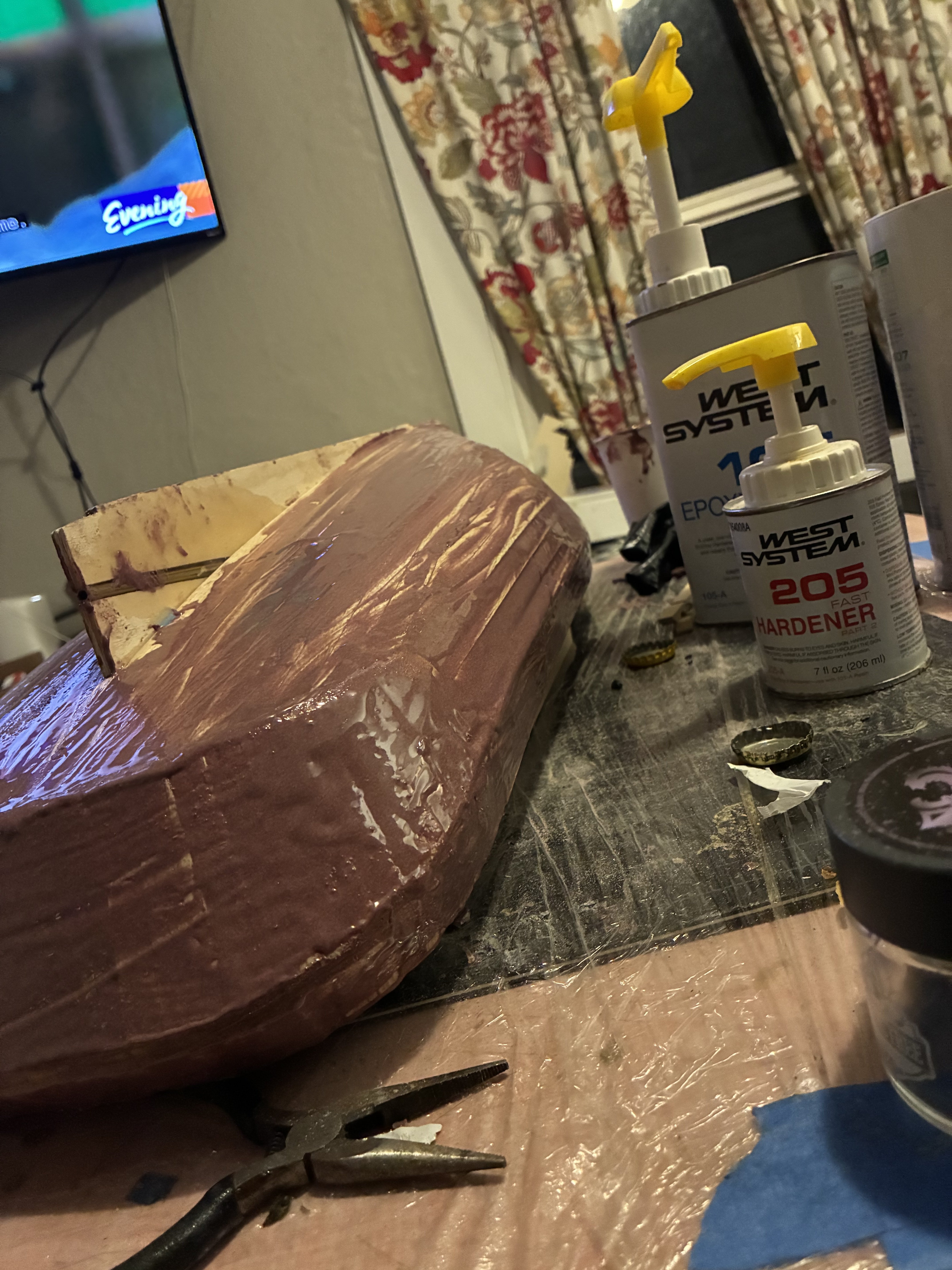

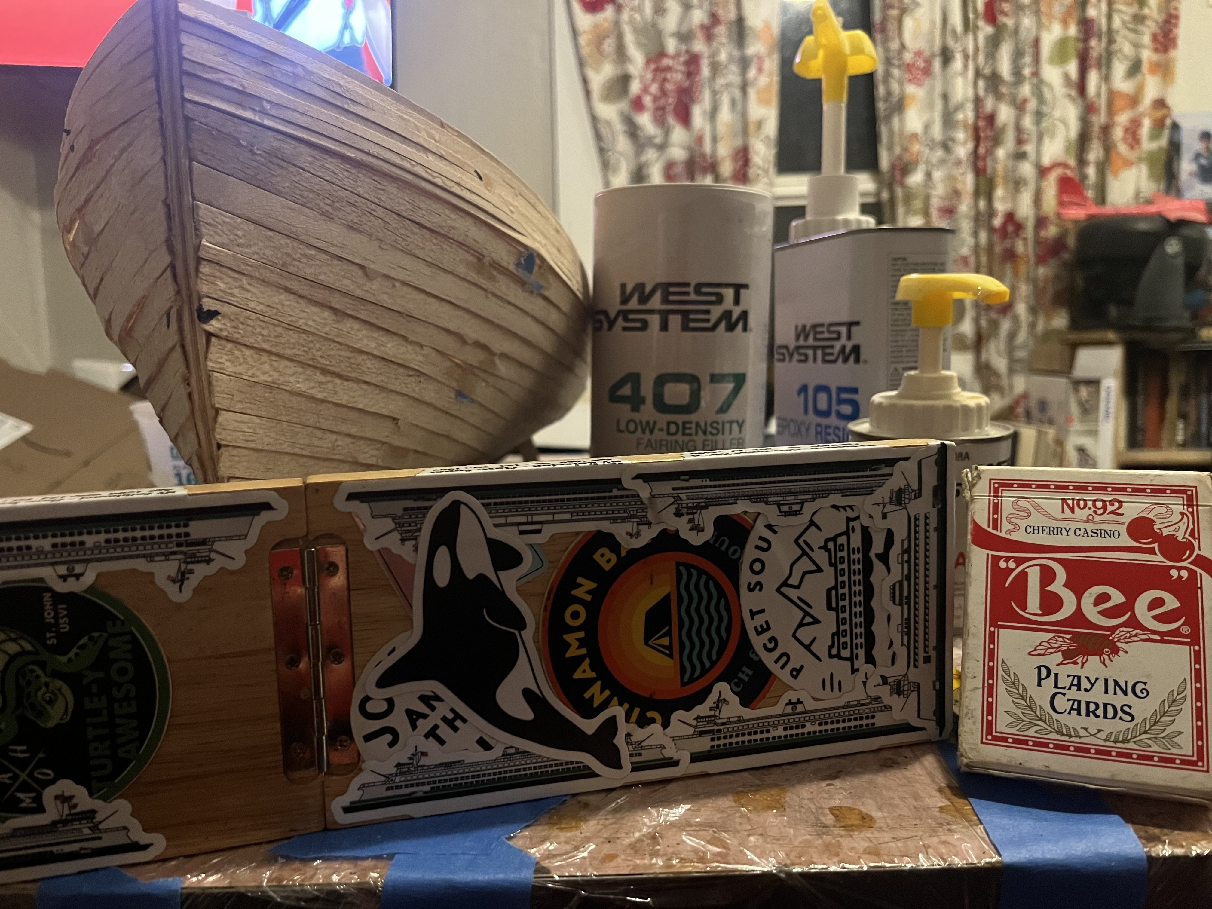

Epoxy done on the inside I was worried it would leak a lot but the tape kept that to a minimum. The next step is to sand the outside of the hull before doing the fiberglass work, the instructions do not mention anything about fairing at this point but I believe I need to do quite a bit to make it nice so I picked up some fairing additive from the chandlery and will be trying that out shortly
on the way to Bainbridge for Sunday breakfast and stop at the chandlery our ferry had to stop as multiple orca pods as well as a couple grey whales surrounded the boat such a super cool experience and sadly no pictures just memories and another sticker on the cribbage board to remember it by
Edited by Andrewiscookin

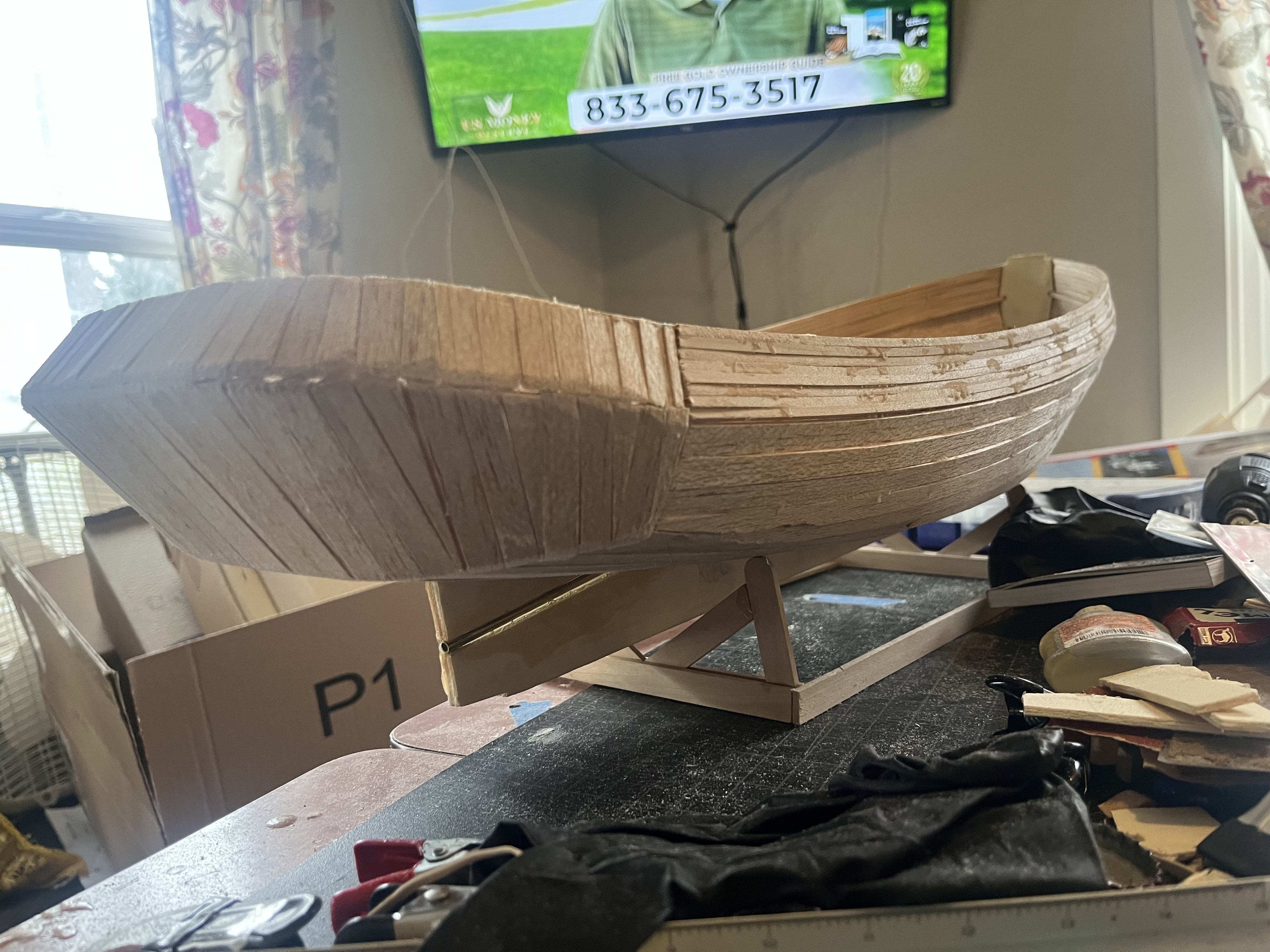

Got a bit distracted after doing that test bit on the bow and just now got around to doing the rest I really liked how this product was easy to sand so I may have gone a bit heavy that just means a bit more time sanding but I think it will turn out even better. So now it is the purple slime machine.

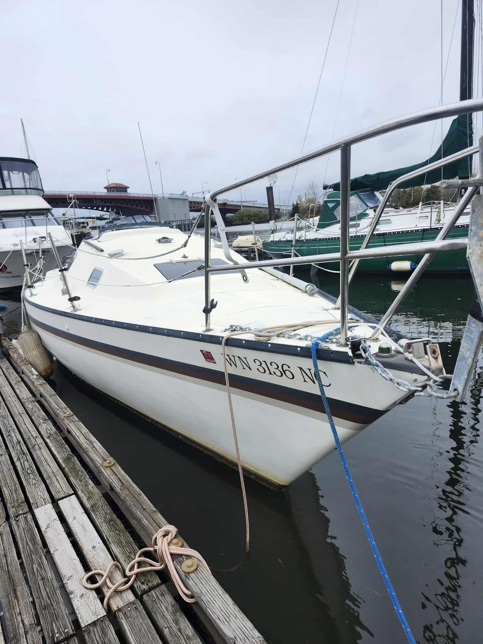

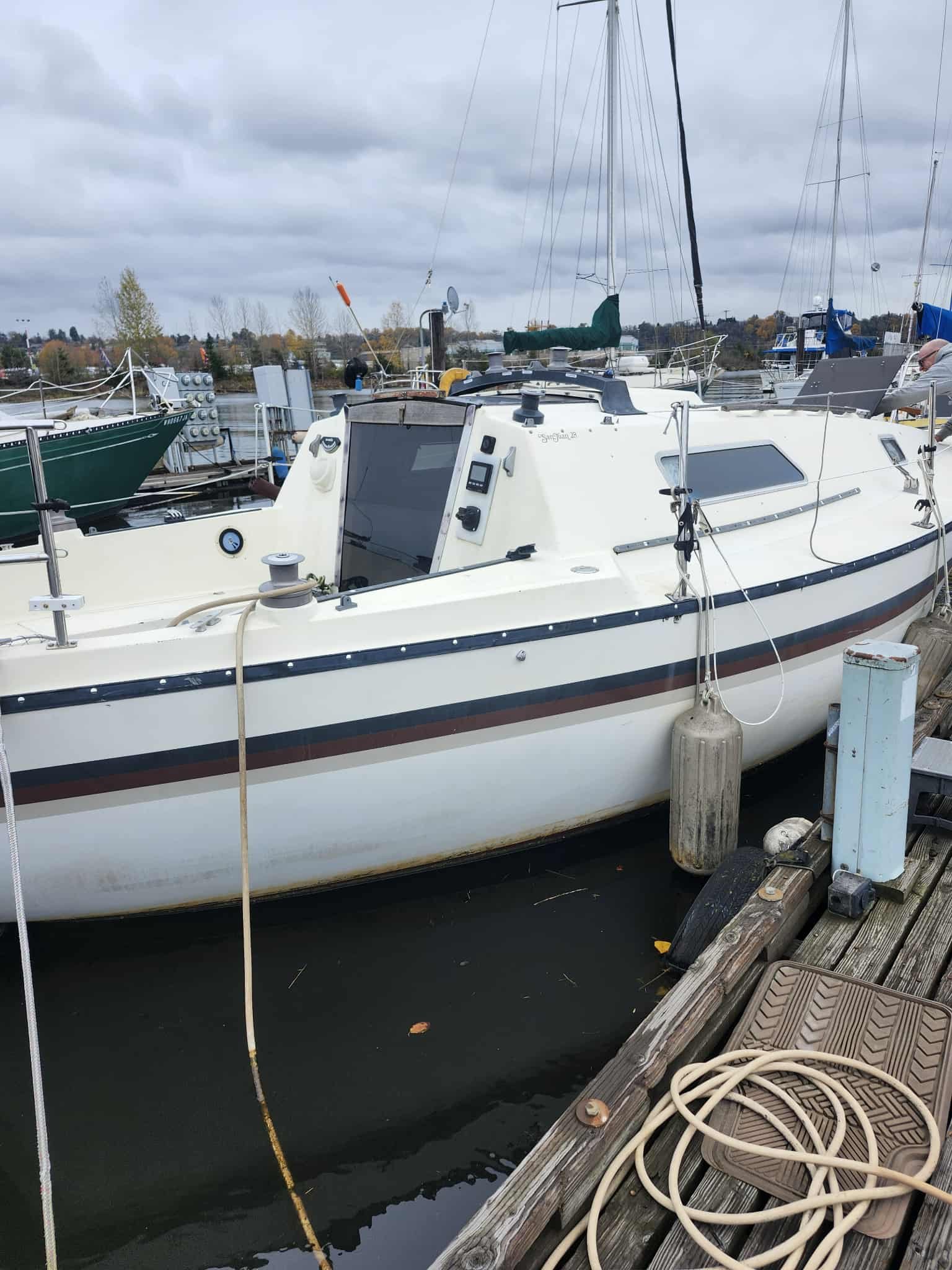

the distraction is very exciting for me as it’s my first real boat and it will be taking a lot of my time and money for the next bit and I hope to still have the time energy and money to keep these builds going because they are bringing me much joy. But to have my own sail boat (San Juan 28) that is a dream and to have someone show me the way as we put it all back together is something I definitely do not want to pass up. You can say I’m in over my head all you want but this is exactly what I want my life to be right now

Photo arrangement
Andrew, now that is a nice full scale sailing model.
