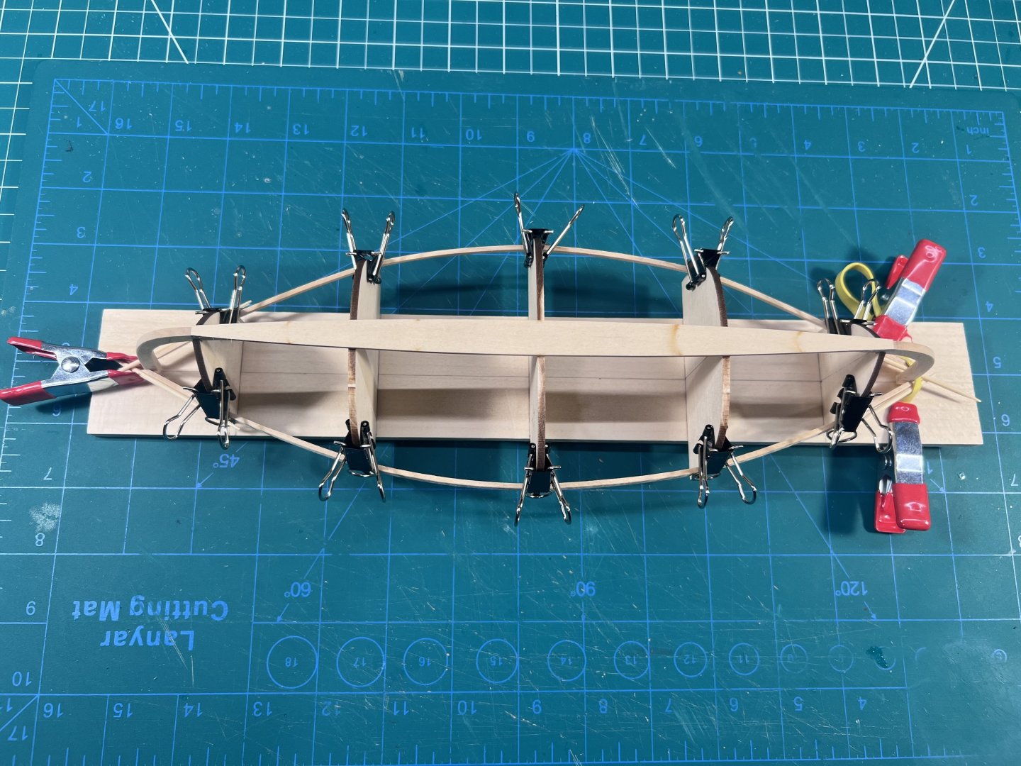

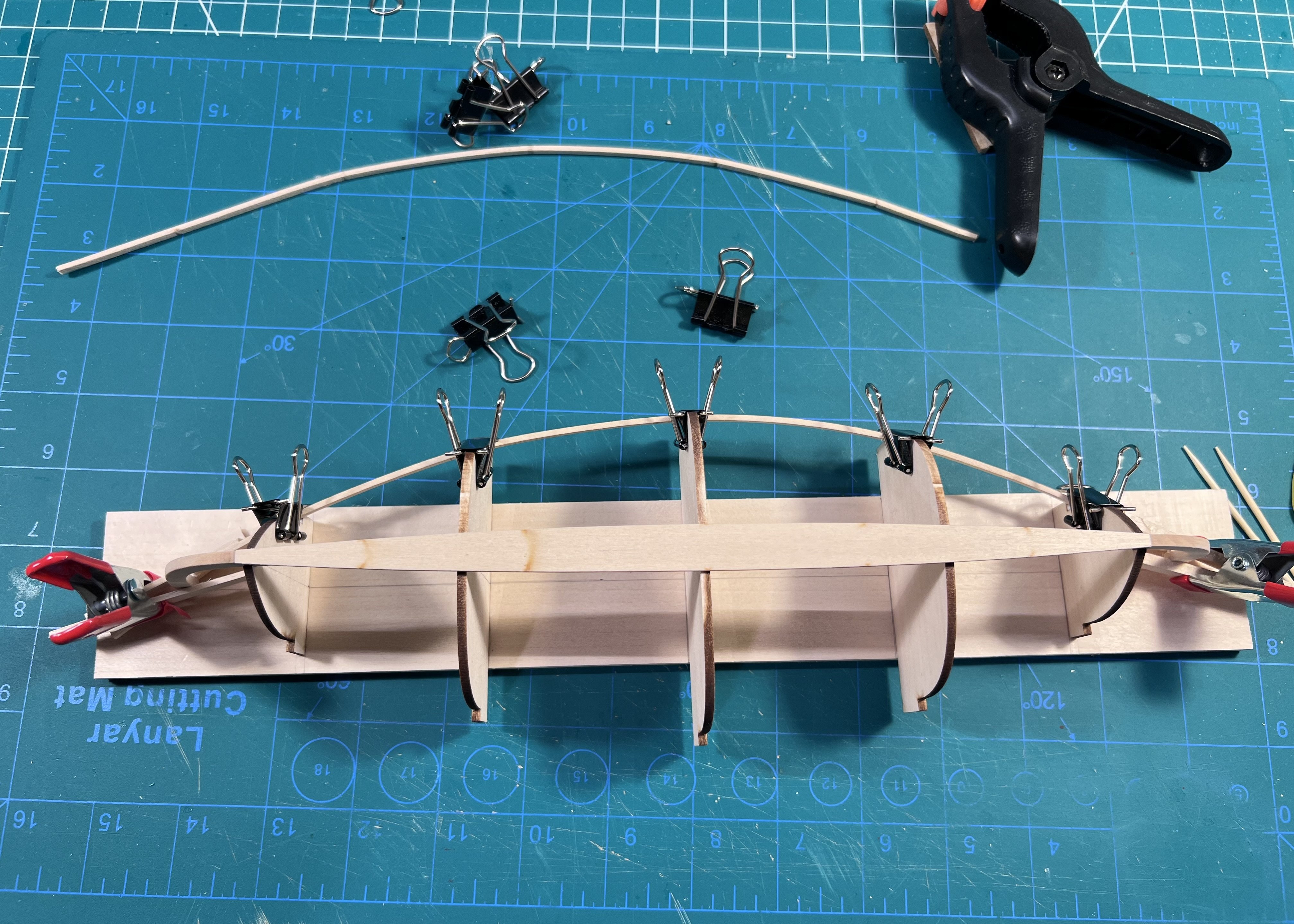

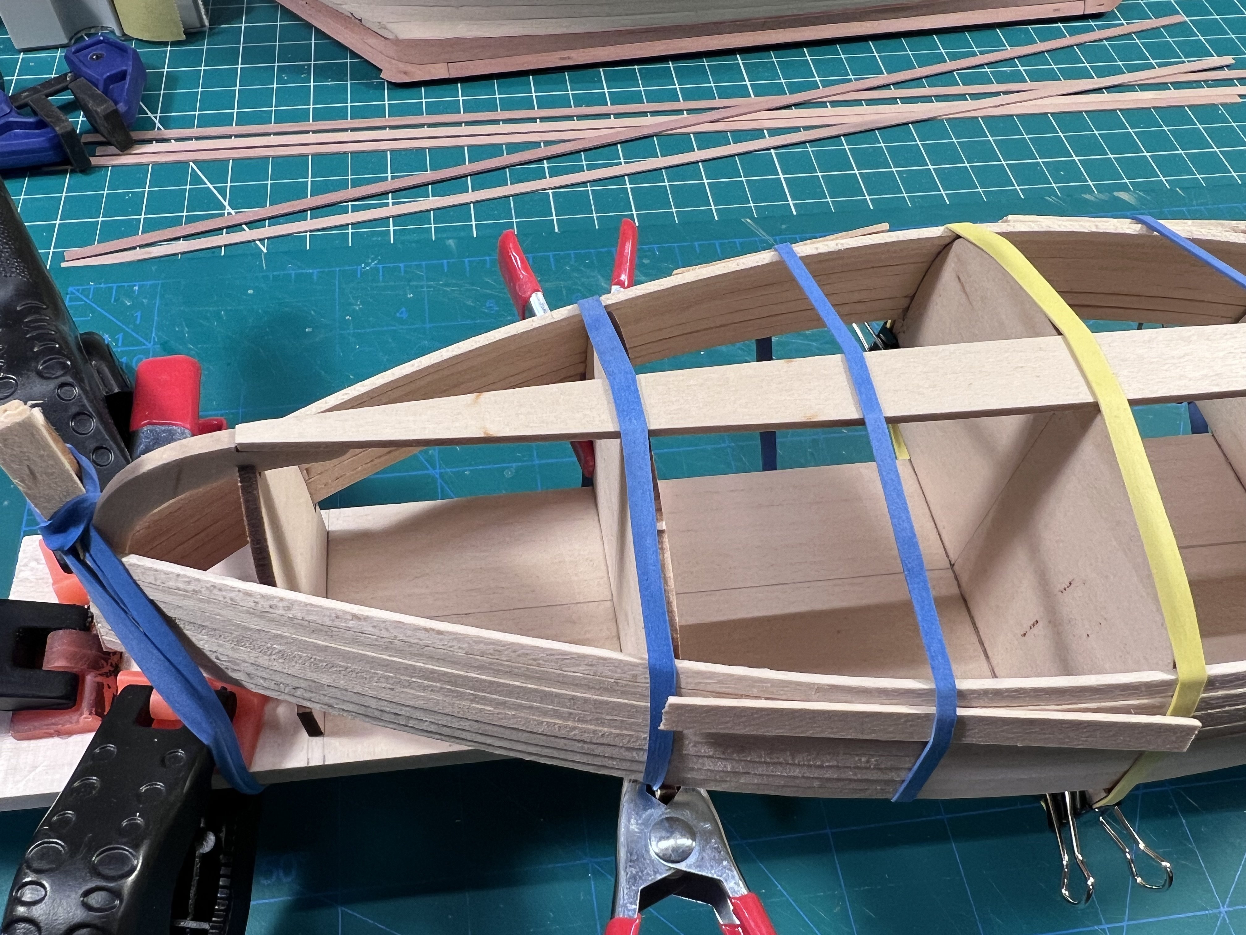

This is probably going to be a plank a day kind of model. That’s fine since I’m doing this one as filler while waiting for parts of other models to dry. I soaked the planks in hot water. I’ll leave them to bend overnight. After I get this first plank glued into place I might soak and bend a few planks on each side.
I’m going to have to figure out better ways of clamping the ends in place - a problem I haven’t solved satisfactorily with other models.

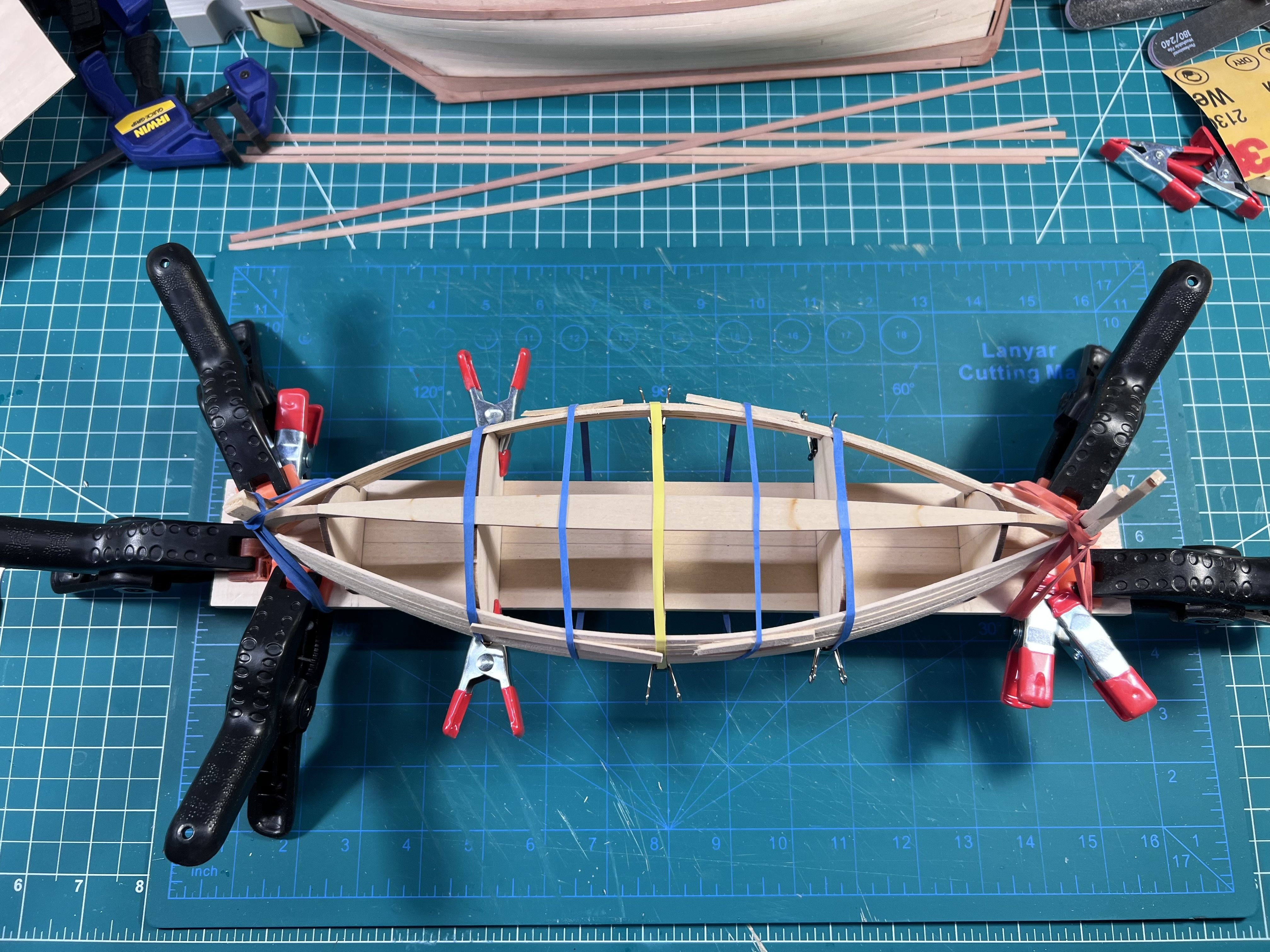

One tricky thing with this model with all the thin planks is that I realized the planks were starting to separate from the build frame (separate in that a gap started forming). I wet down the planks and tightened them down with rubber bands to bend them in a bit. For future planks I’m going to add more of a bevel to the bottom frames than I have so far.

I end up doing a lot of slight repositioning of planks while adding various clamps - and can only glue to the plank edges - so I think superglue would be a real mess in my hands (literally and figuratively).

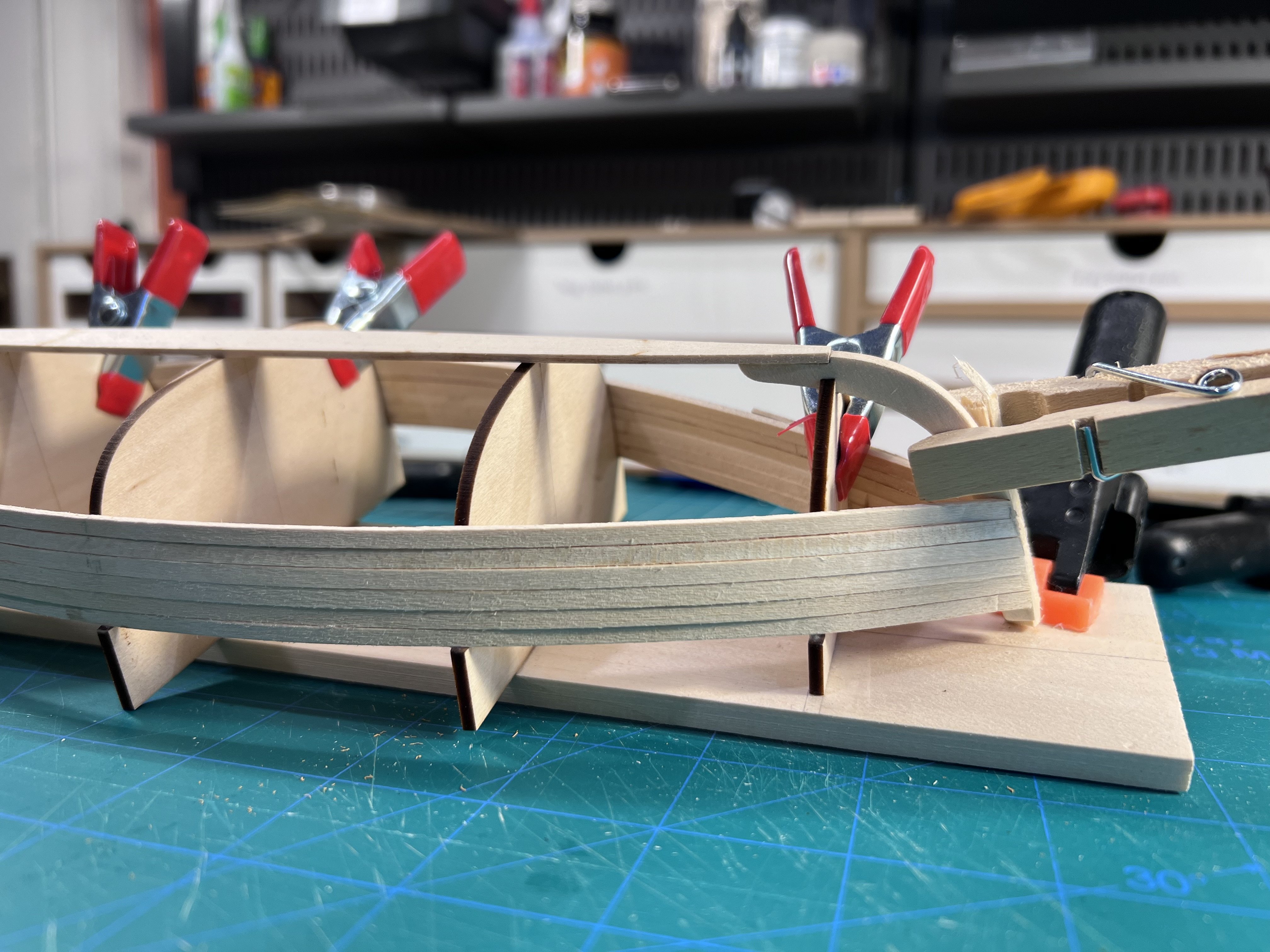

I’m struggling a bit to make that turn. I shaped the bottom of the planks a bit at an angle, which helps. I clamp to keep the hull following the shape of the build structure and clamp to try to avoid too much clinker effect. I’m hoping it won’t be too much that a sanding can’t smooth out. We’ll see.

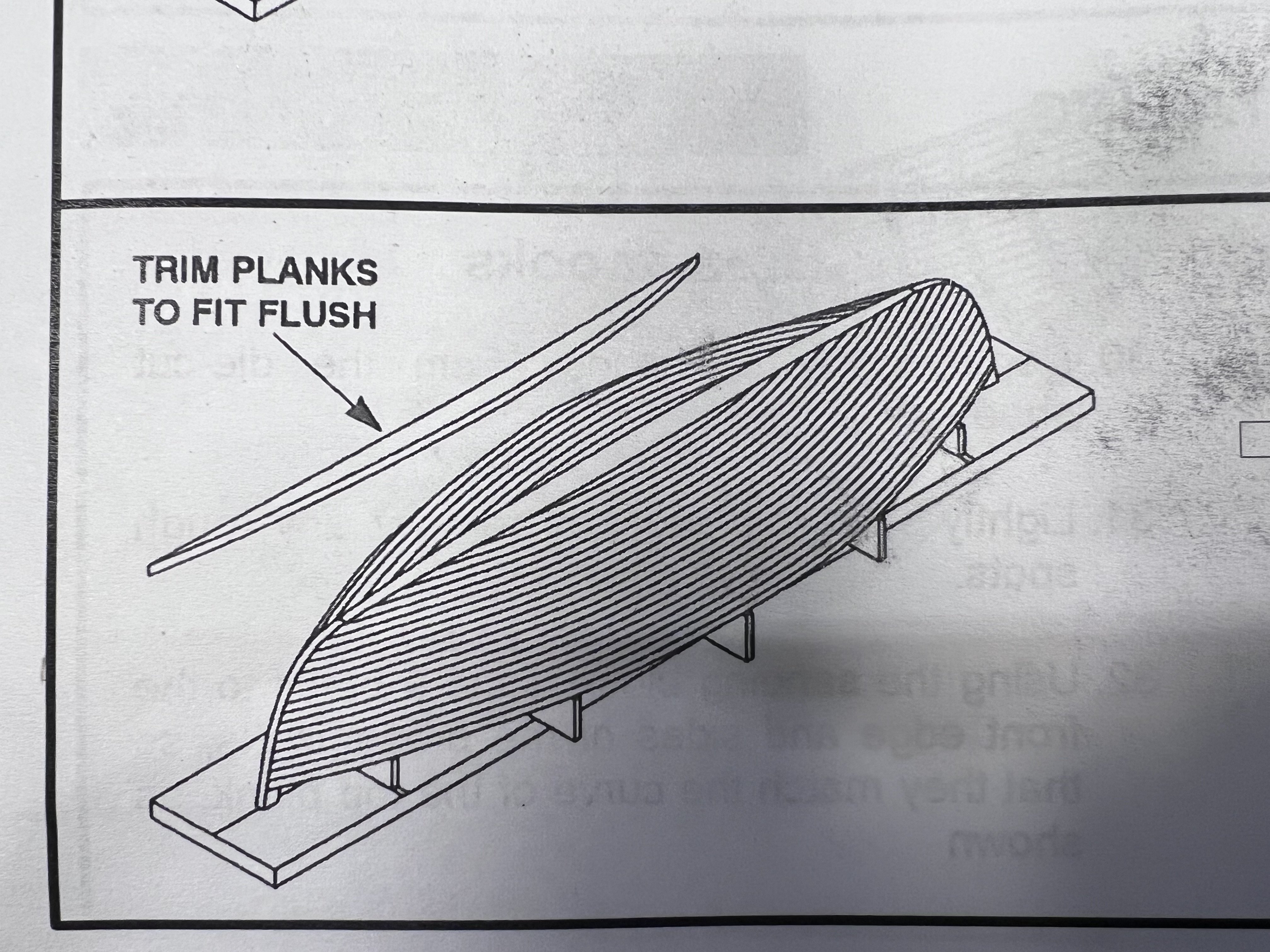

I have no idea how I’ll clamp when I get closer to the bottom board. The kind of just says “add planks” with no pointers. I’m astounded people could build these before the age of the internet. Maybe that’s why there were probably more model clubs back then. Our “clubs” now are virtual.
Tricky though it may be, it looks like you're doing a good job of it! I think I used wedges made from scrap, rubber bands, and bobby pins to hold things in place toward the end.

I read through your log again and I may have overlooked whether you beveled each plank as you added them.
Like you, I soaked the plank and clamped it in place overnight. I left them a bit long so I could cut to size.
Keep in mind that my method here is  based on upside down hull. So top and bottom is relative to that position. The top of the previously installed plank is left untouched. After next plank dried I put a slight bevel on the bottom edge of the next plank. It was just enough to allow the plank to fit flush on the lower plank and to the frame. I think that helps avoid the clinker effect.
I also beveled the planks on each end a bit to fit to stem posts.  I was careful to mark stern and bow on each plank since they were 'custom fit.'  Finally, I beveled the backside (closest to the bulkheads) of each plank (as you did) to fit to the posts.  Entry #6 of my build has some pictures that may help.
As for gluing the bilge area, I did like you and used a lot of rubber bands. I also put a piece of wood under the building base to keep the rubber bands tight to the form. It is a tedious job to shape those planks to size. My results weren't pretty. I had to cut some filler pieces. From the beginning as I put the planks on I knew I'd be doing a lot of filling and sanding. (No matter how new the blade on my knife, I couldn't keep the cuts neat.) Entry 15 of my build log shows the ugly details. (However, filler and sanding made it look better.)

I did bevel both ends on the stem posts and beveled the bottom of each plank to get the angle to follow the shape of the building frame - far more of a bevel as I've worked up (technically down) the hull.

I think that when I used bobby pins and rubber bands on my build, I pushed the pins all the way down against the bulkhead/former, so that the pressure on the rubber band forced the plank to twist and hold flat to the former. It was tricky, though.
Right. I’m just trying to shape them a bit now. I fiddle with them a lot more when I’m gluing them in position. When gluing, I’ve only done one side at a time. I’m at a pace of about a few planks a week. This is definitely a filler model.
