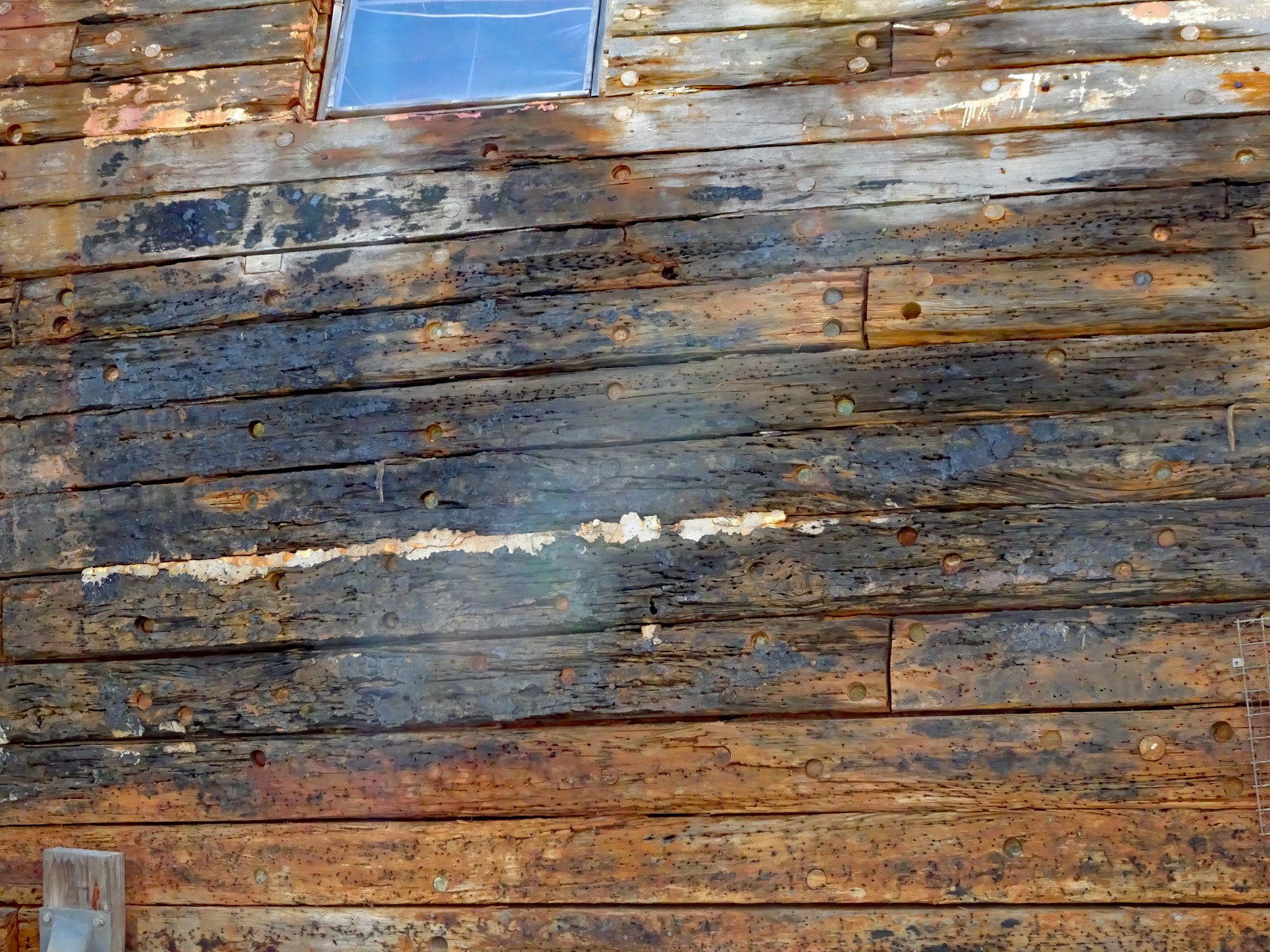

Sorry I'm late to this thread. I thought this photo might be of interest. Part of the hull of the 1864 barque 'City of Adelaide' undergoing preservation at Port Adelaide in South Australia. She doesn't have treenails, rather plugs over bolts as the planks are bolted to the iron frames. Some of the plugs have dropped out, but many remain in place, so I thought it interesting, nevertheless.

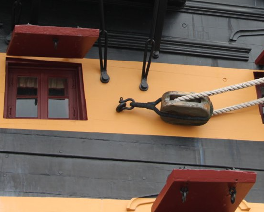

I cannot see any of treenails on today's Victory hull on this photo. Looks more like some nails heads. I can see some on the other pics. None would be seen under the paint and at 1:96 scale.

I always would like to warn to take the museum ship/reconstruction in Portsmouth as a reference.
Actually that was the hardest learning for me to ignore this wonderful exhibit on my trip down Victory roads 🙂
Not moaning or beefing around at all those people that were and still are keeping her alive untill today, but for ressources and other reasons it is far off being a reference. It is a wonderful inspiration, it really is, but not more.
