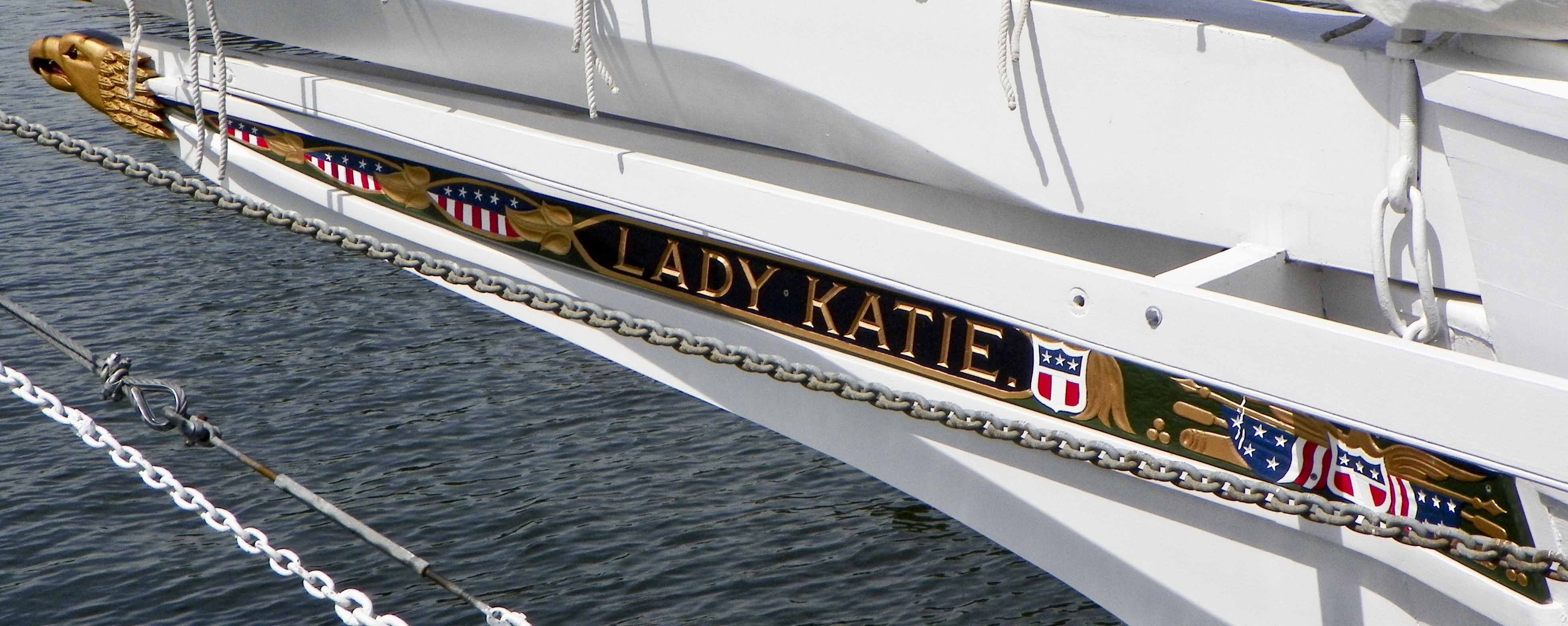

I'm with @catopower: Trailboards and the like were typically carved wood, with master carvers either part of a yard's workforce or else moving from yard to yard as each had a vessel nearing completion and ready for her fancy work.
When in service, the carvings would typically be picked out in white, yellow, gold (paint) or even gold leaf for fancier vessels. (Gold leaf was still common for the lettering of names on yachts into the 1960s.) I'm not sure why they still show as pale in photos of derelicts. That might just be the angle of the light or could the carving be in a different kind of wood from the surface it was fastened to?
Trevor
At least on Chesapeake Bay boats the Trailboard was in two pieces, as one piece was mounted on the hull and the other then angled out from it to the bowsprit. The joint was angled so the board met seamlessly between the two parts. This also accounts for the upward curve of this section.
As a side note typically the only blue on a boat in this area was on the trailboard, as a background to the stars and name, representing the blue background on the US flag. It was otherwise concidered bad luk to paint any part of the boat blue.
