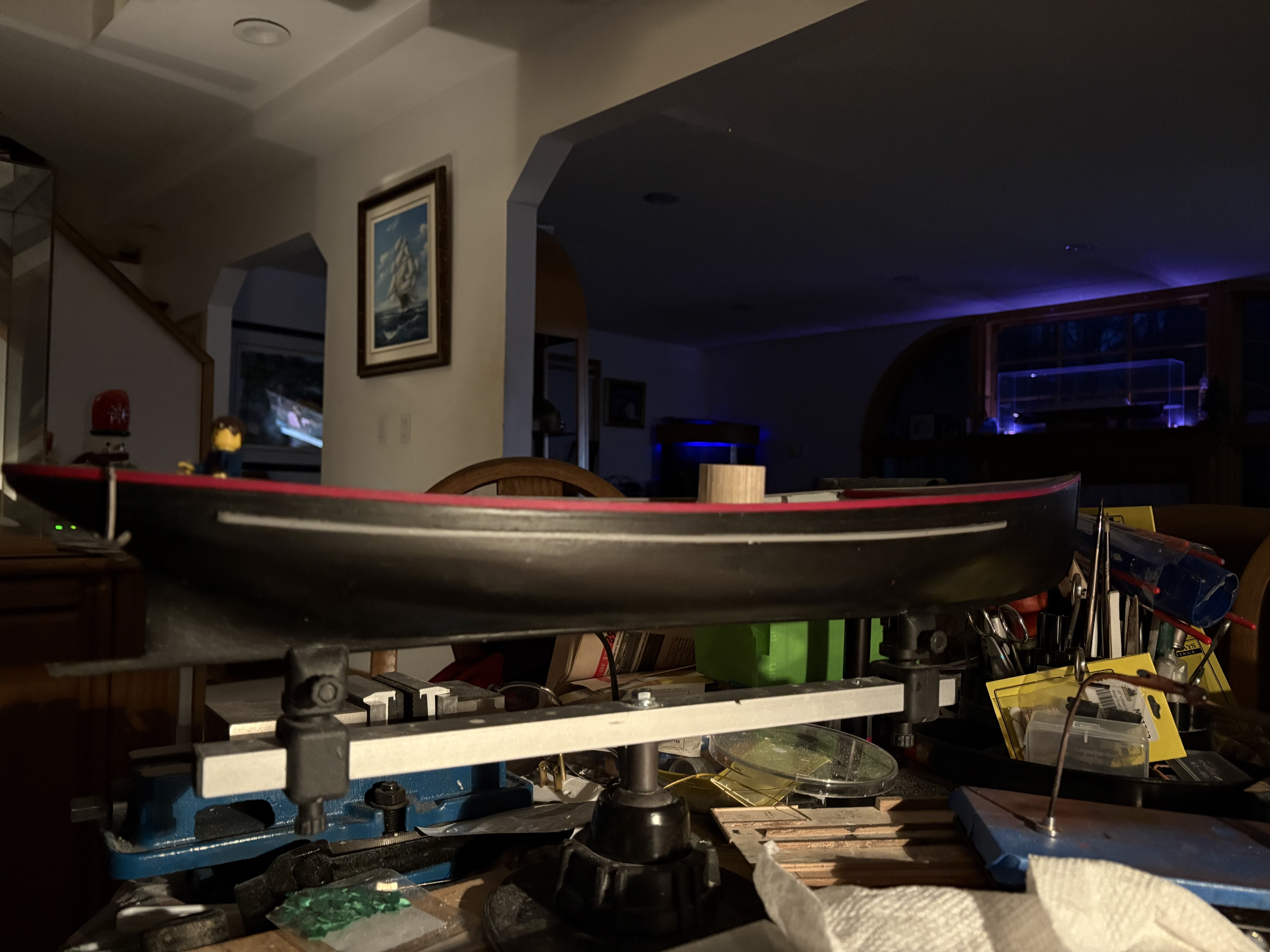

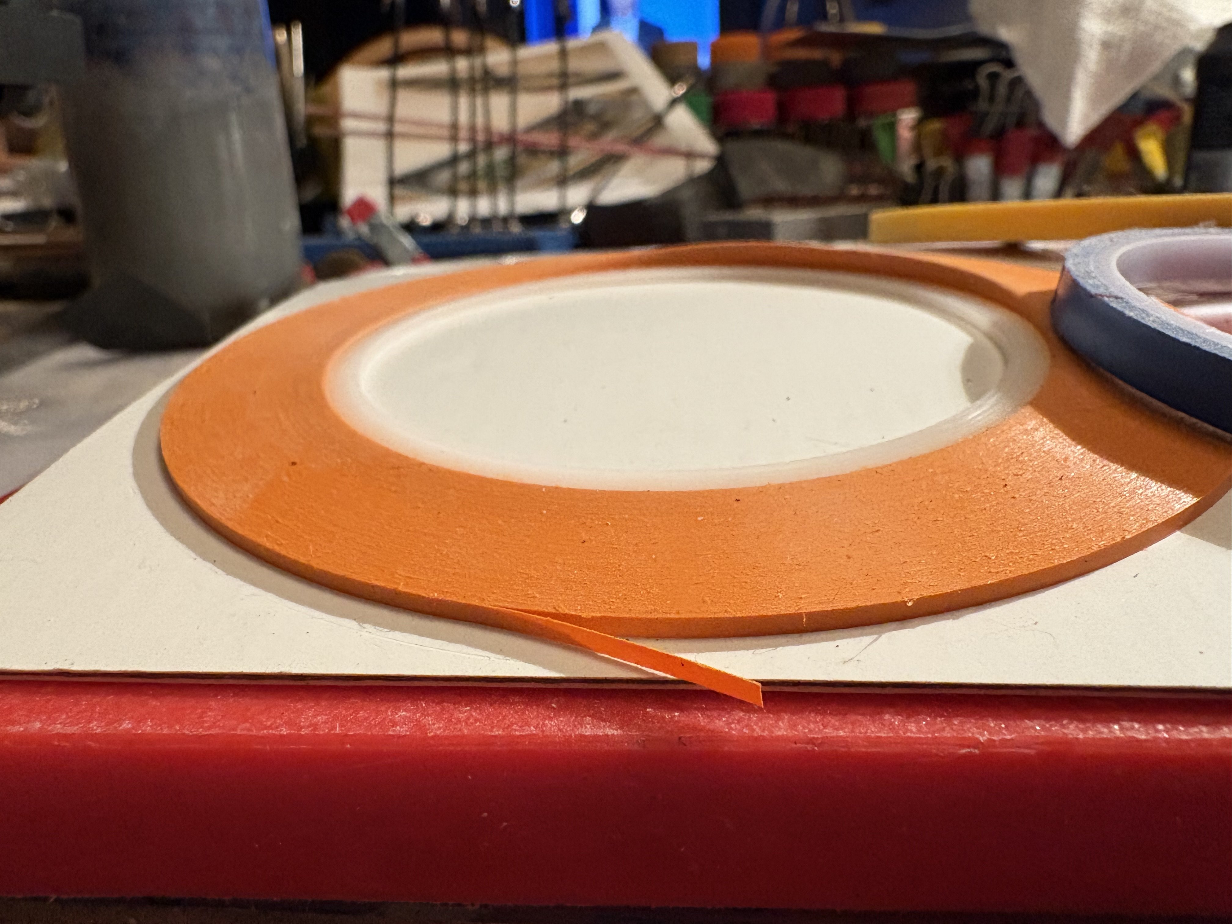

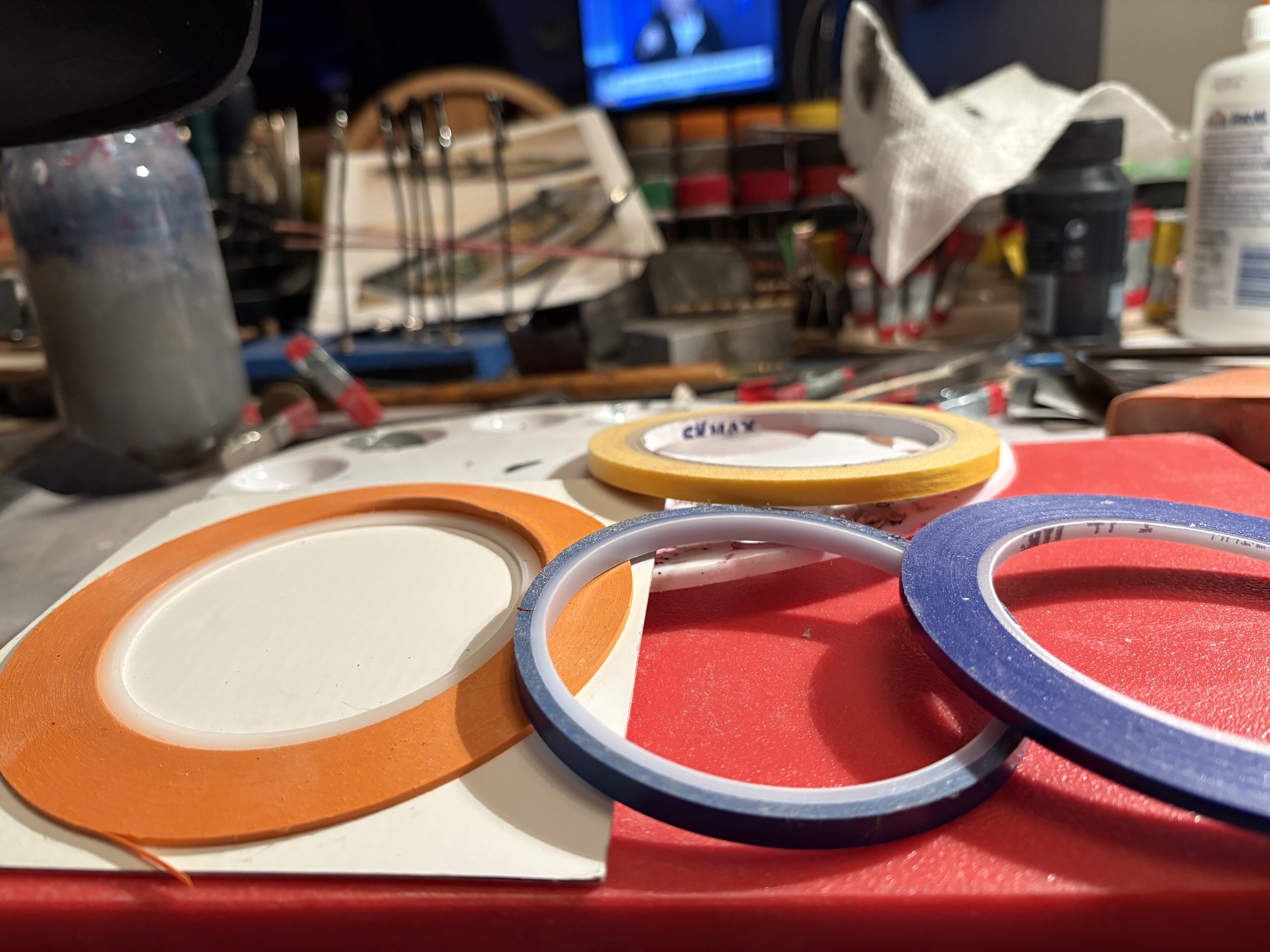

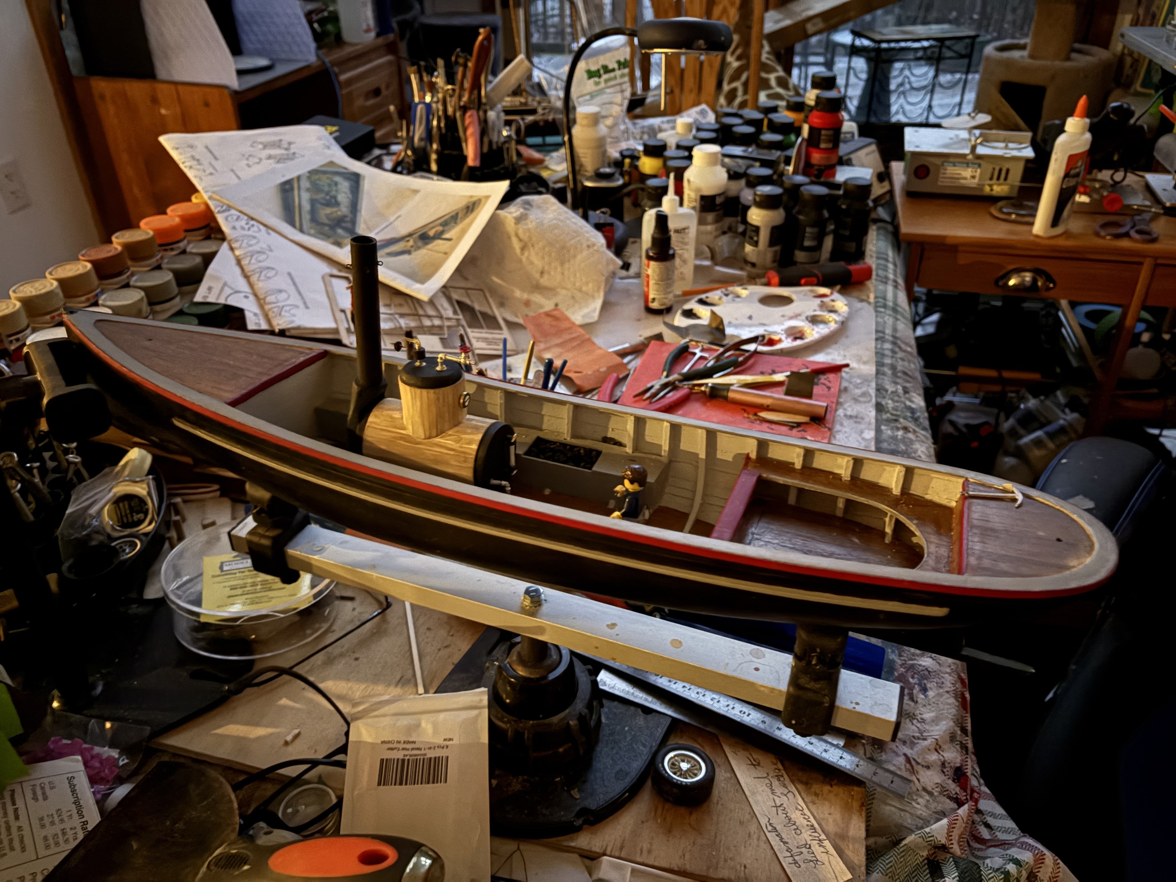

I’m a dentist by profession but I also restore British cars and thru the years I found that pinstripe vinyl tape I use when painting autos works very well in my ship building adventures. The 1/16”  1/8”  and 1/4” are great both for masking and painting water lines. If you first paint down  your water line color, then put the pinstripe vinyl tape down then paint the waterline color over it to seal it, then paint your bottom color over the whole thing when you peal off the pinstripe tape (1/16”or1/8” or 1/4”)  you will have a crisp waterline in the dimensions you need for scale.

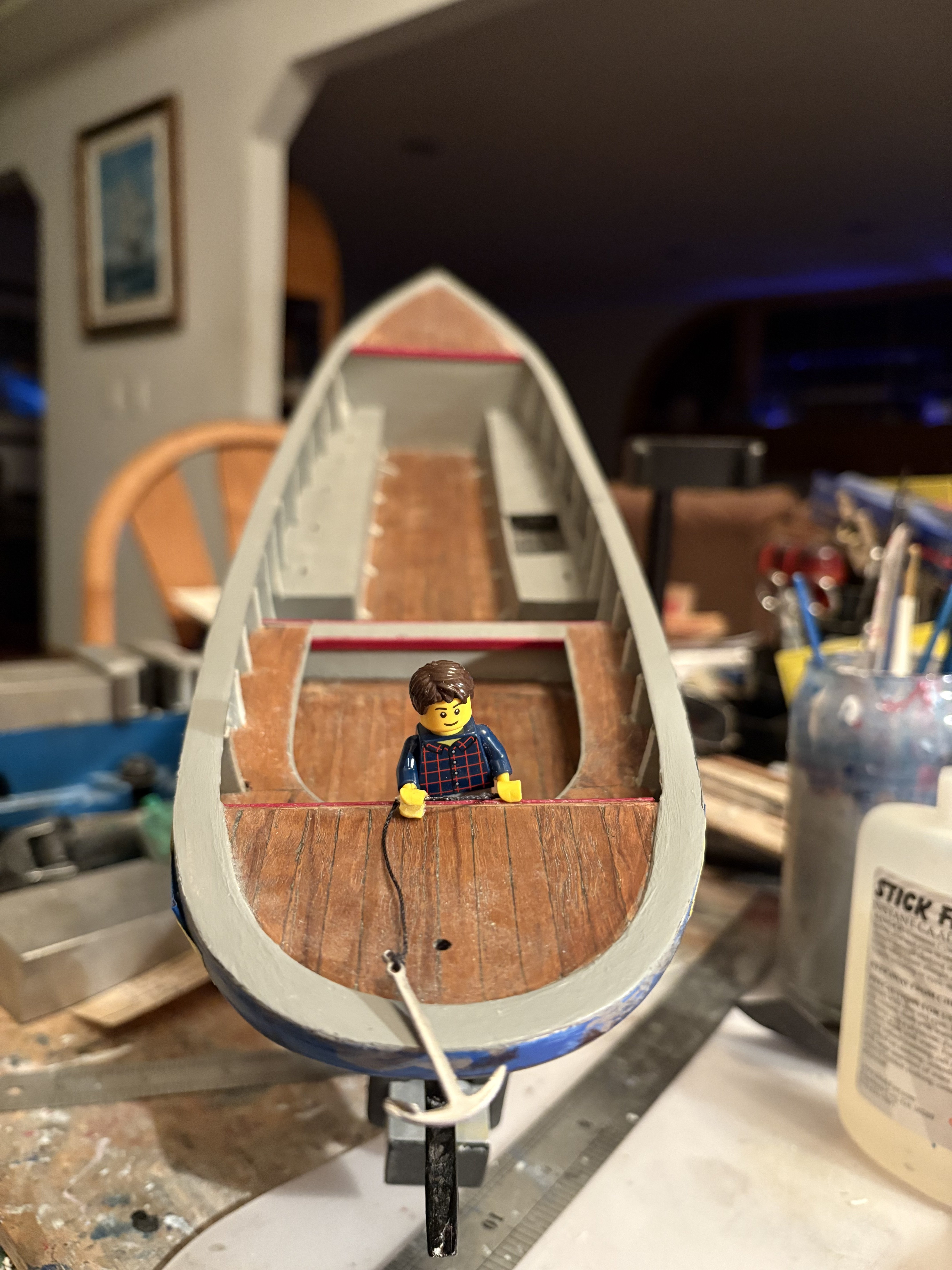

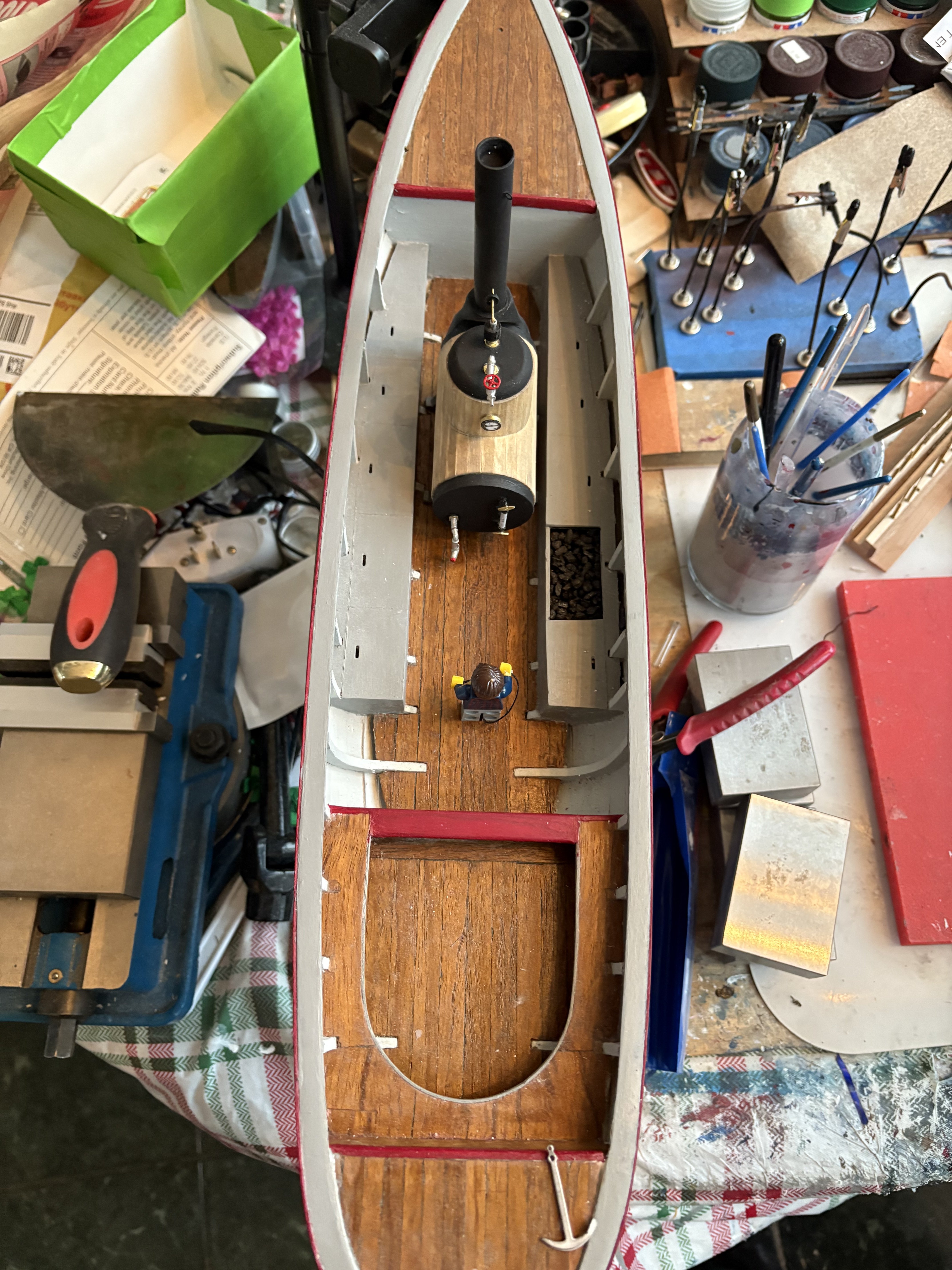

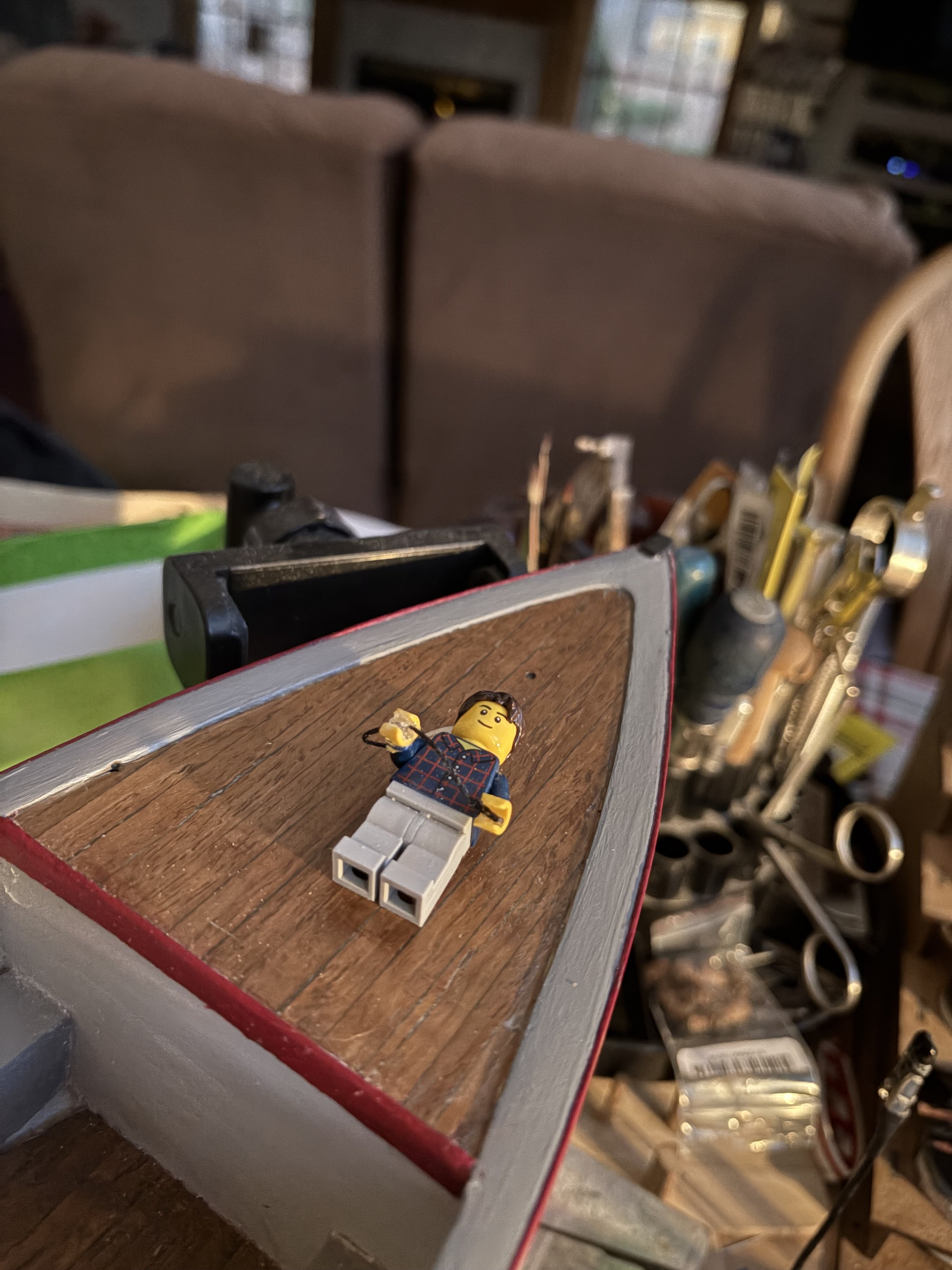

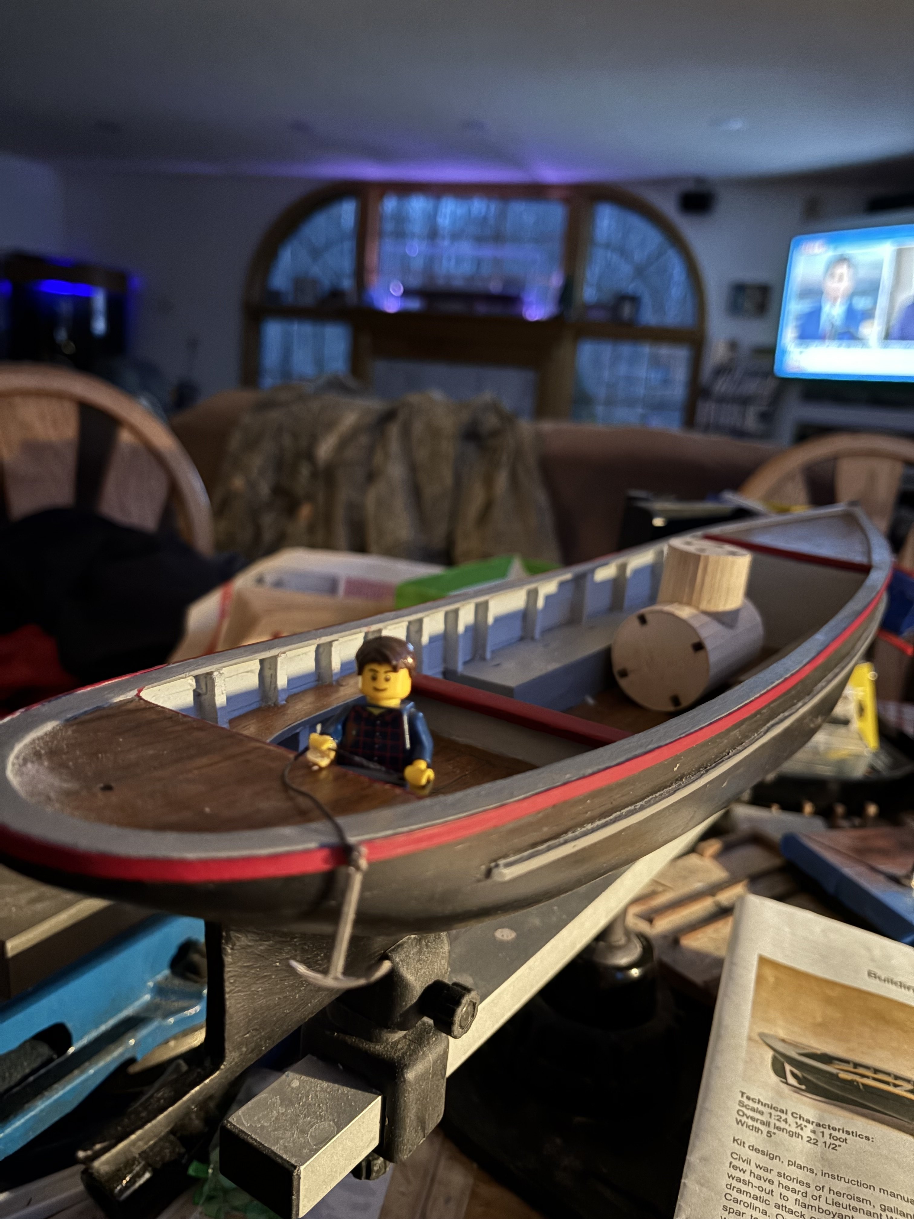

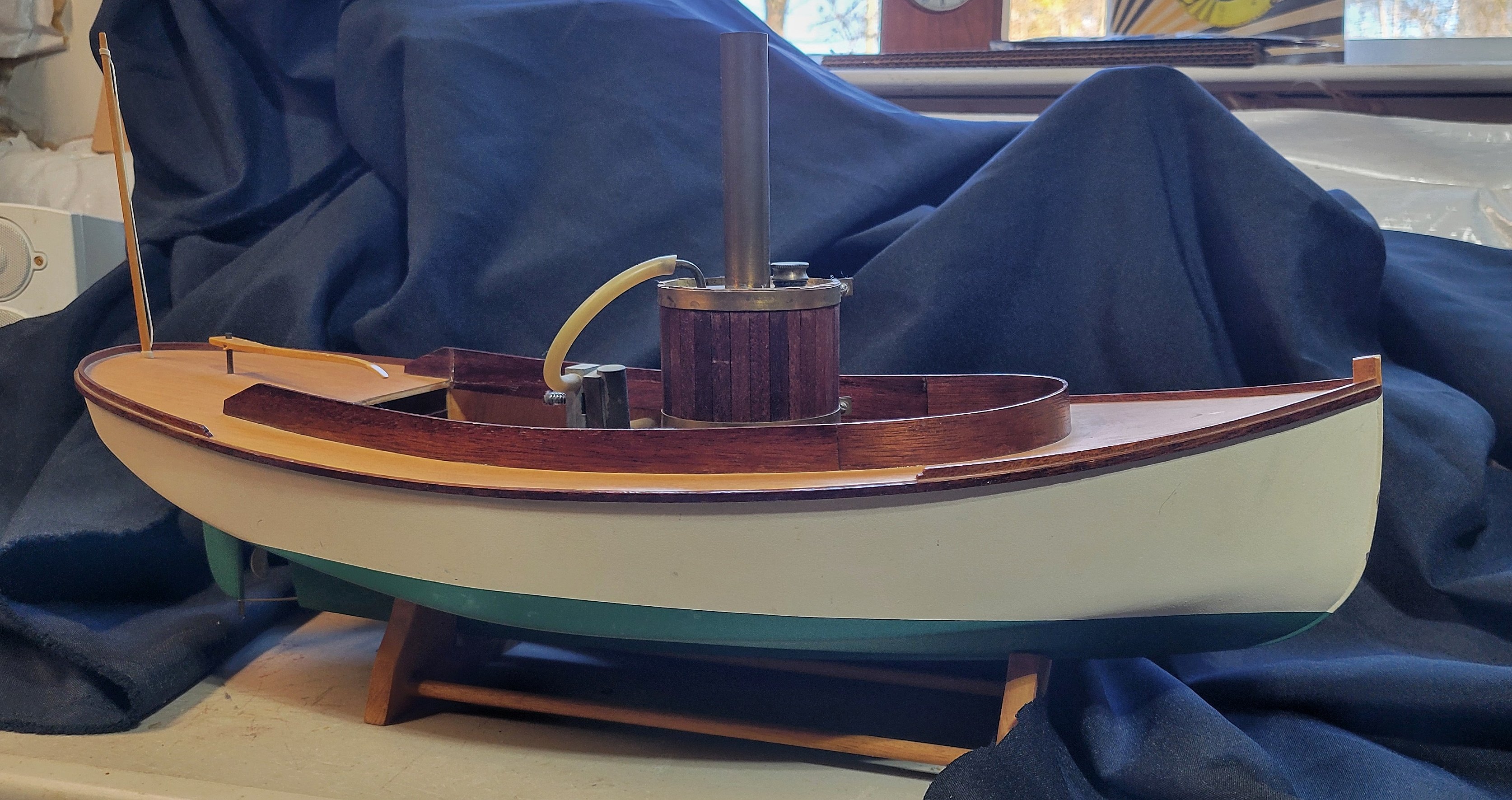

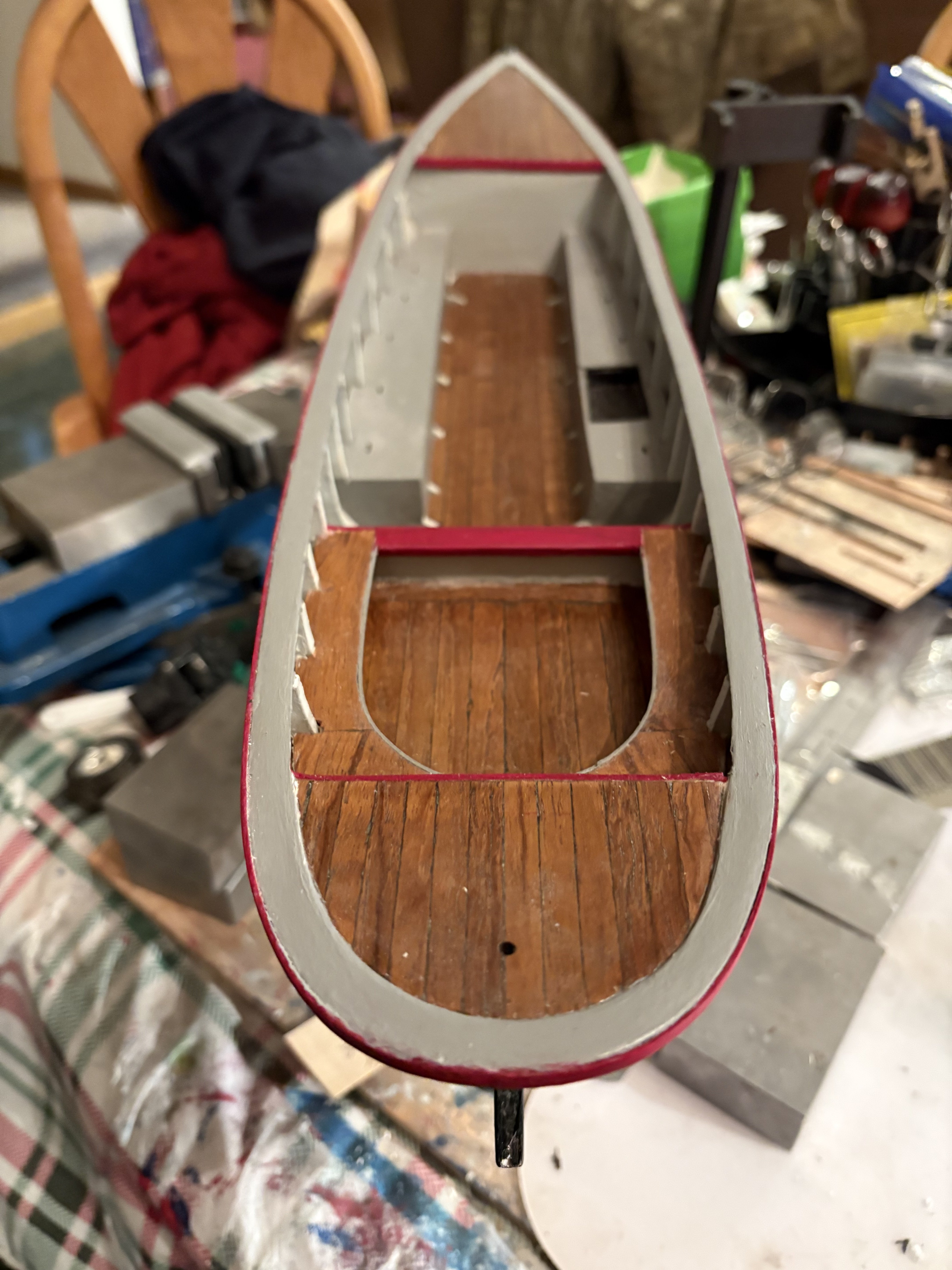

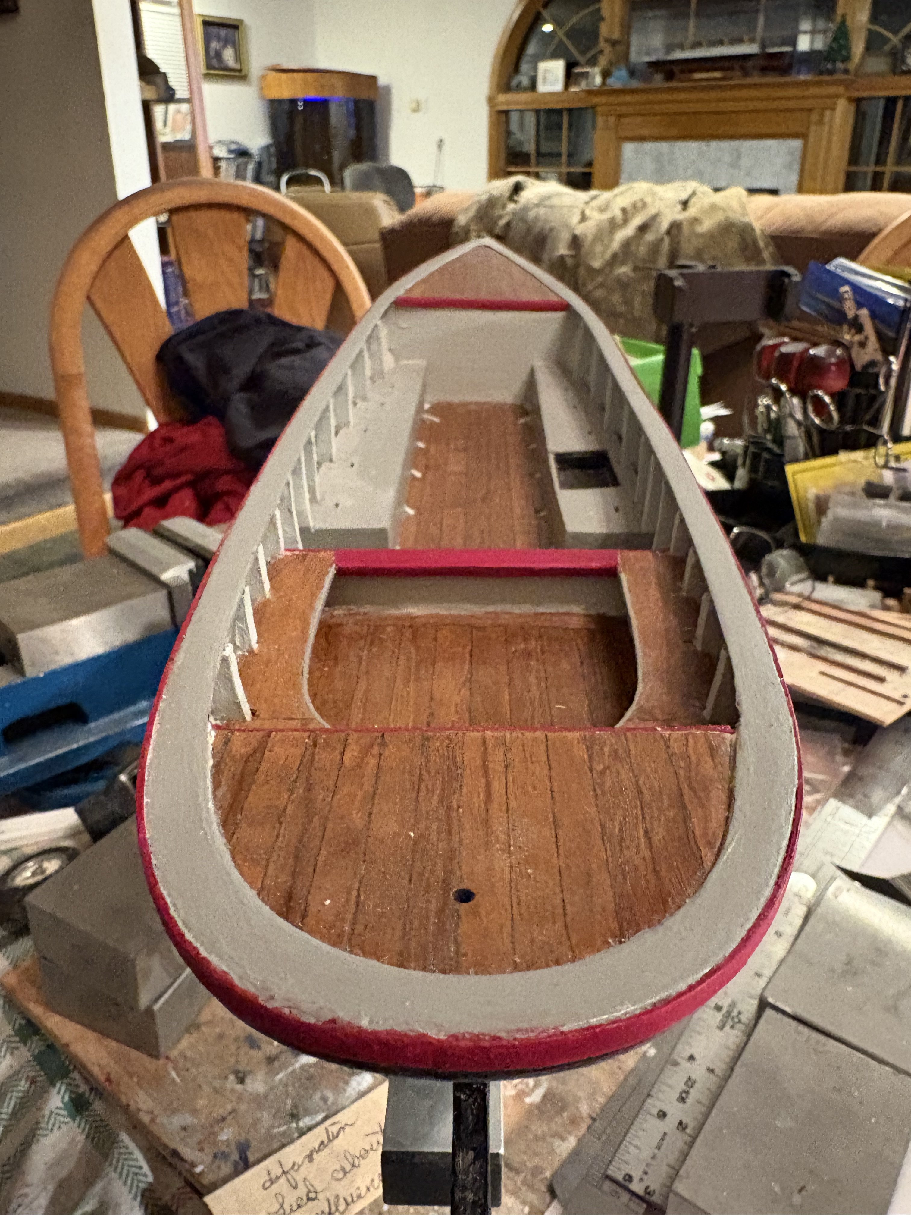

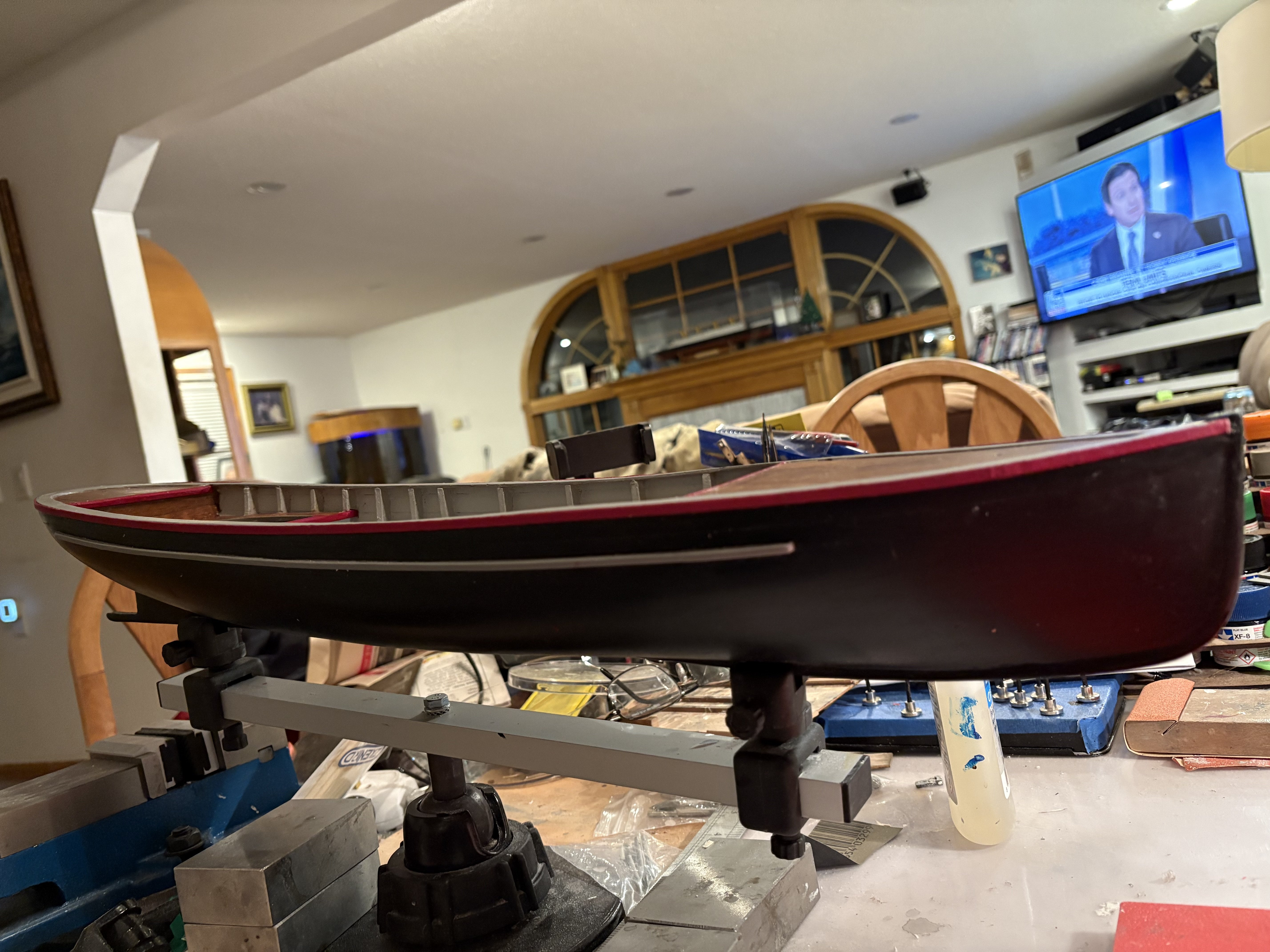

Been a long day at sea. While sailing I installed and painted the top rub rail with Liquitex Basic Acrylic FLUID—Neutral Gray and finished painting interior decor with Liquitex Basic Acrylic FLUID Alizarin Crimson.

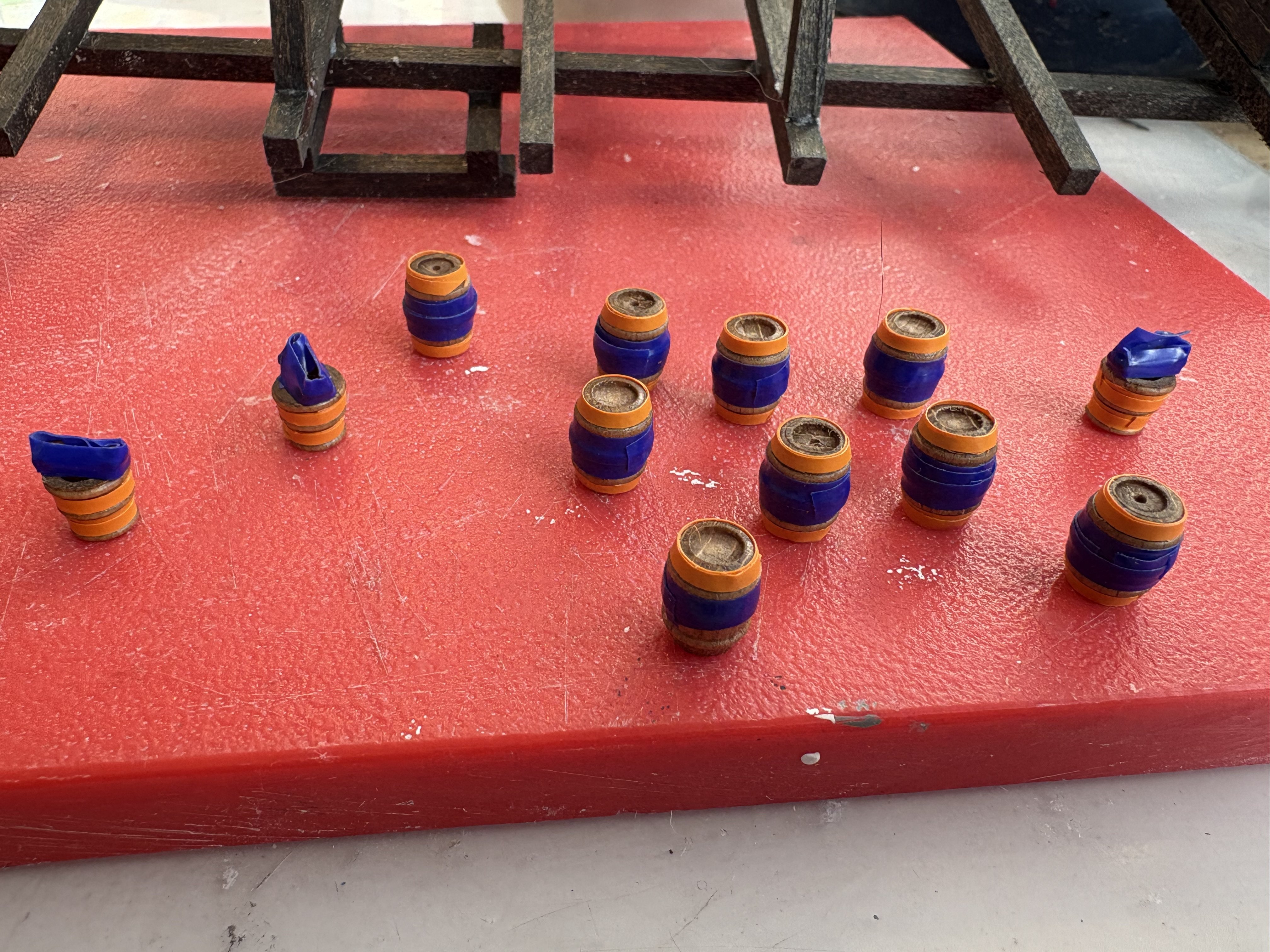

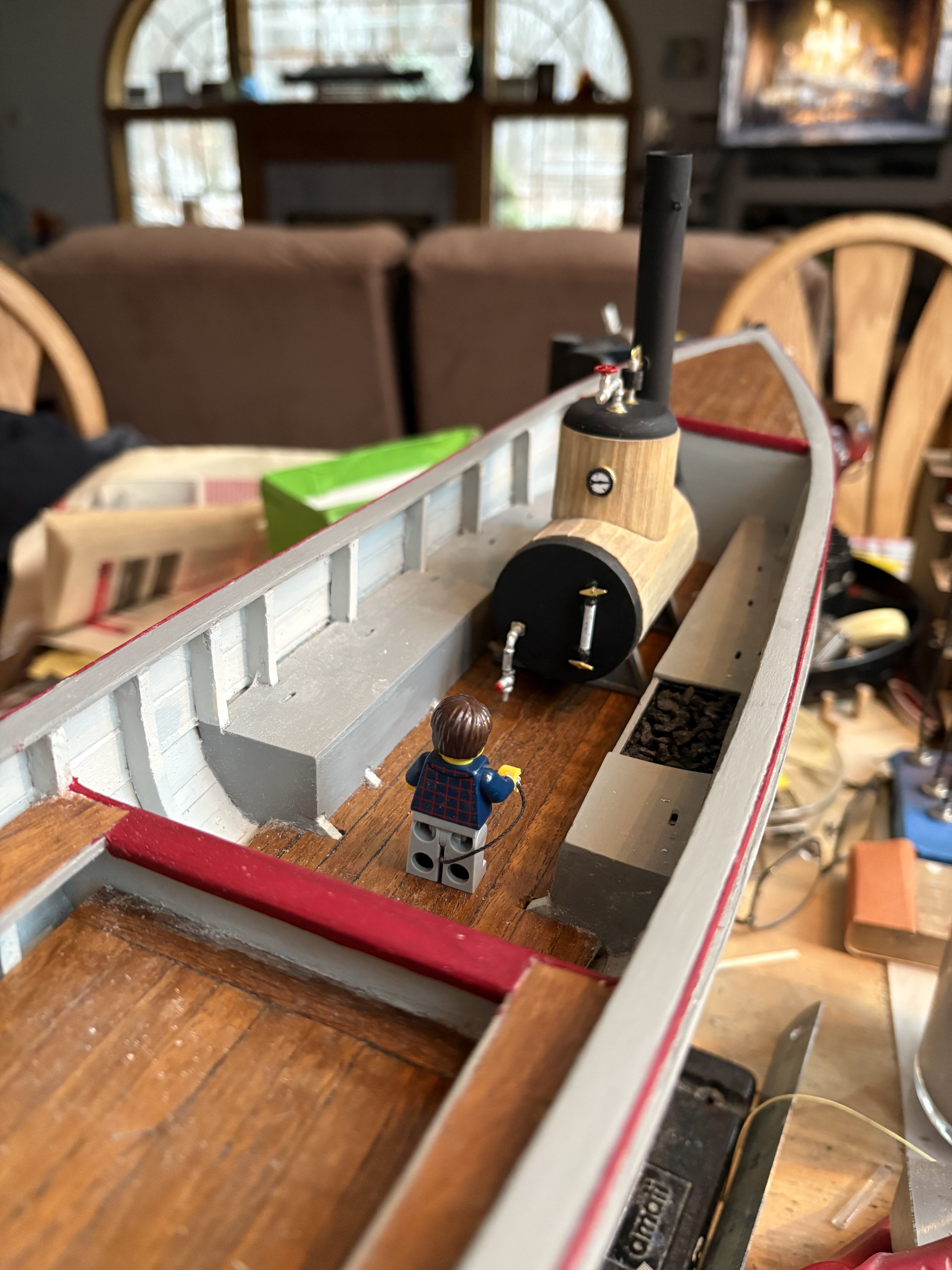

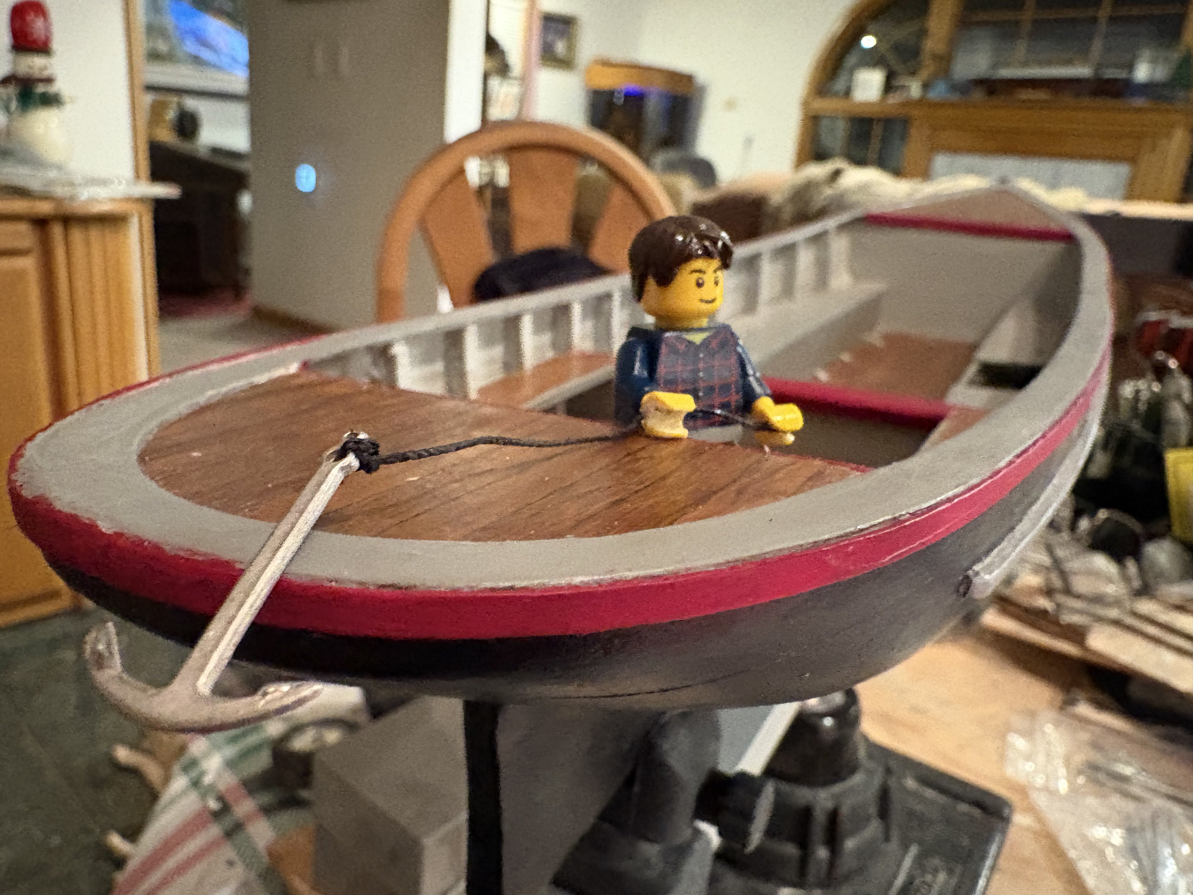

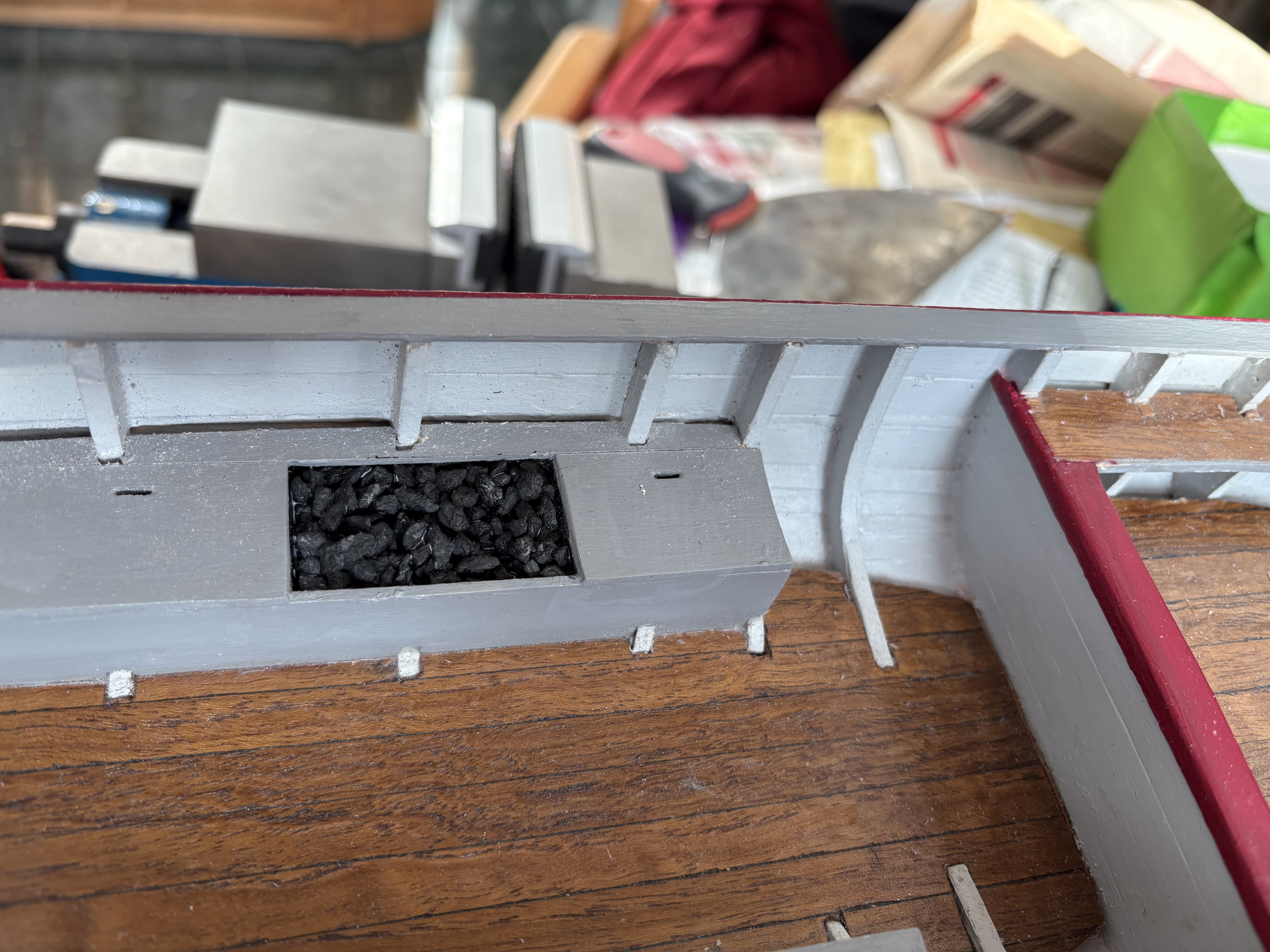

Sun just came up over the horizon and the seas are calm so anchor lifted and setting sail on another workday. Filled the coal bins and airbrushed the coal bin hinges and cleats Liquitex acrylic Fluid Ivory Black to begin my day.

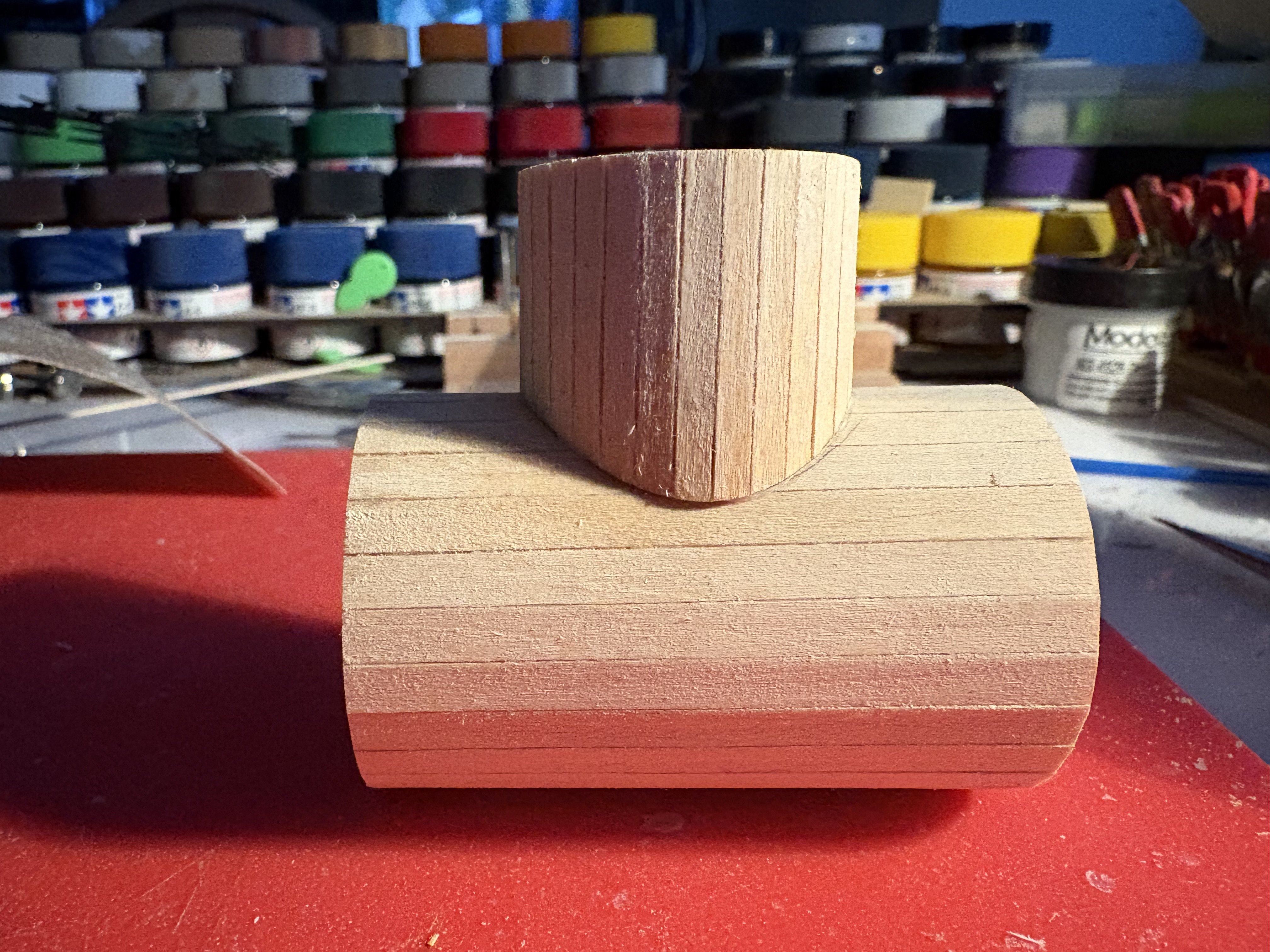

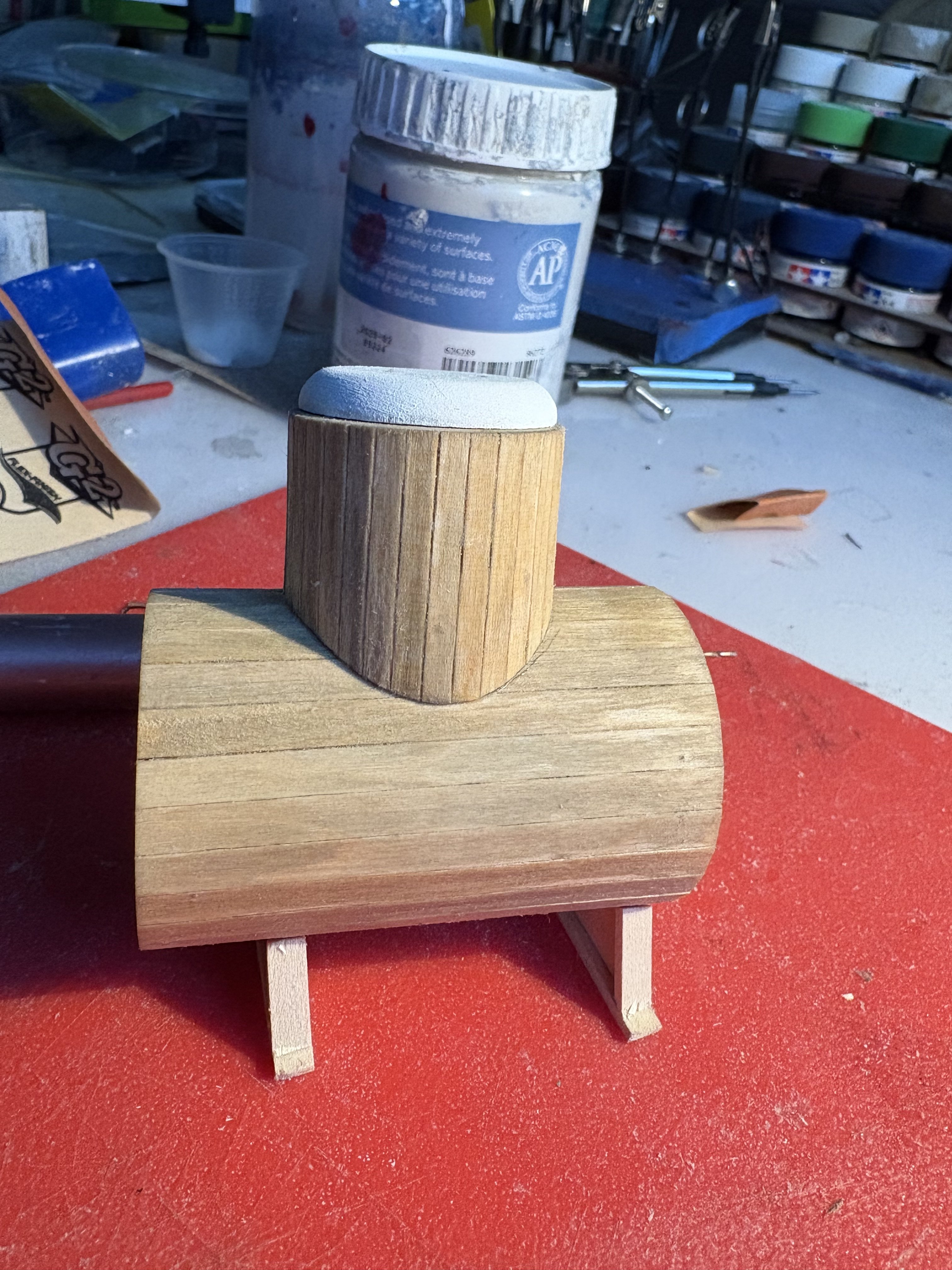

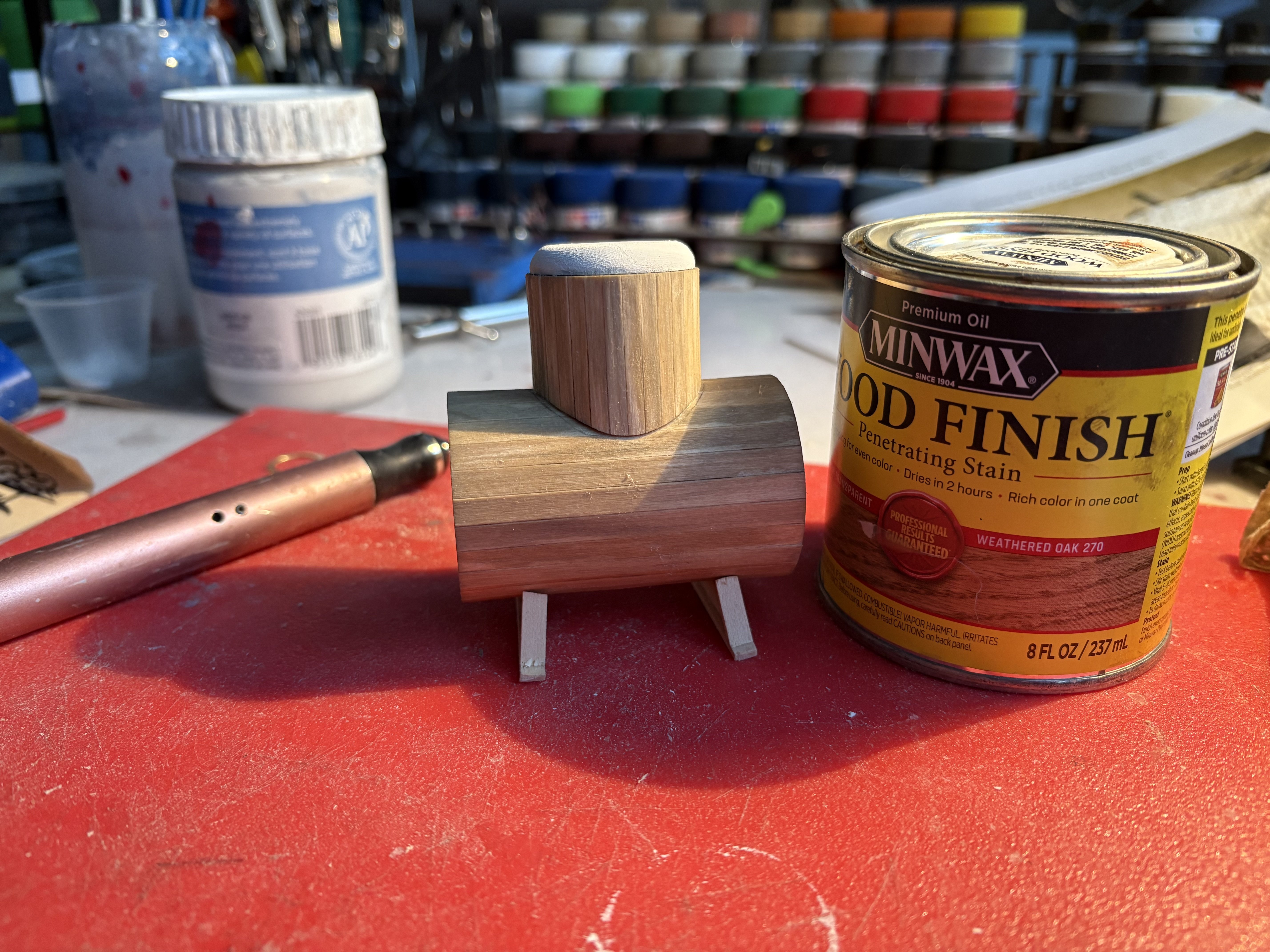

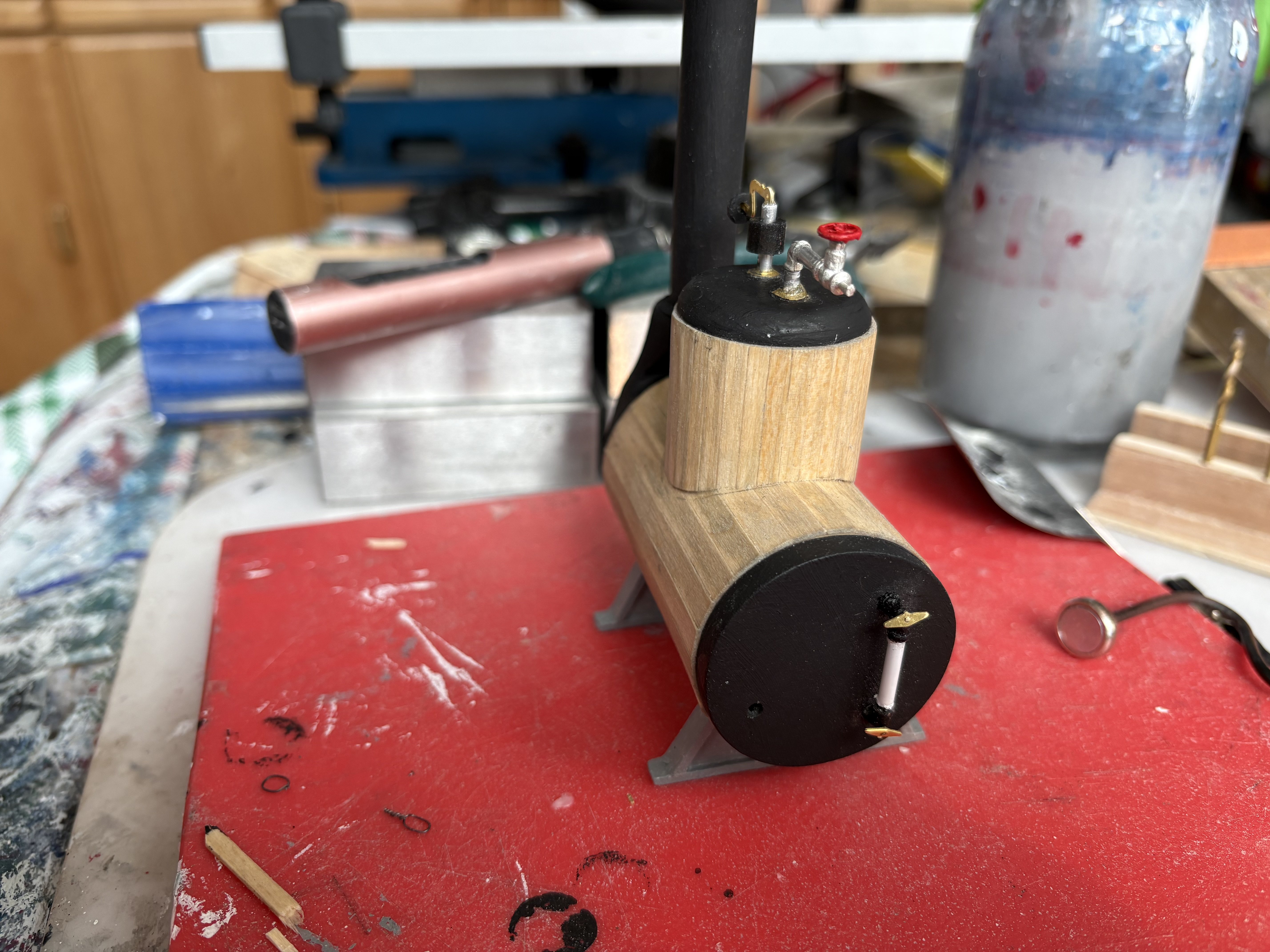

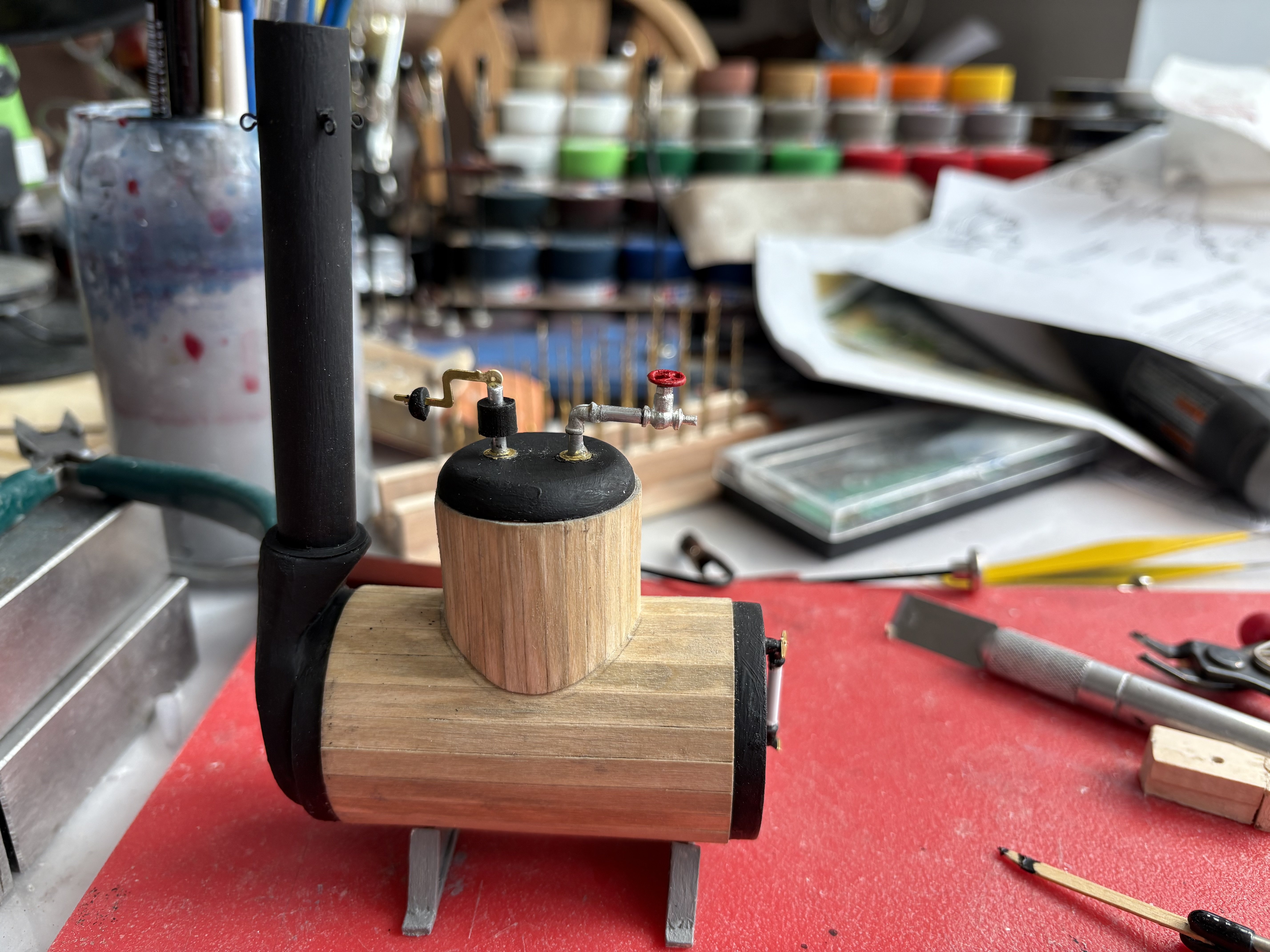

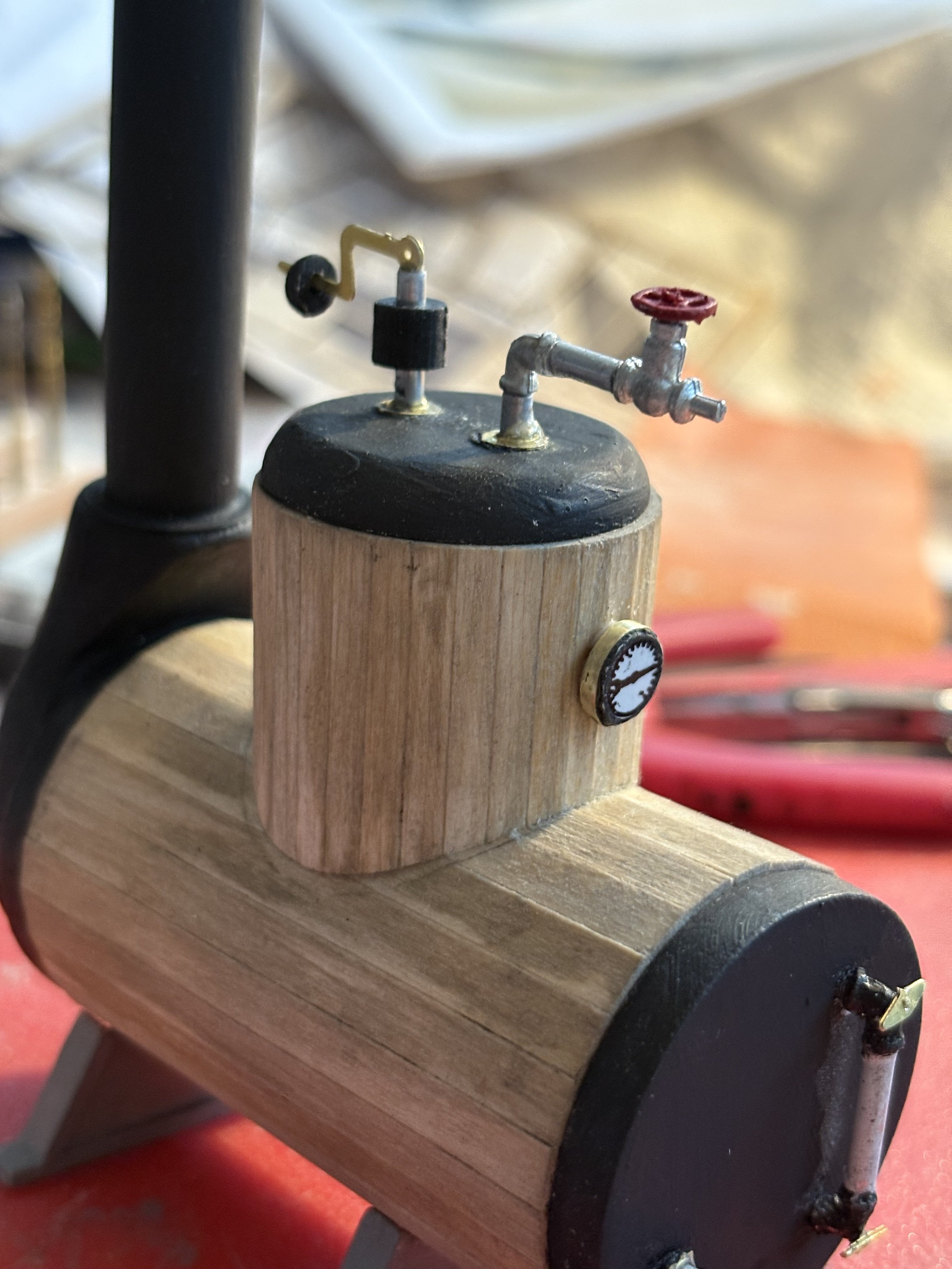

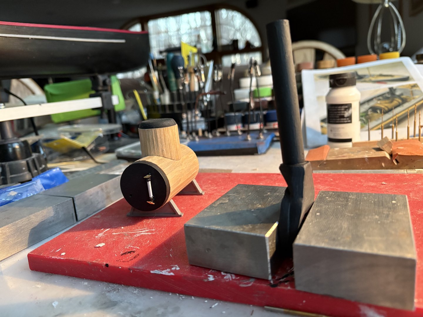

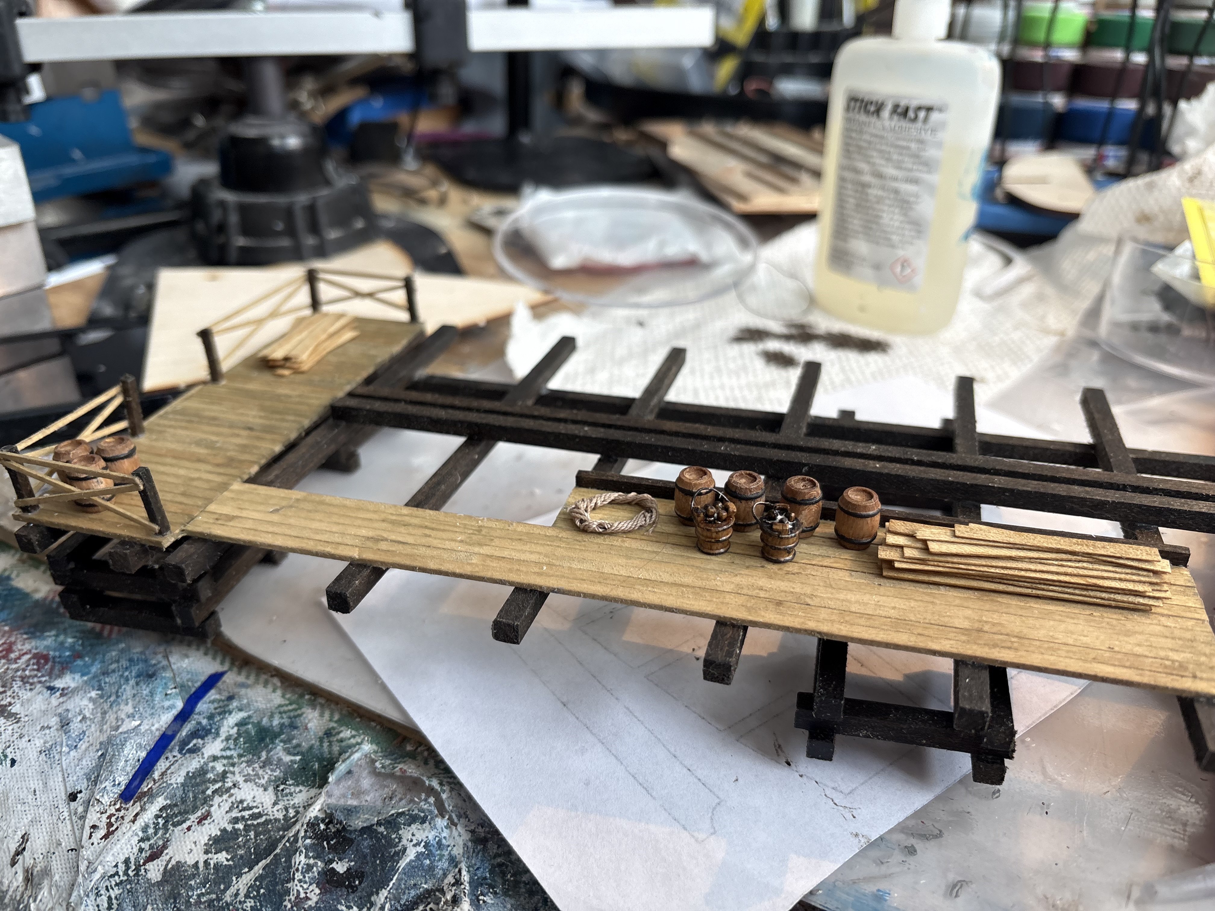

After setting sail this AM started working on the steam engine boiler and stained the wood covering with Minwax Weathered OAK #270. The weathered stain gives it a very vintage appearance (years in the weather).

Do you like the weathered look from the Weathered Oak stain. I compared it to 3 other stains and I think this looked the best.

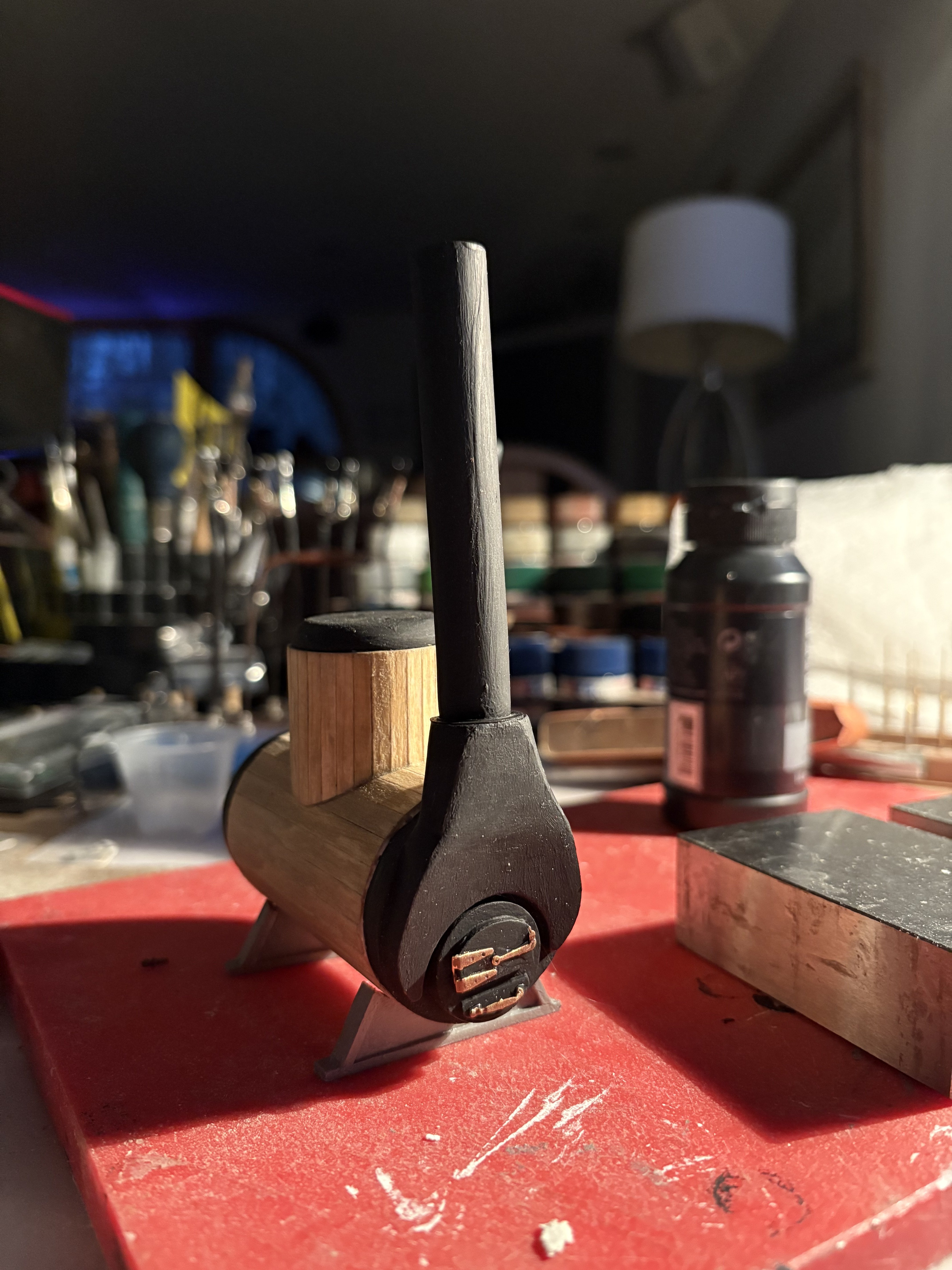

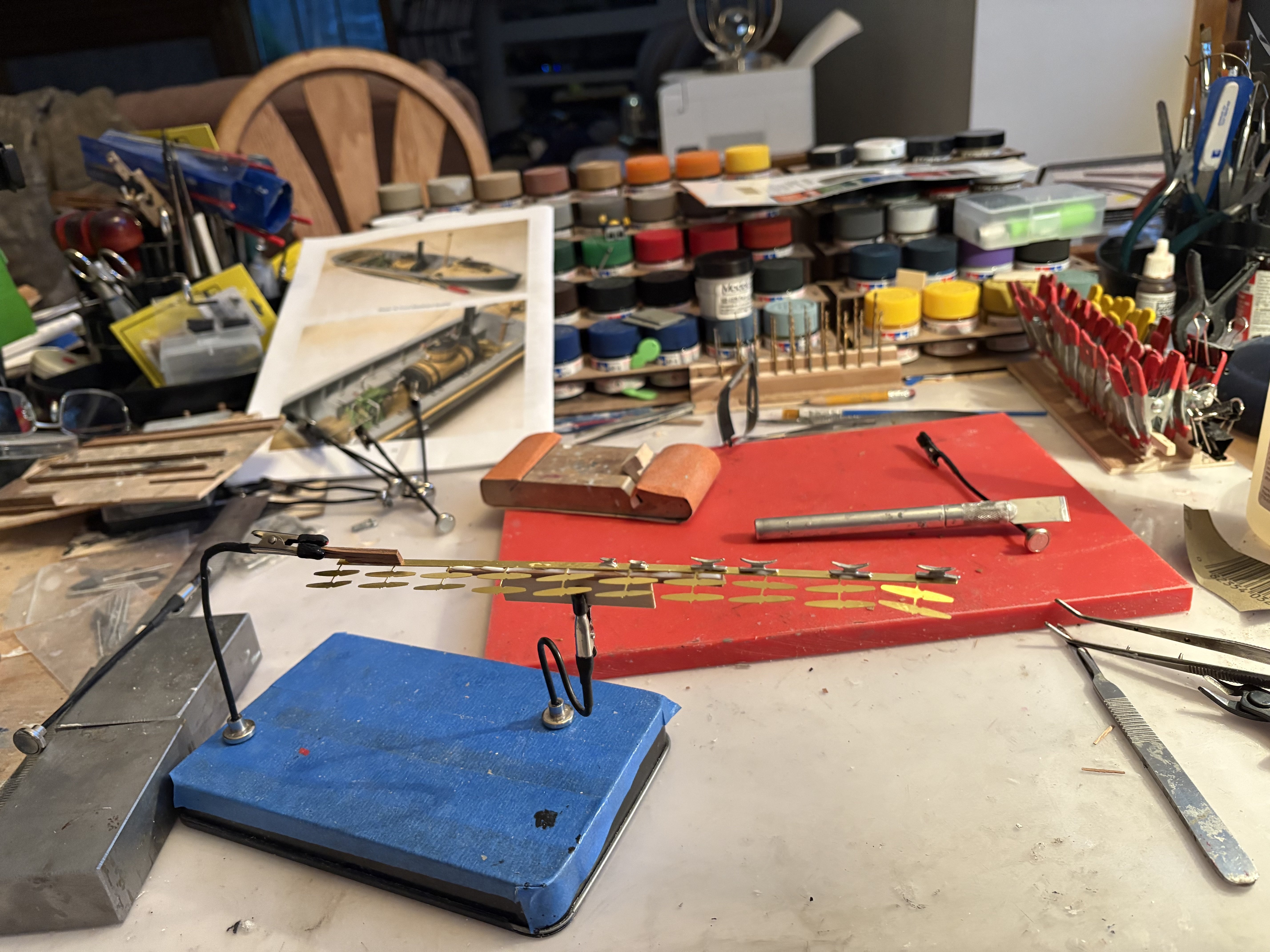

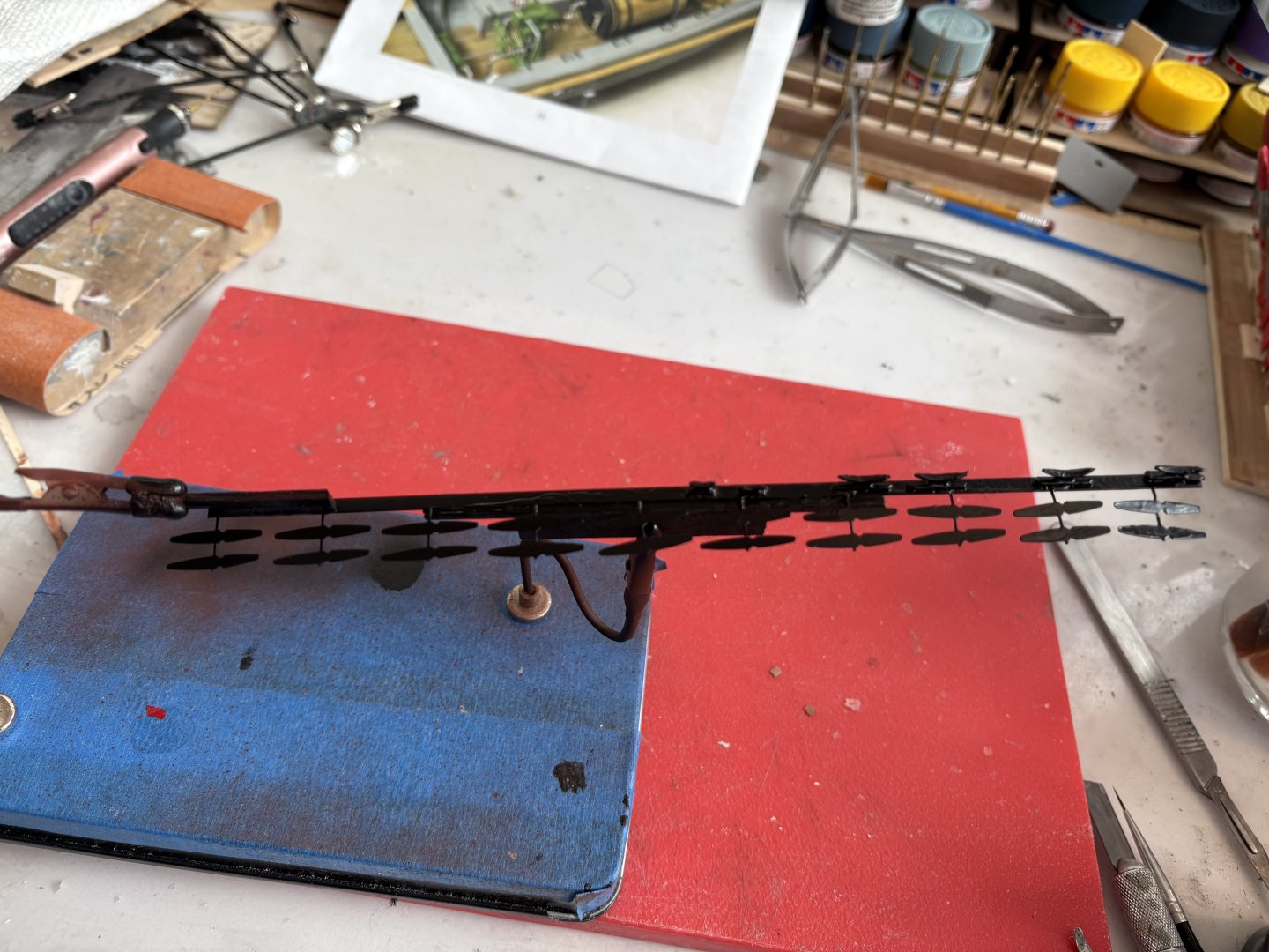

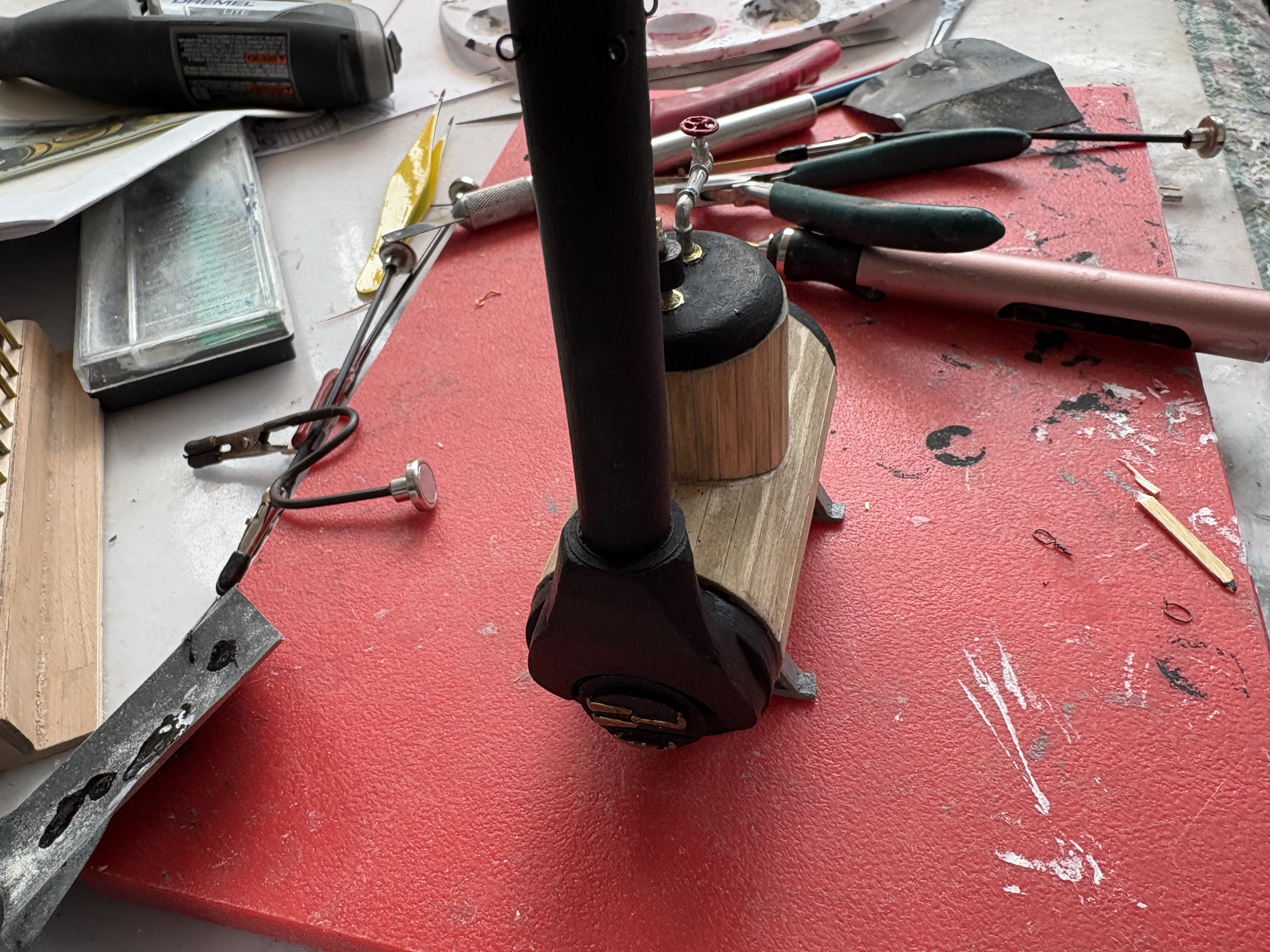

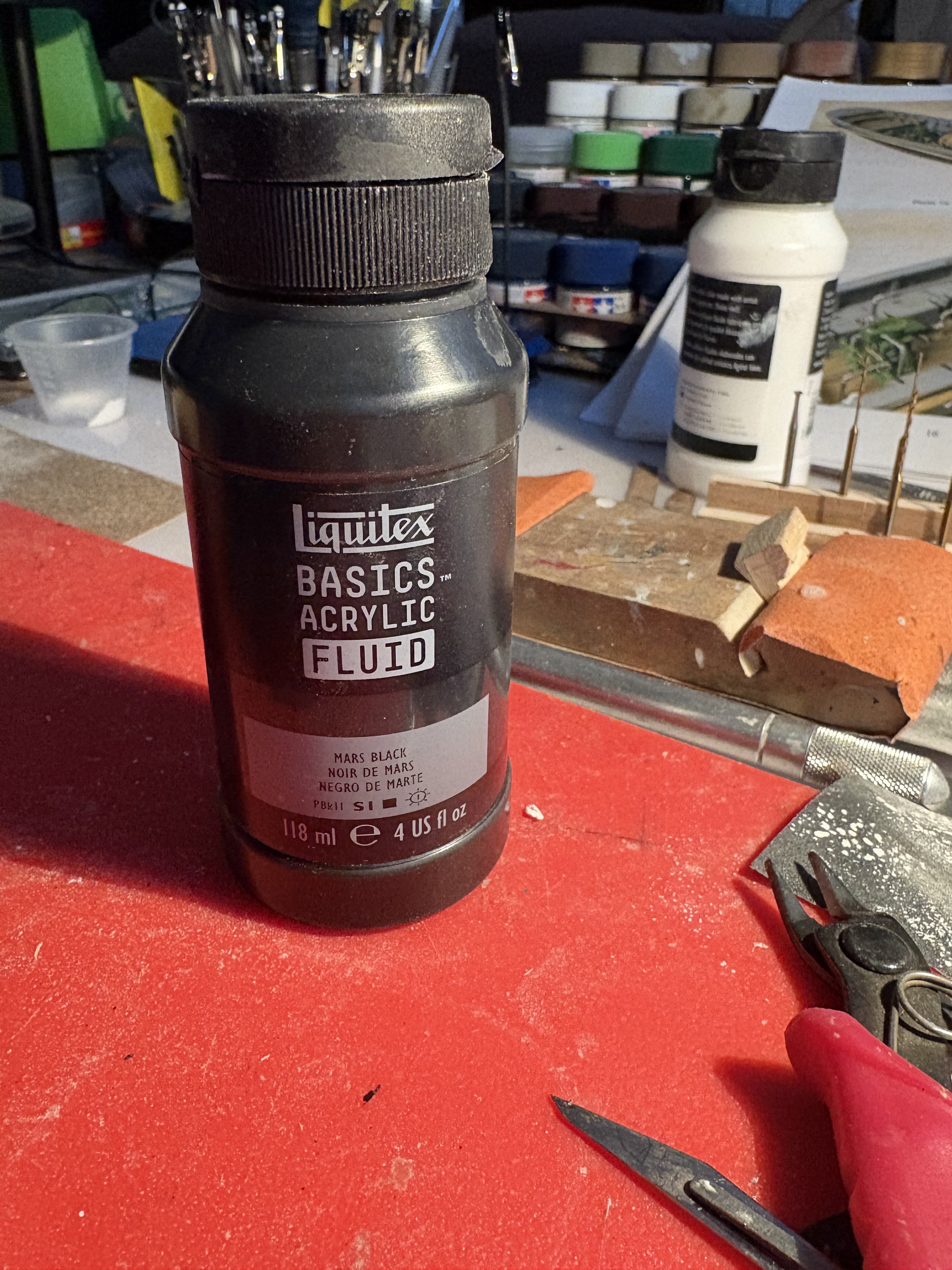

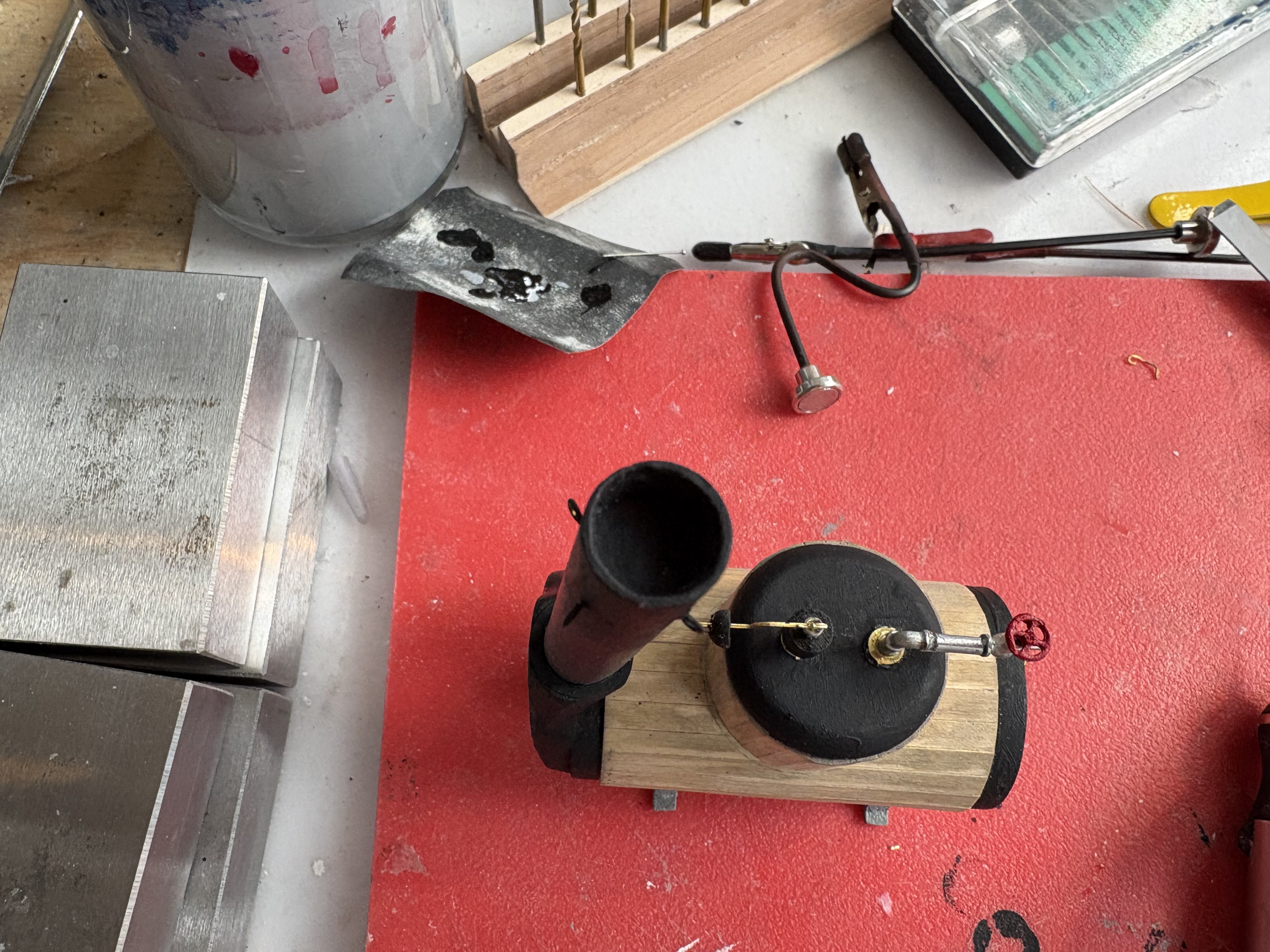

Had a lazy day today and stayed in port and worked on my steam boiler. Tricky day today requiring soldering valves and painting. If you are wondering the matt black is again Liquitex Basic Acrylic Fluid color “Mars Black”. It is a very heavy opaque pigmented black made from iron oxide and gives a great matt finish.  By the way 1-2-3 blocks definitely come in handy.

Yes! It's the same shade as the wood on the boiler of my steam launch. Looks great

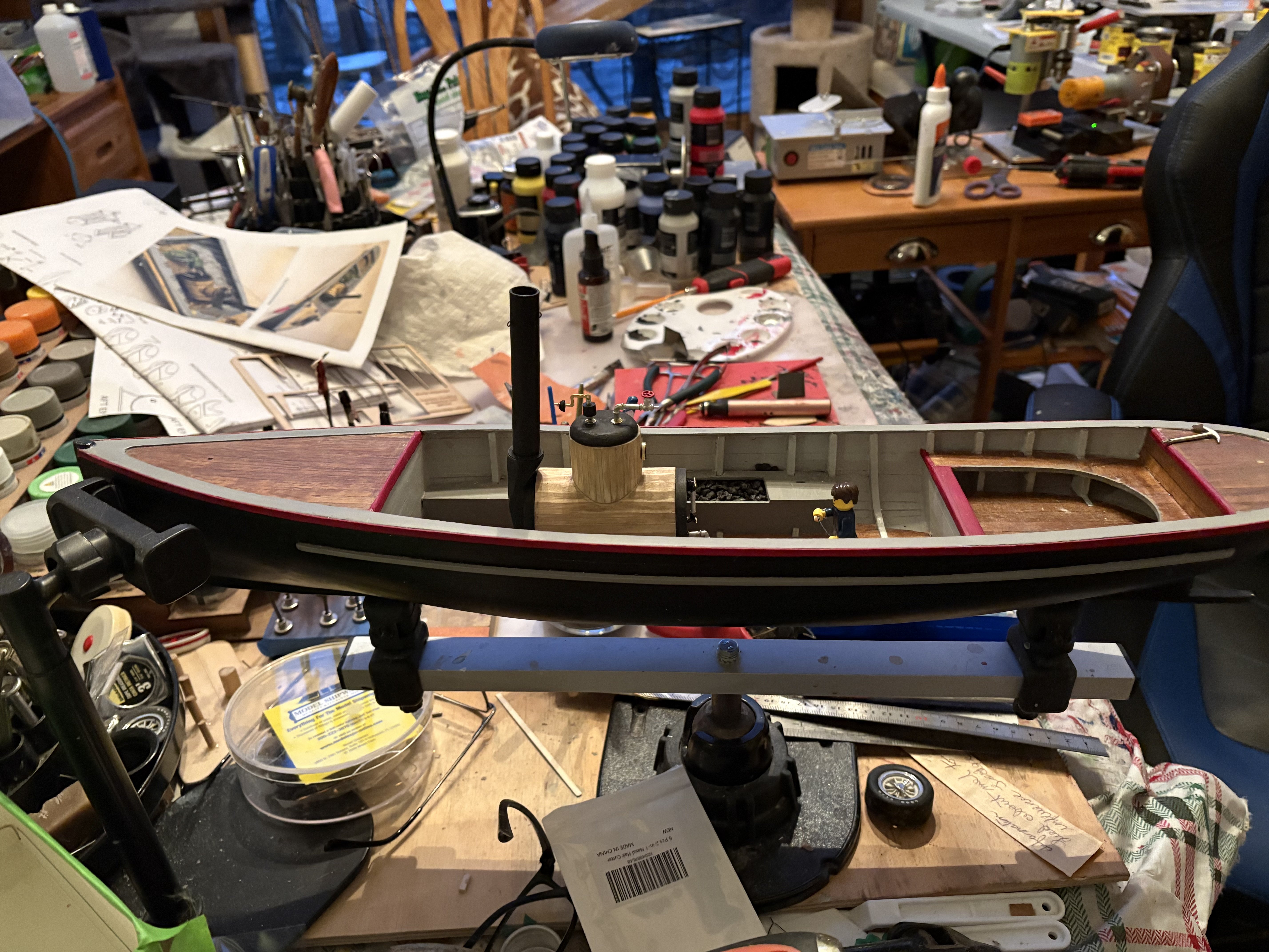

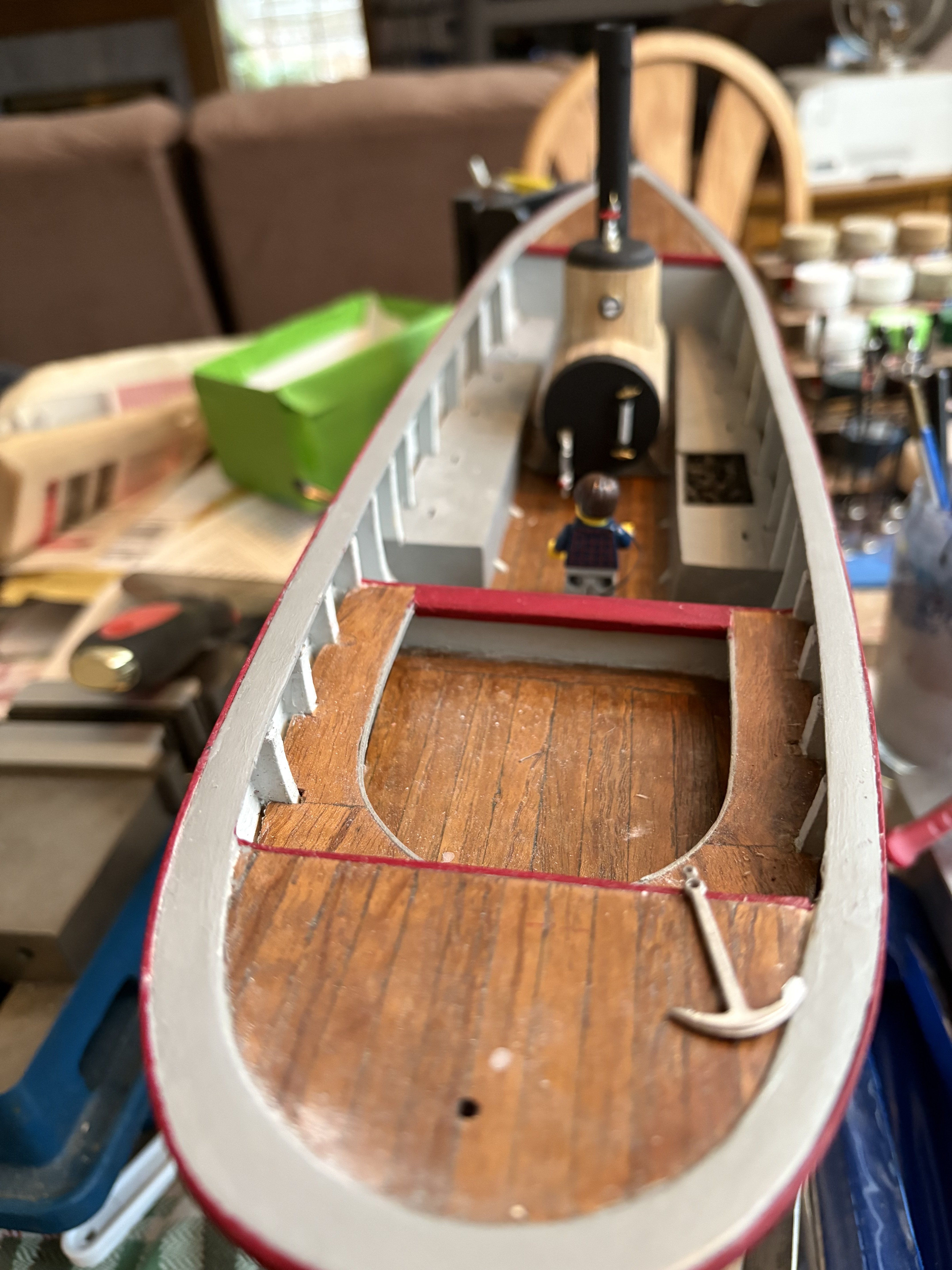

I’m up Suns Up Anchor’s Up and setting sail on another day of boiler and steam engine work. Without the engine and no wind and occasionally getting caught in the irons (with a very demanding 20 year old granddaughter) work must be done. Turning my attention to finishing the steam boiler!

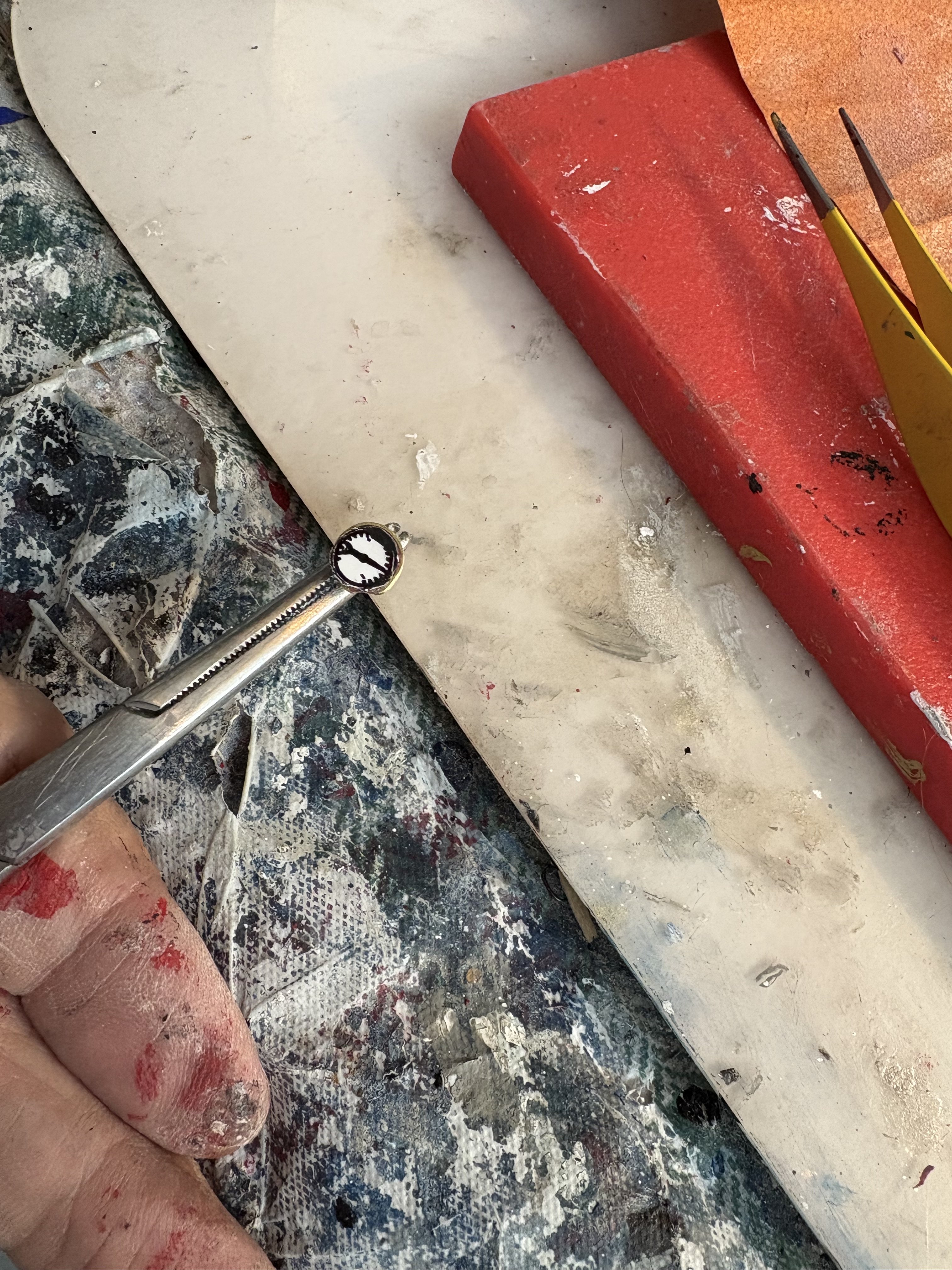

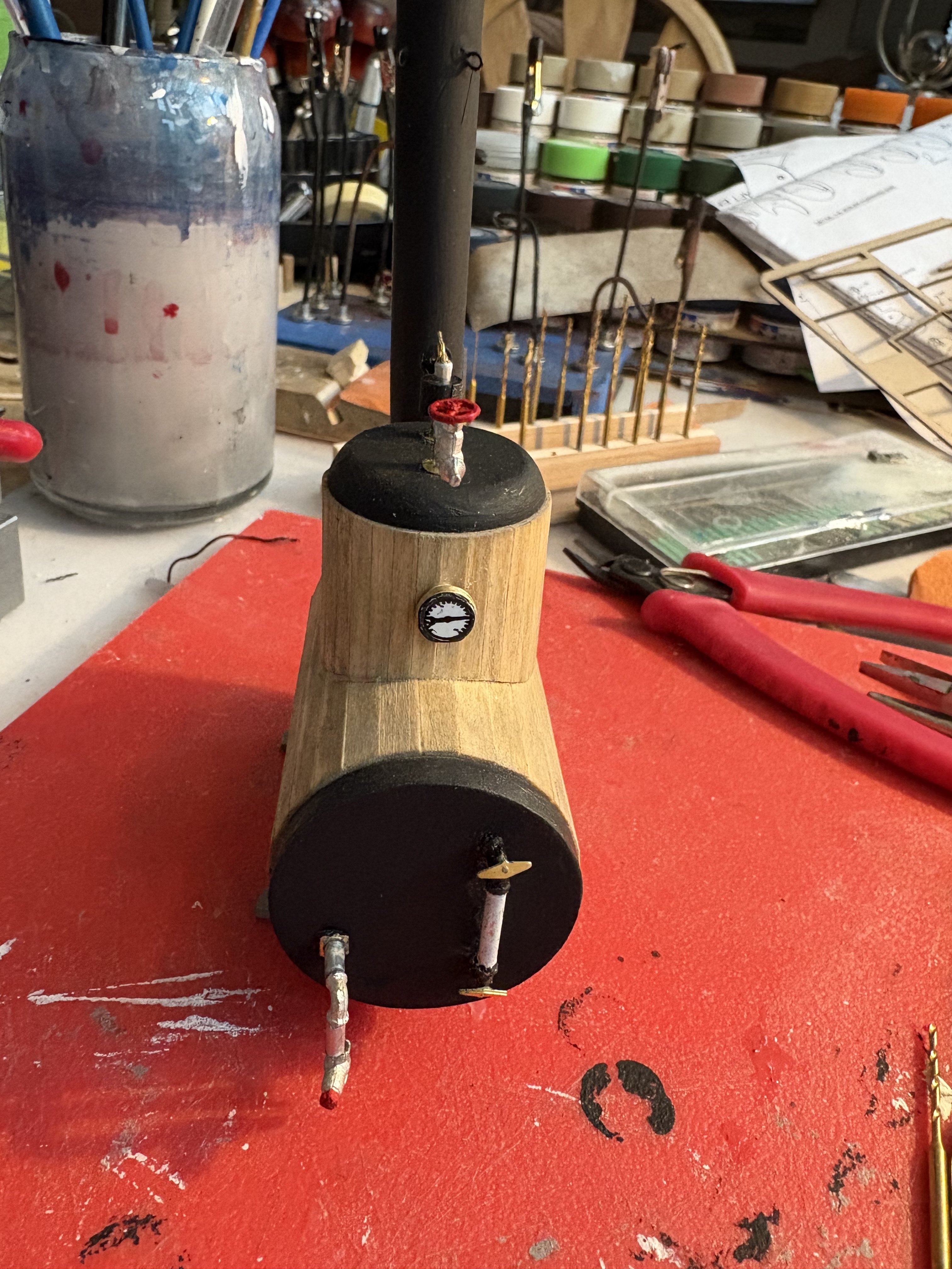

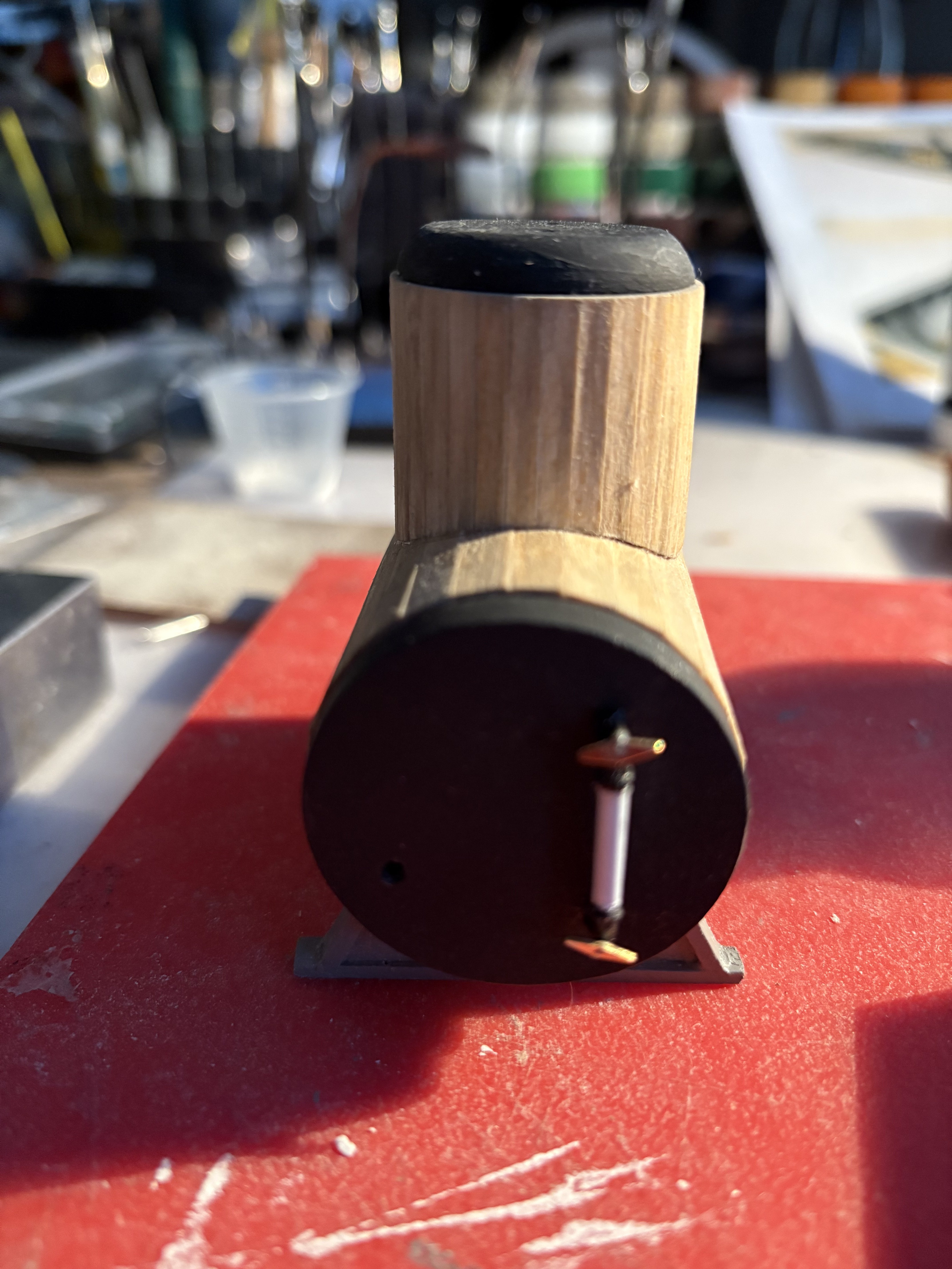

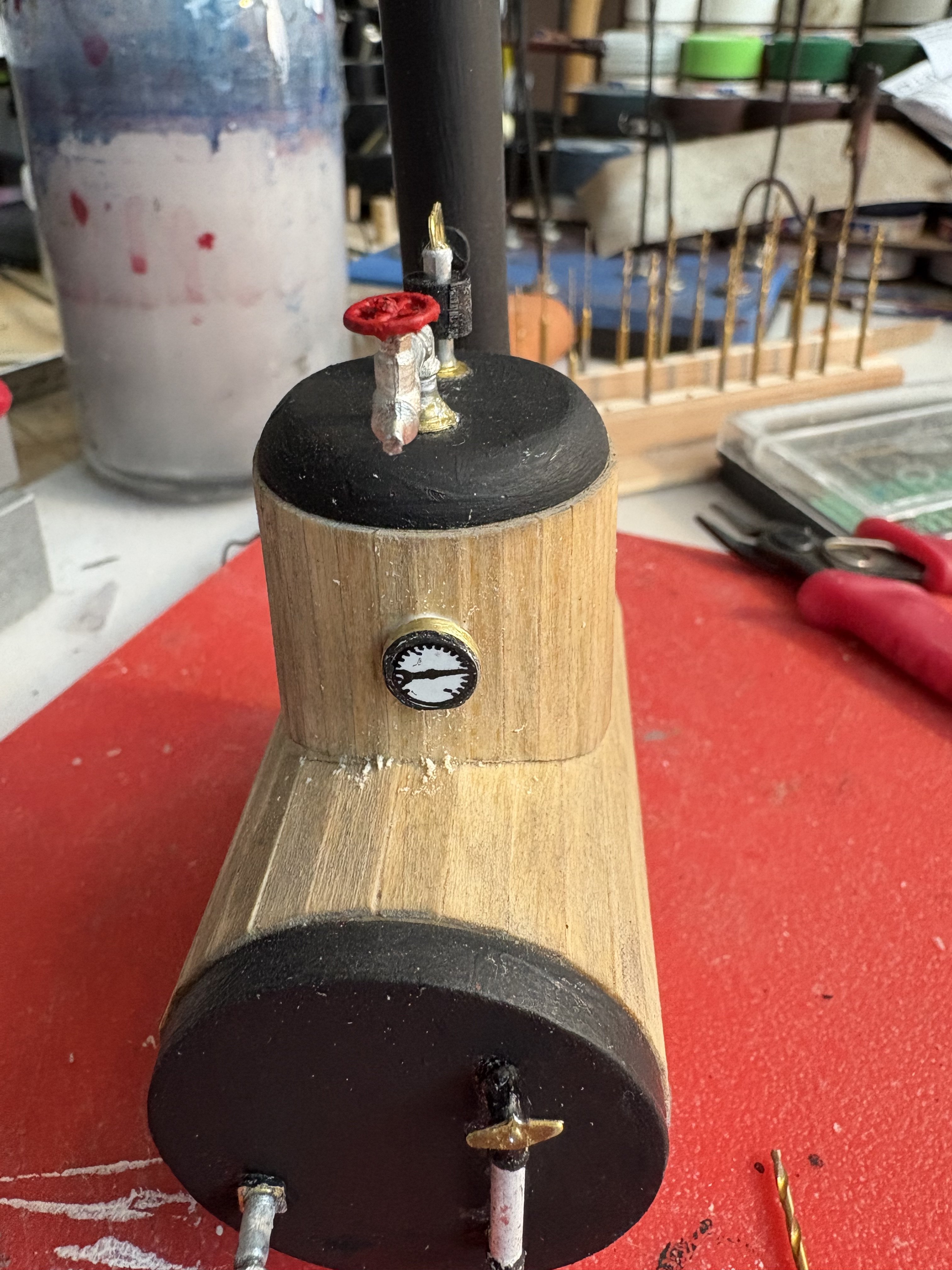

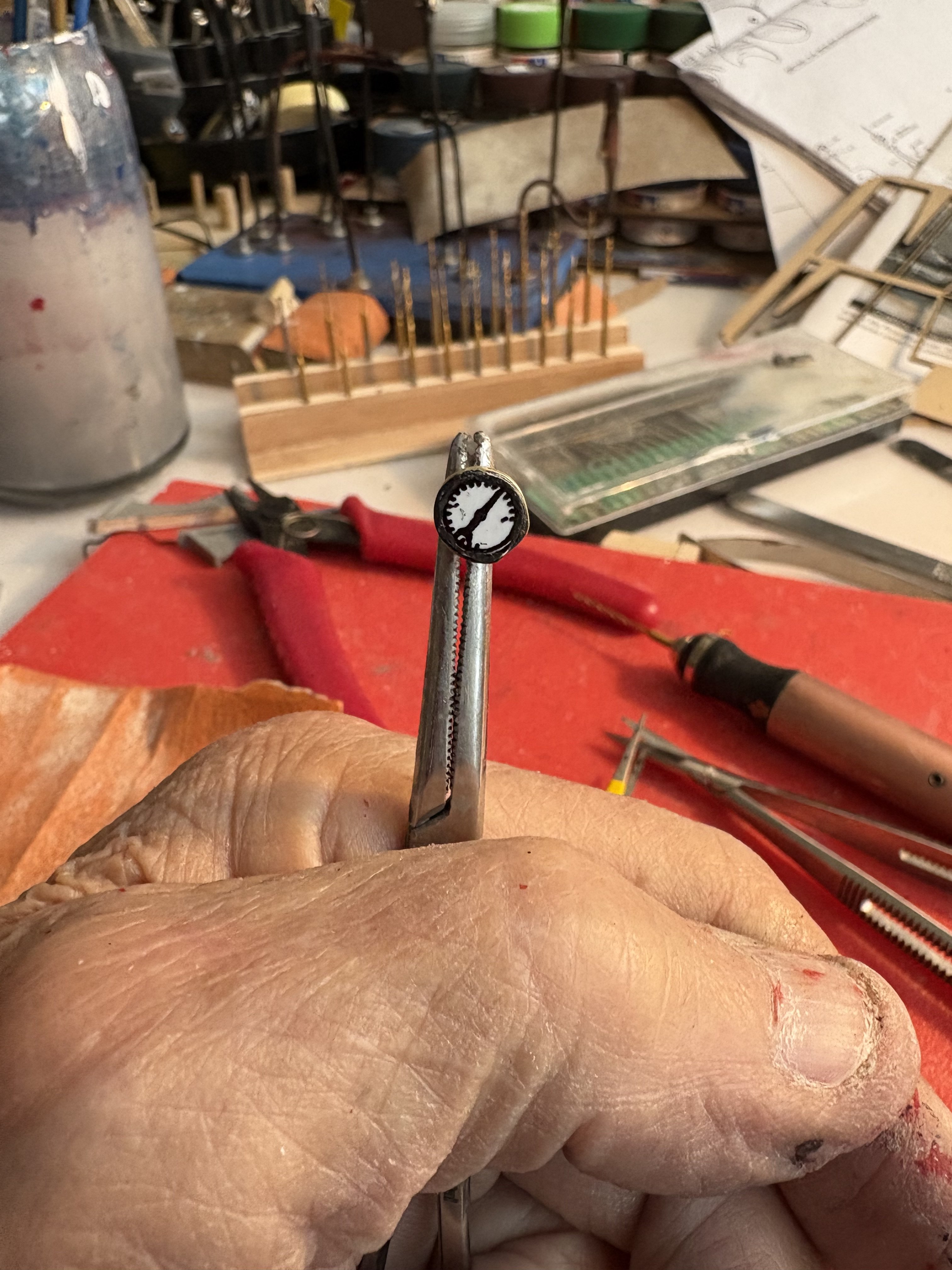

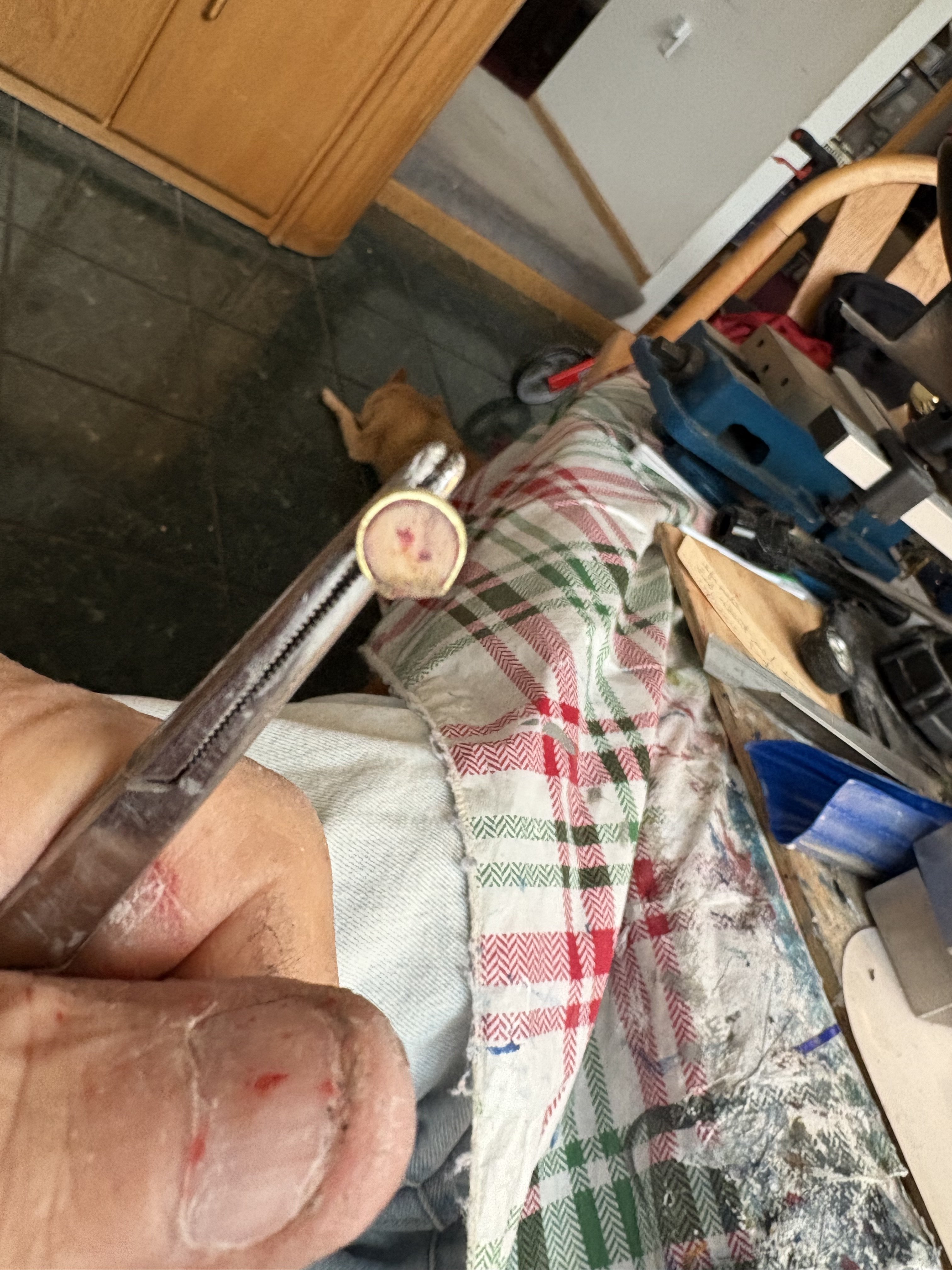

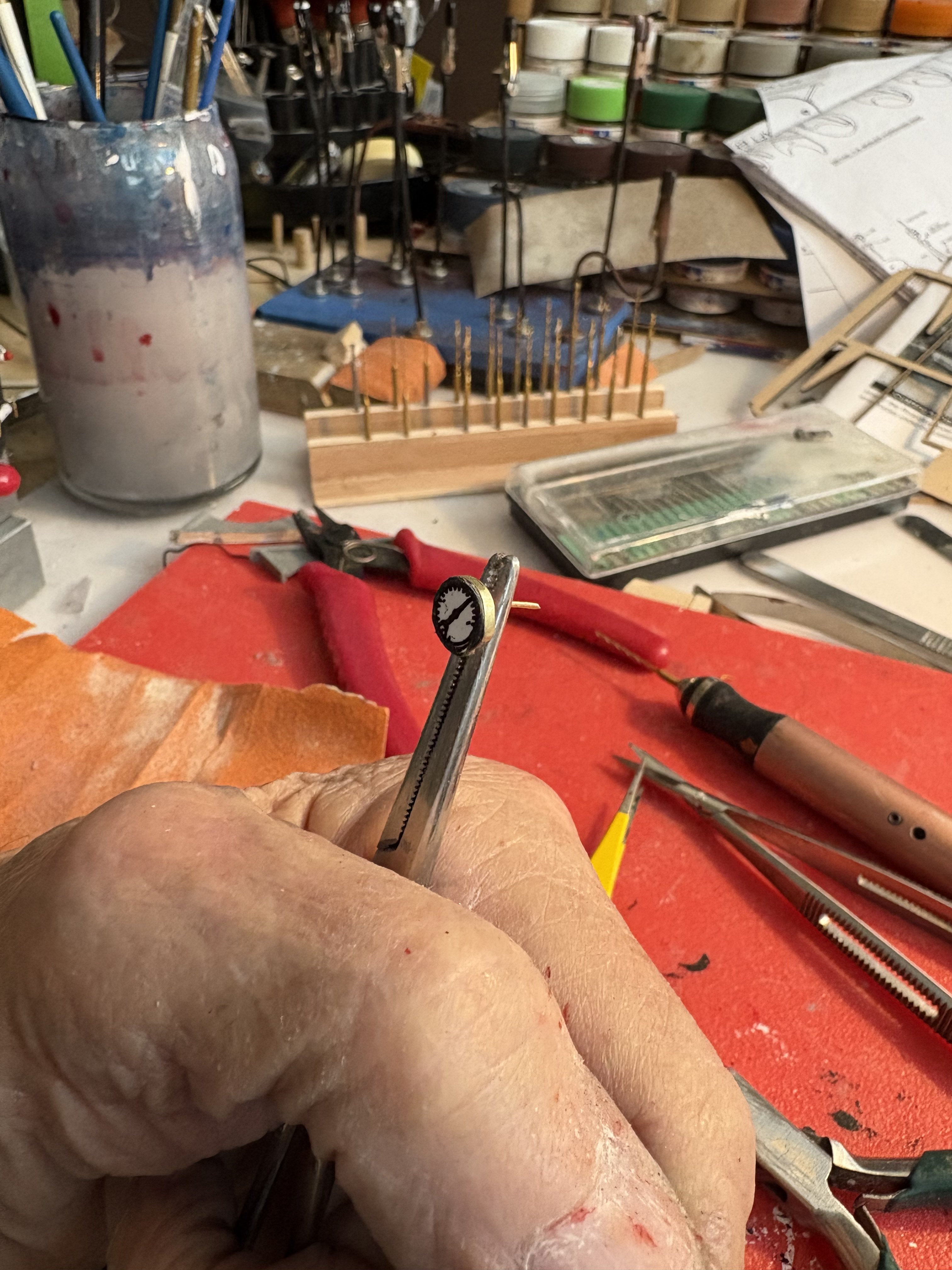

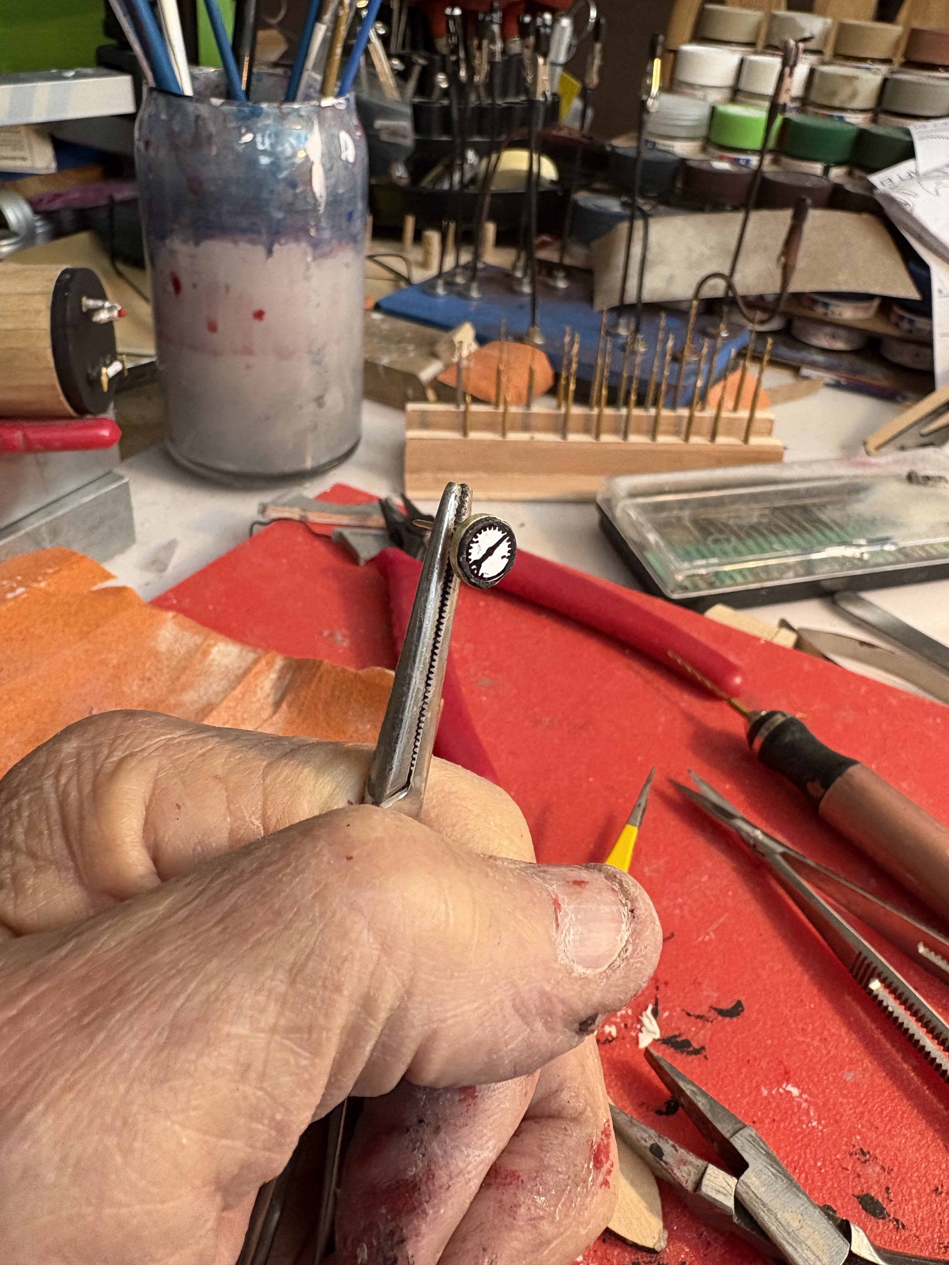

Getting late in the day and the sun is in the far west above the horizon. Worried steam pressure may get too high and explode so worked on the steam gauge. To give the glass look on the face of the gauge I copied the card stock gauge image (that comes with the kit) onto photo paper. I encased the wood plug body that comes with the kit with 2mm wide brass strapping then cemented the photo image to it. I also cemented a piece of wire in the back in the 12 o’clock position to aid in mounting it to the boiler dome.  Getting time to anchor up and admire the gauge.
As Always (until tomorrow) Best Rick

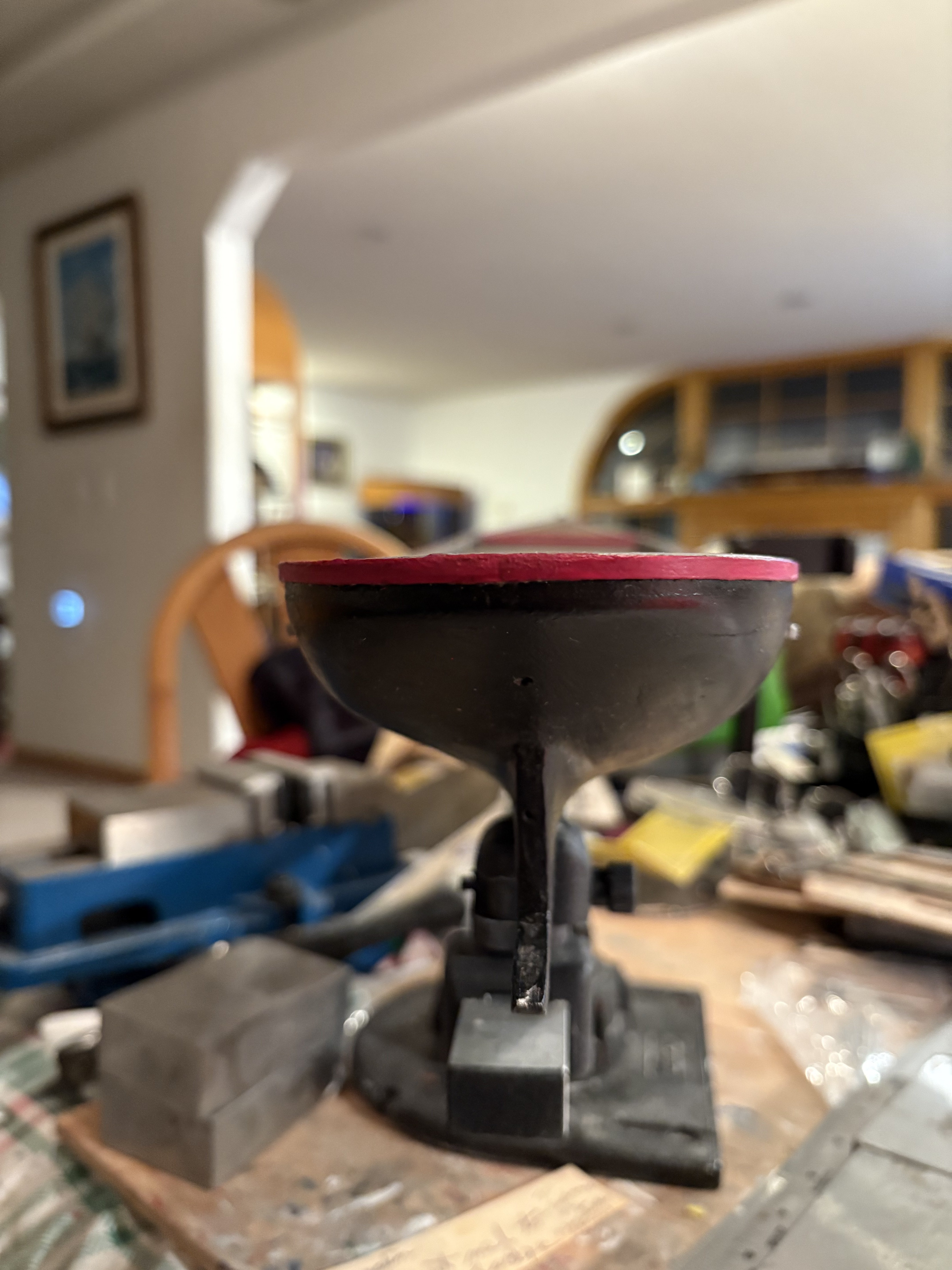

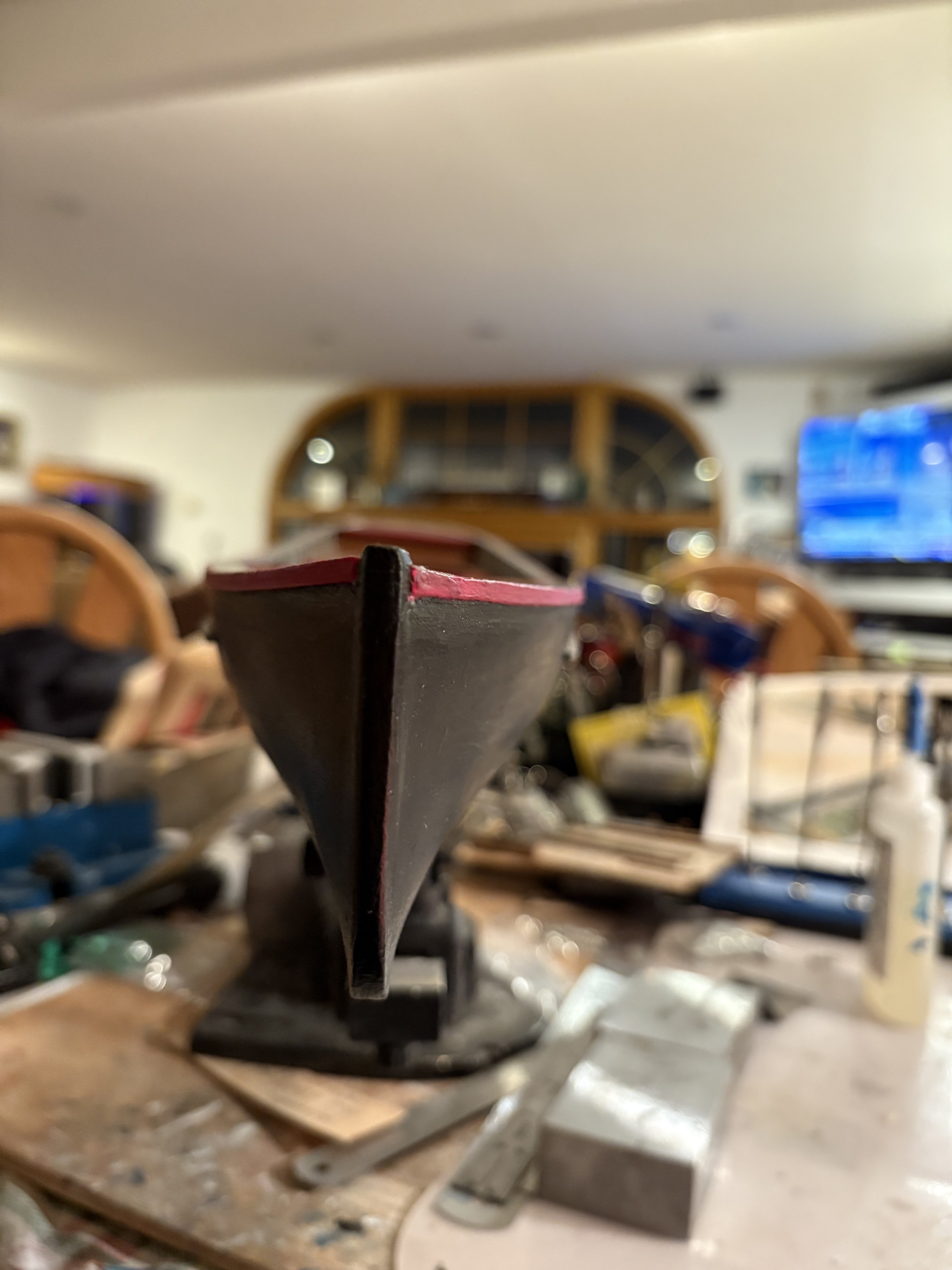

Got up this morning and headed out to sea. Boat was not steering well so headed back to port to fix and paint the rudder and rebuild the tiller. While in port waiting for the paint to dry headed into town to pick up some supplies and found 2 shovels for my granddaughter to load the steam boiler with coal. Were both tired so retiring for the evening and looking forward to head out to sea first thing in the morning. By the way painted the rudder to match the boat trim with Liquitex Basic Acrylic Fluid— Alizarin Crimson Hue.
