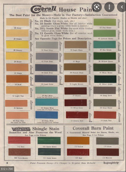

Here's an old chart I have. The quality of the copy is not very good; Hull Cream is not yellow! But it may provide some reference. May want to consider the colors used on whaleboats and Dory boats of that time period.
