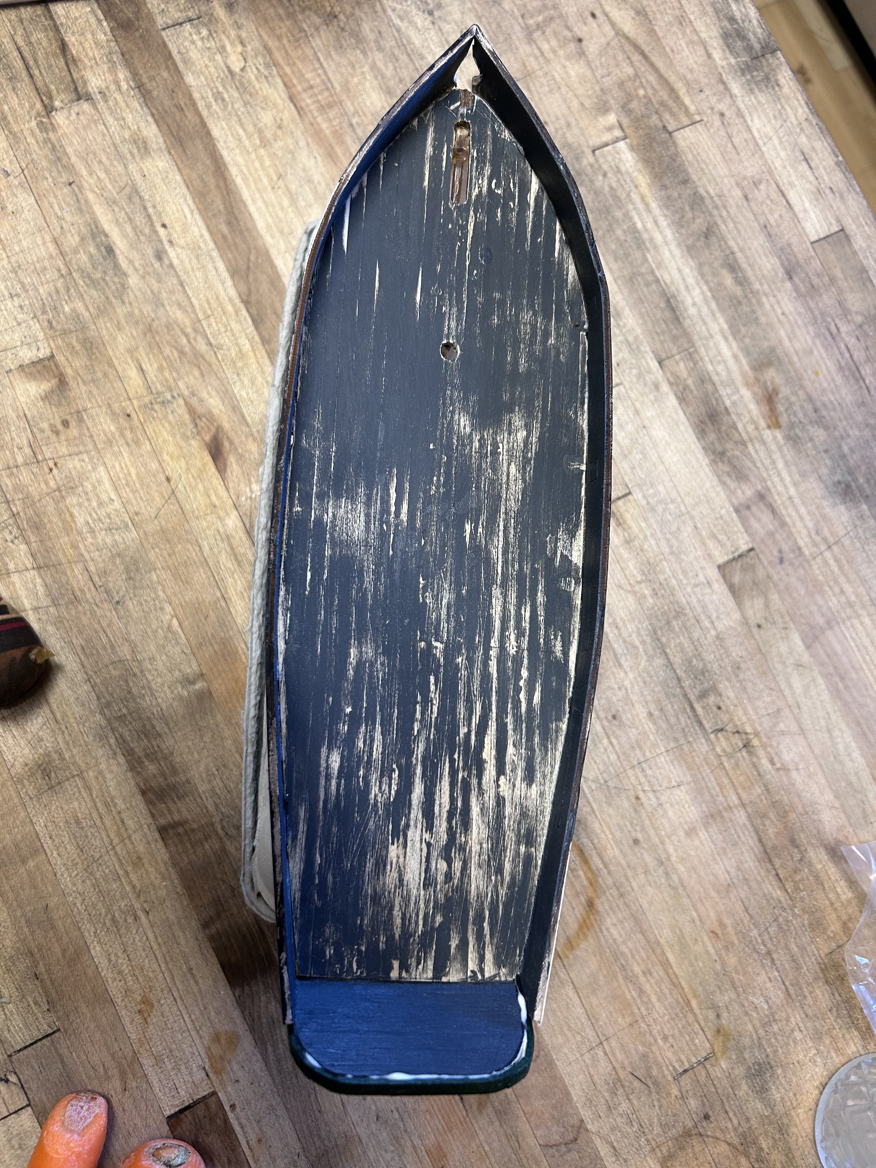

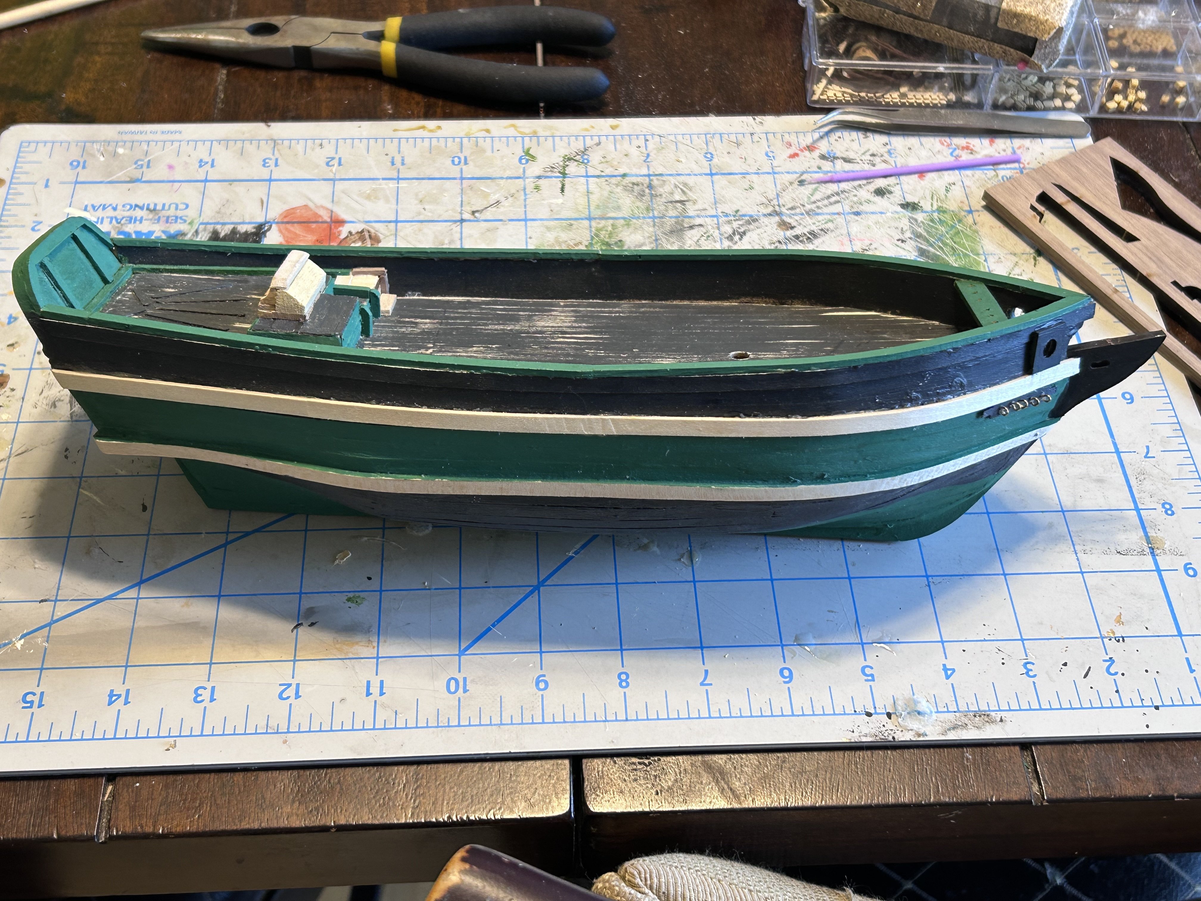

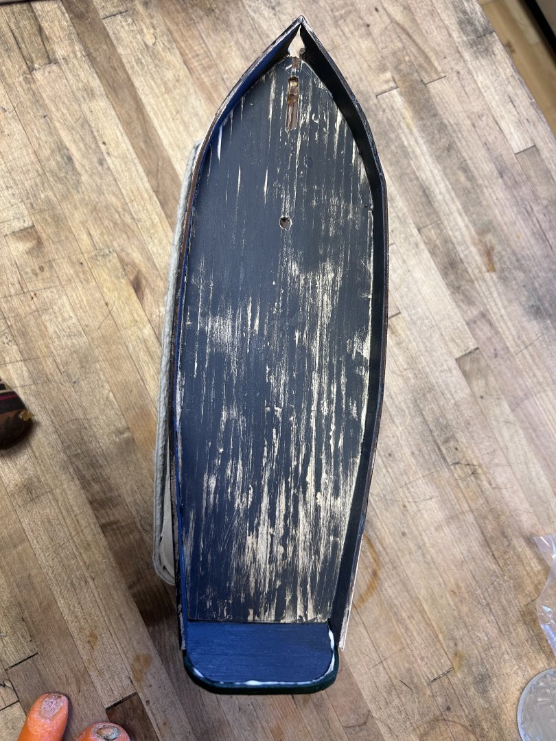

Starting from an early stage though not the beginning, after adding the deck and doing the planking I realized I wanted to make the deck a little more authentic—which means weathering, lots of weathering.
To quickly back up though, when starting this build I realized there were some key differences between my model and the Albatros from which I was pirating, namely the  length of the ship, the fact that it’s only one and not two masts, and the height of the upper deck.
So after some measuring and rudimentary maths (not 1:1 in this case as many of these measurements I did not have exact and I wasn’t focusing on 100% accuracy) I cut the length of the ship down by a few inches and removed the upper deck from the bulkheads. I also cut a new stern to more closely match the Friends.
My goal in this build was always to meet somewhere in the middle between the historical ship, the recreation, and my own abilities and imagination and so any minor differences between the original and mine were differences I was willing to live with.

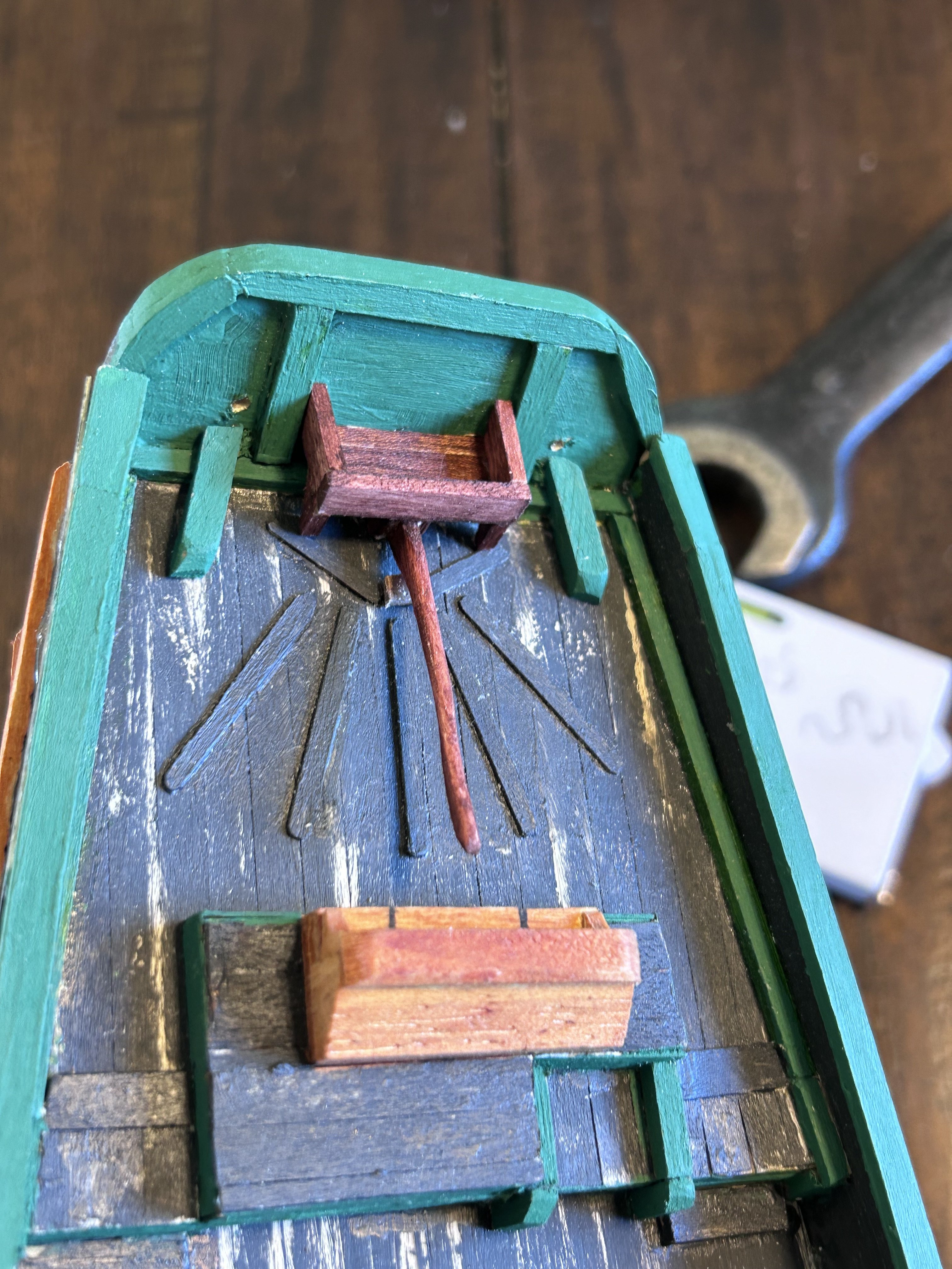

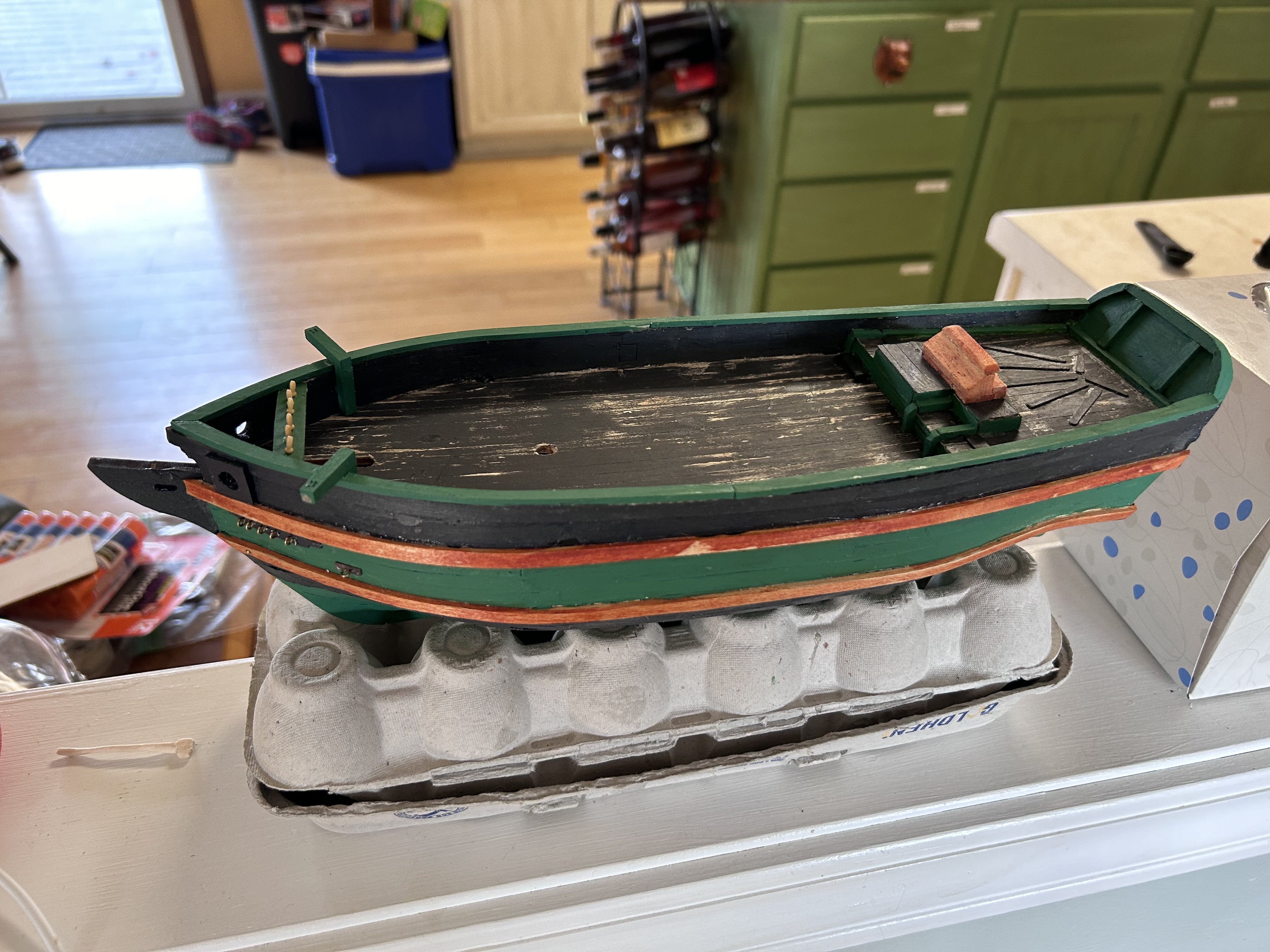

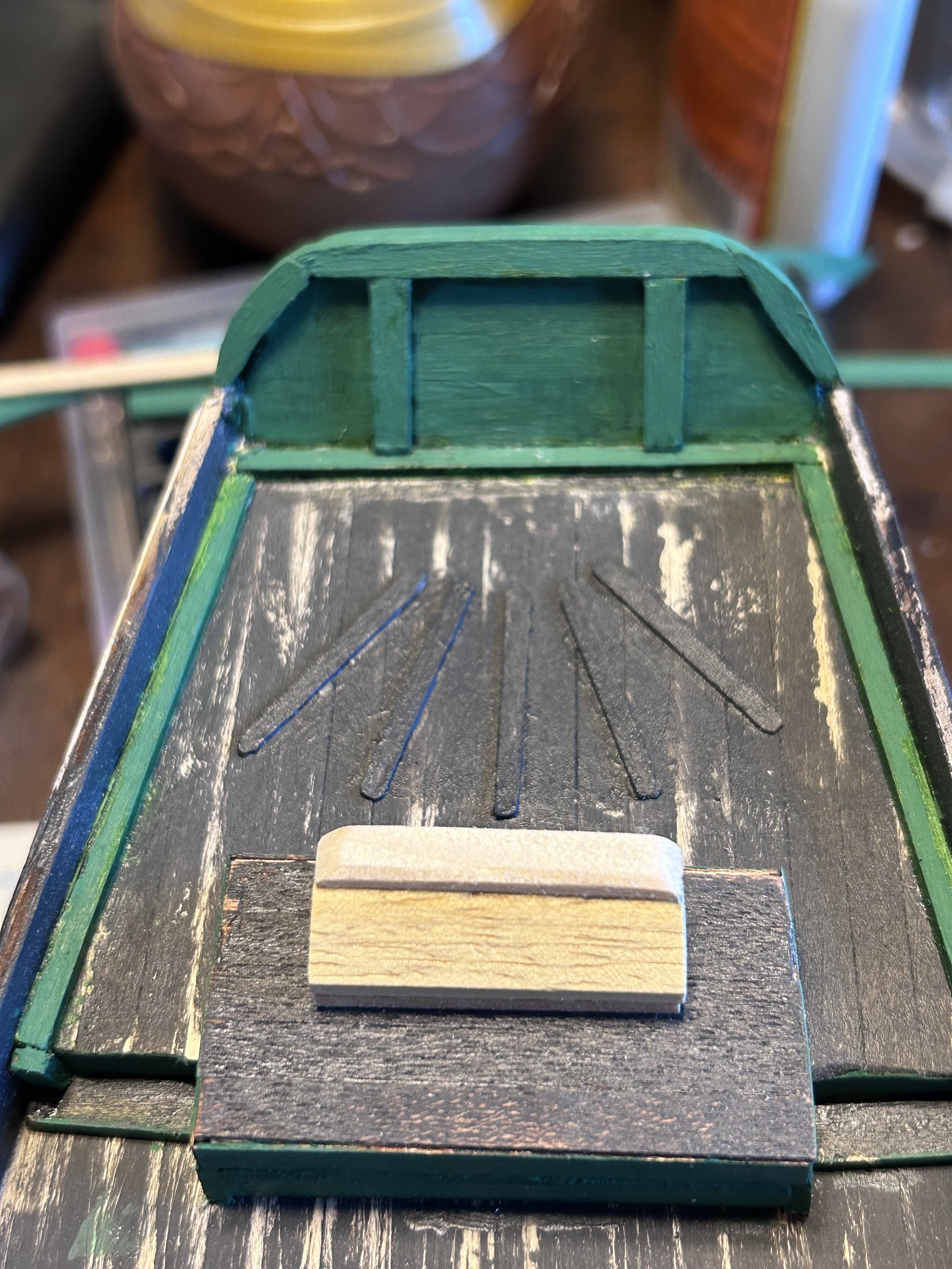

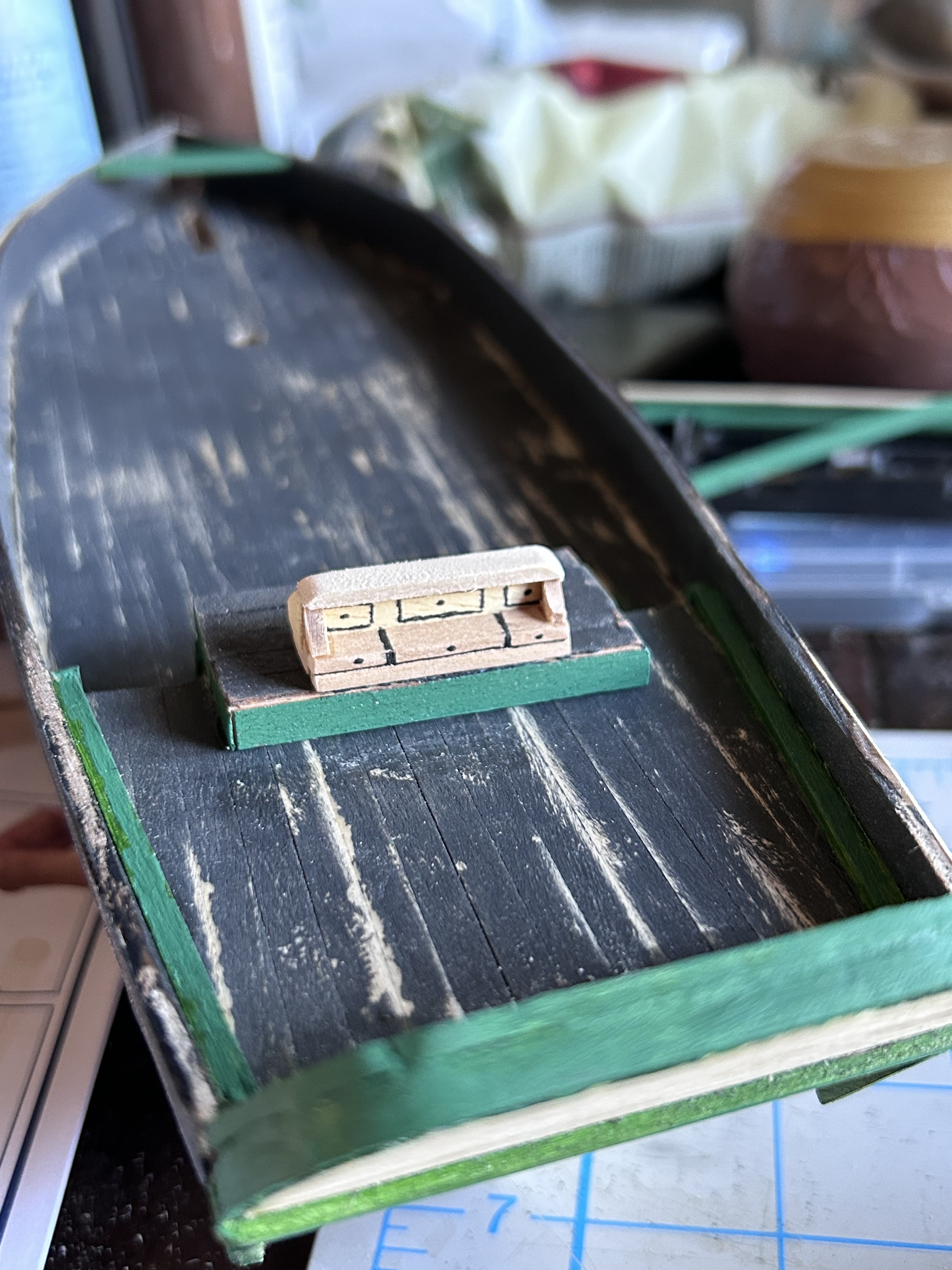

So now that the deck is assembled and properly weathered it’s time to add the upper deck, which once again means some custom cutting. In this case I used a thin piece of basswood and cut it into shape, after that I added the raised platform and binnacle and again; this was another instance where I went with “close enough” rather than 1:1 as the binnacle was made using one of the raised platforms from the Albatros.
I also took the time to cut five strips down to make the floor markers which help in controlling the tiller. IMG_1776.thumb.jpeg.7a57e2dee277d9af54a4acc93f35571c.jpeg
As for the binnacle I opted for hand drawing the lines, though I know the quality could have been higher if I’d carved them in I though this was a small enough detail that it didn’t matter that much. IMG_1775.thumb.jpeg.7606ed60c8bc0486f954d6ff12ce4ed7.jpeg

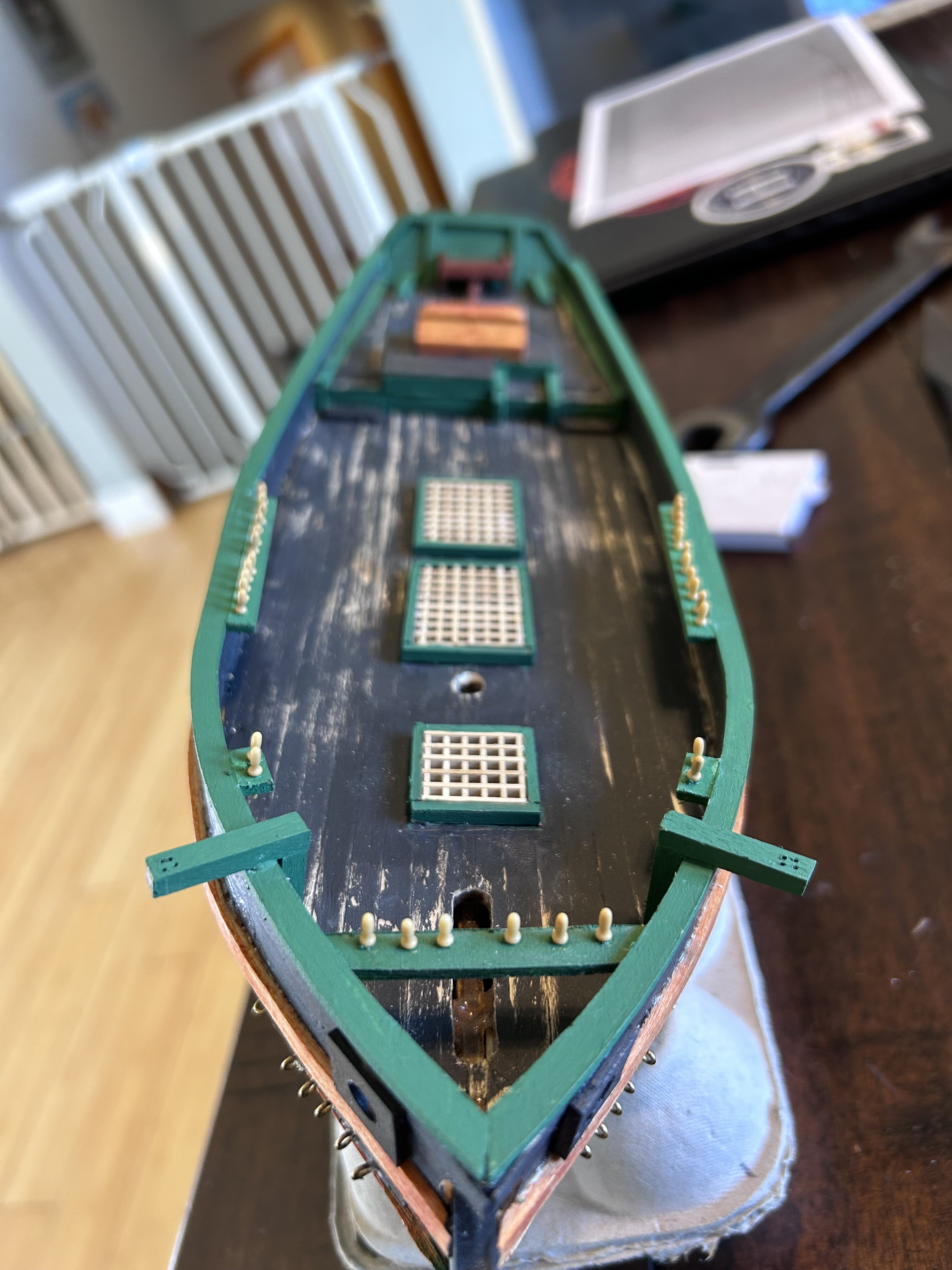

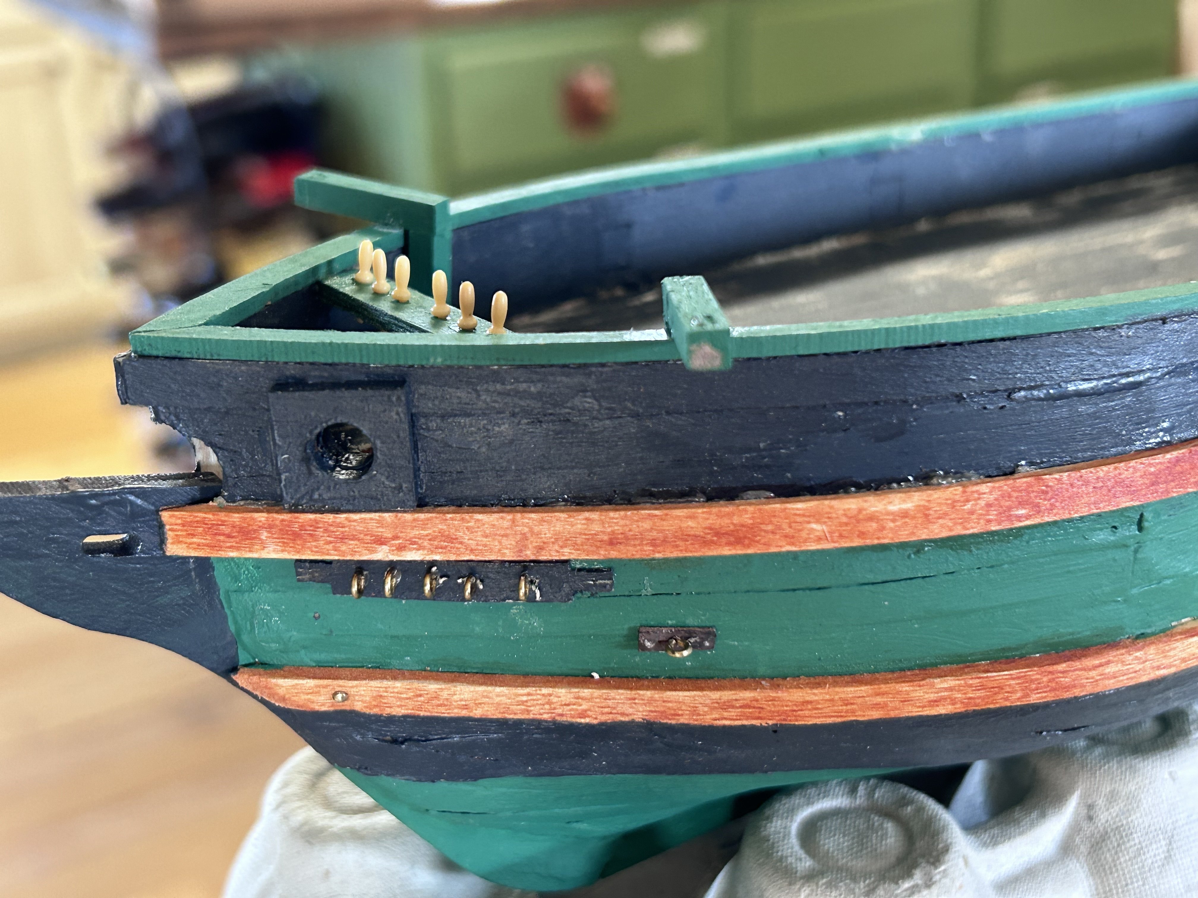

Next came the work on the gunwhales, gluing them down and then staining them. I found a green that matches the green of the ship (though I do have access to the paint from the ship so the day may come when I go back and paint it with the accurate color) and as for black I settled for a base acrylic that matched the color (no need to get super fancy). IMG_1932.thumb.jpeg.5666adfe19a1ad6e6d8c7eafdb532ce9.jpeg
Up at the prow I added the various brackets that would be used for the rigging as well as the hawsholes for the anchors, forward pins, and finally the catheads.

Next came the bulkheads and tiller. The Albatros came with more than enough material to put these together and from there it was just a matter of eyeballing it to get it “close enough”
I actually really enjoyed making the tiller because that was mostly hand carved. Above it I placed a box that’s used to store excess mainsail line.

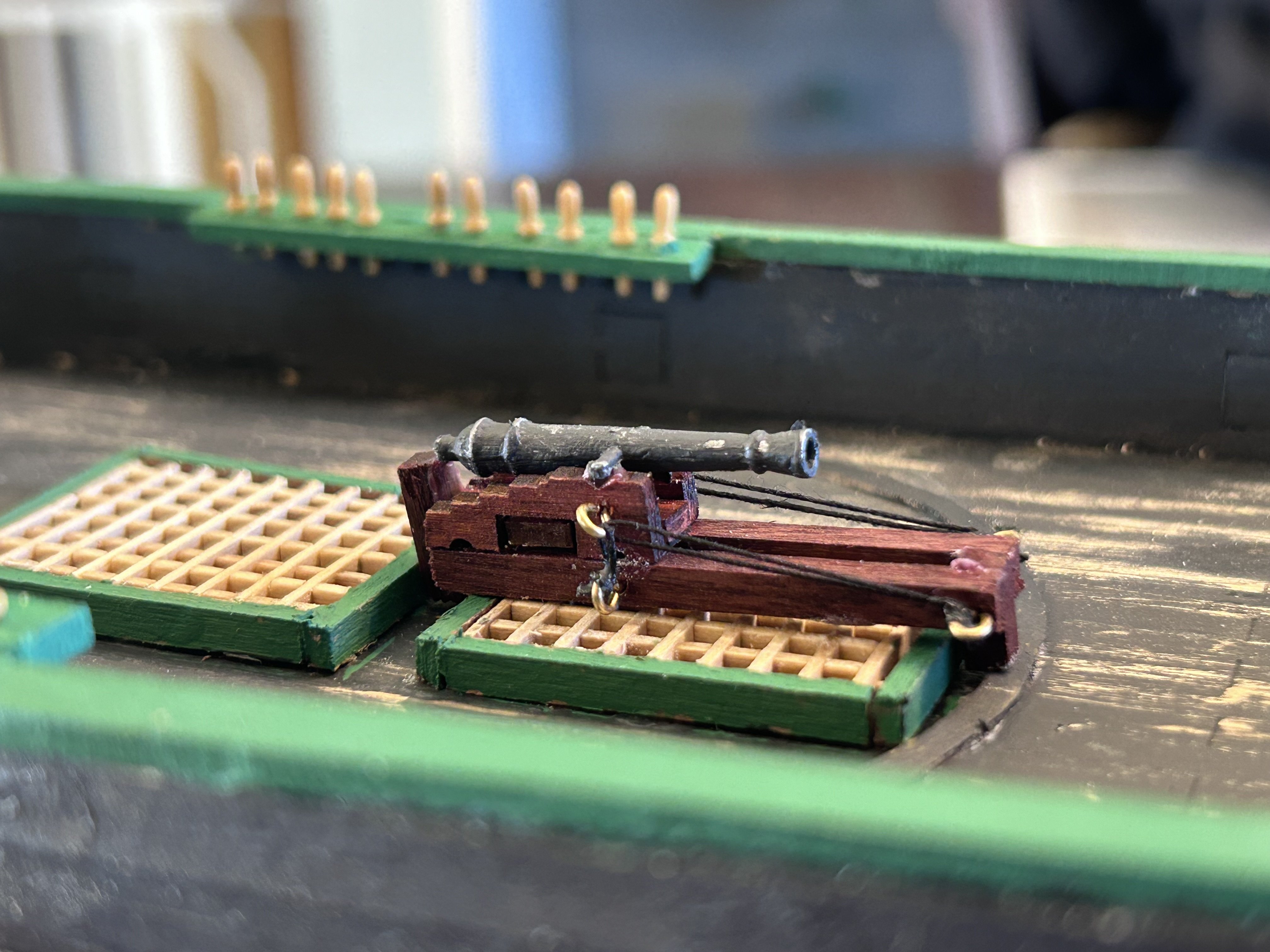

This is where it gets fun because just like with the real ship it’s time to play with the long gun!
Fortunately in the category of “close enough” we have the long guns from the Albatros which when adjusted for scale become the perfect size for the 9 lb long gun.
I really love how this turned out.

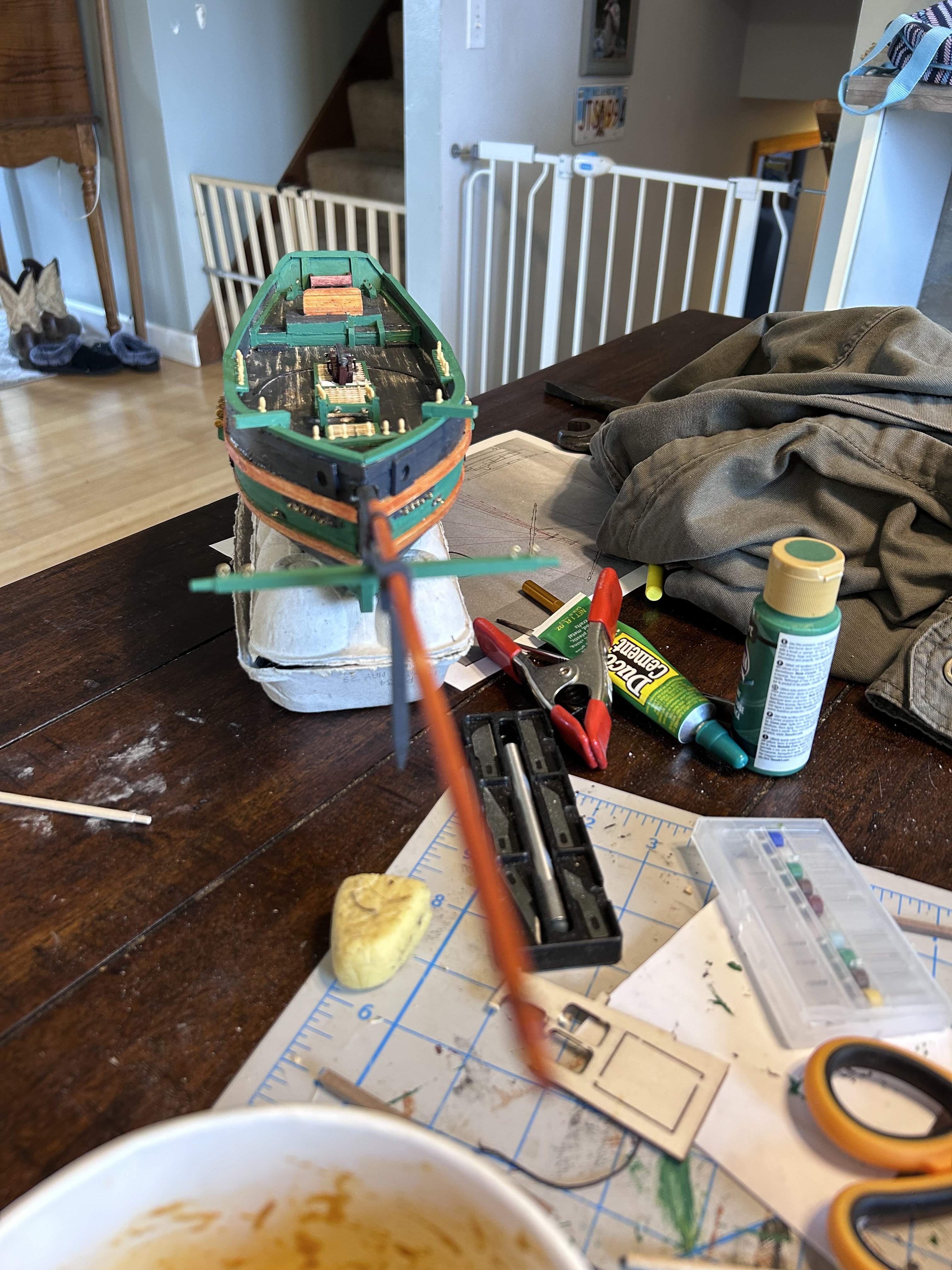

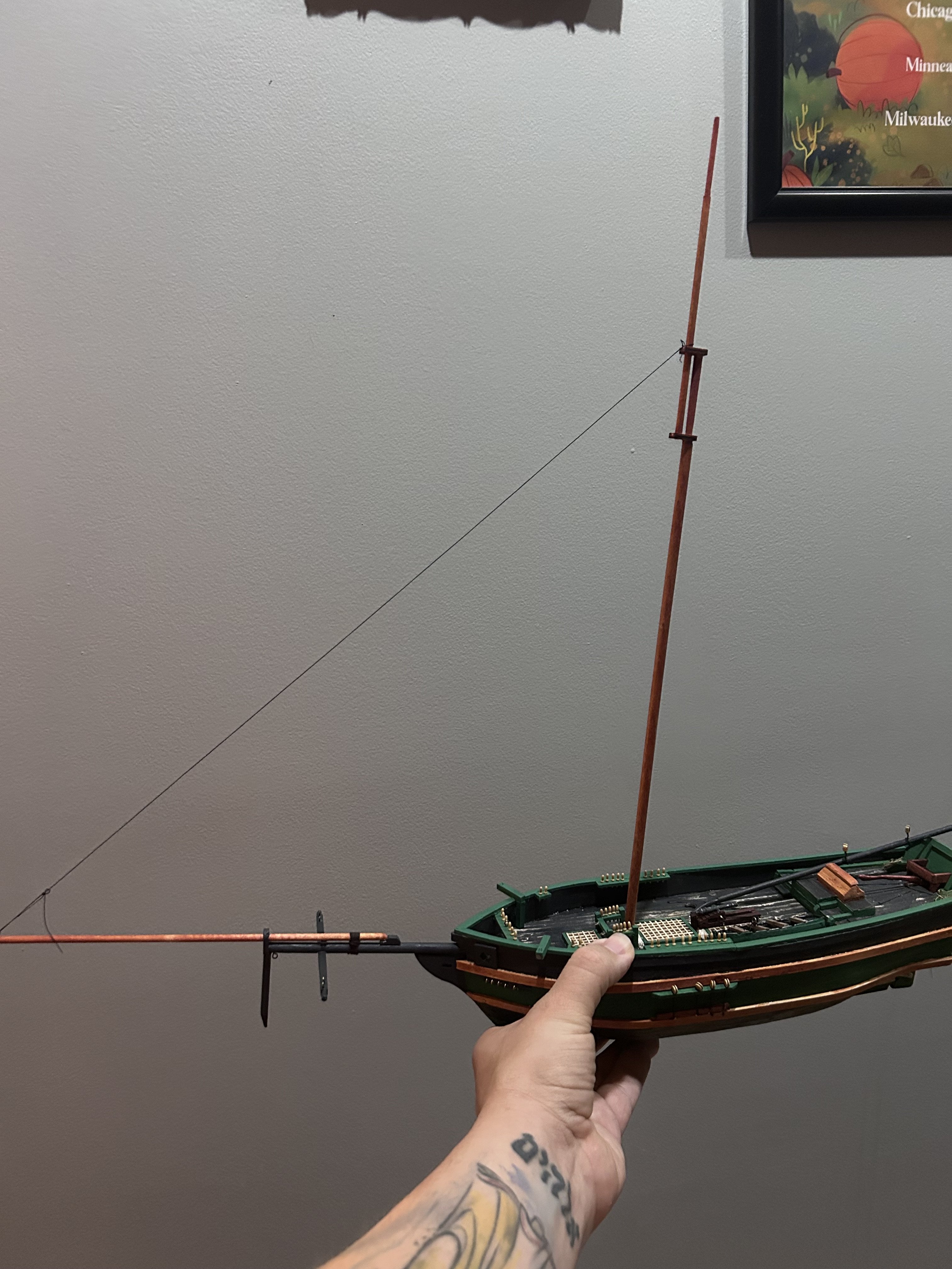

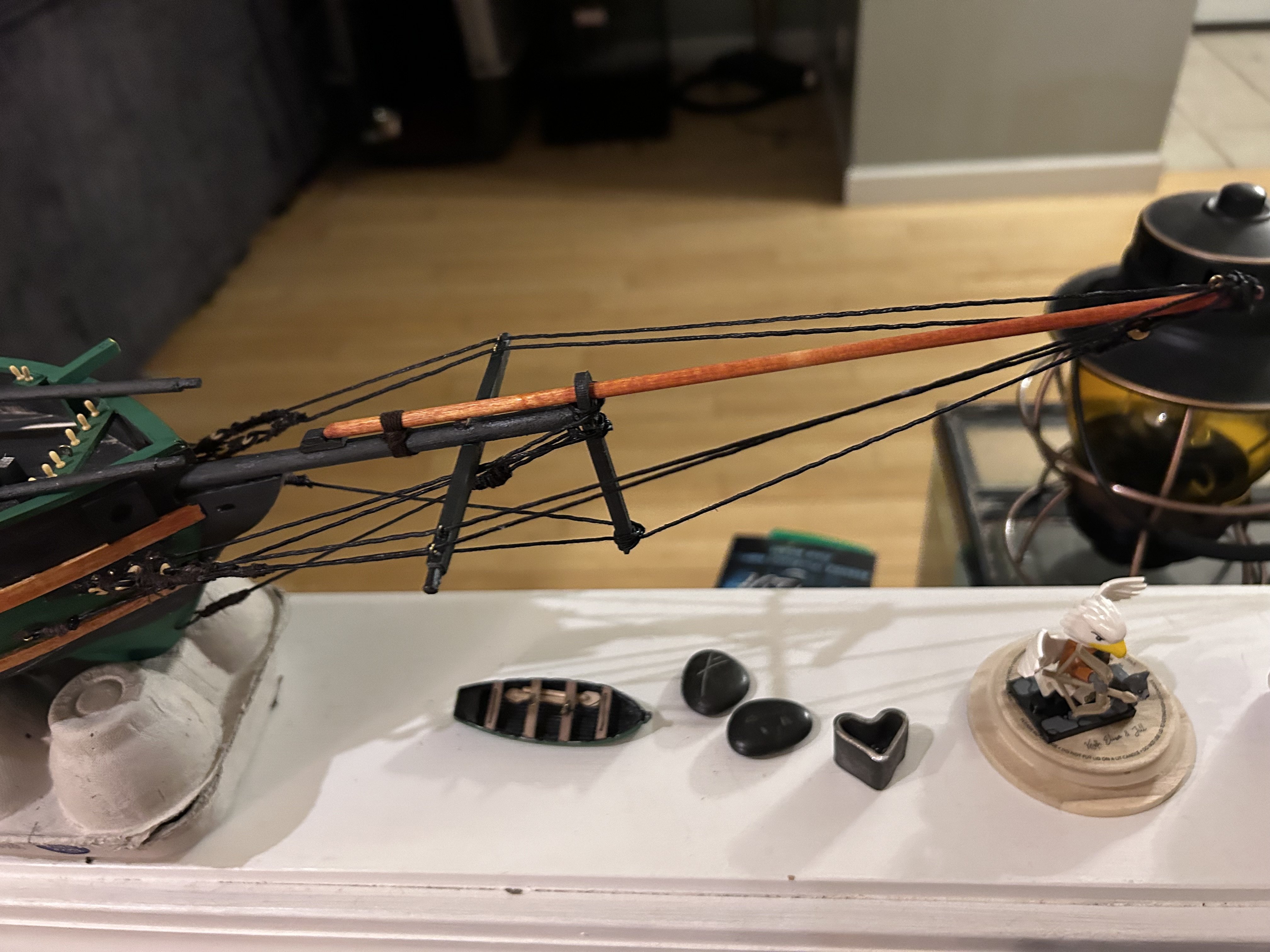

Next came something I dreaded most of all: MATH.
Now the bowspirt of the Albatros is far shorter than that of the Friends and so I had to figure out what the length of it would be given the length of the hull.
Now there’s a reason I got an English and a theology degree, because math is not my specialty. That being said I managed to deduct the equation to get the proportions correct (shocking I know) and the bowsprit and mast came out around the size it should be.
I should also offer some credit to @kruginmi and his build log for the ship as it gave me a lot to work with to get it right.

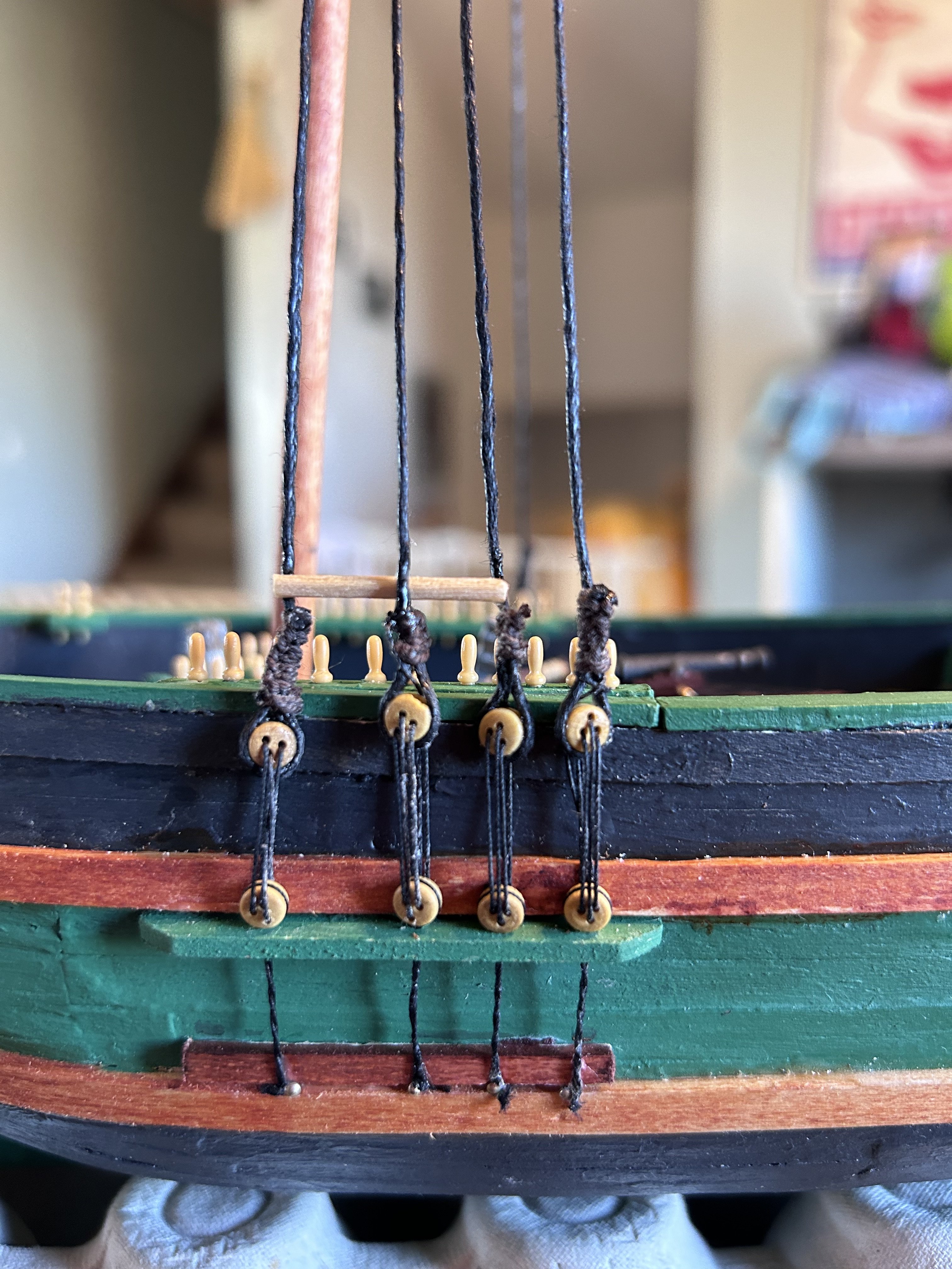

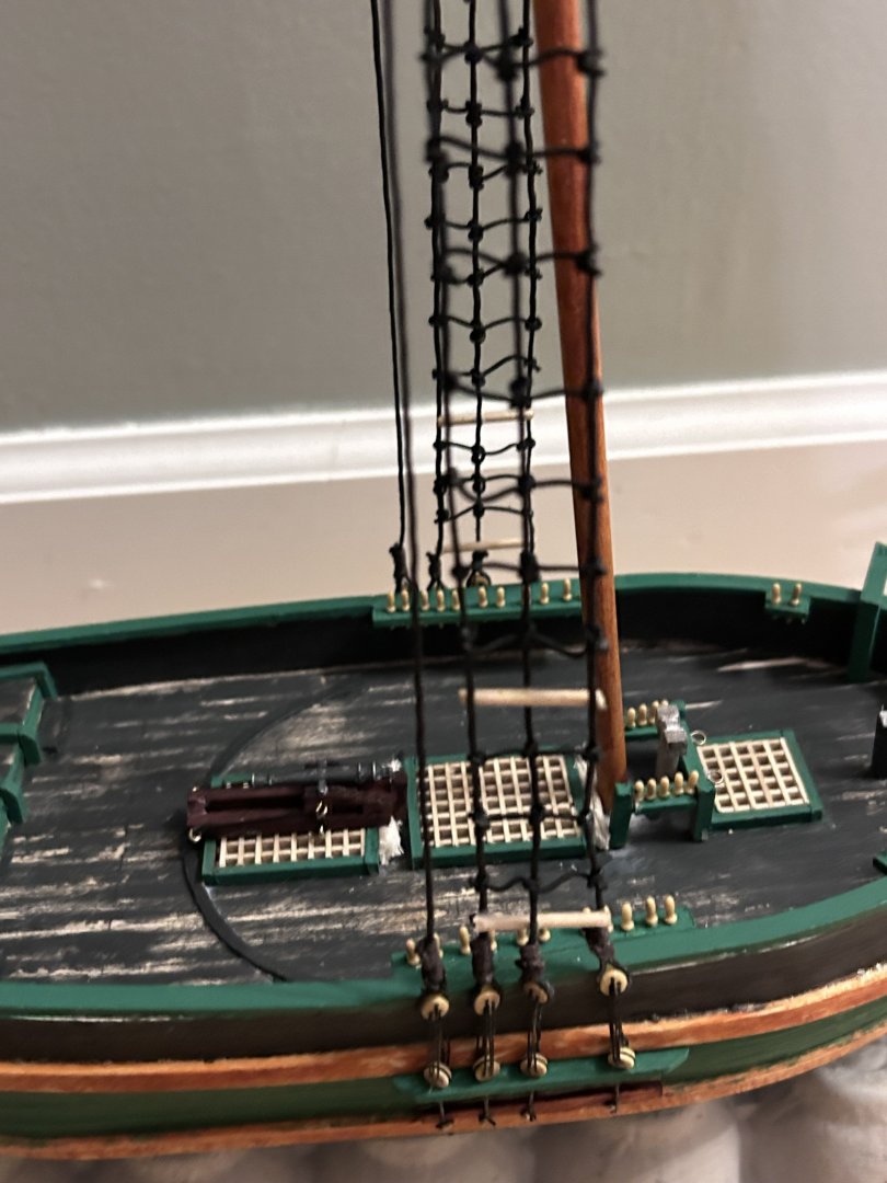

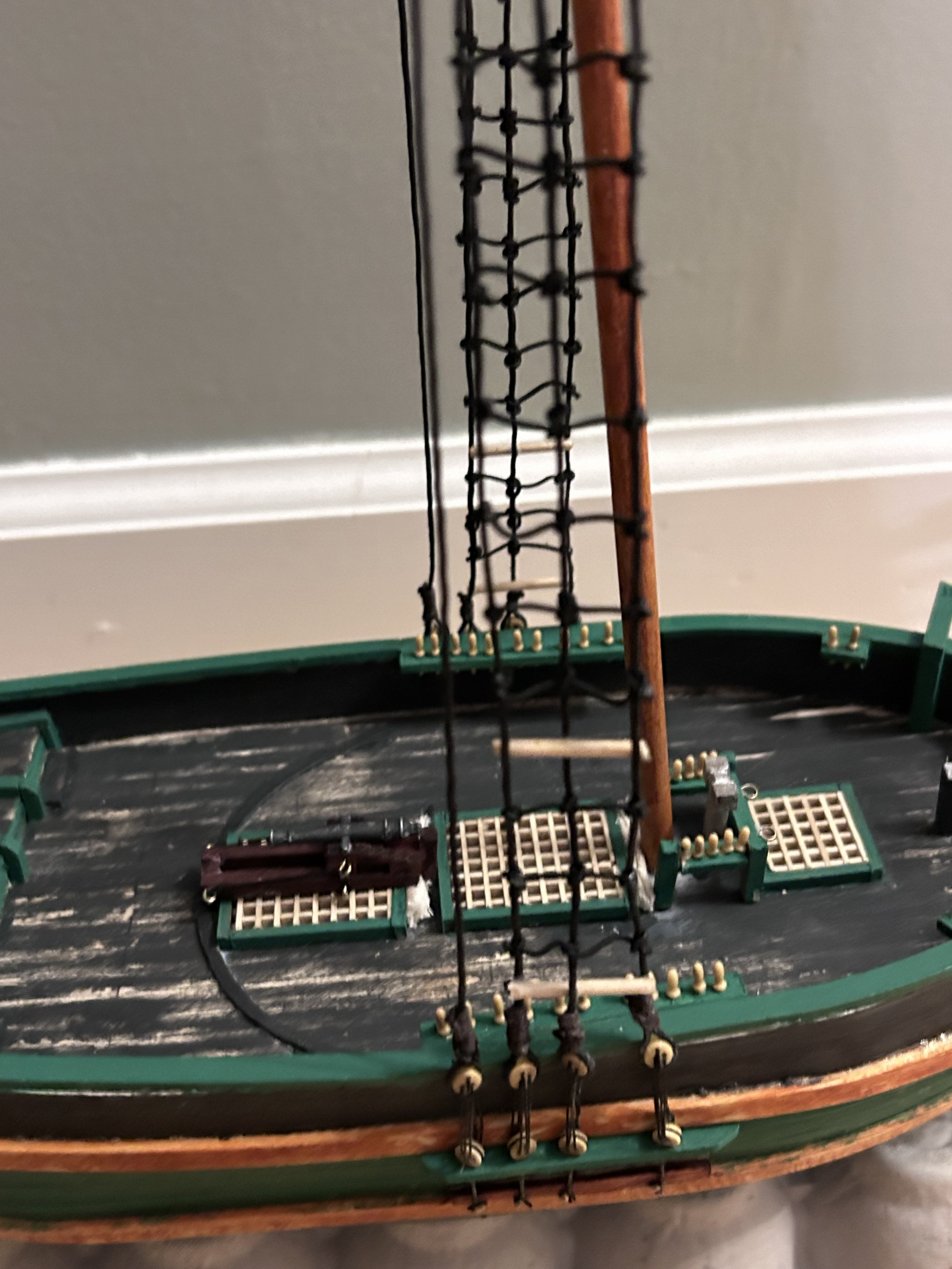

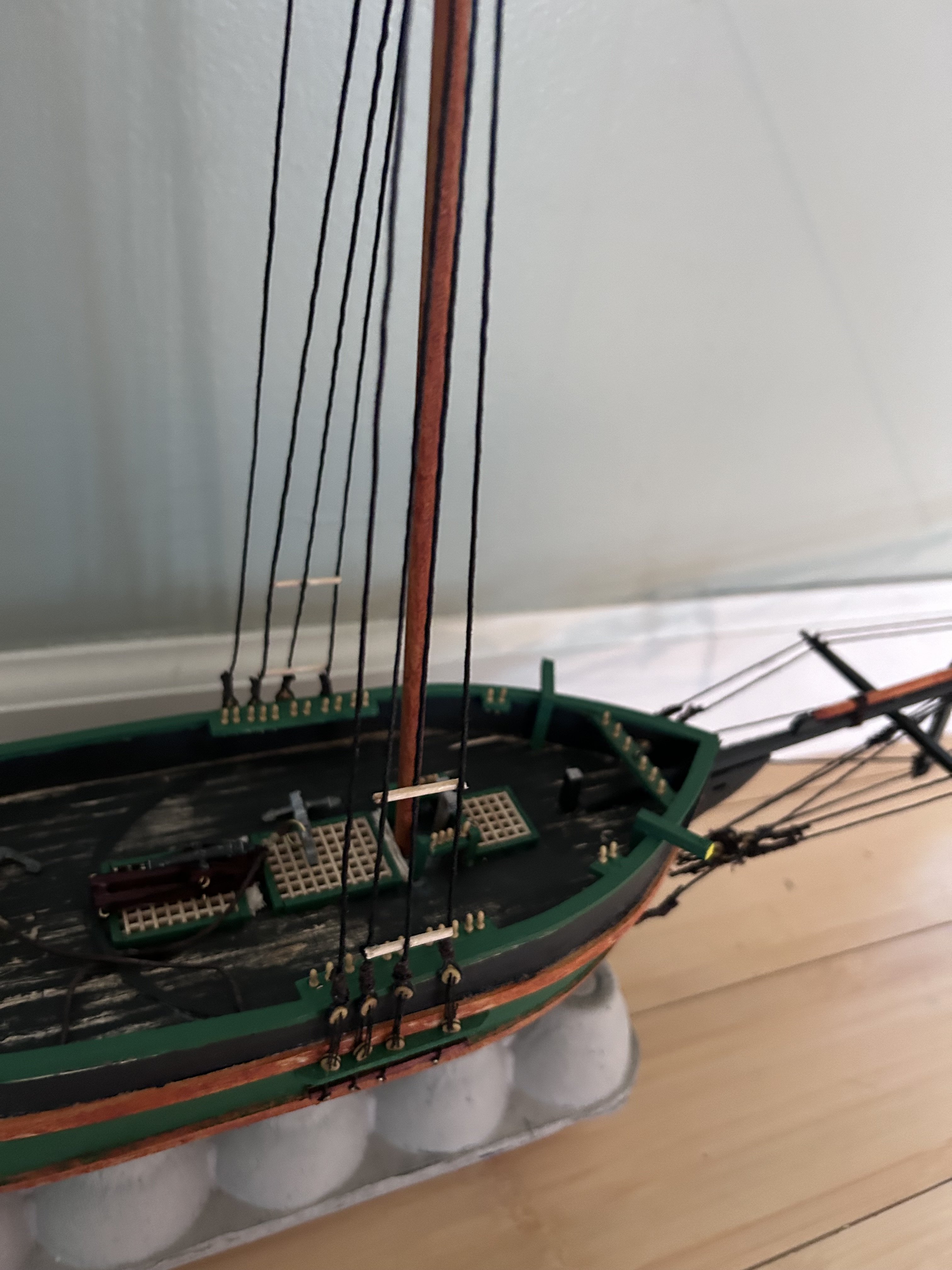

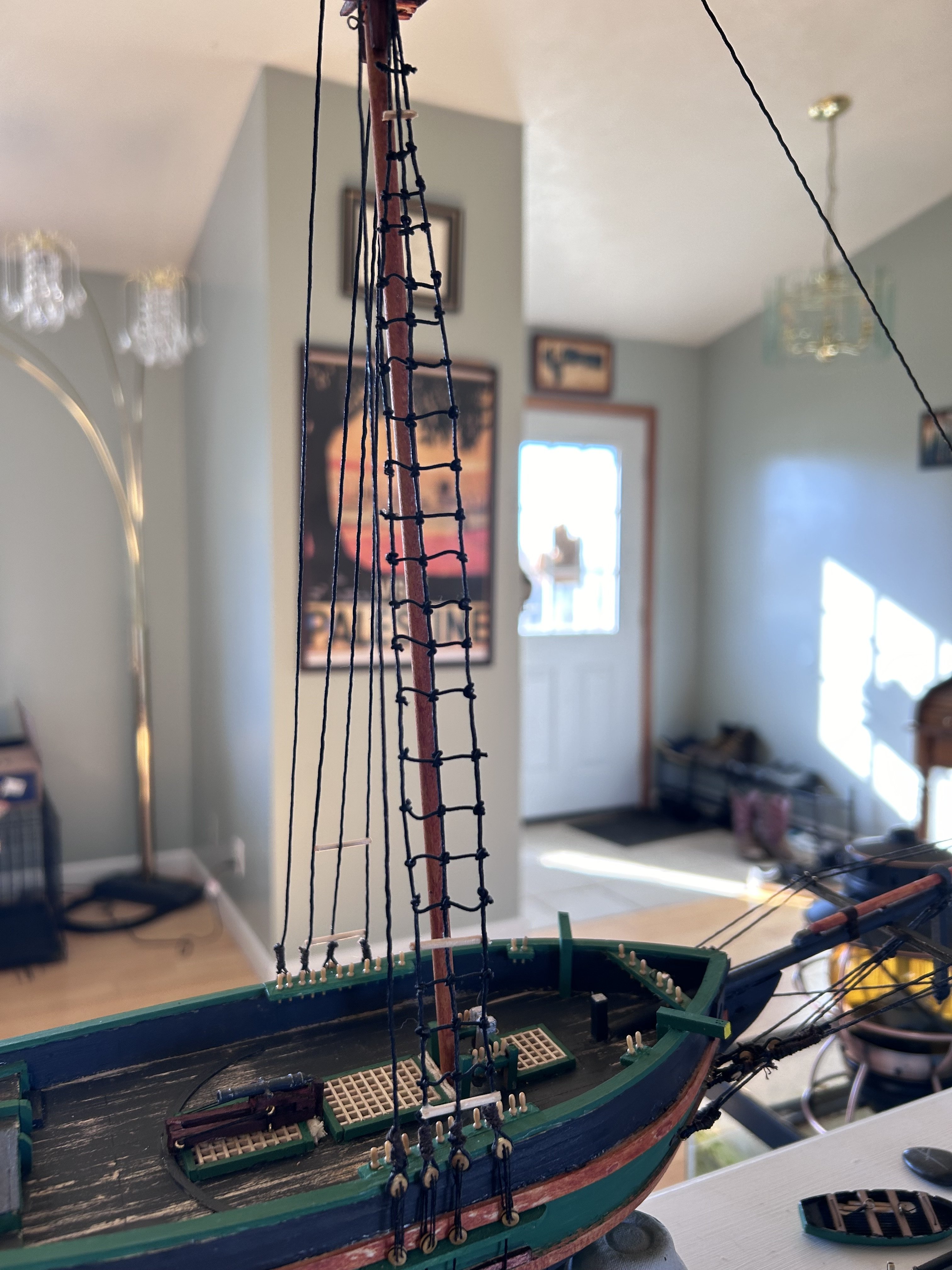

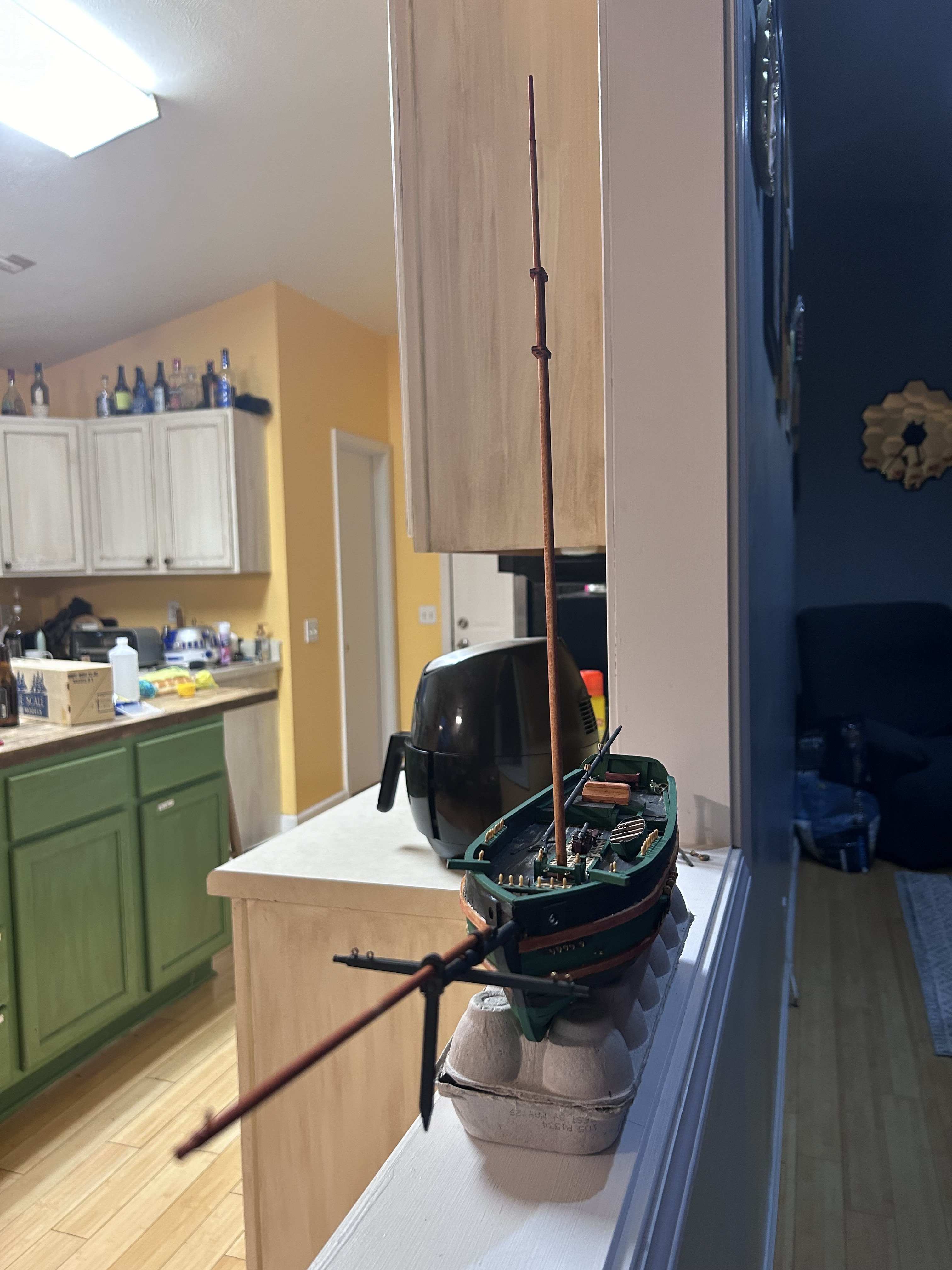

Alright, now time for the confession. This bit contains my biggest goof up and that is the use of an elastic like on the ratlines.
As I realized too late this puts too much tension on the line causing it to twist. IMG_2078.thumb.jpeg.cdaffb865ffe229908d4c3a6a8a519b8.jpeg
I ended up using toothpicks here for the lower wooden rungs on the ratlines.
Yeah… ugly. I’m still not totally happy with this and one day I’ll likely go back and fix it but I just need to will myself to cut down the rigging and start over… which is easier said than done.
With the rest of the rigging and sheets in place though this problem is not as noticeable as you’ll see in future comments.

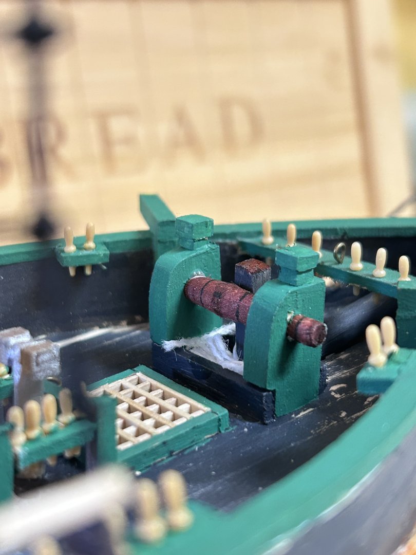

Deck detail.
So first up I had to create a windless that matched the style of the ship’s while also maintaining the scale. This was the result. Other than it being a little taller than the real life version it stands as a faithful recreation. IMG_2119.thumb.jpeg.f23f1da38e54b5322c77de6e79877a22.jpeg

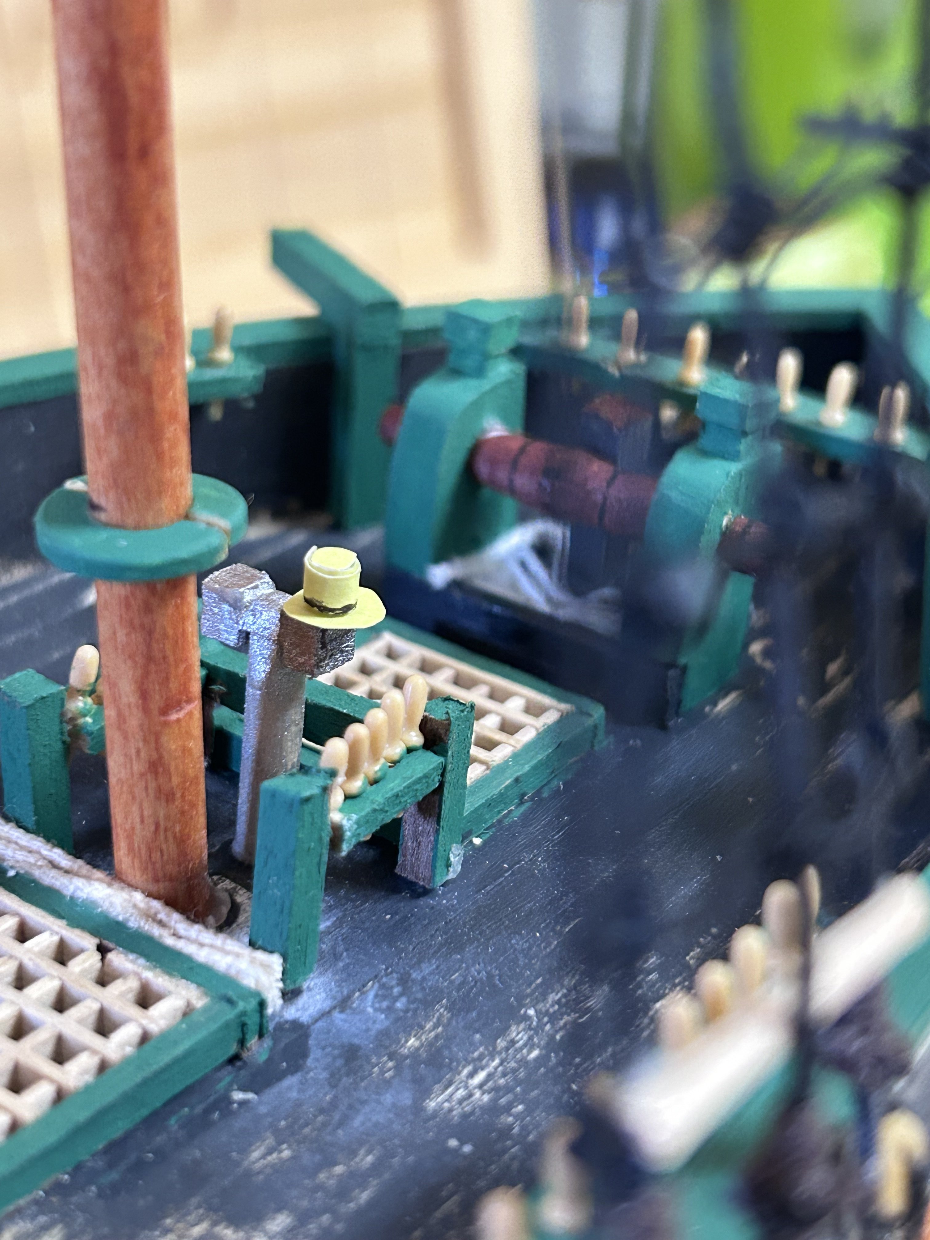

And what model would be complete without a few nods to friends. The friend who made my jacket regularly leaves his hat on the ship’s stovepipe so I wanted to throw it in as a little tribute to him.

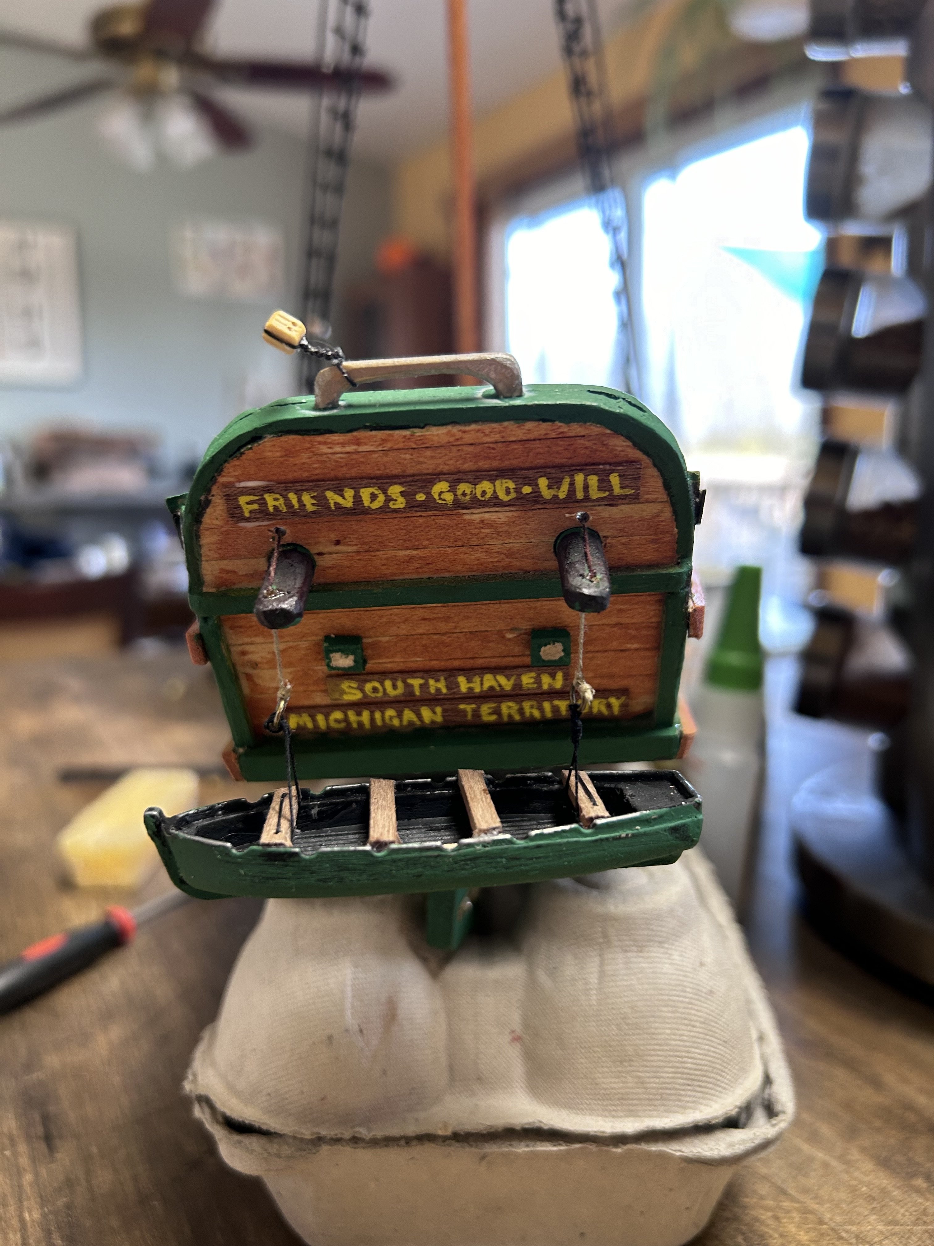

Finally we have the ship’s name plate and the small boat the Little Belt. While the recreation has an inflatable dinghy on the rear I, of course, wanted to spring for something a little more authentic (and make use of the small boat included in the Albatros)
Much like the ratlines this is another one of those things that sits on the to do list to be redone at a later date with gold sticker letters.

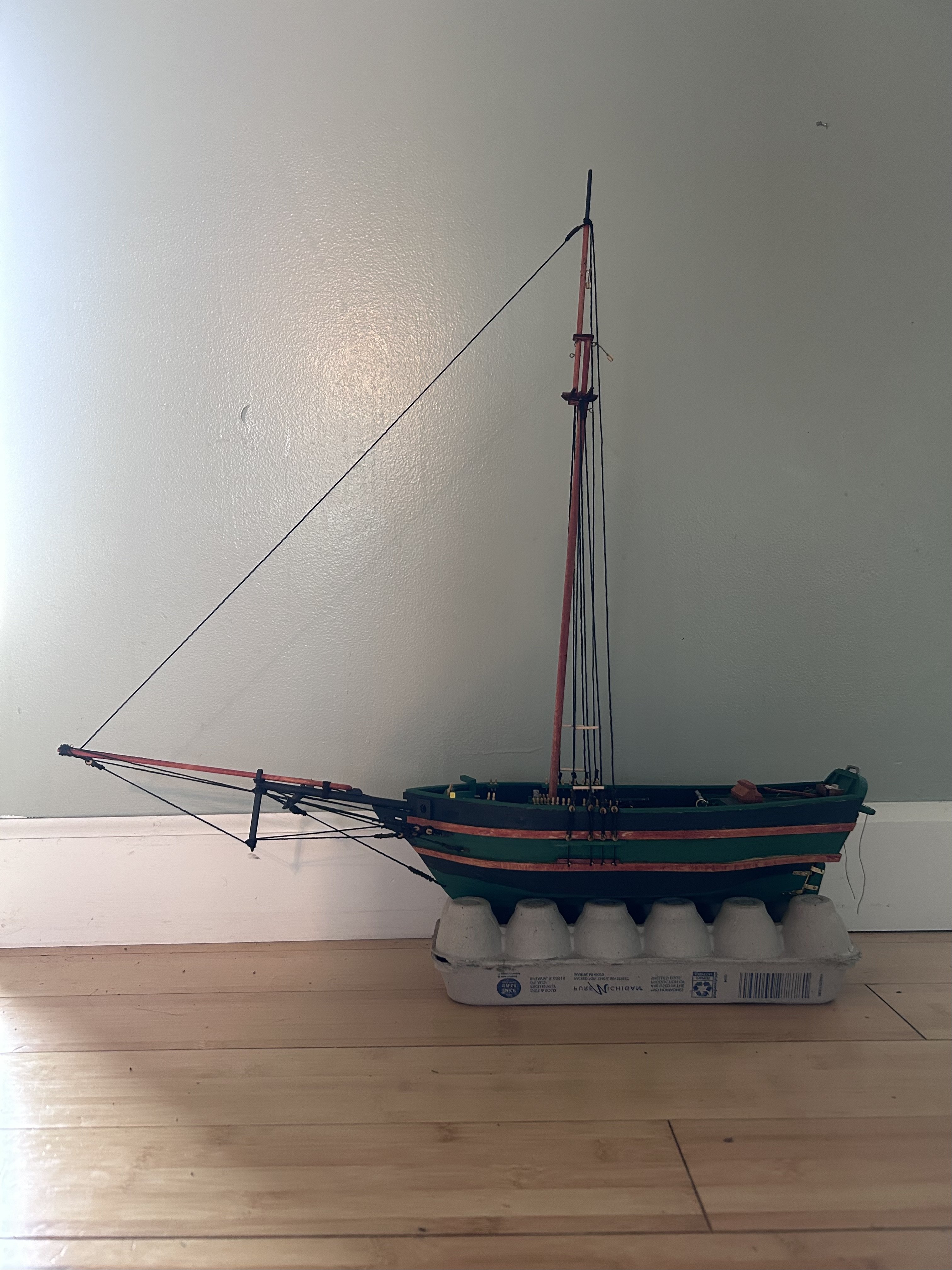

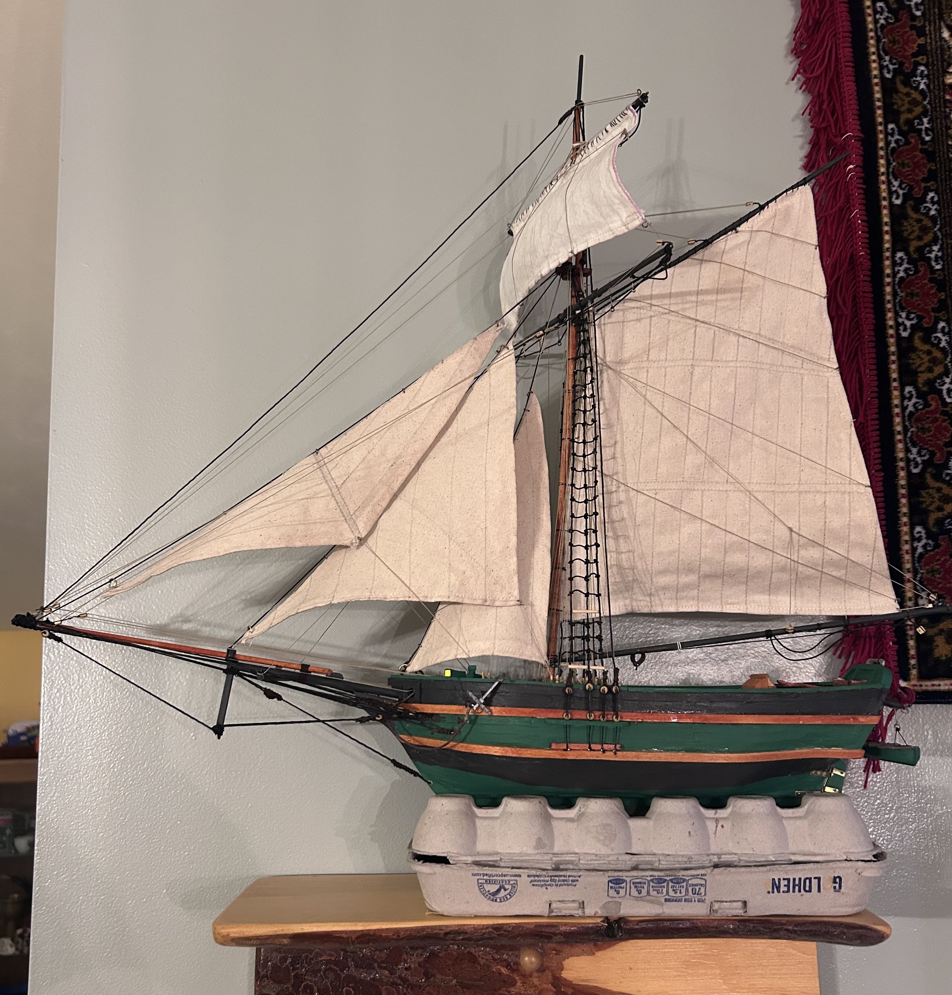

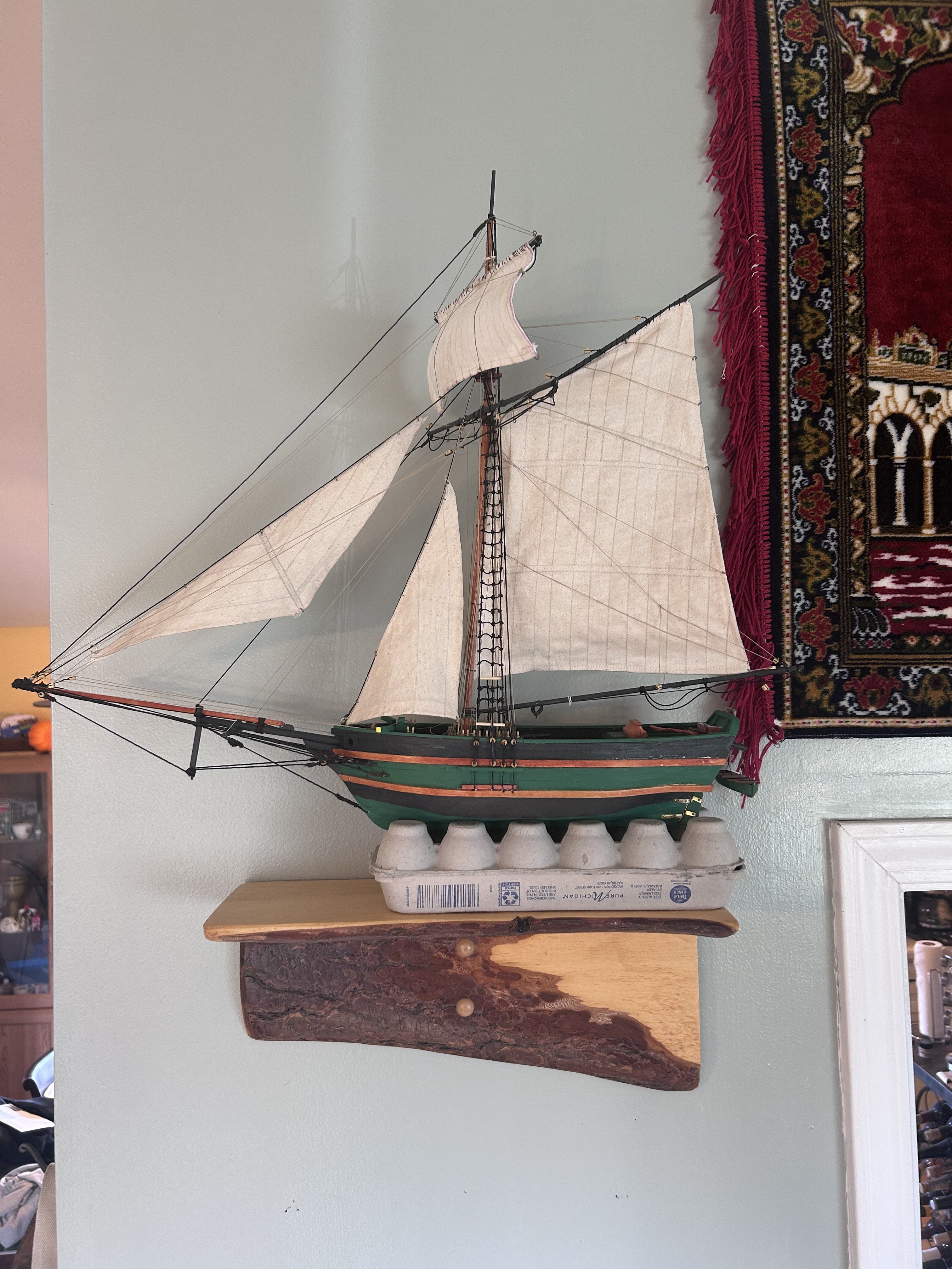

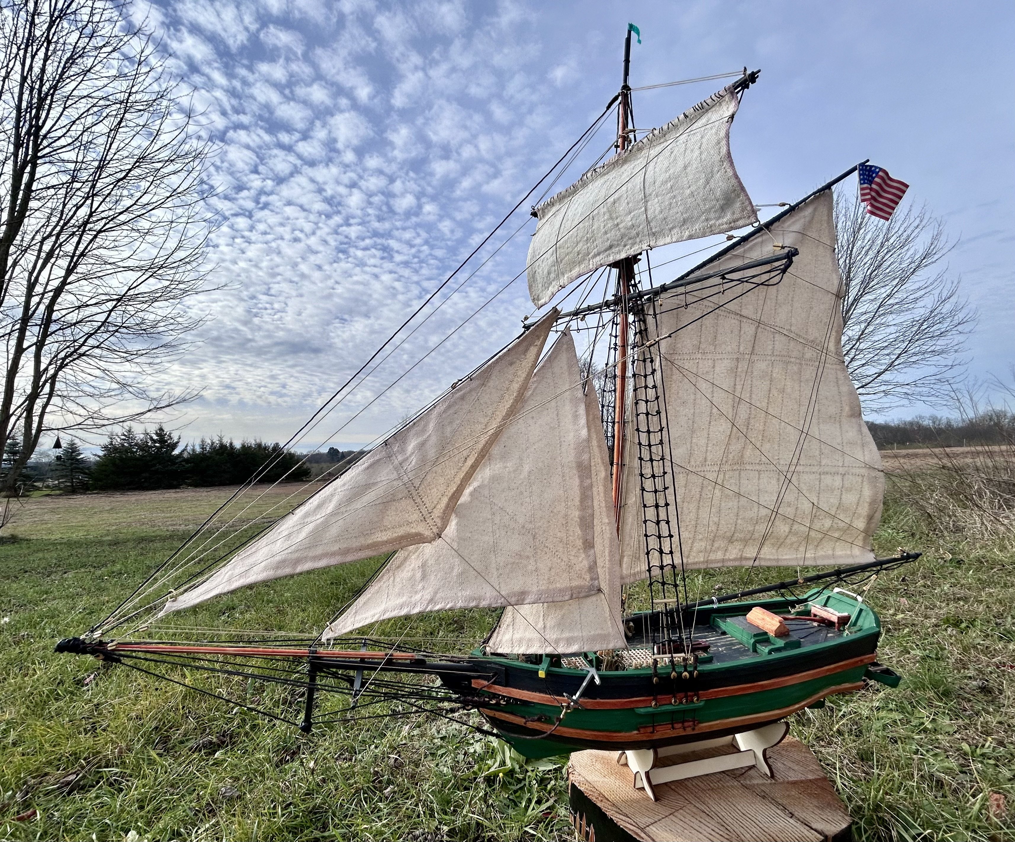

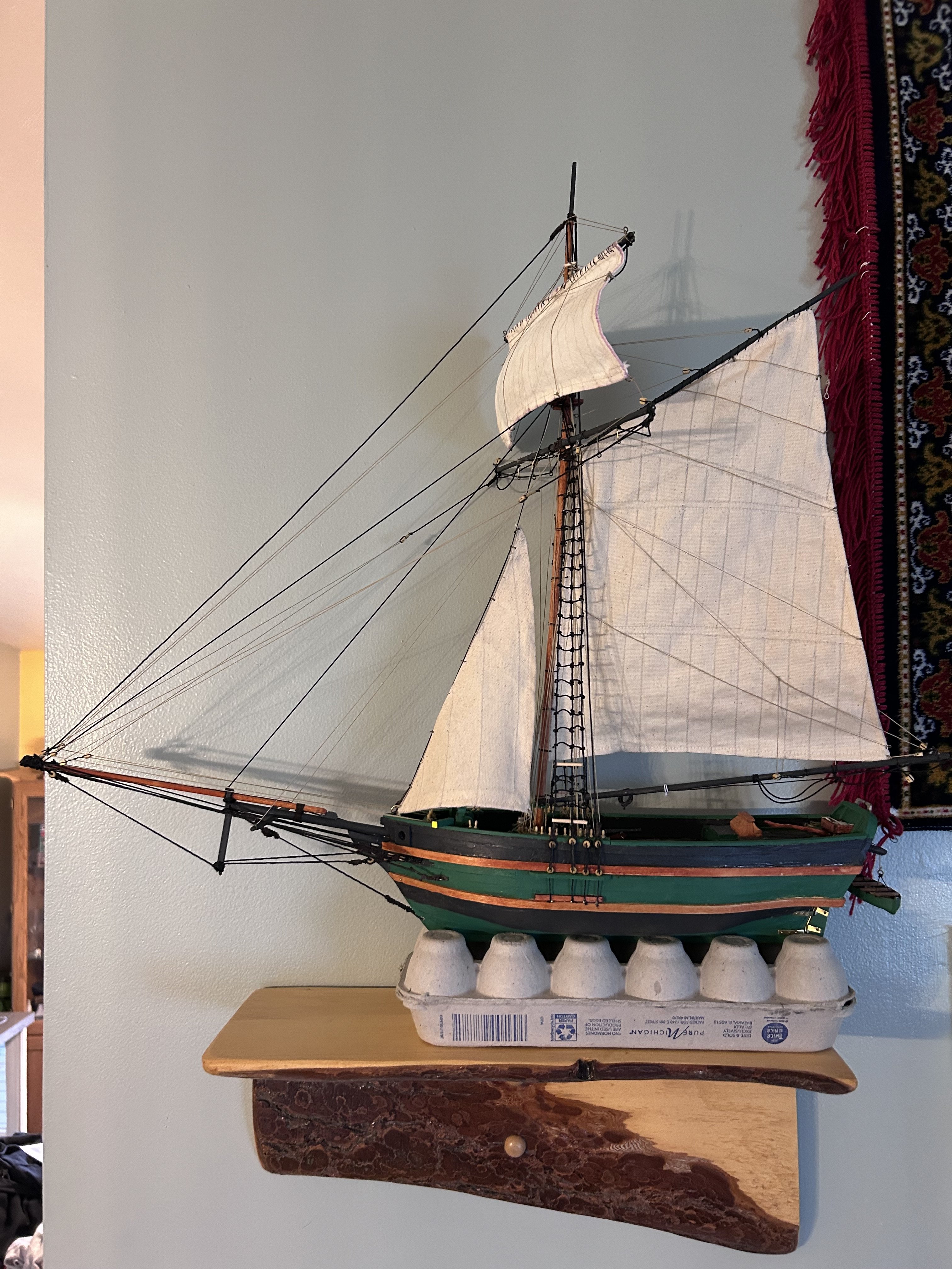

And finally we arrive at the rigging and sheets.
From the top, main, and staysail. IMG_2280.thumb.jpeg.33e9dc06b6855c93e84d43884c985338.jpeg
And finally the inner. IMG_2282.thumb.jpeg.a0b7db53d8d59aea76c8646b6a682b2d.jpeg
These properly scaled sheets were made for me by a friend who recently passed from a sudden heart attack. I’m grateful to her for this gift and it’s a nice way to honor her memory to have it included in my finished model.
As I said at the beginning, I completed this model in November of 2024 and it stands as one of the best pieces I’ve done in terms of lessons learned.
The ship is mounted on a piece of retired topsail yard from the original ship which I feel gives it a little extra personality.
Thanks for reading along, next time I’ll have an actual log to follow along with as opposed to this log which has been retroactively reassembled.
