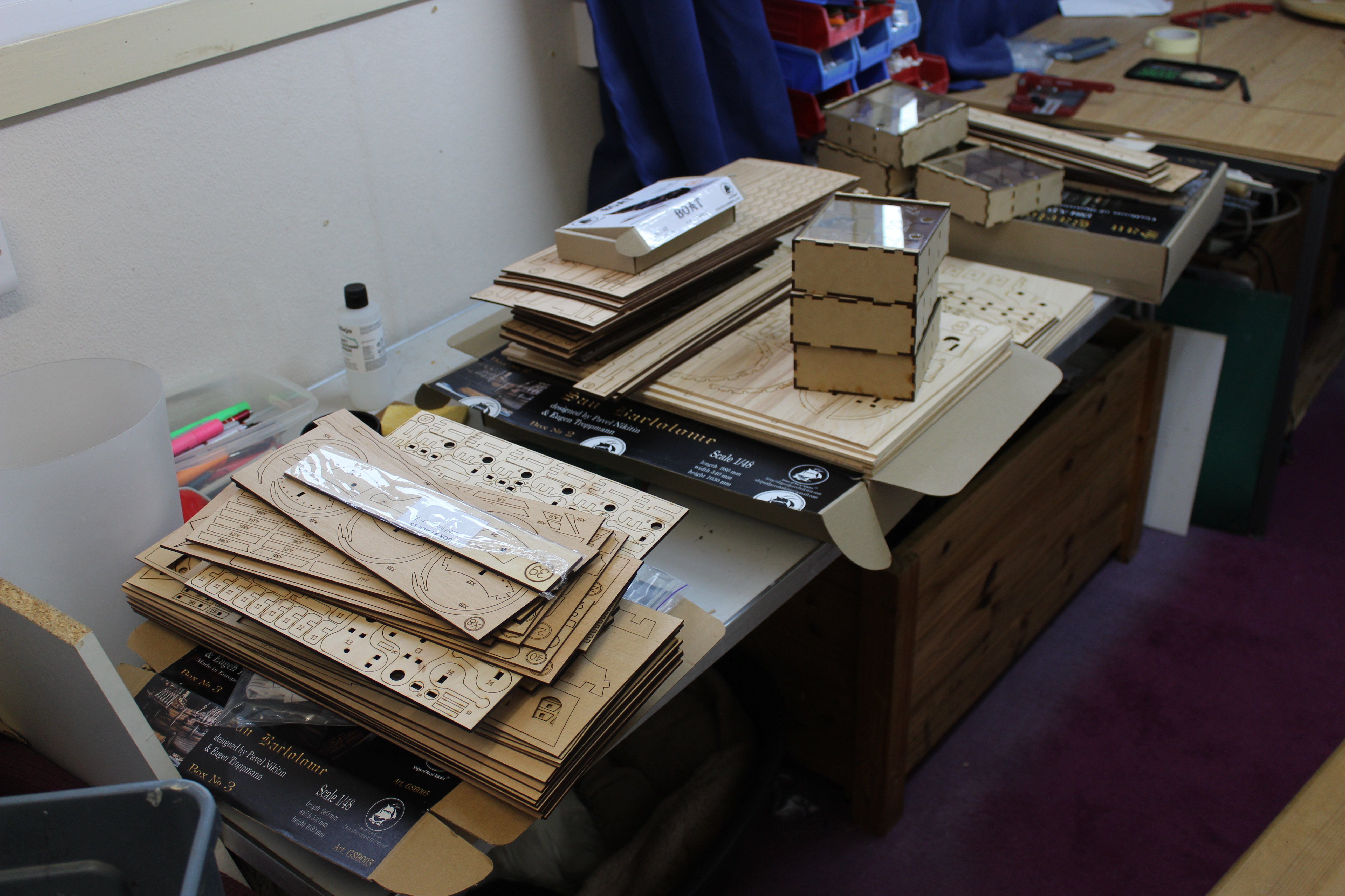

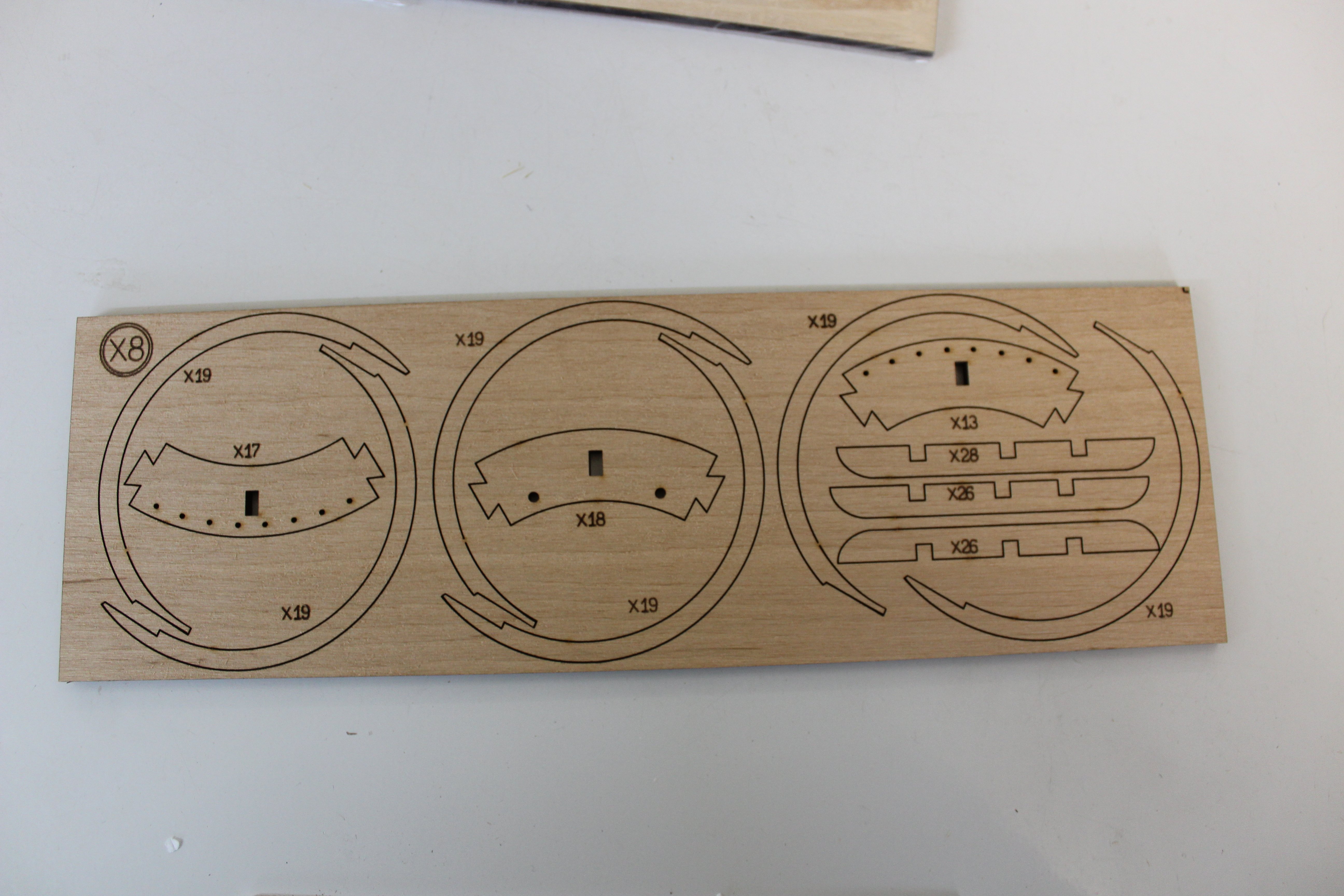

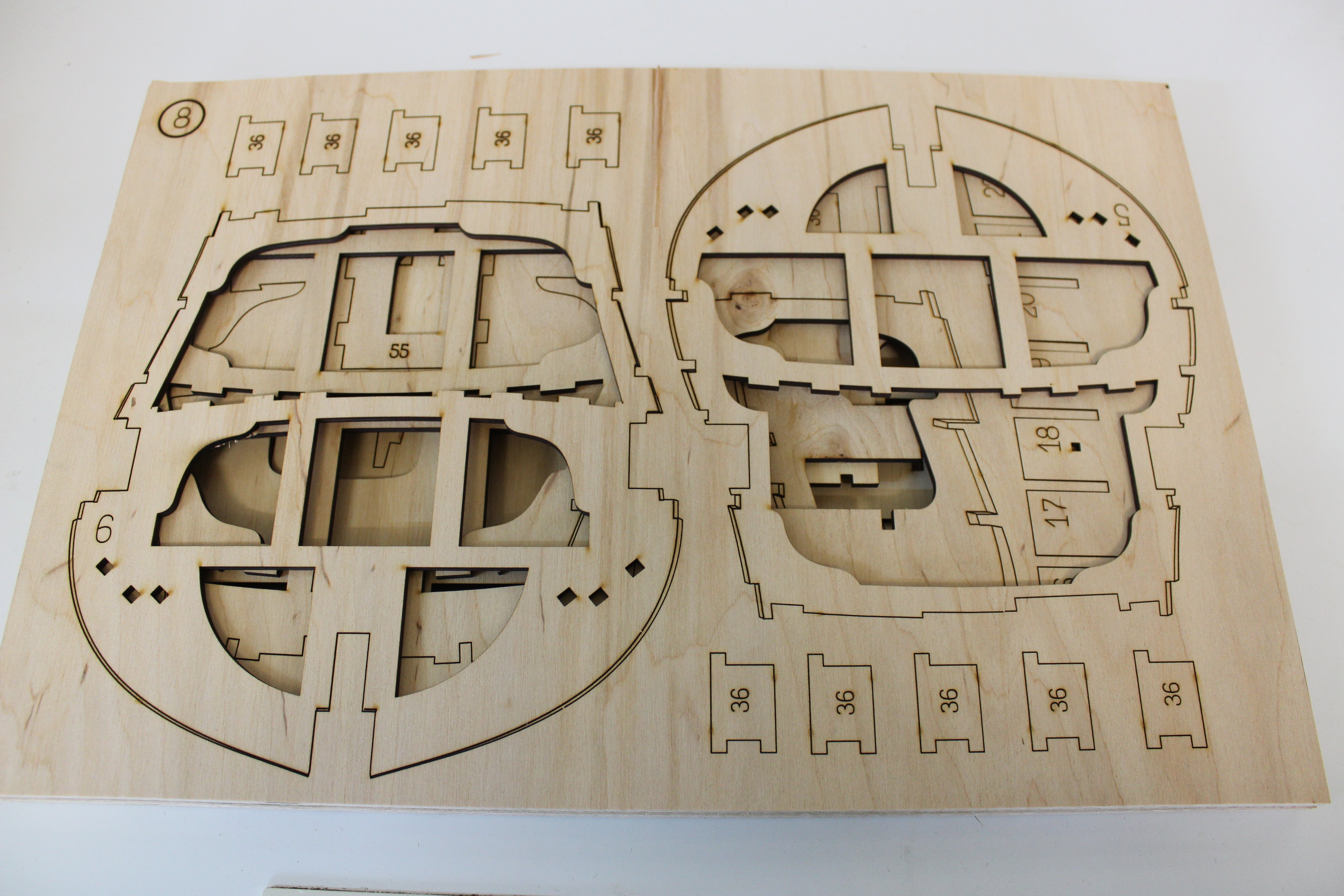

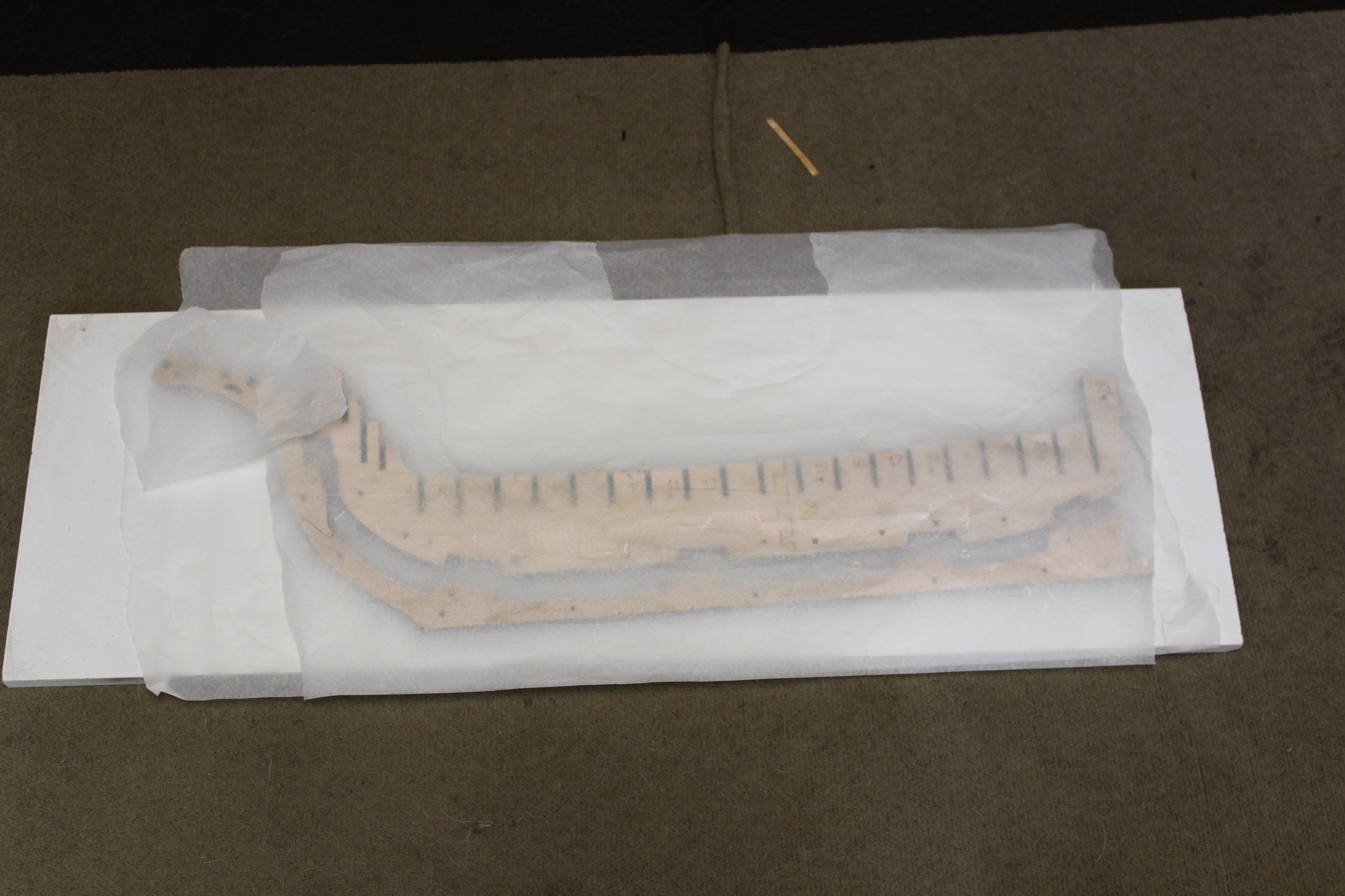

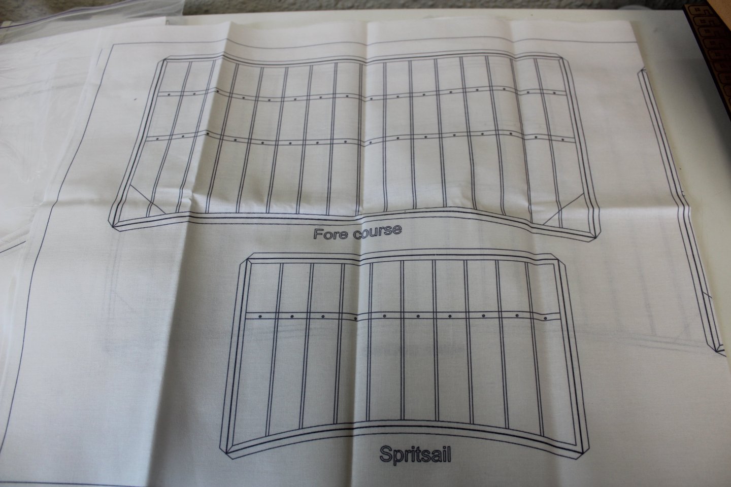

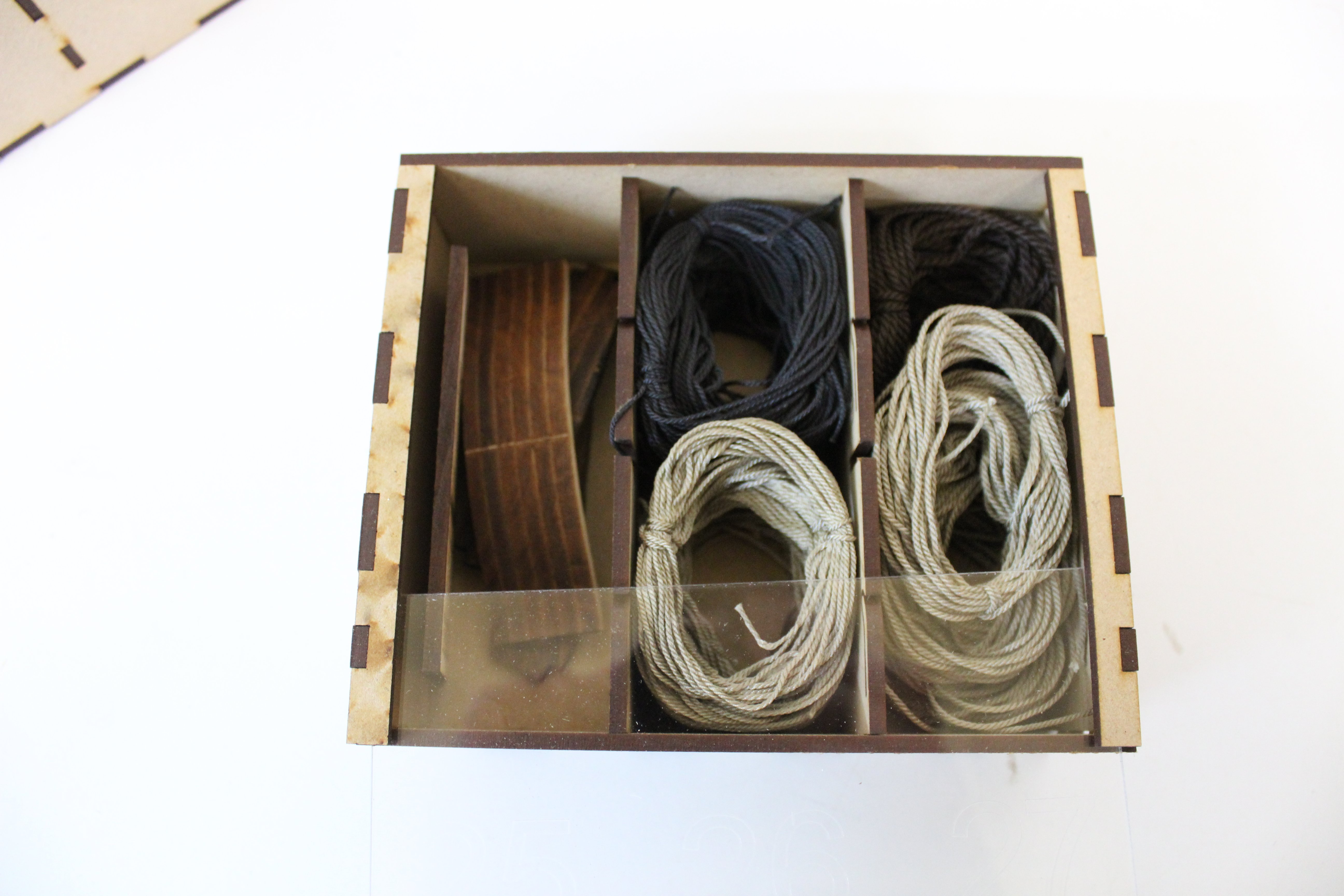

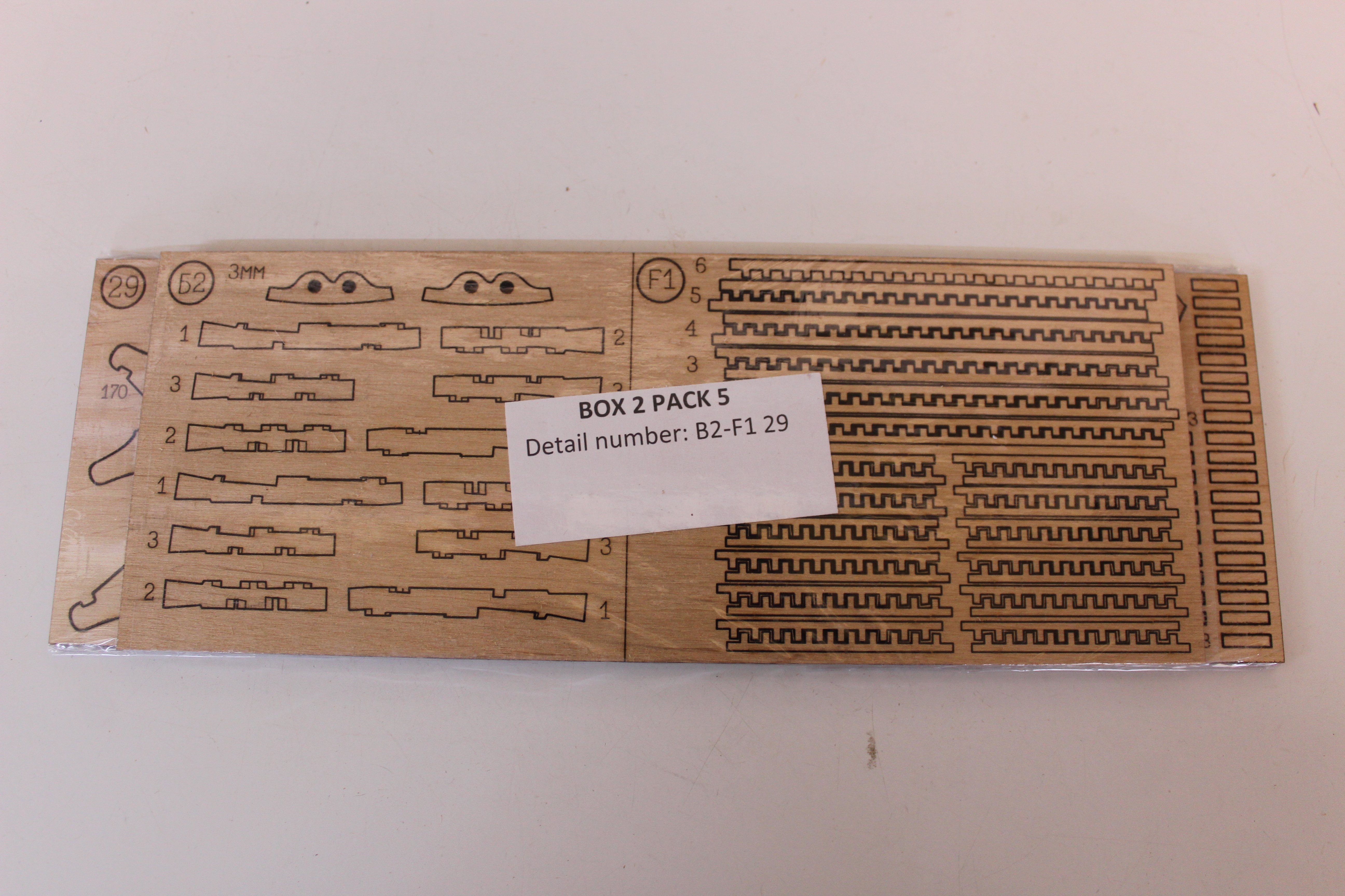

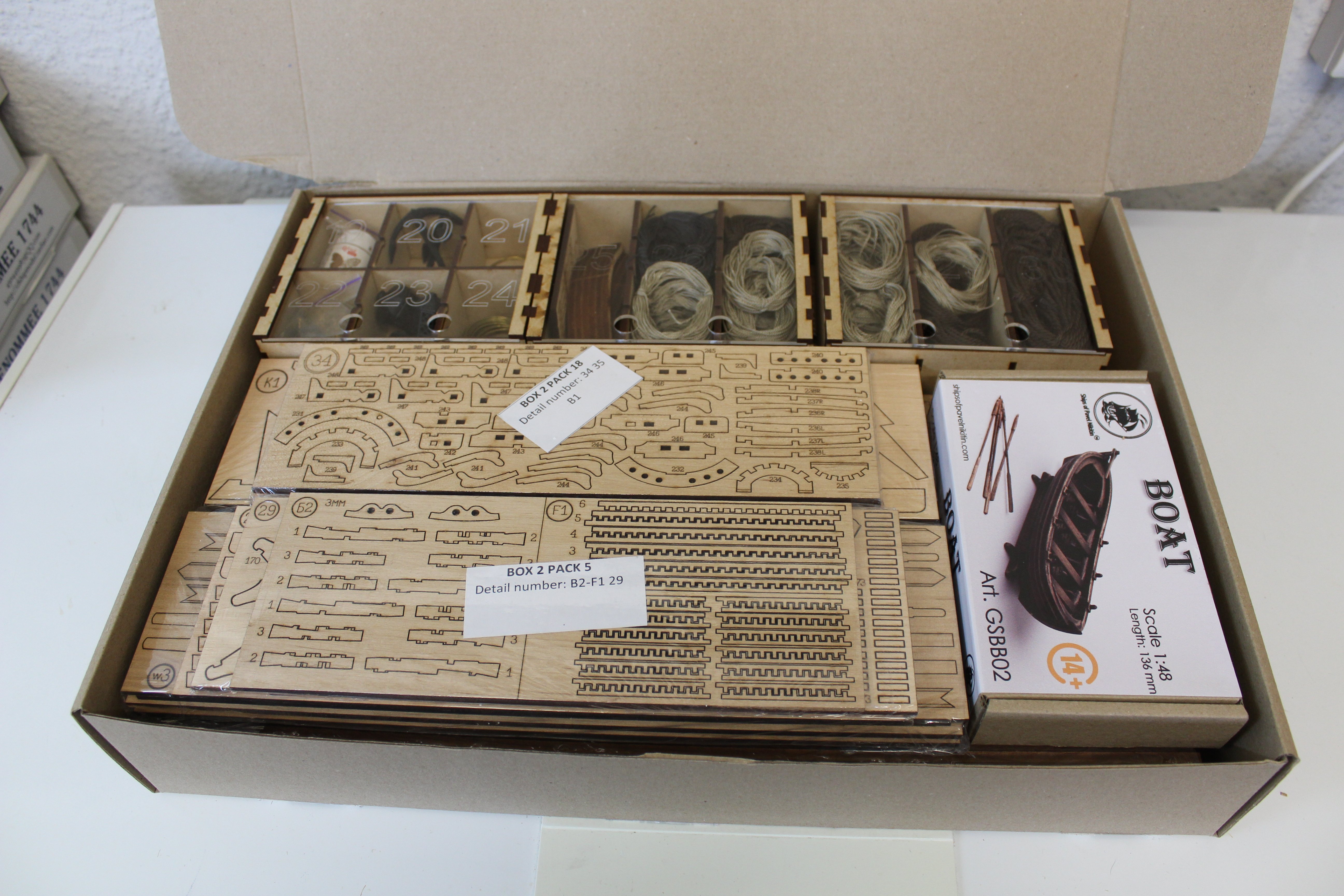

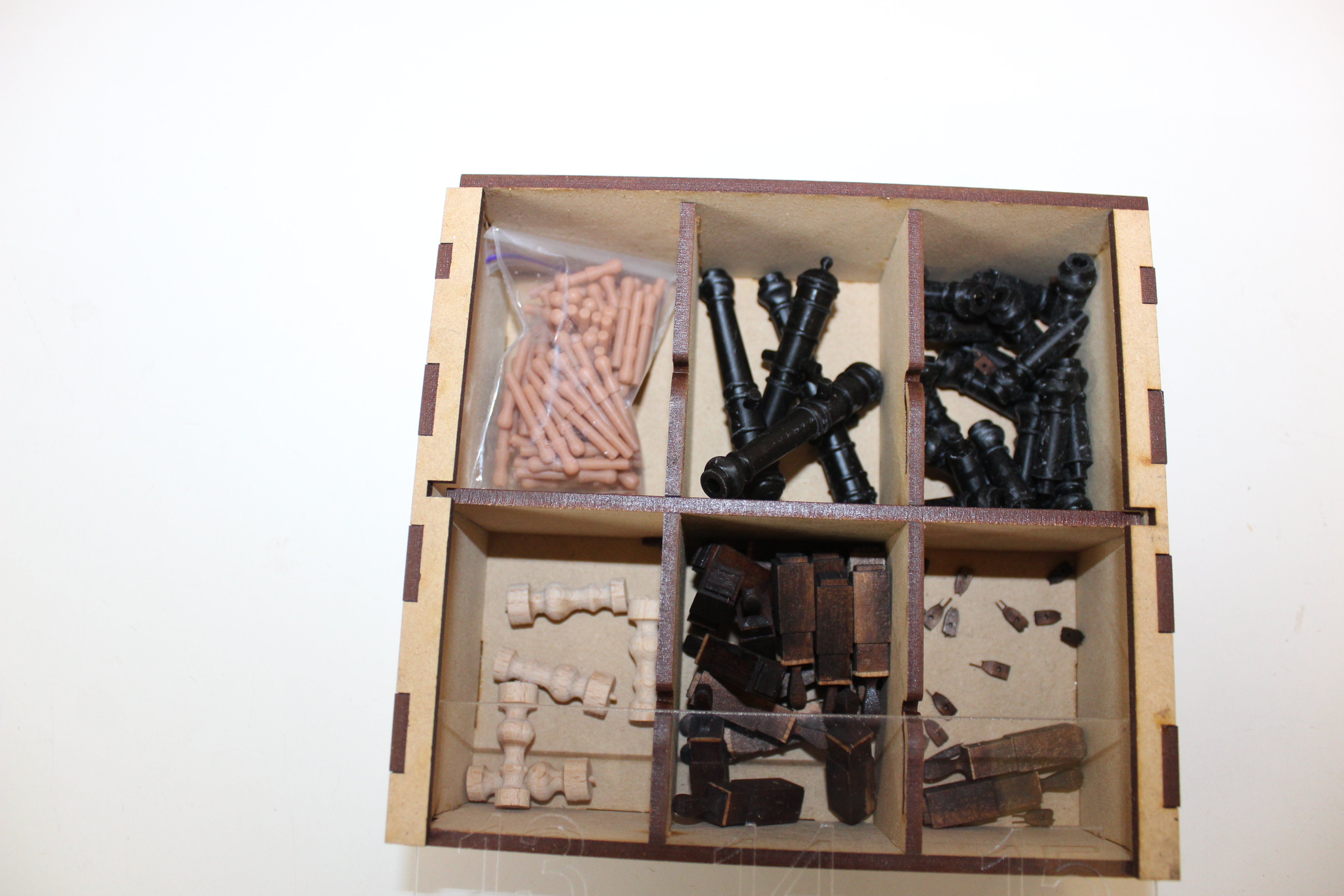

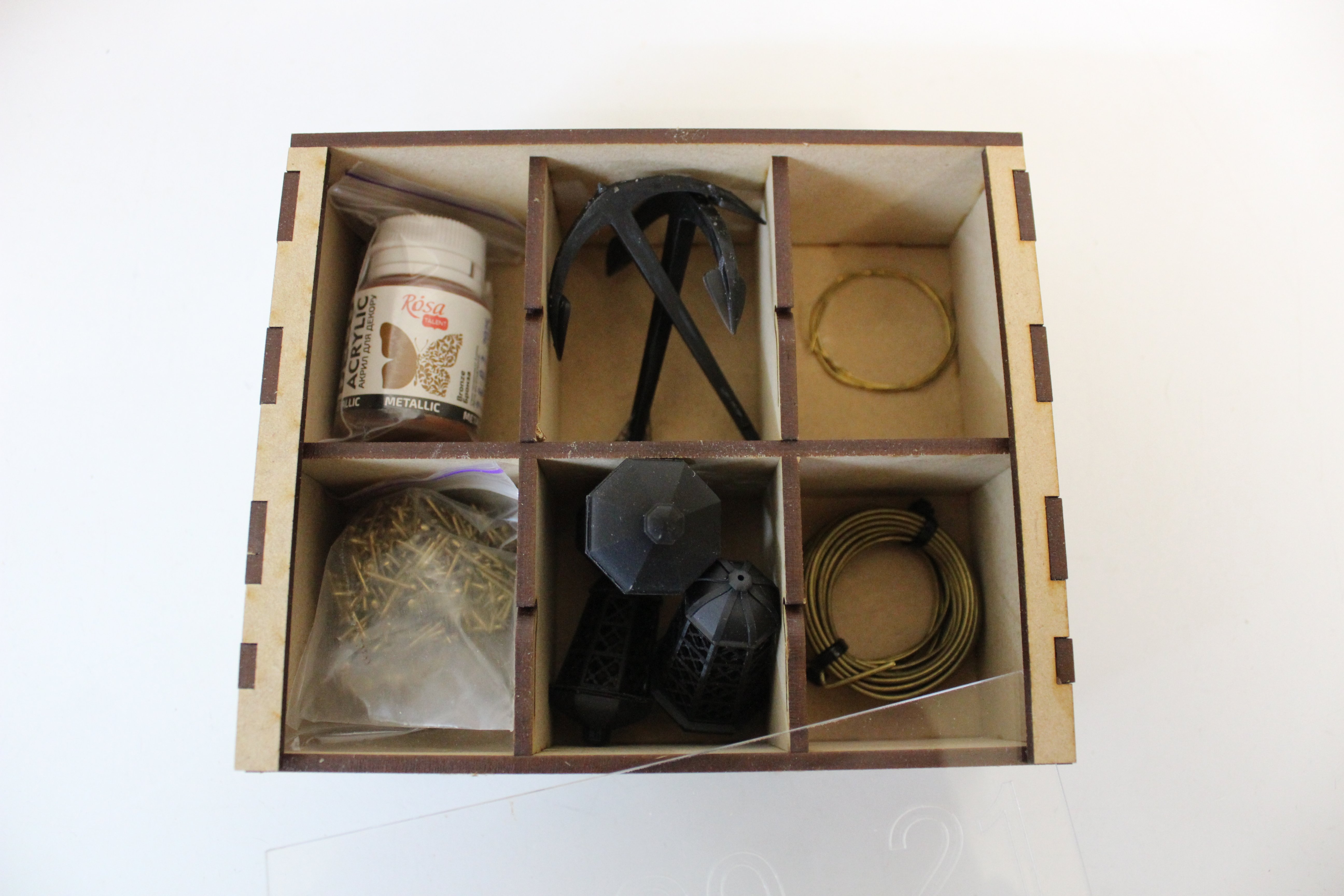

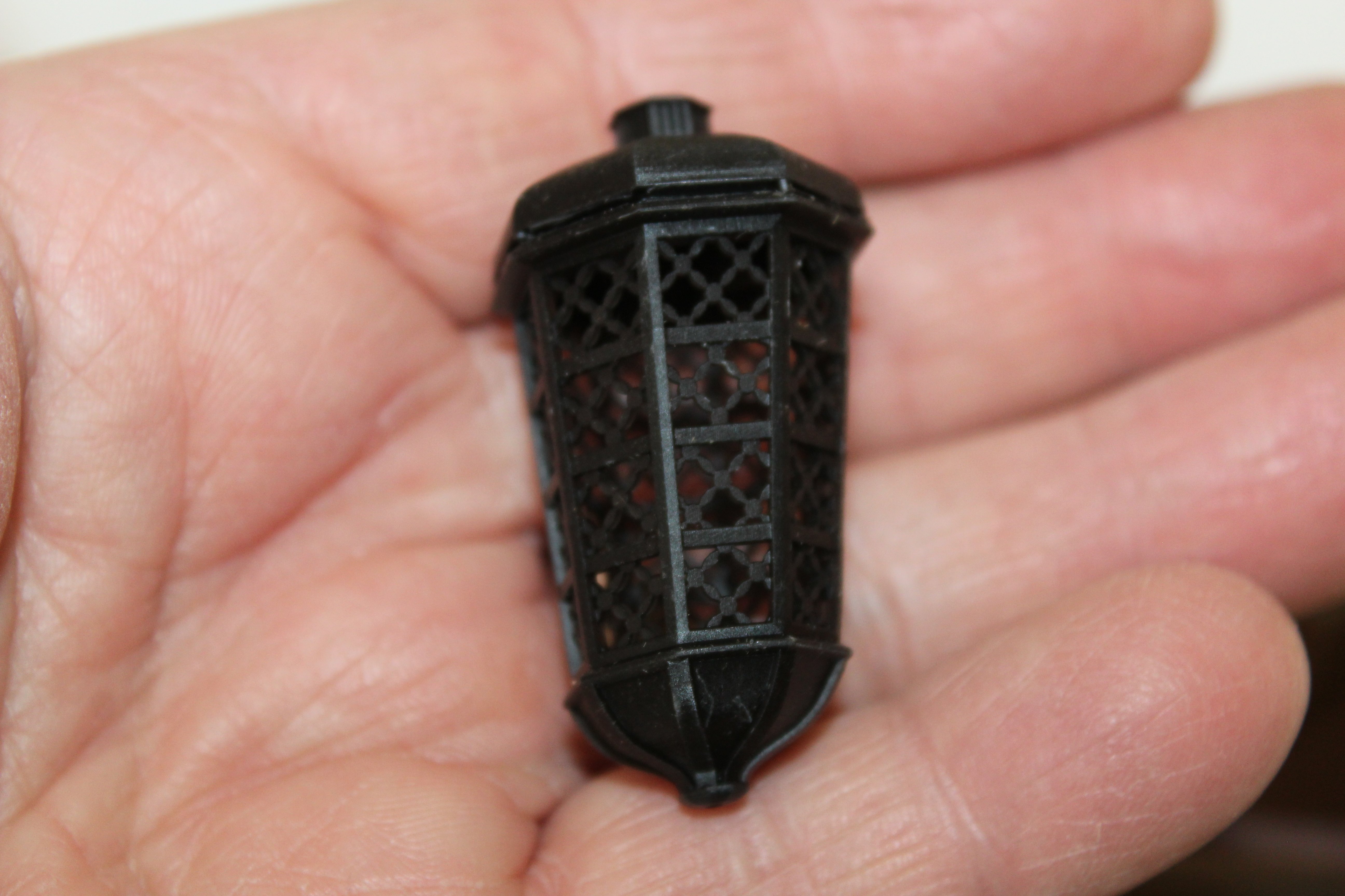

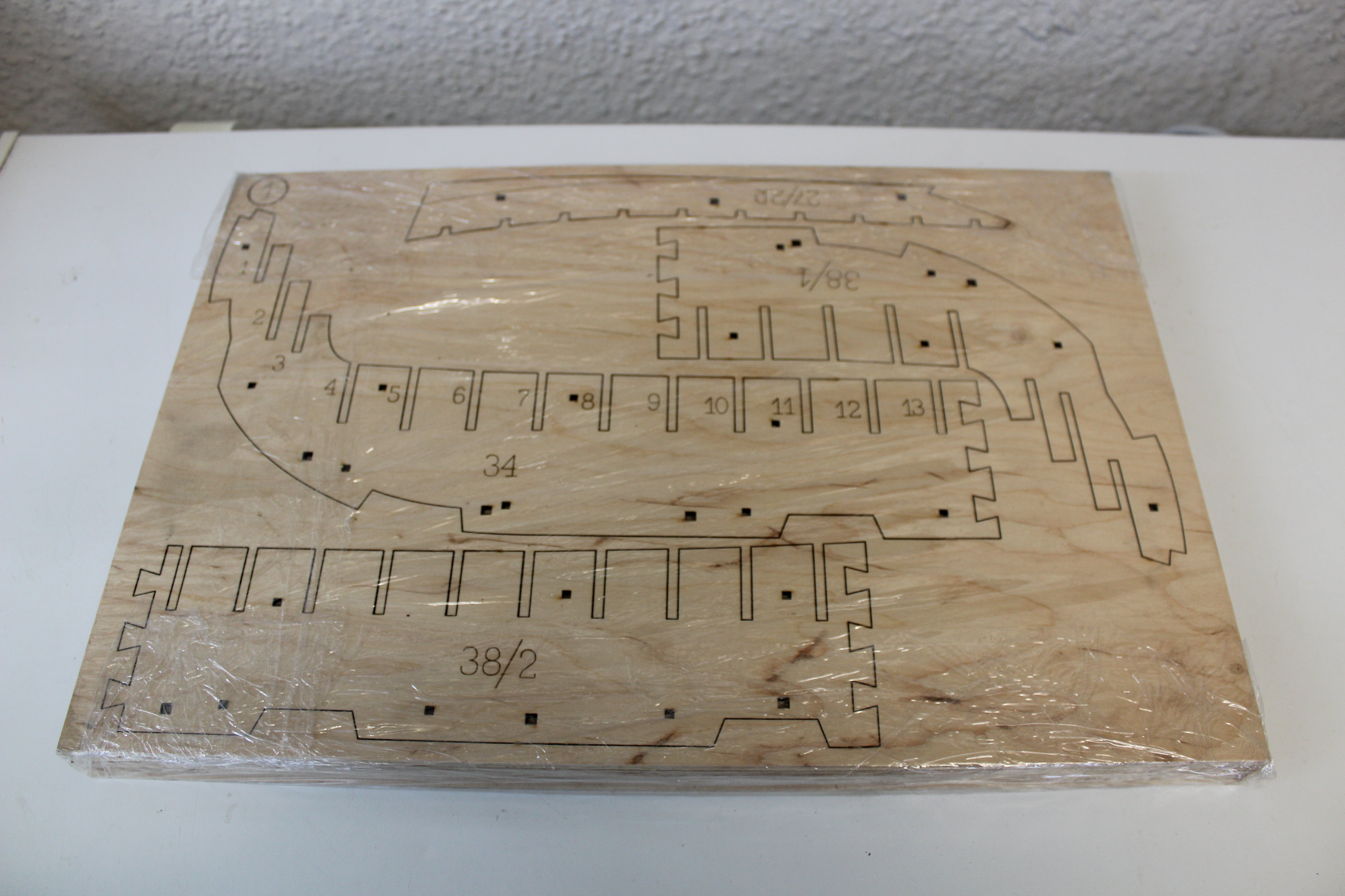

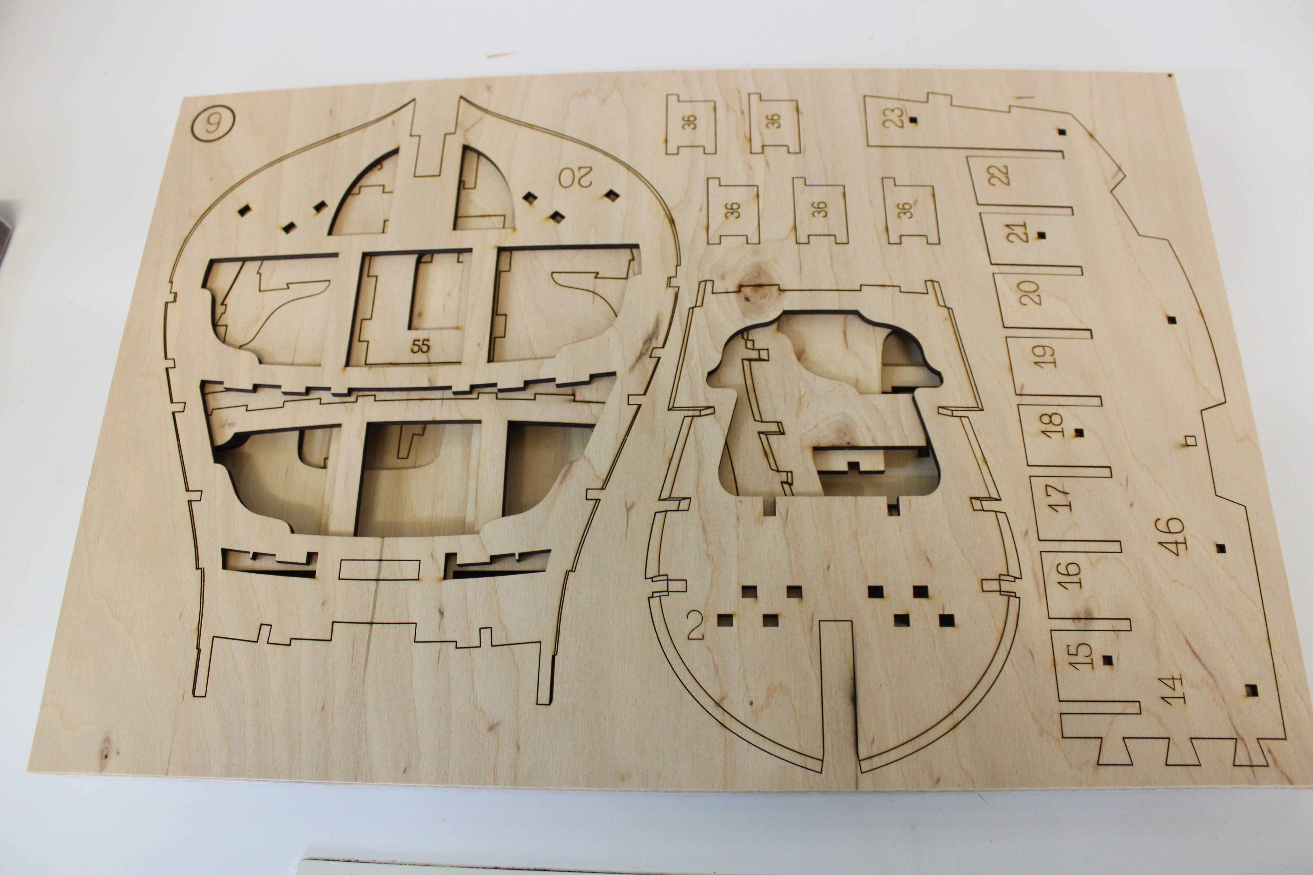

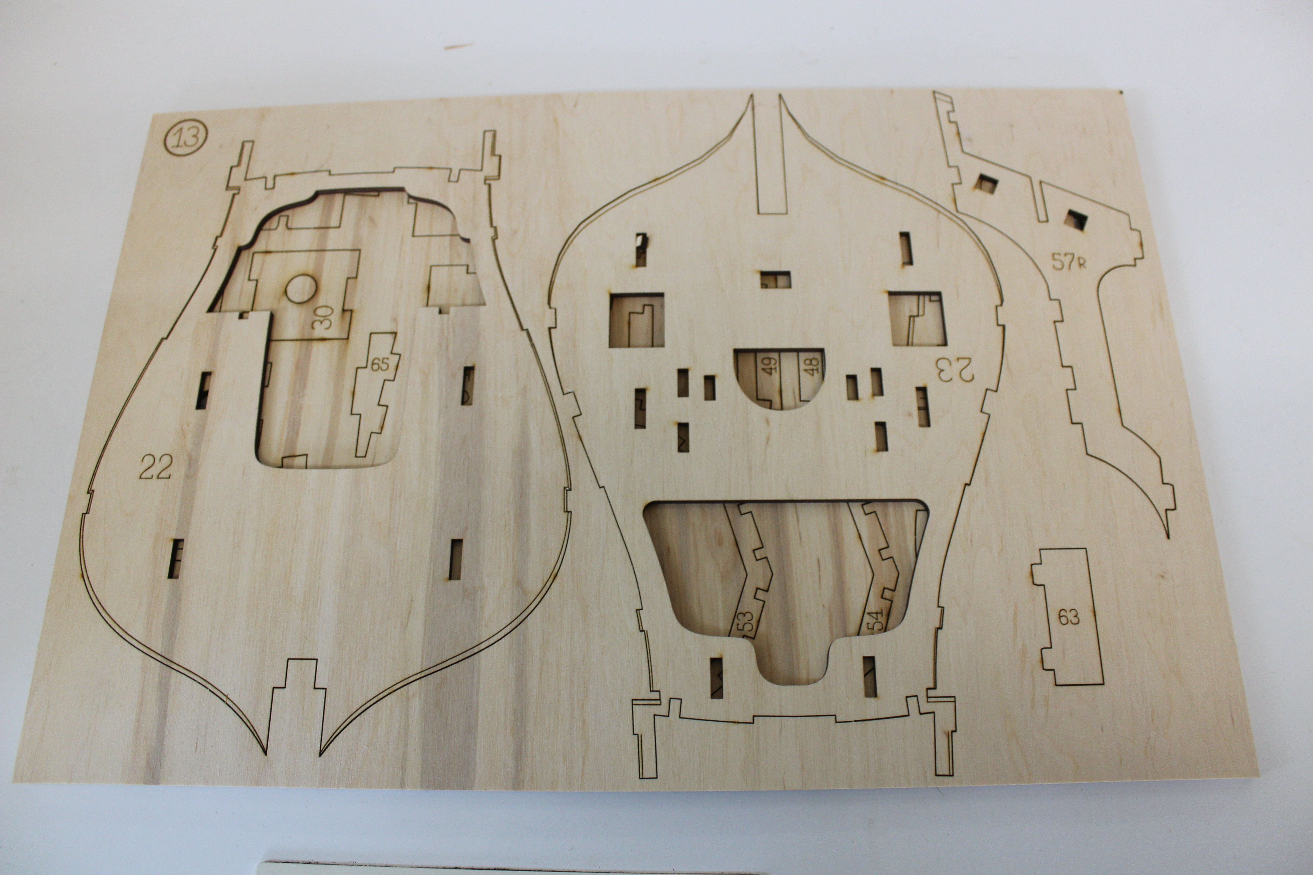

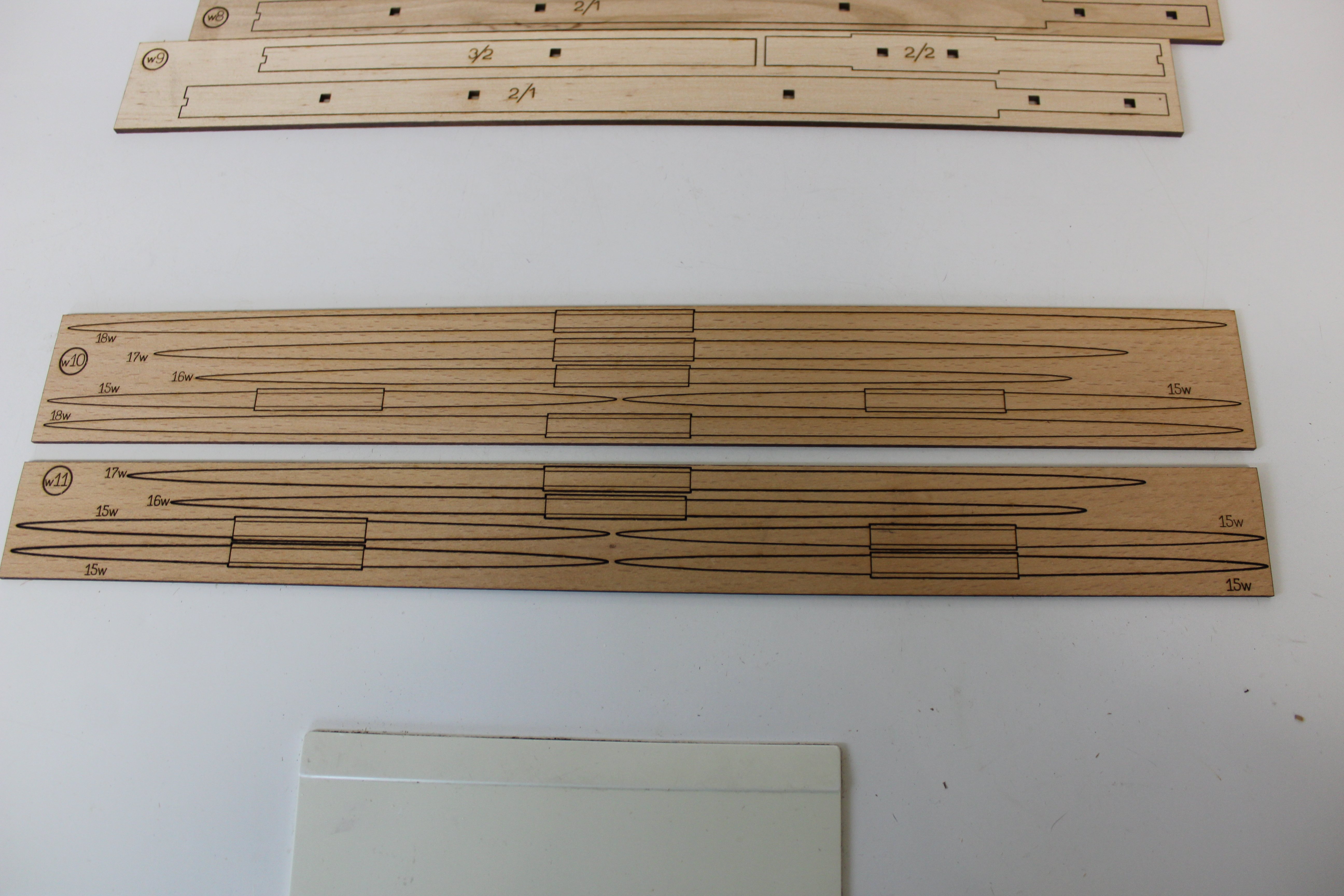

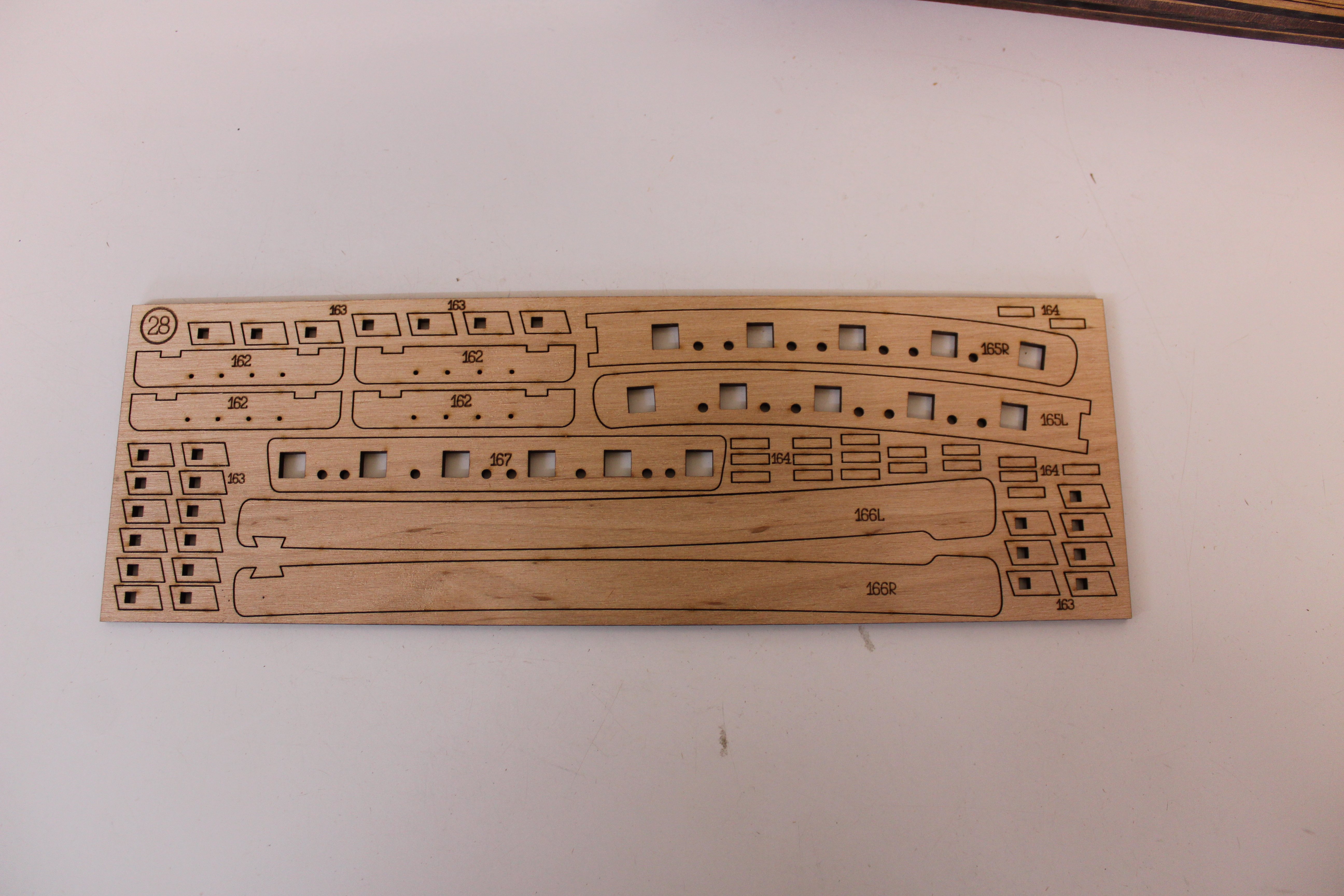

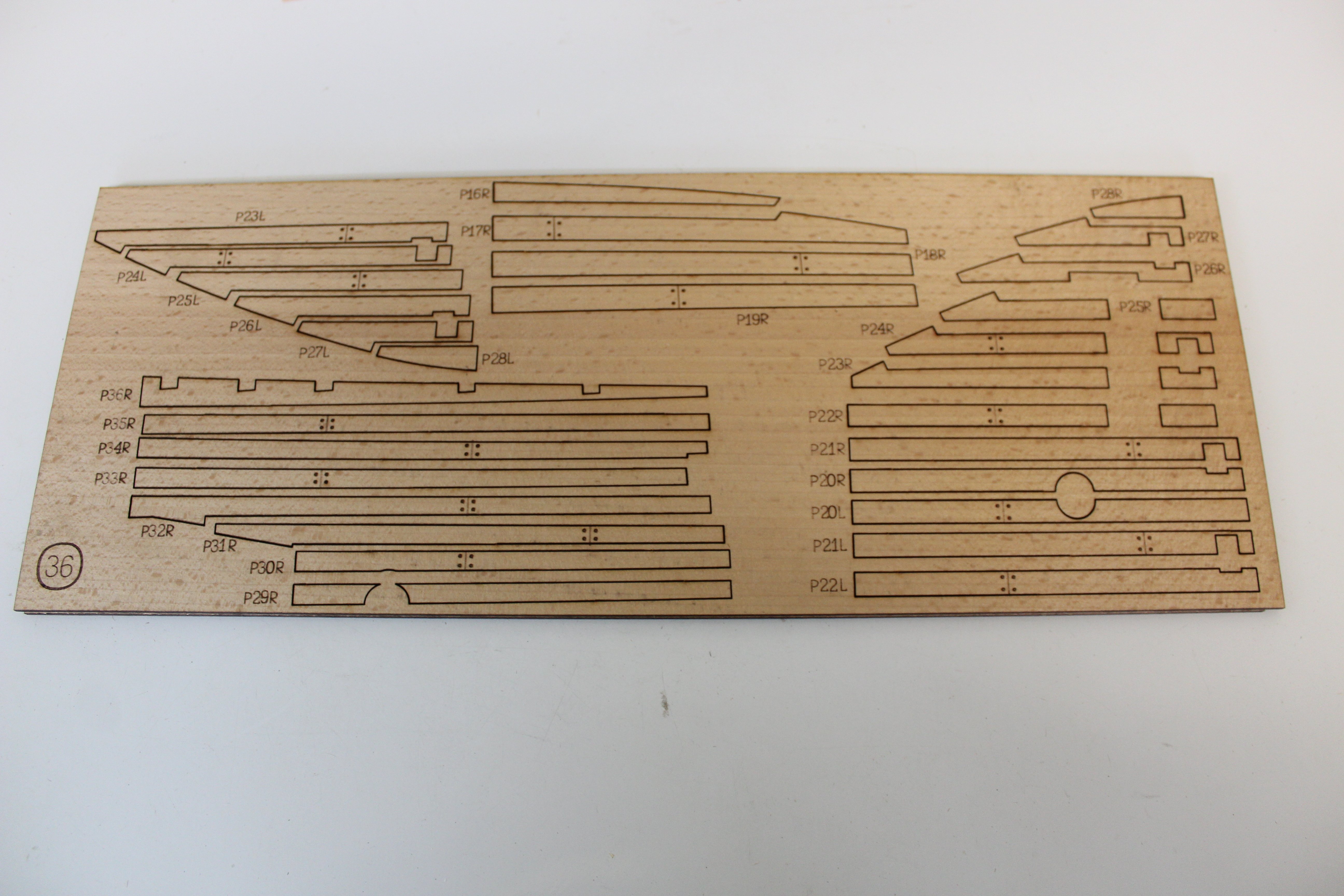

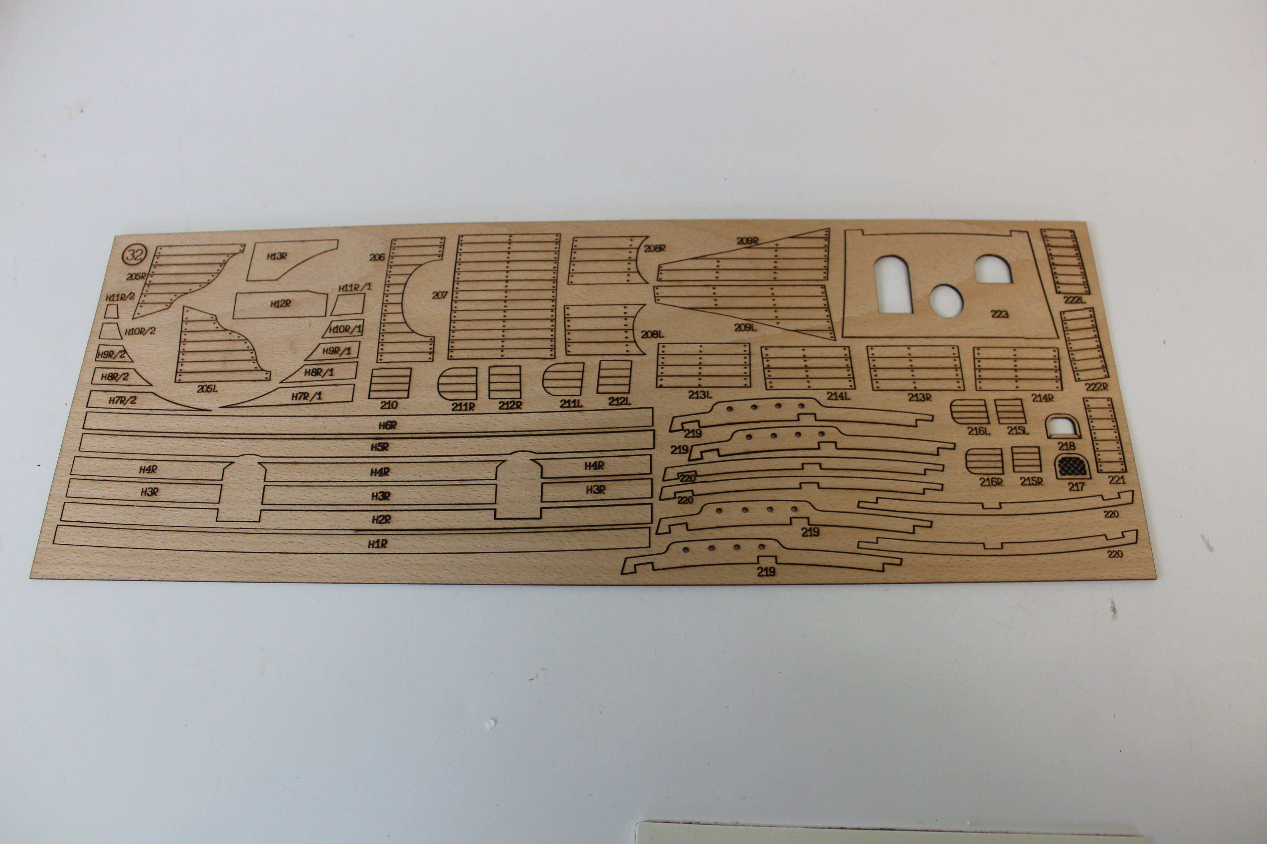

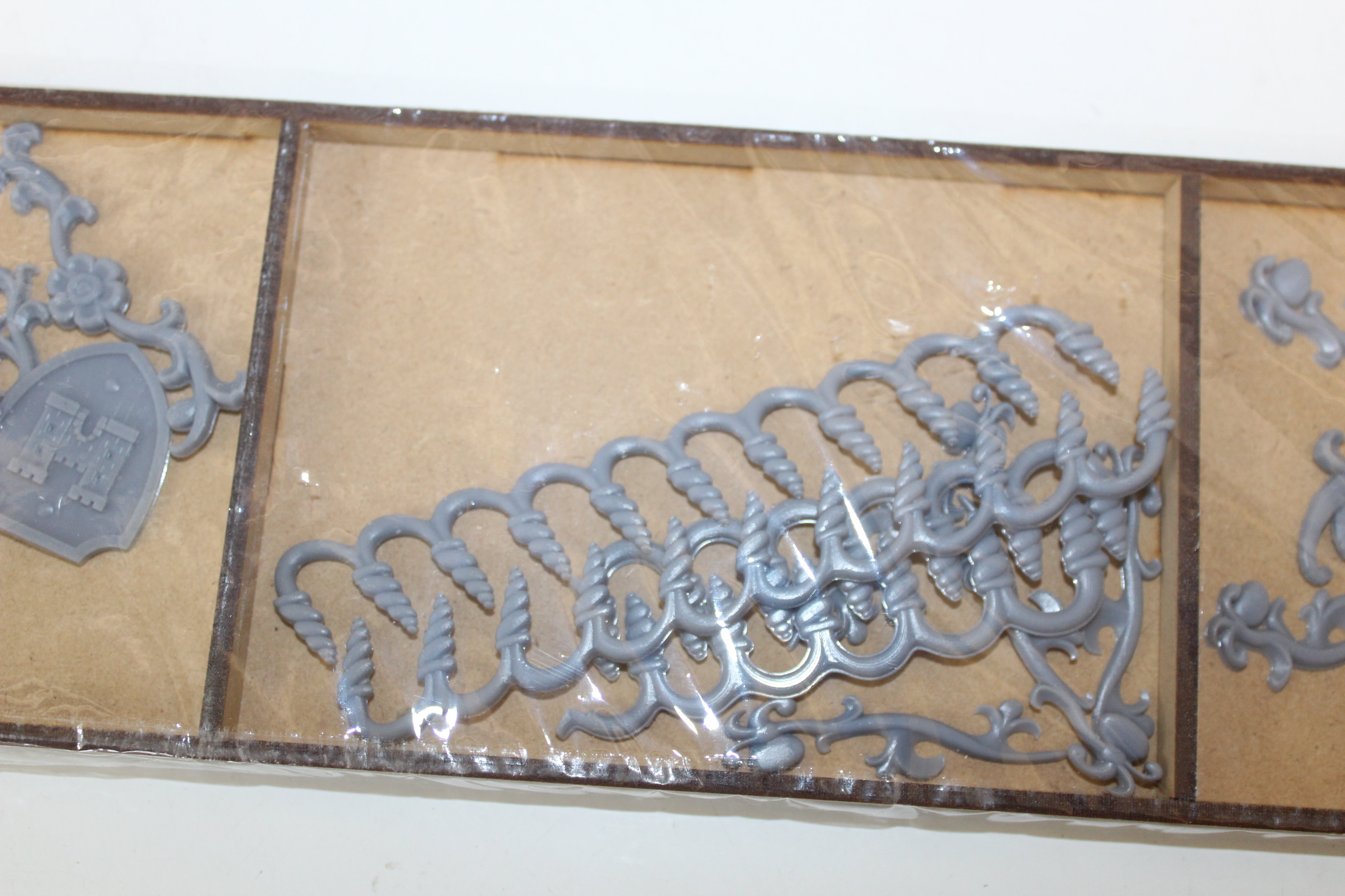

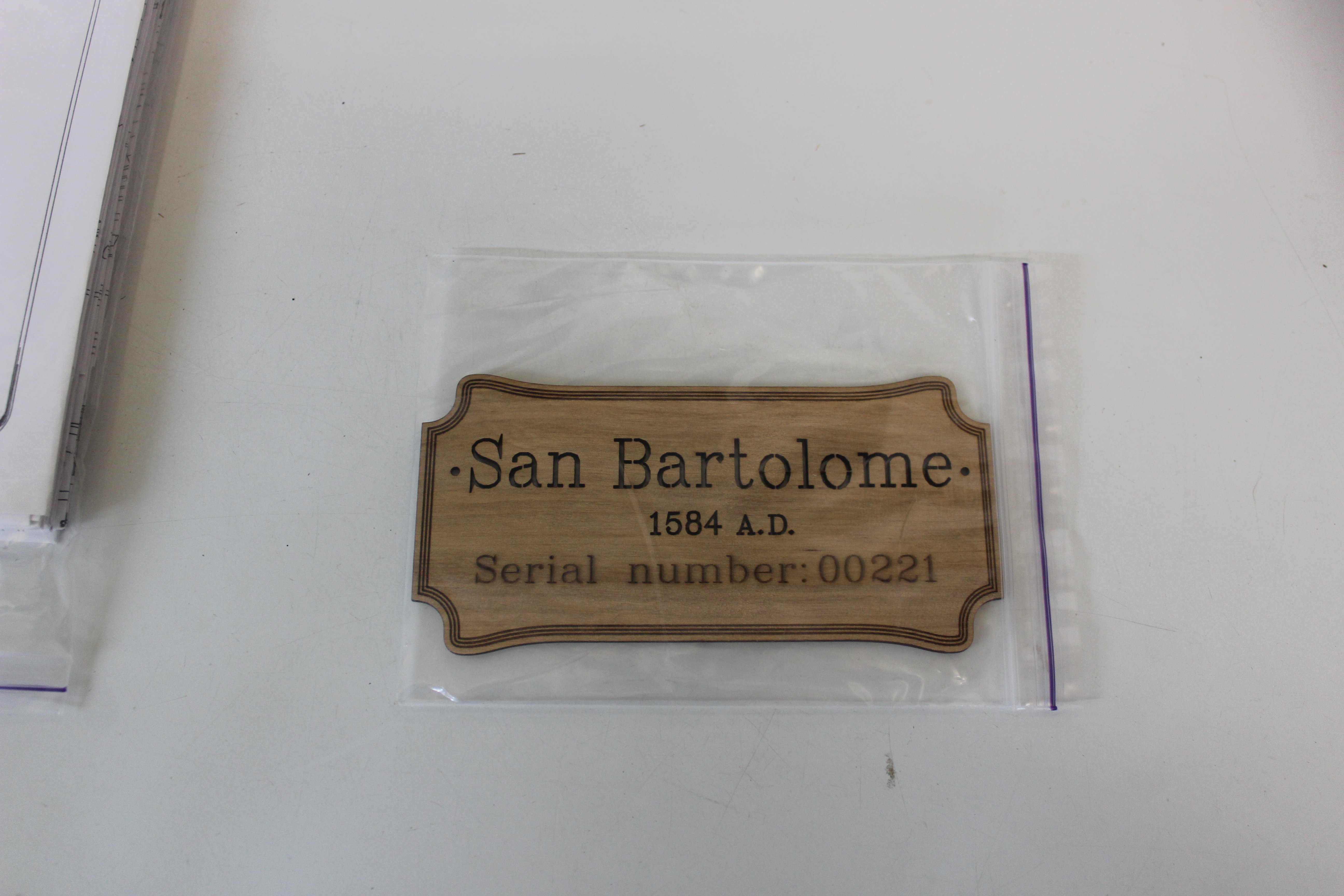

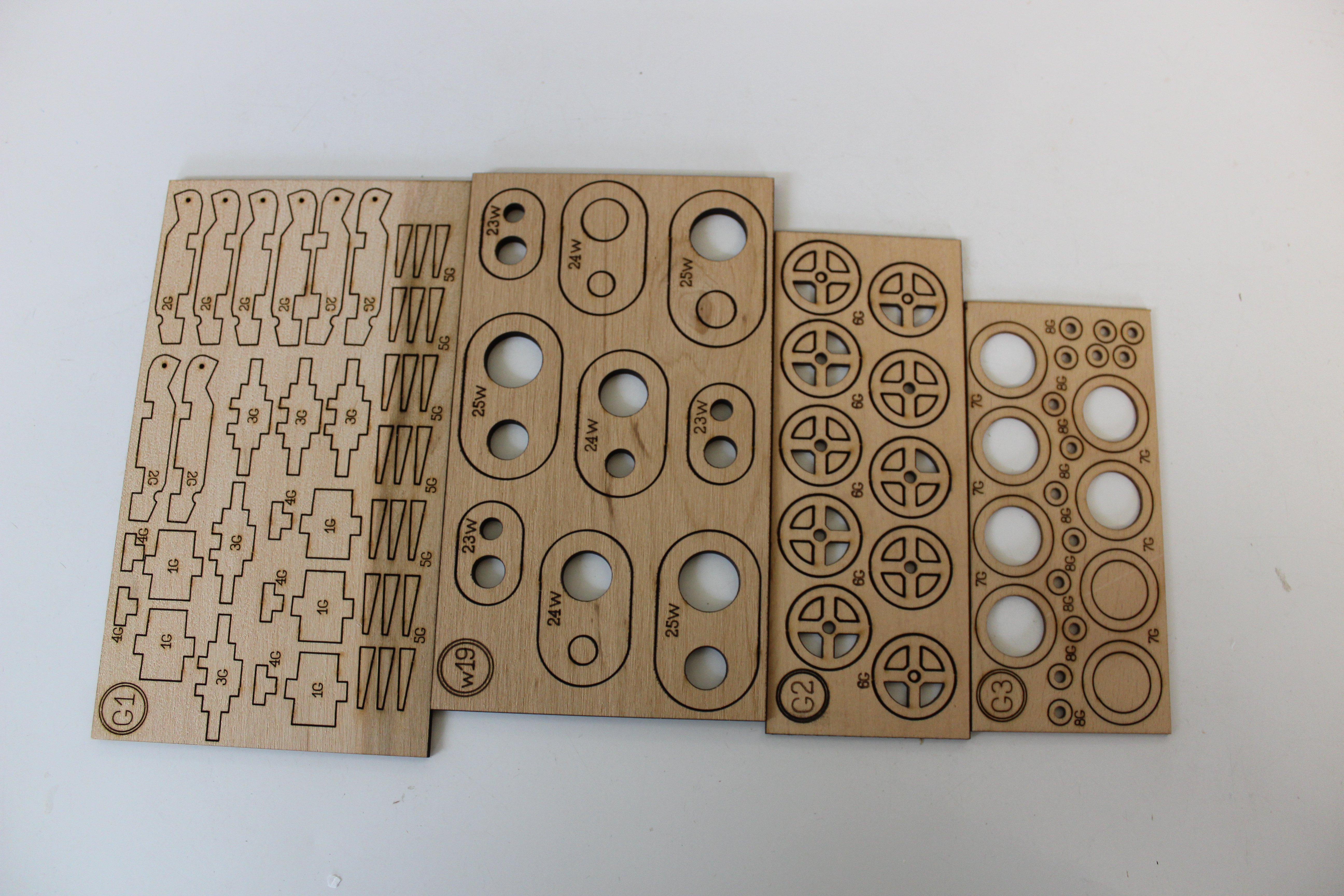

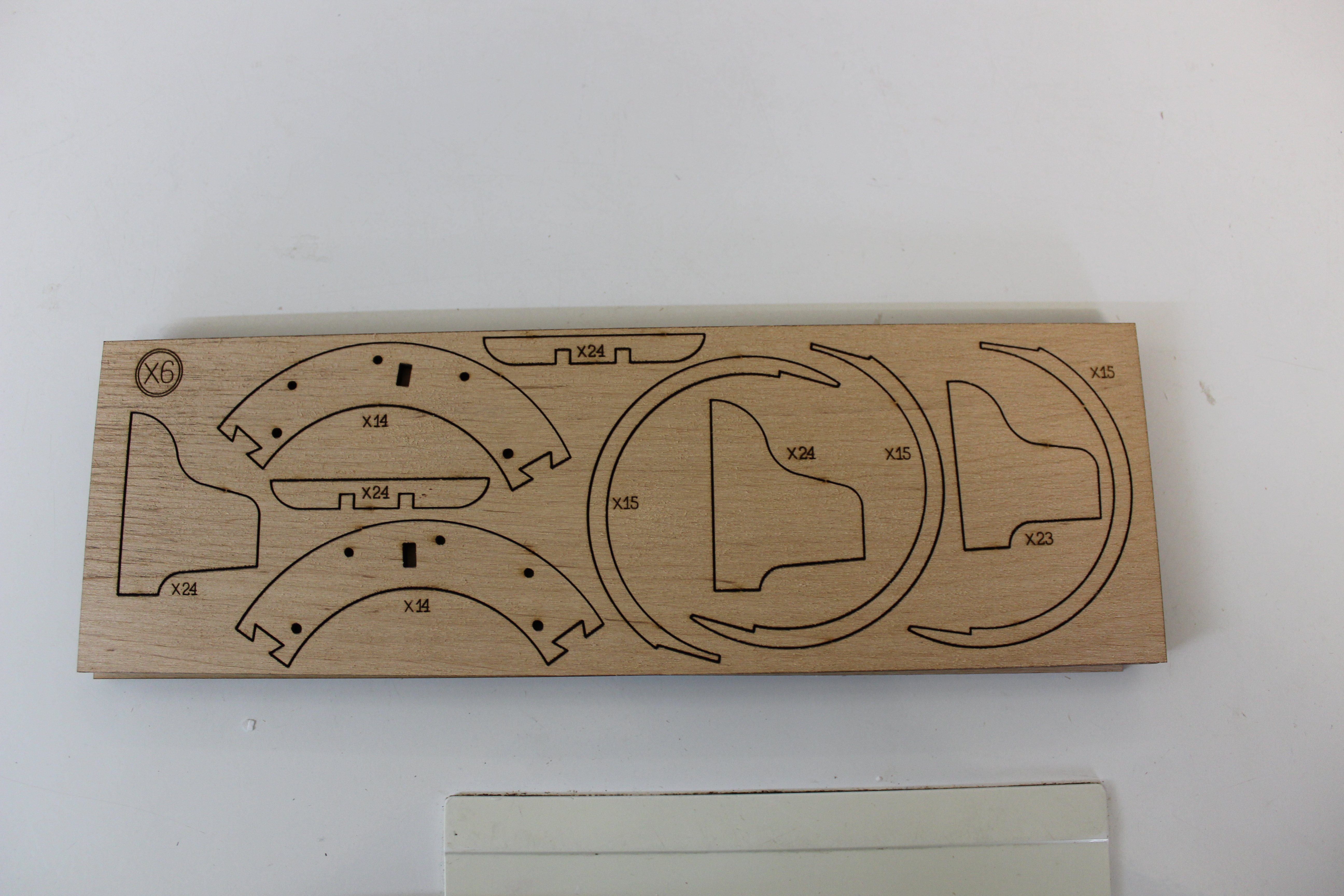

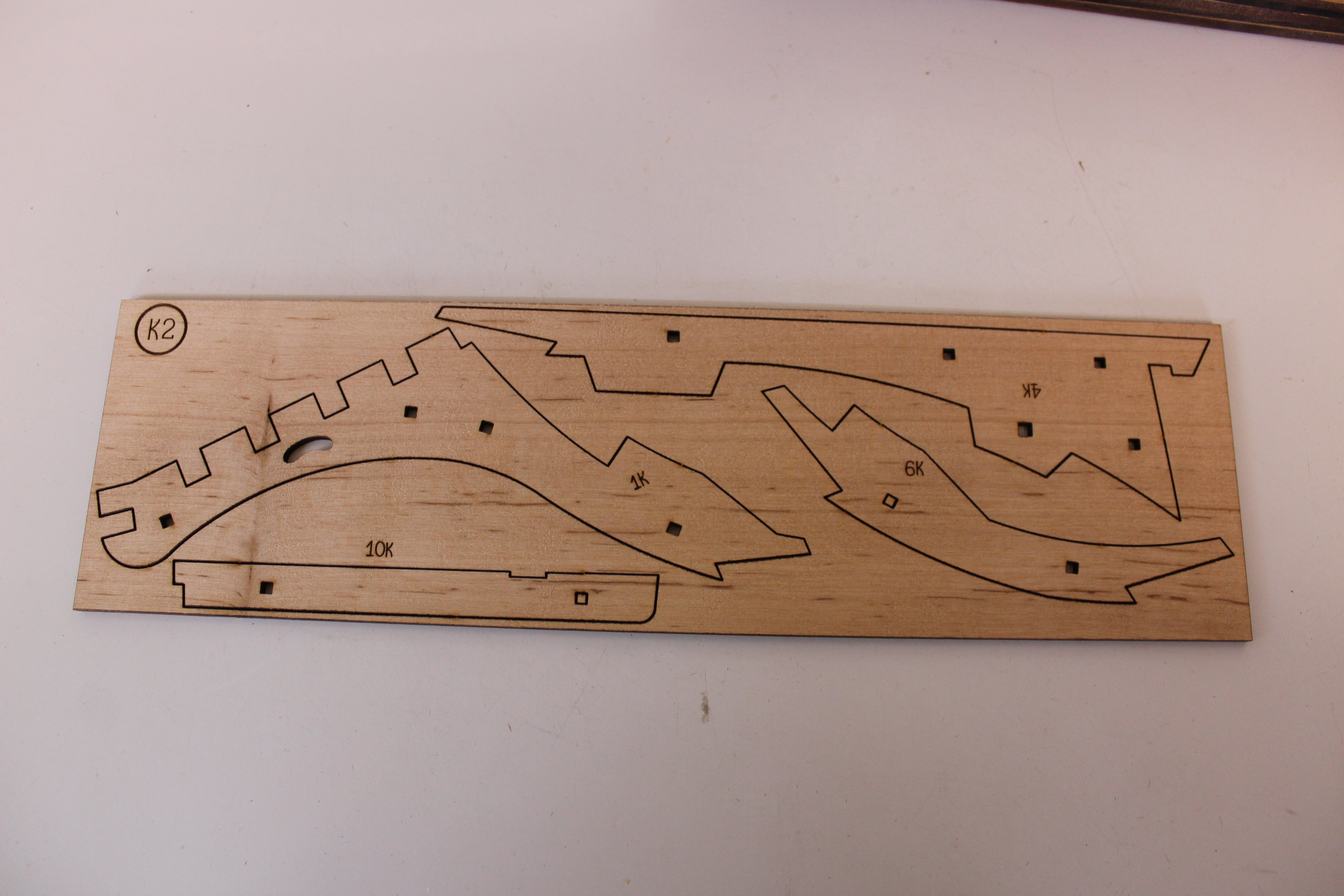

here are a few shots from each of the three boxes i received, i however never ordered the cradle or stand
Box two
box 3

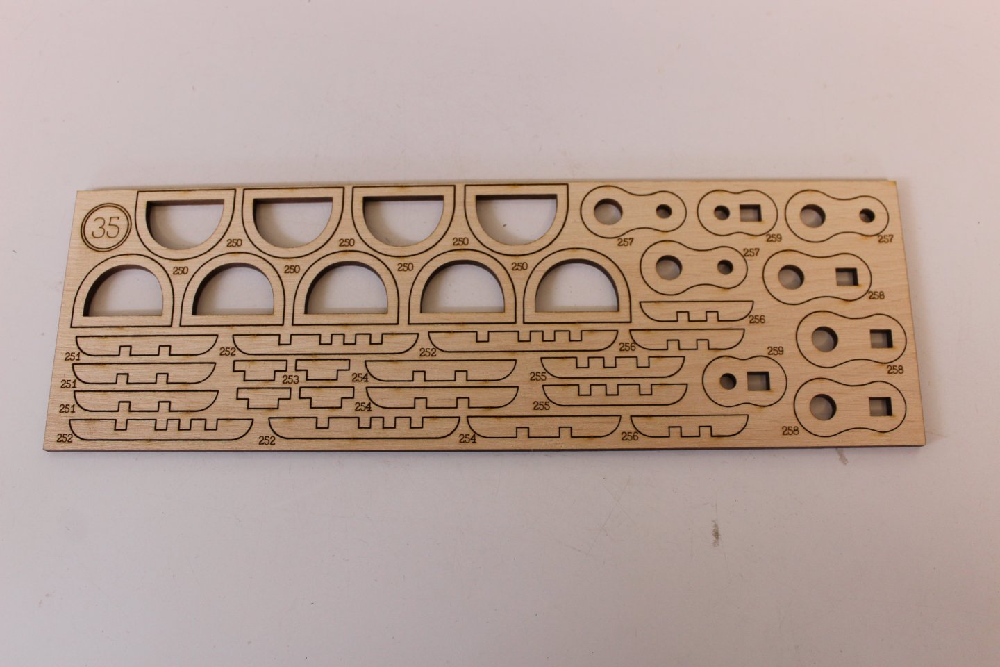

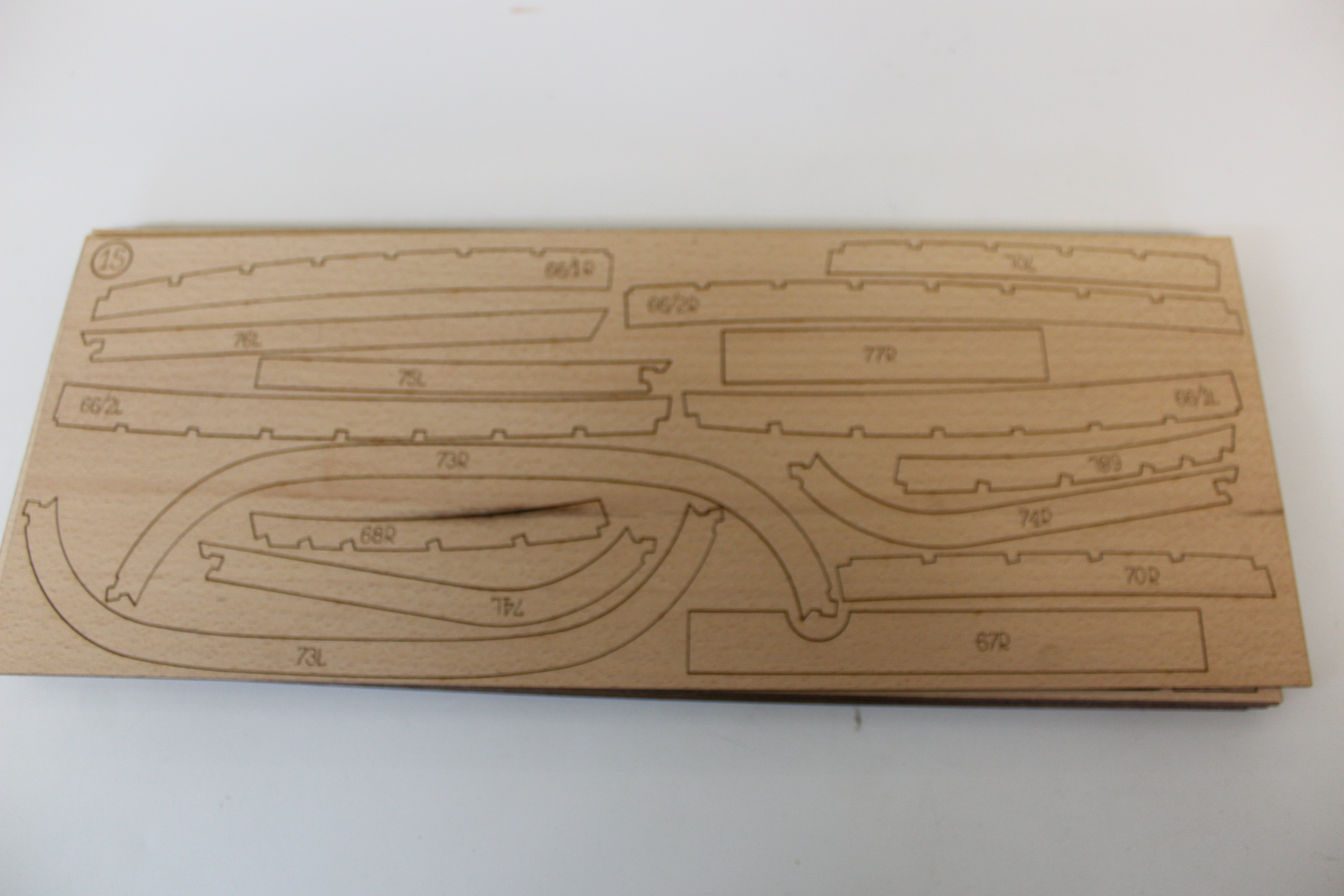

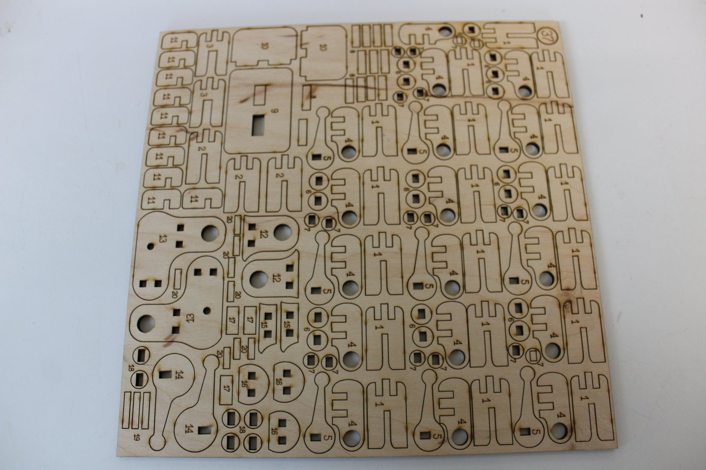

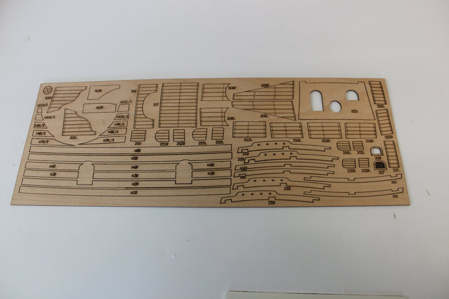

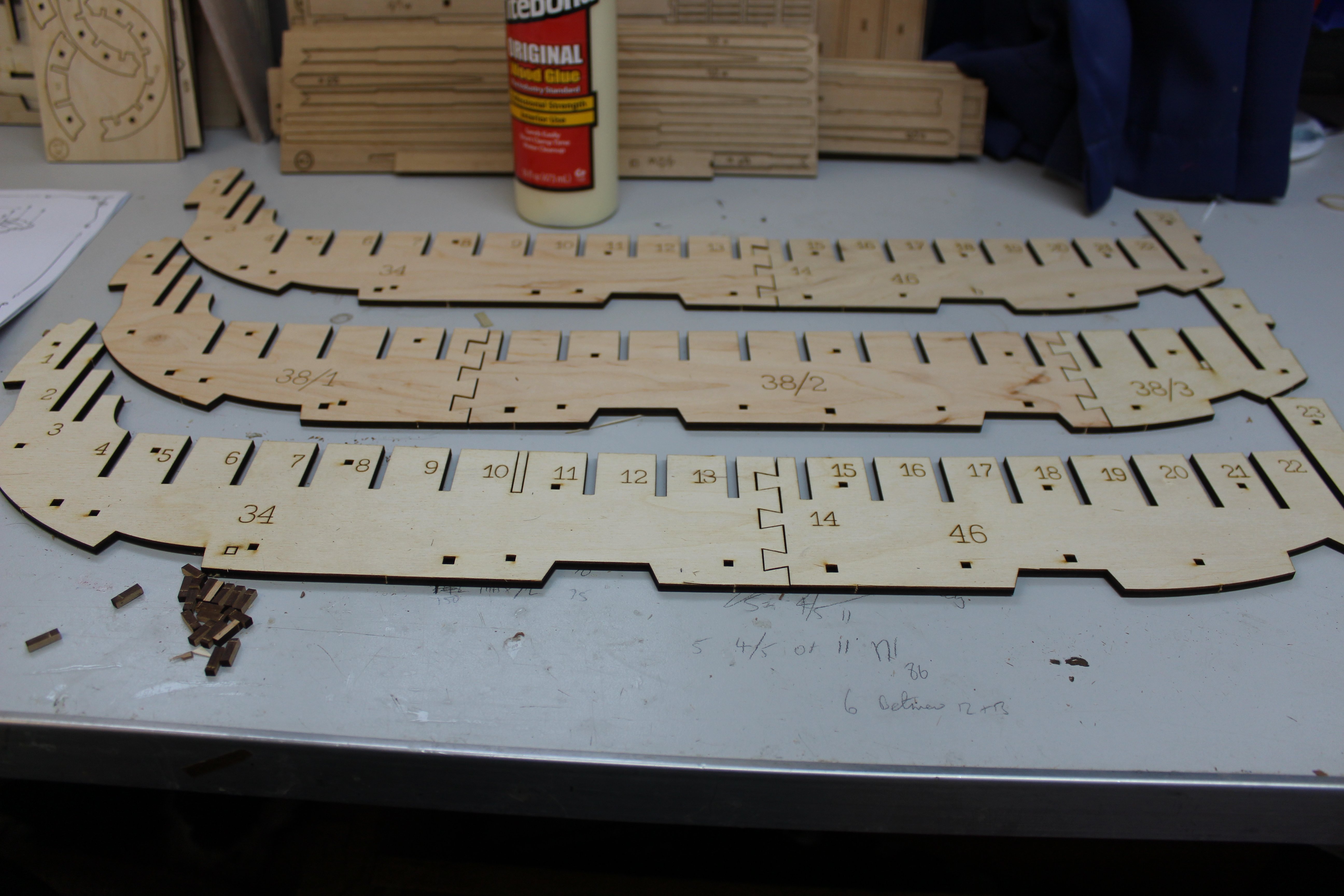

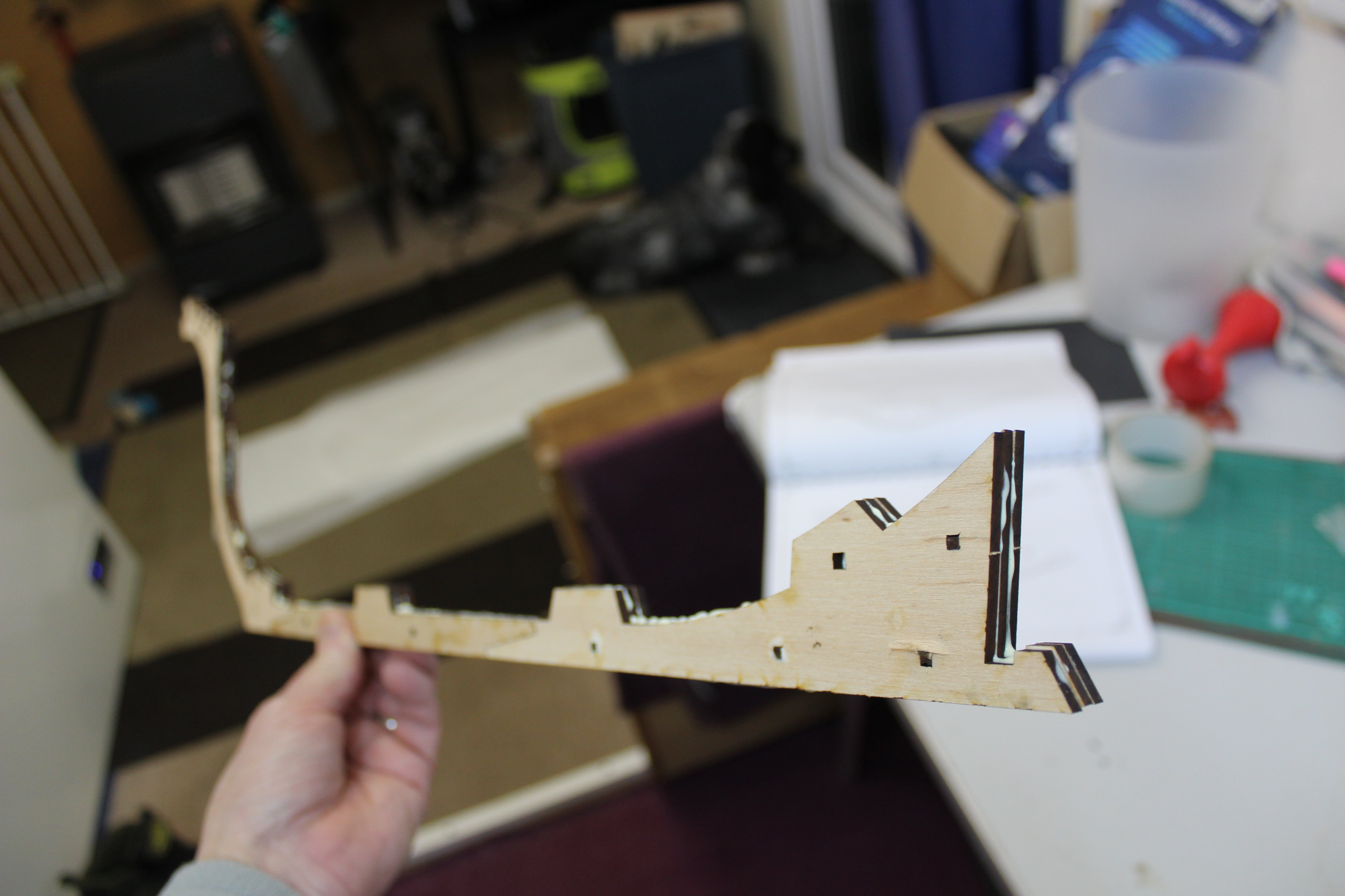

Day 1 wed 14th Jan 2026

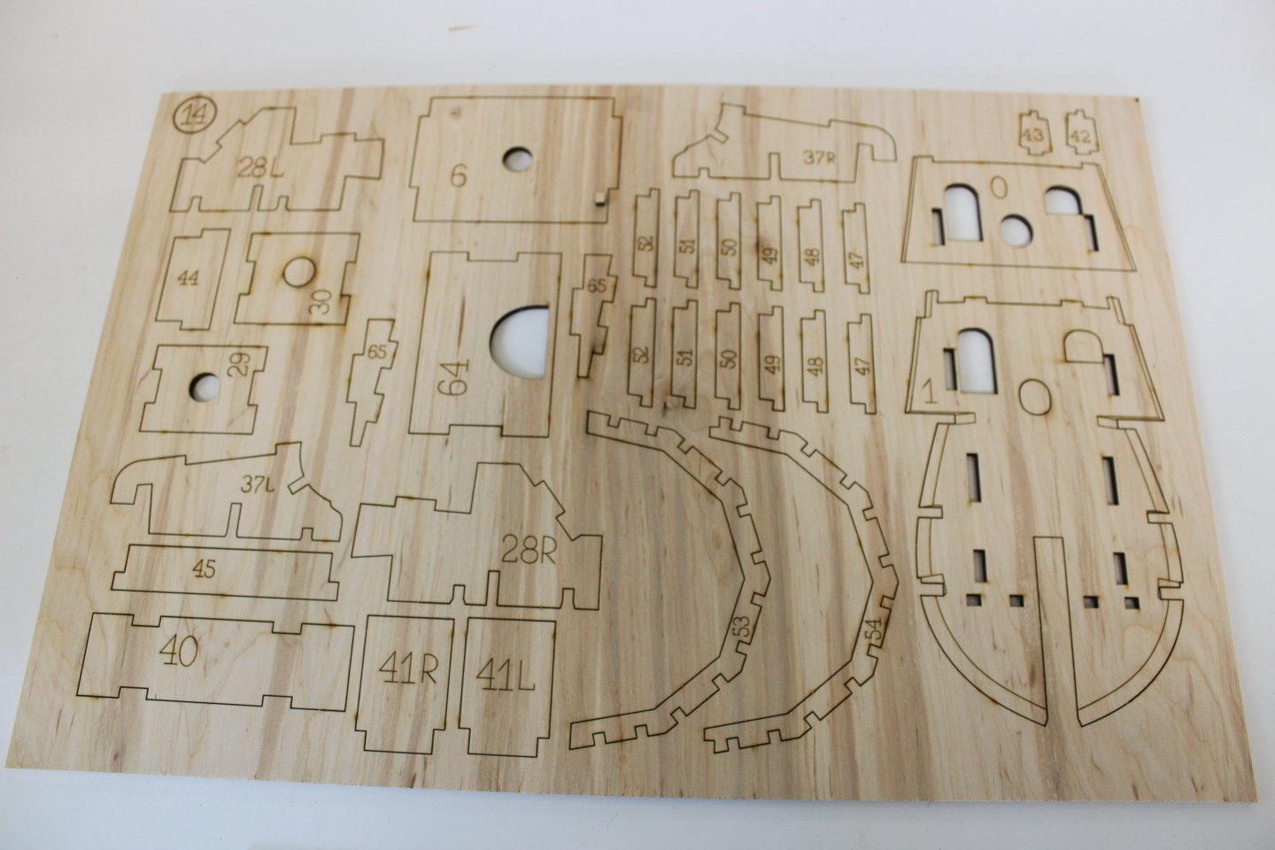

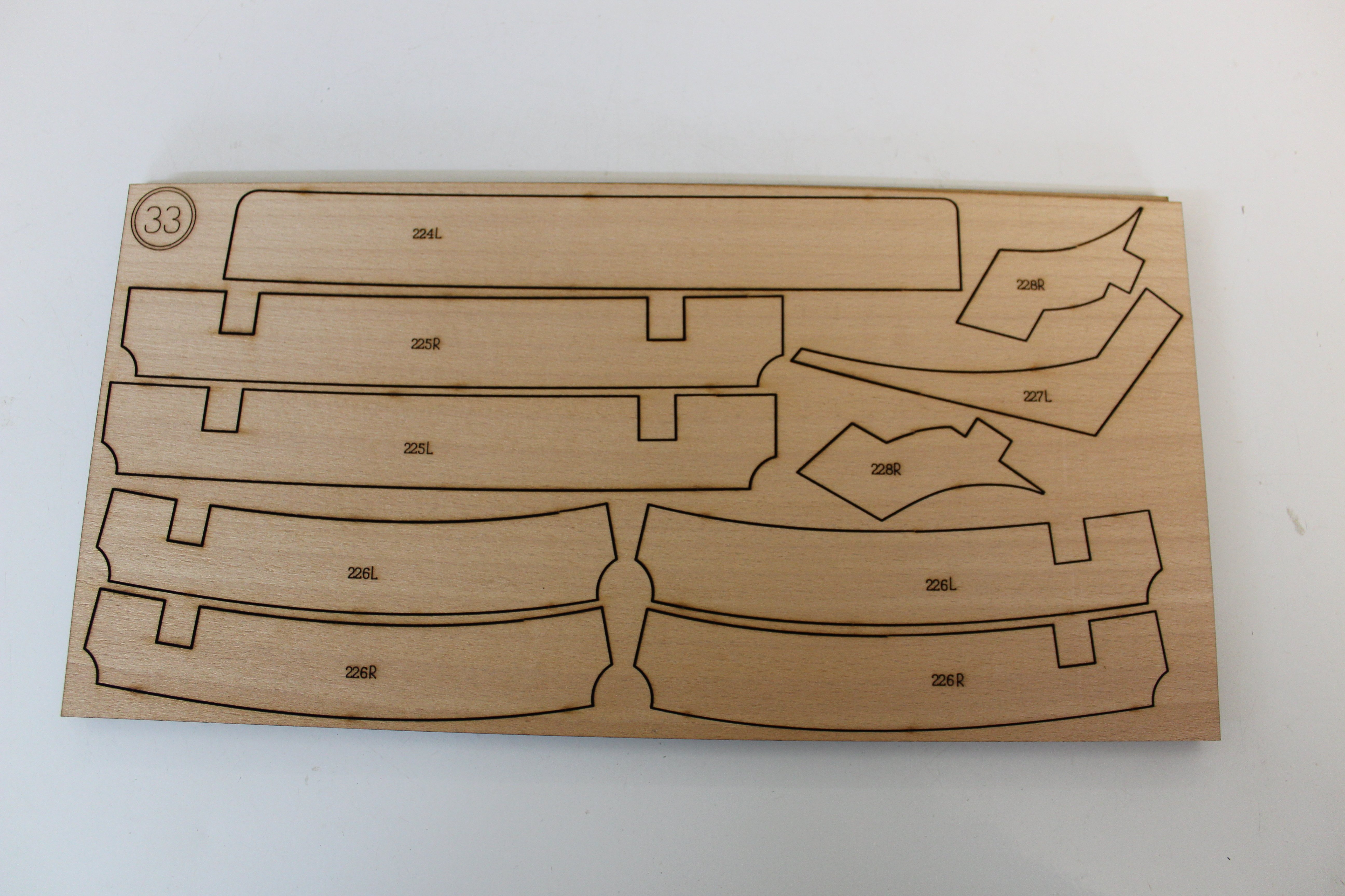

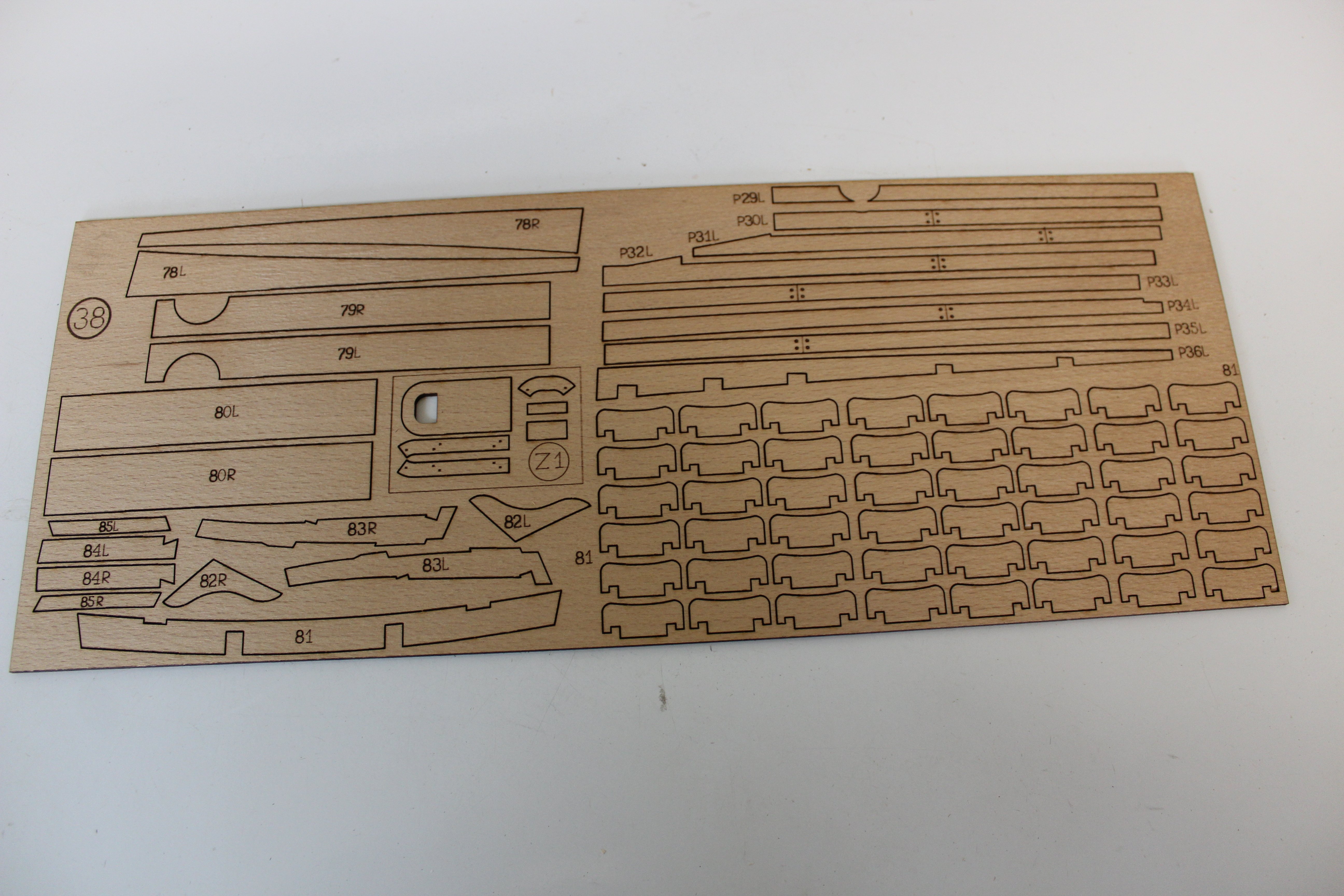

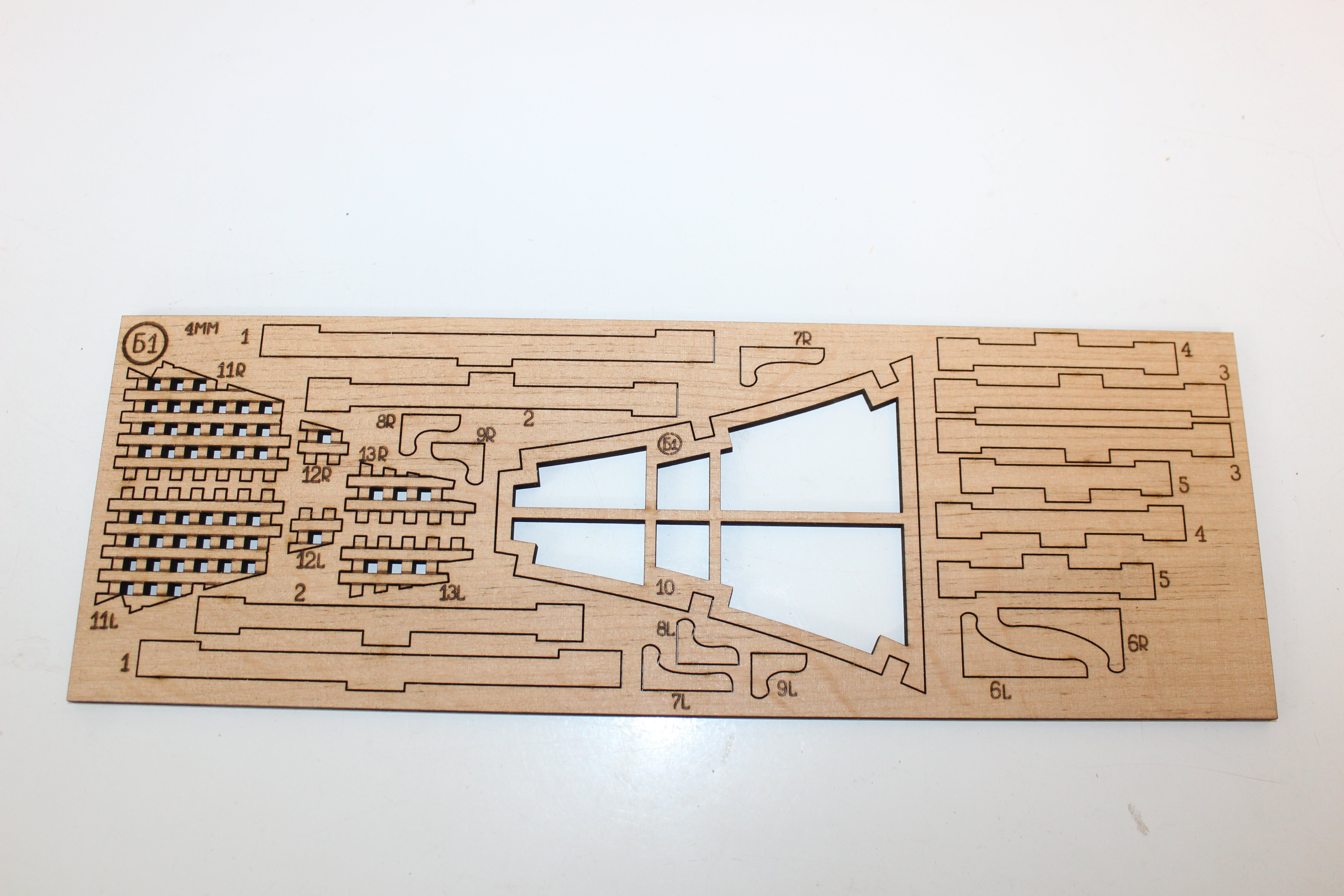

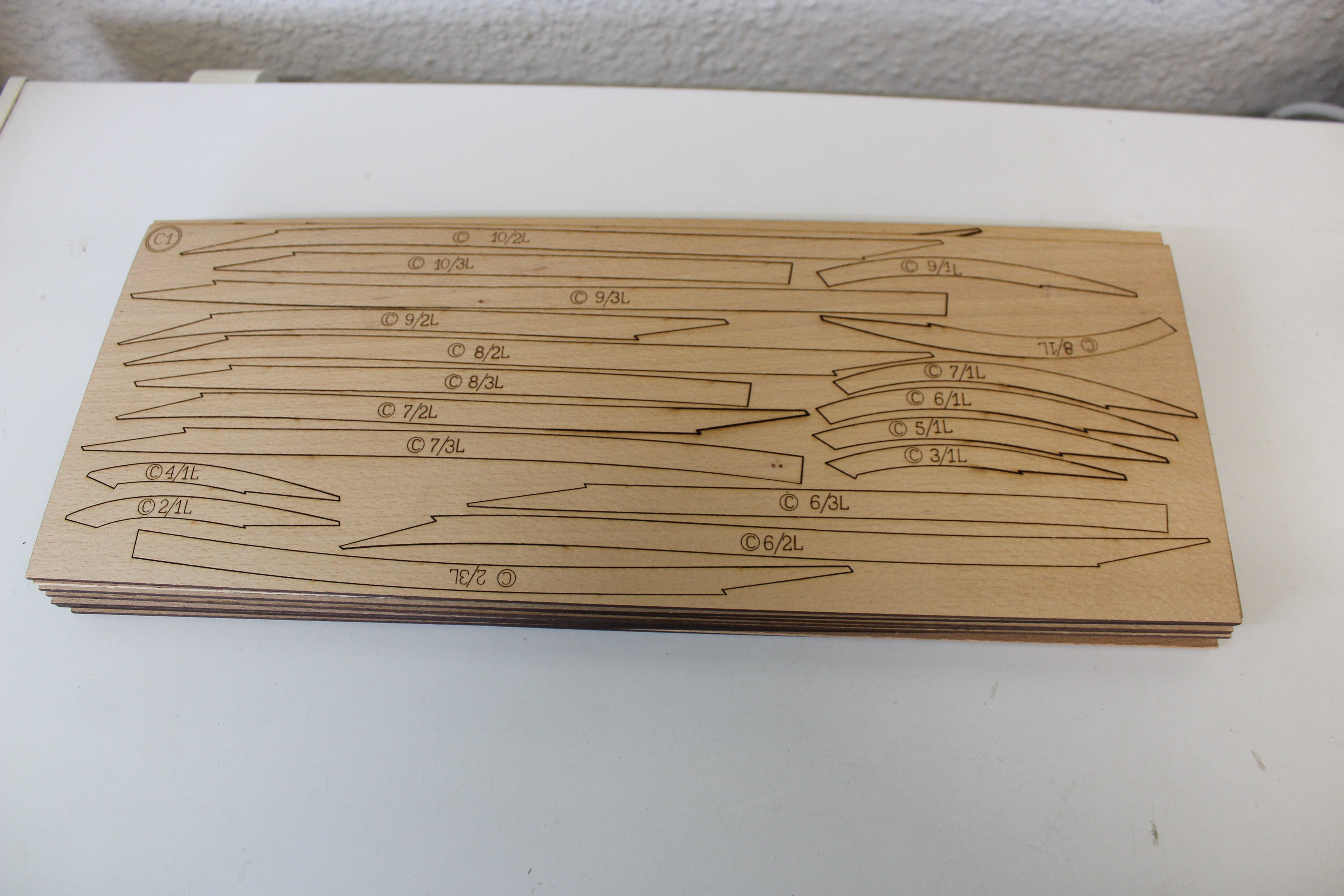

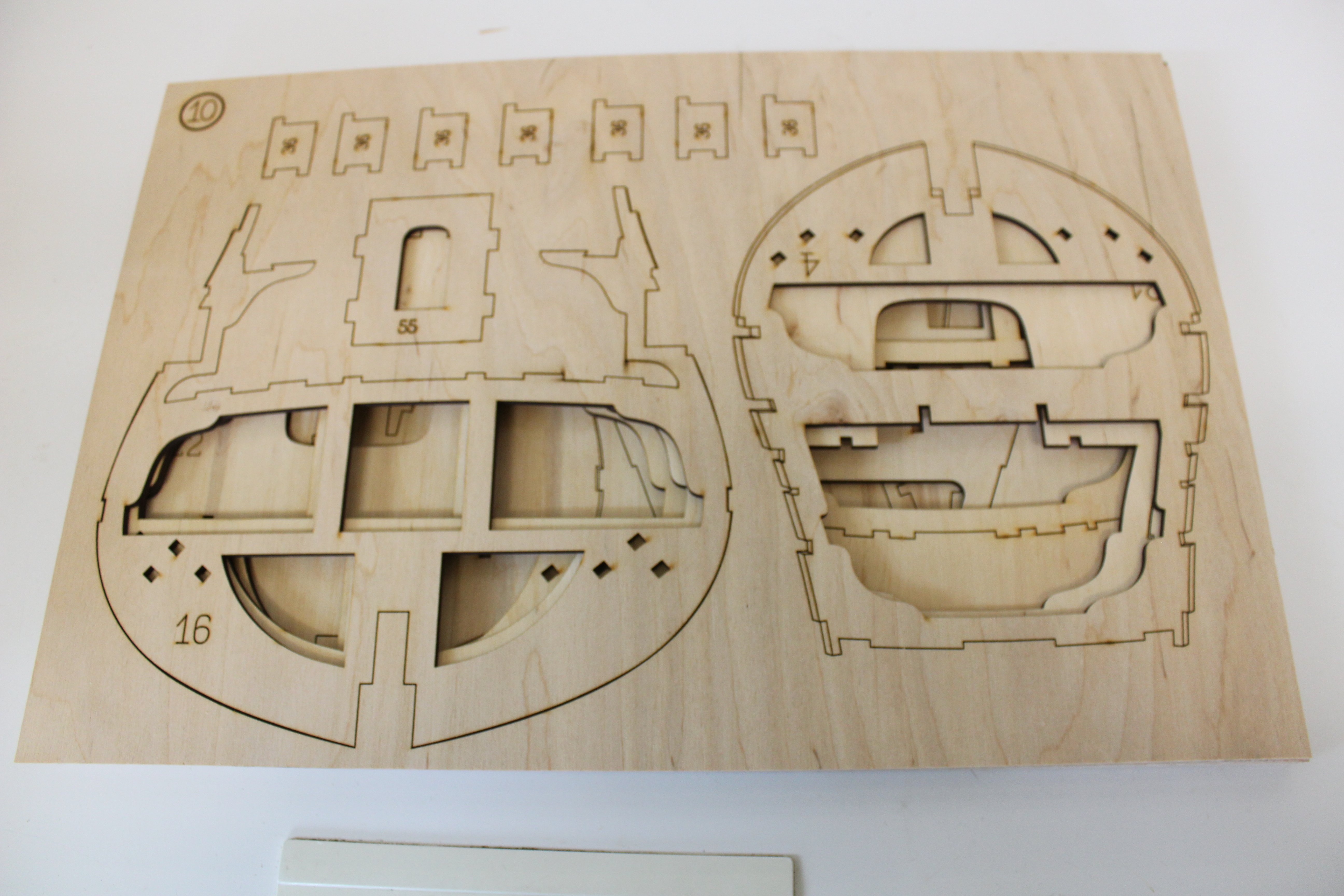

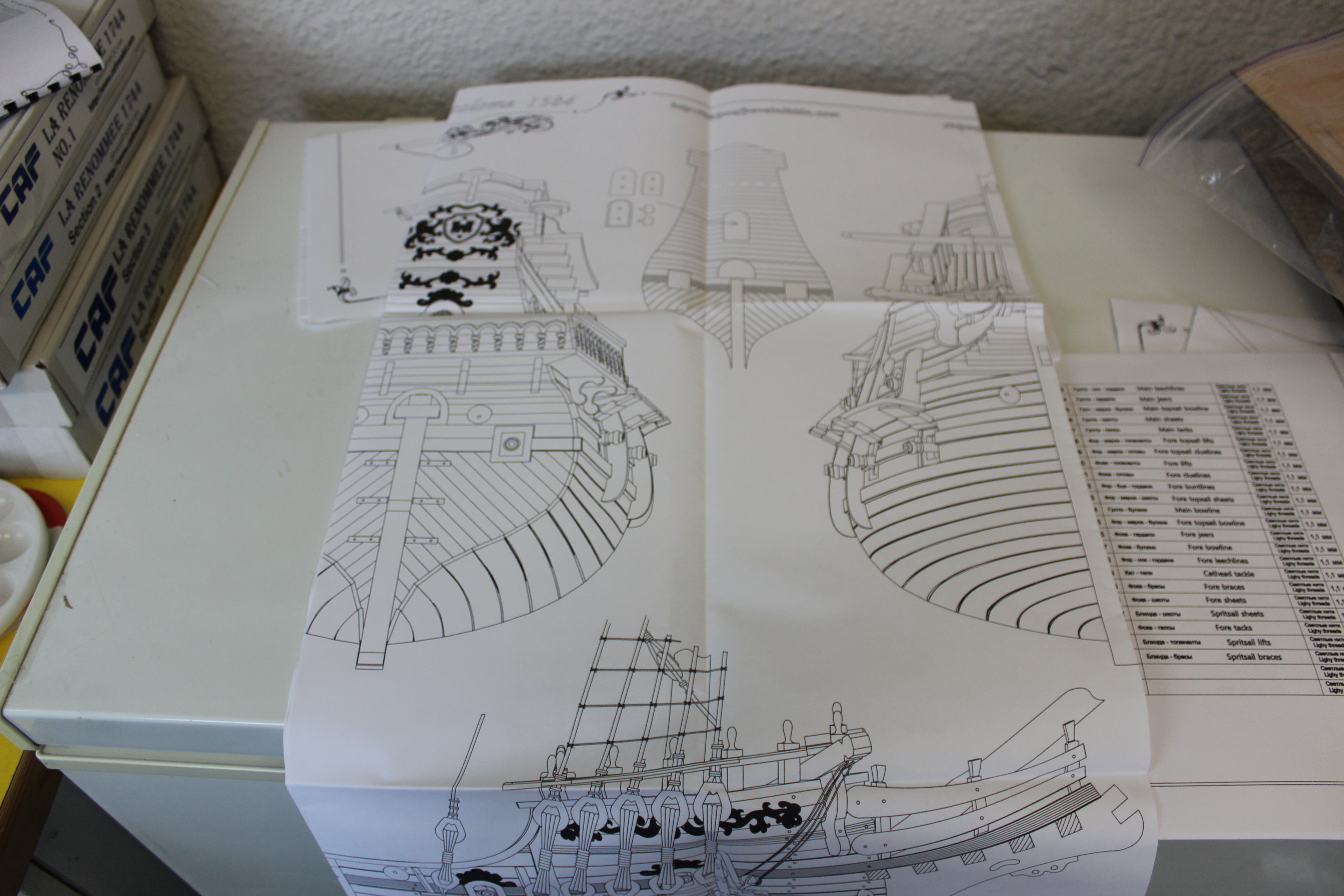

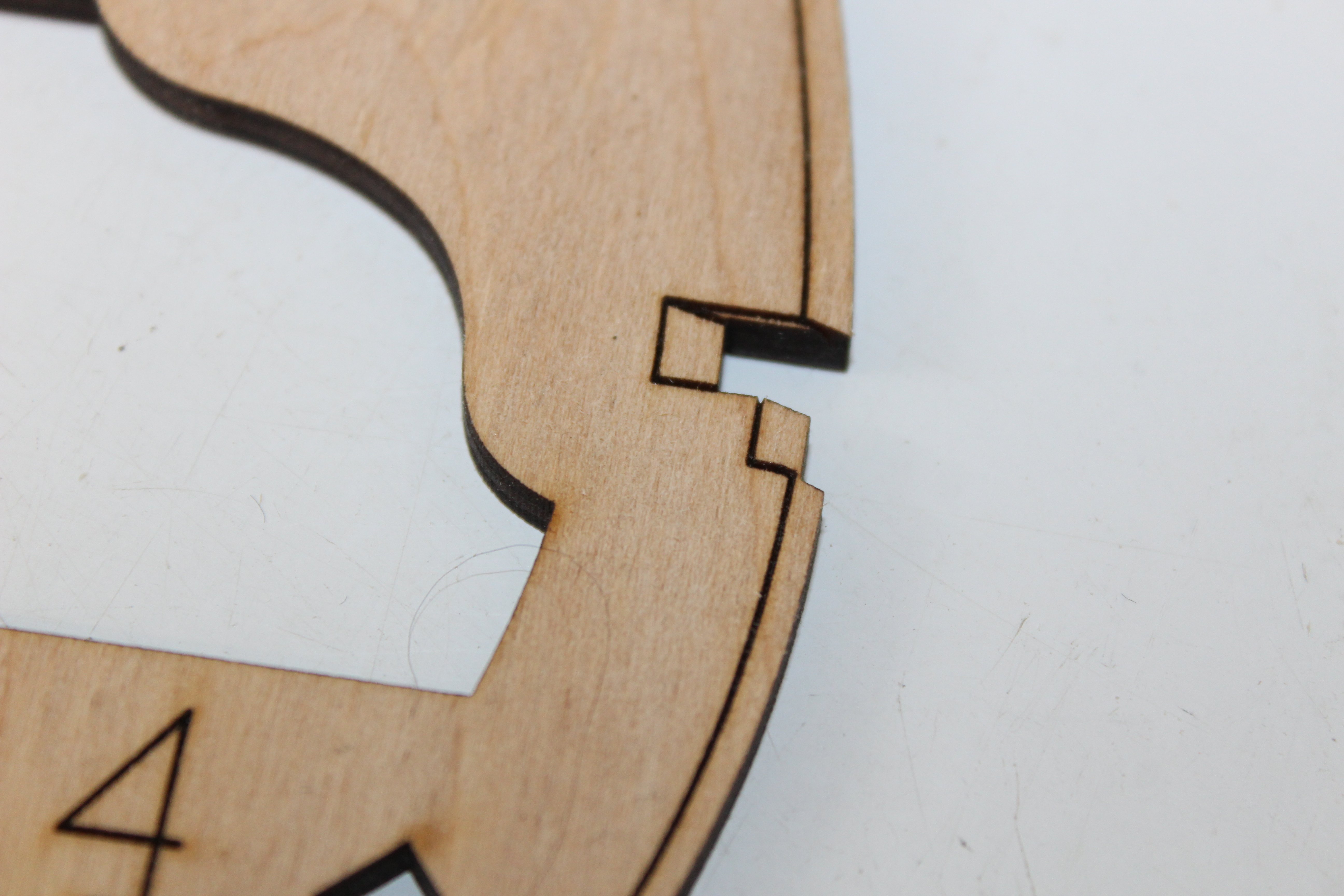

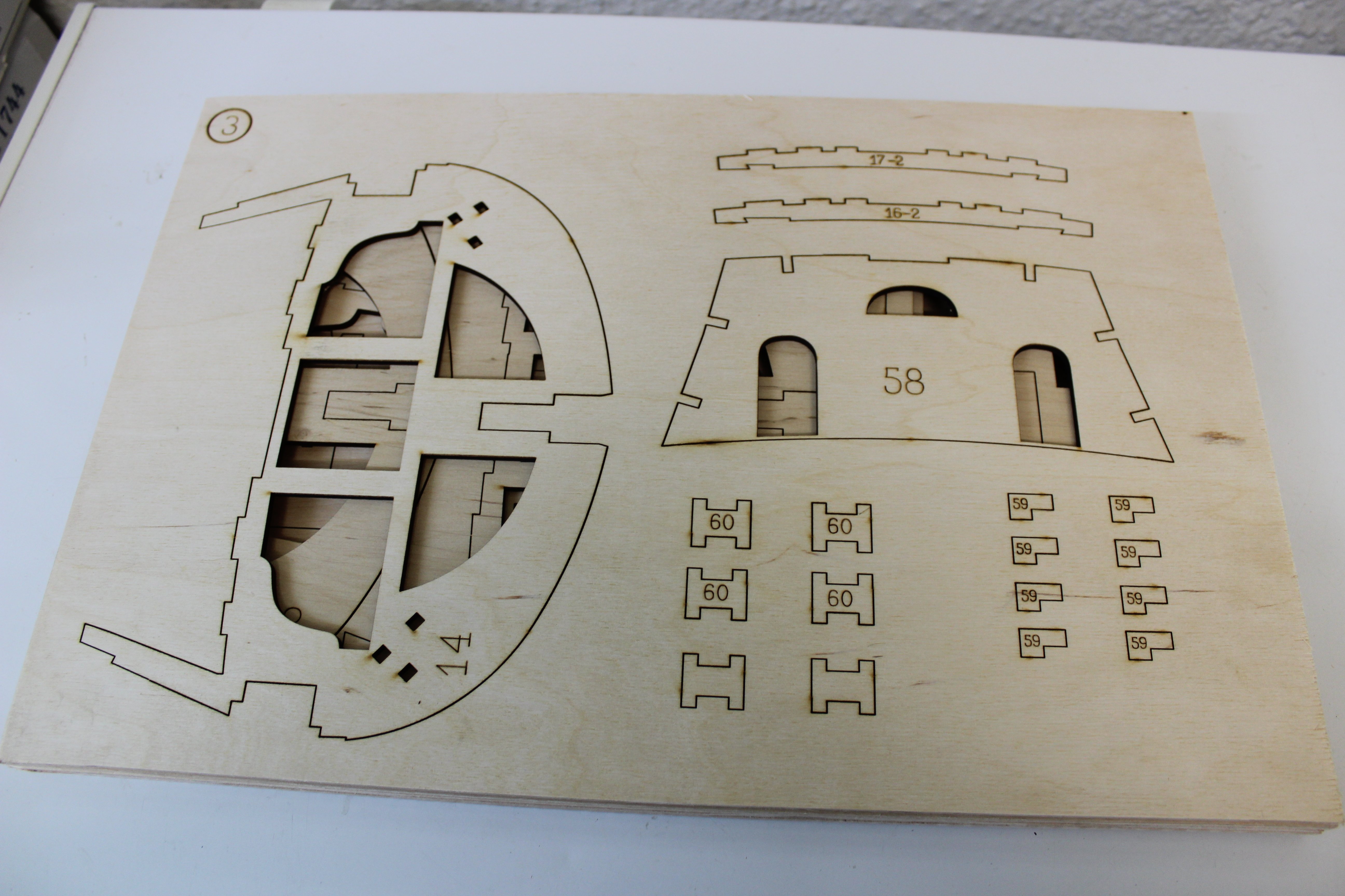

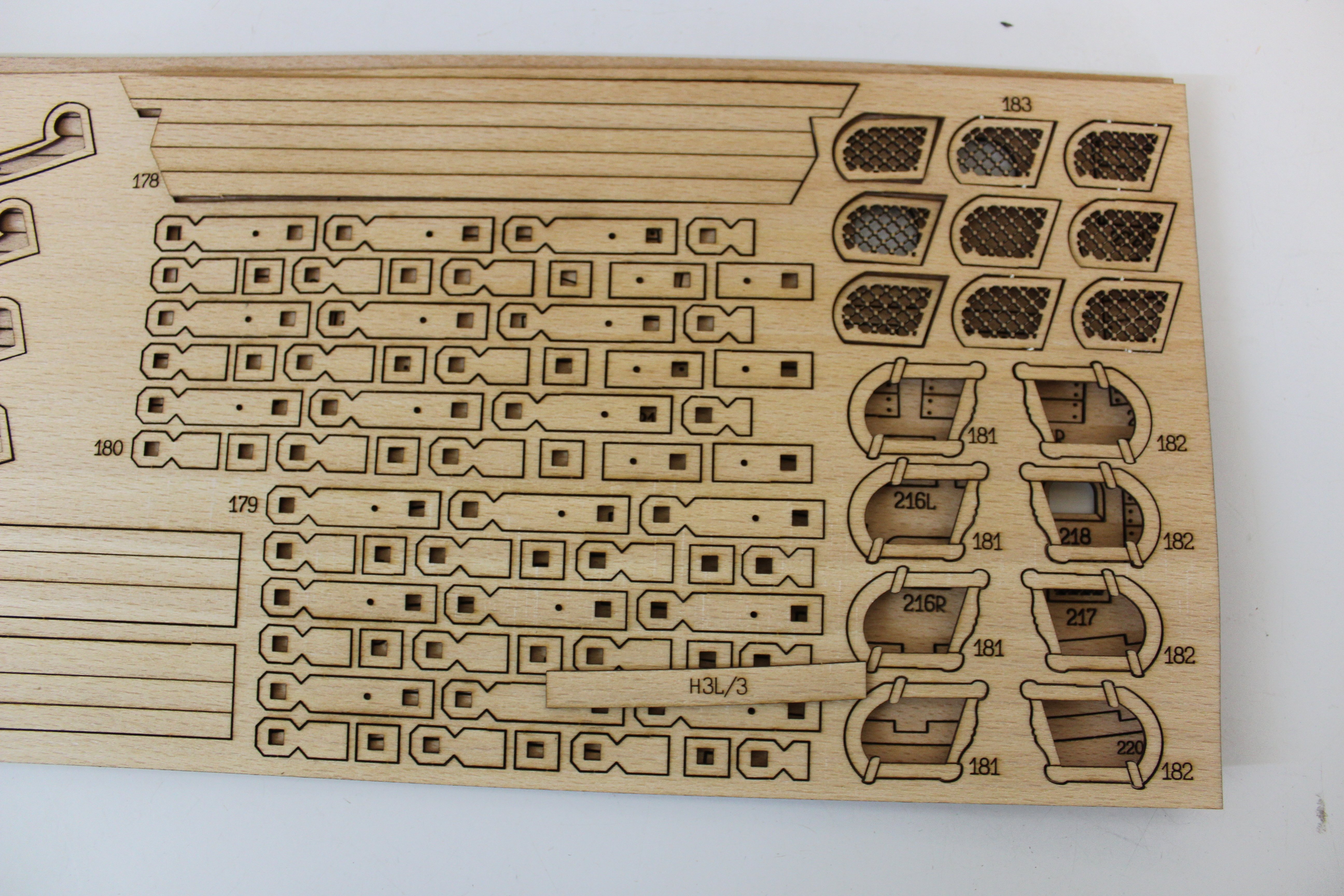

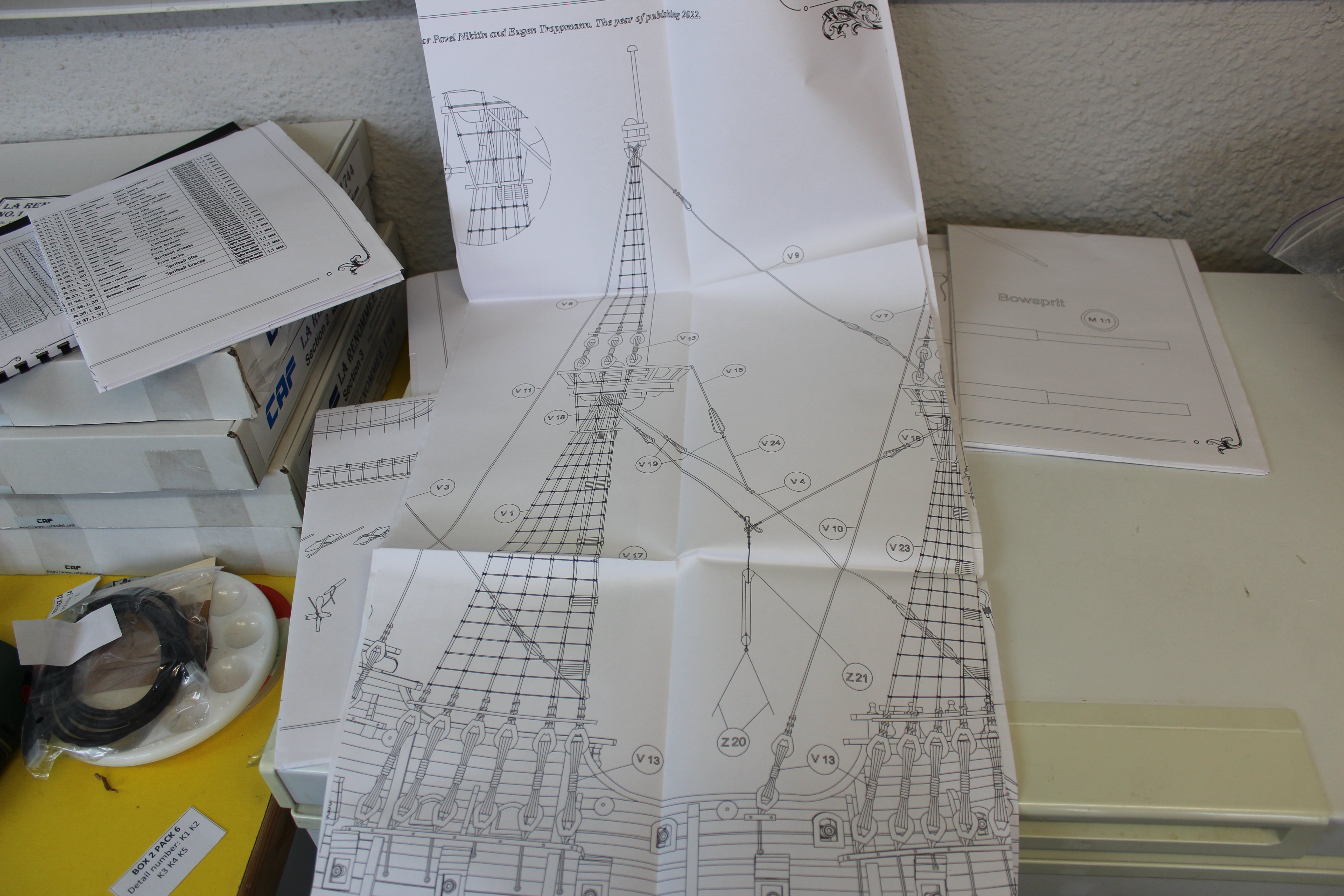

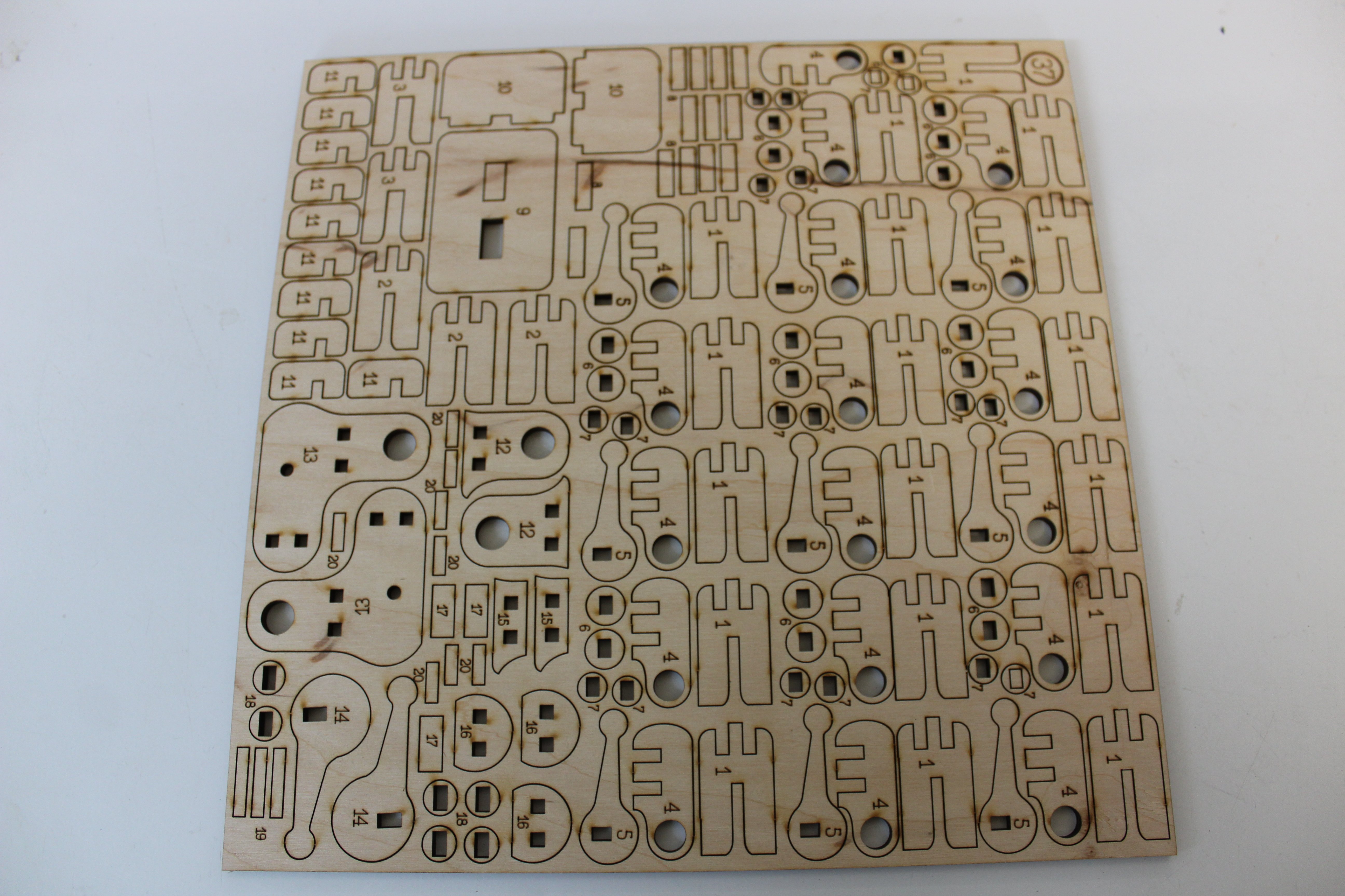

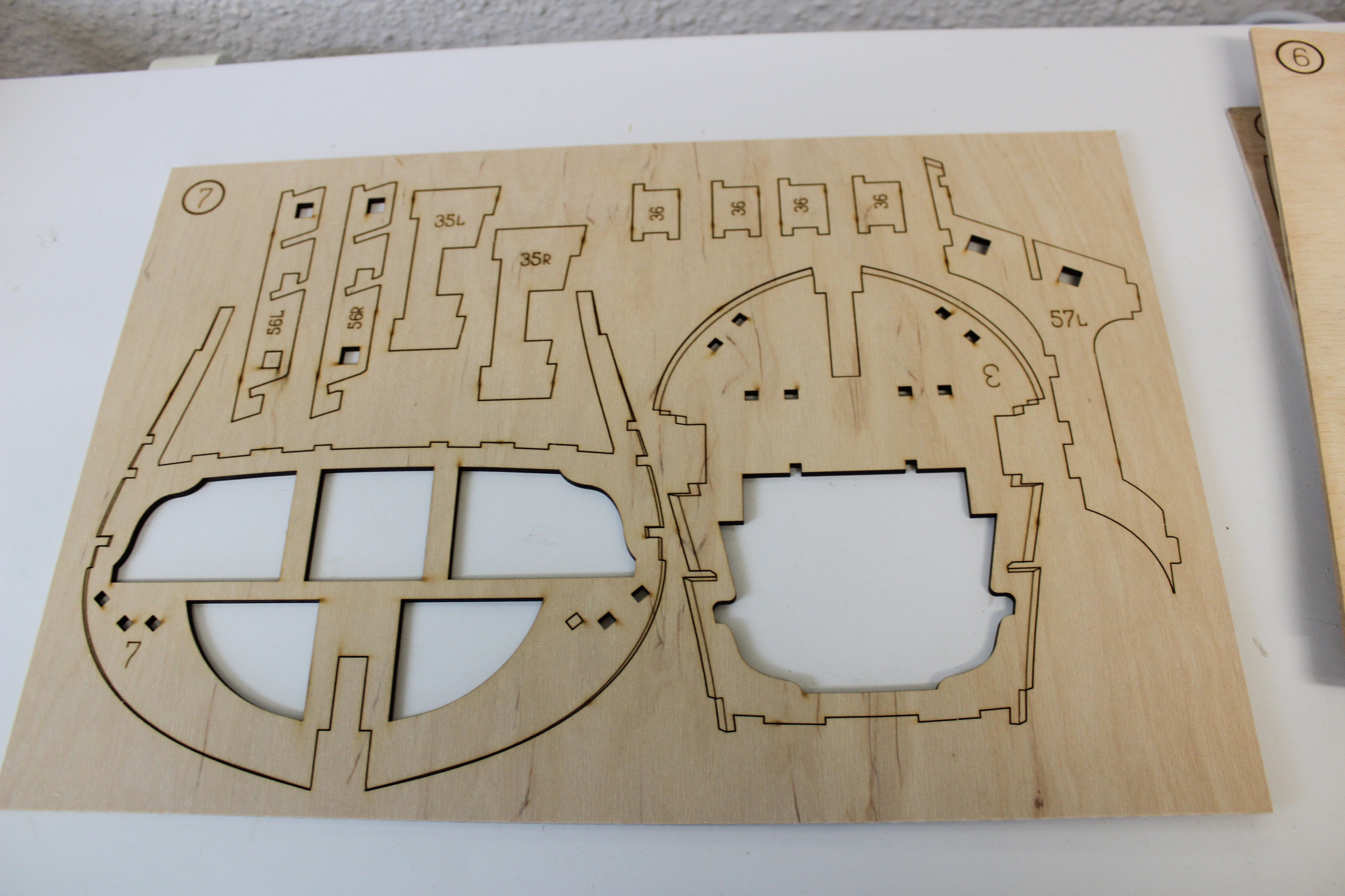

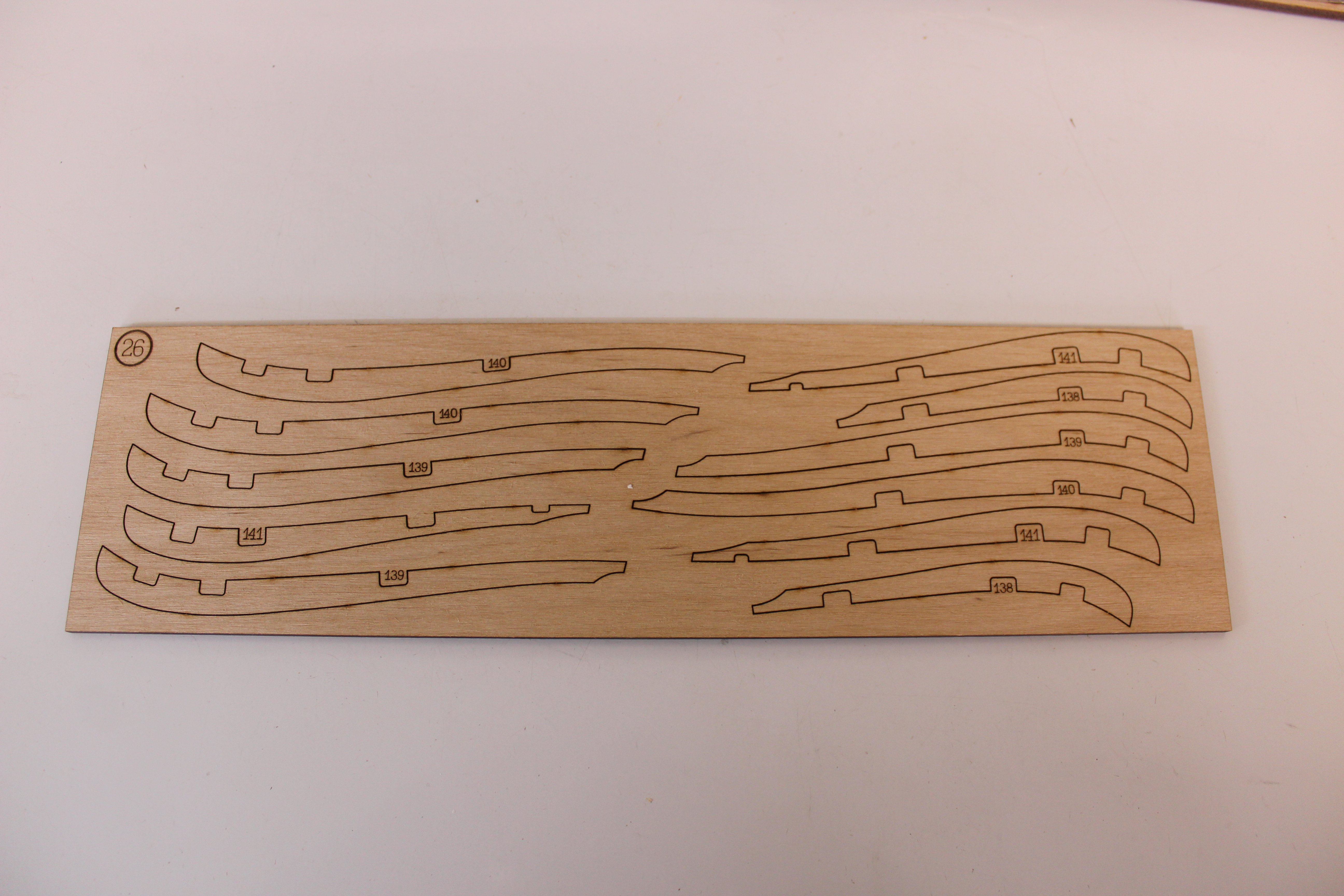

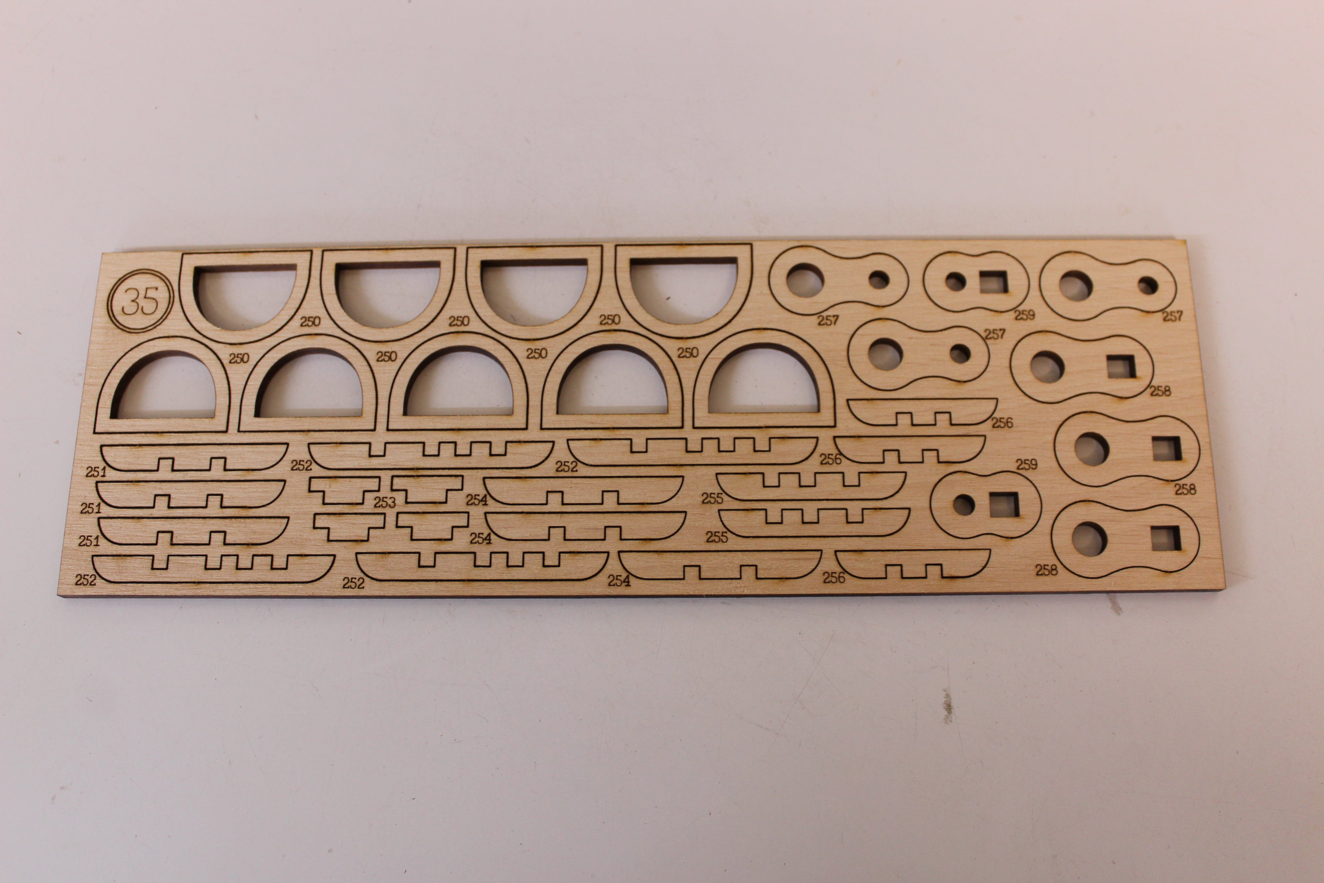

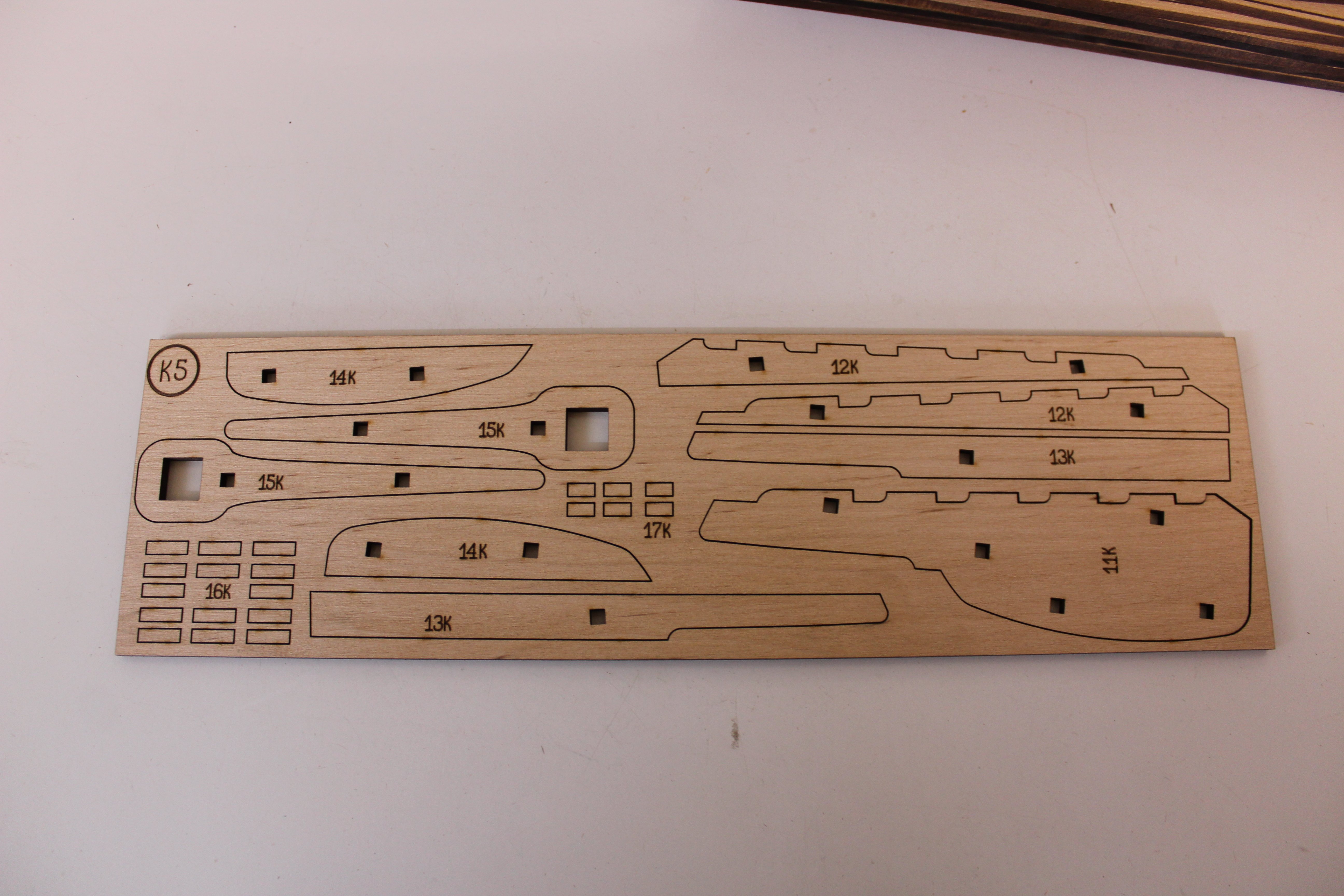

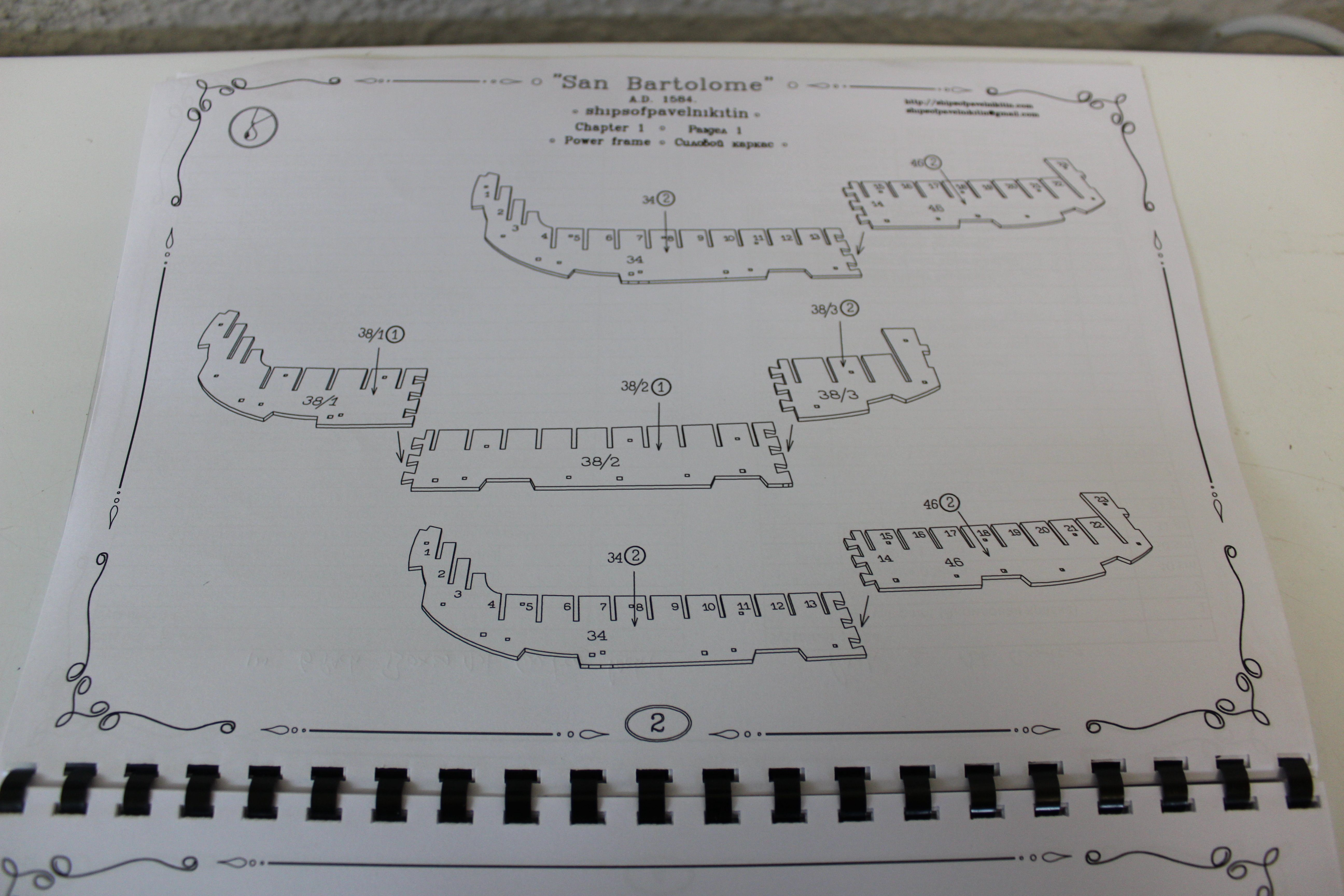

did a full contests check against the instructions
the quality of the wood is excellent, and a lot of it, the frames from Ply are well lasered, the rest of the contents is mainly beech and again well cut with little laser burn, looking forward to this, so lets get on with it
, everything was there, any issues now, i will blame the bois

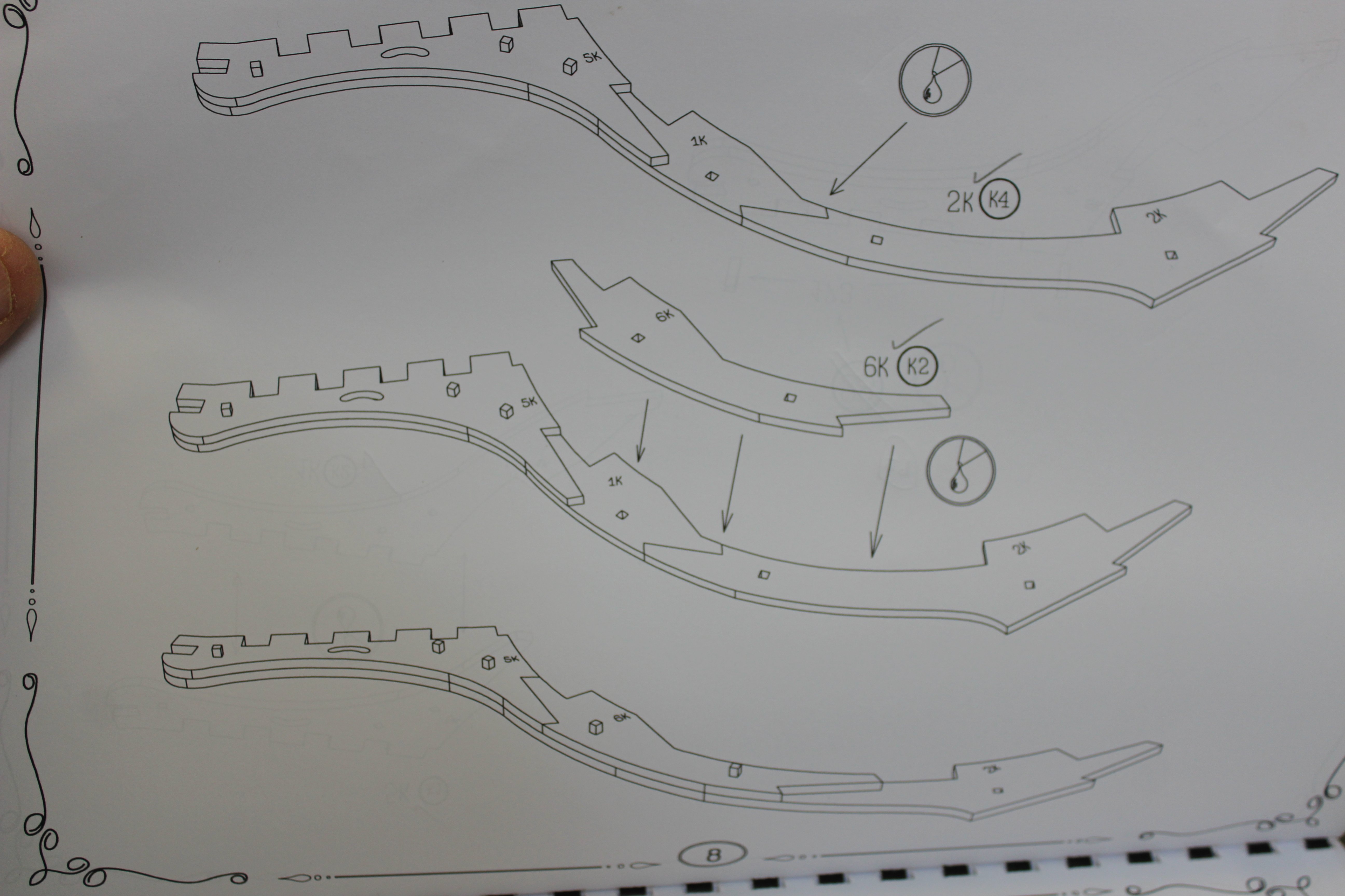

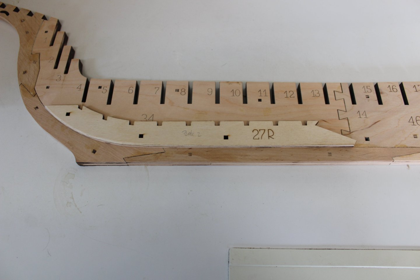

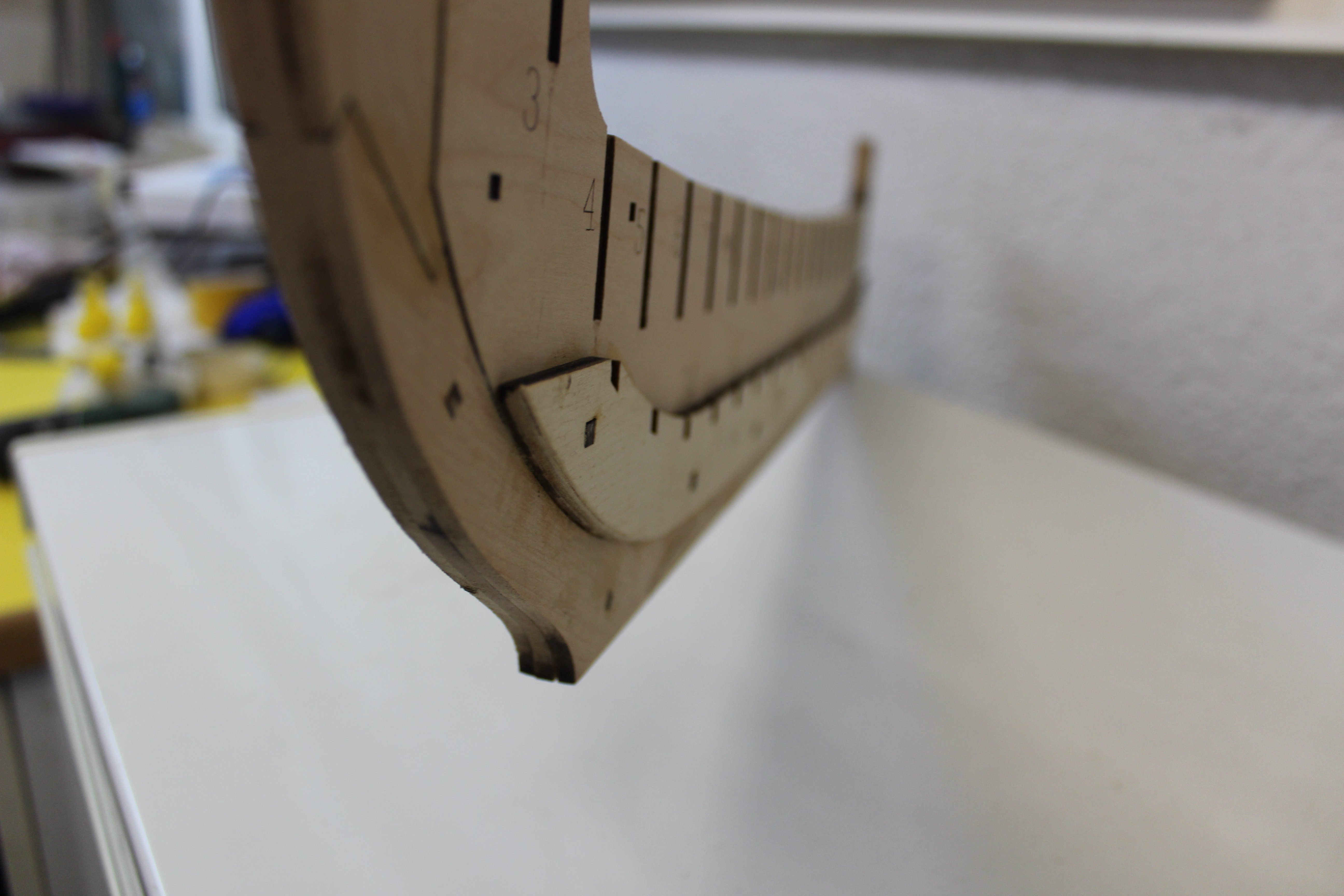

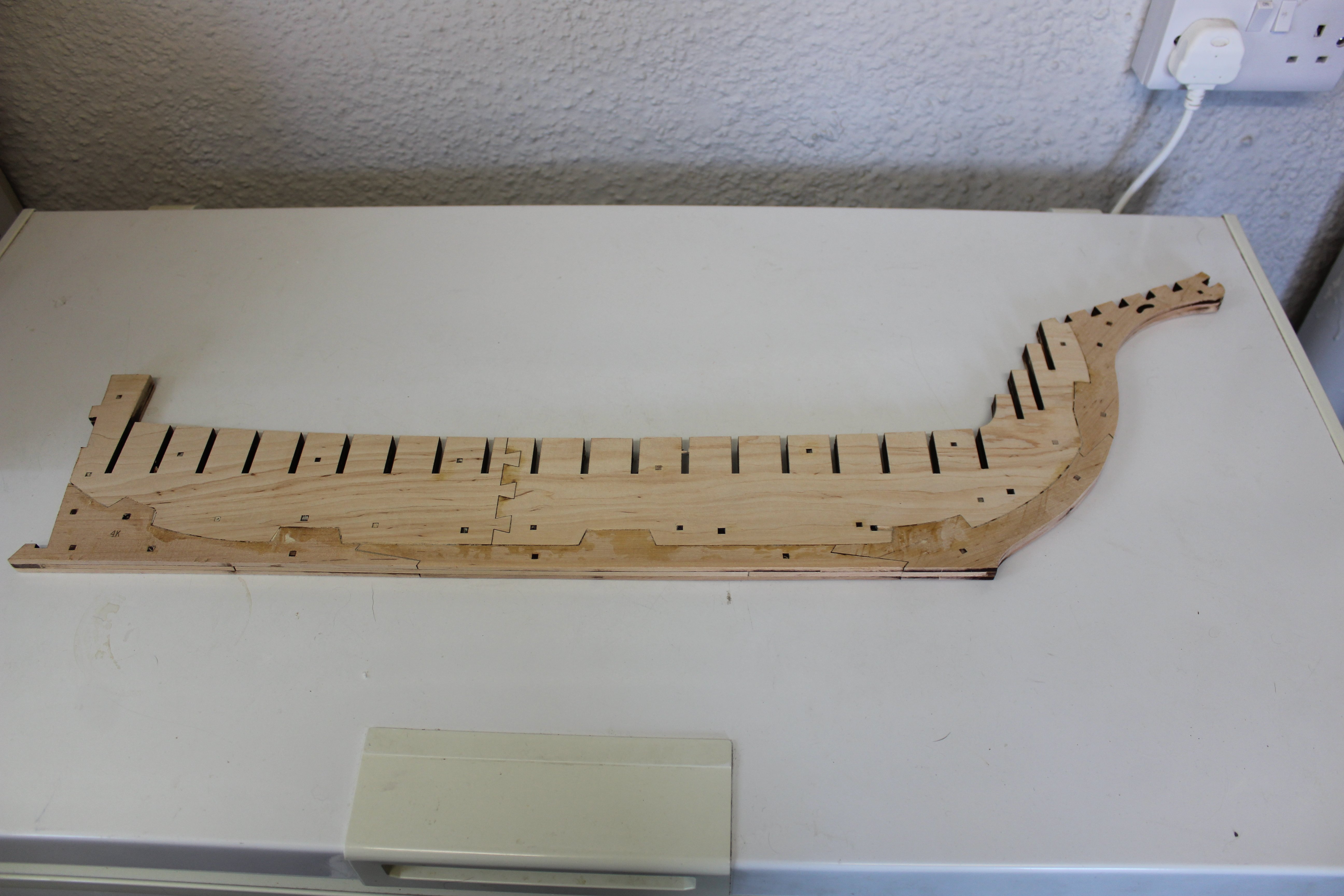

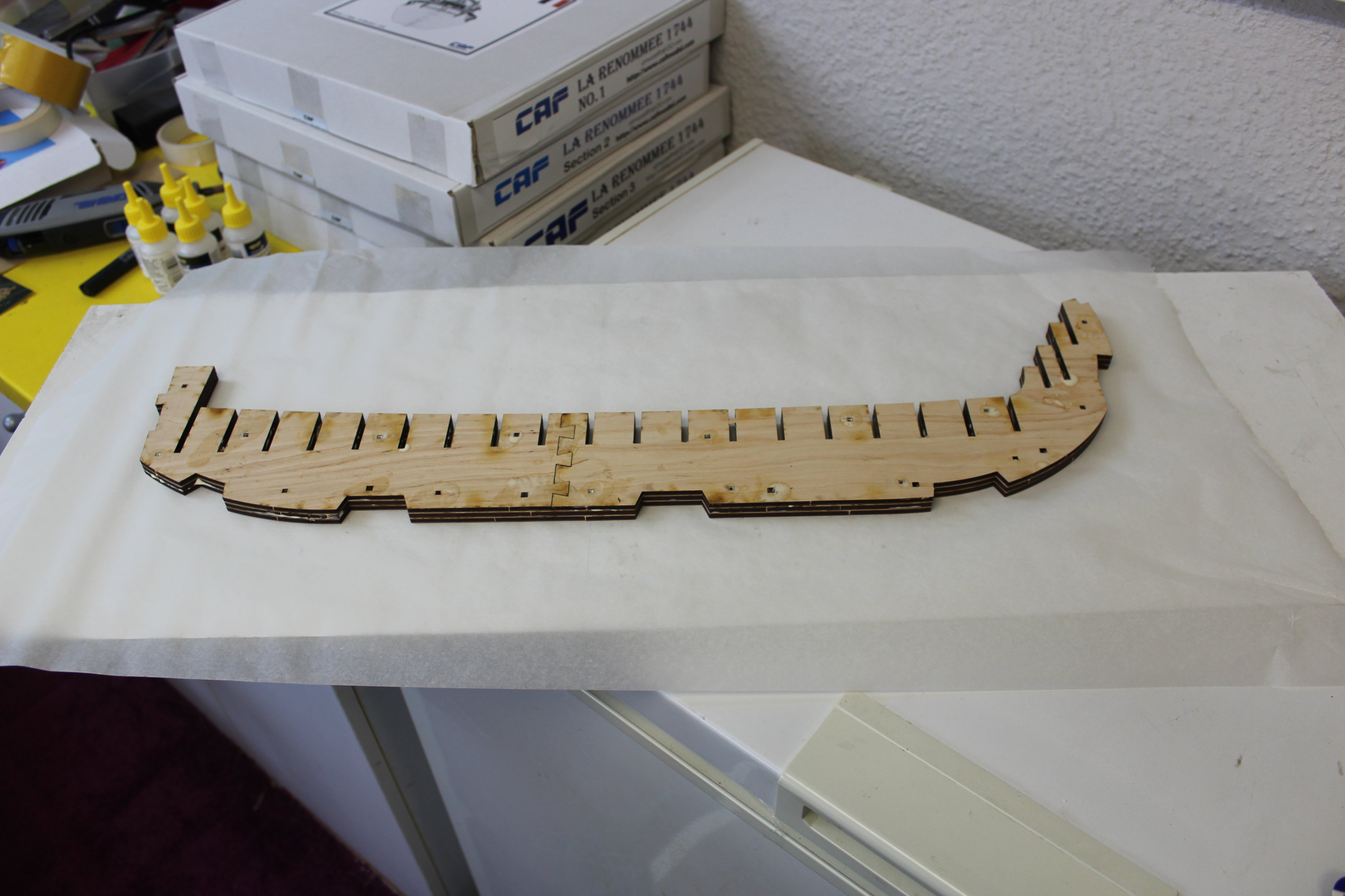

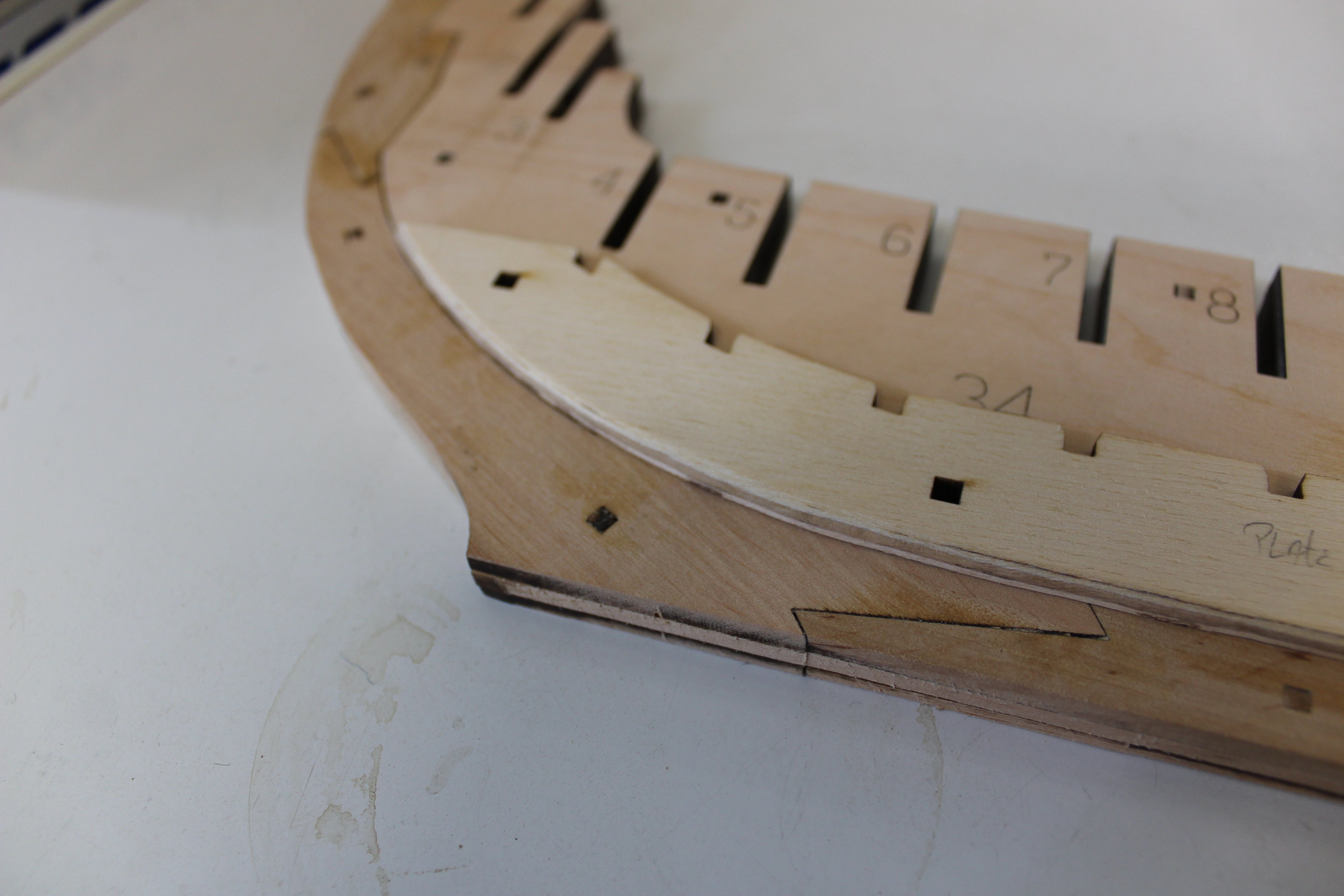

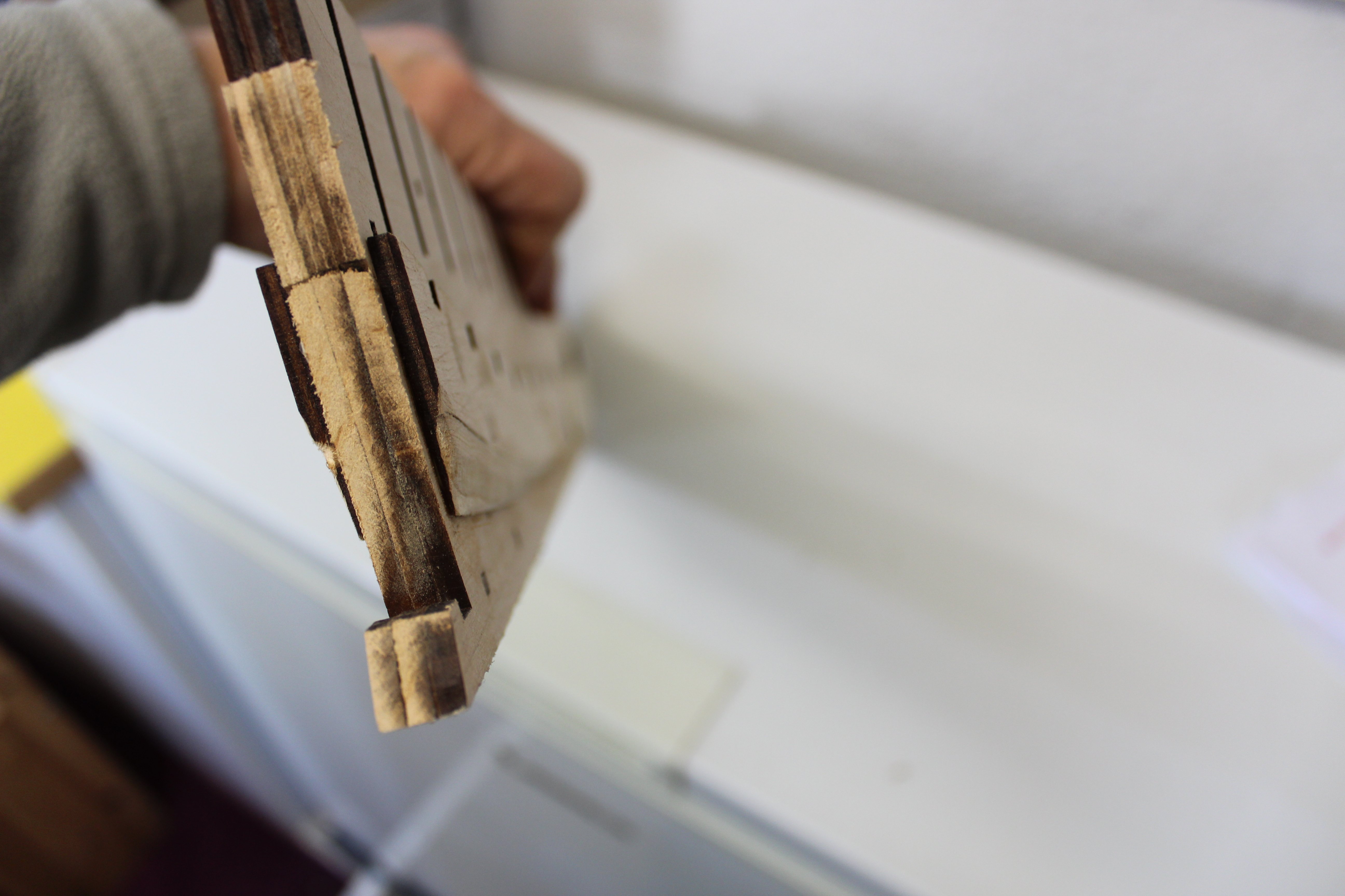

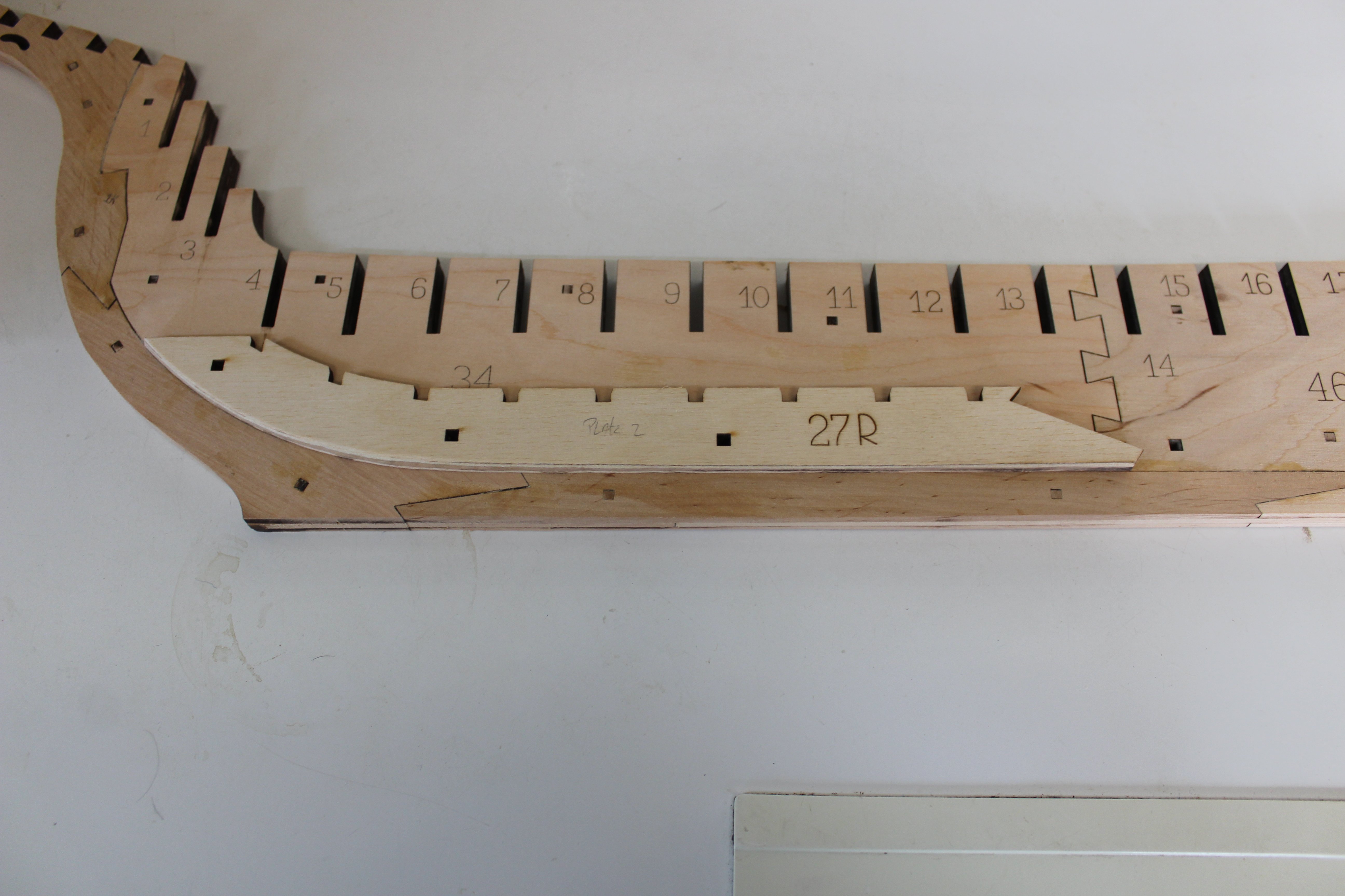

the centre line is made up from 7 pieces that are sandwiched together, and  kept in place with inserts, this was then allowed to dry under weights
image.thumb.jpeg.bd7061845a5af17b628ea6df983172c0.jpegimage.thumb.jpeg.b48af2df850eb3b456064677cf1a3c24.jpeg
the same with the Keel
image.thumb.jpeg.8bf93c0b331598f02bb75ea194129219.jpegimage.thumb.jpeg.236c28773fdd87c1fcfb478eefaf4527.jpeg
and then attached together with tape keeping them together whilst drying

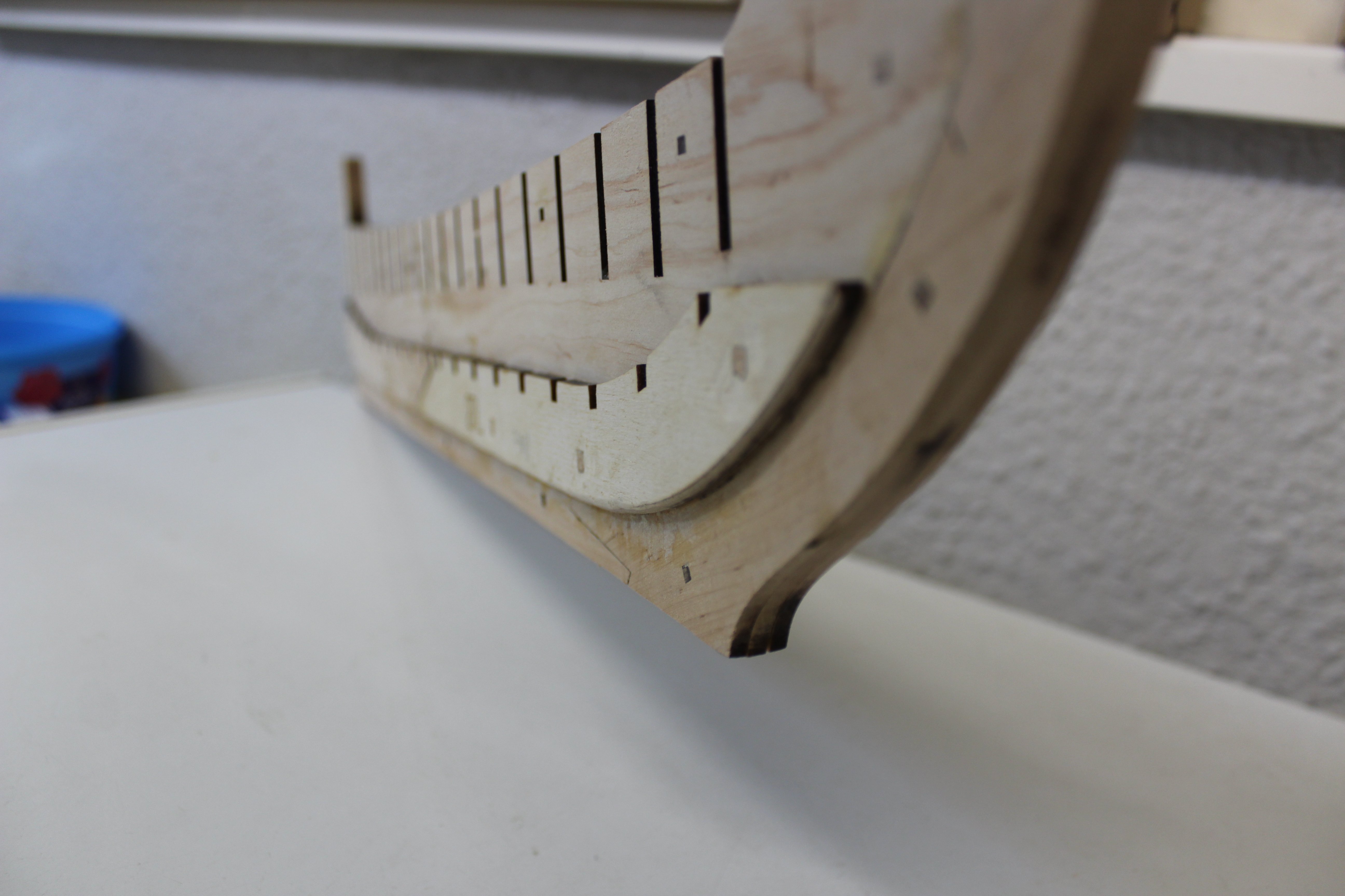

the next part has fairing lines marked on, so using a Dremel this work was quickly sorted, and sanded before fitting in place with inserts again, im noticing a few errors with part identification, , they are not always shown and some are not where they are instructed
IMG_5691.thumb.JPG.3e04ad73723e32a7f476acafc540876e.JPGIMG_5690.thumb.JPG.2edc10852e0562b27e60bde303eb319f.JPGIMG_5695.thumb.JPG.f67e9574c2b92dbcaf5dd6d466c87c5f.JPGIMG_5694.thumb.JPG.f84014a3523e43d466d604d21a0c472f.JPG

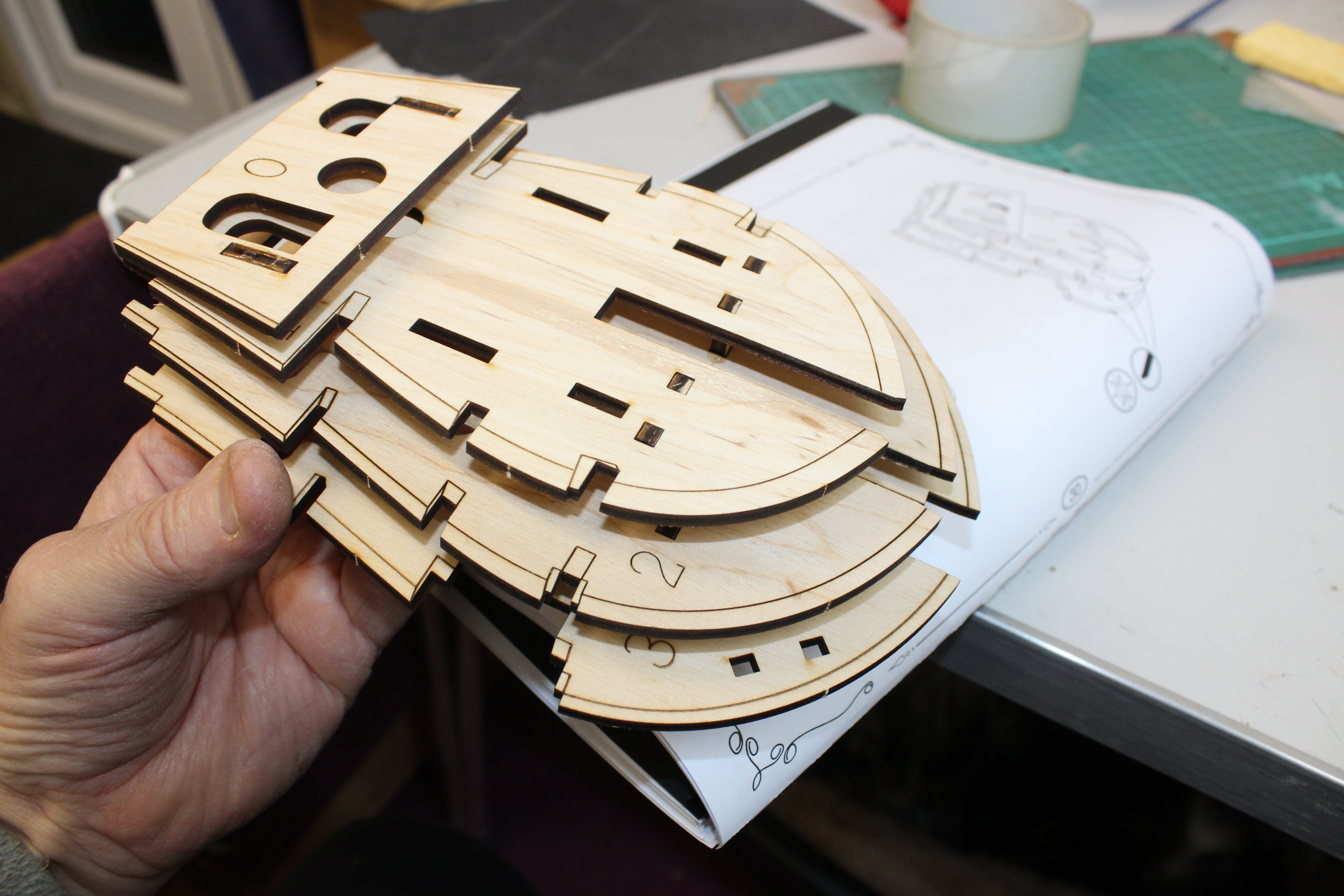

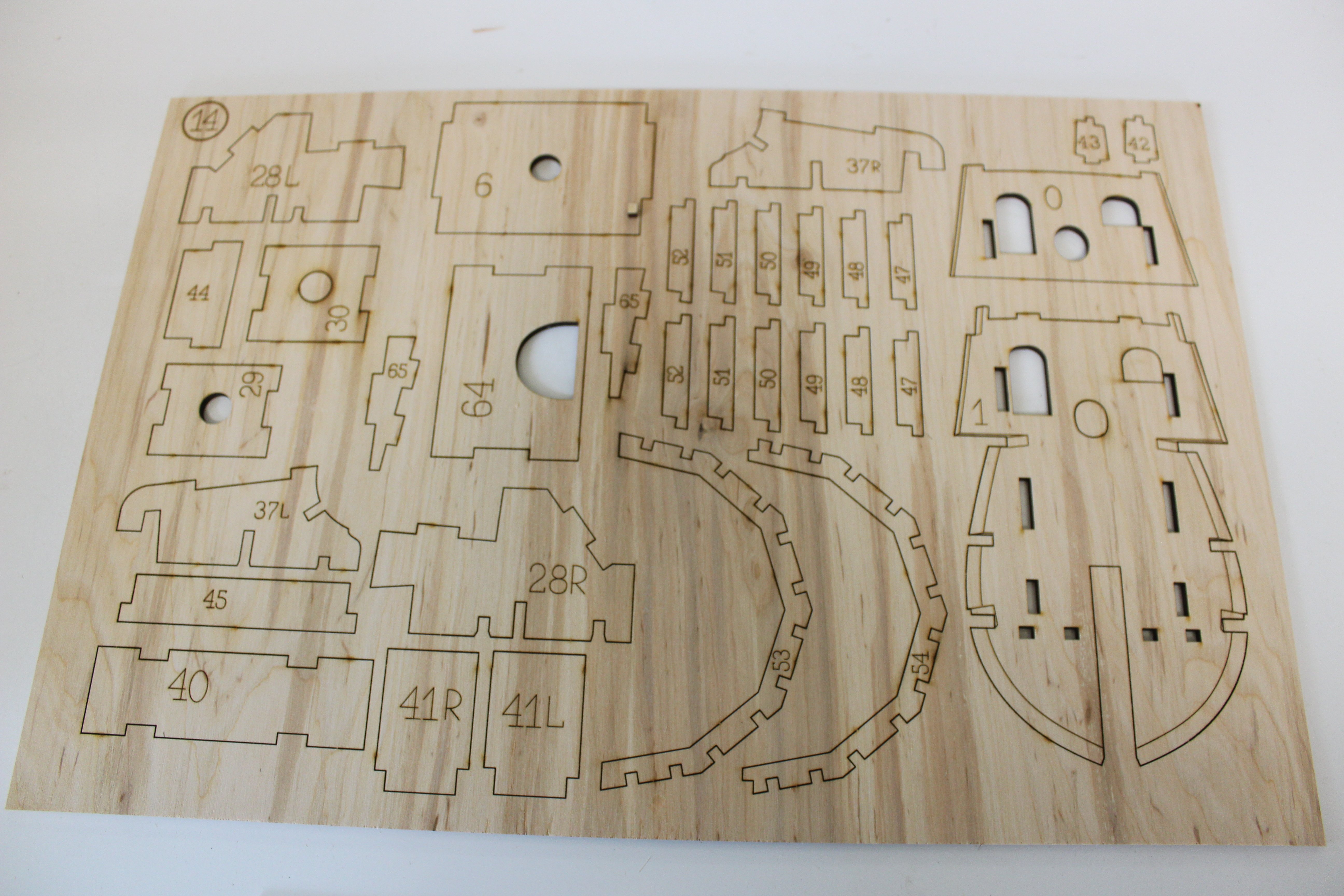

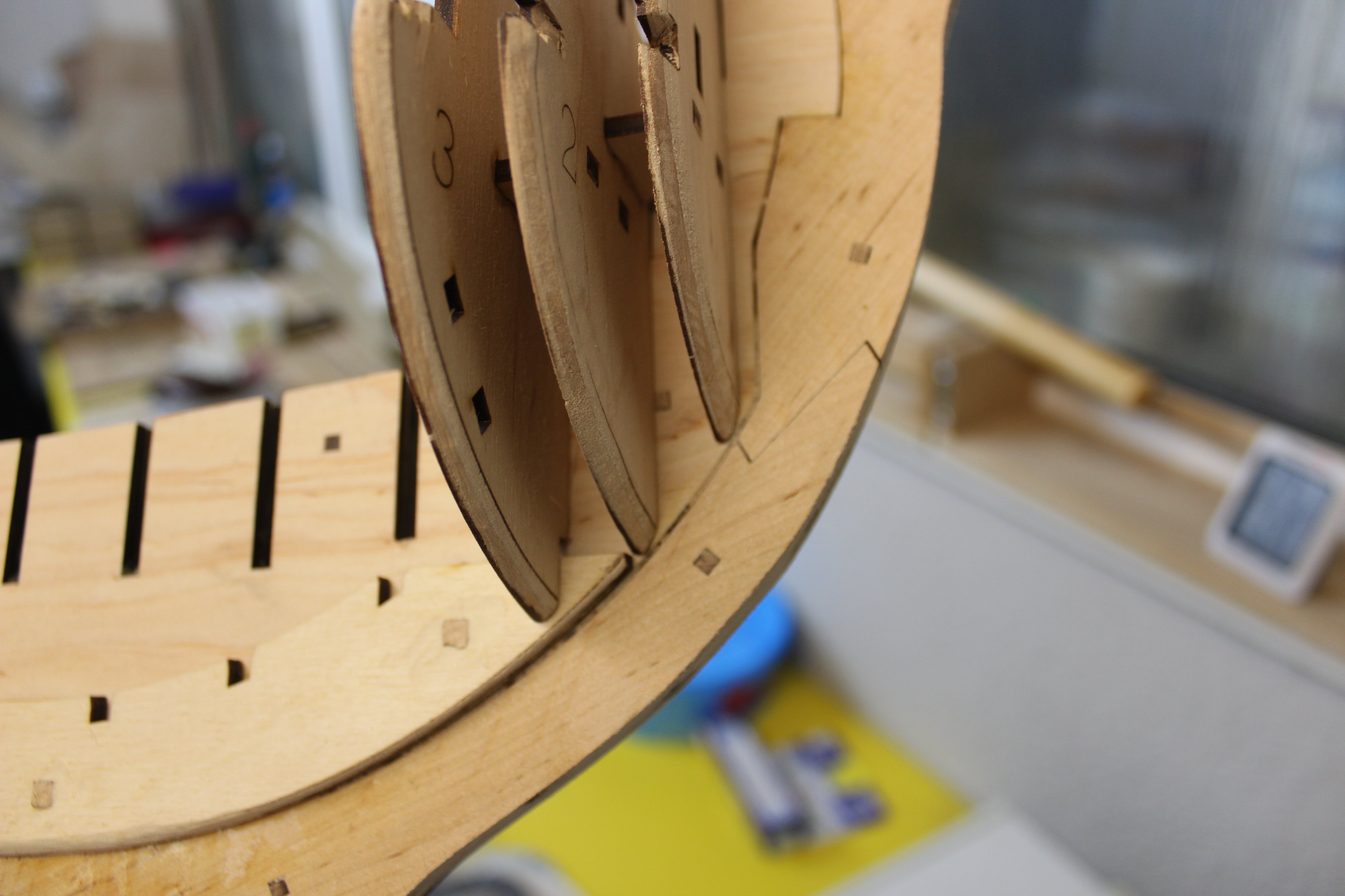

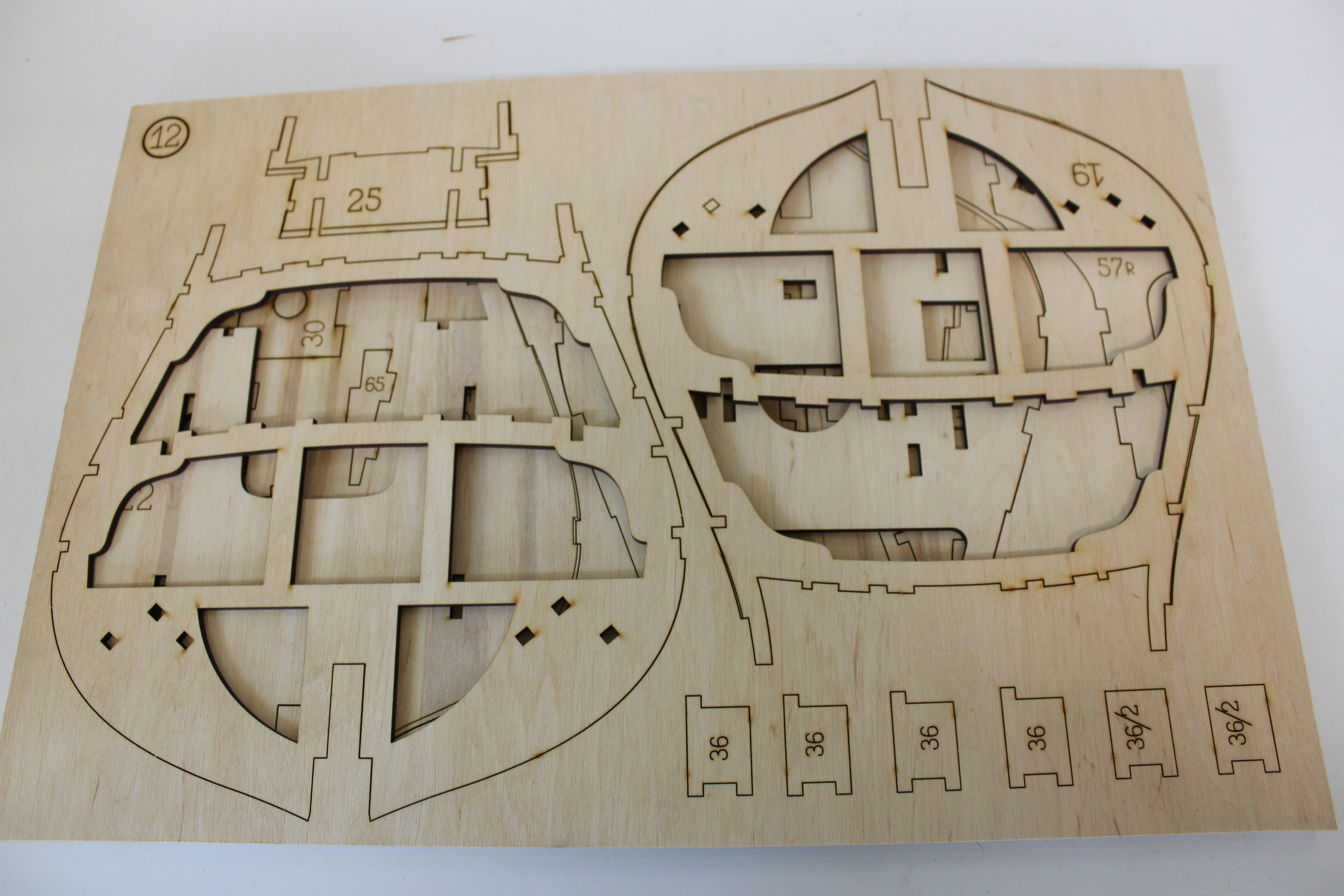

a lot of frames on this build, 24 of them, they are all tight on the centre line, but just removing the laser char enables the to slide on ok, the fwd and after ones however have faring lines all over the place to ensure the plank runs flow ok but also to ensure they fit on the centre line and doubler, the beech is easy to work with and sands down quite fast
the first three go on together, matched as a unit, i am however not ready for that and going to do all the frames before i commit to glue
24 frames to go
IMG_5647.thumb.JPG.8dc8b6d301c2e7a9f7f2469a1847e196.JPGIMG_5645.thumb.JPG.f912511c6277a1d35ca08740ca6c2020.JPGIMG_5666.thumb.JPG.3518dd55cda6e4d0f0543900a3a04edb.JPGIMG_5696.thumb.JPG.23ec4415af4f70cbf5ba4948ba52dae5.JPGIMG_5697.thumb.JPG.67cbf59130e16d50ec6eee2314da8cda.JPG
fairing lines to get a good fit
