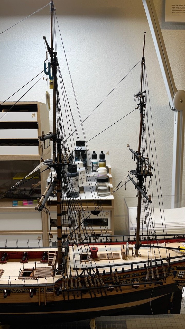

  11. Build day 186-187: 5,5 hrs in 2 days / Total 394,5 hours Started and completed Main and Fore braces in these two days. With this, rigging is complete, not counting that of mounting the boats. Photos 956-961: Some photos showing a few details.

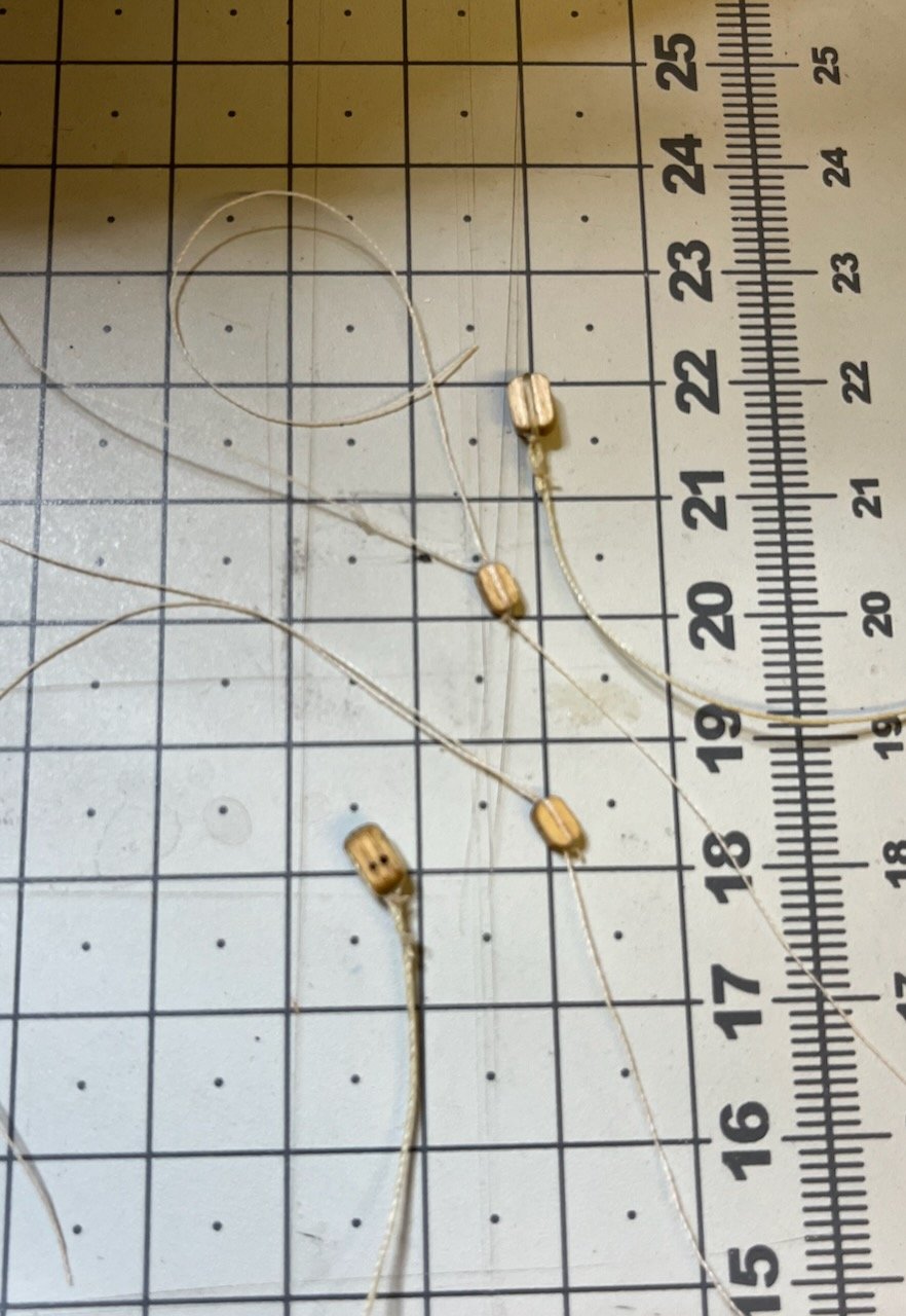

  14. Build day 185: 1,5 hrs / Total 388 hours Photos 949 - 954: Started and completed Main Stay Tackle and Fore Hatch Tackle. Took altogether 1,5 hours, including the time for investigation on the plans and instructions. As instructed, they stay loose for the moment, waiting for the beams and lifeboats to be installed. I figured that the drawings of the tackles on Plan Sheet 21, (Rigging Plan #2) use a different scale (neither 1/64 nor 1/128). According to my calculation I had to divide the lengths on the plan by 0.75 (in other words multiply by 4/3) to get to the 1/64 scale. The distance between the masts is 24 cm, while in the plan roughly 18 cm. Hence, 18/24 =0,75. I needed this calculation in order to identify the separation between the two tackles: Parts that make the tackles: Parts installed on the threads: Tackles ready to be installed: Tackles in place:

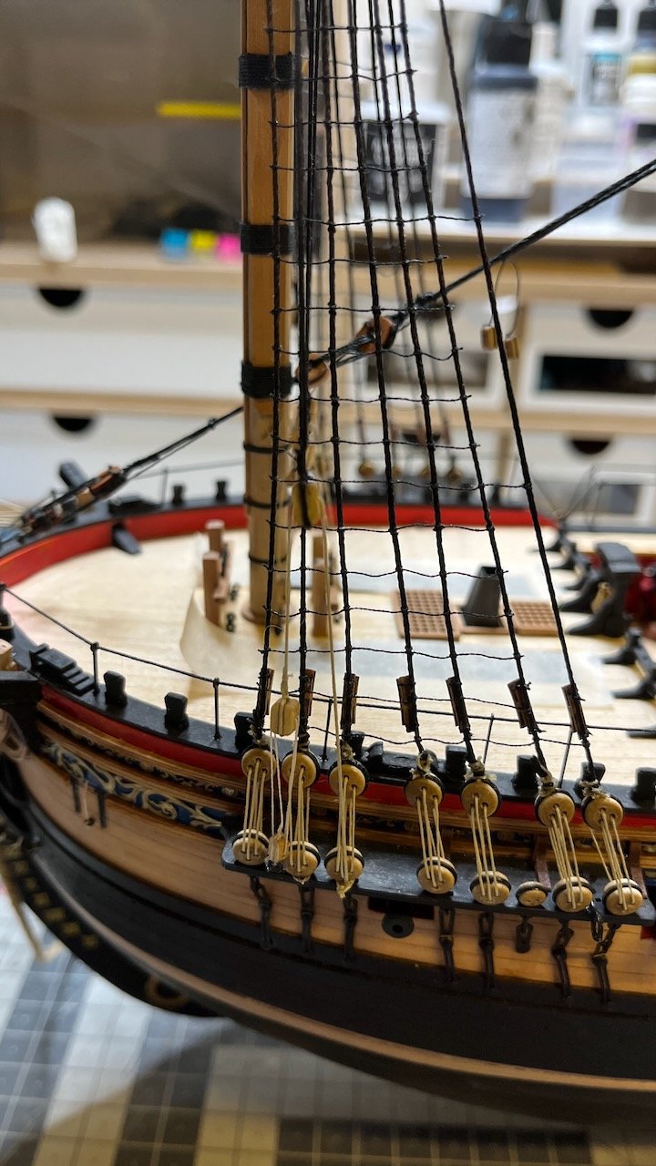

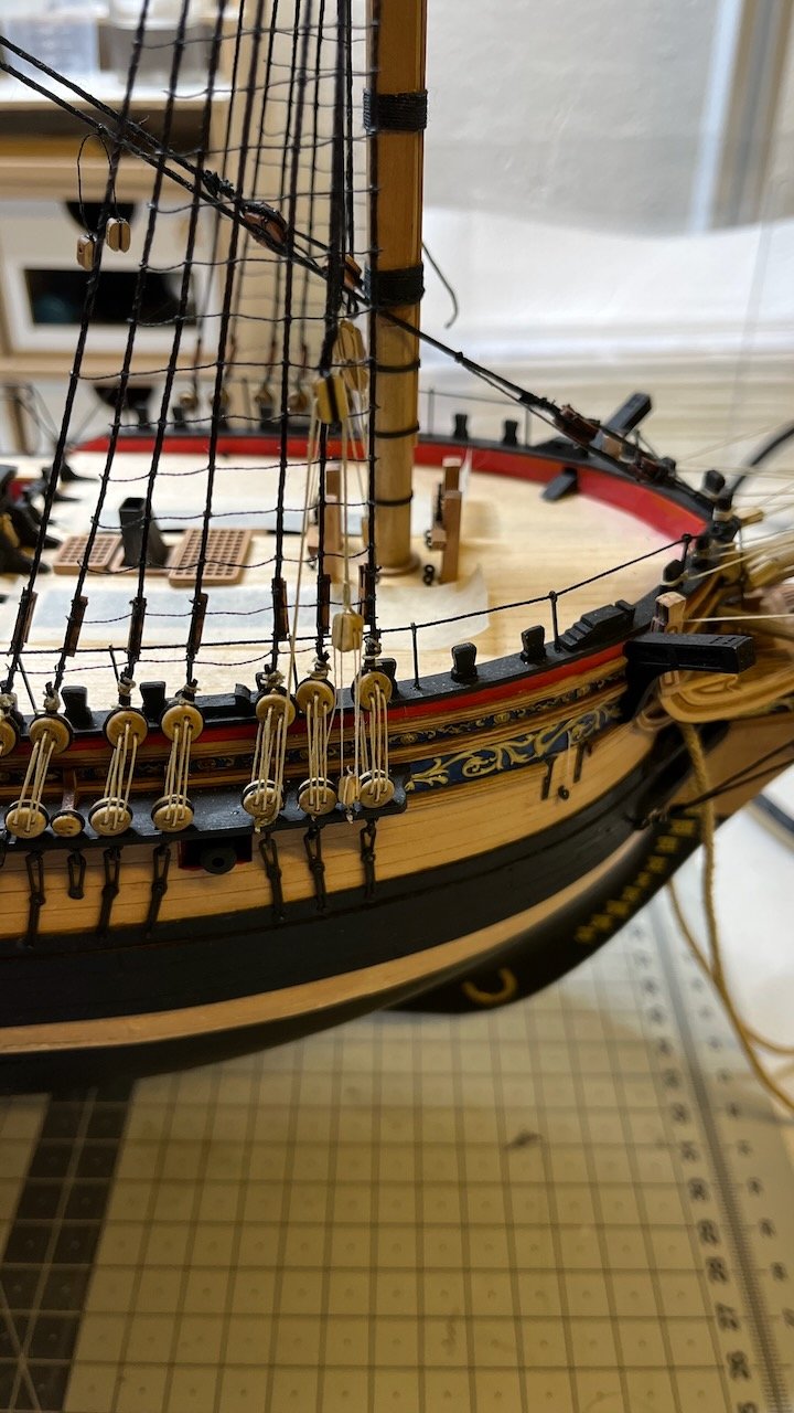

  16. Build day 184: 4 hrs / Total 386,5 hours Photos 944 - 948: Started and completed Fore Sheets and Tacks. Some photos showing a few details and . It was not really possible to take a photo showing everything.
