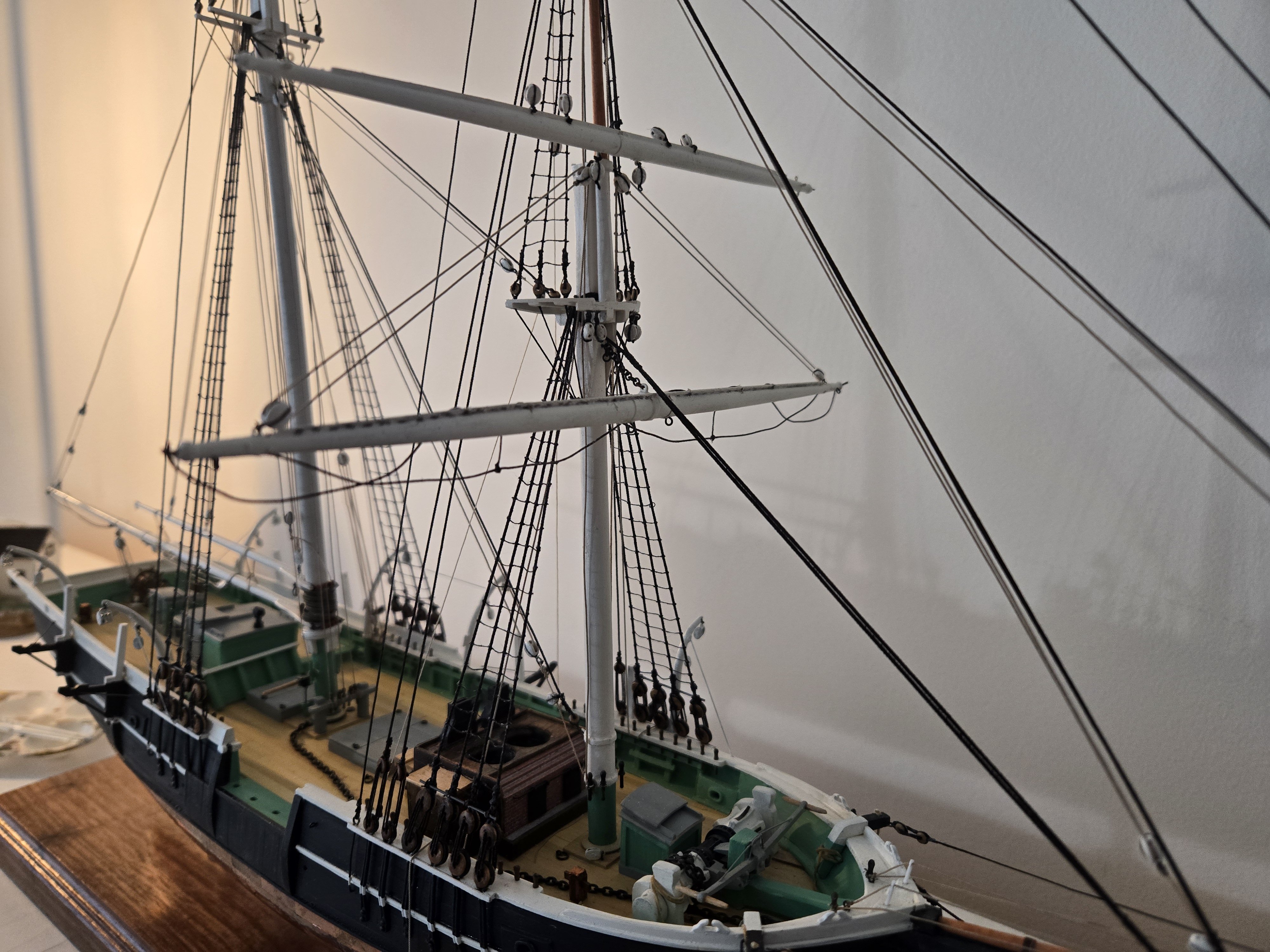

Richvee. At this point I plan on doing the cutting tackle. Some of the bunt and leech lines aren't necessary without sails. Aesthetically it looks better with them, not sure how much I'll add at this point. It's starting to become a slow frustrating process interpreting the rigging plans. Thanks for the tips!

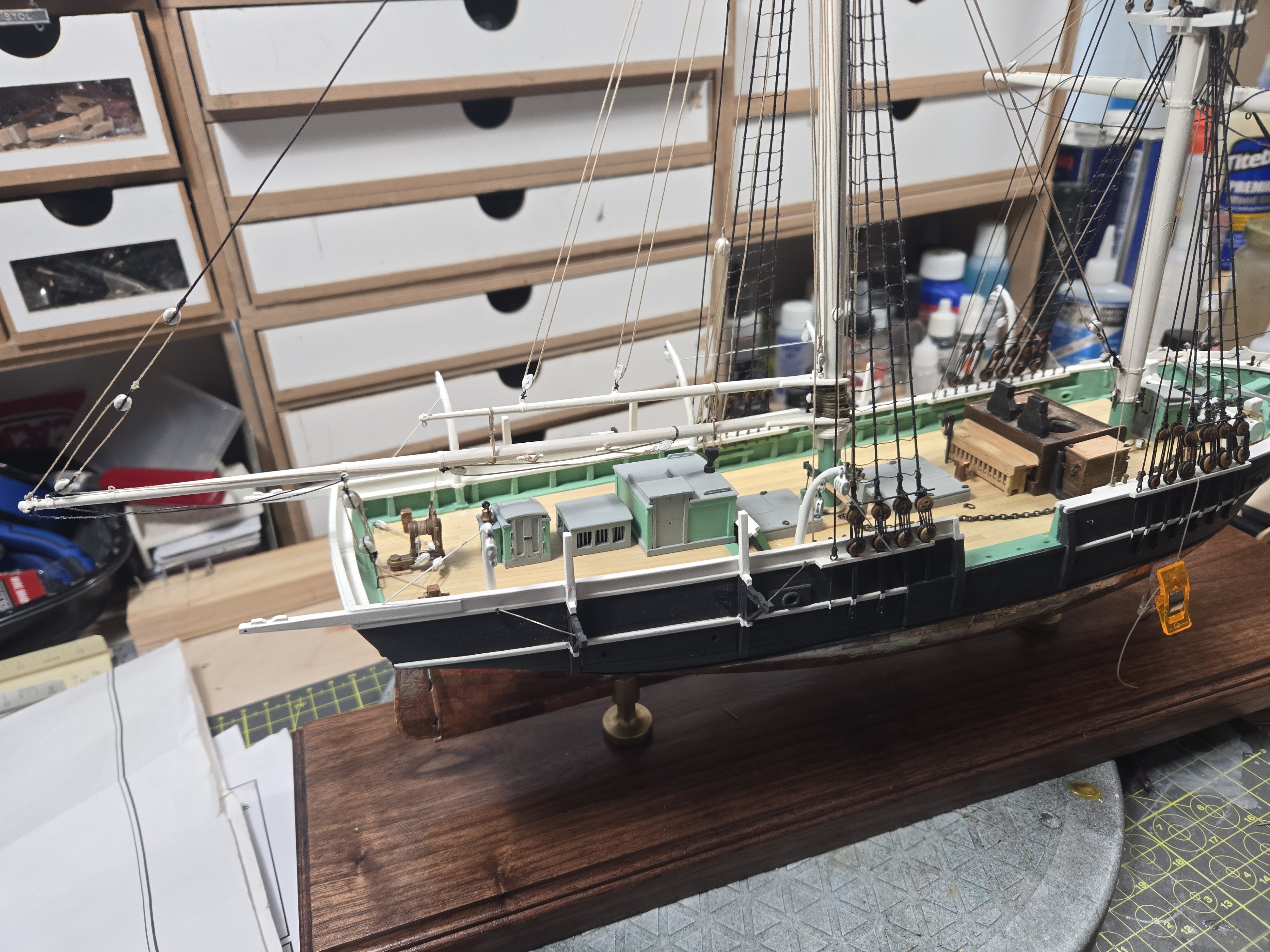

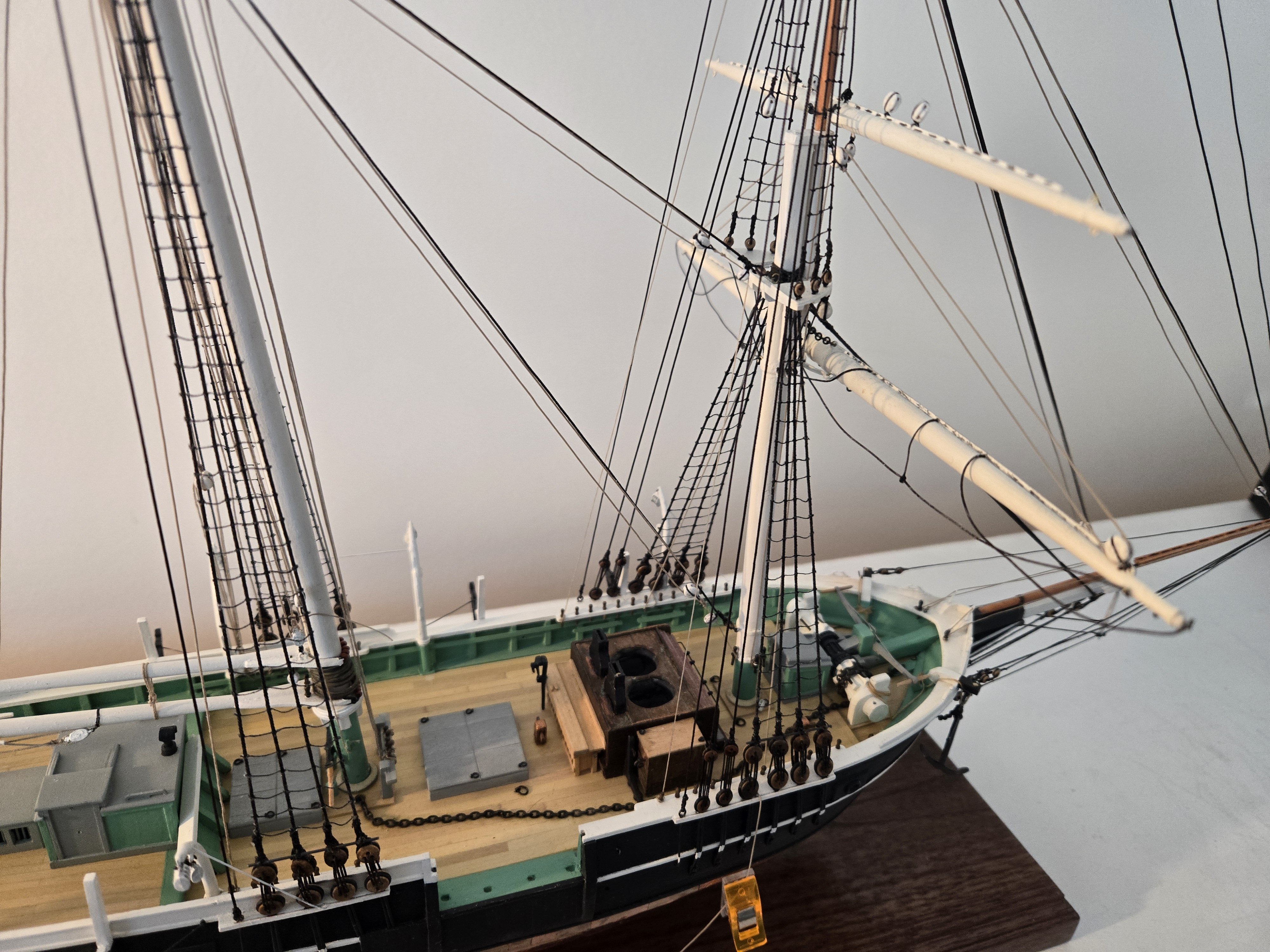

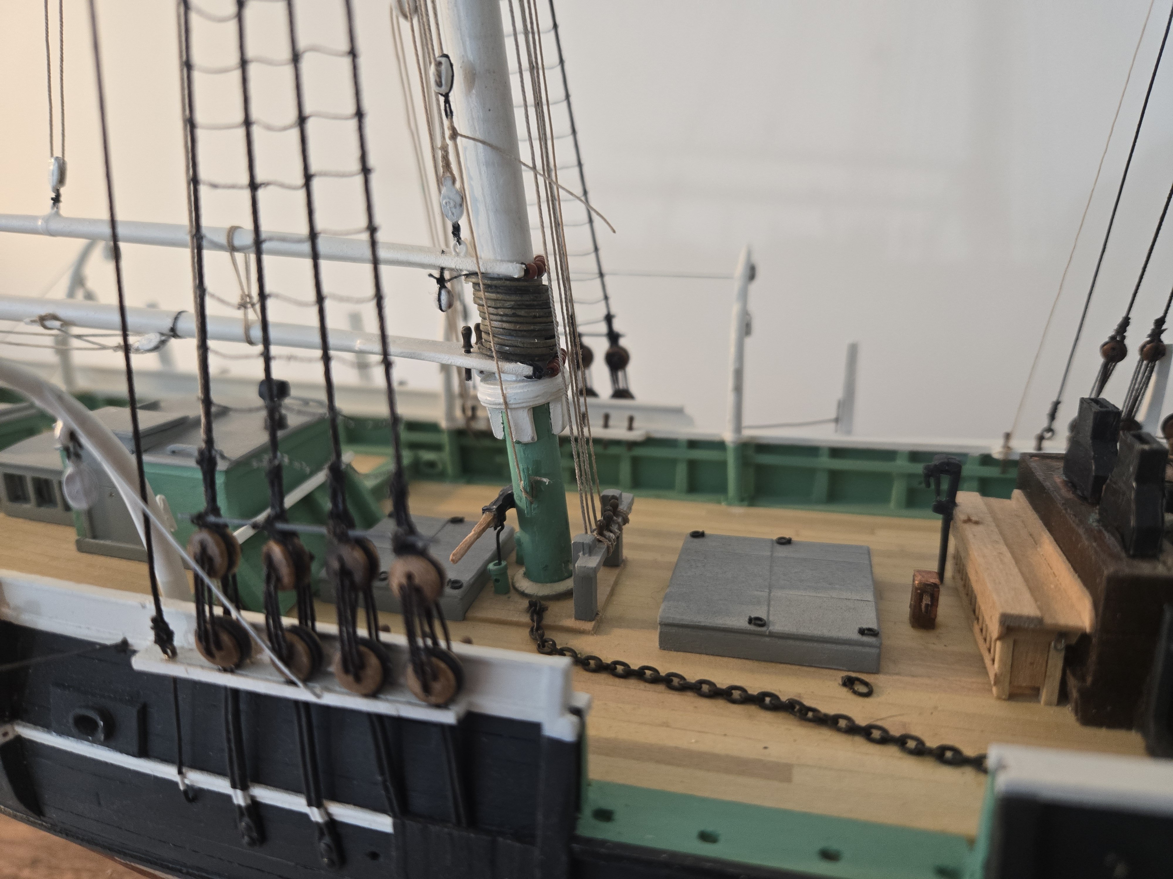

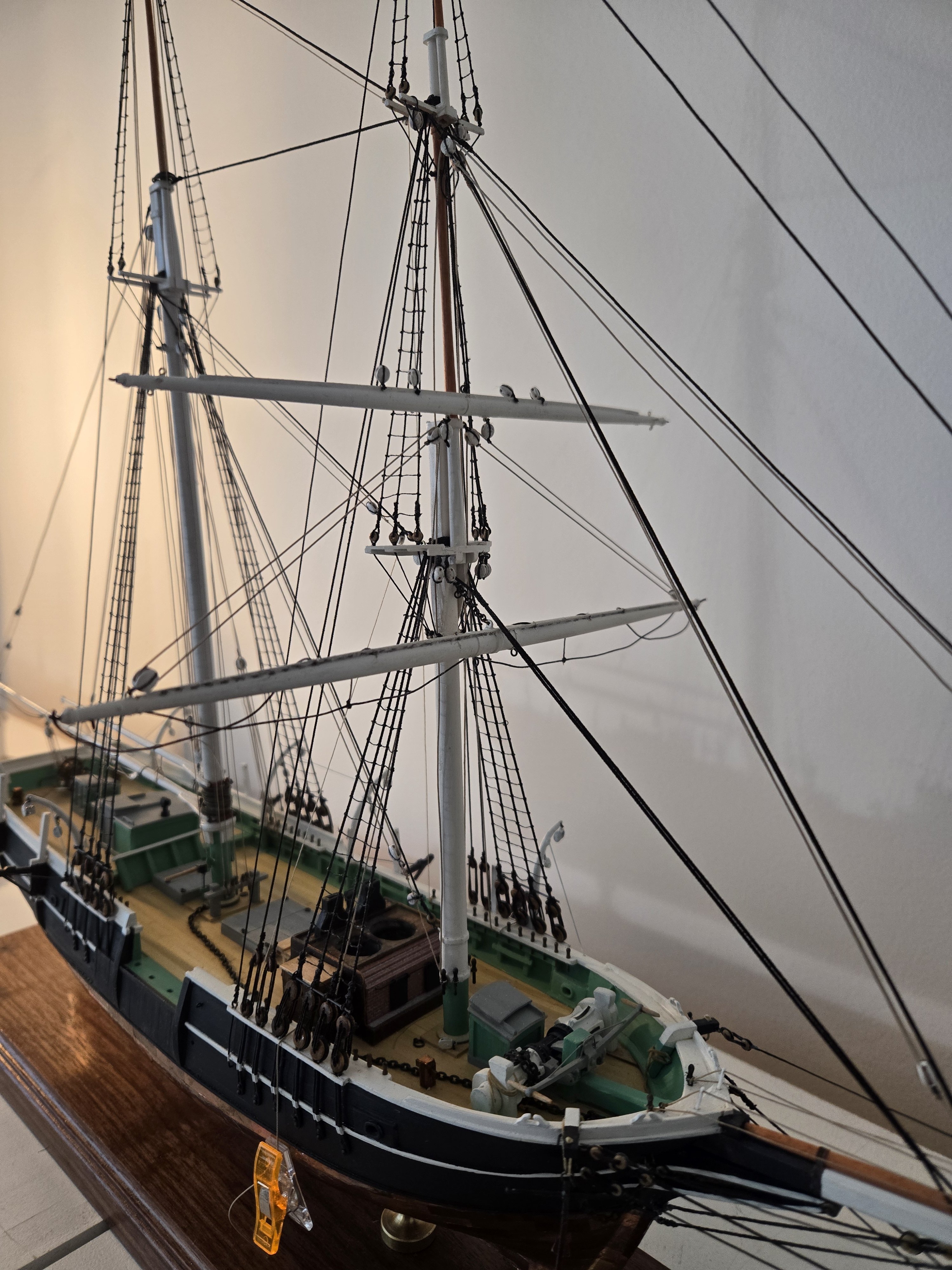

Rigging has been going slower than I expected. Have had difficulty at times trying to interpret the plans. Also, have been frustrated with shaping some of the lines to give a natural appearance. For example, the footropes. I applied coats of beeswax which helped shaped them, but they don't keep their shape. Hopefully over time they'll fall more naturally. If you're building this kit, or plan to, there is lots of tiny detail in the plans which is not obvious, like adding cleats to the masts for attaching hauling lines. Also, there are several eyebolts that need to be added to the cap rail for attaching lines. I didn't find these details until I noted them on the belaying points in the plans. A couple of "learning curve issues", attach as many blocks as possible, especially the Fore Course and Fore Topsail Yards! And I underestimated the amount of running rigging line needed when factoring in hanks and coils.

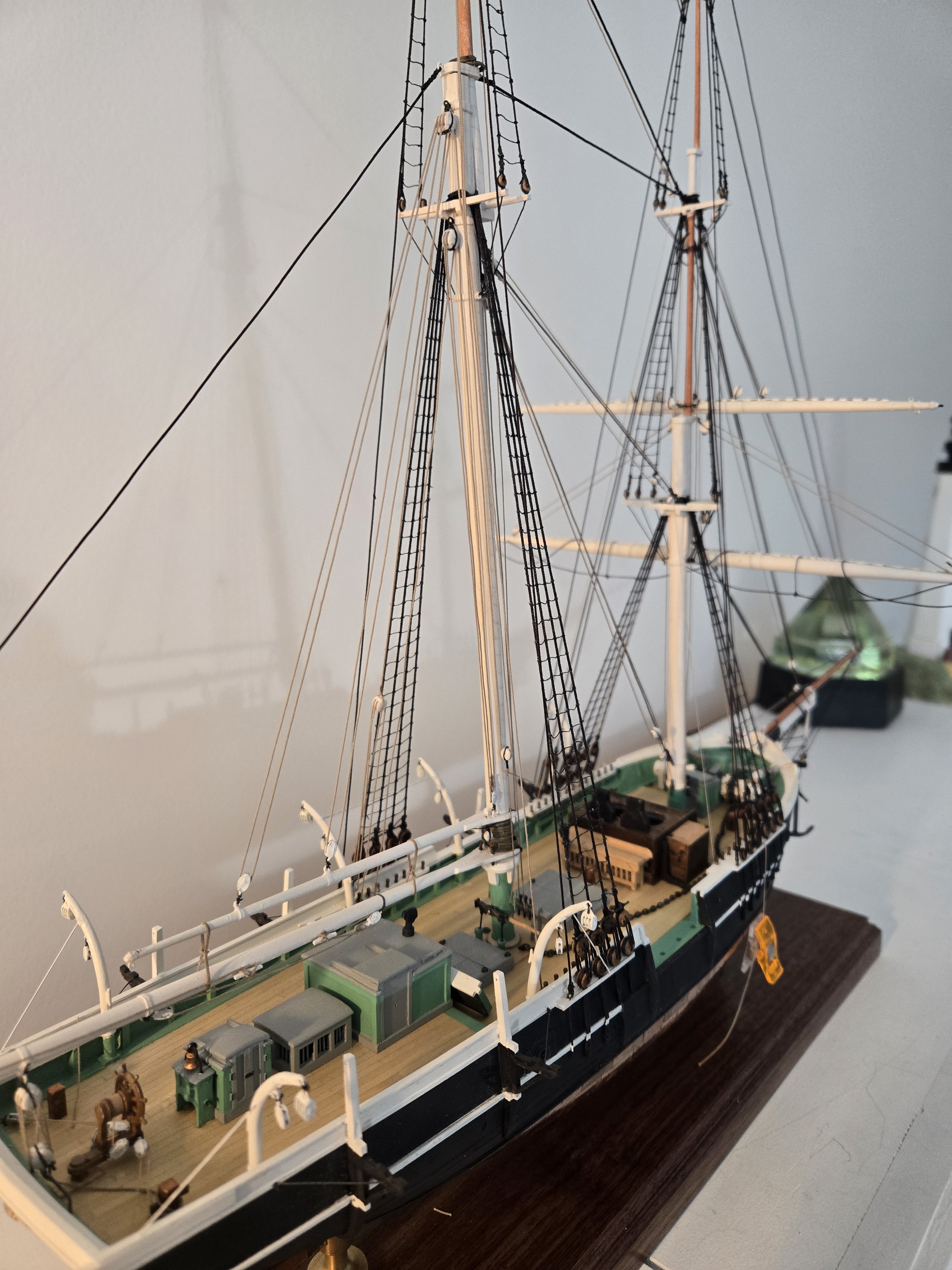

Finishing the standing rigging, next step is the ratlines! Not one of my favorite steps. Decided to stage the whaleboats and am really pleased with the alignment. I've decided to add them last, thinking it would be easier to finish the running rigging without working around them. At this stage I plan on methodically going over the build and doing any touchup and cleaning before the ratlines. Fortunately, I already had finished the yards and boom. So, running rigging should move quickly. Will also start working on the display case. I love this build!!!!!!

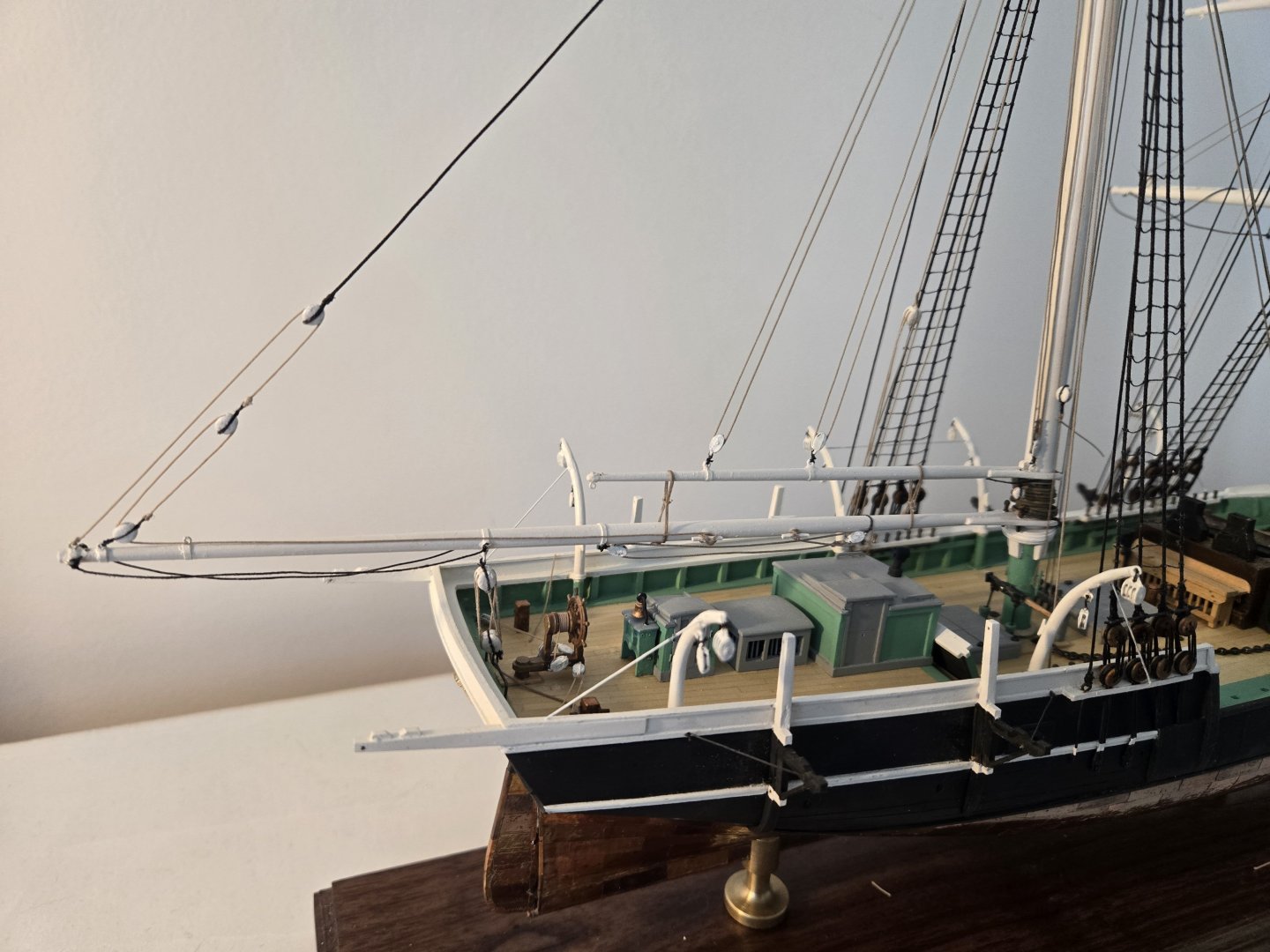

The plans for my current build (Kate Cory) note the use of numerous "Bullseyes & Lanyards". Basically, all involving the Bowsprit standing rigging. I have no experience with these although they look easy enough to assemble. The plans are vague and provide little detail, essentially, two bullseyes joined by rope. Searched the internet and my books but can't find any specifics on how these are put together. Is there a standard or rule of thumb distance between the bullseyes? How many times does the rigging/rope loop through the bullseyes? These details, or lack of, drive me nuts! Any help is appreciated.

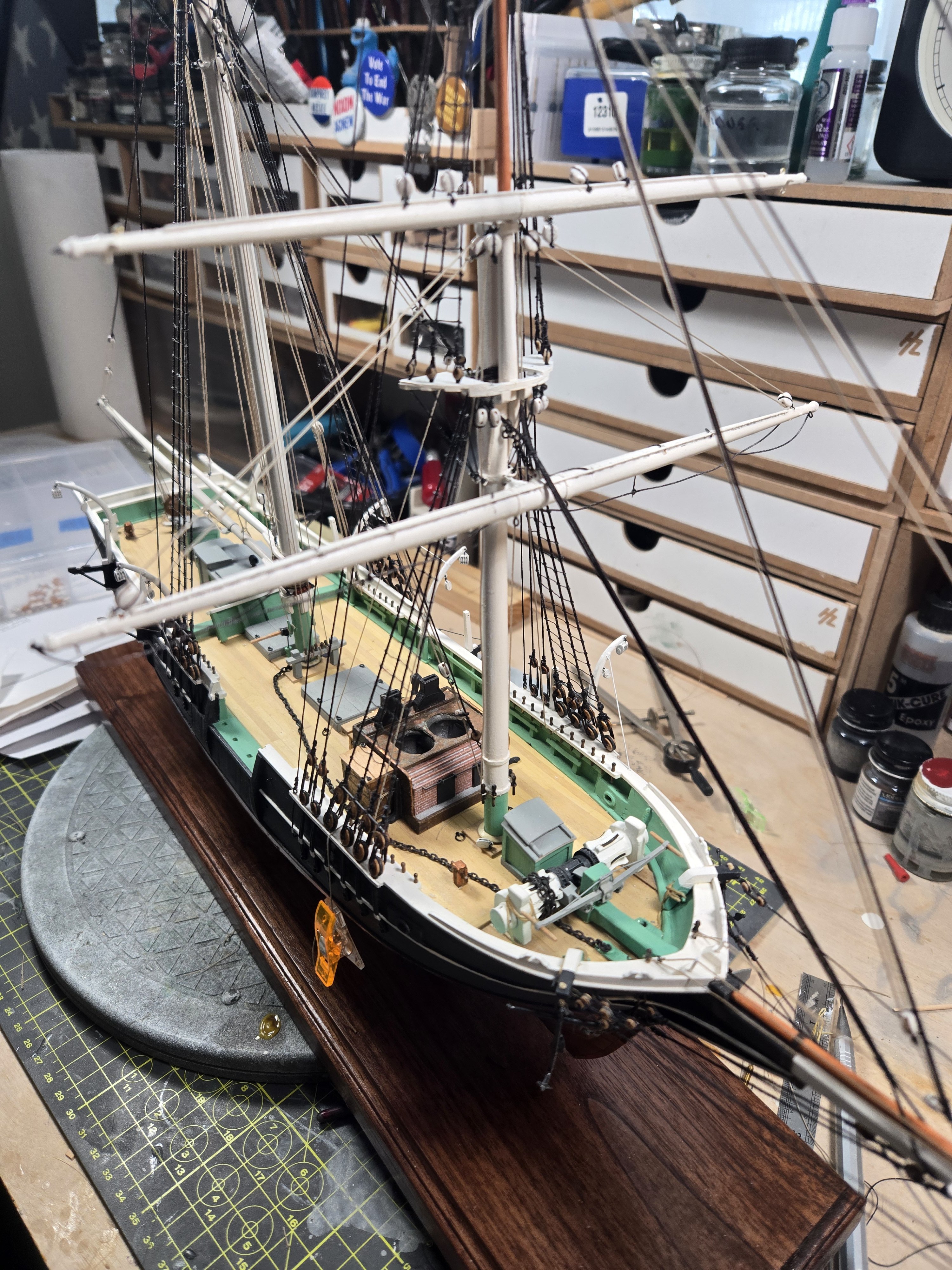

Slow but steady progress. Finished the log pump and wanted to get as much done as possible on the masts prior setting them. Ready to start the standing rigging.

A little detail not covered in the kit is that Kate Cory used two anchors as noted museum plan. Fortunately, I found two that are a close match on Bluejackets site. Finishing up the bowsprit detail and plan to install the masts this week. Once the main mast is set, I can finish the Log Pump, some clean-up and start the rigging. I found some scrap walnut boards at a local woodworker's shop and made the display base. Hopefully I have enough to make a matching display case.
