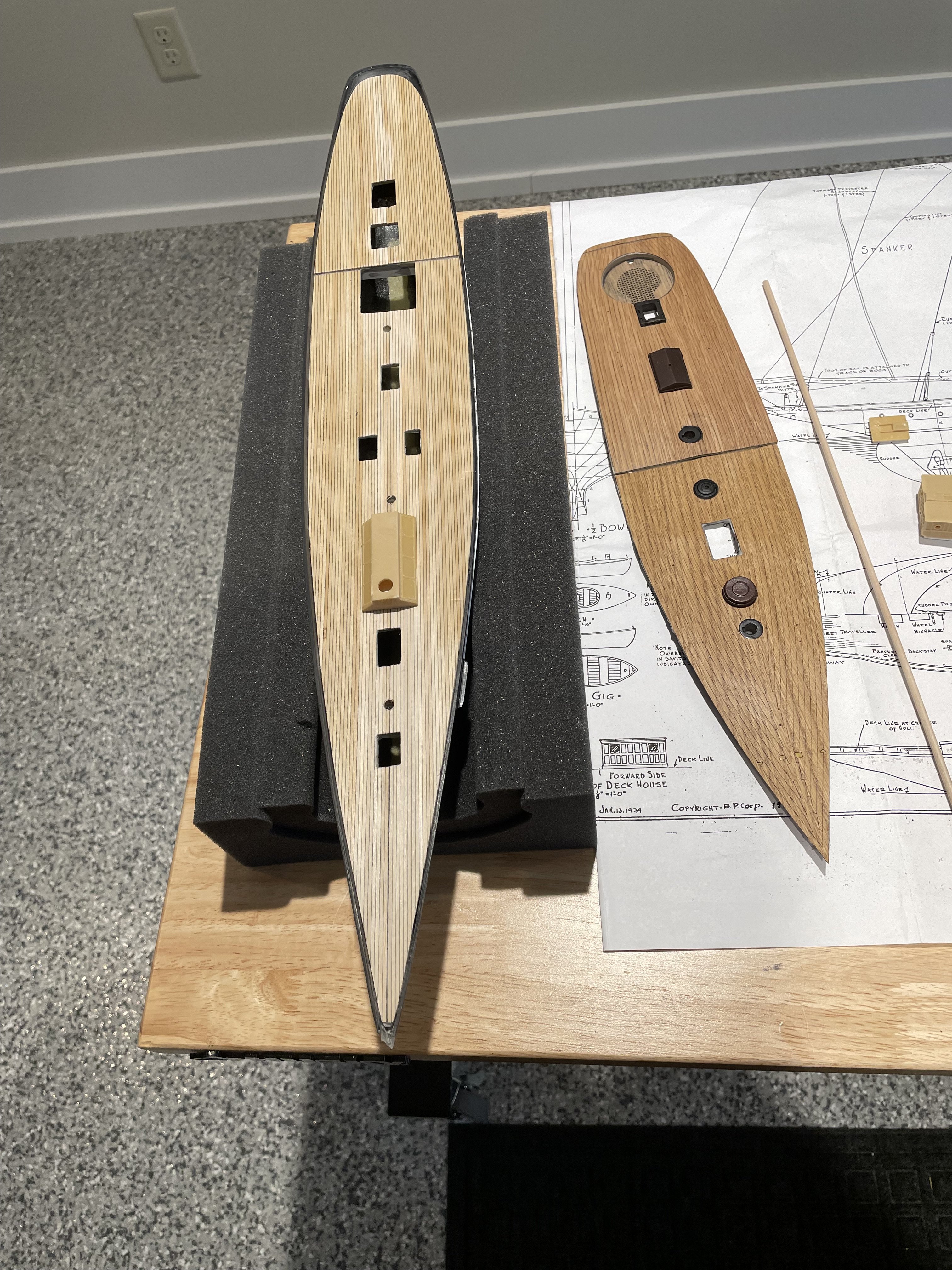

  4. All, here is a shot of the America’s deck with two coats of shellac along with the fitted deck for my Atlantic schooner. More to come!

  12. First installment.
    This kit has a very flimsy deck and  the masts attach directly to the deck as you can see in the photos. I reinforced with strops cut from 1/8  in  styrene sheet, both laterally and longitudinally. I will probably also extend the masts to the keel with brass rod. I used a laser cut deck made of wood veneer it is sealed with two coats of
    The masts were assembled with epoxy and brass rod in the in the cavities .  All the surface detail was removed. Metal mast rings will be added along  with cloth sails. Eyebolts, clears and mast clamps will be constructed of metal The topmost and gaffs will be made of wood.
