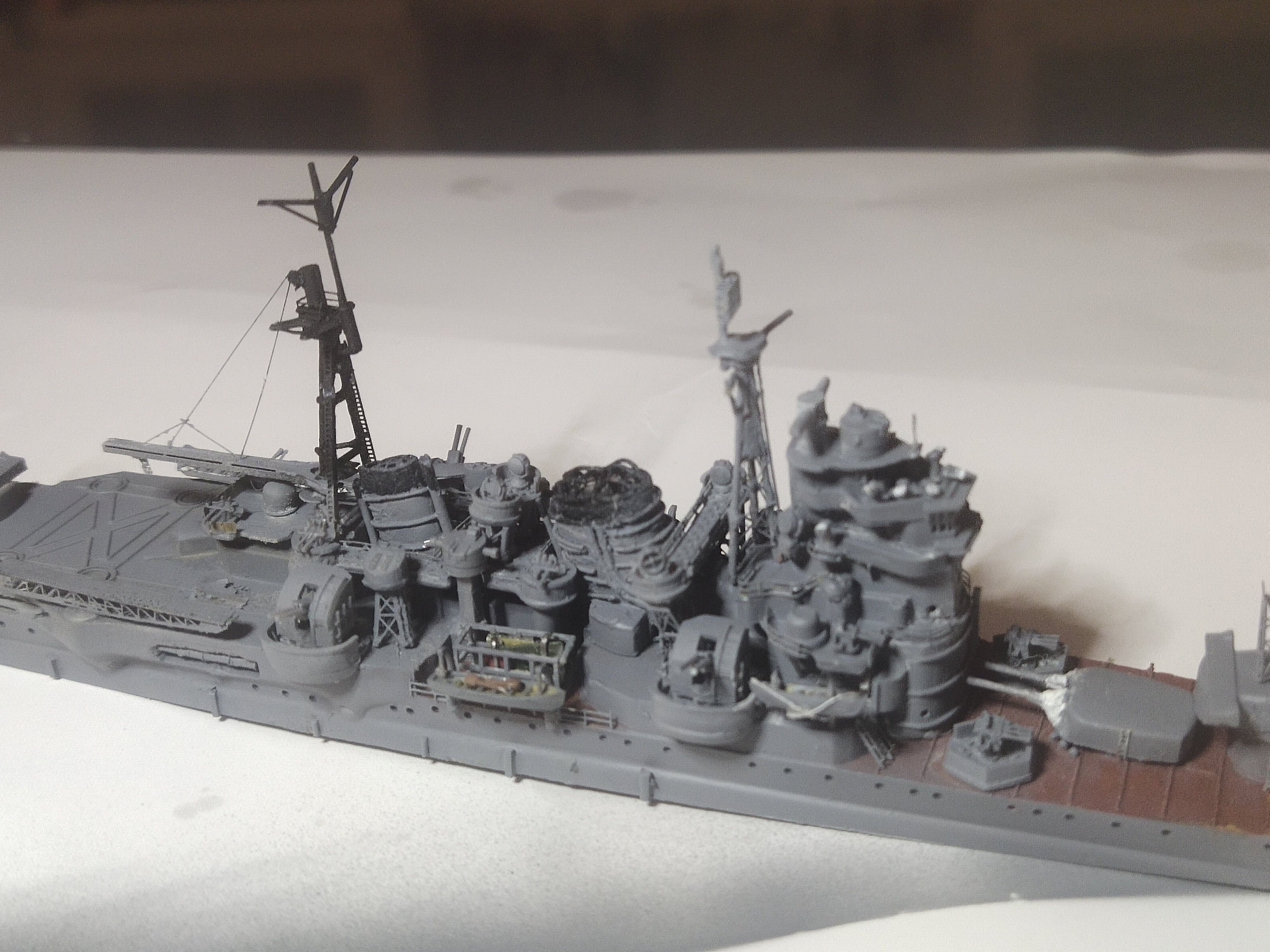

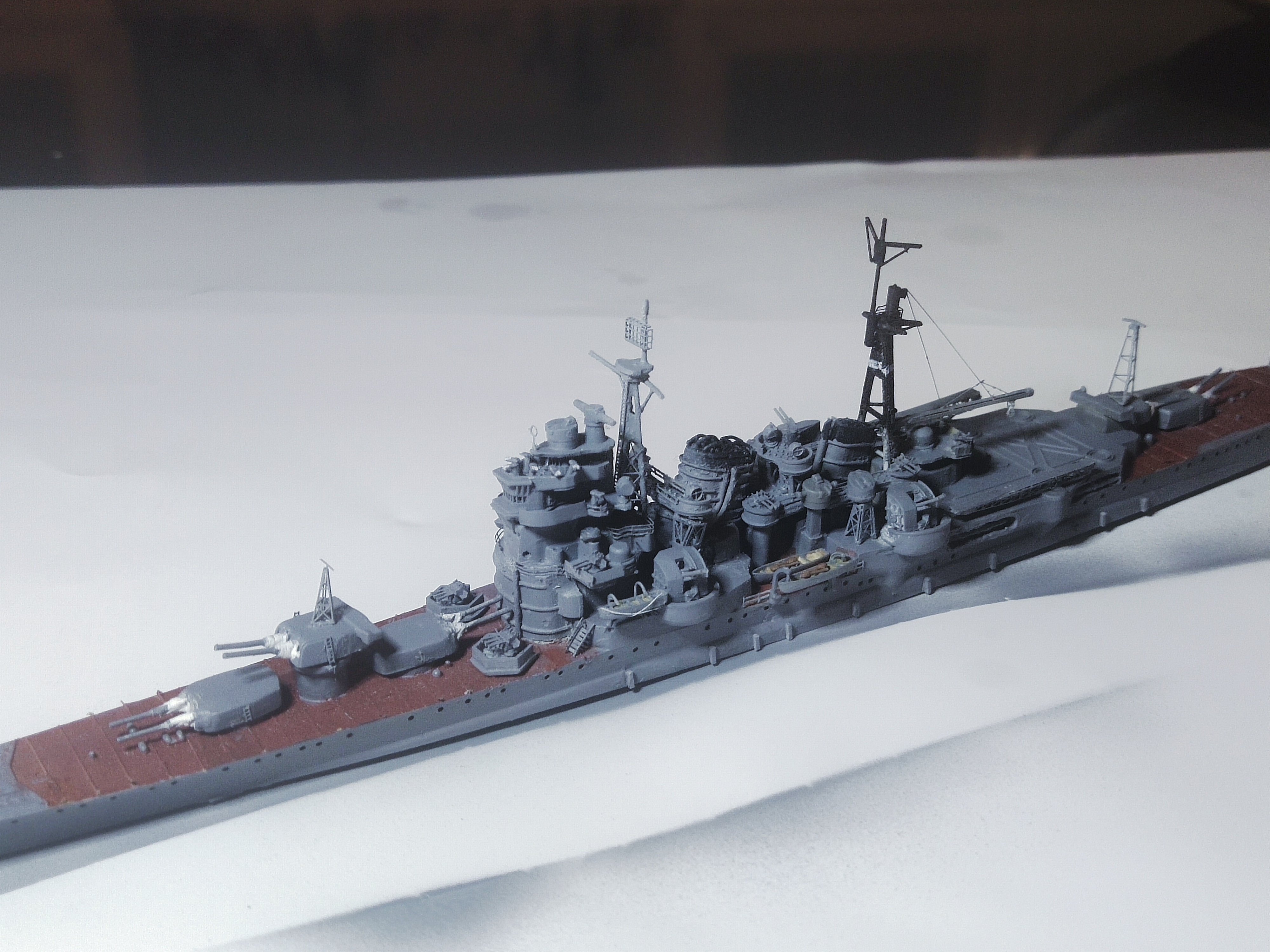

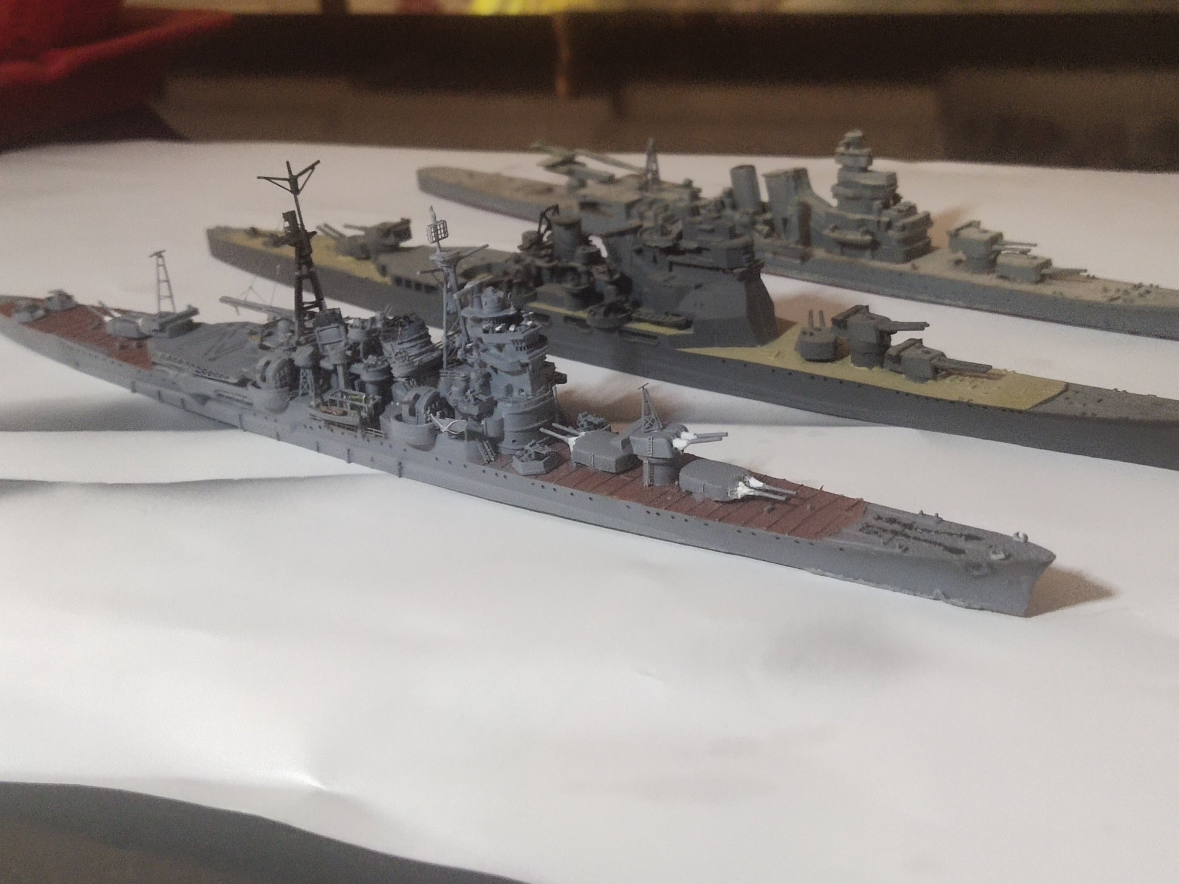

There's only one picture of Shinano available. I have Kagero's 3d book for reference. Starting from the top I realized that the oval shape of the funnel is wrong. So I printed some replacements to experiment with a teardrop shape. The superstructure is also not compatible with the PE parts so I need to work with it also Under the deck there is actually a Yamato class hull which seems that Tamiya used this to the Yamato or Mushasi model

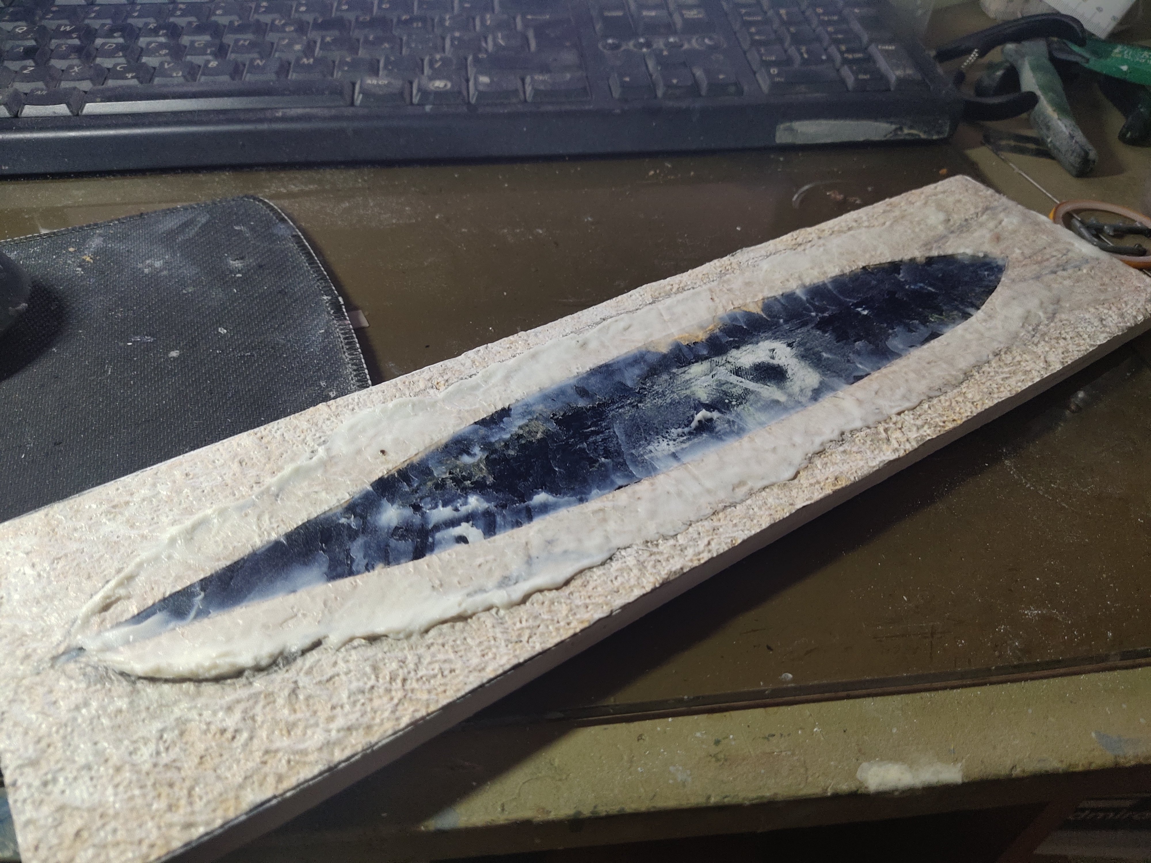

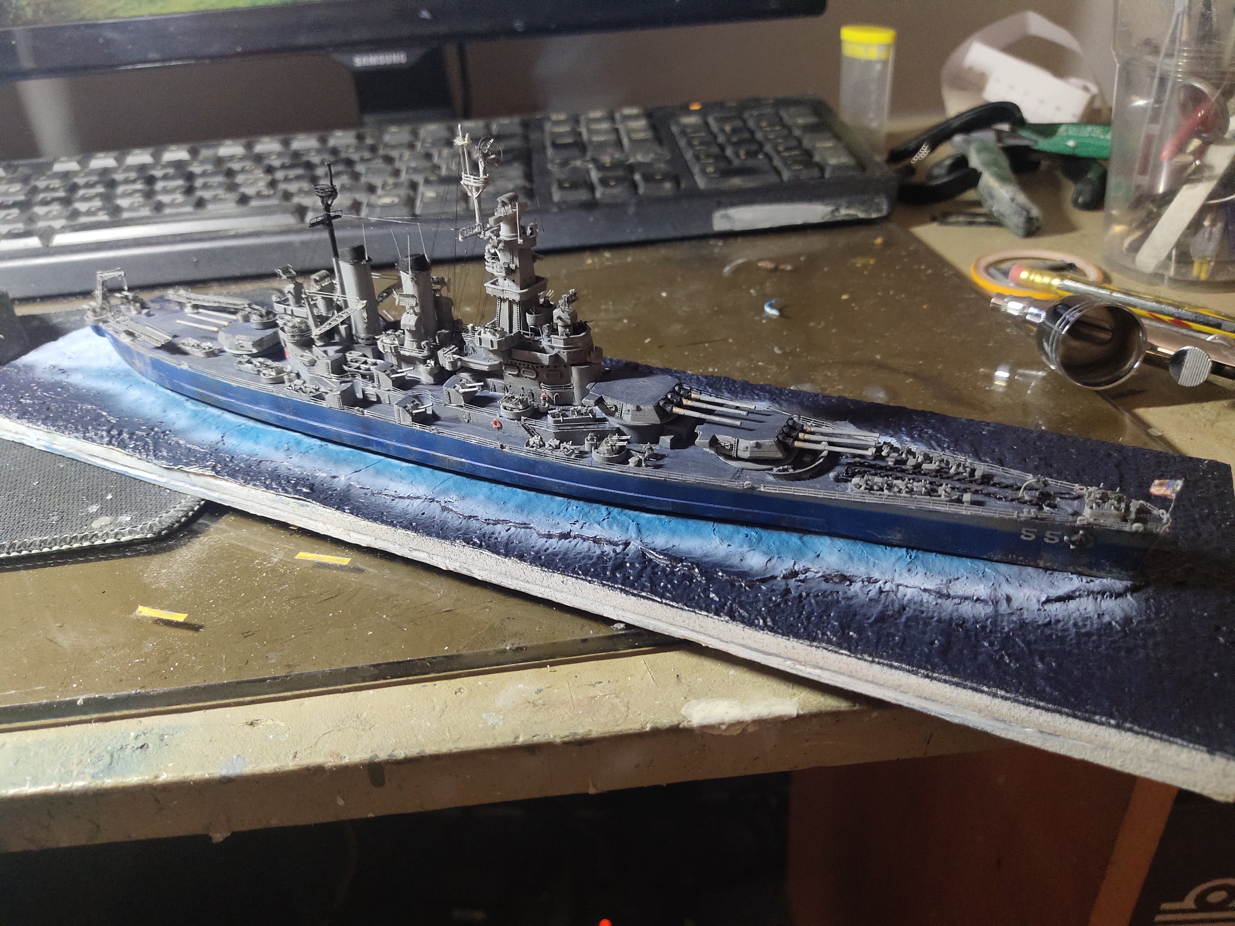

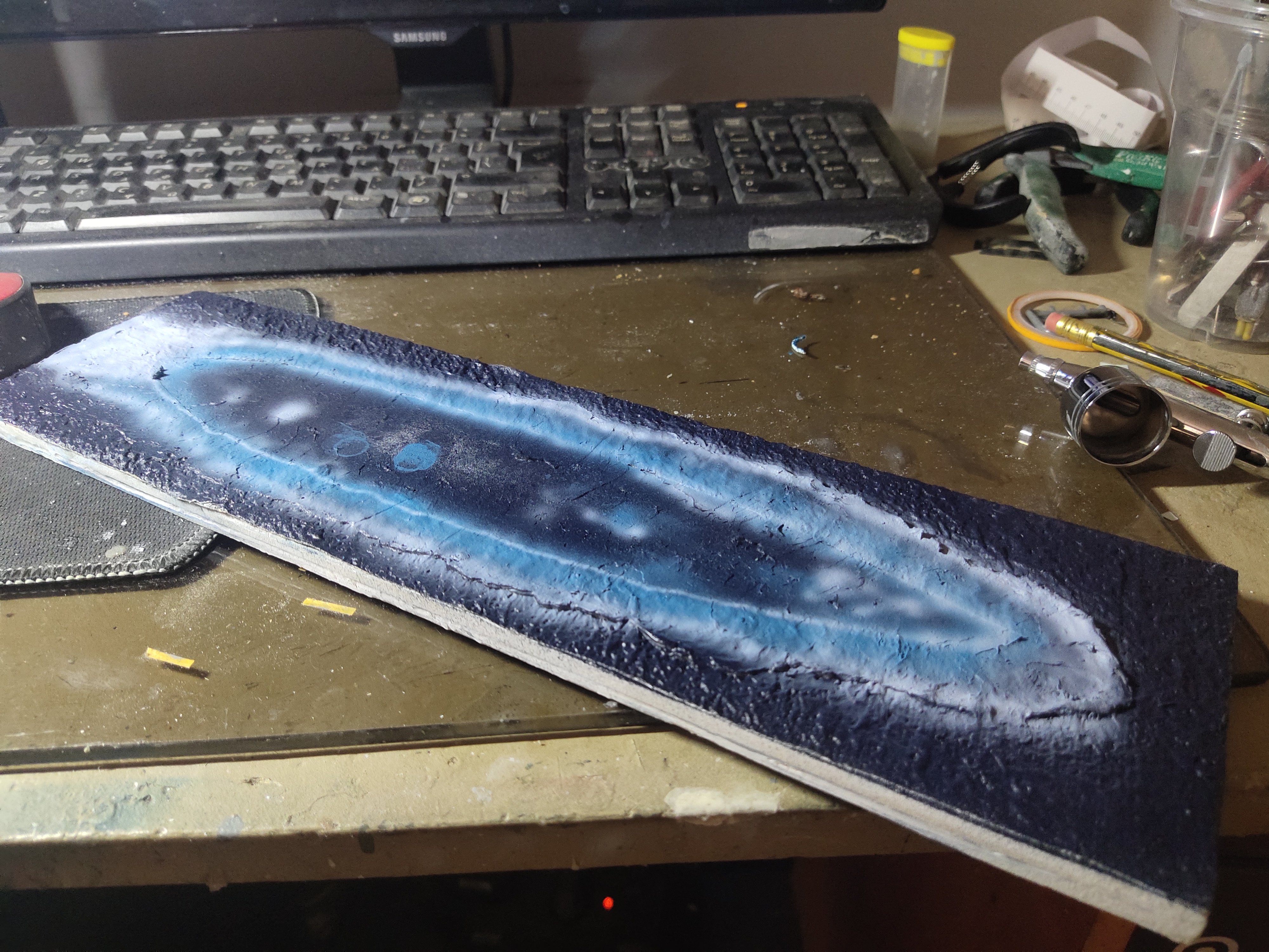

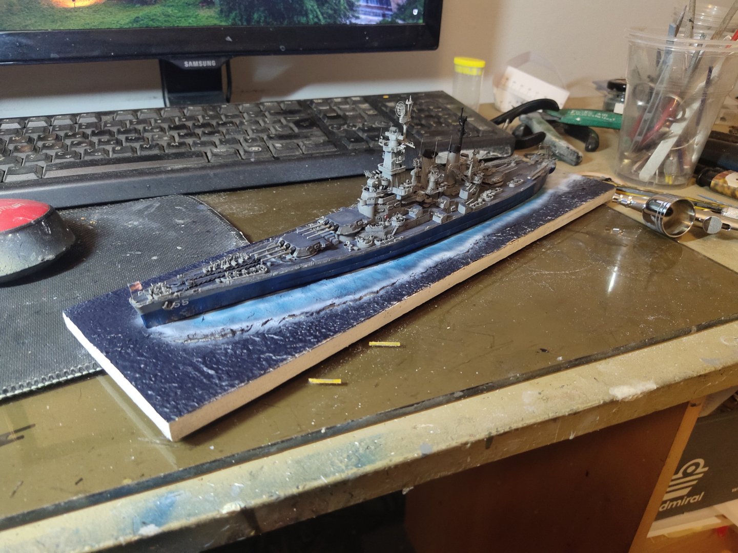

The hand couldn't follow the mind, although I had success in the past. This is the difference between machine and human. So I set aside the base, time to made a new one, the 3rd. My target now is to make a simple presentation than a layout. This time a case was made. The reisn poured over and left overnight under a cover. Note the yellowish mixture. Its an old resin left on storage for long time. I didnt take the risk to use it, although it did hardened quite ok in 40 minutes(fast dry product) Next morning I brushed thick gel over resin, by the time pics were taken it was dried and transparent. Another one project came to end
