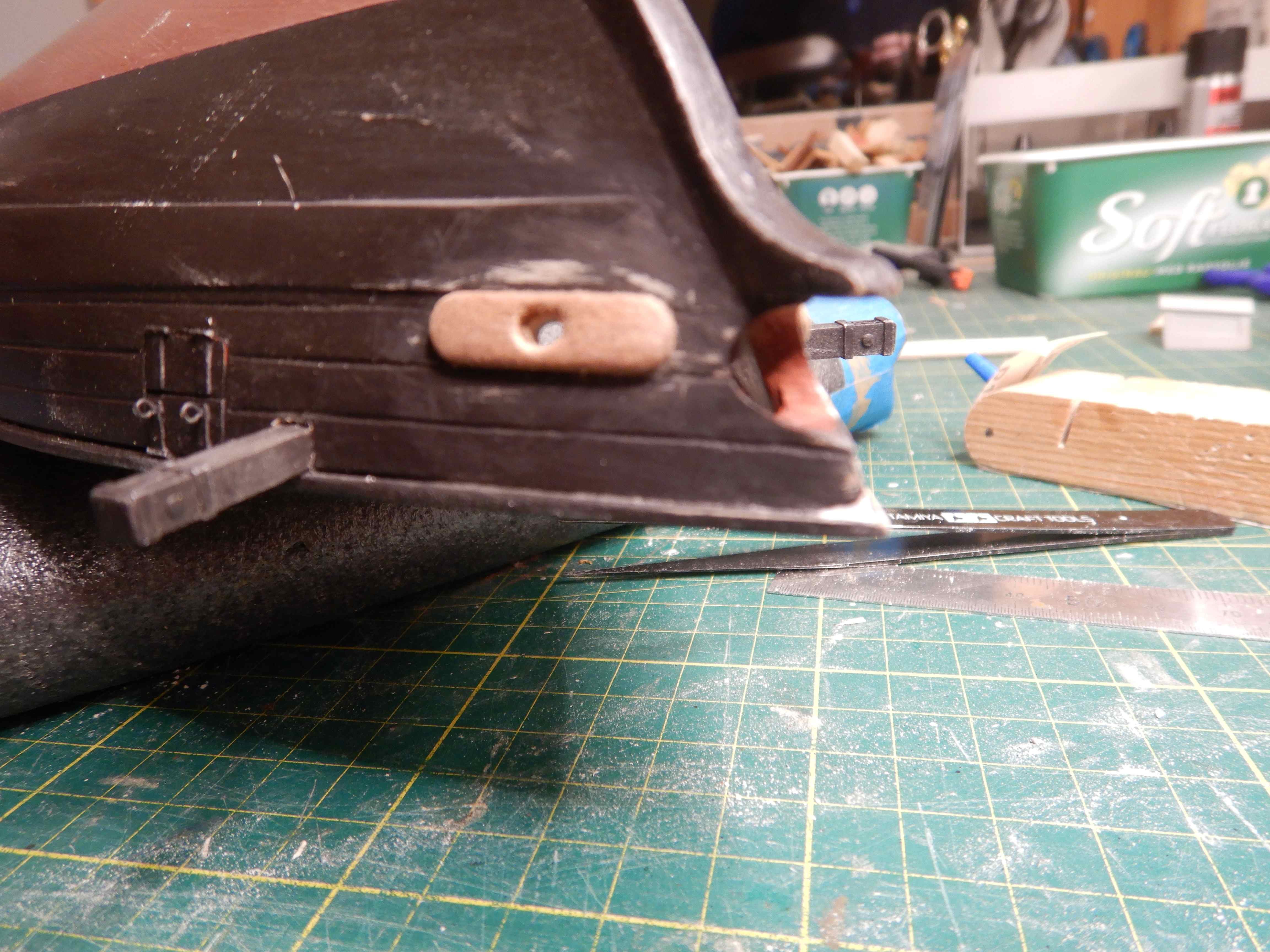

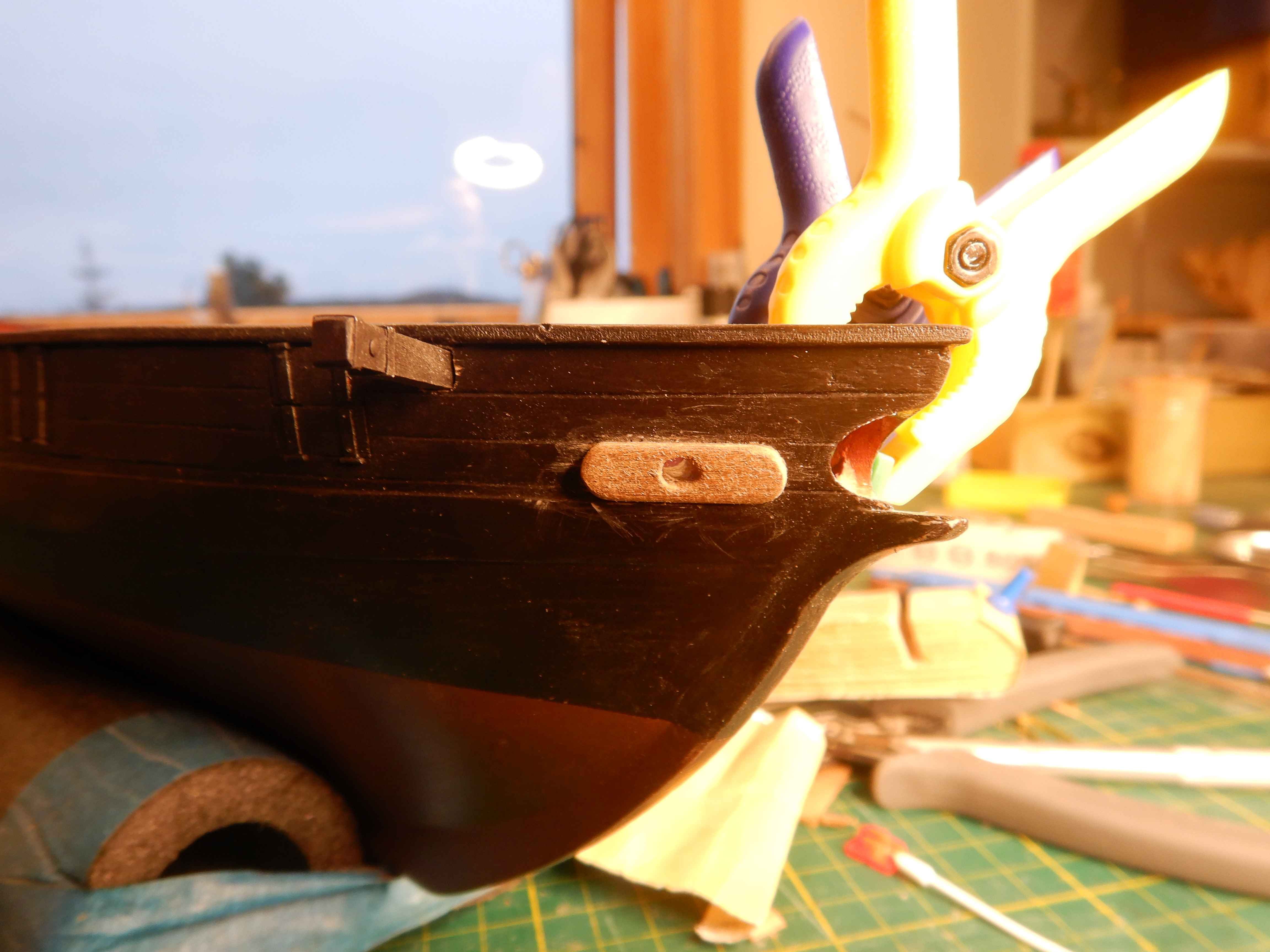

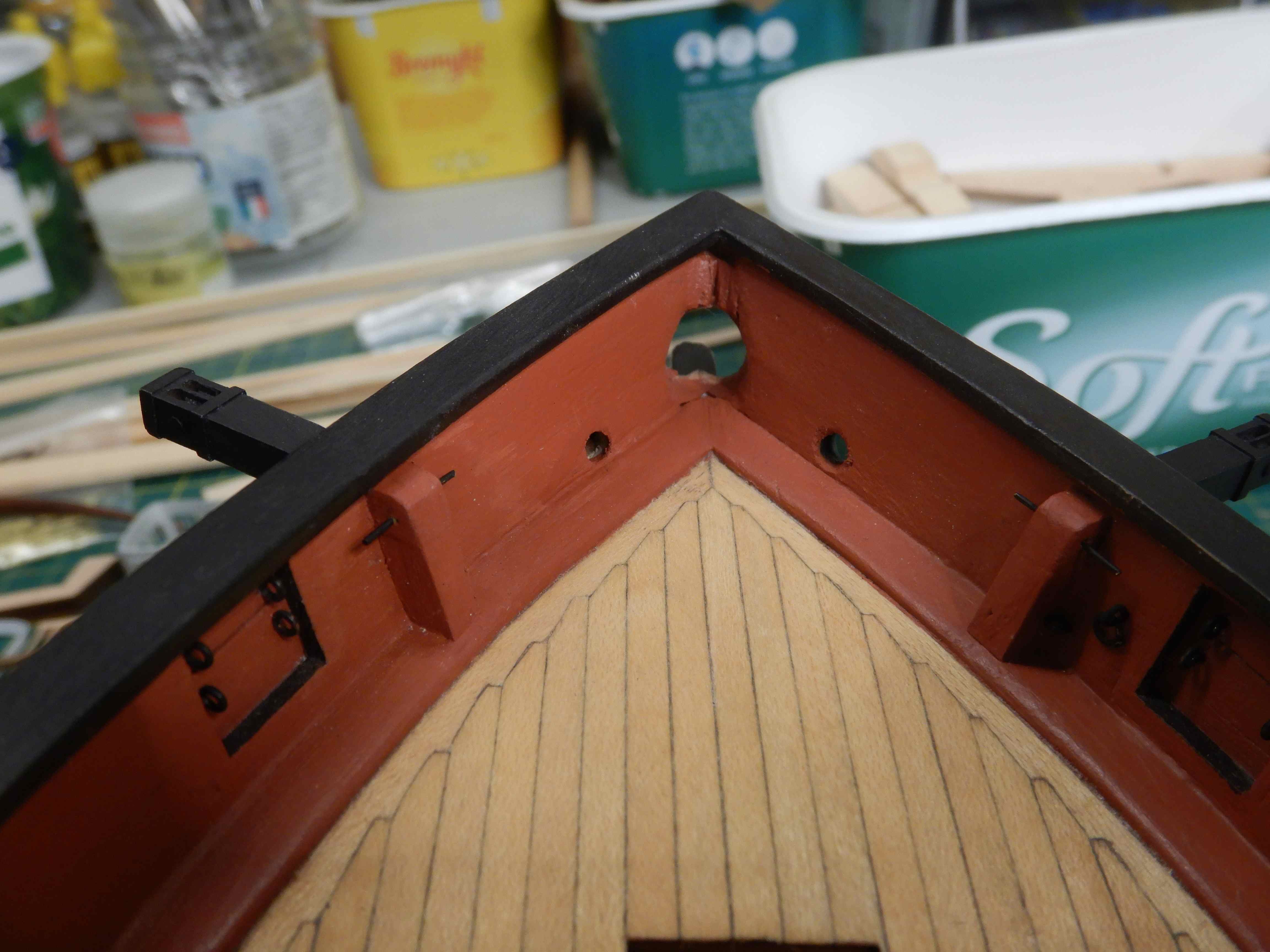

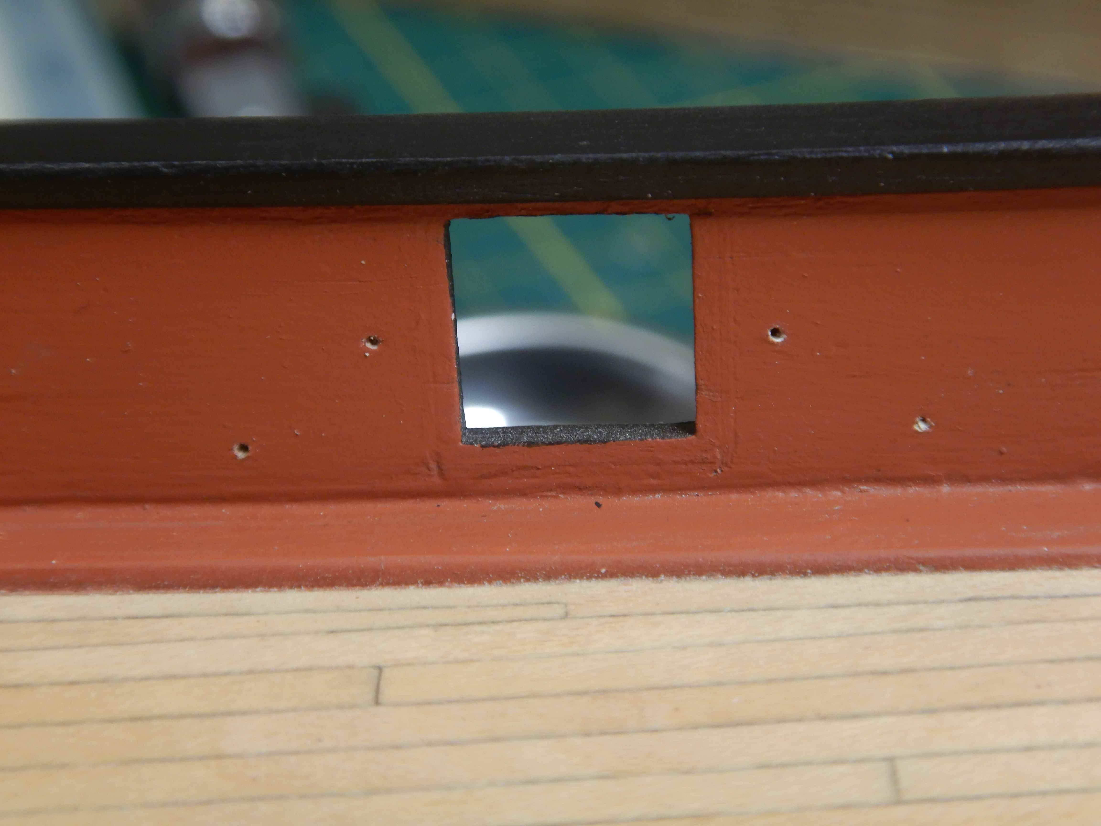

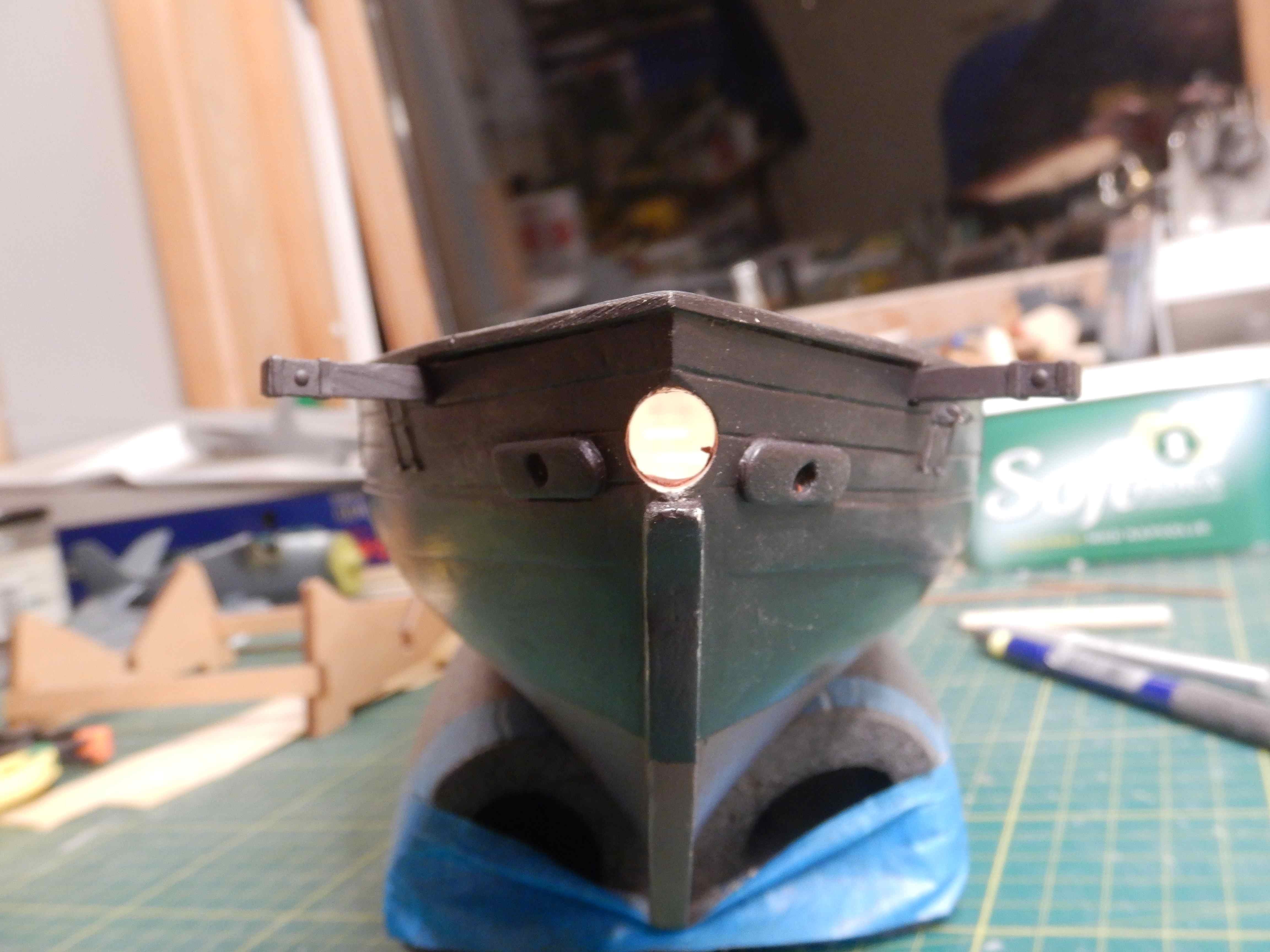

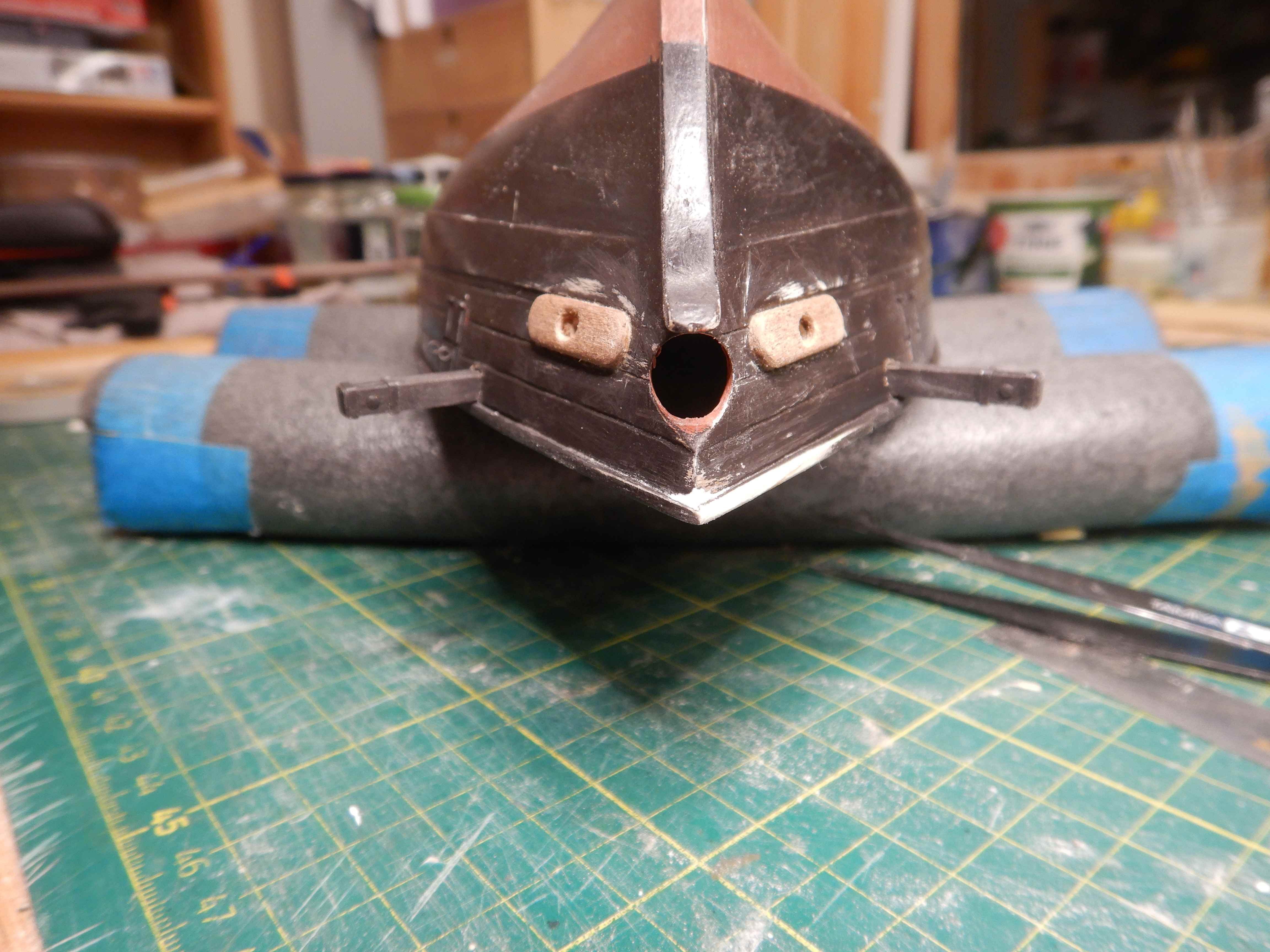

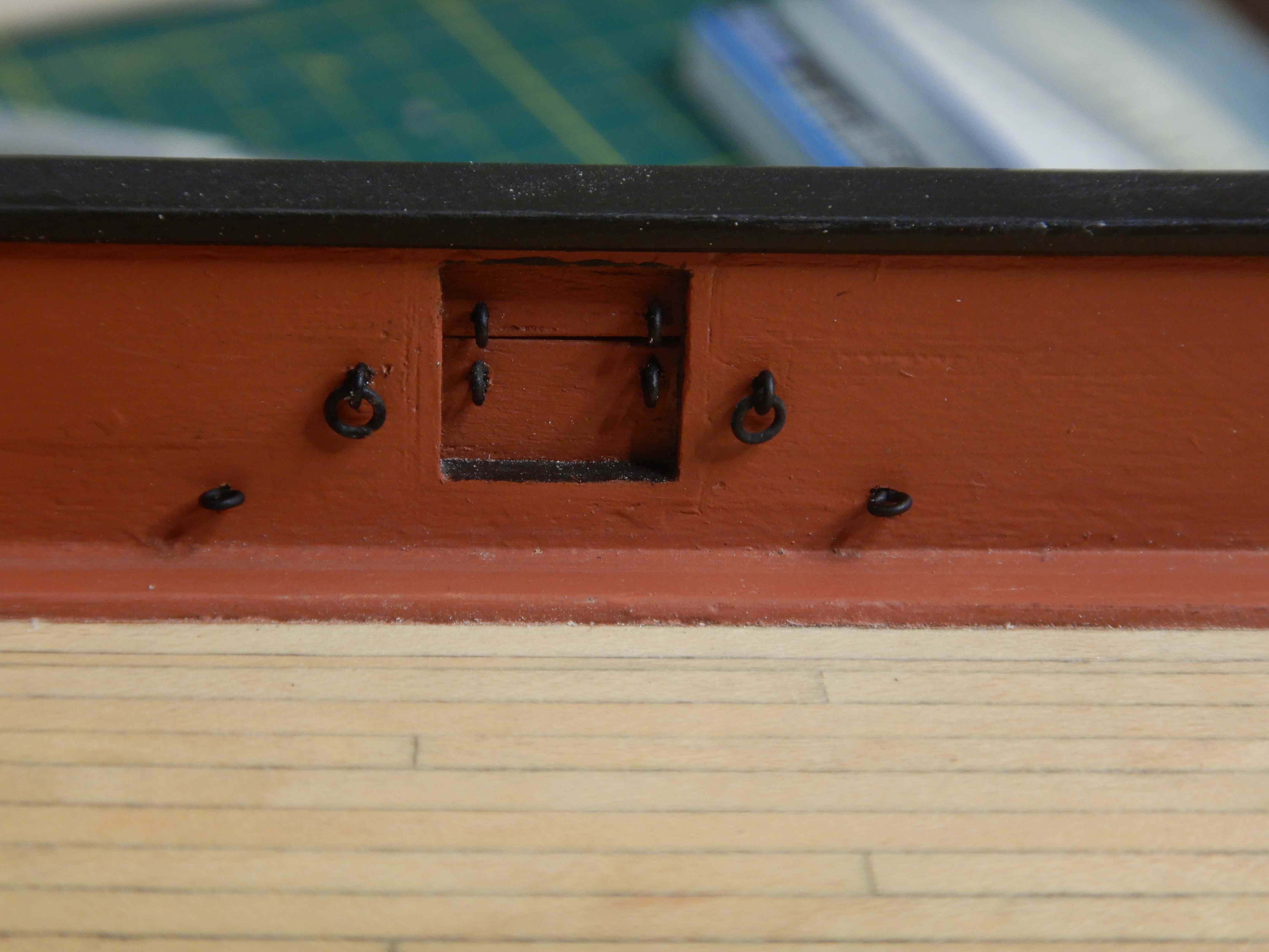

Hello all! Another small update. I drilled the hawse holes and added the bolsters. The bolsters that came with the kit was plywood, and a little big, so I made new ones out of some walnut I found in the kit box.. I also made and added the ringbolts/eyebolts for for the breech rope/gun tackles. I predrilled the holes where the guns will be added, and rig those rings on the guns first, and mount the gun with tackles and rings later. That's it for now! All the best! Gaffrig.

Gregory, the source is just looking at different builds here on the forum, and the thread carriage gun rigging has a few sketches. (Can’t get the link in here for some reason but search and you shall find!) Alan, thank you for the pictures, the extra ringbolt there seems closer to the gunport than I have seen in other pictures. The plot thickens… 🤣 Gaffrig
