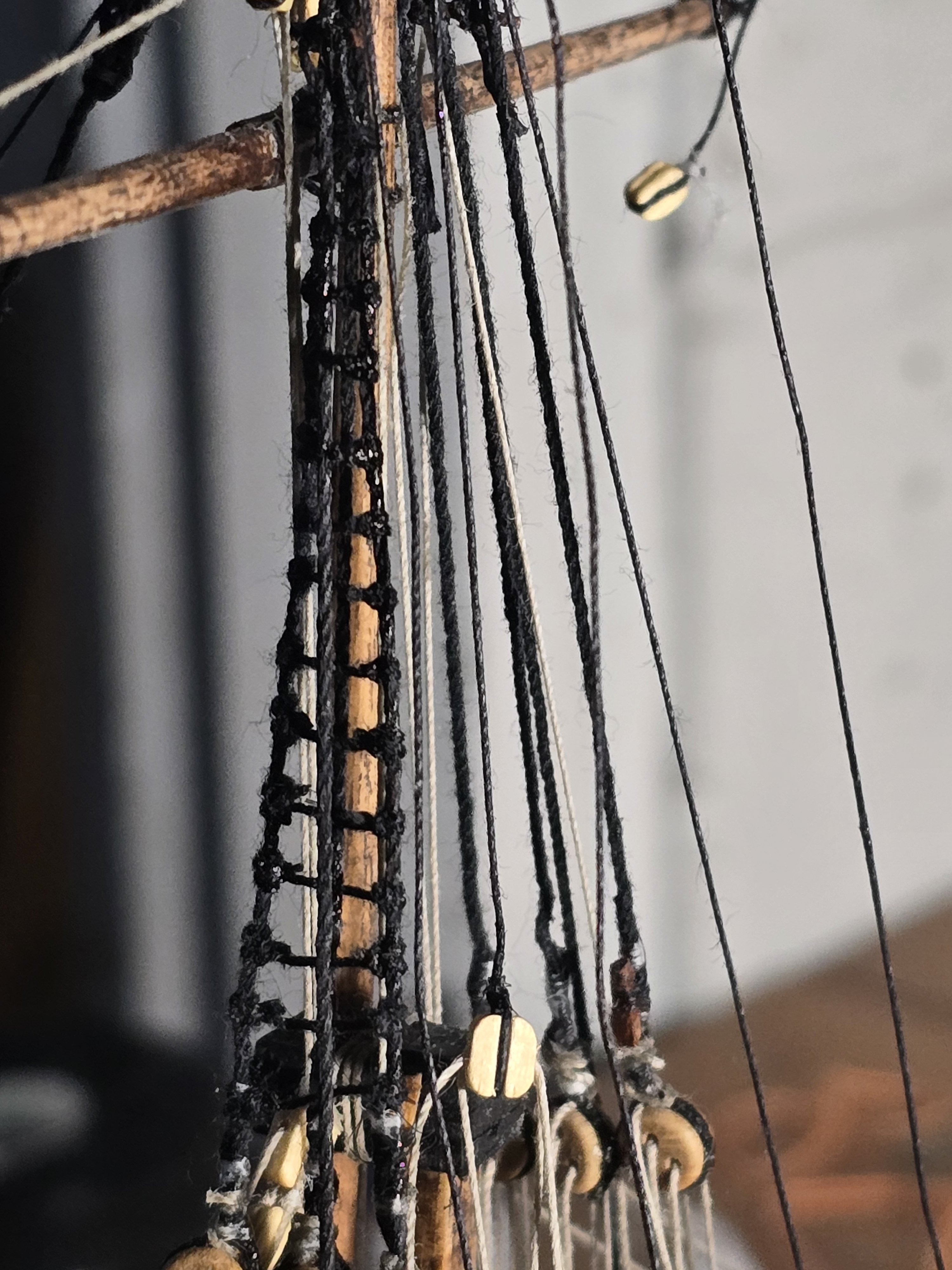

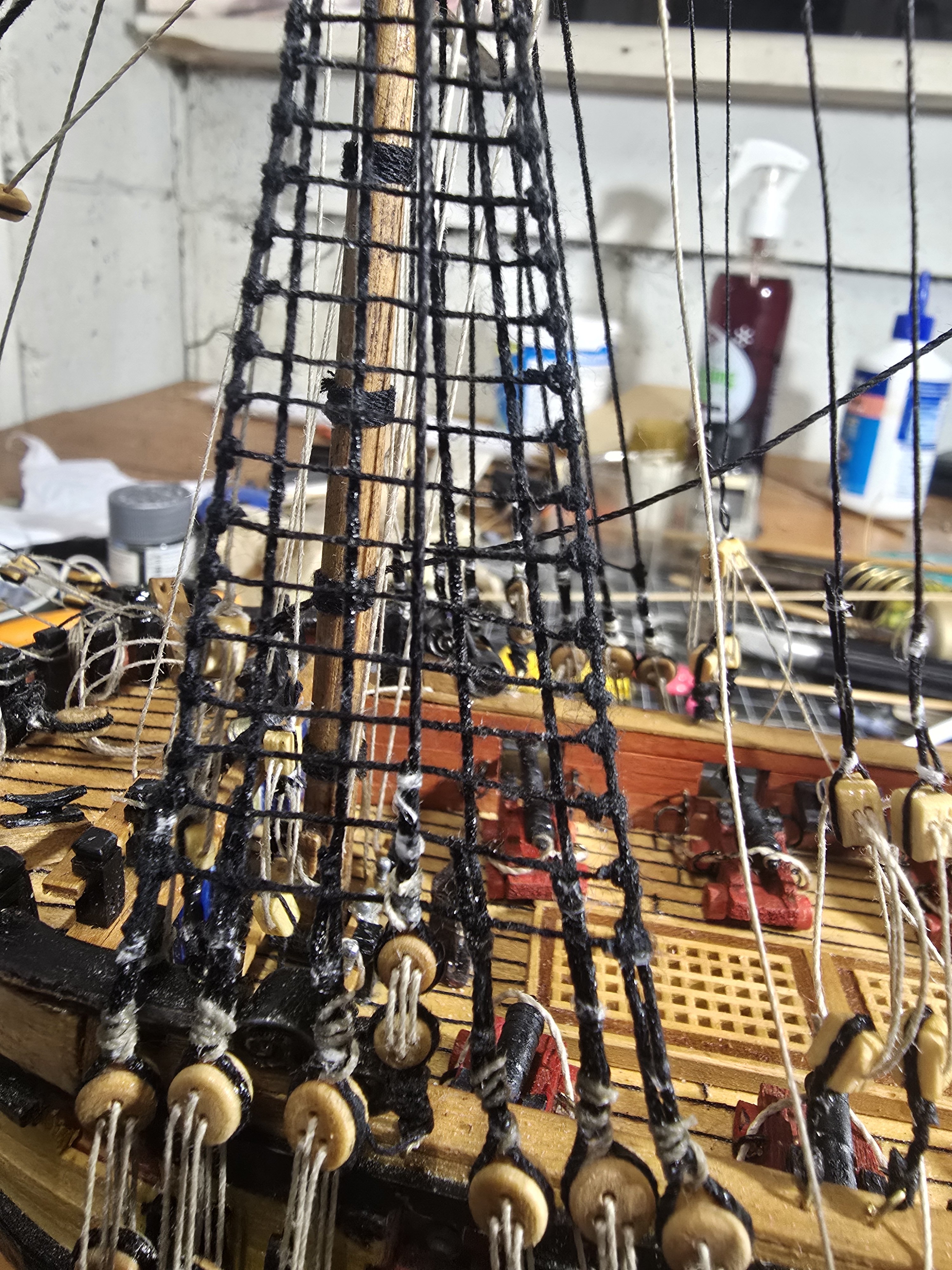

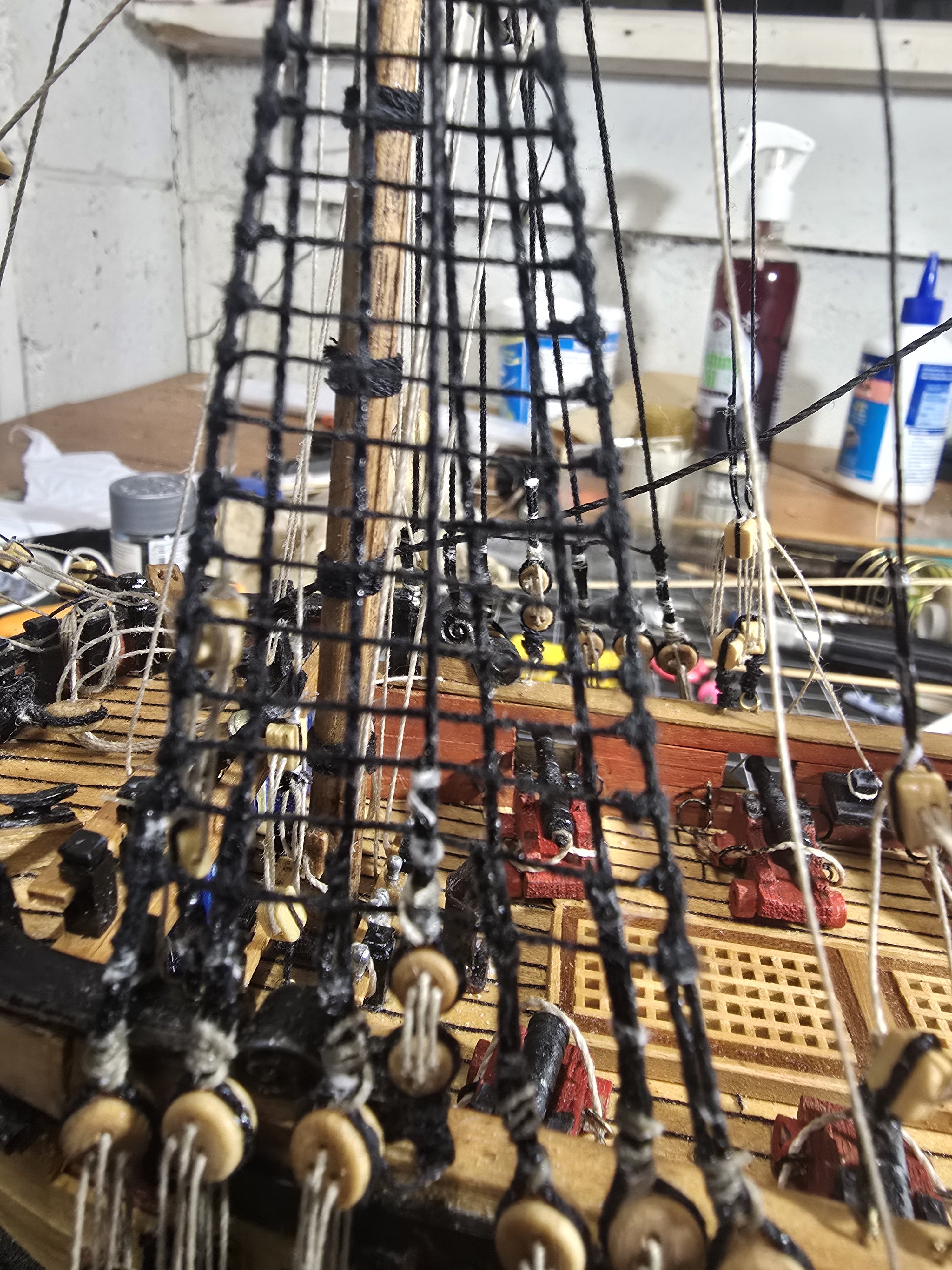

Ive done the port side ratlines using the method recommended for scales 1/100 which is not to tie each ratlone on each shroud but juat glue them on with ca. I seized one end of the ratline to the outmost shroud then using the guide reverse seized it to the other shroud and pulled it tight. I know some people like to have the ratlines sag in the middle but im happy with the straight look i achieved. I also added the foremast carpathians for the 1720 period which is seized to one shroud and zig zag across to the outmost shroud. Fiddly as buggery but i can see the light at the end of the tunnel for the foremast. Ratlines on the starboard side and then start seizing the shroud pairs onto the main mast.

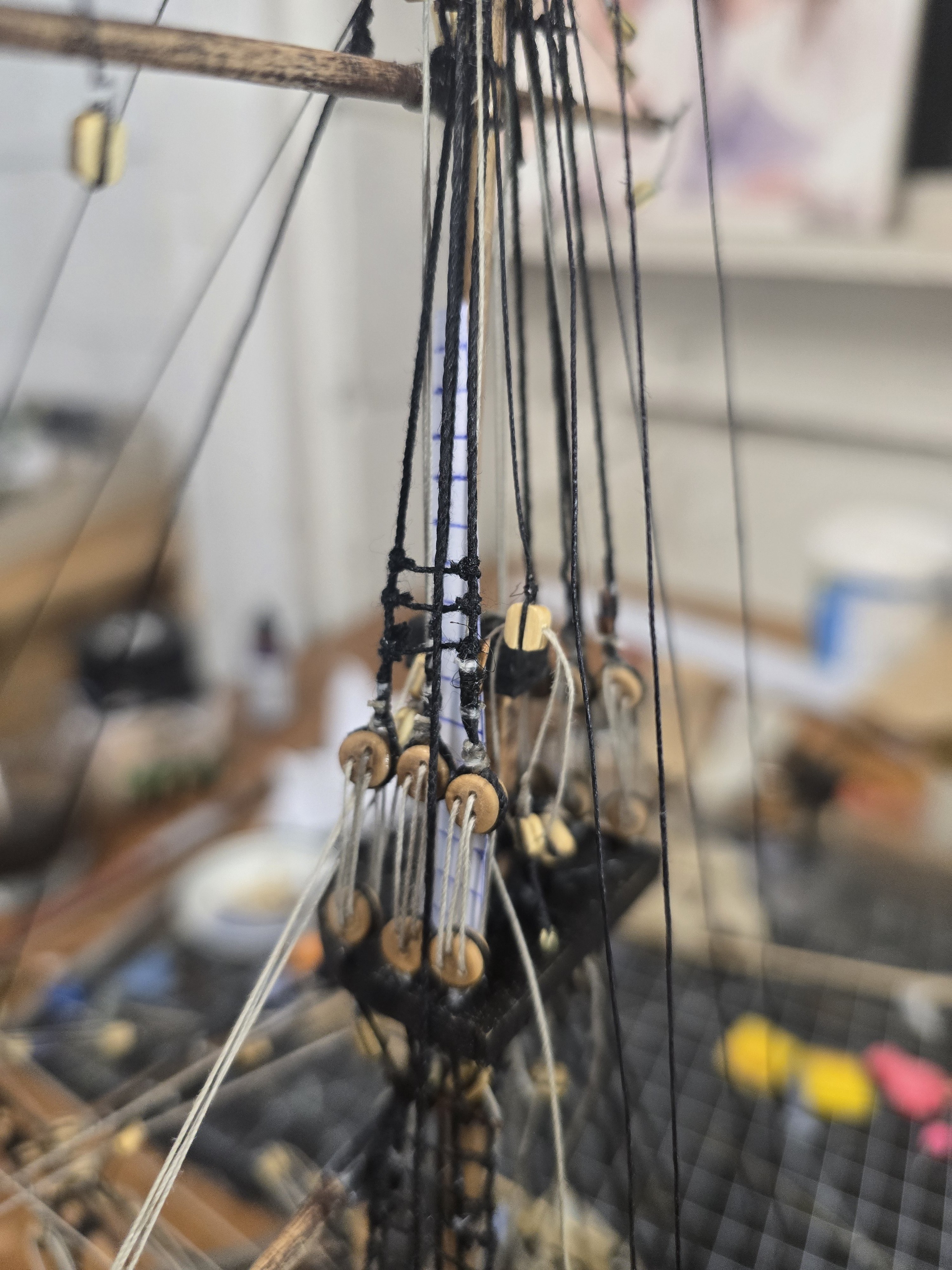

I hve rigged up the fore topsail tie and the fore topsail lift. Its getting lot of rope up there and a bit messt but i have all the inportant ropes in there. Cant imagine doing a sailing rig on 1/100 scale boat... too many ropes. I scaled the heaxagonal section and 3d printed that and stuck it on. Im going to put the final set of lifts on the top gallant after i have completed the topsail shrouds. Im hitting the wall a bit knowing that i have to repeat all of this again with the main and mizzen mast. It looks good but wow what alot of work to do it!!

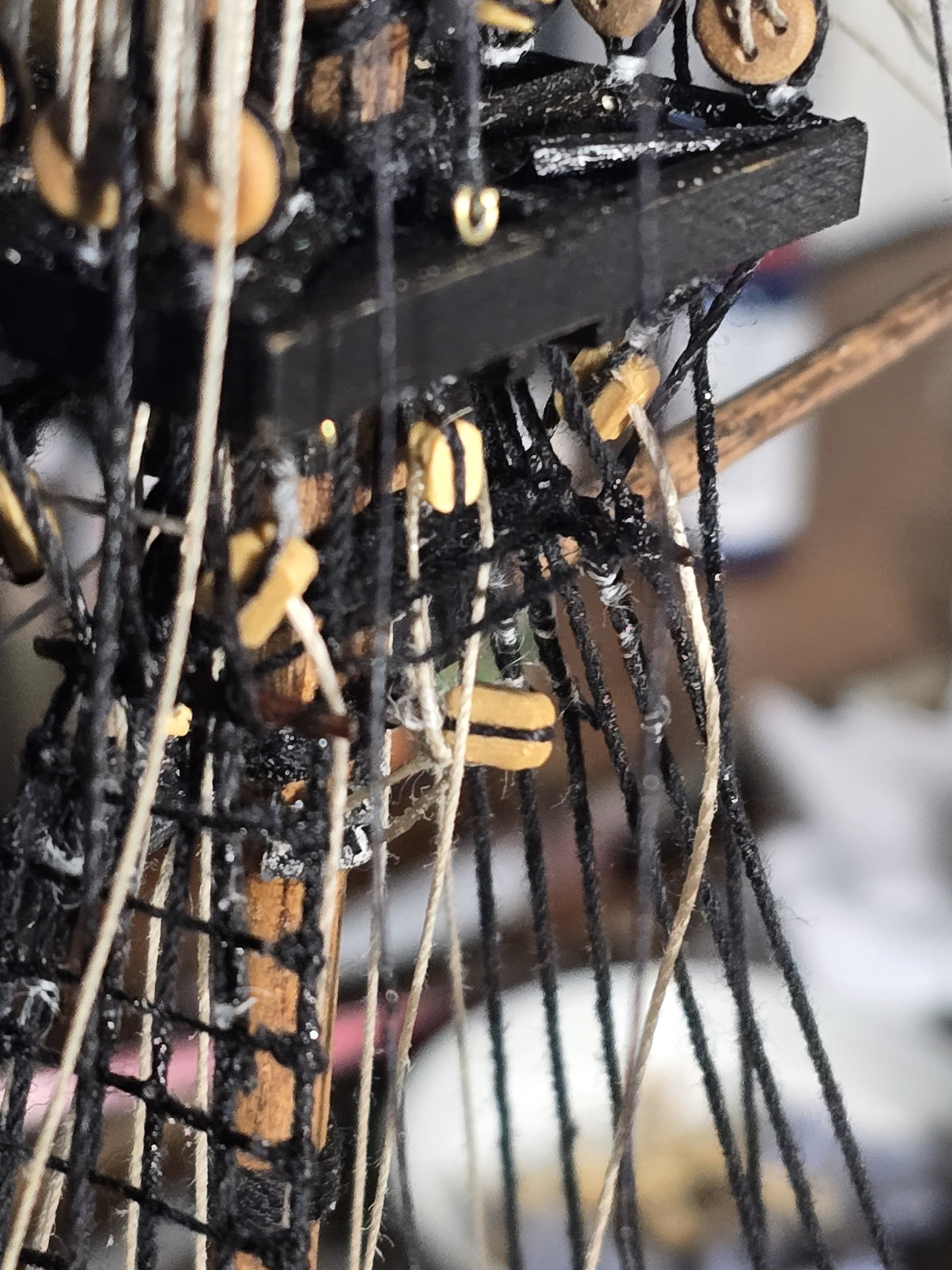

I might be doing this all wrong but ive tidied up alot of the line down at the fore bitts.. my belaying plan is not following any sort of accuracy, im playing with what the kit gave me in terms of instructions. The only thing i am doing is rigging the fore lift near to the edge of the ship on long blocks as per lees book but in the paterrson book it goes to a block on the fore channel. Once again if i had more space i could do that. I put the block on the rail instead. I will be putting coils of rope over each belaying pin so probably wont see them I didnt tie the truss pendent correctly but just glued the lines on approximately and also rigged the nave line and belayed it on the fore bitt.
I managed to rig up the jeer blocks okay... very fiddly but hey this is rigging. They a little lopsided but im not going tk change it... its close enough for me today. Now i have the fore yard no i am going to start belay pinning down at the base of the mast... again quite a lot of tricky stuff to wind around the belaying pins down there.. might have to cheat and just spot glue it and then put a coil of rope over the rope.

I may be doing this all wrong but its getting pretty congested around the fore top area so i rigged the jeer blocks onto the spar before i rigged it up and then poked the stirrups up under the for stay and then im going to stap them to the mast afterwards. The parrel is so small and delicate i basically just stuck it on for the look. It isnt going any job with holding up the spar. And i had a bit of a mistake with the lift blocks but i have followed the 1719 pattern according to lees book

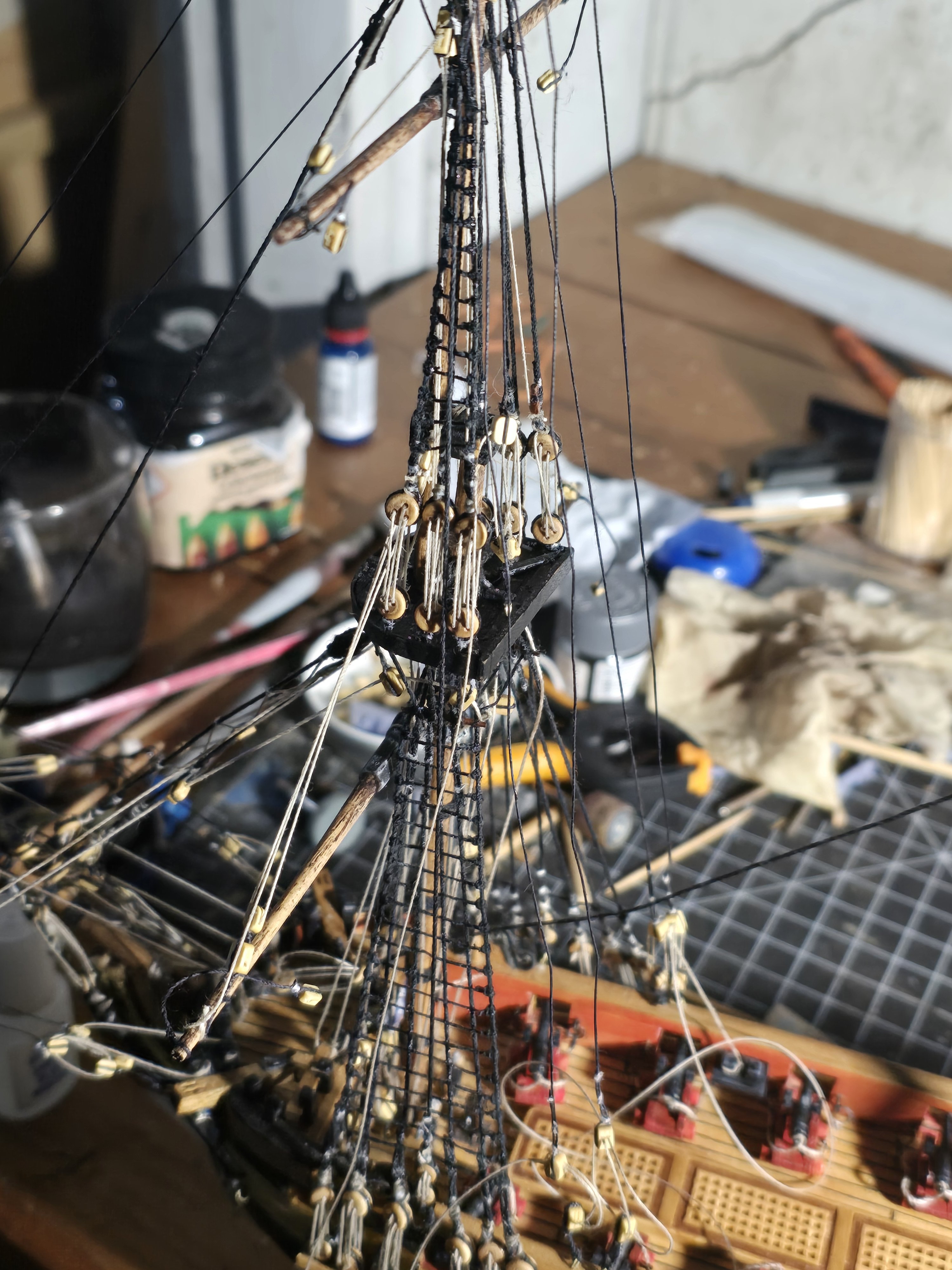

Its been an epic couple of sessions on the rigging and im loving it but the arms get tired holding them up and trying to get very fine motor skills out of them. Fore stay and preventer stay has gone in and i did try and worm and snake them... first effort but im reasonably happy with the result. Its a bit of a worry as it was tricky and a lot of work had gone into the stays anyway. I know there should be hearts instead of deadeyes on the fore stays but the kit came with bugger all hearts so deadeyes it is.

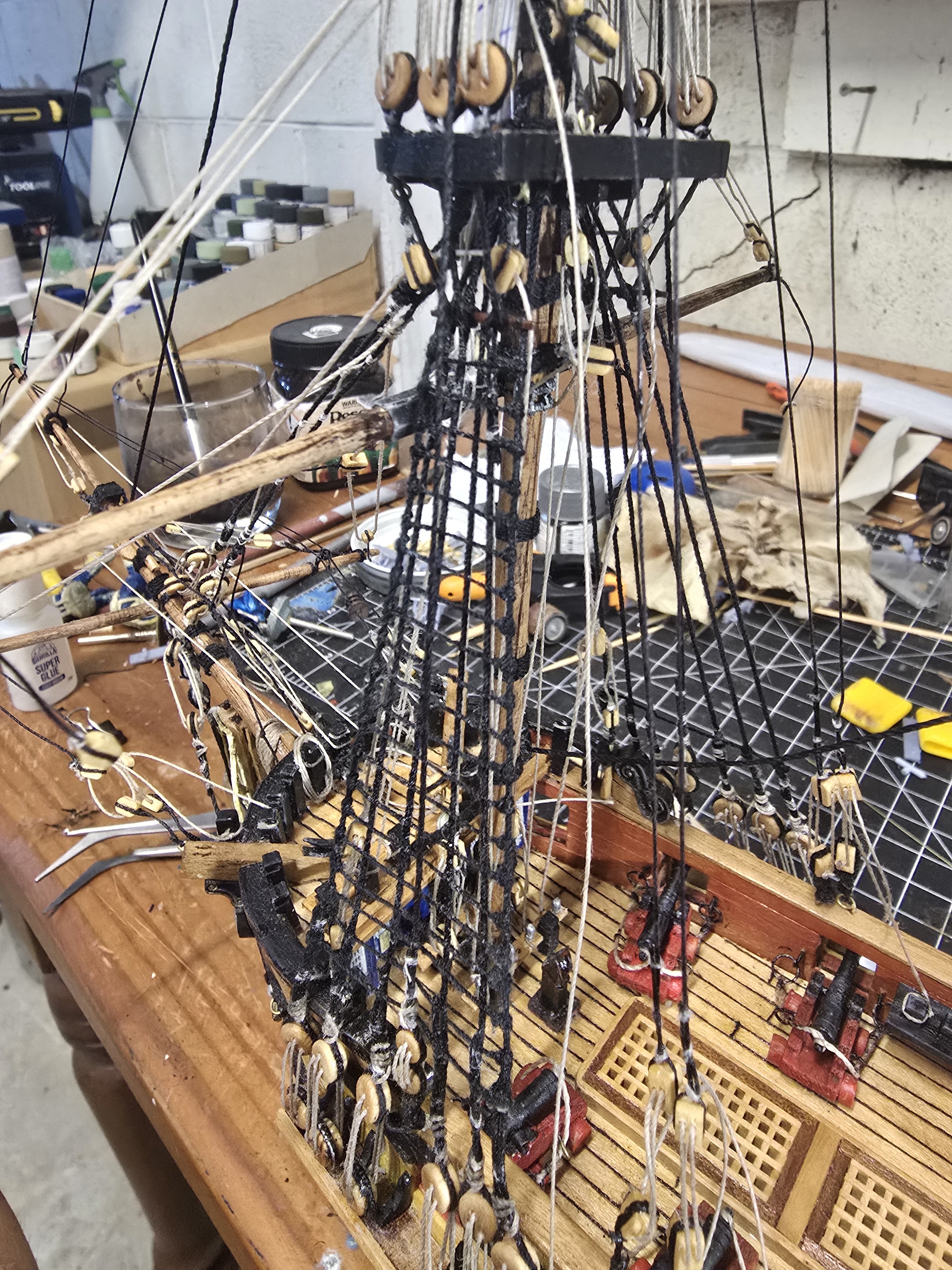

Starting to rig the foremast shrouds and decided to print some deadeye templates with the correct spacing to help. it only took 3 proto types but I think I am getting there. I have started on the starboard shrounds first, then go onto the fore stay and the main stay next. Question, which side should the main stay pass the foremast by convention? on this picture its the right hand side - is that correct?
