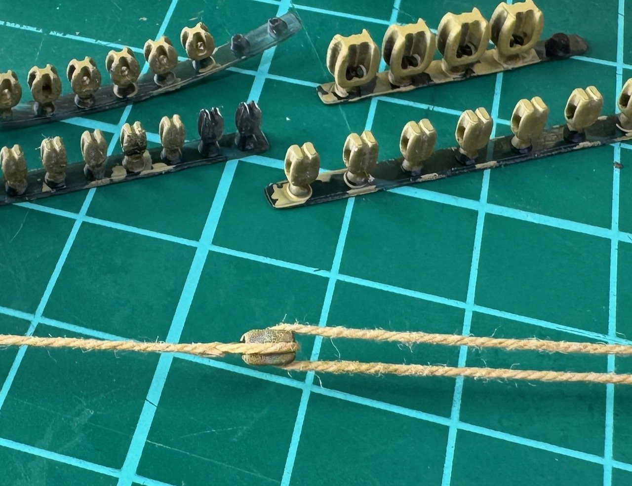

  4. Just getting started here, but I've found these two prints very useful for my 1:100 Victory and of course they could always be rescaled if desired. The prints have integral supports and a base plate including something to hold it by. You can just load the STL directly to your printer's software and hit the print button. They have 20 of each in the file, you will need two of each (which you could easily print in one go). Set your printer to a fairly high resolution, at least 0.05mm layer hight. The photo shows a part-used stack of each, printed on a very very cheap very old printer, so you should get better results than me. And a close-up of the parts installed and with a first coat of primer. Hope they're useful to someone... Rigols curly.stl Rigols round.stl

  6. I'm undecided on the way to do the rigging, and although I won't be rigging every invisible cannon I will certainly attempt some of the more visible ones. To this end I've been working on parameterised blocks with the 3d printer, and seeing how easy very small blocks are to thread. The ones in this picture are 2mm and 3.5mm overall, each with 0.8mm holes (I could go smaller but this makes life much easier to thread). Also on this picture examples of the two types of rigols, which are about 13mm overall. Shout if you want me to upload the .stl files.

  10. Thank you very much for these files, they have printed very well and look superb. I printed them vertically although they do still need supports to ensure that the base adheres as there are tiny rivets on the "bottom". But avoiding any supports on the sides of the barrel makes for a much easier time at 1:100.
  11. Welcome! You should try New Zealand. On the other hand, I guess China is slightly nearer and that's where pretty much all of it comes from anyway. Model shops have long been places that wildly overcharge for average-quality gear for the most part.
