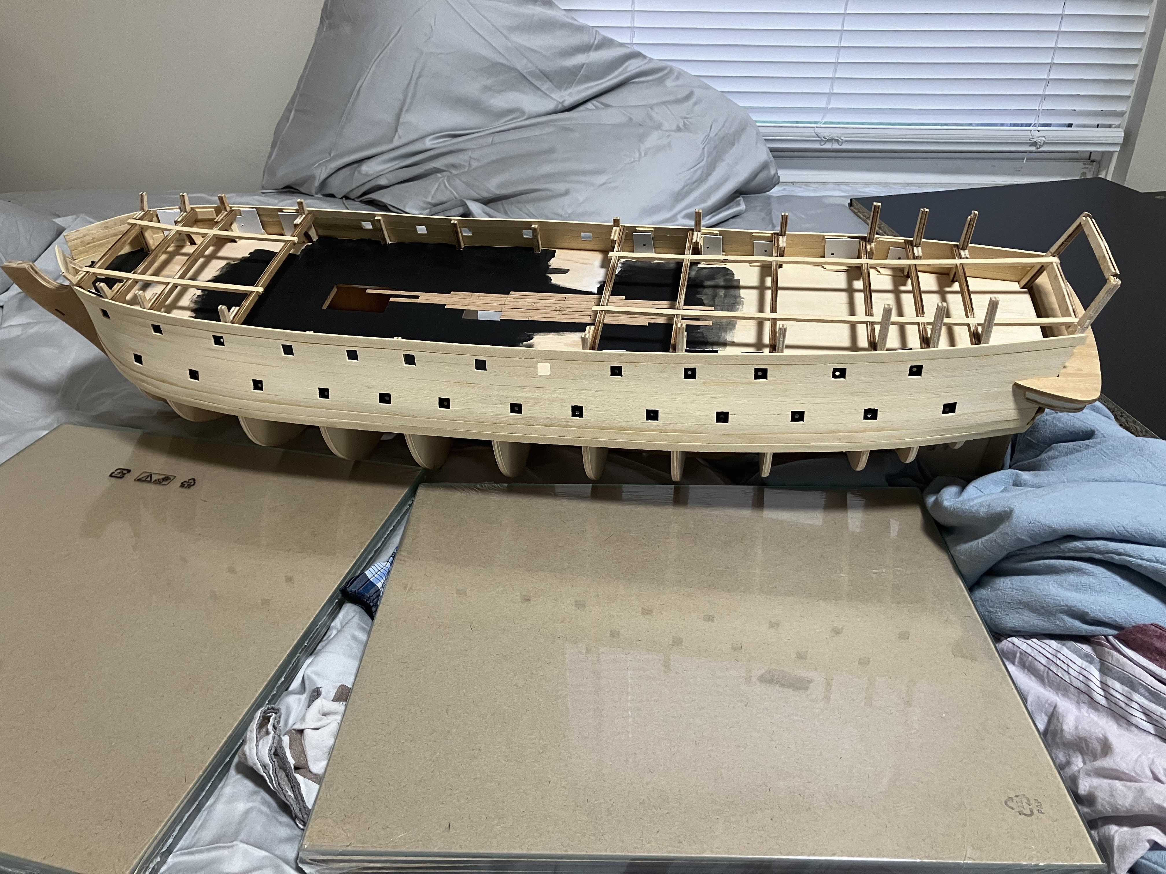

Week 7 update: attached the base piece for the stern gallery, and added beams for the forecastle and quarter decks.
This piece was quite a challenge to fit into place, I had to cut and sand much of the side gallery base to make it fit.
Also added the distancing tabs from scrap wood for the guns' fixtures in the lower gun deck.
Probably won't be an update next week as I will be moving and probably spending the whole weekend arranging the house.
Next up: a few more layers of planking so that I can add the gun fixtures for the upper gun decks.
Week 6 update: finished carving out the gunports and painted some walls.
At first I was not very happy with the distancing on some of the gunports because I distanced them based on the drawings and the ribs, which must have been off by a few millimeters when I built them. (gunport 4 and 5 from the bow are the most obvious) But overall I think they look quite decent.
The walls are not labeled on the instructions as usual, so I had to make some guesses as to which parts are what. The lighting is not very good in this picture so the paint looks darker than it is in real life.
I am at the point now where I need to install these walls and the quarterdeck and forecastle deck before I can plank further up so that will be what I am doing next week.

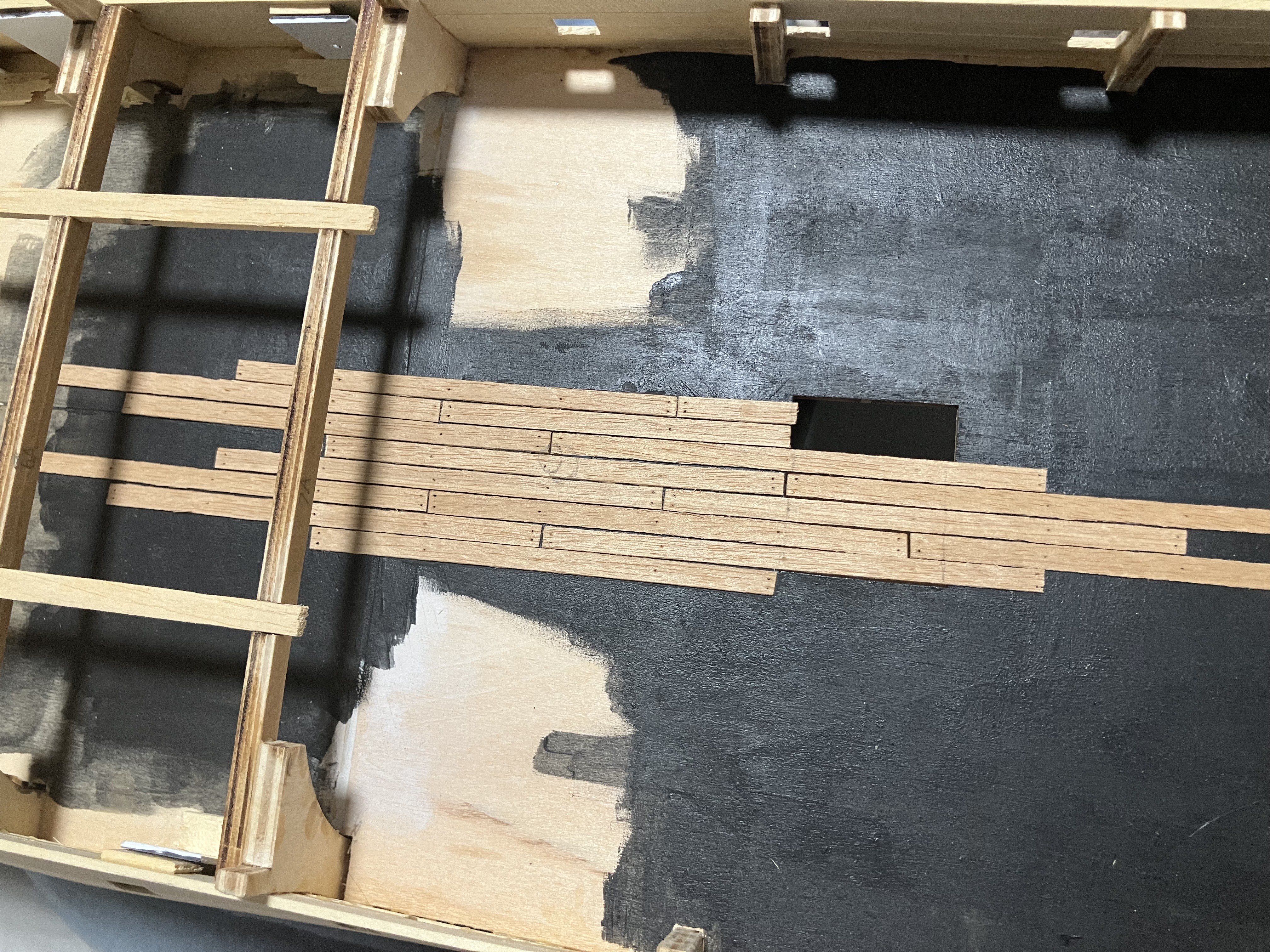

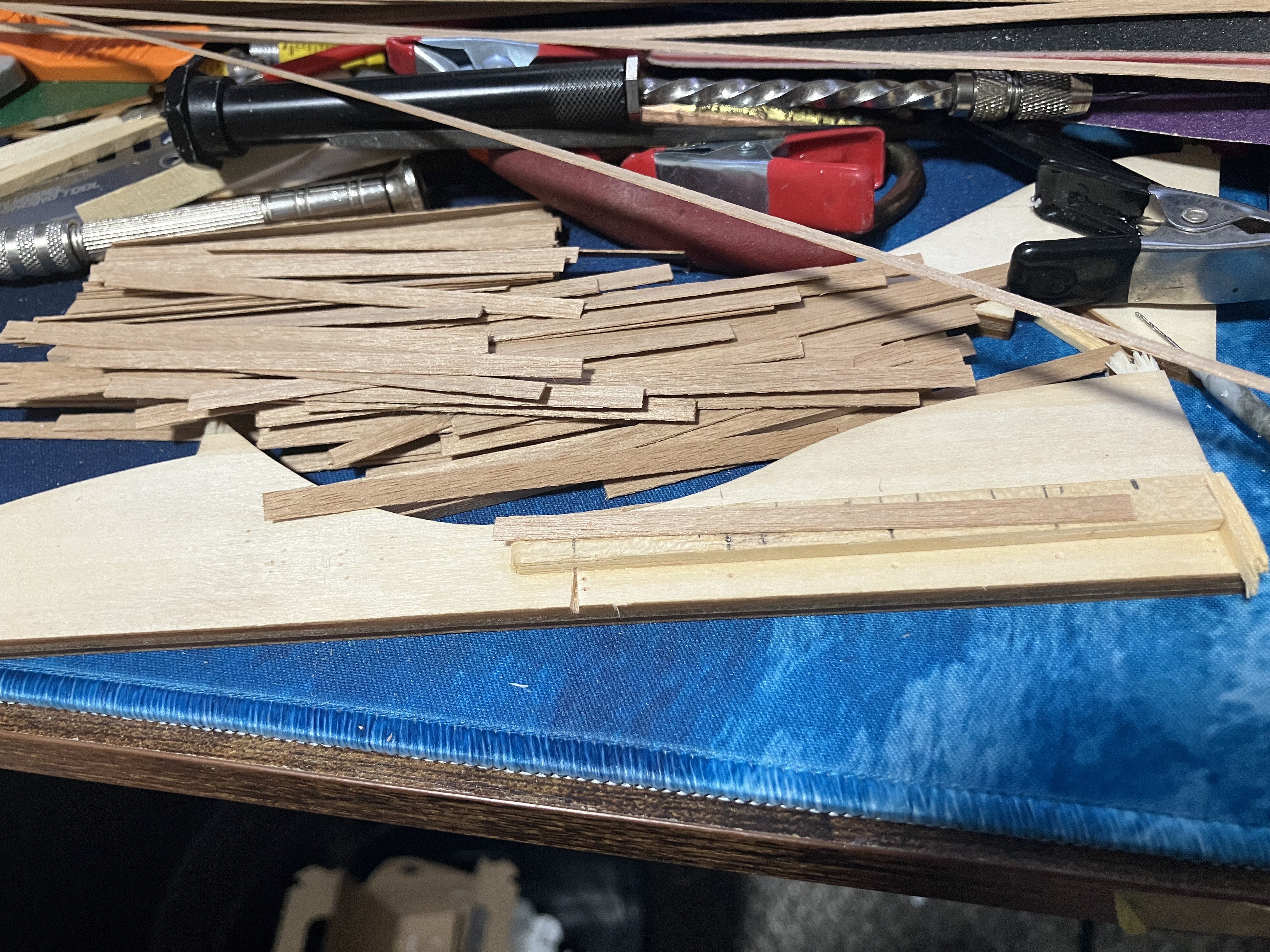

Week 9 update: added the gun fixtures and their bracings, started work on the deck planks.
Mostly done with moving, still assembling some cabinets as of now but I did manage to get some work done on the ship.
I looked through the instructions and I do not see anywhere where these thin annegre strips were to be used so I am assuming these are supposed to be the deck planks. I am going with a three butt pattern.
Still a ton more planks to cut and drill.
Next up: more deck planking.
