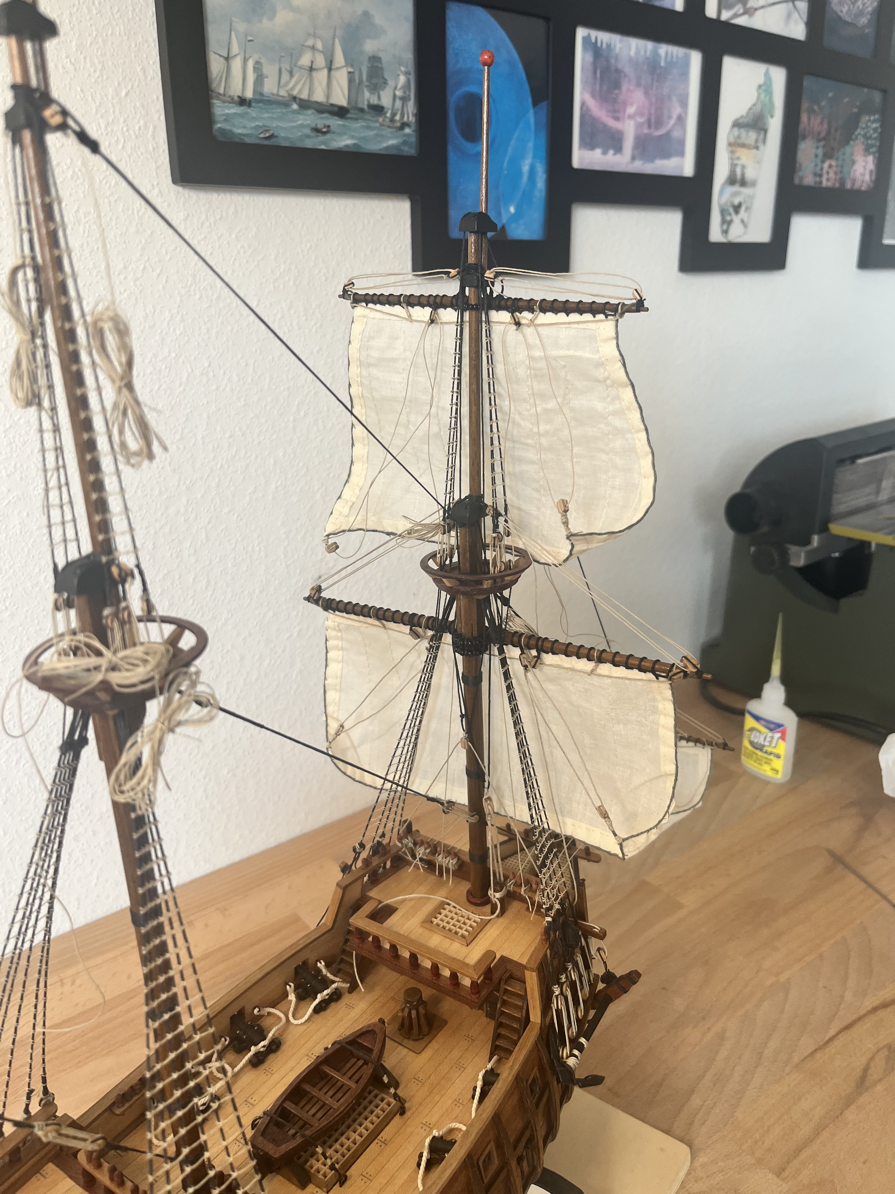

Next part in the kit that was really ugly was the top plattforms (how do you call them in English correctly? In German the "Mars") of fore and main mast. So I made some own completely from scratch, trying to rebuild them as close as possible to the ugly die cast part. Was quite a process cutting and fitting all the small delicate parts together. I'm quite happy with the result :D Last pictures show the testwise mounted platform not attached yet.
Another comment to artesania latina's die cast parts: they are ****! The top plattforms die cast parts not even showing the holes you need for attaching the upper shrouds. If you would forget to drill them as the instructions do not say anything about it, you would be fucked up having to deal with it if already mounted on the mast... As well as drilling holes in such die cast parts of a complexity of that top plattform is not the wood modeler's main ability nor will it end up very precise...

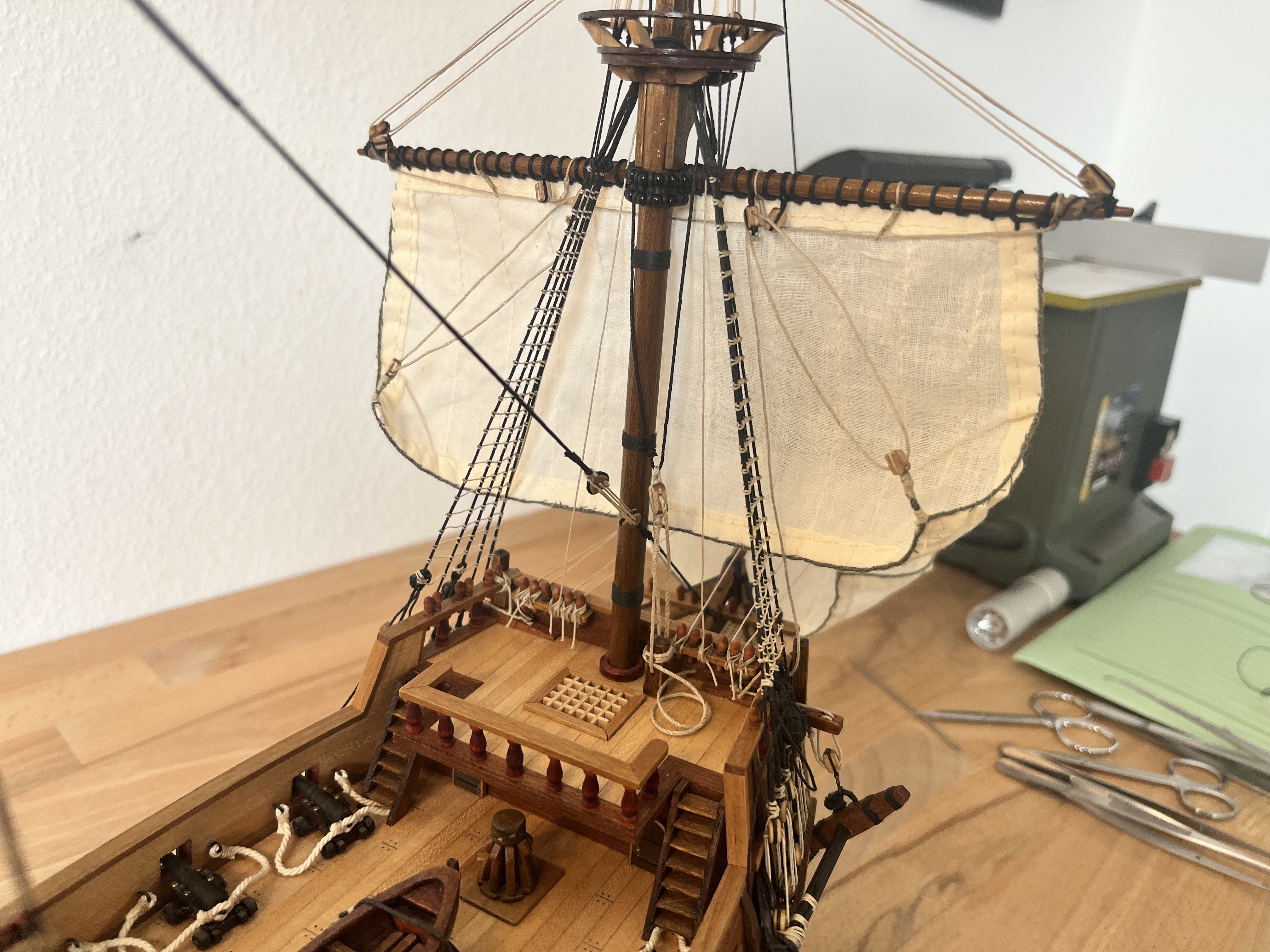

As I haven't worked on the ship for quite a while, respectively only did some stuff during some short periods, it took some time for the next post here... Recently I picked up work and now am trying to finish the build. The rigging is something complete new for me and a lot new stuff and techniques to learn. So I have quite some respect regarding all that work - also stuff can be broken easily now when working on the model 🙄

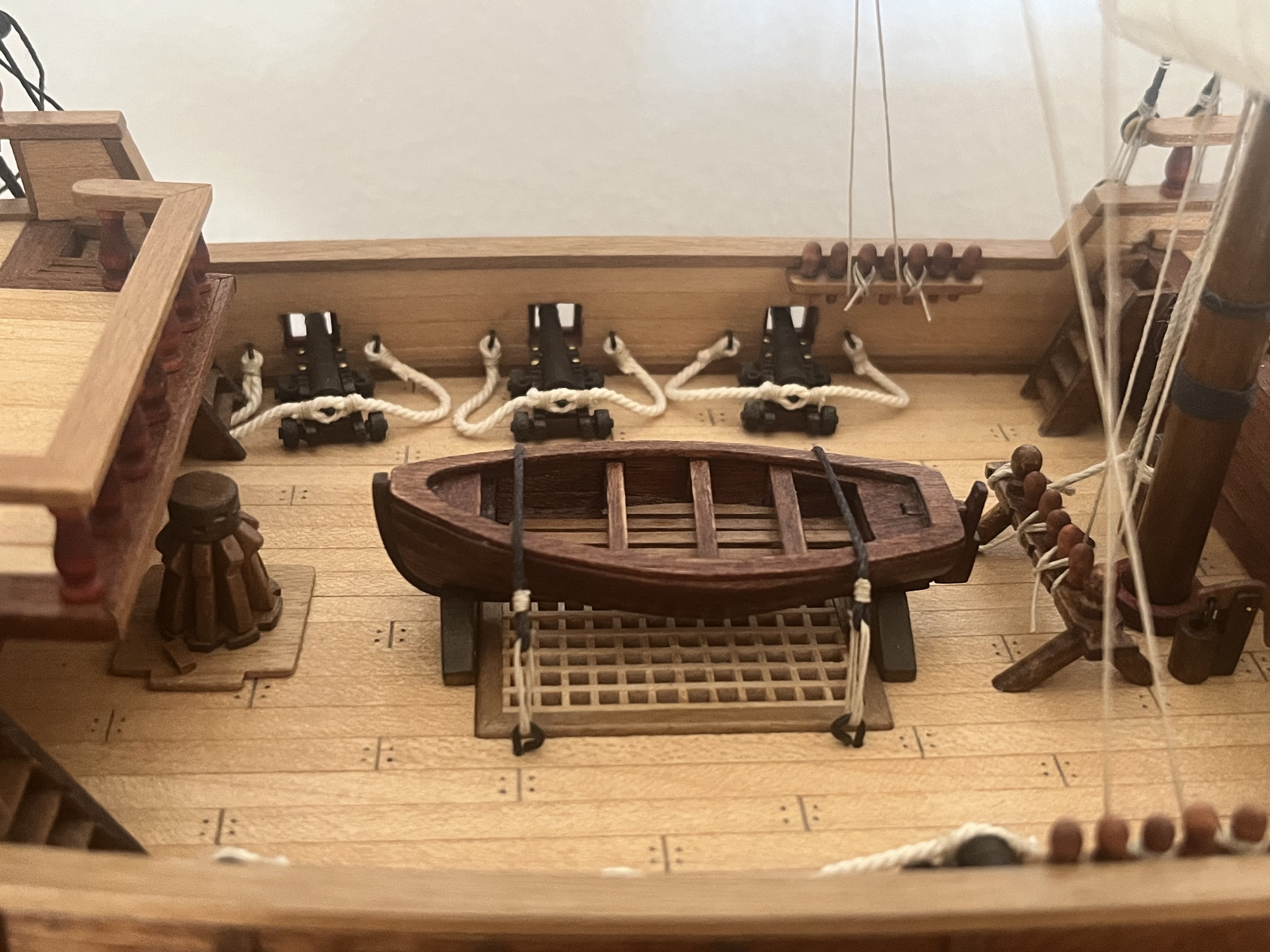

As there was some space on the deck and I thought this detail is missing in the kit, I built a scratch capstan:

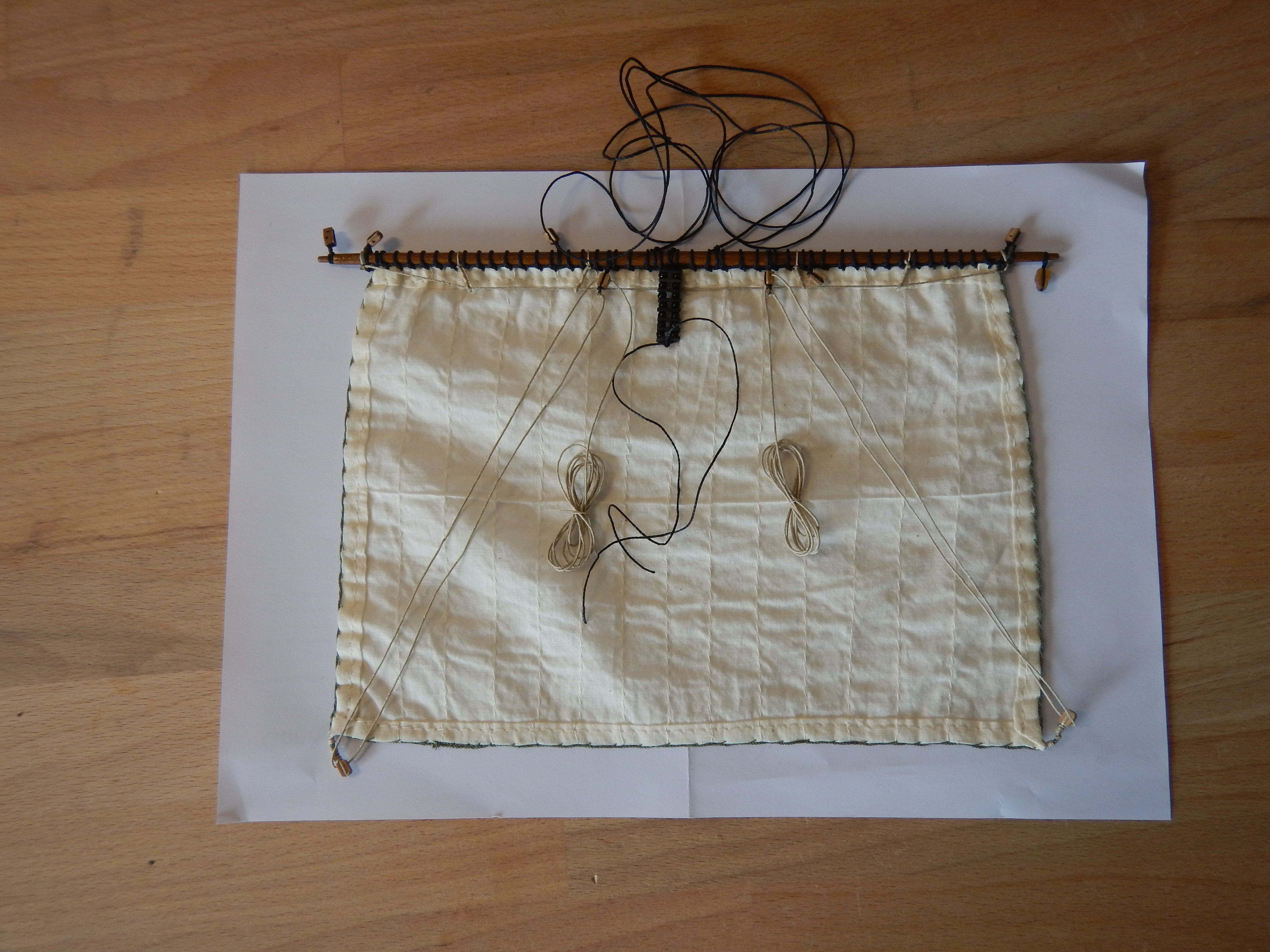

So far all worked well. Even served the part of the stays which go around the masts with thin rope, including a "mouse". Took me quite a while to figure out how to do that and had to build a serving machine for that, which I rebuilt by looking at the serving machine offered by Syren model (thanks guy for putting the assembly instruction online!).DSCN0677.jpg.8d57292e0a40dec73e64a0a8775b4c62.jpgDSCN0679.jpg.5ffd15c3d232e0007ef8da2a1740cb79.jpg

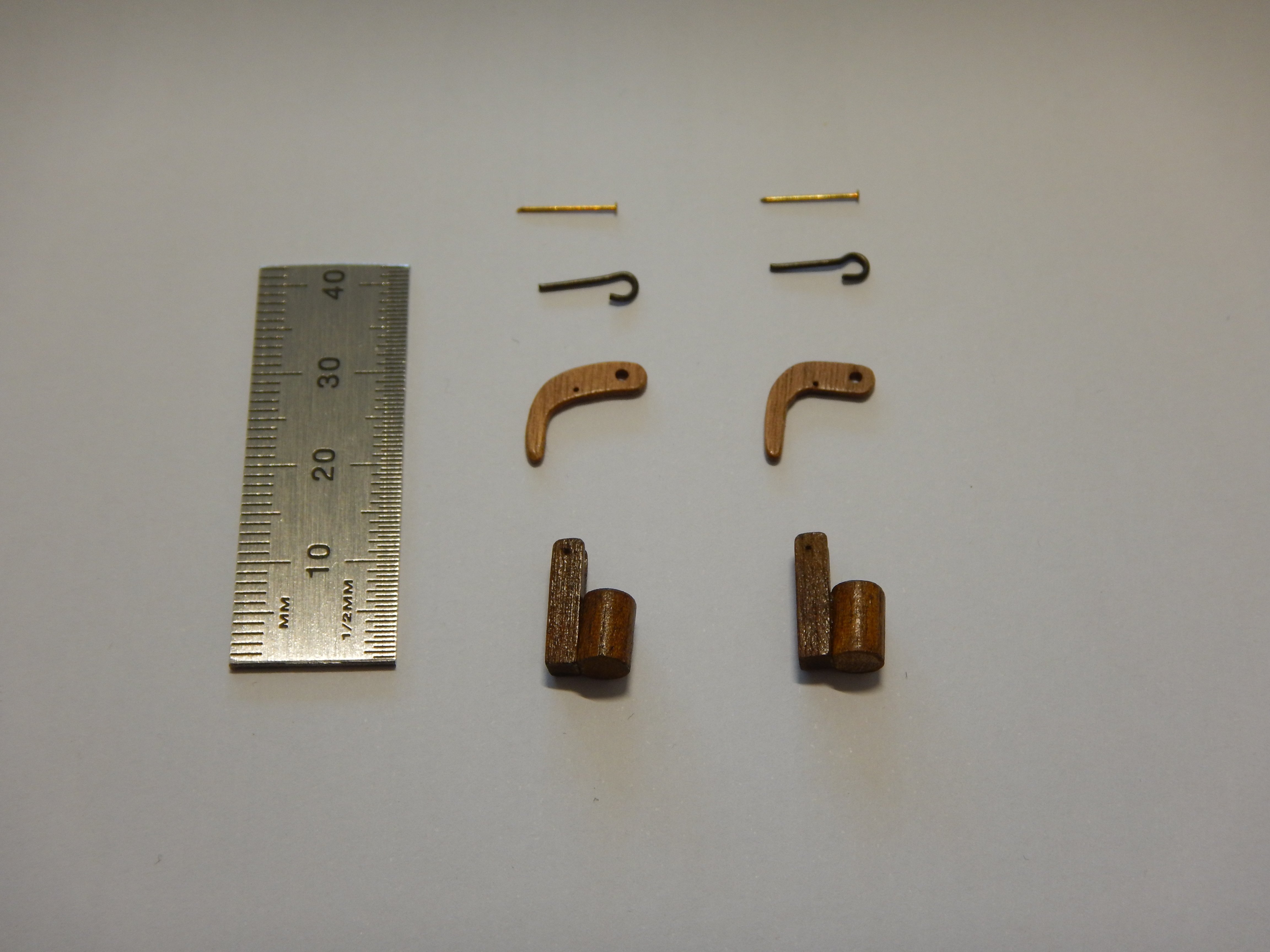

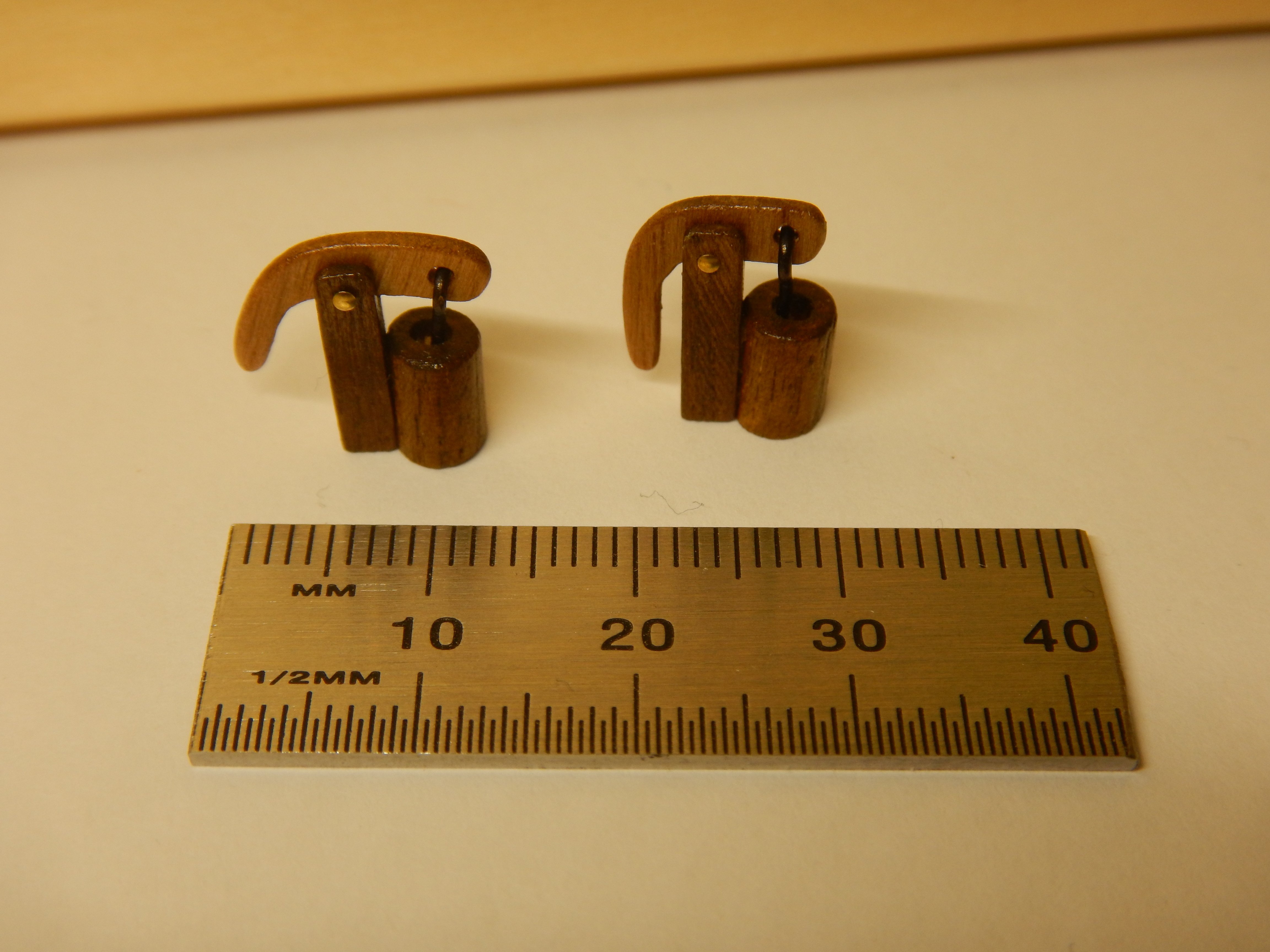

In order to add some deails to the ship which are not inculded in the kit, I built two small bilge pumps from scratch.
DSCN0687.thumb.JPG.9362c9236b13e119385e8e91b283c3ac.JPGDSCN0689.thumb.JPG.566f128a866cf2aba9a52cbf1c574fe7.JPG

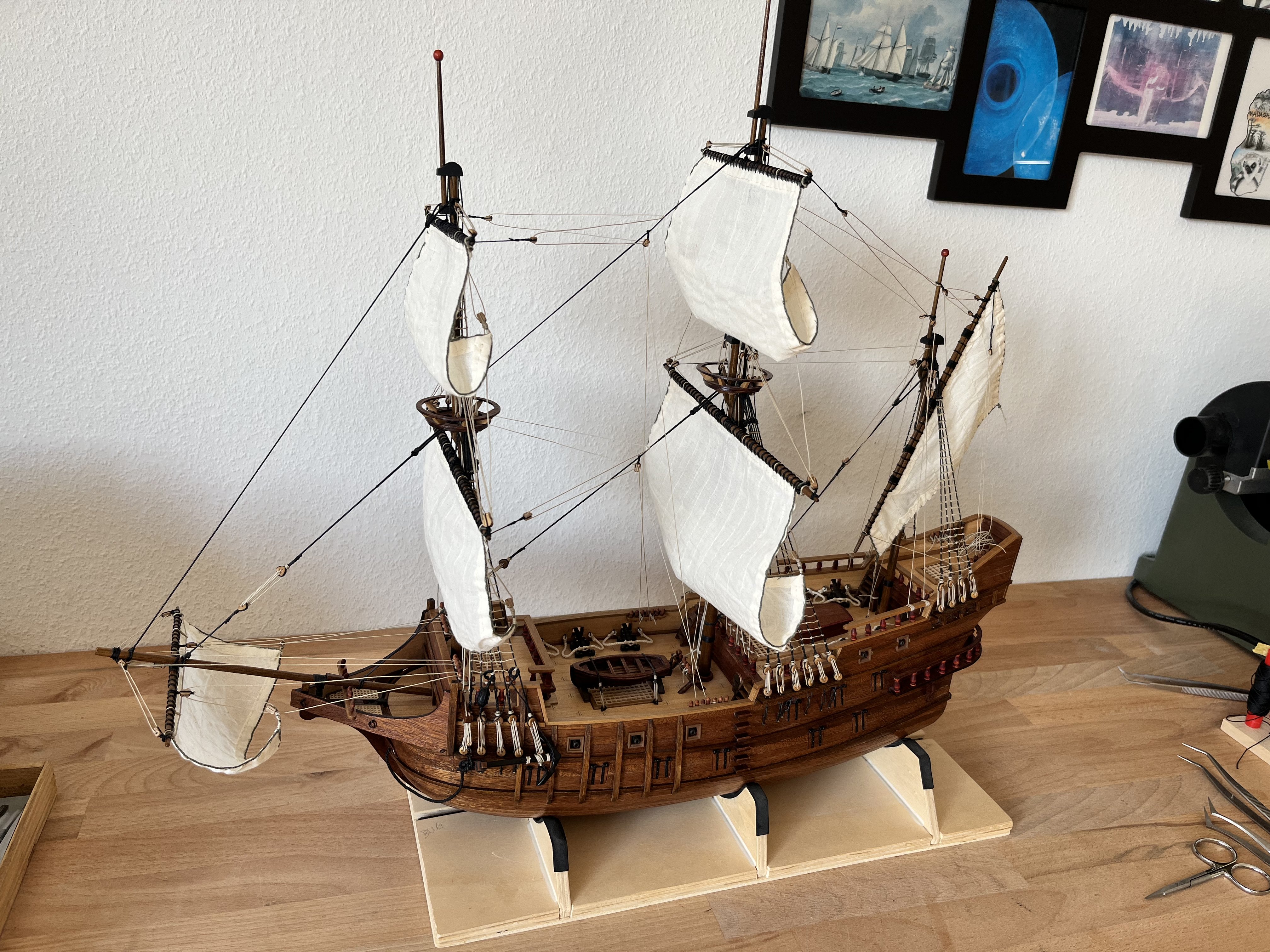

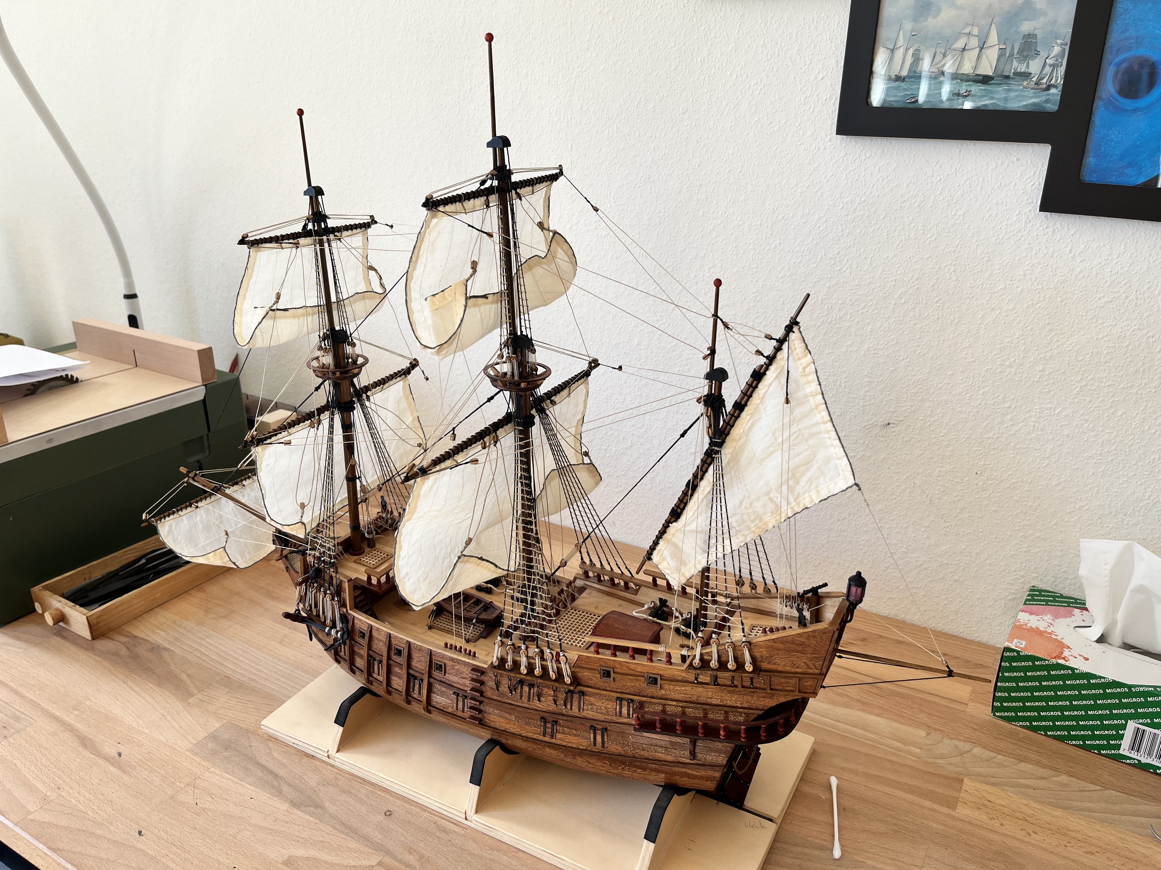

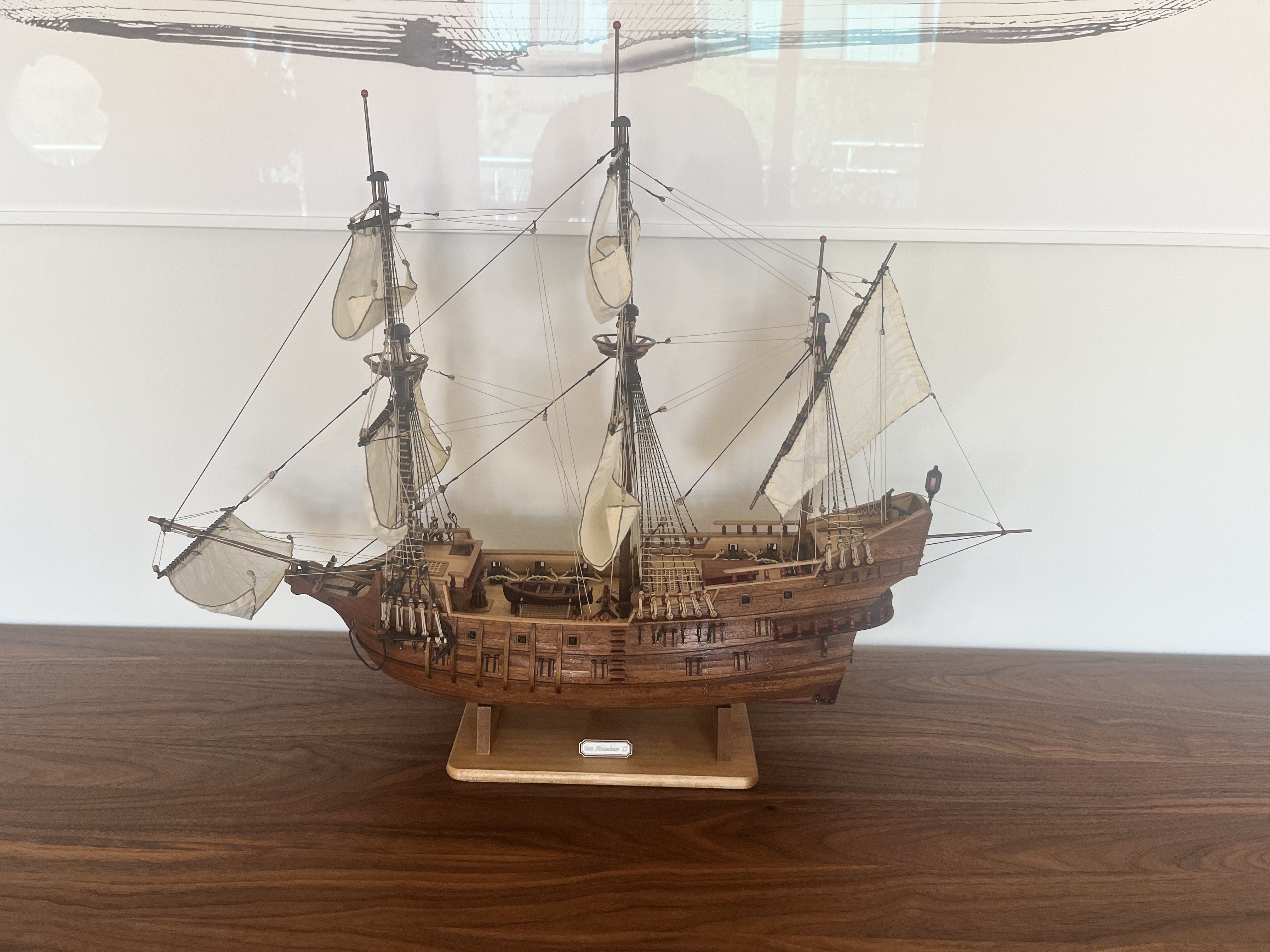

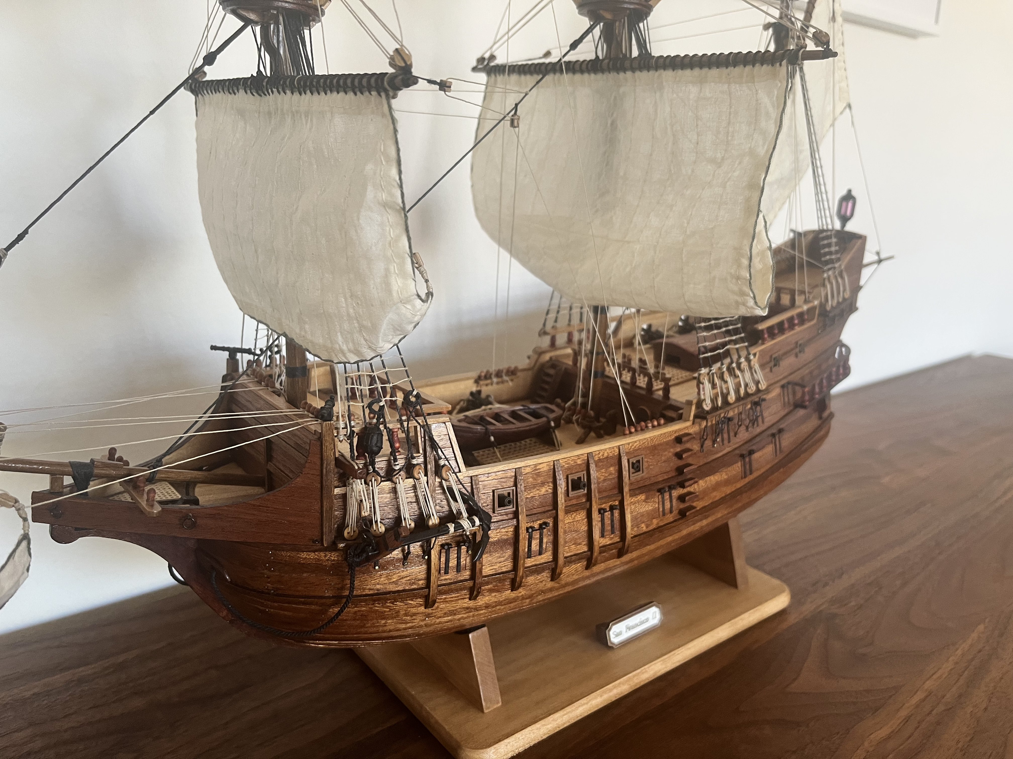

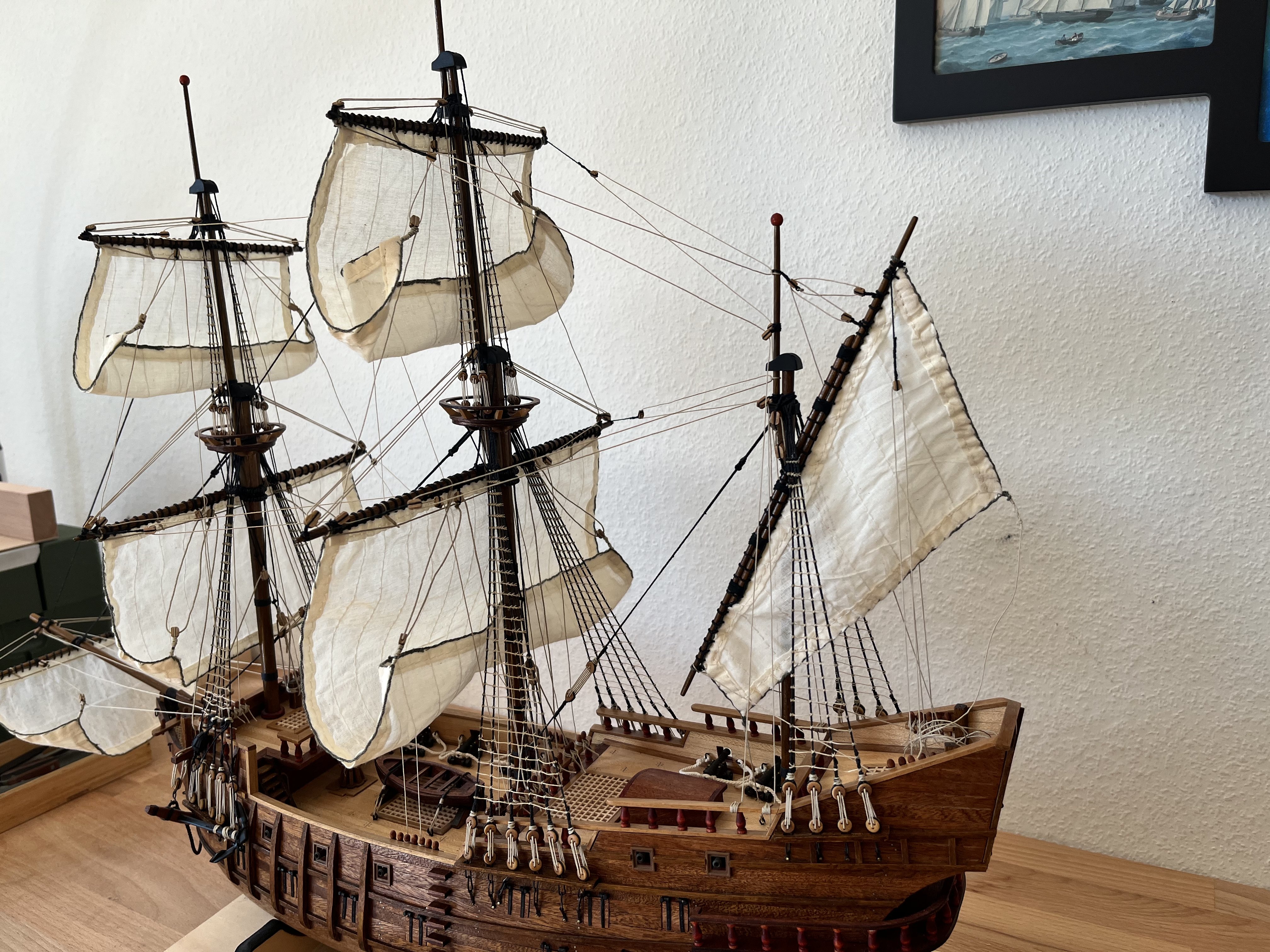

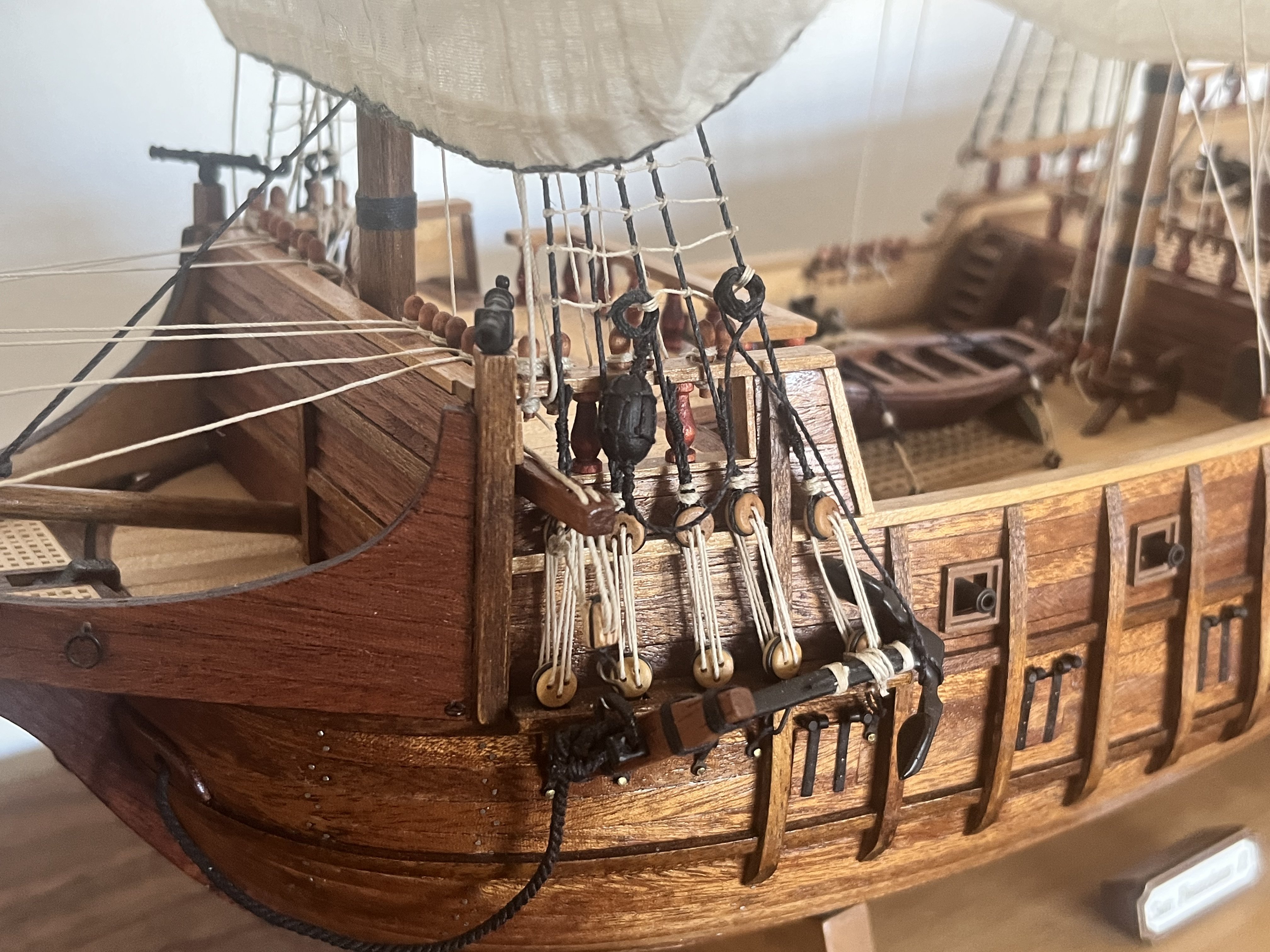

100% completed model on the stand I built for it. Really happy with the result. All went good and I learned a lot during the process of building. I'm somewhat proud of the optimizations I made on the kit, makes the model look much nicer than all that die cast parts...
Thanks guys for reading my blog here and I hope it was interesting and may give one or another some hints and inspiration 😄
